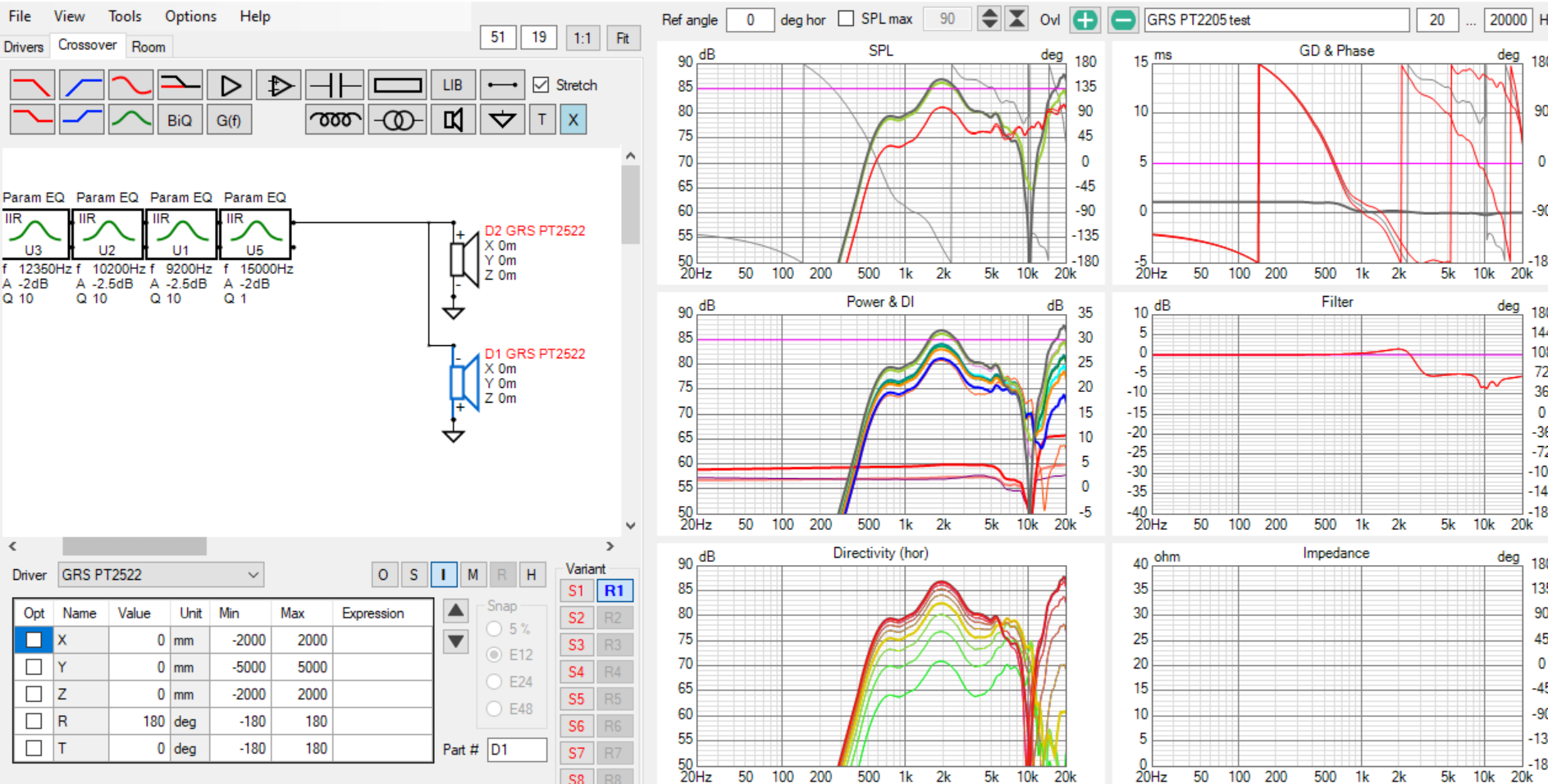

                #772
                Thank you for replies, I will try to provide more sufficient information.
                - All measurements taken at 1 meter, semi dual channel, 4ms gating. All settings followed instructions for measurements with REW, except I started measuring at 400Hz instead of 5Hz because of no DUT protection (I would not think extrapolation in low frequencies to cause issues in other end of spectrum)
                - Driver in example is a GRS open back AMT tweeter (NEO 3 clone), measured nude, no baffle
                - Measured 0 - 180 degrees in 10 deg. steps. Filename example: "GRS PT2522 raw hor 10"
                - Checked impulse response on all measurements, some had REF on reflection peaks around 90deg, so I shifted those before exporting
                - In simulation the "second" driver is inverted, Rotated 180degrees and tried delayed with Z=driver half dimension(38mm)
                I get that 10k dip is cancellation due to phases being 180deg apart, but shift in Z dim only make matters worse. In the first example indeed X,Y,Z was identical, R was 180. If I plot in a positive number in Z, more severe dips occur. Negative Z gives more useful result so I suspect some kind of timing issue.
                I did check all the impulse responses from my measurements to se if something was reversed, but they look correct to me. Surely I have done something wrong, I just can't find the culprit it seems
                Z=38mm
Name:	Dash capture Z38.png
                Z=0mm
Name:	Dash capture Z0.png

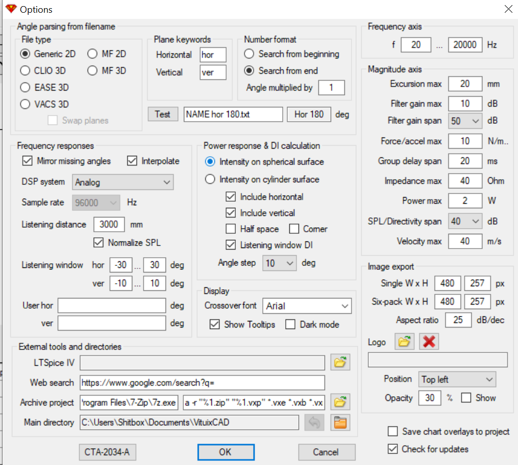

                Options settings
Name:	Options capture.png

                  I did some more brain-storming around my issue, and maybe I found something in my measurements. When Z=0 I get that dip around 10k, which is around 34mm full wavelength. In my measurements delay in relation to loopback varies from around the same approx. 30mm, except the ones around around 90deg, which is several meters. I don't understand what setting I did wrong, but I thought when gating all measurements before room reflections I would not get impulse Reference at a peak at 9-10ms (with 4ms gating). Driver is 9mm thick and centred at rotation point, so to me it makes no sense that 0deg has 15mm delay, 180 has 34mm delay. 20deg has 5mm(!) but corresponding 160deg has 34mm (same as 180, 170, 150 etc).
                  I see that my issues is probably not related to VituixCAD, but some other issues in REW or my execution. If I am cluttering this thread please let me know, and I will address it elsewhere. Thanks in advance.
                  PS; I tried attaching zipped Mdat file, but file size is above limit

                    Maybe it's best to wait for next REW revision (ea27) where at least most of the problems related to dual channel measurements should be fixed. After that I can update measurement instructions.
                    I would probably measure AMTs as mechanically and electrically complete package of two drivers = as a single dipole driver. This eliminates need to add second driver instance to XO, rotate/tilt, invert and set some Z mm to rear driver. This should not change much with correct measurement process, but it eliminates quite many variables from the equation. Variables are sensitive to incidents, accidents and mistakes.

                      #775
                      Just to be 100% certain I understand correctly - Does this mean since my AMT driver is open back and radiates about exactly the same response to the rear as the front, then it's possible to just use single driver in XO sim, with the 0 - 180deg measurements?
                      Anyways, I will look for REW update, and your updated measurement instruction. Thank you
                      • kimmosto
                        • 723
                        #776
                        Sure. That's how measurement and simulation should be done with every naturally dipole radiator. I thought you have built a dipole radiator from two separate sealed AMT drivers.

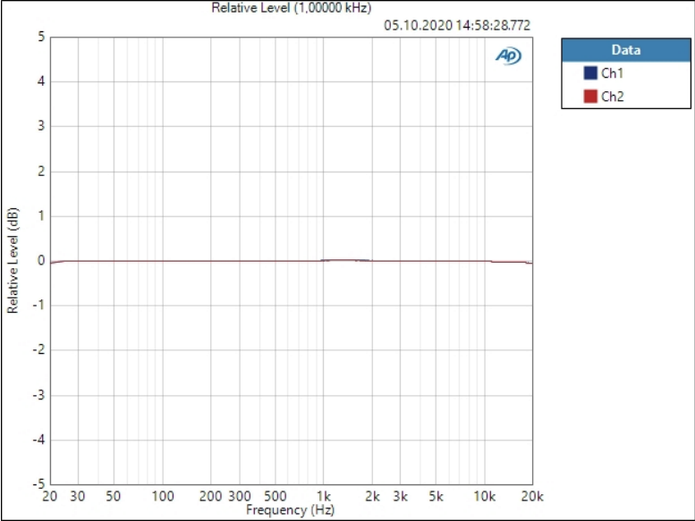

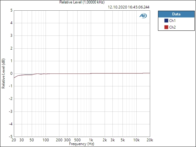

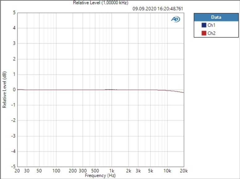

                                                                            So the full dual channel measurement is the added "Use loopback as cal [...]" I assume. Then I'd argue that your old instructions were already totally fine since I don't know any non-condenser measurement microphones and even cheap audio interfaces are almost perfectly flat in FR. Some examples from input measurements of Focusrite, Motu, Steinberg, Behringer, Presonus, Audient, Swissonic, Mackie 😀
                                                                            But it surely doesn't hurt to correct these tiny deviations, too.
                                                                              It's not about tiny deviations. Full dual supports equalization of stimuli i.e. you can add either passive or active high pass or shelving filter to signal and get automatic compensation with loopback reference so that transfer function of protective high pass or shelf is compensated and result is compatible with flat stimuli.
                                                                              Traditionally REW has had possibility to start sweep at mid-range, but that usually increases error at the lowest measured octave. And everything below starting frequency is just extrapolation.

                                                                                        Question:
                                                                                        I am trying to simulate two speakers in an enclosure while also using the crossover/dsp filters.
                                                                                        When I enable to crossover filters by checking the box in the screenshot below, the number of drivers is locked at 1.
                                                                                        Is there a different way to do this?
                                                                                            Driver instance in the crossover is just one driver. Transfer function with given generator voltage is sent from the main program to Enclosure tool, and Enclosure tool sends simulated impedance response back to main program for passive crossovers. So it's the most logical and easiest to handle when Enclosure tool has one driver, and it's terminal voltage comes from the main program. Purpose of crossover link is to enable testing of power and excursion with some active bass boost and/or subsonic filter. Simulating with single driver provides that information. After this test you can scale the system up by adding drivers and volume, and keeping system resonance constant and vent capacity adequate.
                                                                                            Purpose of Enclosure tool is to select driver and calculate box and vent/passive parameters. Not to simulate whole project with crossover.
