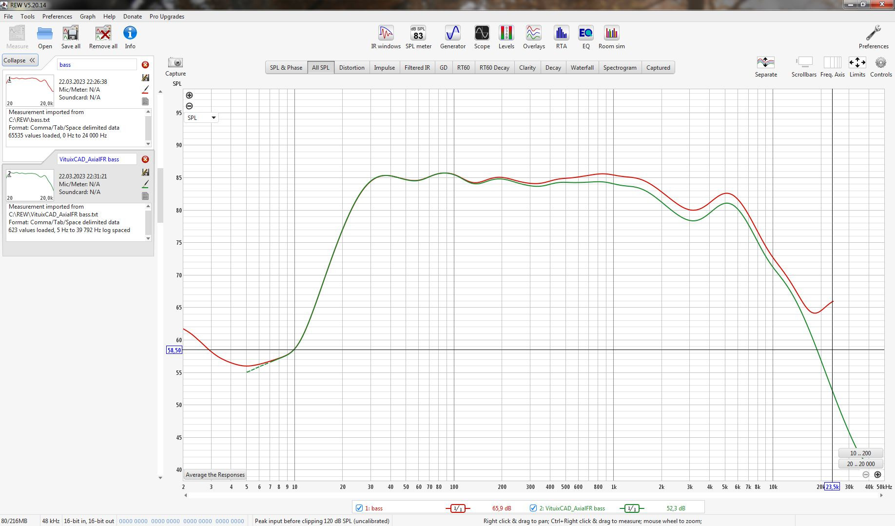

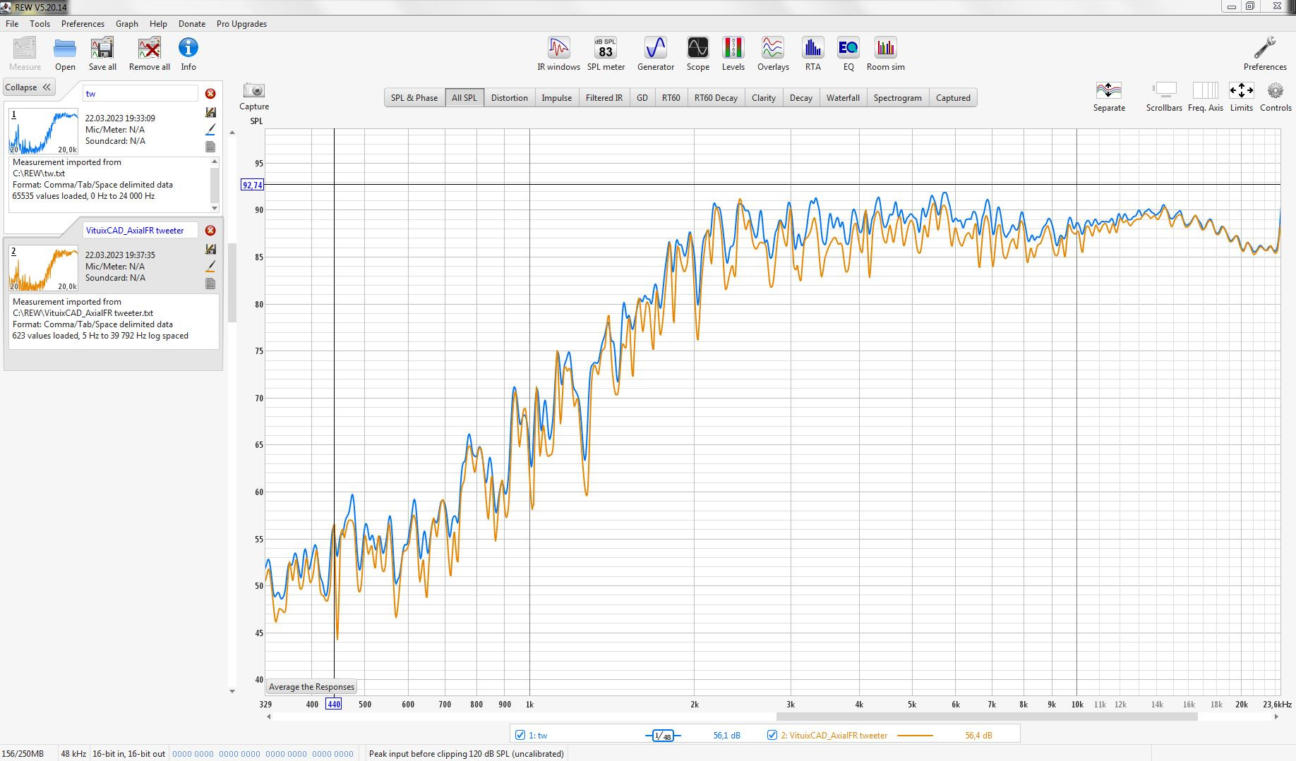

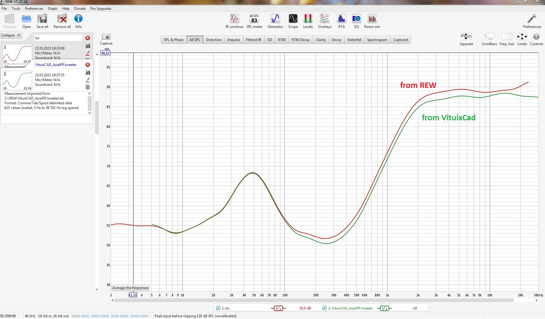

                                • Nil L
                                  • Jul 2021
                                  • 50
ID:	930481 Click image for larger version
ID:	930482 Click image for larger version
ID:	930488 Kimmo, I measured the tweeter in REW, exported to txt file, uploaded to VituixCad. It seemed to me that the FR amplitude should be slightly different. I exported this response from VituixCad to a txt file, loaded it and the original file into REW and compared. They are different. On one image, strongly smoothed responses, on the other up to 1/48. What should I do to load the response into VituixCad as it is in REW? I also compared bass and mid responses. The mid is exported 1:1, the bass after 10 kHz differs by 10-15 dB. This difference in bass response is irrelevant. But the tweeter has to be accurate.
                                  Update.
                                  I myself found out that this situation only appears if you export from REW without smoothing. 1/48 smoothing fixes this problem. It's almost 1:1, but the levels are ok.

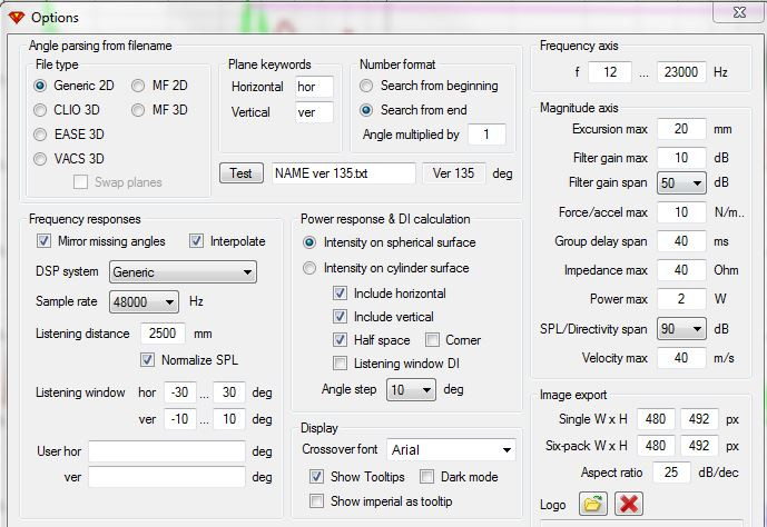

                                      I have a repeat question that I asked in post 826 I loaded the characteristics obtained from REW with 1/48 smoothing into VituixCad. In VituixCad they are displayed correctly. But after exporting impulses from the impulse view window, the tweeter, for example, is 22.5 dB higher than it was, middle is 17.5 dB higher. What could I misconfigure? After post 826 I checked, and then everything happened correctly. The levels stayed the same.
                                      Click image for larger version  Name:	options.jpg Views:	0 Size:	101.9 KB ID:	930881

                                          • Nil L
                                            • Jul 2021
                                            • 50
                                            I don't export impulses from REW, but frequency responses. And impedances. After exporting from REW to a txt file, the frequency response in VituixCad is the same as the one I observe in REW. By level.
                                            • Reet
                                              • Dec 2007
                                              • 524
                                              Sorry, I misunderstood your post. For impulse export from VituixCAD, file format other than PCM wav must be used to avoid normalization.
                                              https://discord.gg/h5SuNKDJfx
                                              • Nil L
                                                • Jul 2021
                                                • 50
                                                32-bit IEEE mono (.wav)(*.wav) is used. In the options, the 'Normalize SPL' checkbox, turned on and off, does not change the impulse export.

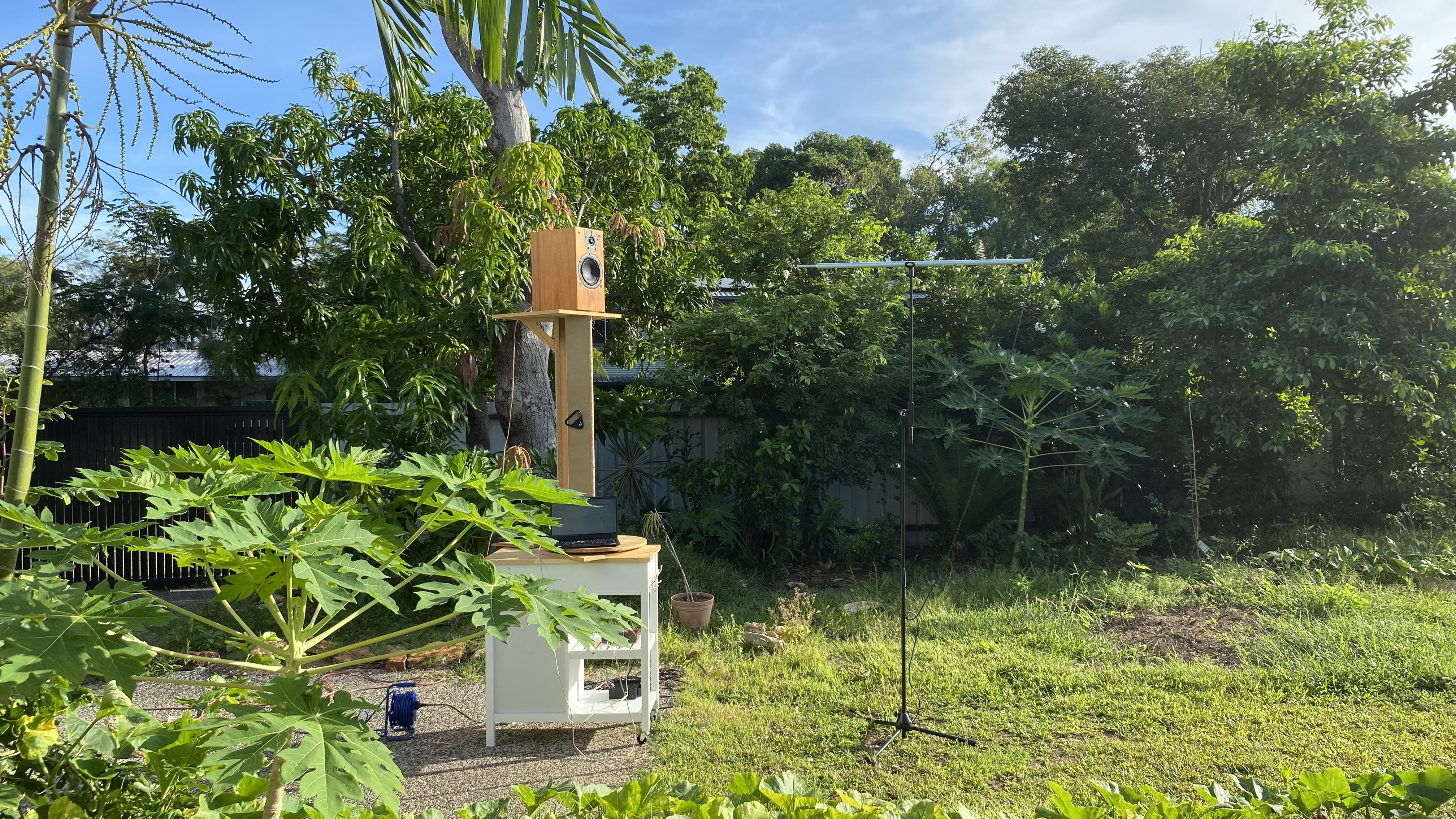

                                                    • tktran
                                                      • 661
                                                      Originally posted by Reet
                                                      Measurement distance is really up to you, there must be a balance as farther is better to capture real diffraction at listening distance, but closer is better as far as window length goes. 1m is generally a good distance for most speakers indoors, until you are building big cabinets where 3x cabinet width is >1m.​ Closer than 1m distance may allow for slight increase in window length, but quite minimal difference to actual measured data resolution.
                                                      Thanks for this. I spent the last few Sunday night at the local basketball court from 9PM to MIDNIGHT! taking measurements at great heights.
                                                      Which is great as far as low noise floor (30dB) and window lengths (>10ms) are concerned.
                                                      Except that setting and packing up takes SO LONG:
                                                      Click image for larger version  Name:	C124FDB6-D3AE-4AE1-B7E3-82A2B6248C9C.jpg Views:	0 Size:	2.51 MB ID:	930913
                                                      I'd rather do it from the comfort of my own spare room, but it's only practicable at about 50cm for a nice window length.

                                                                      • tktran
                                                                        • 661
                                                                        Click image for larger version  Name:	13D60080-178F-499B-93A5-2654453E50F2.jpg Views:	1 Size:	3.52 MB ID:	931053
                                                                        LIVE!
                                                                        stay tuned…
                                                                        • tktran
                                                                          • 661
                                                                          Far field measurements first​
                                                                          Edit: Scale and colours changed for clarity​​

                                                                              This is a midwoofer with response down to below 50Hz, yes.
                                                                              However, to get a reflection free (anechoic) response down to 50Hz; we need a gate time of 20ms
                                                                              The math is T = 1/f where f is the frequency in Hz and T is the period in seconds.
                                                                              So if you want to measure to 50Hz, you need a window of 1/50 = 0.02 secs = 20ms.
                                                                              There's a tool included in VituixCAD2:
                                                                              Auxiliary -> Time window that you can use to calculate this-
                                                                              eg. to measure down to 50Hz, at a distance of 1.5m; that means the speaker and microphone have to be off the ground by more than 4.15m:
                                                                              Click image for larger version  Name:	image.png Views:	0 Size:	16.3 KB ID:	931280
                                                                              To measure at 2m, the speaker has to be off the ground at least 4.4m
                                                                              Click image for larger version  Name:	image.png Views:	0 Size:	14.1 KB ID:	931285
                                                                              If you're NOT using VituixCAD2 you can try it for yourself online:
                                                                              I do have the ability to measure at 5m above the ground, but I'm too lazy- to set up and pack up is even more bothersome than the basketball court!
                                                                              I prefer to do it indoors in my lab and merge the farfield with the nearfield, as per Kimmo's instructions:
                                                                              page 14 of:
                                                                              VituixCAD_Measurement_REW.pdf (kimmosaunisto.net)
