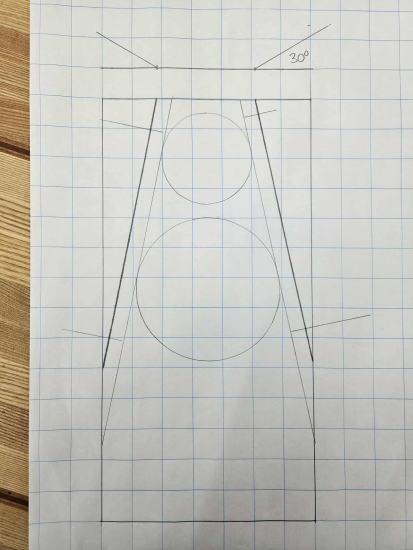

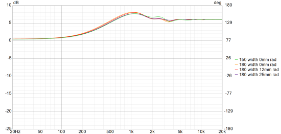

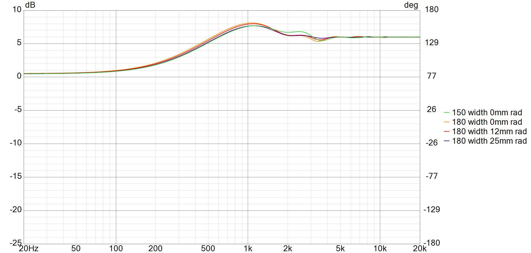

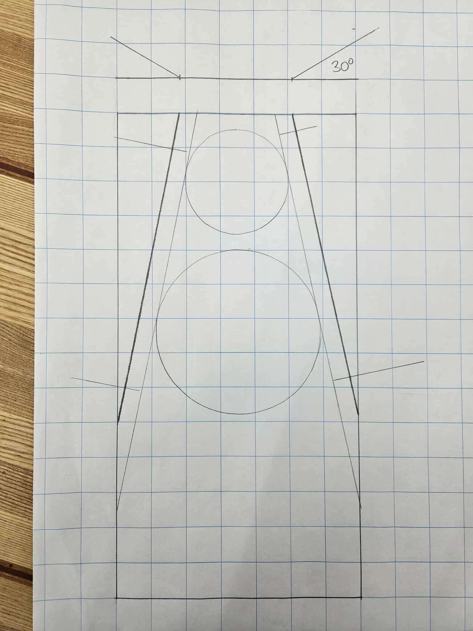

    At the risk of splitting hairs, I am wondering how to best model enclosure diffraction when the cabinet has beveled facets.
    Here is the cabinet drawing, 350mm tall, 180mm wide, driver 190mm from bottom, driver SD 54cm^2,
    And here are some diffraction simulations,
    Orange - 180mm cabinet width with square edges ignoring the bevel
    Red - 180mm cabinet width, treating the bevel as a roundover based on where the bevel lands in the middle of the woofer
    Purple - 180mm cabinet width, treating the bevel as a roundover based on where the bevel is at the top of the woofer
    Green - 150mm cabinet, treating the cabinet width as being the bevel in the middle of the woofer.
    I realize that for the purpose of baffle step, these are all within 1/2 dB and not going to make a world of difference, I was just wondering which simulation would you consider most correct?
    My poorly educated guess would be "Red".

      For the intended purpose of diffraction simulation, which would be to apply to nearfield response of a woofer, I would probably just take the size of the facet directly horizontal to the centre of the woofer and apply that as a roundover and call it good, so red trace if I understand your descriptions properly.
      I know you have some completed speakers with these big facets, why don't you compare with your own real-world measurements? Which one of these responses when applied to the nearfield response and merged, has the best alignment with the final speaker measured response?

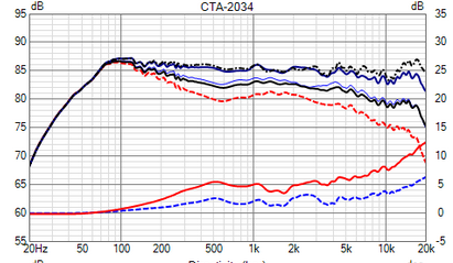

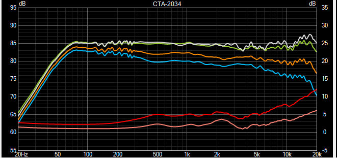

            Target zones in CTA-2034 chart as a function of standard directivity index slope, since rev. 2.0.133.0:
            Red circles are default values of target slopes (SL_) in Preference rating window: Close to Constant DI @DI-slope=0.3 dB/oct, Half space @DI-slope=0.78 dB/oct, Full space @DI-slope=1.18 dB/oct. Ideal 'Constant DI' does not have default values (all -0.8 dB/oct). It's too theoretical.
            Click image for larger version  Name:	image.png Views:	1 Size:	100.8 KB ID:	960099

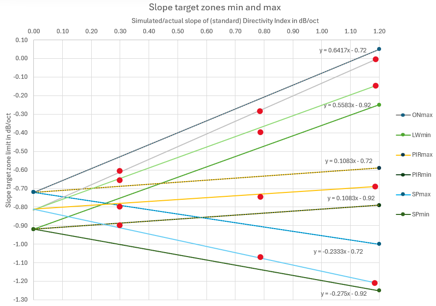

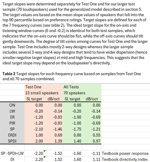

              Originally posted by kimmosto
              For example default values of SL_LW, SL_PIR and SL_SP for 'Full space' are equal to 'Multiple Regression Model for Predicting Loudspeaker Preference Using Objective Measurements Part II' by S. Olive.
              Chapter related to slope targets. Last two rows are calculated from Olive's table, not included in the original.
              Click image for larger version  Name:	image.png Views:	0 Size:	61.6 KB ID:	960105
                  There are few typos in Olive's paper...
                  There are also a couple of ambiguities or illogicalities. Preferred speakers in the big group have target LW slope = -0.2 and target SP slope = -1.75, but target SPDI slope = 1.4. It should be 1.75 - 0.2 = 1.55 if the same speakers were preferred. Maybe each variable has own group of preferred speakers...
                  Speakers in the small group were 2-ways having higher directivity slopes due to directivity of smaller box and less crossover bands. Can we assume that lower slopes would be more preferred also with 2-ways, but really good 2-ways with lower slopes were not available and tested? Or was stronger directivity more important in that room acoustics than better (=lower) directivity slopes? Combination of reverberation time and listening distance may not support well-designed small 2-ways with healthier directivity slopes.
                  Speakers were not listened off-axis or off-room. Speakers were not listened how they are normally listened to. Monophonic only, one speaker at 3 m, directly in front of the listener. In the consumer market, everyone does not sit in the same listening spot whole time. If someone does, they are most likely listening in stereo or multi-channel, meaning the angle between listener's ears and the speaker was not correct either (except for HT center). Music samples were almost the same elevator muzak. Few sharpened drum beats, but no real transients, heavy loads or real acoustic orchestra for sure. Listeners were led to focus on the tones of the singer, guitars and a few other instruments. Why not, because there was no intention to study anything else due to preconditions. The study was so limited that for example directivity slopes, dynamics, non-linear distortion, direction of wavefront, sound stage / diffraction problems dropped to zero or close to. So here we are - too many variables has become irrelevant on some forum(s) because they were not properly studied when it was possible.
                  Last edited by kimmosto; 06 February 2026, 12:27 Friday. Reason: dB/oct units removed

                      #1270
                      Chapter related to slope targets...
                      Quoted message updated completely. Added text by S. Olive, target values in dB/oct and calculated textbook power response and DI slopes.
                      Few comments to Olive's short text:
                      The ideal target slope for the on-axis and listening window curves (0 and –0.2) is identical for both test samples, which indicates that the on-axis curve should be flat, while the off-axis curves should tilt gently downwards.
                      Agree, but other directivity patterns than unidirectional boxed were not (presumably) studied so this this cannot be generalized. I'm quite sure horizontal on-axis cannot be generalized because nothing in practice has indicated that. More constant directivity (flat horizontal DI or widening dispersion at top octave) -> more on-axis tilt down.
                      The degree of tilt varies among curves for Test One and the larger sample. Test One includes mostly 2-way designs whereas the larger sample includes several 3-way and 4-way designs that tend to have wider dispersion (hence smaller negative target slopes) at mid and high frequencies. This suggests that the ideal target slope may depend on the loudspeaker’s directivity.
                      3- and 4-ways don't necessarily have wider dispersion at H.F. than small 2-ways. They can have smaller mid so dispersion at upper mid can be wider. More ways and larger front baffle increase directivity at lower mid ... upper bass so large traditional multi-ways usually have more linear directivity index and lower off-axis slopes. Agree that this suggests that the ideal target slope may depend on the loudspeaker’s directivity, but dependence locates probably in on-axis, listening window and power response. Not (so much) in predicted in-room because it represents perceived tonal balance at mid...far field better than on-axis and listening window alone. Power rules more to far field + off-axis. In addition, speakers in Test One were quite bad in average so we can ignore the results and conclusions quite safely, though slope targets in the table are calculated from top-10 %.
                      Dipole usually produces extra reflected phase matching pressure to mid-bass so on-axis and listening window slopes can be more horizontal than with cardioidish. Dips at L.F. in room response reduce energy and tilt balance up so large boxed or cardioid woofer arrays with solid wavefront towards the listener can have more horizontal on-axis than e.g. small bass cardioid requiring intentional bass boost. And so on, not forgetting the tilt of room reverberation balance.

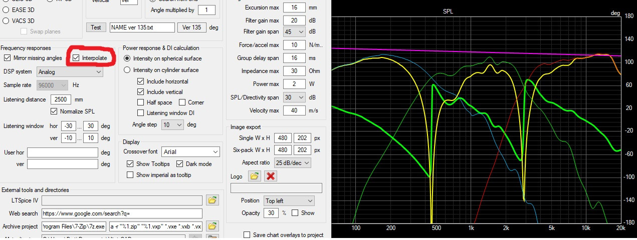

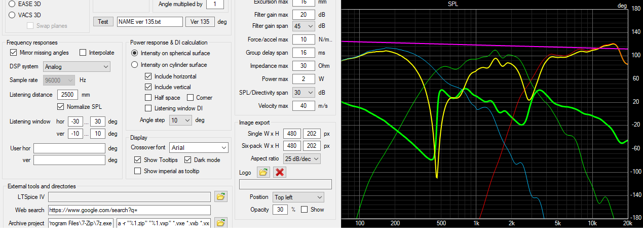

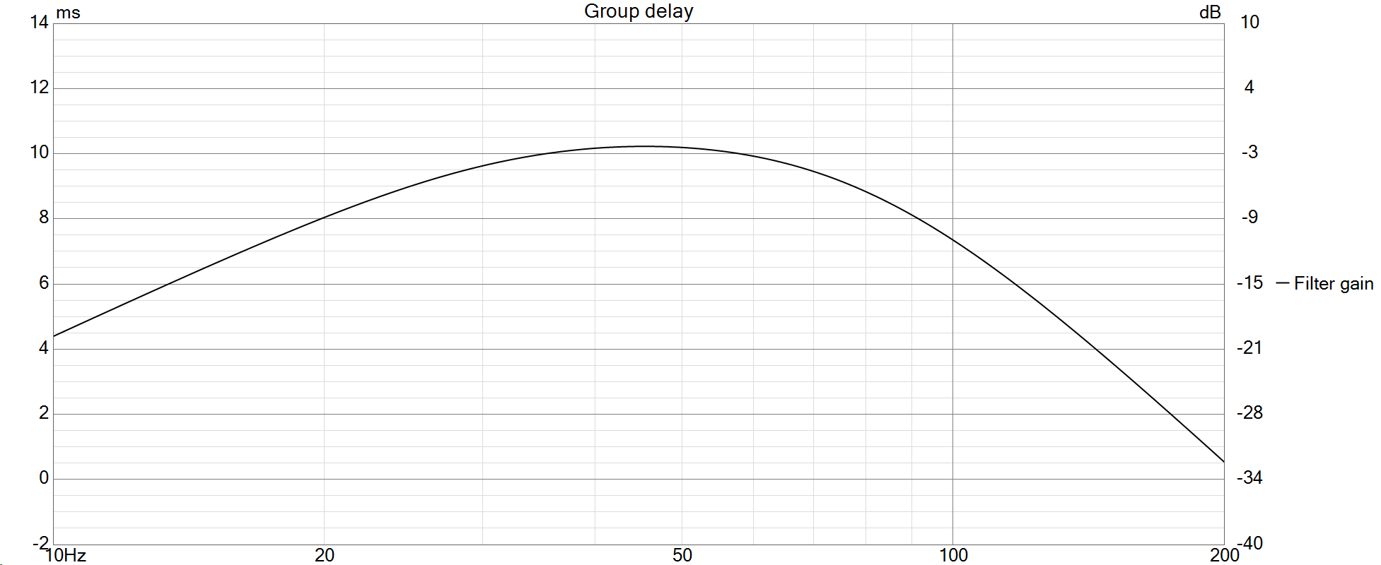

                                              Hello. I would like to make a small suggestion for an added feature. When I am using the Enclosure Tool, I often work with various high-pass and low-pass filters. I use the Group Delay panel to display the filter gain, but I tend to swicth off the display of the Group delay trace, leaving just the Filter gain trace, which is what I am interested in seeing. Below is an example:
                                              To make the display of filter gain make more sense in this particular use case, would it be possible to change the "Group delay" graph heading to "Filter gain"? I imagine that it should not be very difficult to do that. Ideally, it would also be great if the dB axis was now displayed on the left-hand side of the plot, and the group delay axis was completely omitted in this instance.
                                              If both "Group delay" and "Filter gain" are being displayed simultaneously, would it be possible to change the "Group delay" heading to "Group Delay and Filter Gain"?
                                              If only group delay is being displayed, then would it be possible to completely omit the dB axis that is labelled on the right-hand side?
                                              Taken together, those relatively minor changes would considerably enhance the UX.
                                              Thank you for giving due consideration to my request.
                                              • kimmosto
                                                • 712
                                                #1283
                                                ^I need to stabilize Y-scale in Frequency domain tab of Impulse response window anyway so I can look Enclosure too.

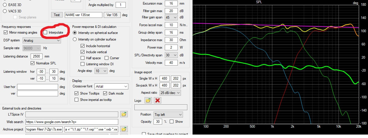

                                                  Just want to mention that the VituixCAD help page appears to be missing today - 404 Not found.
                                                  • kimmosto
                                                    • 712
                                                    #1285
                                                    Few days ago service provider informed that my site has exceeded maximum data transfer so I temporarily removed user manual to maintain download service without extra payments. Site uses <3 % of maximum size, but data transfer hits the limit.
                                                    Negotiations to balance maximum size and data transfer have started. Situation is that customer service did not understand Finnish or was too busy read my questions.
                                                    It's also possible to change service provider or move setup and help docs to somewhere else (shared cloud). Less revisions per month might not help because all - thousands of users would download within the same month anyway.

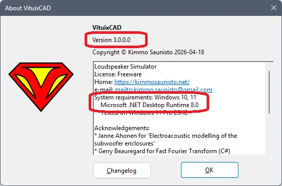

                                                          Plan is to update source code for .NET 8.0, convert old practices to new syntax recommendations and rules, and simplify the code. .NET (core) is more modern and significantly faster in some tasks than .NET Framework. Basic work including more than 3000 modifications and code refactoring is already done. It's basically ready for beta testing. This was possible within a week while conversion to Java or something else would require a year or two.
                                                          Click image for larger version  Name:	image.png Views:	0 Size:	118.1 KB ID:	960439
                                                          .NET 8.0 will drop Windows 7 and 8 users out. .NET 5.0 would support Win 7 and 8, but I've not yet tested is it possible to step back from 8 down to 5. The latest .NET LTS version is .NET 10 supported until November 14, 2028, and .NET 8.0 is supported until November 10, 2026 so I already have small pressure to go forward.
                                                          What do you think?

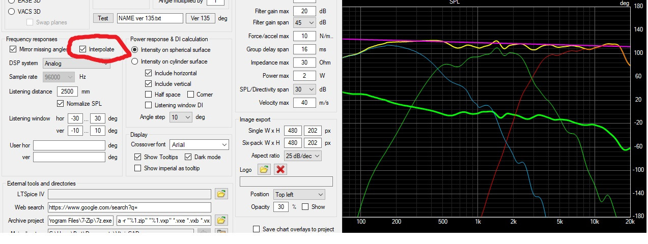

                                                                        • BartL
                                                                          • Mar 2026
                                                                          #1296
                                                                          V2.0.130.1
                                                                          On the option Tab you have the possibility to interpolate off axis responses.
                                                                          When I turn this feature on or off I got very different results.
                                                                          I made measurements 0-15-30-45-60 degrees.
                                                                          What is the correct setting for this option?
Name:	No interpolation 2.jpg
Name:	No interpolation 1.png
                                                                          I'm confused 🤔
                                                                          Do you need some adjustments on the "Listing window" settings to match the steps off the measurements angles? (step of 15 degrees in my case)
                                                                          What is the meaning of user hor & ver?
                                                                          • kimmosto
                                                                            • 712
                                                                            #1297
                                                                            User manual says:
                                                                            Frequency responses are interpolated between off-axis angles and planes loaded to drivers when Interpolate is checked. Program selects the closest off-axis angle loaded to driver when Interpolate is unchecked. This could cause some errors and discontinuities, but enables simple tests and projects with few responses only in Directivity chart.
                                                                            Angle density of simulated and visualized off-axis directions is selected with Angle step list box. Available options are 0, 5, 10, 15, 20 and 30 deg. Off-axis angles loaded to drivers are simulated when 0 deg is selected. Initial value is 10 deg.
                                                                            Generic 2D is configurable option allowing user to specify how plane and angle value are coded in frequency response filename. Plane keywords define how to distinguish between horizontal and vertical axis. Horizontal axis is selected if keyword of vertical plane is not found in the filename. Search from beginning/end defines whether VituixCAD should start parsing angle value from the beginning of the filename (hor +150 drivername.txt) or the end (drivername hor +150.txt). Angle multiplied by defines how angle value is formatted. For example if 1500 represents 15 degrees off-axis, use Angle multiplied by 100. This option is compatible with ARTA, CLIO in 2D mode.​
                                                                            • kimmosto
                                                                              • 712
                                                                              #1298
                                                                              Listening window (LW) is specified in CTA-2034 to include -30,-20,-10,0,10,20,30 deg off-axis in horizontal plane and -10,+10 in vertical plane. That is one small reason why you could measure and simulate with 10 deg steps. You should also measure 0-180 deg to simulate CTA-2034 parameters for normal full space design.
                                                                              VituixCAD is very flexible with interpolations enabled. It does not care much about angle step and coverage, but you could follow recommendations (in measurement instructions) and play with default settings to get more accurate results.
                                                                              • BartL
                                                                                • Mar 2026
                                                                                #1299
                                                                                User manual says:
                                                                                Still confusing 🤔 read it 3 times.
                                                                                Still don't quiet understand what would be the correct setting in my case 😕.
                                                                                The above picture is on axis. 0 degree measurement.
                                                                                Still, toggling the interpolation on/off shows different results.
                                                                                • Reet
                                                                                  • Dec 2007
                                                                                  • 816
                                                                                  #1300
                                                                                  When driver coordinates are entered, woofer may be 5.6 degrees angle to the listening location centered on-axis with tweeter at 2500mm. With measurements at 10 degree intervals, interpolation would be required to provide an estimate of the result at 5.6 degrees. Without interpolation, it will simply use 10 degree measurement as-is since it is closest to the required angle.
                                                                                  Most will leave interpolation enabled as it is by default, unless you have some high resolution of angular measurements I don't really see any reason not to use interpolated data.
                                                                                  • kimmosto
                                                                                    • 712
                                                                                    #1301
                                                                                    'No interpolation' is primarily designed for:
                                                                                    1) Coaxial 2-ways having both drivers at X,Y,Z=0,0,0 mm and R,T=0,0 deg because measured and simulated exit angles match to all off-axis angles.
                                                                                    2) Professionals who can measure in large anechoic at 2-3 m without time window, keeping rotation center (of mic or speaker) at the same position for all drivers. This enables setting all drivers to X,Y,Z=0,0,0 mm in the schematic because all exit angles match between measurement and simulation. Distance from each driver to mic will change while (vertical) rotation - especially with large constructions so there will be some dense phase wrapping in measurement data. That does not harm summing at the mic, but GD cannot be calculated to off-axis angles. Fortunately it's not usually needed.
                                                                                    One small thing in BartL's screen captures is testing with inverted polarity of mid. That method is not valuable while simulation. Phase mismatch is one possible tool to control direction of main axis usually in vertical plane, power balance and timing (reduce...minimize excess group delay). Inverted polarity method can be used as sanity check to compare timing of simulation and actual speaker. Sometimes mic or speaker stand bends causing error to timing and phase responses if designer forgets to double check actual distance from rotation center to microphone before measurement sequence. Required accuracy is just few millimeters if the highest XO frequency > 3 kHz.
                                                                                    So common people like us keep Interpolation checked. Mid-woofer and tweeter of tiny designs can be measured using the same mic position for both drivers. Interpolation does not help much with tiny speakers because error between simulated and measured exit angles is small. Interpolation is best to keep on that you don't forget it off.
                                                                                    With 15 deg angle step while measurements it's safest to simulate with 15 deg angle step to minimize effect of interpolation due to exit angle error. 5 of 5 measurements within 0-60 deg are probably quite close to simulated 0, 15, 30, 45, 60, ... deg.
                                                                                    Options:
                                                                                    Click image for larger version  Name:	image.png Views:	0 Size:	1.4 KB ID:	960545
                                                                                    3 of 5 measurements (0, 30, 60) would be close to measurement data if simulated angle step is 10 deg.
                                                                                    0 deg setting in Options uses measured angles only.
