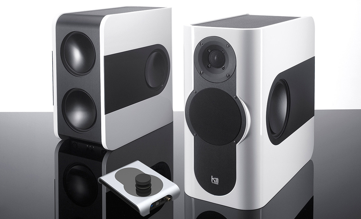

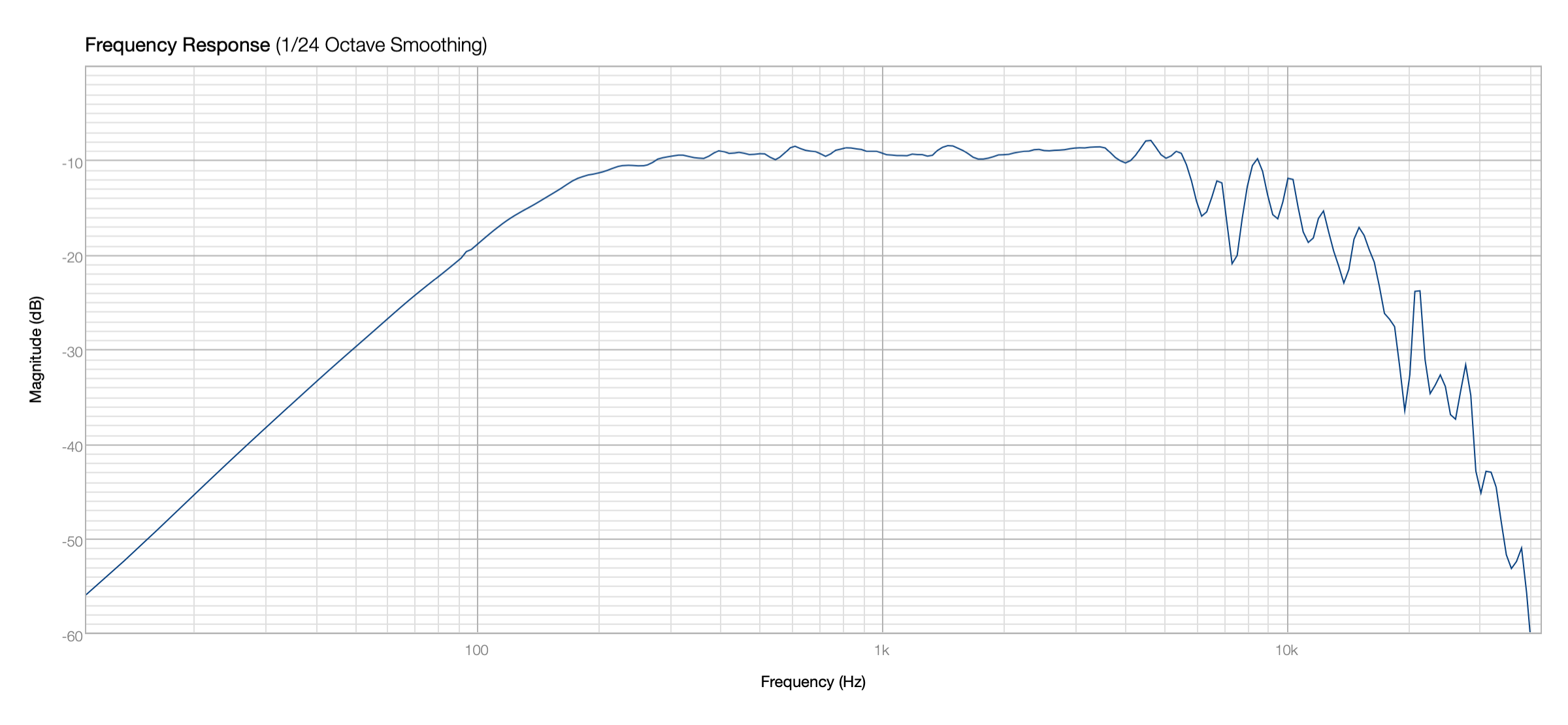

    The Kii Three has always, in my perception, been emblematic of the most clever technique and thoughtfulness of Bruno Putzeys.
    Impressive... most impressive.
Name:	Kii Three.jpg

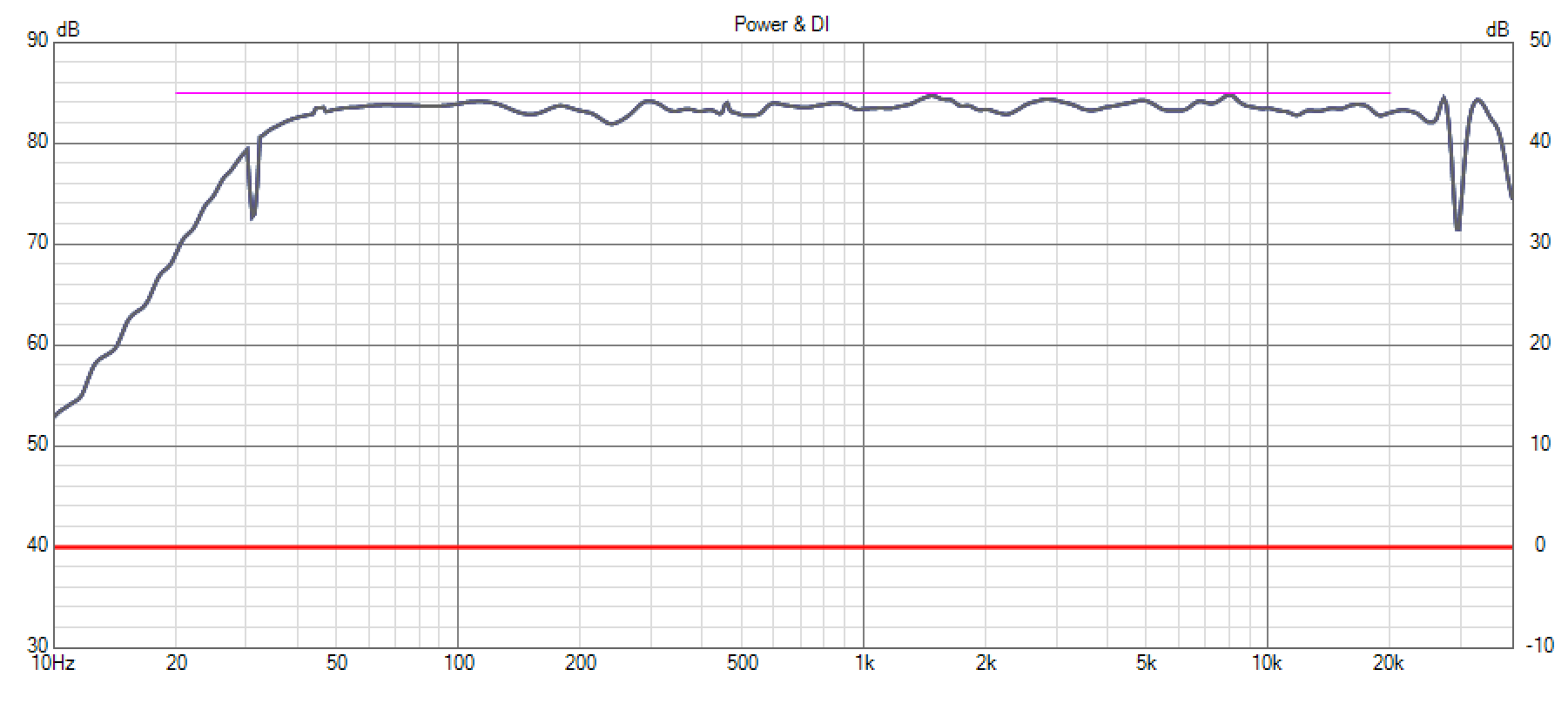

    Like the Dutch & Dutch 8C, it proposes to develop a cardioid in room response profile,
    Yet, at the same time, I must offer the opinion that it may suffer in some regards from the same level of complexity and tradeoffs inherent in this approach as implemented by the D&D 8C.
    This introduction from the Six Moons review can convey key aspects of the configuration, as well as some concerns, yet still miss some more subtle yet important issues that were addressed successfully in early designs such as the Natalie P, which cannot be addressed by this approach.
    Wave shaping tech is key to Kii. This fully DSP-controlled active 6-driver compact breaks the rules. Its bass is actually directional. Cardioid aka heart-shaped dispersion is the technical term for its propagation shape. The upshot? Unlike conventional speakers, the Kii Three wants to be more blasé about room interference. It directs most of its sound at the listener, eliminating or at least attenuating side and especially rear radiation with strategic phase-canceling chicanery. This downplays usual room dependencies. It performs superior in far more real-world situations including very close to the wall. For a perfect step response of what is a three-way—reference this for the actual graph—its designers use minor time delay on their frontal drivers. This lets the side and rear woofers catch up.
    That trick plus claimed 20Hz response can only do the work because filtering and compensation occur in the digital domain. Analog inputs must convert. By the same token, LF headroom must be lower than mid and high freqs because, to keep its box small, the Kii Three gooses bass gain on its built-in amps to offset natural roll-off. In payment for this, it abolishes your own amplification and D/A conversion. Its functional very high IQ relies on the designers controlling all the parameters, not letting us techno peasants piecemeal it. This eliminates the lego and puzzle crowd who insist on arbitrary system assemblage. Au revoir, amigos. Those who—gasp!—are still with us have notions:

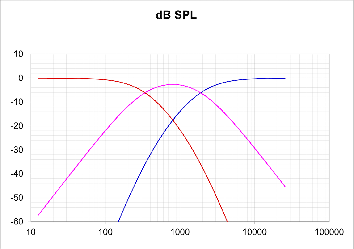

Name:	Duelund 800-2.75.png
    An RMS average of the forward +30 to -30 degree laterally measured previously was used to evaluate a fast Proof Of Concept for the HF section, deemed to be more of a challenge. The result was reasonably satisfactory...

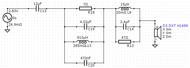

Name:	DXT H1499 Fs Zobel XO-SPL-1A.png

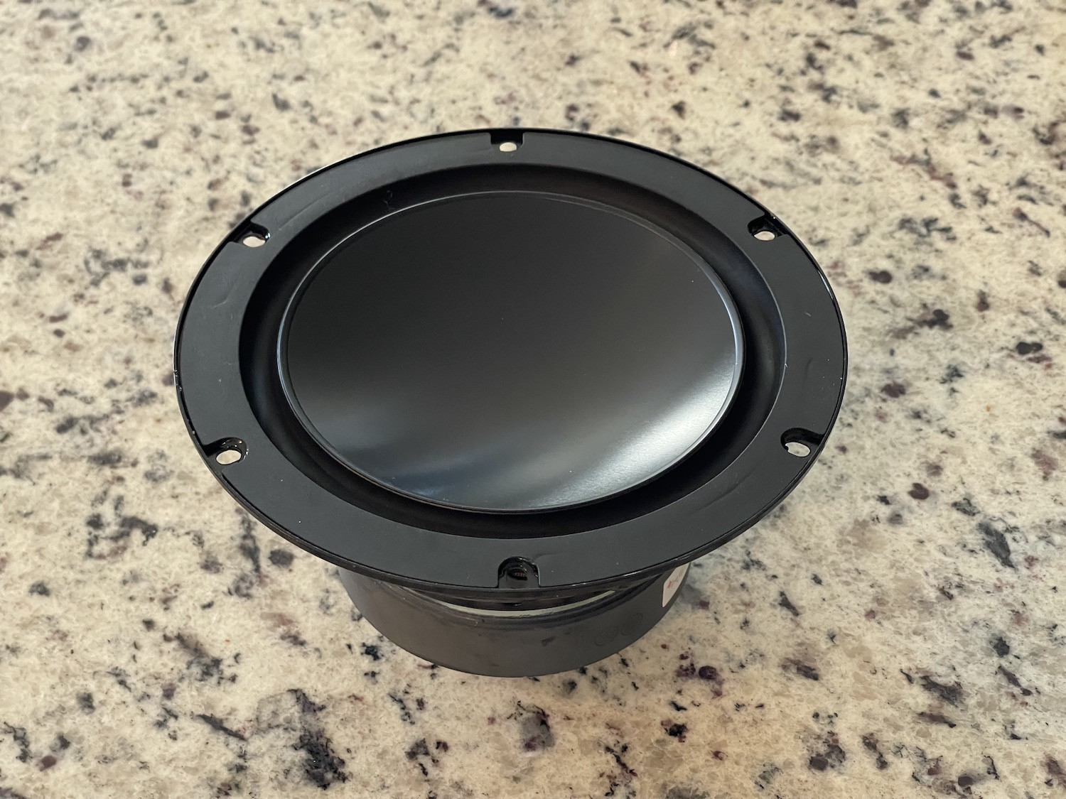

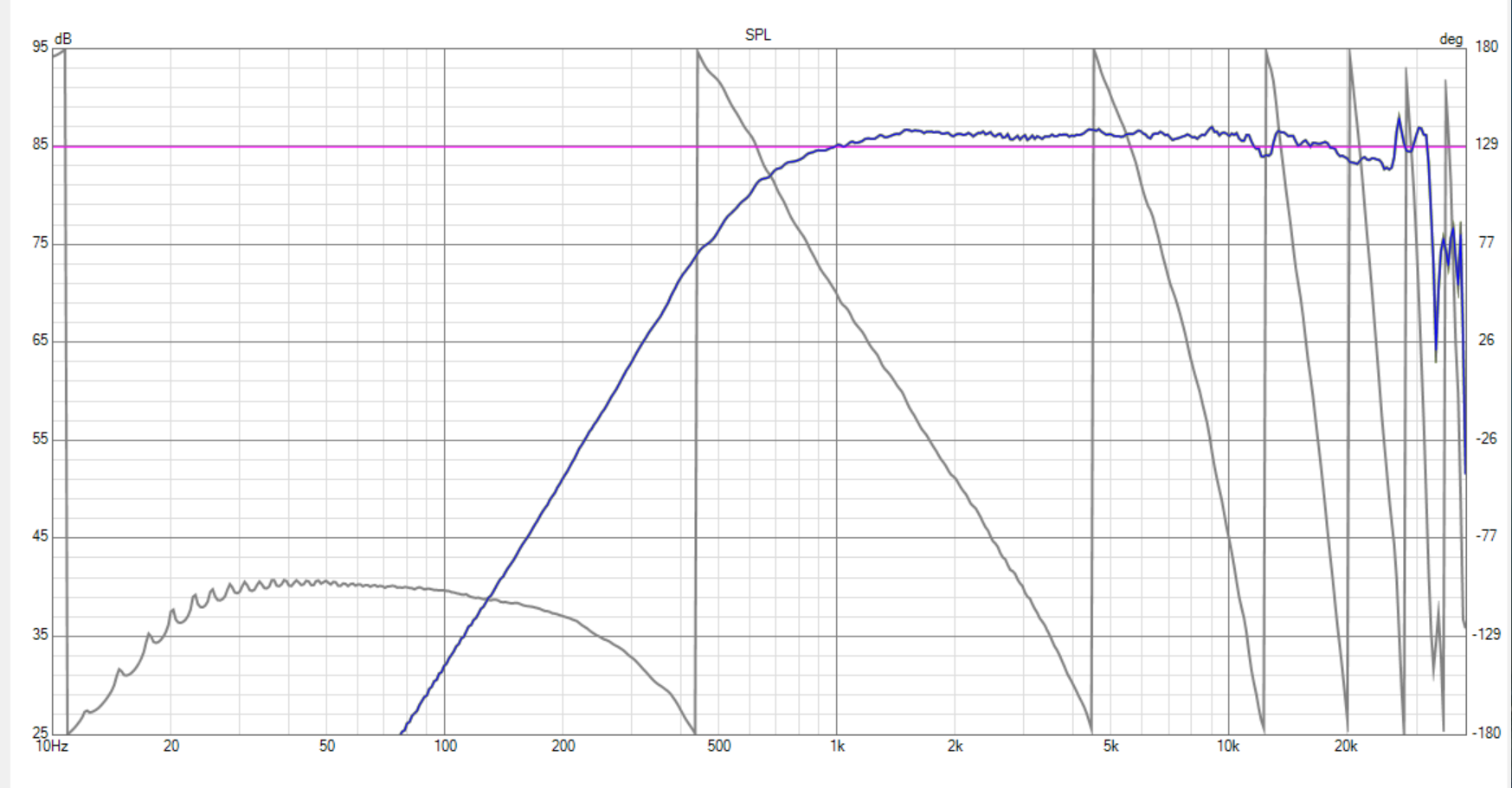

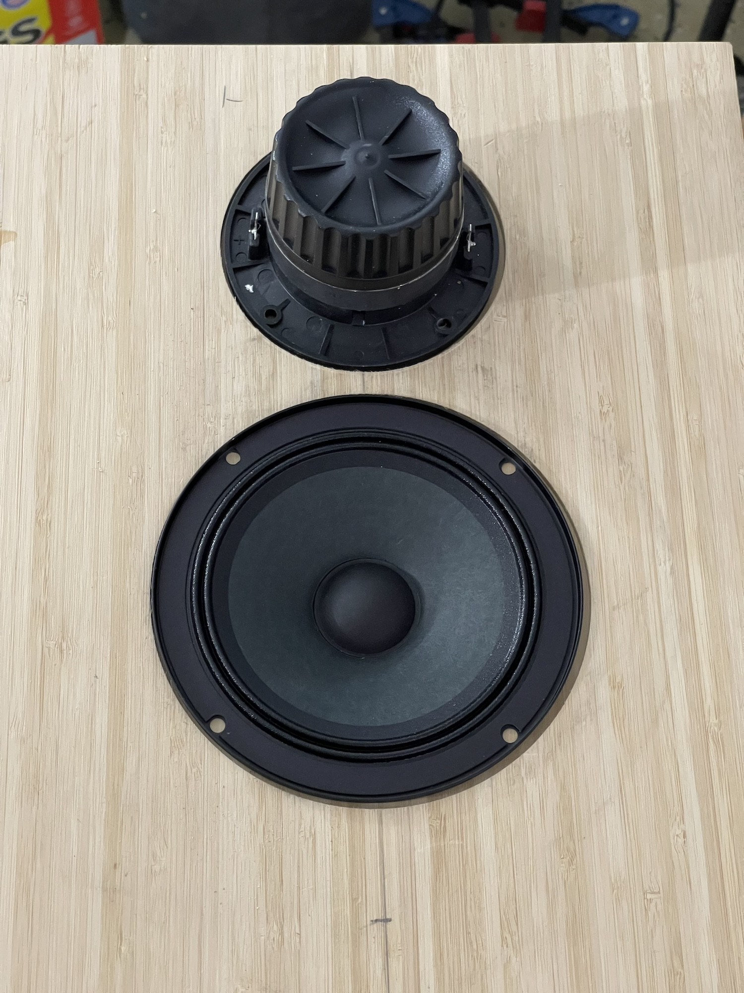

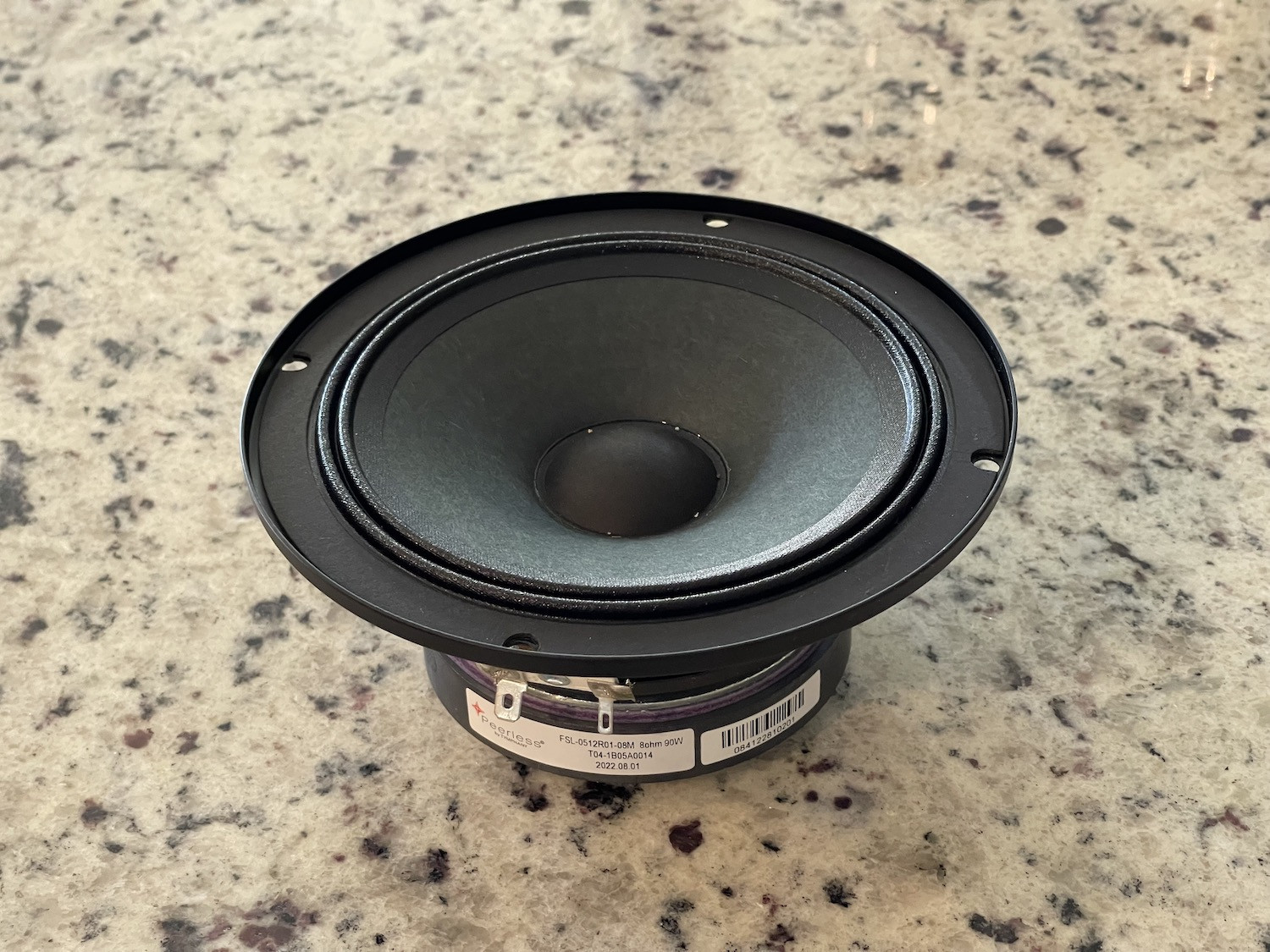

    With the early arrival of drivers ordered, there will be some flexibility about starting measurements for the midrange and woofer....
Name:	FSL Midrange.jpg

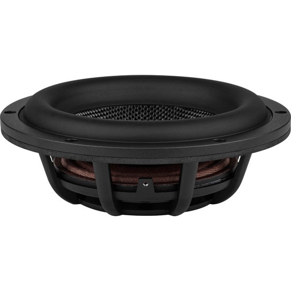

Name:	SBS Woofer.jpg

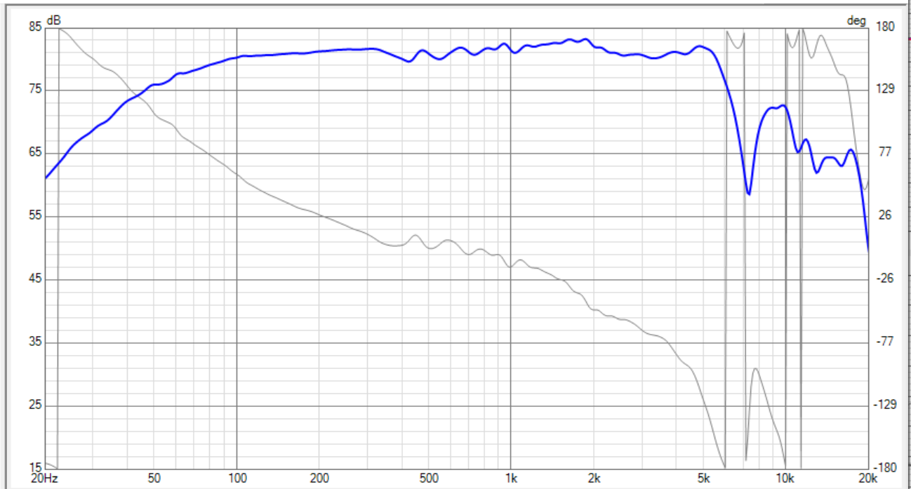

        As I write this measurements of the SBS-160 woofers are in progress.
        This is a basic effort to create a simplified system using these "classic" drivers to ascertain what their native performance without active EQ, cardioid cancellation and efficiency losses might provide... and with possibility of a greatly simplified amplification chain.
        ​​​​​​​One might say that this is a combination of nostalgia and curiosity...

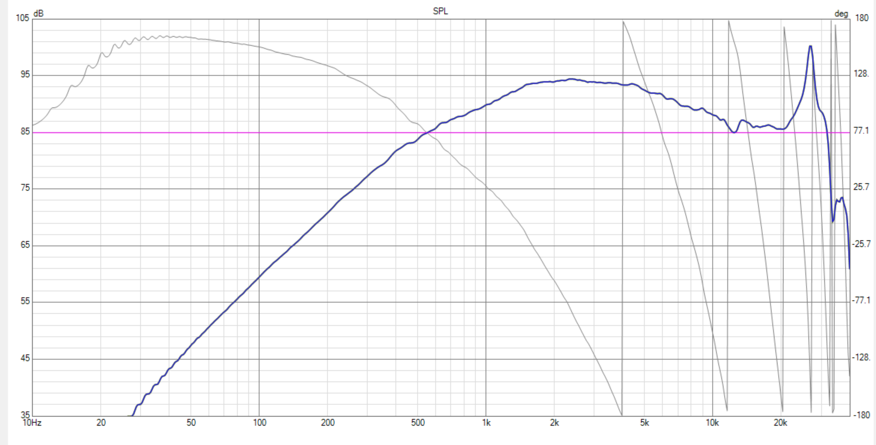

          • 1612

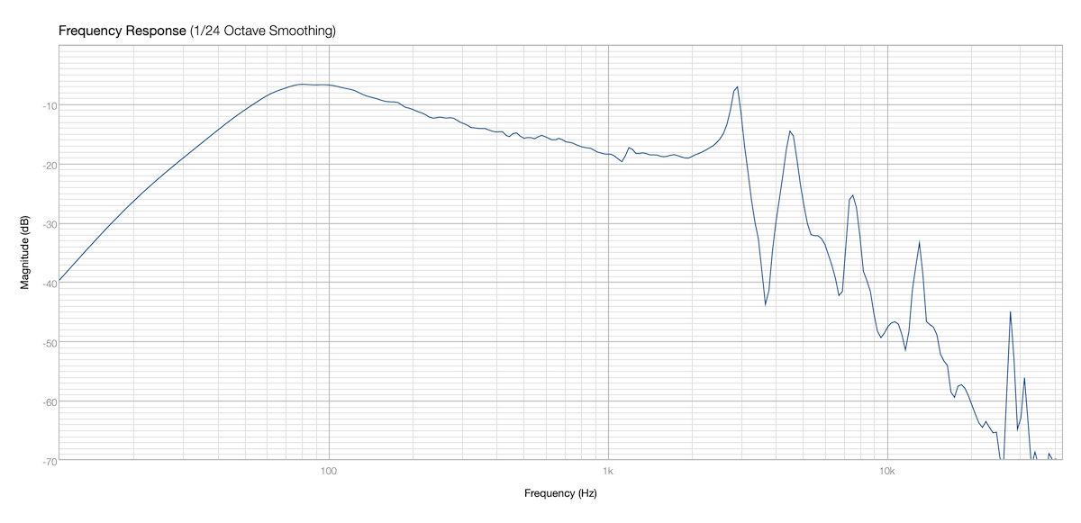

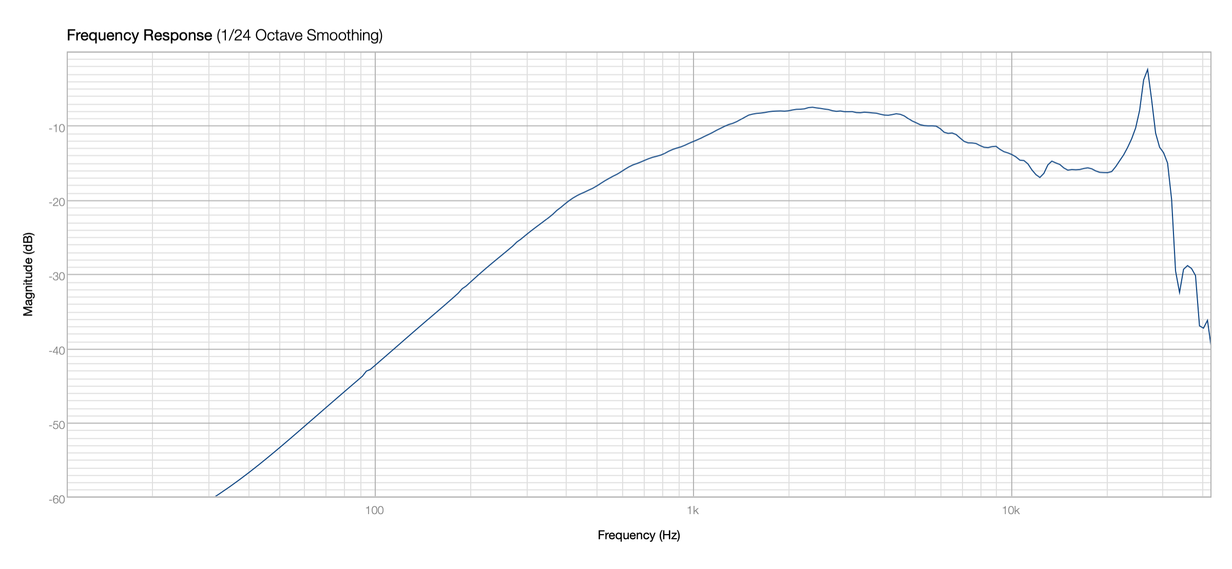

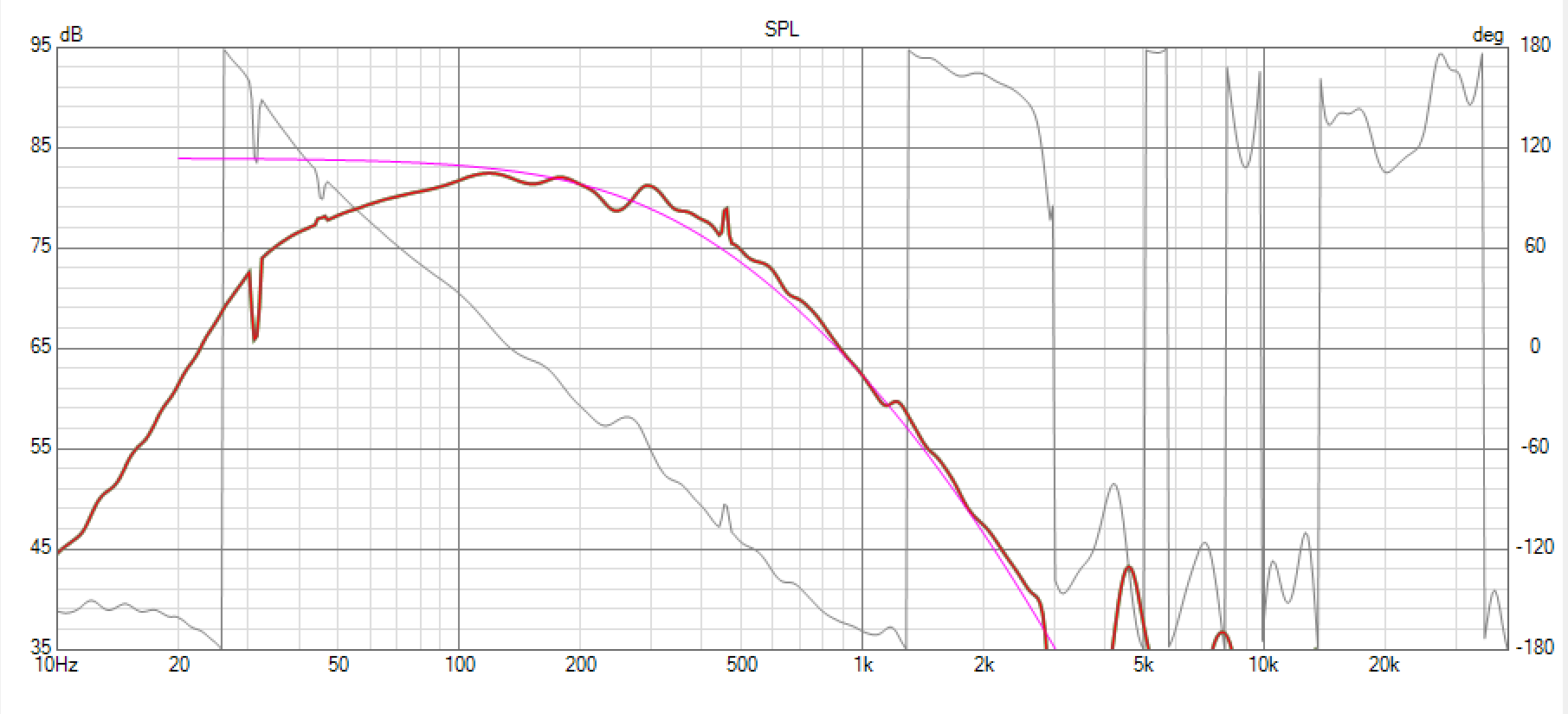

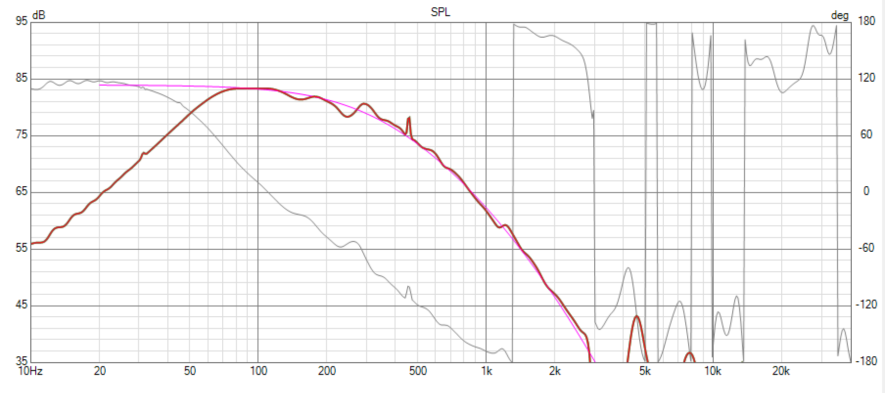

          Basic measurements are complete for the SBS-160F35AL01. Two test conditions were used-
          • A quasi-near field on a large baffle, to simulate the "normal" conditions that should be used in a "factory" measurement
          • A sequence of polar measurements in a small baffle cabinet at normal distances, to evaluate polar response and behavior with baffle step
          There is reasonable correlation for this measurement with the factory data sheet, except that this measurement with very little smoothing (1/24th) is free of a variety of artifacts that may be due to the acoustics of the Peerless test facility. It is perhaps curious and interesting that the net response curve and bump occurring above the Fs and Fb in the response bears a passing resemblance to the STW-350 - perhaps there is a common designer or design philosophy.
          As mounted this way, the response would not be suitable for a typical three way or the proposed Duelund alignment, due to excessive early fall off above 100Hz.
          For a "practical" application one must turn to a representative cabinet baffle dimension with measurements at 2M-

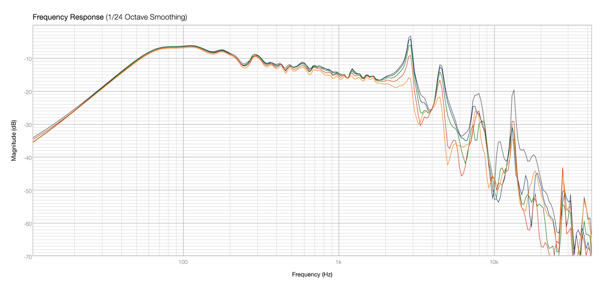

Name:	SBS-160 Polar 2M.png
          Two issues of note:
          • the response profile above 100Hz is modified due to the baffle step, and has an initial roll of slope which can fit to the proposed crossover configuration
          • With the fairly stiff (3kHz breakup) concave cone, the response tracking from 0 to 40 degrees shows nearly no divergence out to almost 2kHz, which is most satisfactory for the planned three way configuration.
          So far, the proposed configuration seems feasible.

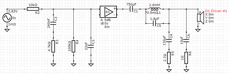

                  Several concepts for the LF configuration have been under consideration and evaluation...
                  The most promising to date would give cause for titling this project as the Modula Xtreme MkII...
                  This combines the input tuning capacitor with the passive LF EQ implemented in the same manner as Jonmarsh's voicing filter, passively between preamp and power amplifier, and the first pass does a fairly competent approach to the Duelund LF target, with good bass extension to about 30Hz... a more conservative and realistic value than the Kii Three for 4 6-1/2" drivers. Not using two of them for cardioid shaping helps matters to an additional degree.

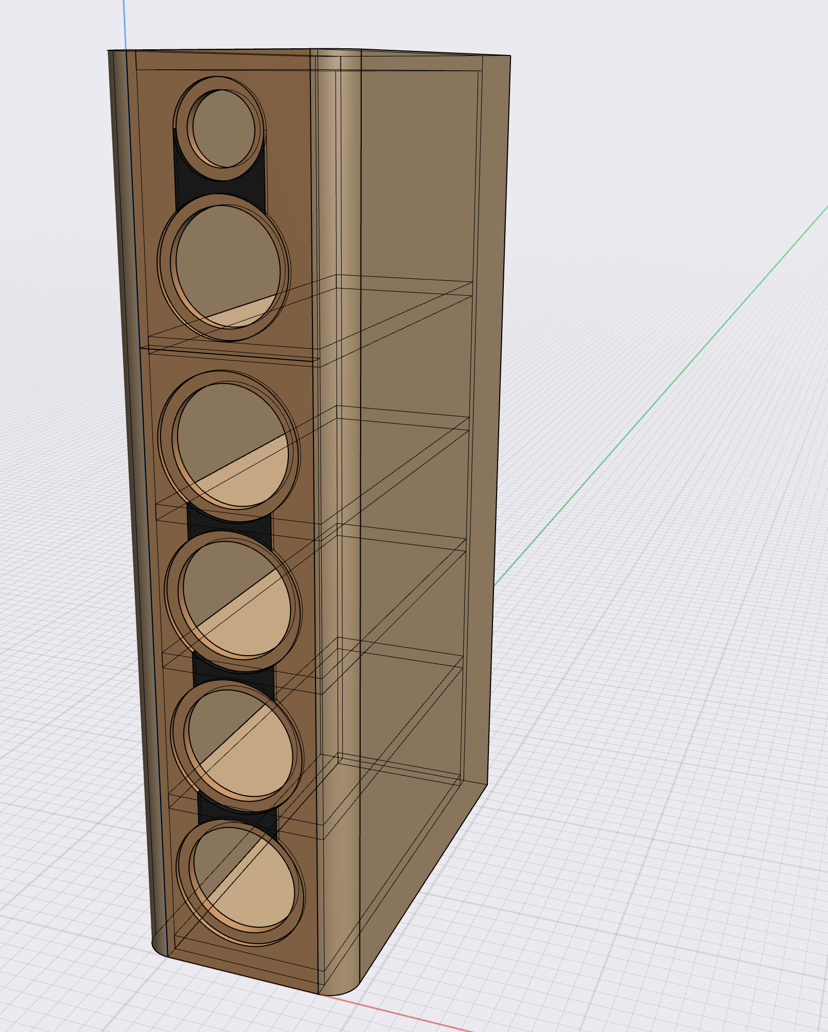

                    • 1612

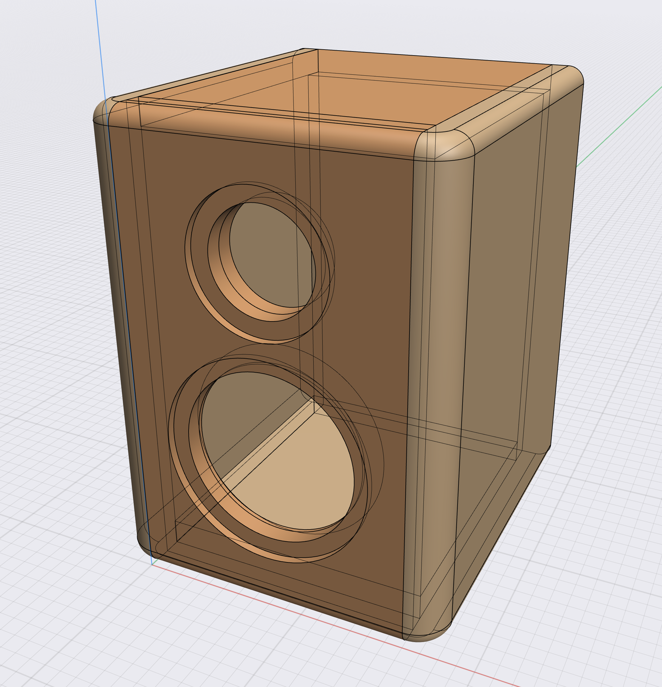

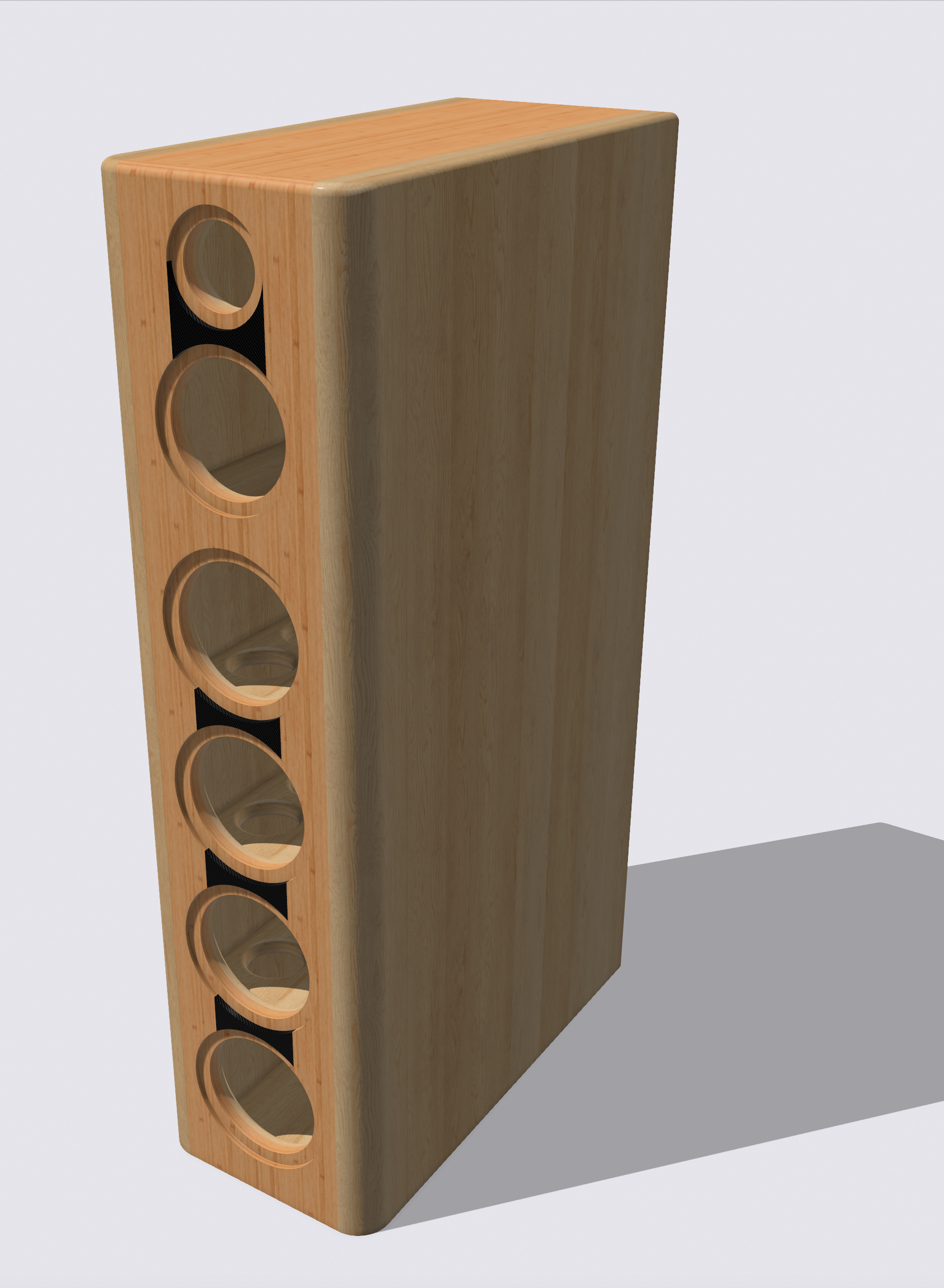

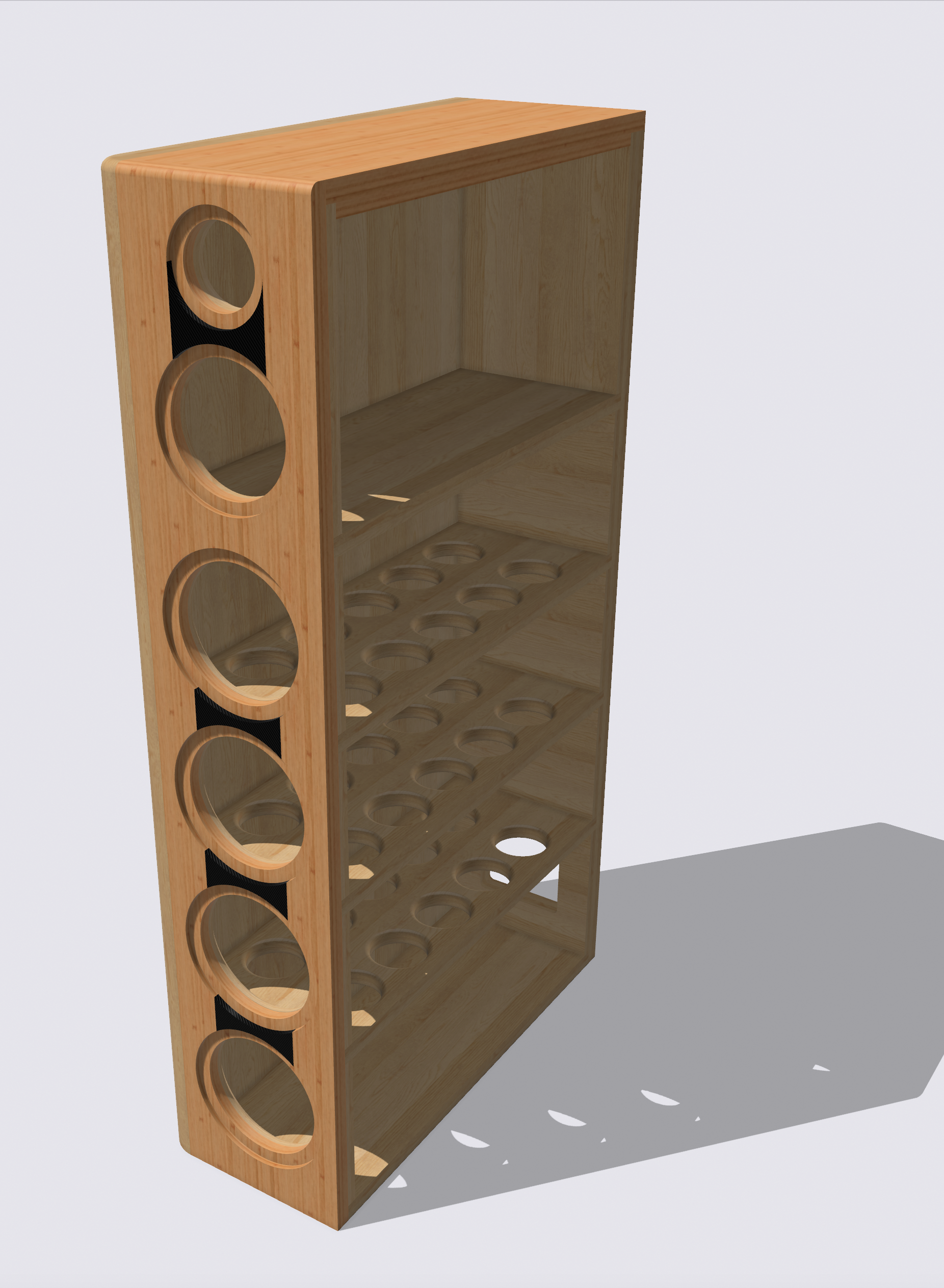

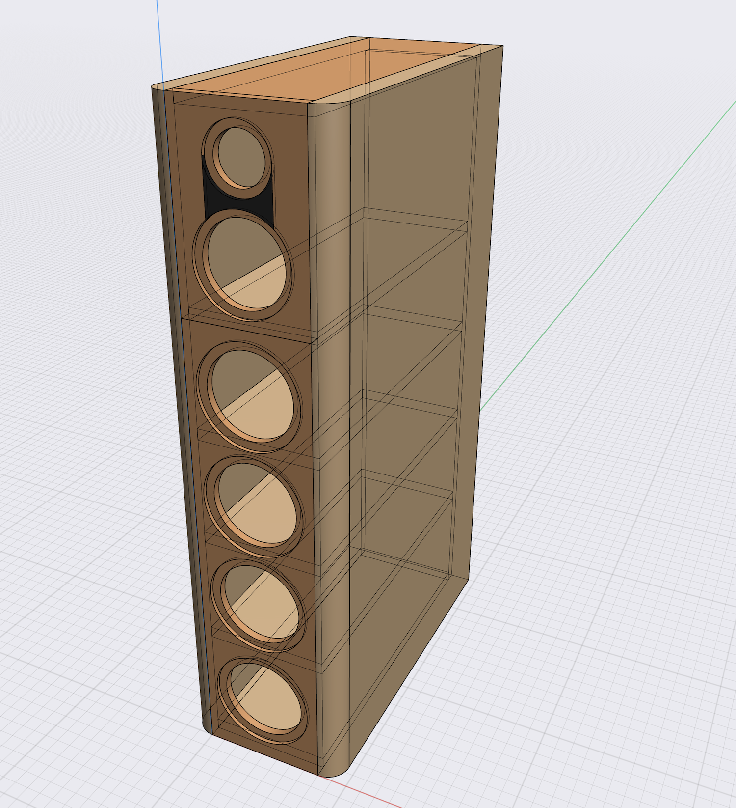

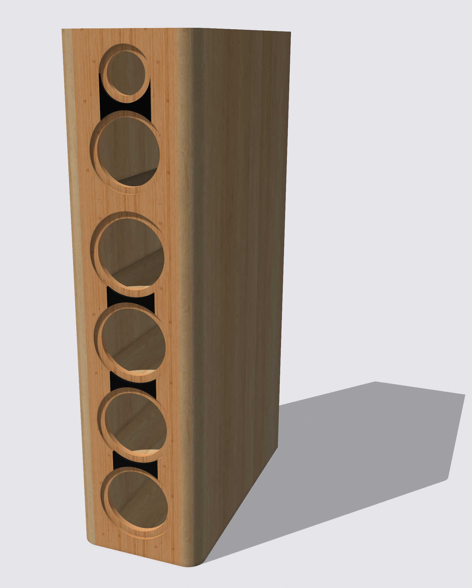

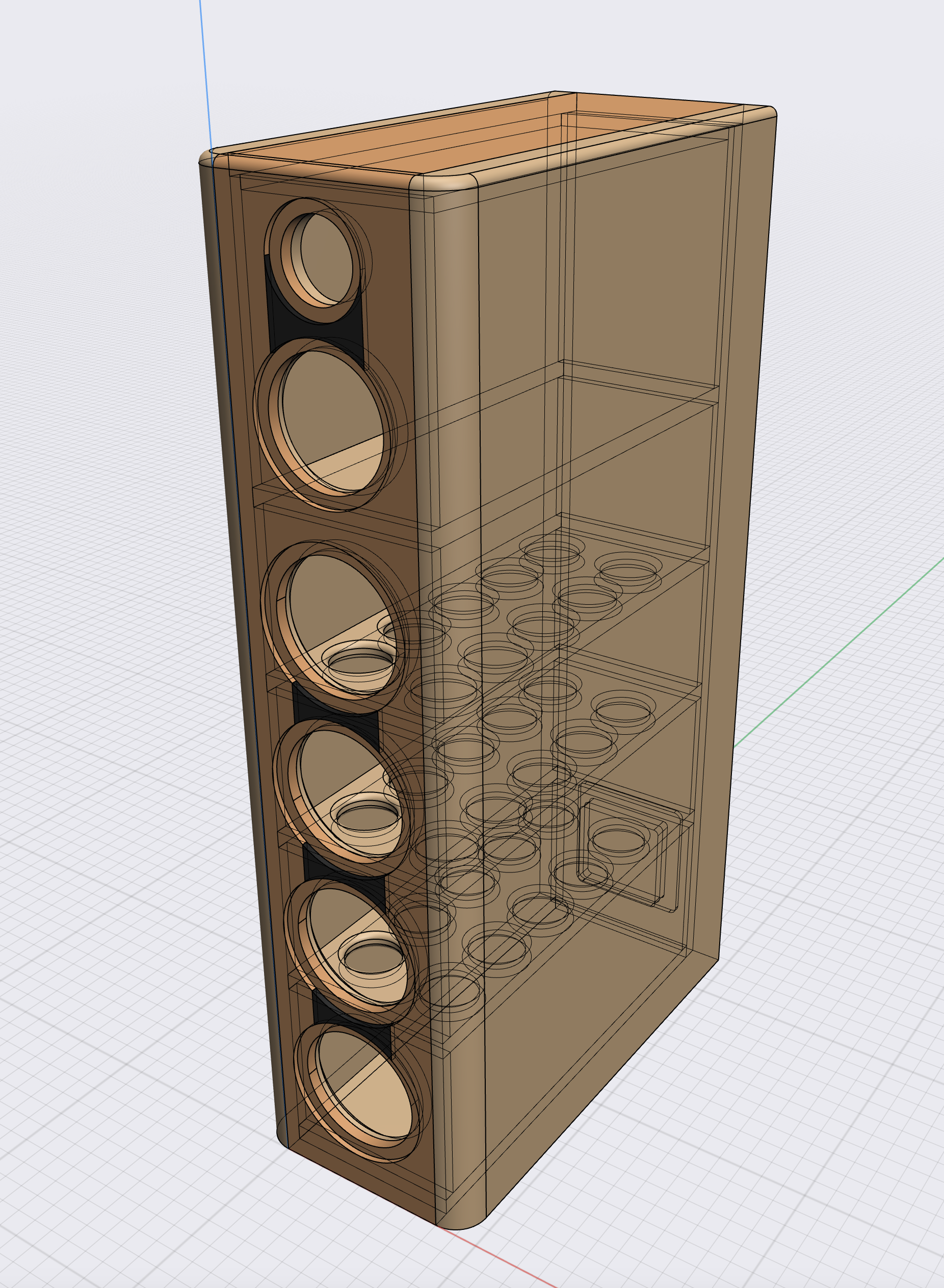

                    It is intuitively clear that for a given LF performance to be modeled, a concomitant enclosure design must be specified first- or have been conceived in the mind of the designer. That has been the case, and these images will convey the fundamentals of the current concept design...

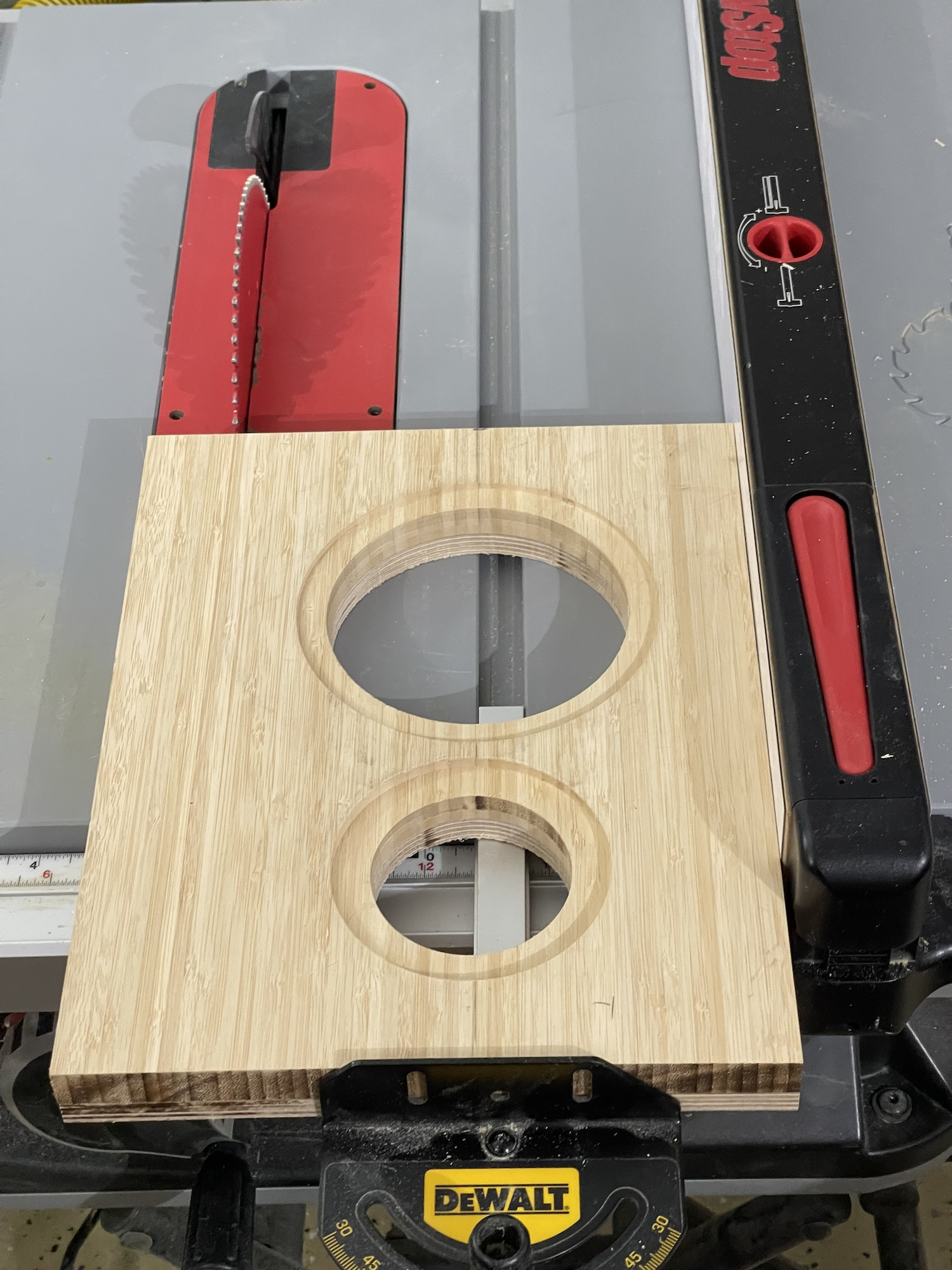

                    Click image for larger version  Name:	Hidden Line CAD.png Views:	0 Size:	1.88 MB ID:	949114
                    Click image for larger version  Name:	Render V2 Kii.png Views:	0 Size:	2.21 MB ID:	949115
                    Material choices are relatively basic and focused on the concept of being a "value build", relatively speaking.
                    • Front and top panels are planned as 3/4" caramelized bamboo ply- materials ordered.
                    • Side walls are double 3/4" baltic birch ply- on hand in the Imperial storage
                    • Internal baffles are 3/4" baltic birch ply, pass through holes not yet implemented
                    • The inlay is black acetal copolymer, from Imperial stocks- Black is back.
                    • Bamboo panels are 8" wide, overall cabinet width is 11", not including a planned stand. Height of the main cabinet is 42", not including a planned stand.
                    Last edited by Evil Twin; 10 September 2023, 11:05 Sunday. Reason: correcting dimensions

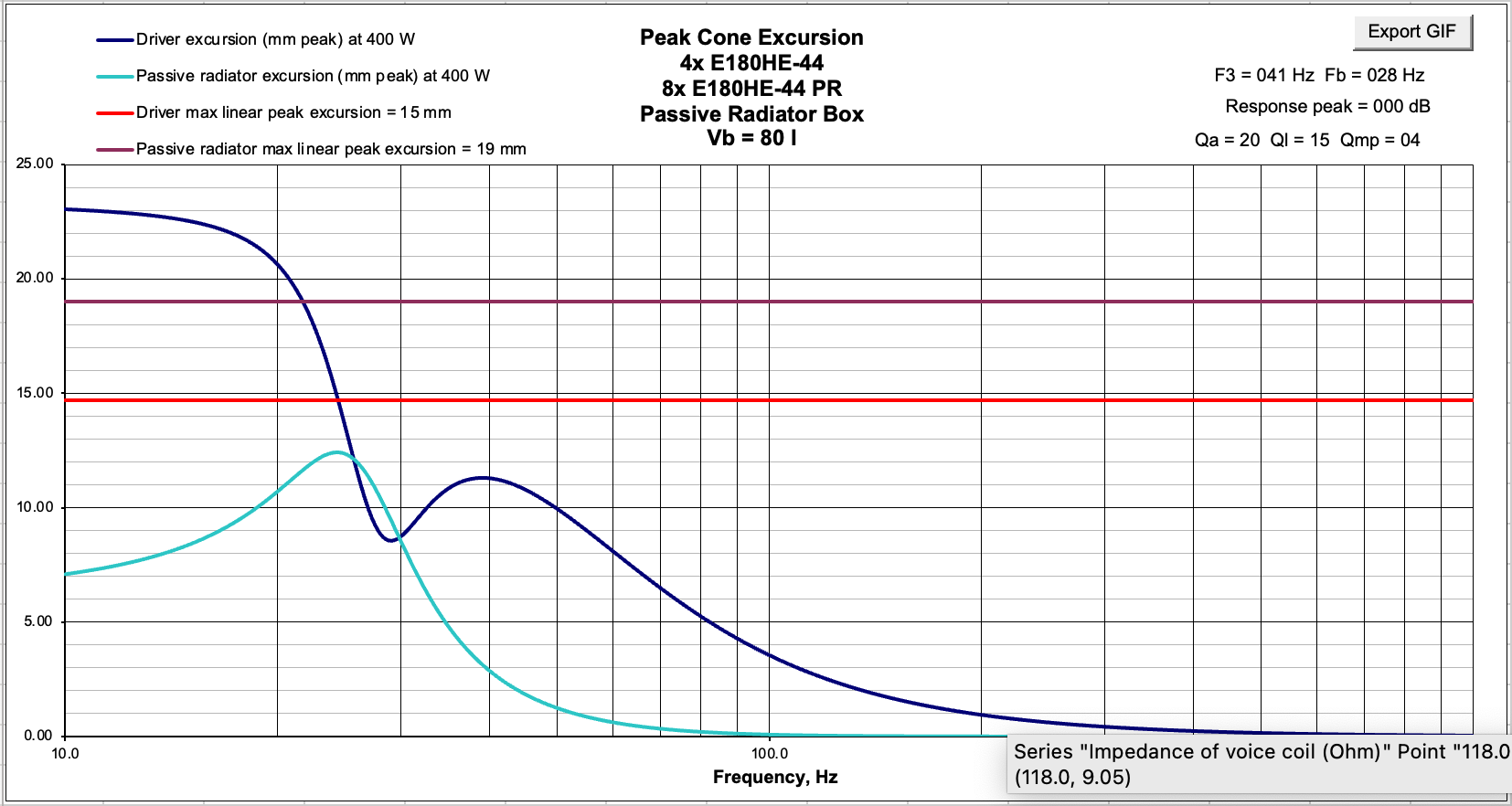

                      Incidentally, LF analysis with Unibox 4.08 indicates a single cabinet LF capability of 102 dB @ 30Hz, and 108 dB at 40Hz.

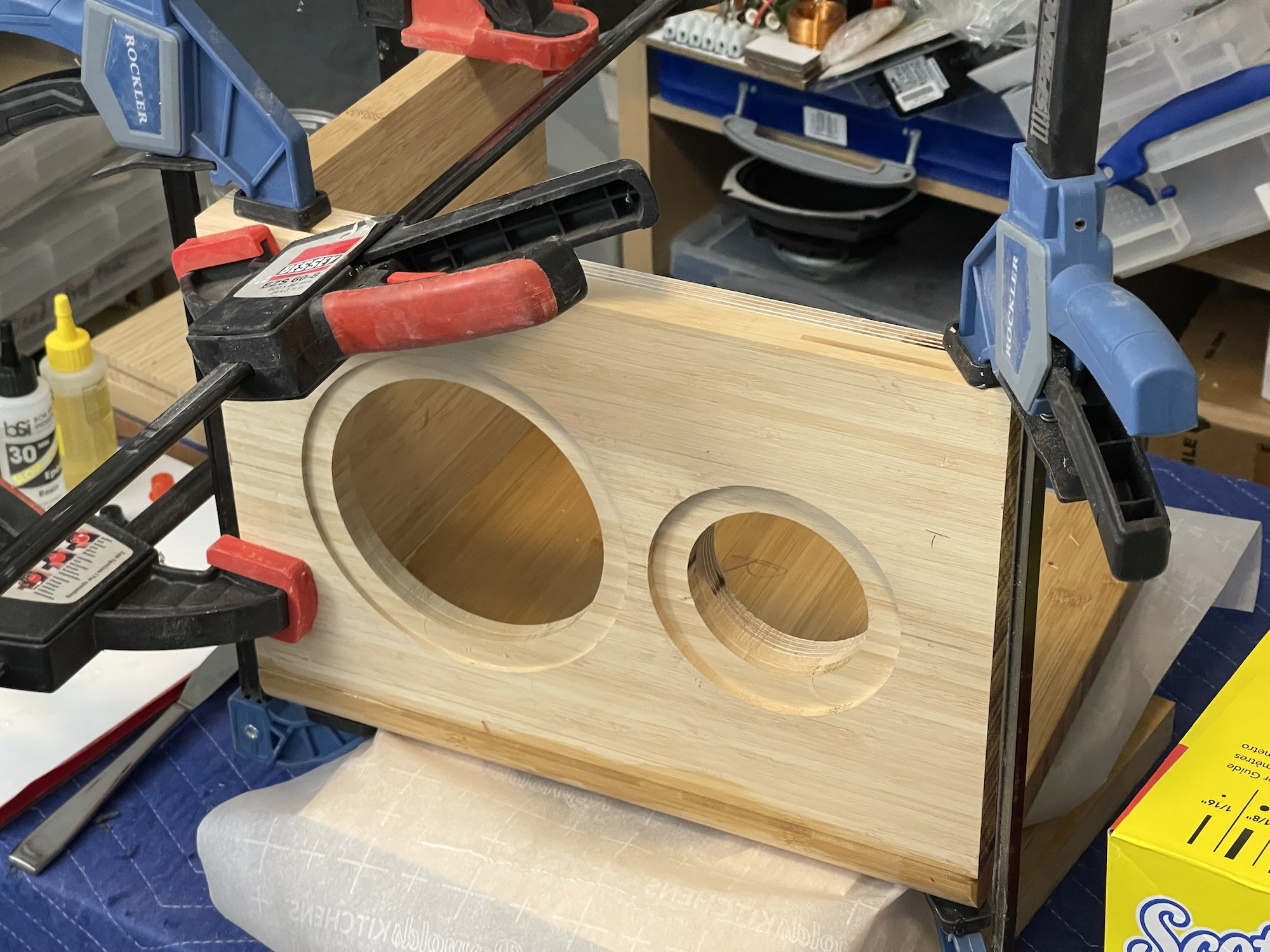

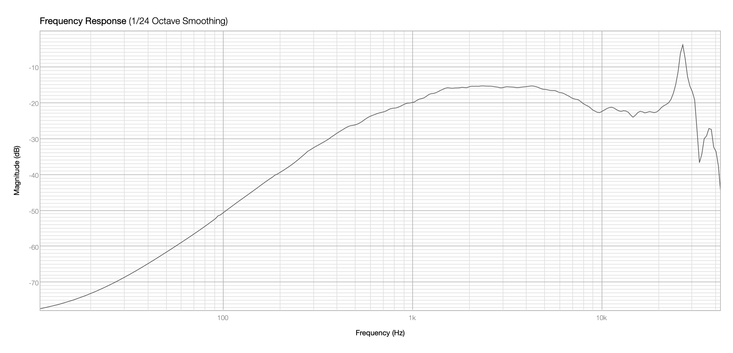

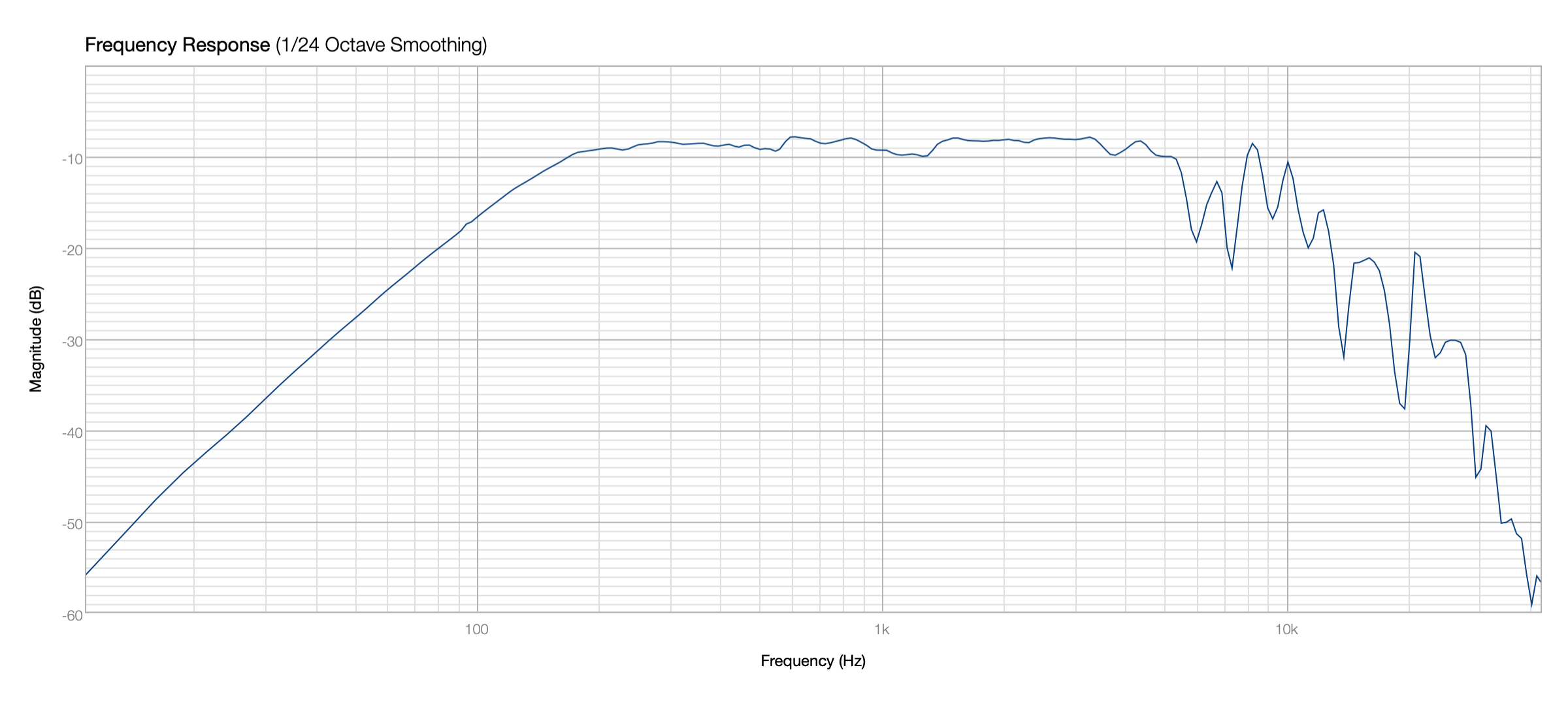

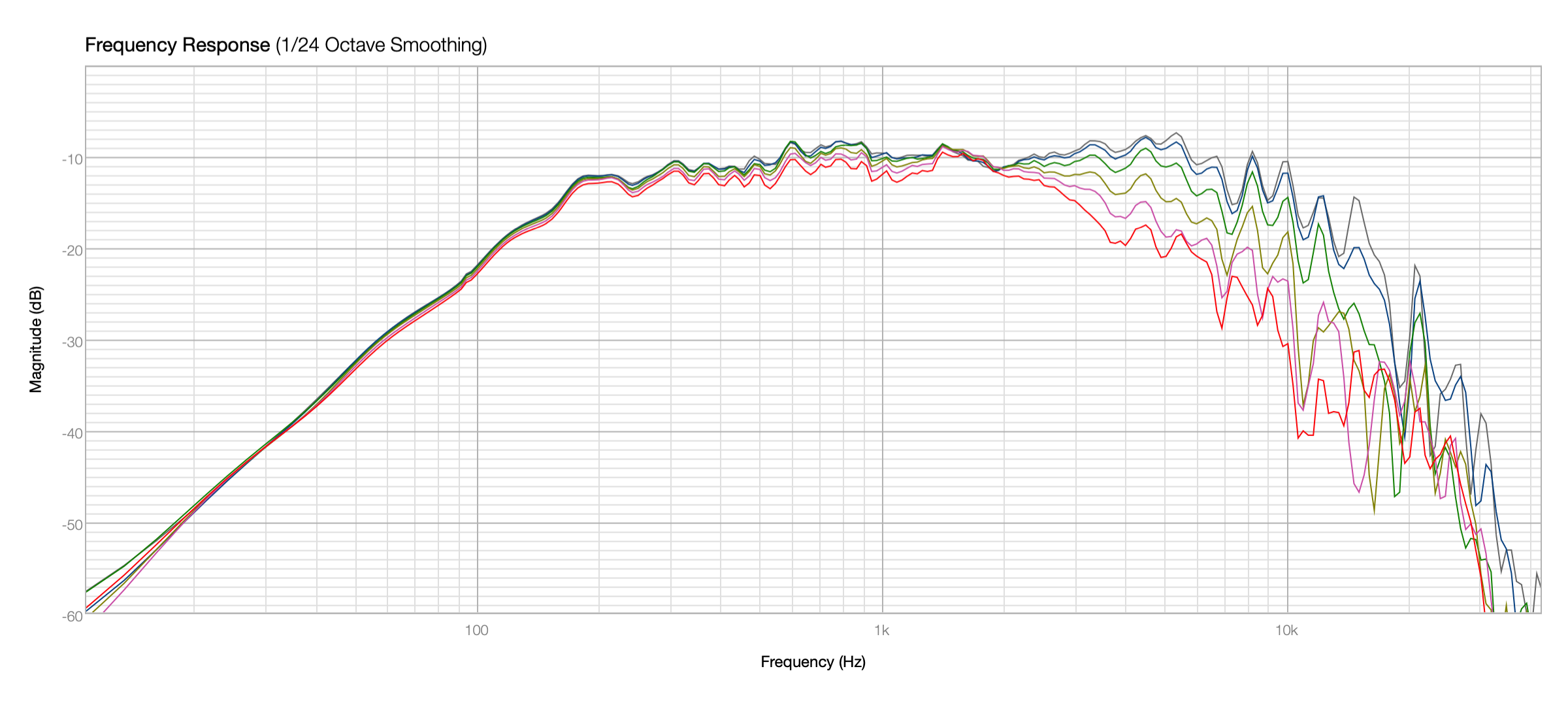

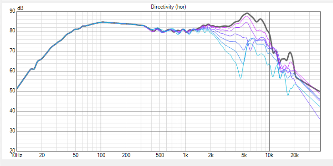

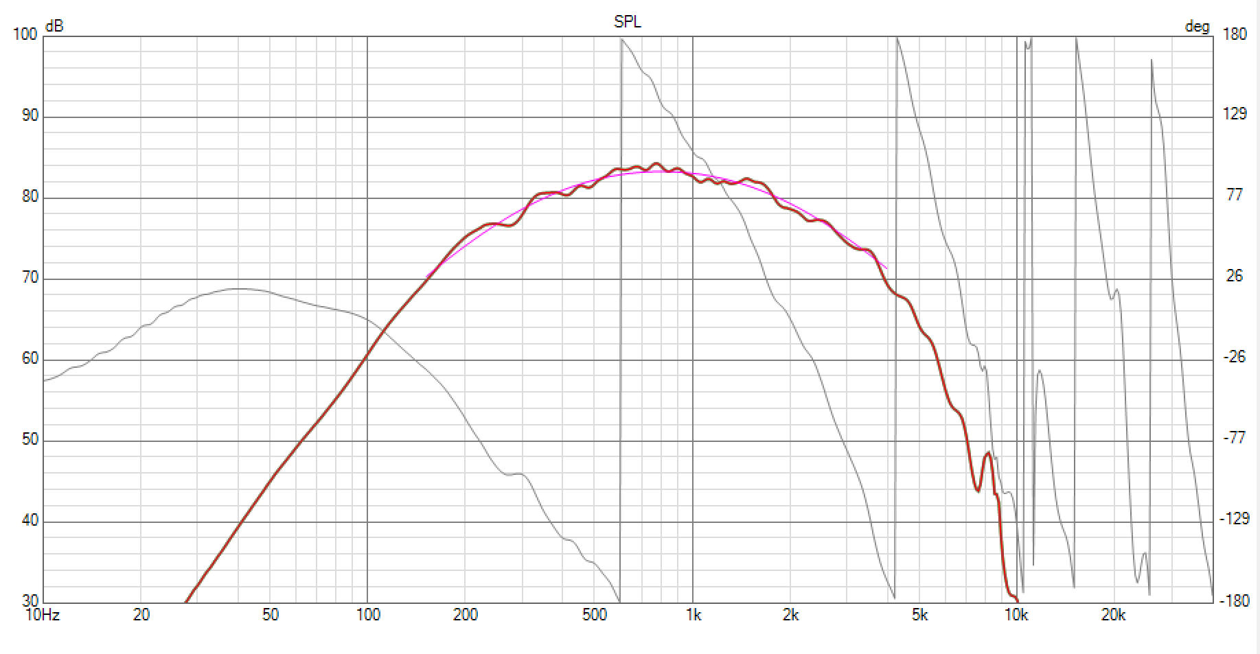

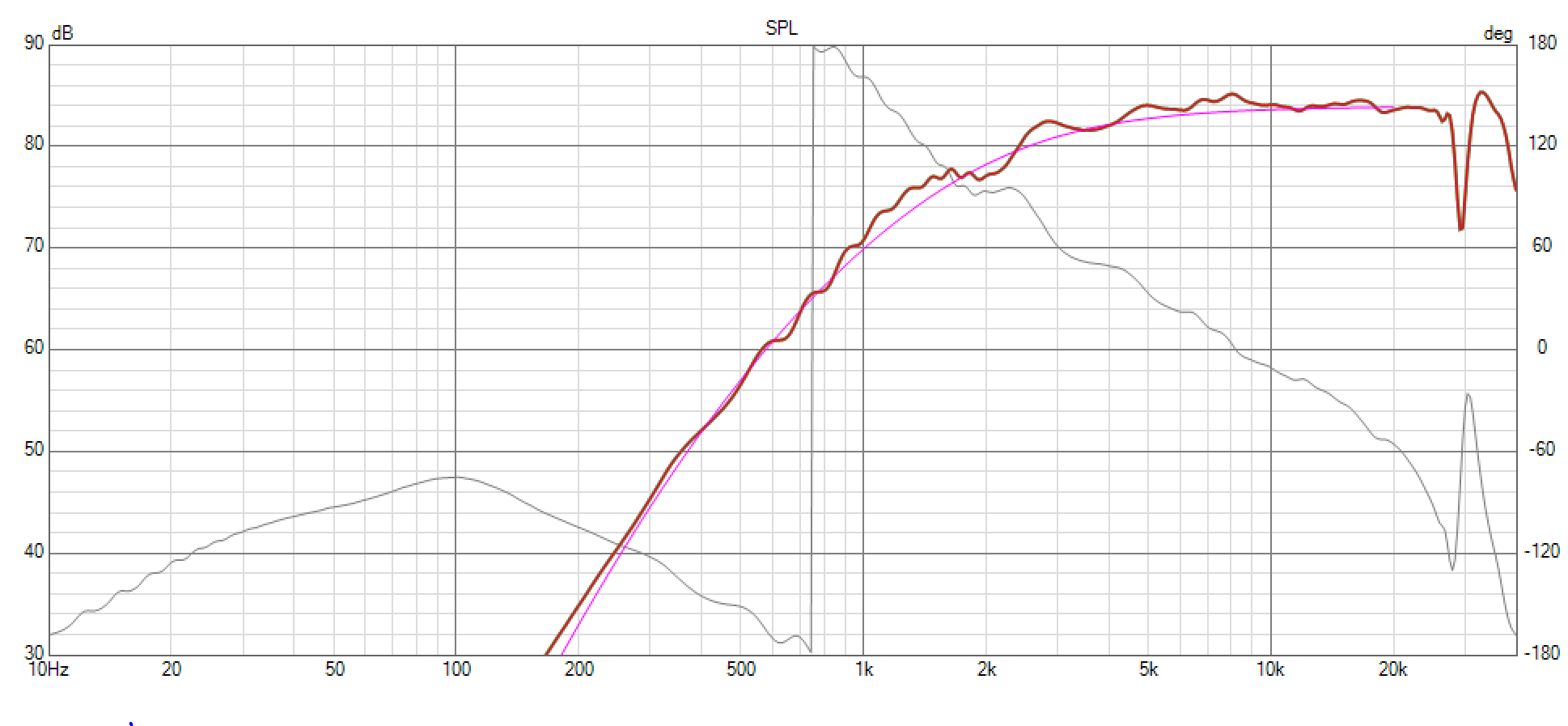

                        A midrange test enclosure for data capture has been assembled, driver mounted, and data collected for the Peerless FSL-0512R01-08. The results seem quite satisfactory, and in some regards more encouraging than the factory data sheet.
                        Quasi near field on axis, captured to obtain data which should correlate with large test baffle results in a basically anechoic environment:
                        And a polar set on 10 degree increments at 2m...
Name:	FSL-0512 Polar 0 - 50 Deg.png
                        As one would expect from a cone of this size, off axis behavior is consistent and tracks well up to 2kHz, then deviates progressively about that point with the measurement angle. The test enclosure has a width of 11" with 1/2" round overs.
                        This data is sufficient for crossover concept development, but measurements will be required in the target enclosure design before calculating component values to order.

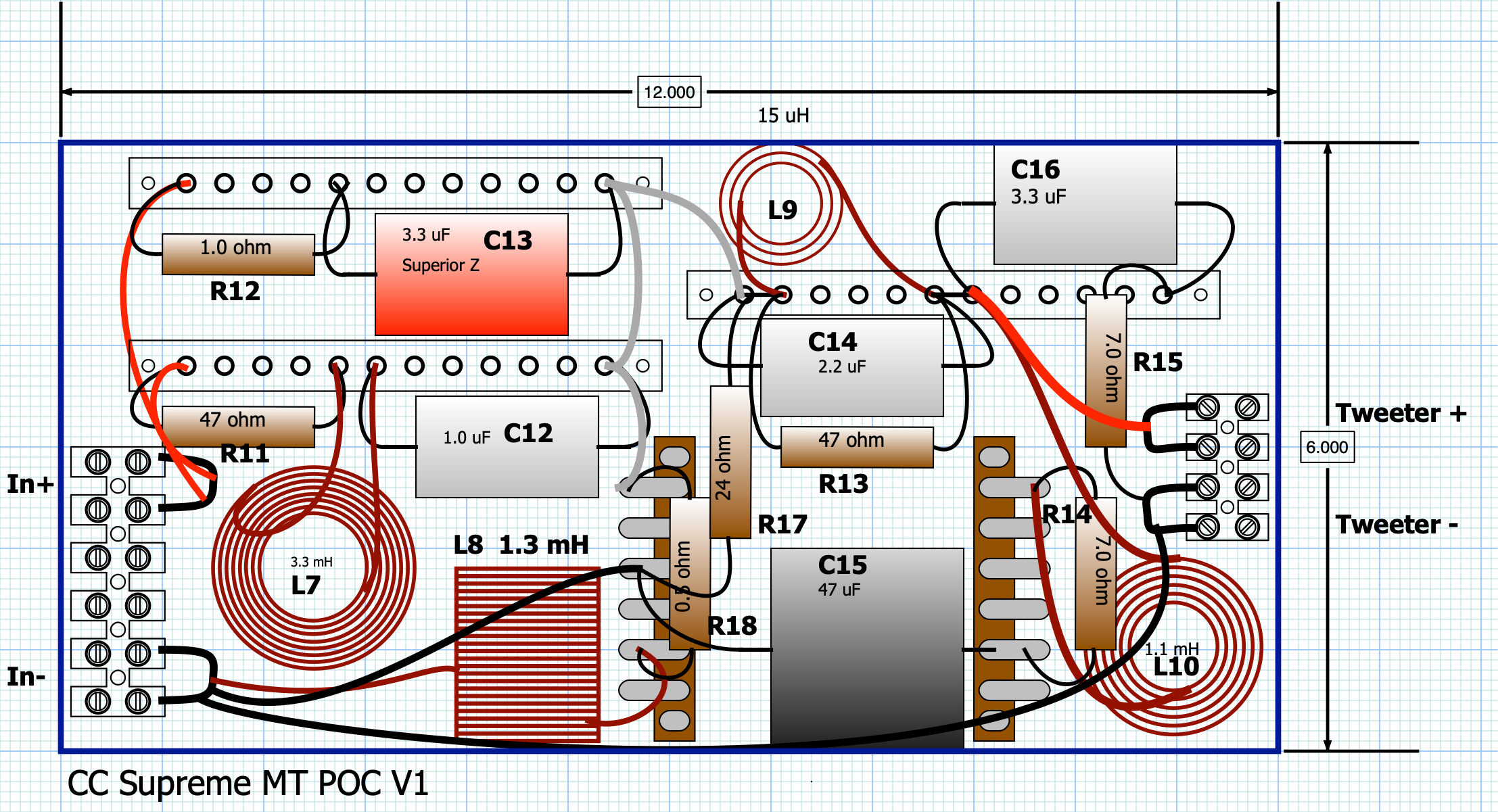

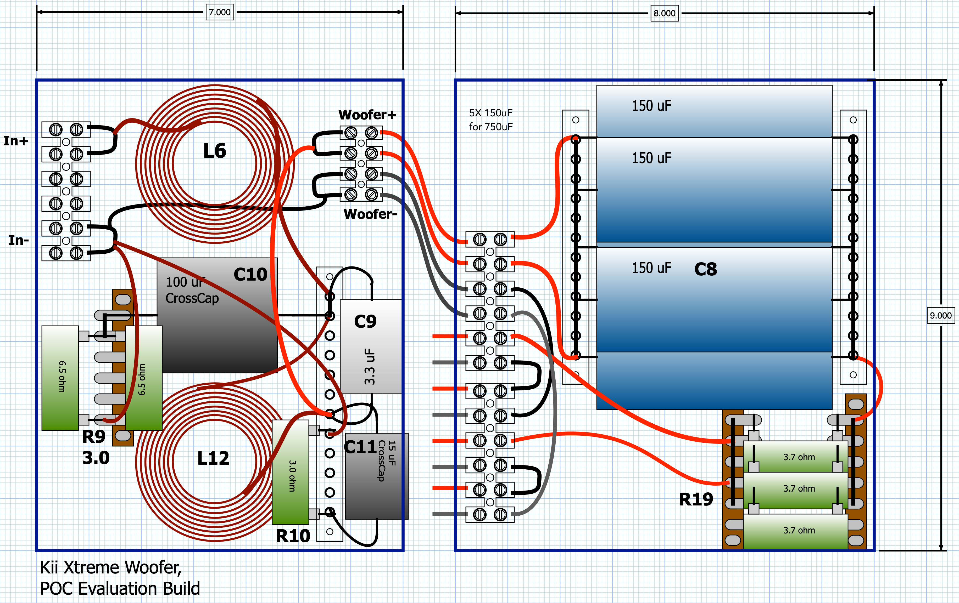

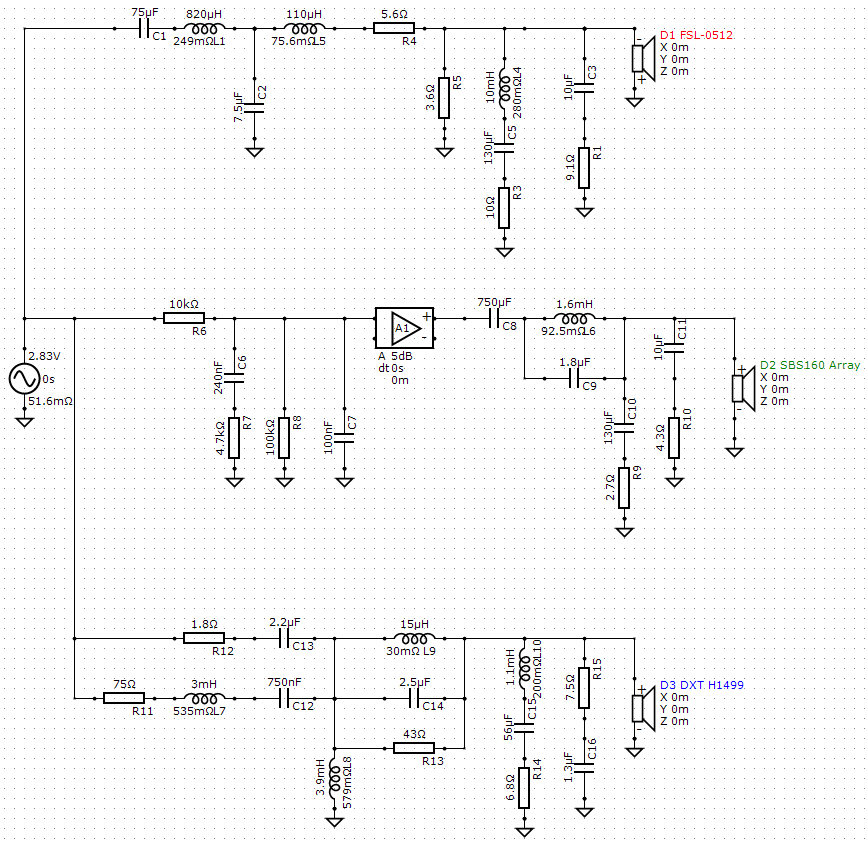

                          A basic Proof Of Concept crossover has been formulated using the data measured from test cabinets. The results are within the range of initial expectations, and based on that, proceeding with a project build has been approved by the Chancellor.
Name:	Kii Duelund LF MF HF POC XO-schema-1.png
                          This is NOT a final design schematic, merely a POC demonstration.

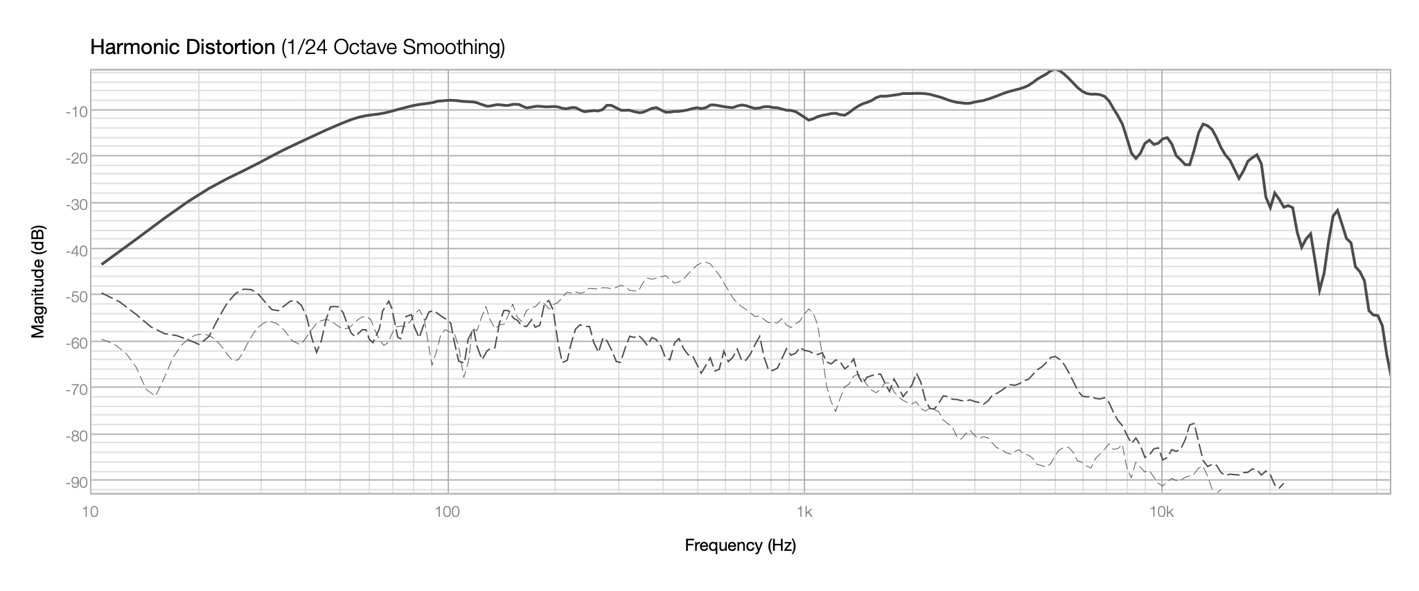

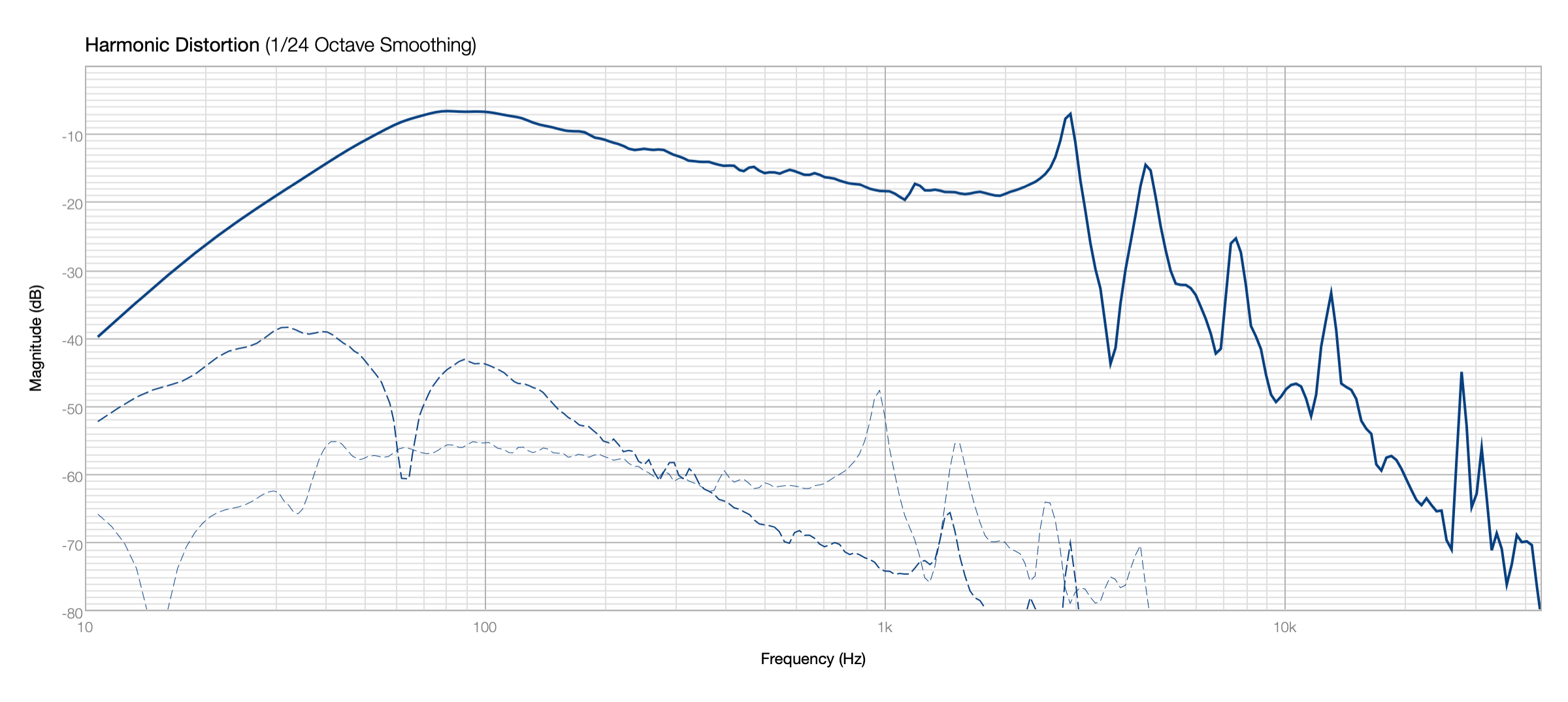

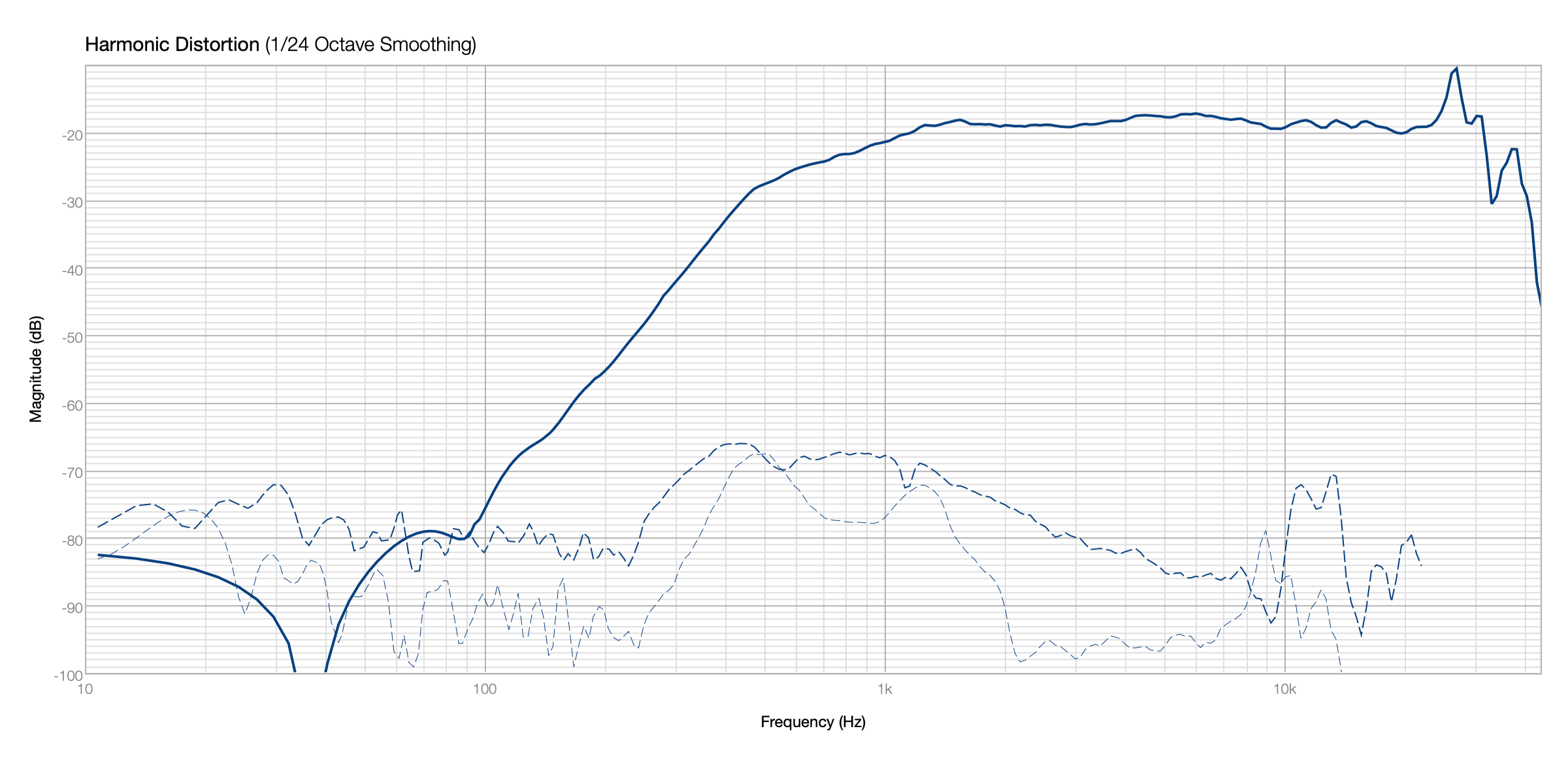

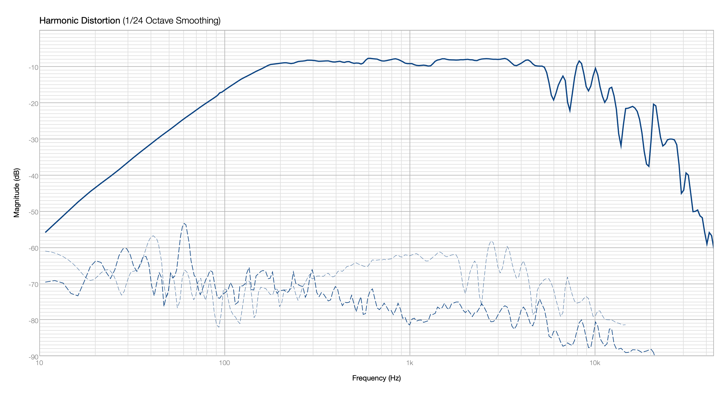

                            What's the harmonic distortion performance like? Say 94dB @1m? Surely 86 would be a cakewalk...
                              • 1612
                              Individually the drivers look quite reasonable- but at "normal" test levels. But for example, keep in mind, the midrange driver delivers 92 dB with 2.83VRMS. In consideration of that, having HD3 in the -65 to -70 dB range at that SPL over it's operational range is most satisfactory for a "value" build. The DXT sensitivity is in a roughly similar range, but optimizing HD3 and HD2 requires a crossover in place to suppress resonance amplification. Even without that factor being implemented, HD3 has been measured for the raw driver in the -75 dB range between 2500 Hz and 8,000Hz. That should extend much higher with the planned crossover configuration.
                              The true measure will be with an assembled system and full crossovers.

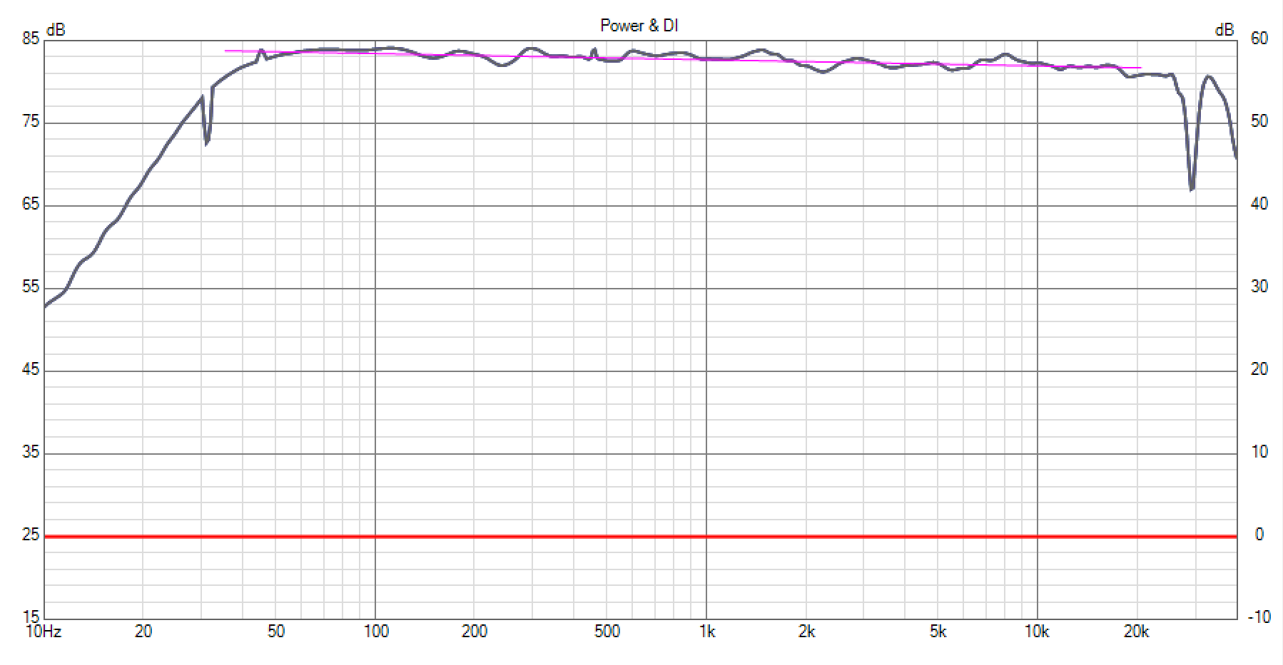

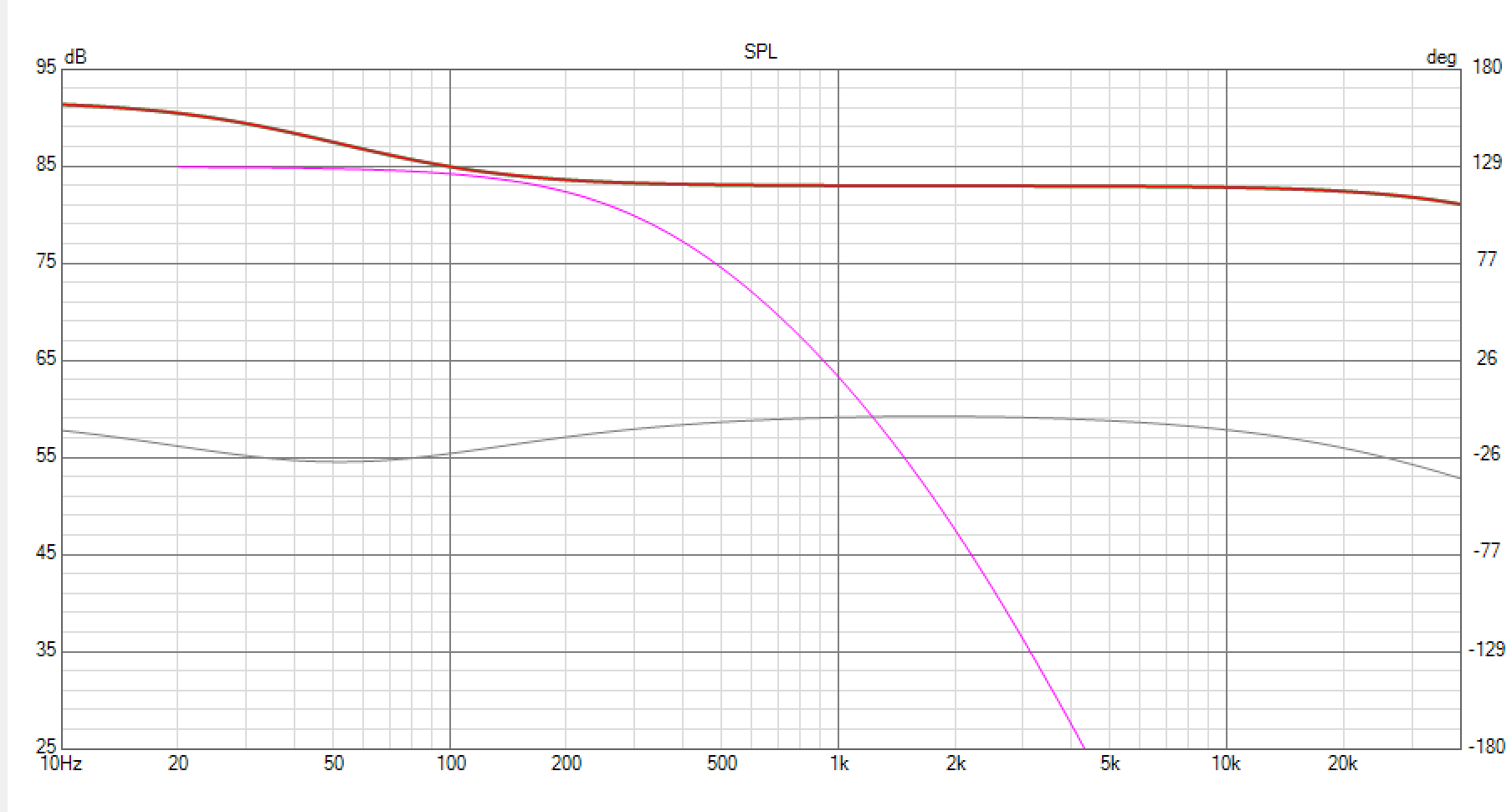

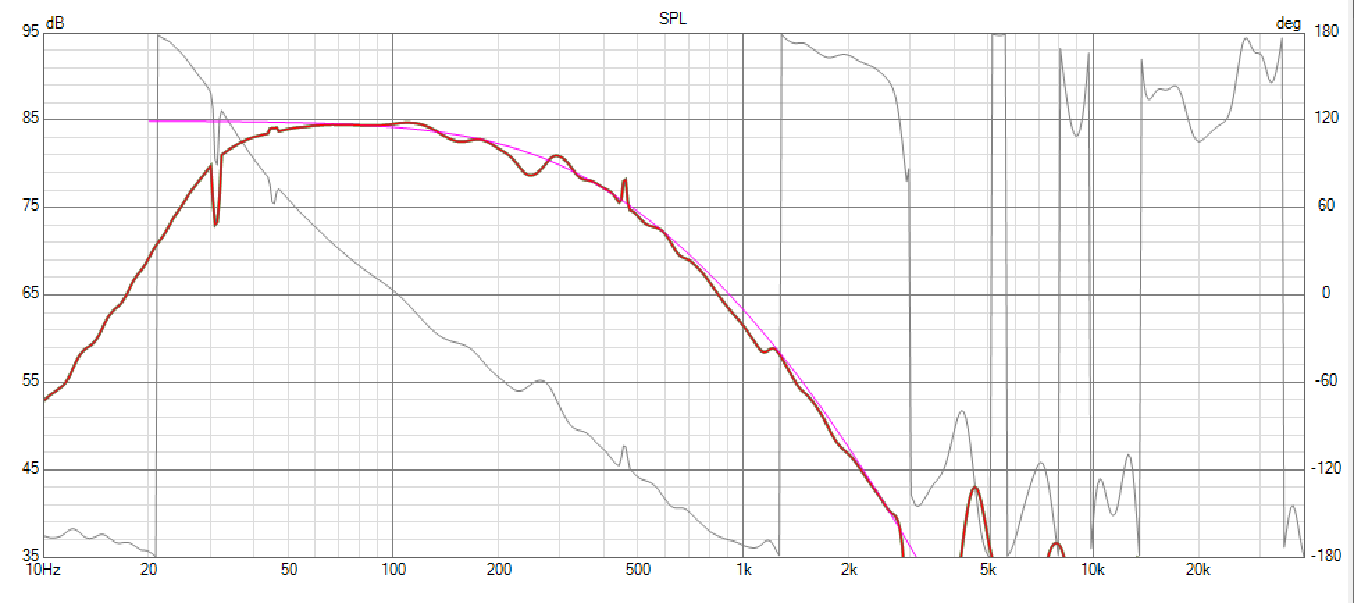

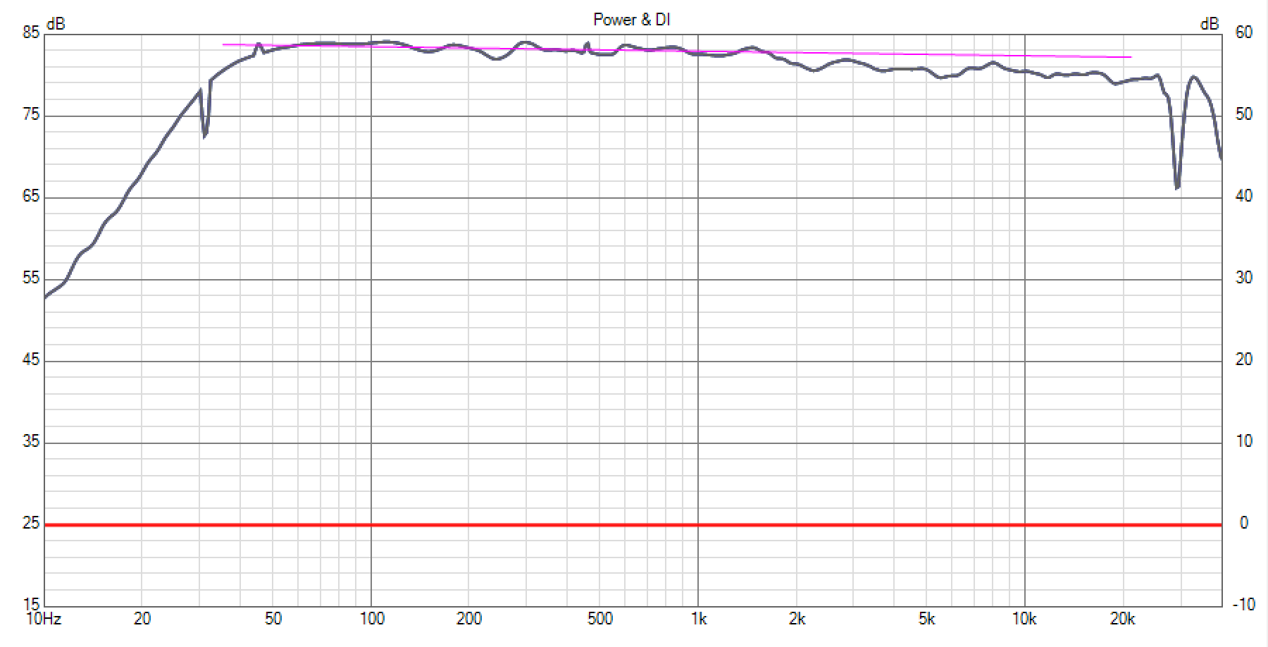

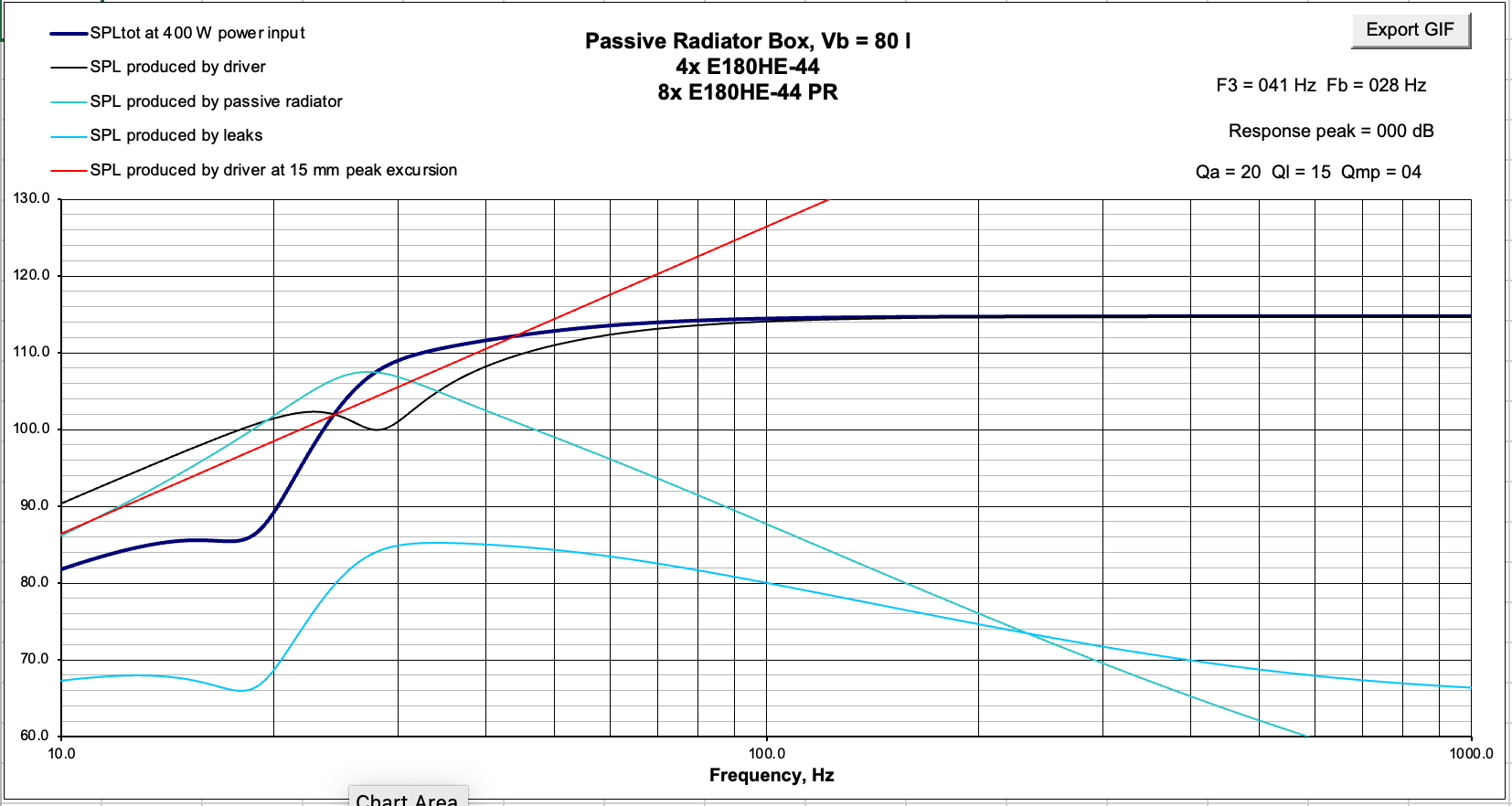

                                  A few have asked about the methodology for achieving the low frequency system response... and how the woofers look in "native mode".
                                  In the target cabinet volume of 70L, which is not small for 4 low sensitivity long throw 6.5" woofers, the basic response curve is as shown above with measurements, and if the Duelund target crossover is included, the result is as one would expect...
Name:	Modula Xtreme MkII LF Basic No EQ no Cap POC XO-SPL-1.png
                                  What is very clear is the relatively high Q 2nd order roll off, caused by the low compliance suspension and relatively low cone mass, and due to system Q, response that is already down about 4dB at the Fb. This is not a system response which would be amenable to a simple first order voicing filter approach, and is why the reflexive mode of the majority of designers might be to reach for a DSP crossover.
                                  A series LF capacitor or an LCR network can be used to modify the low frequency profile, and is useful with drivers within certain parameter ranges, such as employed with the ScanSpeak 10" woofers in the original Modula Xtreme. Adjusting the range of value can produce considerable variation in the resulting basic response curve.
                                  In this case, a value was chosen to enable achieving the desired system response with a simple 5 dB first order filter.
                                  ​​​​​​​Here is the response with the series cap, but without the passive LF EQ filter (that would be inserted between preamp and power amplifier).
Name:	Modula Xtreme MkII LF Basic No EQ POC XO-SPL-1.png
                                  Now one can begin to see how the available "simple" LF "equalization" can adjust the total system response.
Name:	Modula Xtreme MkII LF POC XO-SPL-1.png

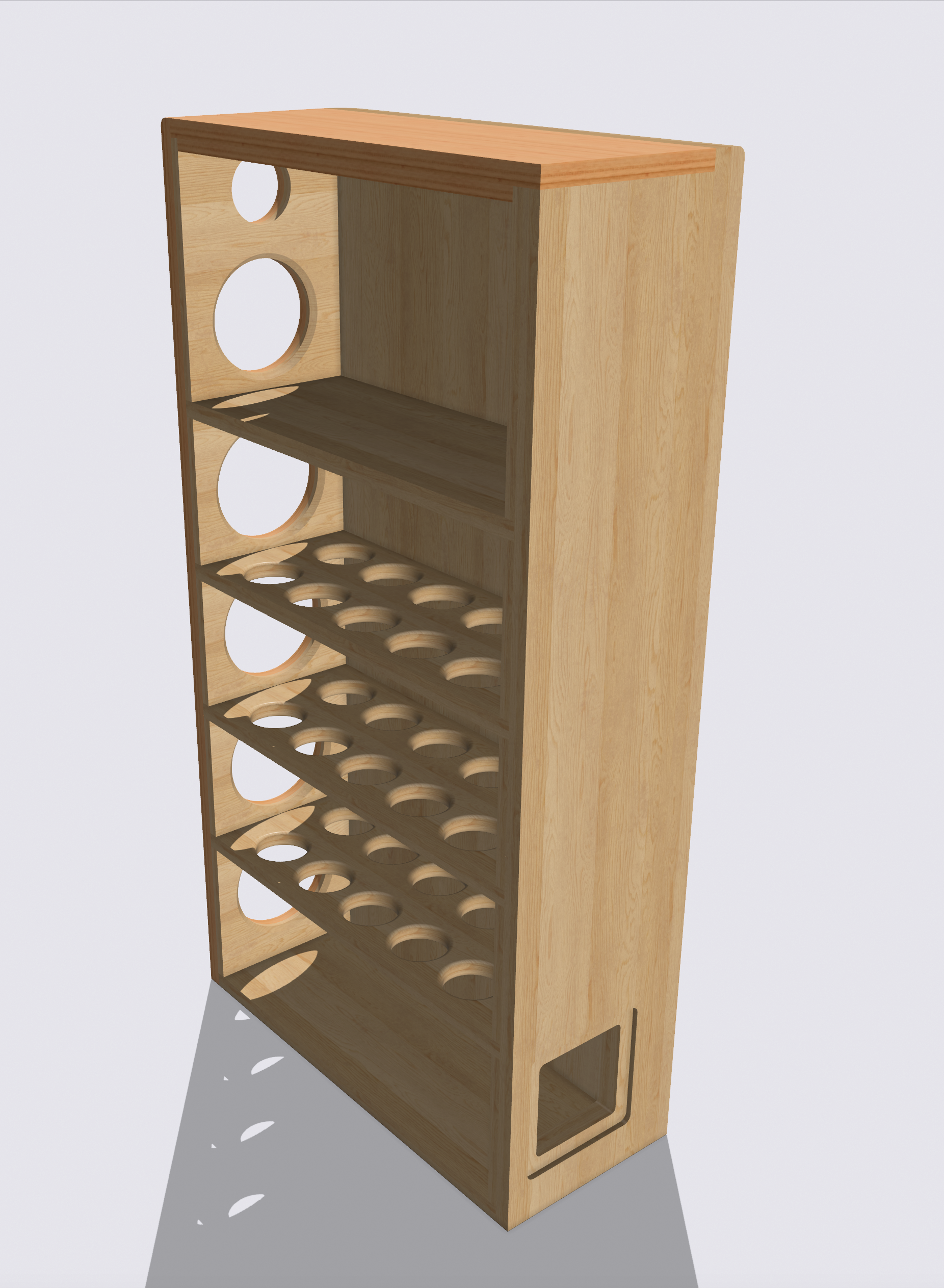

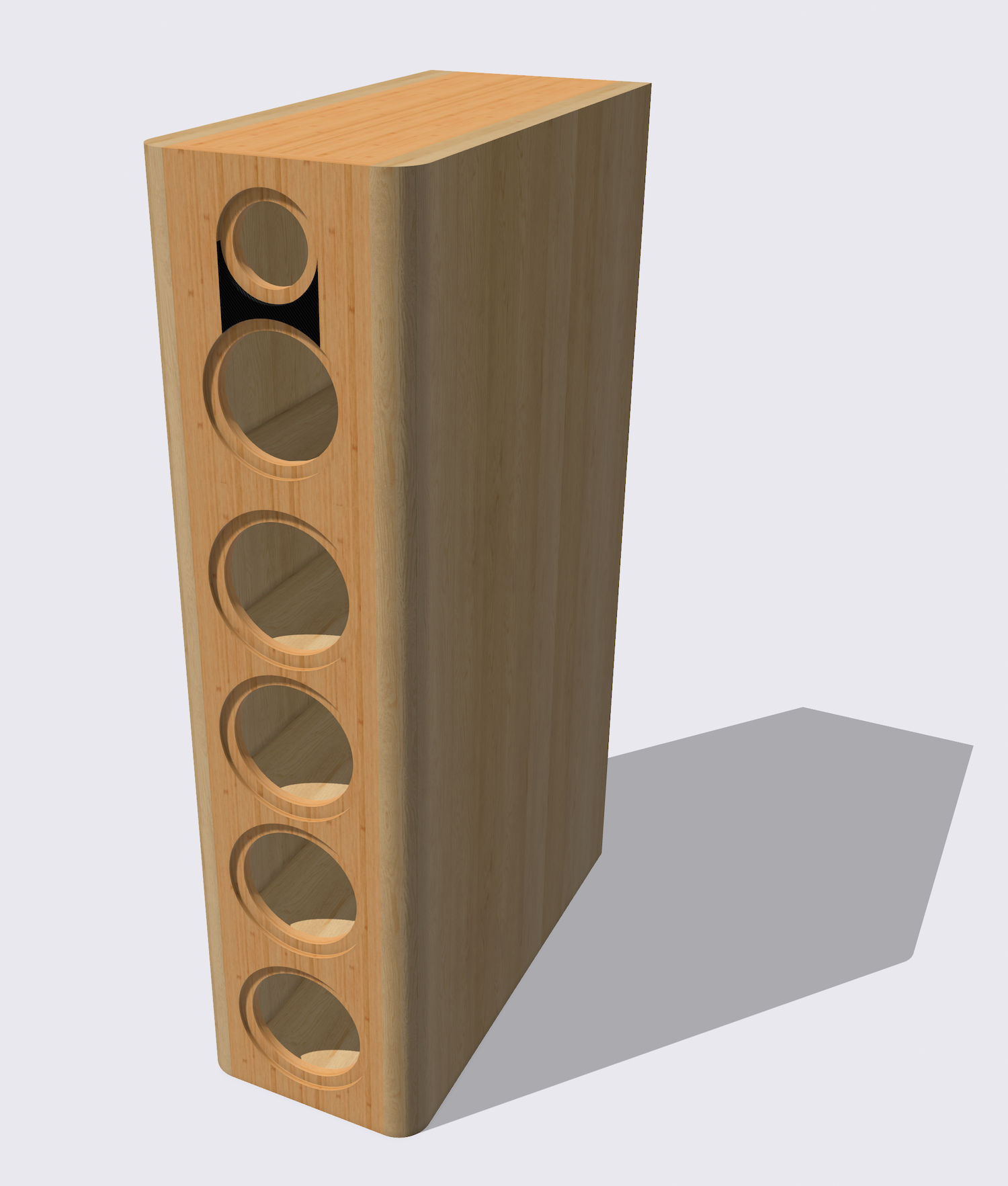

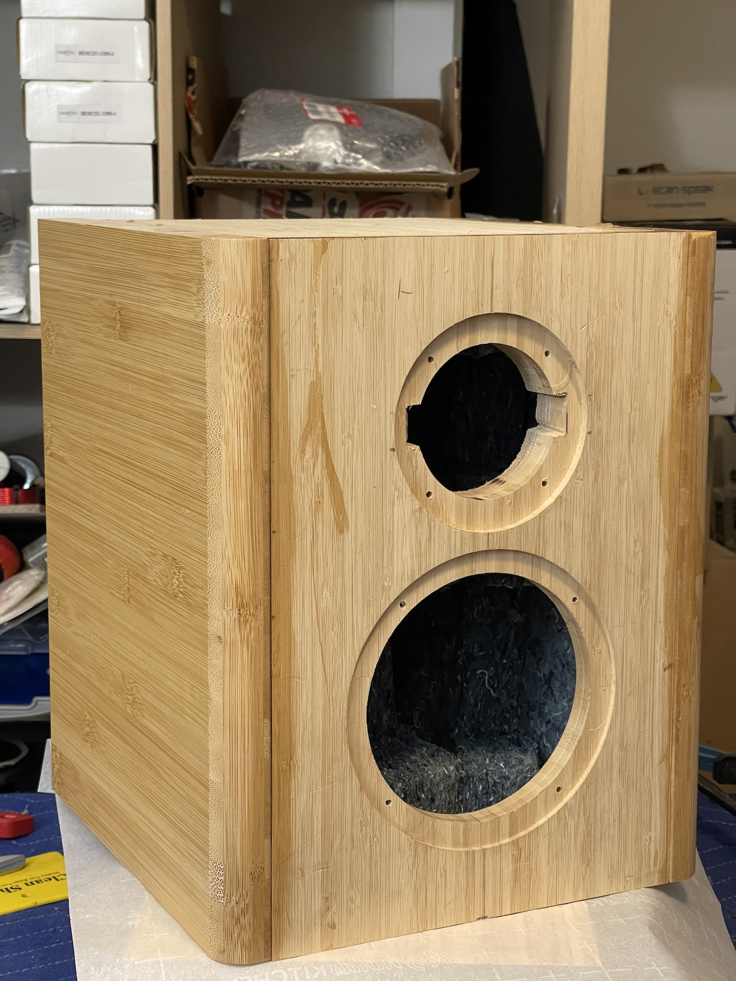

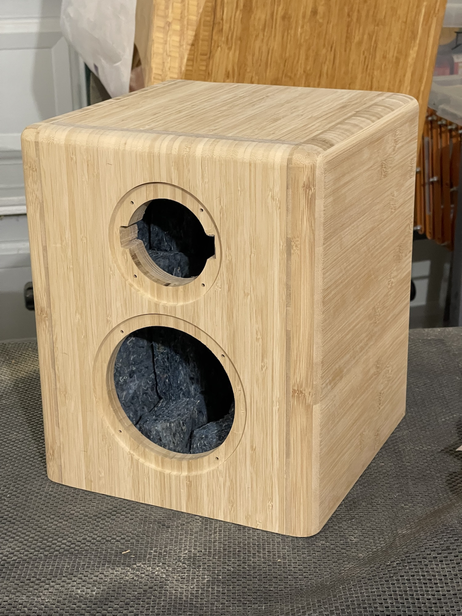

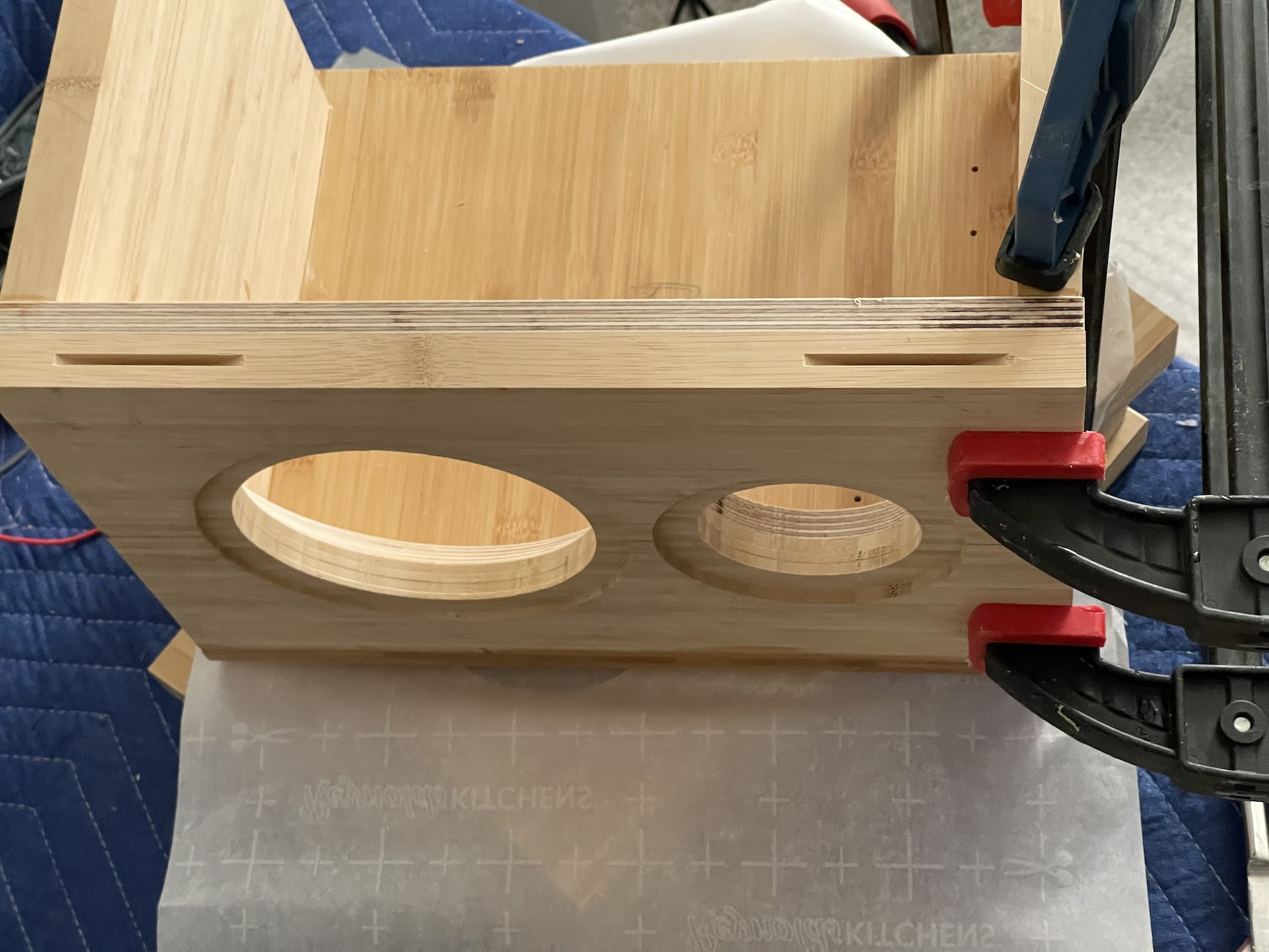

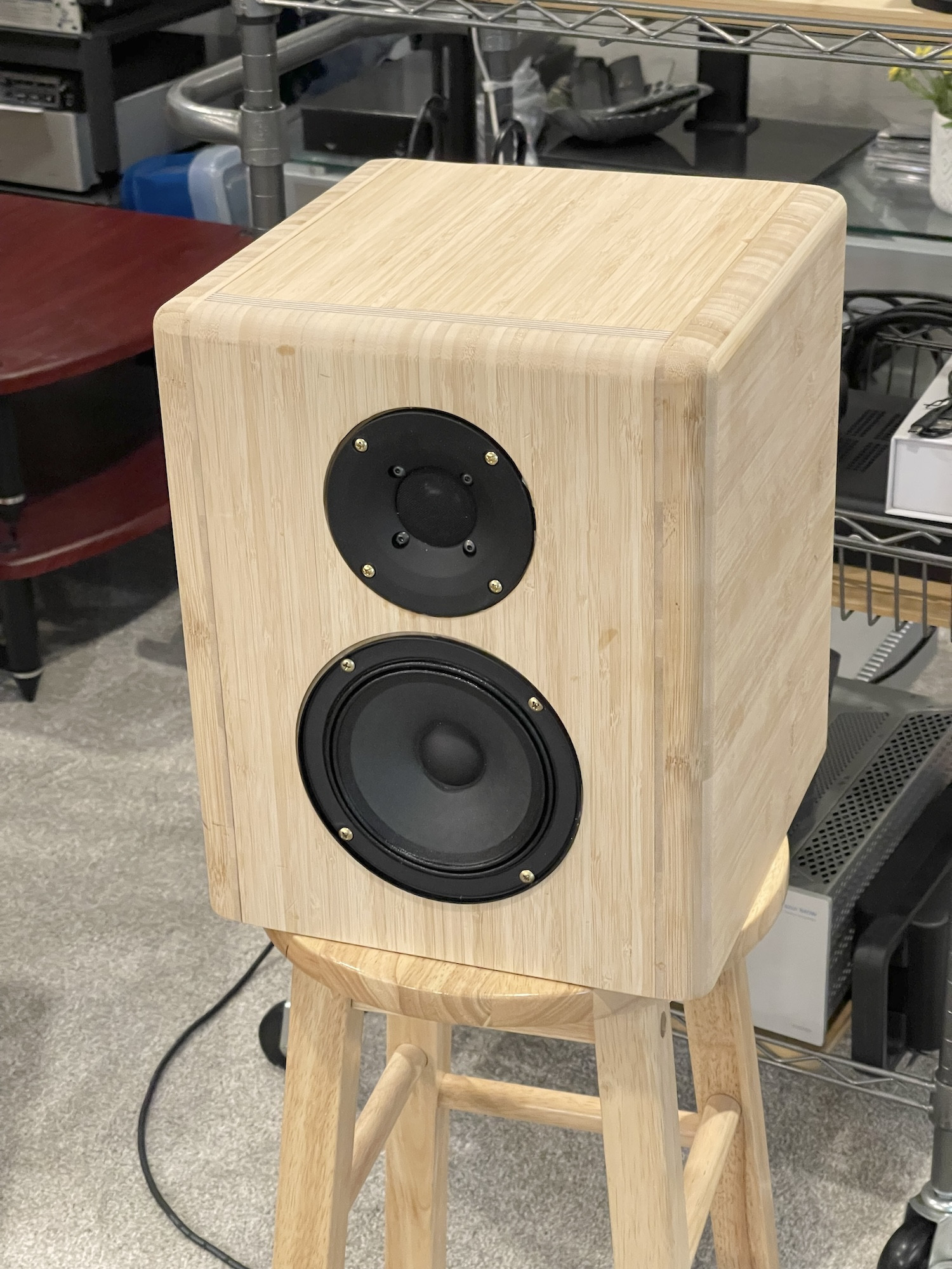

                                                An experienced Sith CAD apprentice has been "recruited", though not with the eager and compliant spirit I would usually prefer... however, in these times, needs must, and the results to date seem satisfactory....
                                                Detailing has involved the addition of an inner baffle layer in the front, rear, and top panel baffles, as well as detailing the woofer area braces, and the upper cabinet edges. A rear entry panel for crossover mounting has also been provided.
Name:	Right Front Hidden Line.png
Name:	Right Front Render.png
Name:	Right Front Render 2.png
Name:	Right Rear Render.png
                                                The majority of crossover components have been ordered from a key European vendor, and a test layout for the tweeter crossover is in preparation, and soon, fabrication.

                                                  It is time to advance the effort of this design study, with limited but critical hardware evaluation. To that end, we commence the fabrication of an M-T assembly mimicking the upper section of this proposed system design, to a limited degree. This will also serve the purpose of evaluating a potential M-T combination for the CC Technological Terror.
                                                  The concept for this cabinet is a shallower version of the top part of the proposed system:
                                                  Click image for larger version  Name:	1_Kii MF-HF 3D CAD.png Views:	0 Size:	1.49 MB ID:	949701

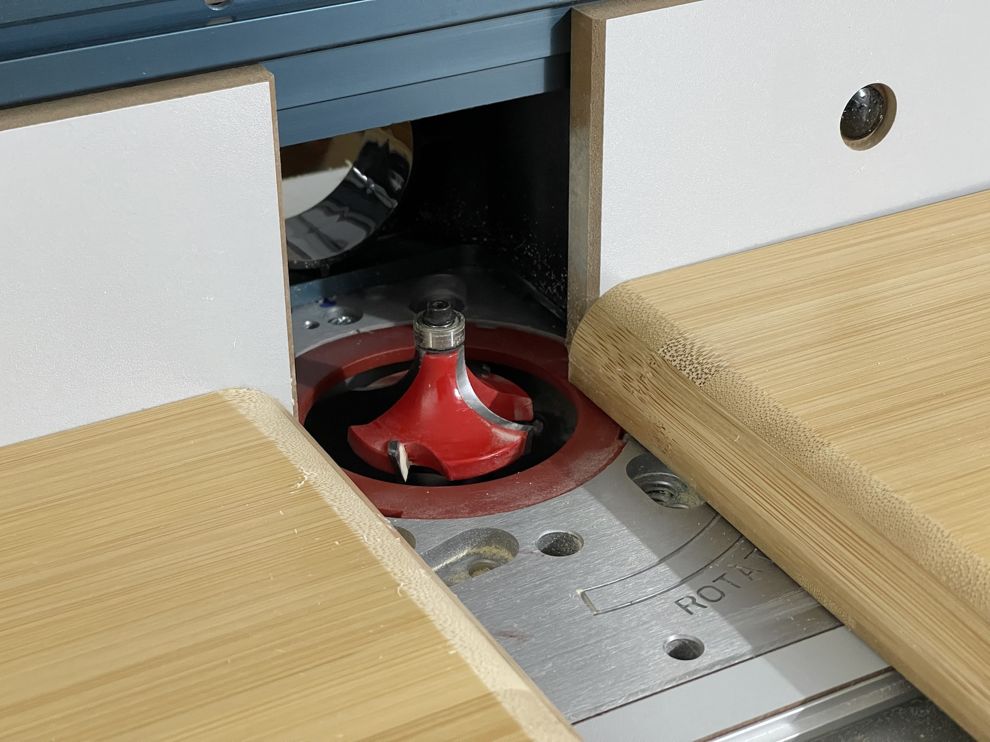

                                                  The construction chosen mimics the planned large cabinet fabrication- for the front panel with a 0.75" Bamboo panel laminated to 0.5" BB ply. Routing was accomplished next, on the larger piece of raw material (12" x 30"), laid out for fabricating two front panels. This allows clamping support for routing which the Final Cut size would make difficult.
                                                  After routing in a larger piece, the driver fit is checked, and as expected, found to be satisfactory.
                                                  Click image for larger version  Name:	2_Routing check fit.jpg Views:	0 Size:	687.4 KB ID:	949702
                                                  After routing operations are complete, the midrange backside through hole is beveled, then the panels are cut to the final size for assembly.
                                                  Click image for larger version  Name:	3_Ripping FP width.jpg Views:	0 Size:	604.1 KB ID:	949703
                                                  Side panels are a special fabrication, for this demonstrator evaluation it was decided to use just 1" material instead of 1.5", but a substantial round over is still required.
                                                  Click image for larger version  Name:	4_Side Panel Round overs.jpg Views:	0 Size:	636.8 KB ID:	949704
                                                  Assembly operations were conducted using biscuit joiners and the Imperial standard epoxy, BSI 30 minute cure.
                                                  Click image for larger version  Name:	5_M-T Glueup 1.jpg Views:	0 Size:	694.4 KB ID:	949705
                                                  Click image for larger version  Name:	6_M-T Glueup 2.jpg Views:	0 Size:	578.9 KB ID:	949707
                                                  Note the use of parchment paper to avoid issues with glue drips and protect bench surfaces and fixtures.

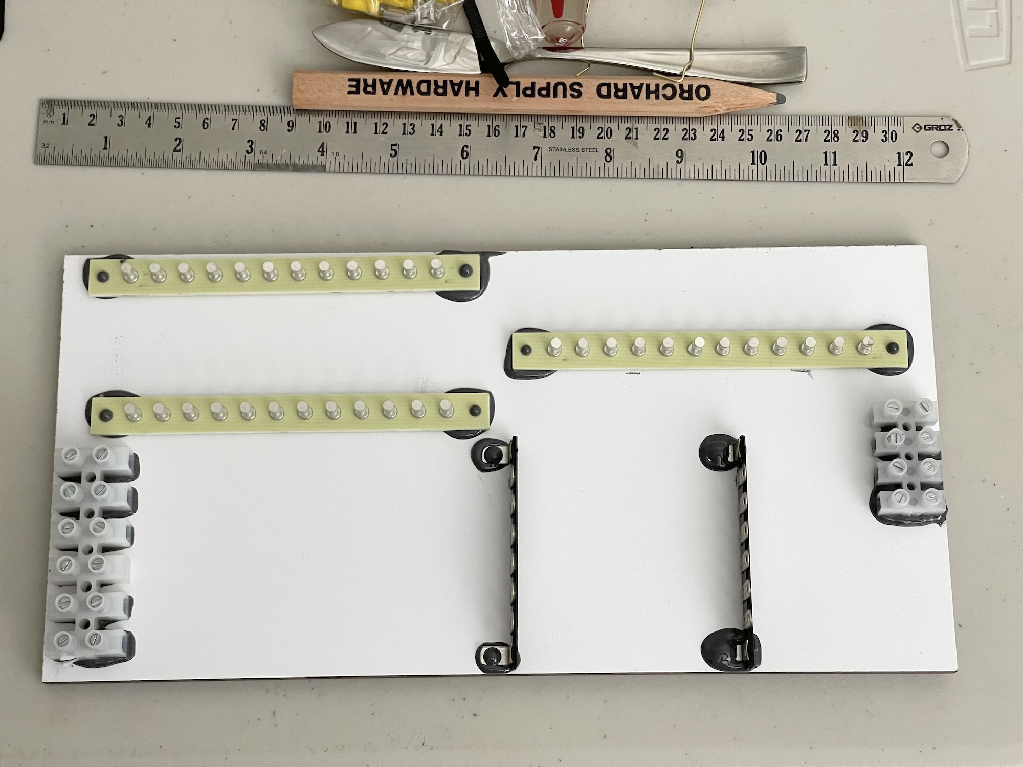

                                                  While waiting for epoxy to cure in each assembly step, a layout proposal for the Duelund style high pass tweeter crossover was prepared, and the base board for that was glued up.
                                                  Click image for larger version  Name:	Ardent Kii DXT PE HF Xover 6in RC Build.png Views:	0 Size:	549.1 KB ID:	949708
                                                  Click image for larger version  Name:	IMG_9021.jpg Views:	0 Size:	549.1 KB ID:	949709

                                                    Next is cleanup work- sanding, top and bottom round overs, wiring and driver mounting.
                                                      • 16038
                                                      Slow work takes time, but eventually it gets done!

                                                            Also, a scaled up version will be built, as a test for the PuriFi two way with PR’s for Steve for his neighbors. Not much bigger, but with the PTT6.5X04 woofers, the RSS210PR on the sides, and assuming things work out with measurements on the crossovers, regarding the notch filter behavior, probably DXT’s up tip- I have a nice looking LR3 design in VituixCAD for that systems concept.
                                                              • 1612
                                                              While I long for the days of reliable Imperial minions, with fast completion of projects, At least I must acknowledge that when slow work takes time, the resulting quality is most satisfactory... or at least, mostly satisfactory.
Name:	MT Assembled.jpg
                                                              Additional POC work has been completed, with several alternative configurations balancing off efficiency and total sensitivity, but now matters are clearly at a point where updated hardware measurements are necessary before proceeding further. Still, the several POC designs to date for crossover configuration all confirm that the driver choices should make the desired end results achievable.
                                                              The measurements for the Mid frequency and High frequency components will be ready soon...
                                                                • 1612
                                                                It might be worth noting that in this project, more measurements with test cabinets are in the queue prior to construction of the target cabinet designs, even though materials for a pair of those is already in the Imperial holding facility in this local sector.
                                                                Materials for an LF array test have been ordered and are expected soon.
                                                                A key part of the design path is completion of another detailed examination and documentation of all aspects, and providing for the possibility of HF voicing adjustments. Specific component parameters may require adjustment pending final cabinet+Driver measurements, but the crossover concepts and expected targets have been documented using existing measurements and appear to be fully realizable.
                                                                The final target for LF passive EQ has been selected on this basis, and documented within VituixCAD:
Name:	Modula Xtreme MkIII LF  EQ  POC XO-Graph-1.png
                                                                This is to be implemented with a simple passive network inserted between preamplifier and power amplifier, and this passive network is what produced the response above. Of course, there are alternatives, such as using a plate amplifier with Linkwitz style shelving EQ and speaker input mode, but this was deemed more complex and expensive than desired for this configuration.
                                                                There is a nominally flat system response crossover candidate currently termed RC3...
Name:	Kii Duelund RC3 11-2 LF EQ HF Flat XO-SPL-1.png

                                                                  • 1612
                                                                  The measurements and analysis of the MT test cabinet were completed today, with few surprises, other than slightly better measurement results, and the opportunity to reduce the number of components in some of the crossover filters.
                                                                  For reference,
                                                                  FSL-0512R01G-08 Quasi Near Field
                                                                  Click image for larger version  Name:	FSL-0512R01G-08 QNF.png Views:	0 Size:	143.6 KB ID:	949775
                                                                  27TBCD_GB-DXT Quasi Near Field
                                                                  Click image for larger version  Name:	DXT QNF.png Views:	0 Size:	125.0 KB ID:	949776
                                                                  The composite stuffing approach for the Midrange driver now also utilizing denim insulation performed most satisfactorily. And in this cabinet configuration, the 2kHz dip seen in measurements made 4 years ago is not present.

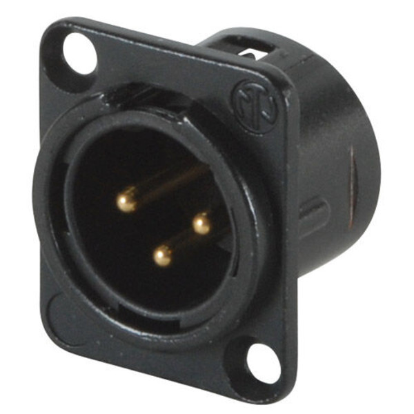

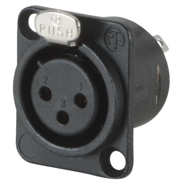

                                                                    Potential components for the LF Passive EQ module have been identified from Neutrik components and ordered. This is their "D" module system, and would use a Female XLR at the input end and Male XLR at the output, with a module board slotted in between the sides.
Name:	Female XLR.default.jpg
Name:	Male XLR.default.jpg
                                                                      Click image for larger version  Name:	Kii Duelund LF MF HF POC XO-schema-1.png Views:	497 Size:	51.4 KB ID:	949139
                                                                      Click image for larger version  Name:	Kii Duelund LF MF HF POC XO-SPL-1.png Views:	509 Size:	33.8 KB ID:	949140
                                                                      The target Duelund implementation for this POC is as shown earlier in this topic.

                                                                      well, decided to work through the same design issues of this project with a new structured design process I've been kicking around in the back of my head, and after applying it just to the midrange of this system, I can comfortably say that at least the midrange crossover in this design will be significantly revamped.
                                                                      Click image for larger version  Name:	Kii Duelund RC3 11-30 MF FSL-0512 Crossover RefPOC XO-SPL-1.png Views:	0 Size:	73.3 KB ID:	950026
                                                                      Remember there may only be historical value to watching the sausage get ground... until you get served the final sausage patty, anything can happen.
                                                                      But I'll also mention the impedance curve is nicer now, too!

                                                                        Have you taken any HD measurements of the SBS-160F35AL? Can it compete with SEAS L16?
                                                                          • 16038
                                                                          Yup. Possibly on both accounts.
                                                                          Click image for larger version  Name:	FSL-0512 QNF Disto.png Views:	0 Size:	256.4 KB ID:	950081
                                                                          I'd rather it had copper in the gap and didn't have the rise between 300Hz and 1kHz, but it's still under -50 dB. Unlike, say, an Epique E180HE-44, which increases to -30 dB, by my measurements under the same conditions.
                                                                            JonMarsh commented
                                                                            Editing a comment
                                                                            OF course, it's probably not fair to mention that there's a 10:1 difference in the price of the Seas versus the FSL-05120R01.
                                                                            BUT, I hadn't had my coffee yet, and I just re-read and you're interested in the SBS160!!
                                                                            Oopsie!
                                                                          • 16038
                                                                          Here's the SBS160F35AL01-04... QNF SPL and HD2 + HD3.
                                                                          Were I to quip a brief joke about this part, it's that, "This is not your father's 6-1/2" mid woofer"! That is to say, it's a bit of a quirky design, not intended for a conventional 6-1/2" two way, (Fs~50Hz, Xmax = 10.5mm, significant roll off slope above 100Hz that is modified by baffle step to be a bit flatter out to ~150Hz) but my intuition says it's a potentially useful part. I say potentially, because all I have so far besides base measurement is design SIM's.
                                                                          Another project (CC with Coax, for the Chancellor) is at the head of the queue for assembly and testing, though all the crossover parts for this project are on hand, and board layouts done.
                                                                          Click image for larger version  Name:	SBS160 QNF Disto.png Views:	0 Size:	229.7 KB ID:	950084
                                                                          The L16 seems to be a well executed more "conventional driver, (more a proper "your father's 6-1/2" woofer) with a 32 Hz Fs (instead of 49 Hz for the SBS160), 7 mm of Xmax, and a smooth response not quite extended enough for a "normal" two way, but possibly a waveguide setup? And higher sensitivity. And with the T/S parameters, well suited to ported or PR configurations.
                                                                          For the Peerless, HD2 is higher than I'd like to see, but HD3 seems well controlled. Overall behavior is fairly easy to work with, and the price is right- less than 1/4 of the L16 locally. Which is part of what suggests to me using a 4 driver series/parallel array, with it's partial line source giving benefits with regards to minimizing floor bounces irregularities in the frequency response that a single driver creates in a typical room with typical placement. And the partial line source giving the same impedance as one driver, but with a 6 dB boost in sensitivity.
                                                                          I'm sure that configuration could be effective in the right size enclosure for the L16, but the price would be a bit dear...
                                                                          This SBS160 response profiles fits well within the desired concept of a Duelund with a center frequency of 800Hz, and an Aleph of 2.75. I do prefer the inverted edge suspension, and it certainly seems to keep suspension contributions in the midrange at a low level.
                                                                          But then, it's quirky combination of Fs, Mms, Qts, means some special tricks are in order, to get a flat extended response below 100Hz, with the "Xtreme" series capacitor and a shallow LF EQ (done passively).
                                                                          I'm itching to get the CC coax design tested, so I can get back to this one... with four 180mm woofers, in a sealed configuration and the damping on overshoots that comes with that compared to a reflex design (cross fingers), I'm very curious to measure and listen to how it works and sounds.
                                                                          YMMV!

                                                                            Just to tease a bit more, here's the LF crossover build plan:
Name:	Kii Xtreme POC Woofer.png
                                                                              • 1612
                                                                              I am finding it desirable to introduce a different flavor of "rigor" to some driver evaluations, and rein in the "enthusiasm" of my at times over active and recalcitrant apprentice...
                                                                              In this case, owing to the possibility of alternative HF transducers, one element in this process which is being added to all potential waveguide oriented projects is to prepare a normalized filter network converting the waveguide response not to an arbitrary system response requirement, but to a nominal flat response as one might expect from more conventional tweeters and as used for a standard of comparison, especially for distortion product levels.
                                                                              This brief post will show how that concept has been applied to the Seas DXT H1499 tweeter, using QNF measurements to approximate an IEC baffle half plane measurement, with a filter to normalize both the response below 20kHz and to "neutralize" the impact of ultrasonic resonance on the SPL curve and resonant amplification of distortion products, if possible. This process has been used for other tweeter evaluations, sometimes only partially, as for direct radiation components such as the Peerless DA25TX-008.
                                                                              First, the raw QNF response.
Name:	Kii DXT QNF Import 1-10-2024 SPL-1.png
                                                                              Next, the schematic of the dual mode filter- the series cap and parallel LCR to flatten the response level to 1kHz on the left, the ultrasonic notch filter on the right. These filters will be built as a test board for evaluations of the DXT in "normalized" mode against alternative solutions.
Name:	Kii DXT Normalization 1-10-2024 -schema-1.png
                                                                              The simulated QNF response with these filters...
Name:	Kii DXT Normalization 1-10-2024 SPL-1.png
                                                                              The measured response, with a focus on achievable distortion levels, will be compared against other potential solutions, including direct radiation tweeters.
                                                                              Note, it has already been determined that increasing L13 to 1mH from the original calculated value should slightly further flatten the DXT normalized response plot.

                                                                                  At the behest of the Chancellor, it seems necessary to stage an "intervention" as recent checks indicate that the supply of the Peerless woofer has suddenly dried up... while OTOH, the midrange is plentiful, and another batch was recently imported.
                                                                                  While the original woofer candidate may be used for some HT oriented personal applications by Jonmarsh, it is clearly necessary to arrive at a new solution for the mainline concept- and of course, a truly intriguing one might require a certain amount of unusual thinking... one might say that worthy of a Sith Lord.
                                                                                  So for the Chancellor and others, I present a truly evil proposal, for a widely reviled driver, which may actually increase the performance envelope while retaining the compact overall configuration previously discussed.
                                                                                  The key is knowing the strengths and limitations of candidate drivers, and not billing them as something they are not... such as being described as a Full-Range Subwoofer...
                                                                                  It does not require Force intuition to realize that such a phrase is an oxymoron, yet it was widely used for the introduction of the Dayton Epique E180HE-44... including in reviews by nominally well regarded writers... The previous crossover proposal should be basically usable for this updated concept, but the passive LF equalizer becomes quite "optional".
                                                                                  As always, look beyond the data sheet and to the proposed configuration and how performance benefits can be optimized, while other issues are circumvented.
                                                                                  First, a review of the manufacturers half plane polar data.
Name:	E180HE-44 4x half plane Polar SPL.png
                                                                                  One important point that should be apparent to the astute designer is that response profile between 100Hz and 1kHz can be attuned for optimization with the baffle step of an optimum width enclosure.
                                                                                  This can be shown by simulation in tools such as VituixCAD,
Name:	E180HE-44 4x Baffle Model 9 SPL crop.png
                                                                                  And confirmed with measurements in an actual enclosure...
Name:	QuasiNF + Disto.png
                                                                                  OF course, including a distortion measurement highlights the issue discovered in early reviews of the E180HE-44, that it's rising distortion in the midrange will disqualify it for most as the mid woofer candidate for a two way system, as originally marketed. But with a crossover like the previously proposed version, at about 250 Hz, should produce fairly acceptable results, with an unusual extension in LF dynamics.
                                                                                  A key to this is using a 4 driver short line array, which keeps the nominal LF impedance in the 8 ohm plus range, but boosts the sensitivity by 6 dB, raising it to a reasonably healthy 86 dB, with no crossover baffle step required.
                                                                                  Combine this with the nearly 15mm of Xmax, and include the E180HE-44 Passive radiators, and we can achieve a true manifestation of the power of the Dark Side...
Name:	E180HE-44 PR 100W SPL.png
                                                                                  While still having reserves for SPL and driver excursion...
Name:	E180HE-44 PR 100W Excursion.png
