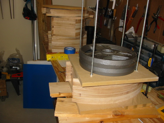

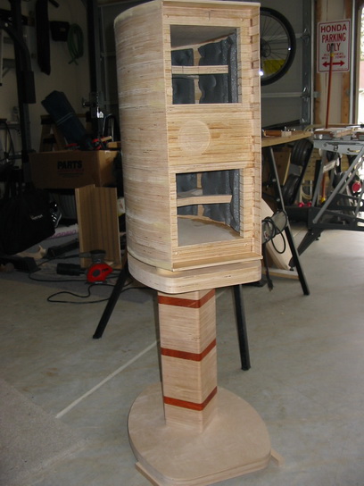

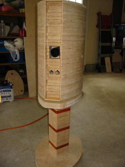

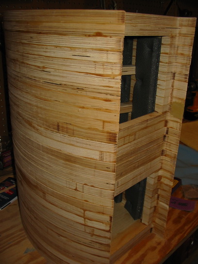

                                                        cochinada nice looking project, can't wait to see how it turns out. I did a translam project a few years ago and I would agree with knowledgebass with his suggestions if you are going to use baltic birch. I had splitting on my project like others have, so here is my two cents worth from what I learned, they may duplicate what knowledgebass has already said .......
                                                        * If you can I would use bamboo plywood, it's a lot more stable than baltic birch.
                                                        * Seal inside as well as the outside of the wood to get even moisture absorption.
                                                        * I would not use dowels to hold the layers together, it will constrain the plywood and not allow it to move.
                                                        * Do not glue the baffle in place, same reason as the dowels, float it with a gasket. Magico did that with their original Mini.

                                                          • 2142
                                                          Hi Steve,
                                                          Somehow this post slipped through my eyes. I understood your first two tips but exactly how do you suggest to hold the layers together without dowels? Just using glue? And what about the baffle? Do you mean to screw it instead of gluing it?
                                                          Hi Cochinada,
                                                          Glue should be all you need ....... I used the holes for clamping and alignment when I was gluing the layers together, then removed the threaded rods.
                                                          As to the baffle question ....... I glued and doweled the baffle and back into place, which I think is where most of my trouble came from. You can see the holes in the pictures I posted. I found out from looking at some construction pictures of older Magico speakers, that they have an o-ring in the back of the baffle and back insert for sealing and then bolt the baffle and back together though the cabinet. This lets the cabinet float independent to the baffle, allowing the wood to move around as needed.
                                                          Steve

                                                              • 2142
                                                              Thank Steve. The first part with the rods is understood but I'm afraid you lost me on the Magico speakers. You will need some giant screws for attaching the baffle to the back of the speaker I would say unless I didn't understand the idea. Do you think you can find those pictures you mention?
                                                              They use threaded rod and since their baffles are aluminum coming up with a thread hole is rather straight forward. Using wood, threaded inserts are easy to come by to do something similar. I'll look and see if I can find some pictures of what I'm talking about for you.

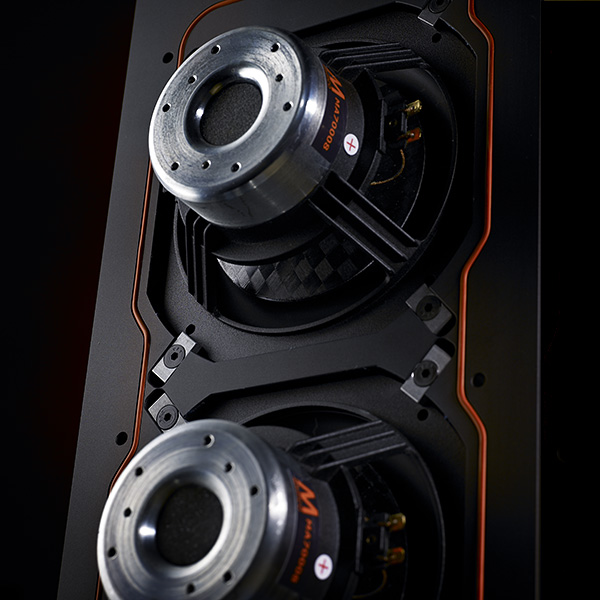

                                                                I found some pictures of Magico's construction back when they were doing BB and aluminum. They are going all the way through the cabinet with threaded rod. I think something a little cleaner could be done, but you get the idea and you can see the o-ring on the back of the baffle for sealing.
Name:	Magico V3 Drivers.jpg
                                                                I think you could also layout your driver cutouts such that you just use a threaded stud attached to the baffle and and have it run through the wood and attached a washer and nut by reaching through the driver cut outs, or a removable cabinet bottom.

                                                                    I would suspect that it's just one way of attaching the baffle and being able to adjust the bolt tension as desired to track wood expansion and contraction, other than that I don't know.
                                                                    • deewan
                                                                      • Feb 2009
                                                                      • 290
                                                                      Monitor Audio does a similar construction with threaded rods through the back of their PL line. I think the Monitor Audio design would be easier to duplicate.
                                                                        Actually I really like this approach, allowing you to do removable baffles that can be decoupled by a layer of something squishy between the baffle and the cabinet hmm..
                                                                        Last edited by theSven; 20 June 2023, 20:03 Tuesday. Reason: Remove broken image link
                                                                          • 2142
                                                                          Makes it nice if you want to mount your drivers on the backside of the baffle as well.

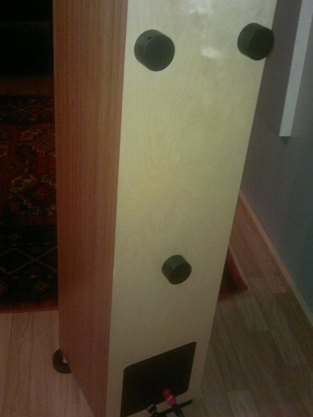

                                                                            Some ideas:
Name:	Series_cutout_Coltrane_3-pt98stiyx2tdr1opomya5e210fixafveyx32kkc9og.png?media=1677056741.png
                                                                            I will most probably design my own supports (in fact they are already finished) and will choose between the Viablue or Trackaudio or even the Soundcare spikes.
                                                                            One thing is settled: due to the weight of each speaker they will have four spikes that will of course have to be adjustable.
                                                                            If anyone has any suggestions please come forward.
                                                                            Last edited by theSven; 26 March 2023, 11:41 Sunday. Reason: Update image location
                                                                            Joaquim
                                                                            DIY 4 way speakers.
                                                                            DIY subwoofers.
                                                                            Zaph ZD3C.

                                                                                  I have the ViaBlue's on my Jensen's, very well made and they have a great load rating. I also found a place that sells them for about 1/2 of MSRP is, so that also helped in making my choice.
                                                                                  • cochinada
                                                                                    • May 2014
                                                                                    • 661
                                                                                    Originally posted by Hdale85
                                                                                    Wow those Viablue's are nice looking.
                                                                                    Yes, I also find them very nice notwithstanding the Trackaudio ones.
                                                                                    I like the look of the outriggers, but when I've gone looking for them they've been really really expensive. Recently, someone on PE Tech Talk recently posted a link to a metal fabricator who had standard off the shelf brackets for a reasonable price. He then added some of the big PE spikes to it and it made outriggers very similar to shown above. I thought I had book marked the site, but now can't find it on this computer. I thought the company had 'Uni' in the name, but my memory isn't working so well these days.
                                                                                    Well, if you remember please share although I don't think it pays importing them from USA. I mean with the shipping, taxes and the devaluation of the Euro these days I probably have to order some custom made supports locally.
                                                                                    Great! Then you are the one that is going to clarify some doubts I have .
                                                                                    One thing is not clear to me and it's the length of the threaded sticks. From the Viablue site they mention 15mm but with only half of it coming out of the spike I find this too short to provide a sturdy attachment. What do you say?
                                                                                    My other question is about the adjustment. Is it easy to do it using our bear hands without tools, even if we have a very heavy speaker like 360lbs?
                                                                                    BTW if you also want to share that place where they are sold at 1/2 price please do even if it is by PM.
                                                                                        I just did a measurement and the threaded rod is just over 20 mm and looking at the online specs you can adjust that by another 5 mm. I have no problem taking them on and off by hand, but I do tip the cabinet to one side to do that rather than trying it with the cabinet flat, that way your not trying to move the entire cabinet.
                                                                                        Here is the link to the place I got them from http://www.avoutlet.com/index.php?di...roduct_id=1577, looks like they still have them for half of what I have seen them else where ... not sure if it would be worth it getting them sent to Europe or not, might be worth crunching the numbers at that price. They also carry Viablue cable stuff as well.
                                                                                        Besides the looks one of the main reasons I picked them, was their ability to support almost 450 lbs, everything else I looked at was around a 100 lbs for a set.
