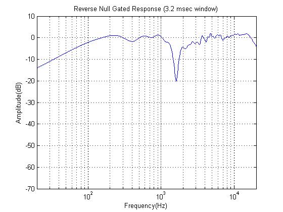

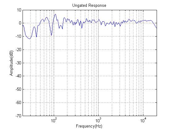

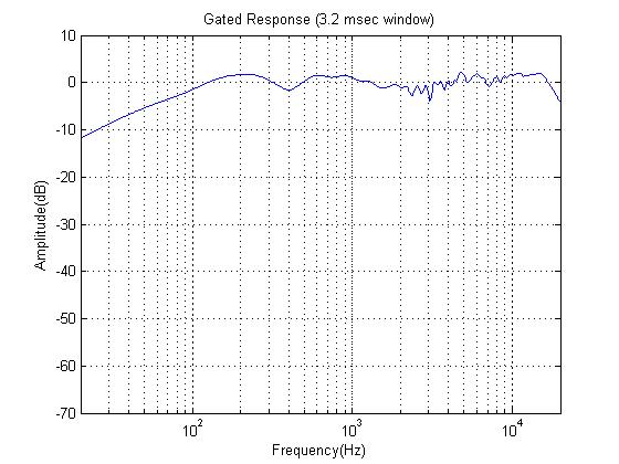

                                                                              Here's my on-axis measurements at about 1 meter with no mic calibration used on my ECM8000.
                                                                              Tweakable tweeter values used:
                                                                              First series resistor: 1.33 Ohm
                                                                              Series Lpad resistor:2.2 Ohm
                                                                              Shunt Lpad resistor: 8.33 Ohm
                                                                              Shunt cap: 4 uF

                                                                                      I'm not Jim but I'll give it a shot. Remember he's measuring indoors so he has to deal with room reflections.
                                                                                      1. Very short gated measurement. Just measuring the direct signal before any reflections arrive. Accurate at high frequencies but not accurate below several hundred Hz.
                                                                                      2. Ungated measurement. Accurate at all frequencies but it shows the full effects of room reflections so it looks more ragged.
                                                                                      3. Measured with the wires reversed on the tweeter. Deep null at the XO frequency shows good phase alignment.

                                                                                        • jimangie1973
                                                                                          • 92
                                                                                          #134
                                                                                          Originally posted by KarlXII
                                                                                          Hmmmm.
                                                                                          I'm not that used to measurements.
                                                                                          What's the difference between the graphs?
                                                                                          What's the dip in the last one?
                                                                                          What software did you use?
                                                                                          Dennis answered the first two questions perfectly. As for the third, I'm using ARTA for frequency response, and LIMP for impedance. I export the ARTA/LIMP data in text format to Matlab where I do the plots. I also do the crossover simulations in Matlab. I use Matlab mainly because it's what I'm good with. I have used it for years at work. I also know exactly what the simulation is doing because I have written it from the ground up.
