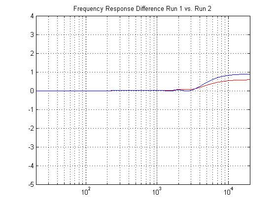

                              I got the parts for the XO now. Unfortunately it´s impossible to find the same components as in Jim´s design.
                              These are the diffs:
                              Capacitators:
                              4 uF replaced by 3,9 uF
                              30 uF replaced by 33 uF
                              Resistors:
                              2,2 Ohms replaced by 2 Ohms
                              Coils:
                              Erse 14 GA=1,63mm replaced by noname 1,4 mm = close to 15 GA
                              Jantzen 20 GA replaced by noname 20 GA
                              Jantzen 18 GA replaced by noname 20 GA
                              All other values are the same.
                              What do you think about this?
                              To me, looking at it, this could make up a completely different XO.
                              Is it? Any ideas how this may change speaker output?
                              • jimangie1973
                                • 92

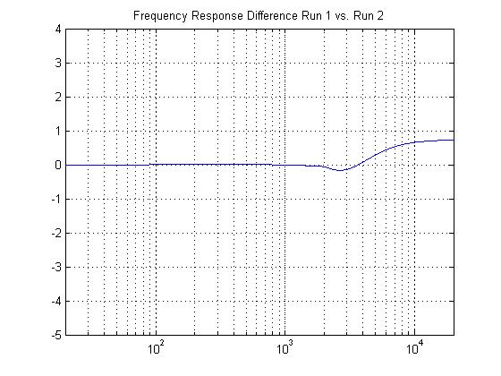

                                Hi Karl,
                                What I will do is provide you with a difference frequency plot between what you have and what I currently have. I'll do this tomorrow when I get to work.
                                The two components that stand out as potential problems are the 33 uF cap and the 2 Ohm resistor. I originally had a 33 uF and lowered it to 30 uF for a smoother response.
                                I use an 18 uF and 12 uF in parallel to get the 30 uF value.
                                Also, you can parallel a 4 Ohm and 5 Ohm and get 2.22 Ohms which would be very close.
                                Do you have access to any of these values?

                                                                            Hey Karl,
                                                                            Funny you mention this. I was just playing around with this in my simulation yesterday.
                                                                            You can change the 8 Ohm parallel with tweeter to a 10 or 12 Ohm, and change the 1.33 Ohm to a 1.2 Ohm (2 Ohm parallel with 3 Ohm). This will give some upper treble boost. I'll add the difference plot to show you the change in FR when I get to work today.
                                                                            The extra bass you're getting from the TL is probably skewing the tonal balance a little bit.
                                                                            EDIT: I've attached the plot showing how the change affects the frequency response. The blue curve is with the 12 Ohm, and the red curve is with the 10 Ohm. Y-axis is dB, X-axis is frequency in Hertz.

                                                                              Originally posted by jimangie1973
                                                                              Hey Karl,
                                                                              Great!
                                                                              Funny that you already were playing with it. :B
                                                                              So that'll be appx 1 dB starting from 3000Hz?
                                                                              That could do it, but what if it isn't..?
                                                                              What happens with the 1,33 -> 1,2 ohm change?

                                                                              • jimangie1973
                                                                                • 92
                                                                                Originally posted by KarlXII
                                                                                Great!
                                                                                Edit: Perhaps I won't even have to go to the store.
                                                                                This is a 12 ohm resistor, right? ops:
                                                                                Click image for larger version  Name:	r12.jpg Views:	0 Size:	62.2 KB ID:	936331
                                                                                Edit..again!
                                                                                Just measured it to 12,2 ohms. :T
                                                                                Looks like a 12 to me. I'm anal so I always verify with an ohmmeter. If you have two 12 Ohms per channel, you can add the second one in parallel with the 1.33 Ohm to make 1.2 Ohm.
                                                                                Lowering the 1.33 Ohm resistor raises the entire treble response. Raising the 8 Ohm value lowers the lower treble very slightly and raises the upper treble. The combination gives the best response from what I think you desire.
                                                                                From my experience, a 1 dB raising of the upper treble level is not subtle. If it's still not enough, just let me know and I'll work with you.

                                                                                    Houston, we got a problem. :roll:
                                                                                    Seems I'm already running the boosted treble - I've got 2 & 3 ohm parallell soldered in! I have a faint memory of the guy in the store saying it was no mentionable difference from the 2 & 4. :evil:
                                                                                    Anyway, this means I'm currently running the boosted treble and still want more.
                                                                                    I could still switch the 8 for the 12, but do you think that will do it for me or do we try something else?
                                                                                    • jimangie1973
                                                                                      • 92
                                                                                      Yes, switch in the 12 for the 8. That makes the difference in the upper treble.
                                                                                      EDIT: Attachment shows difference from what you're currently running.

                                                                                        • KarlXII
                                                                                          • 41
                                                                                          Change implemented.
                                                                                          First impression:
                                                                                          This is not a subtle change.
                                                                                          Wow.
                                                                                          • KarlXII
                                                                                            • 41
                                                                                            A lot more detail. Air.
                                                                                            Now all the small details in the upper region comes through.
                                                                                            This is exactly what I was looking for.
                                                                                            Now I just have to check that it isn't too sharp...
