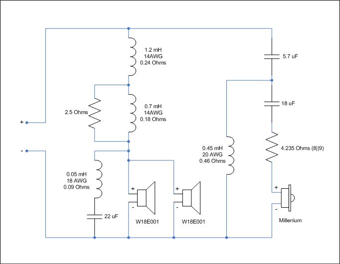

          As you are probably aware, both original SEAS Odin Mk3 and Thor have the same crossover, just different cabinets.
          The first crossover pictured in the above post (with 1.2mH series woofer inductor) is a LR4 1.9KHz crossover that user "jimangie1973" designed for a commercial speaker which utilised SEAS W18E001 (with rubber boots) and T25CF002 drivers in a cabinet with the same baffle layout as the Odin, but slightly wider width (10" vs 9.5") and sealed with 1.2 cu ft (Odin mk3 is vented). Jim developed this crossover sometimed in 2007/8.
          A few comments (all IMO) if I may. There may be some variations of the first picture floating about, because you can basically tweak the tweeter level to your own taste by adjusting the series tweeter resistor (4.235ohm). A fraction of an ohm can make a difference to a tweeter that calls out "hey everybody listen to me" and one that's never calls any attention to itself, but the treble is still all there.
          The parallel woofer inductor (0.05mH) is responsible for notching out the magnesium cone resonance of the W18E001, and may need some fine tuning. This is because the resonance have wandered over the years, according to some reports (and publicly available measurements). In my own W18E001 (copper plated motors, no rubber magnet, earlier production year), I found that I had to unwind my inductor to 0.045mH to knock the magnesium cone resonance right on the head. Of course YMMV.
          I'm not sure what that 2nd picture posted above (2mH series woofer inductor) but if I recall correctly, it was a drawn version of one of Jim's ealier crossover iterations, because Jim's original crossover is a text document and difficult to for some interpret.
          Now a couple of years later Jim developed another LR4 crossover, crossing over at 1.5KHz. Jim reports this as sounding slightly better. This is the recommended crossover, if you were to build one today. It's posted here:

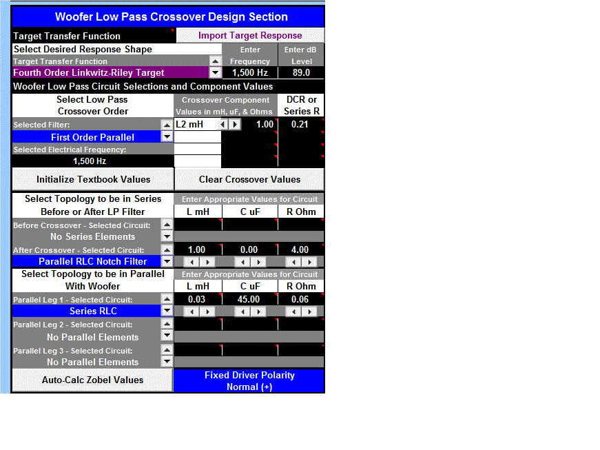

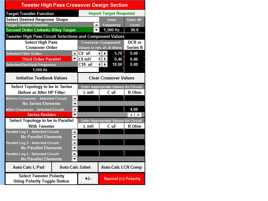

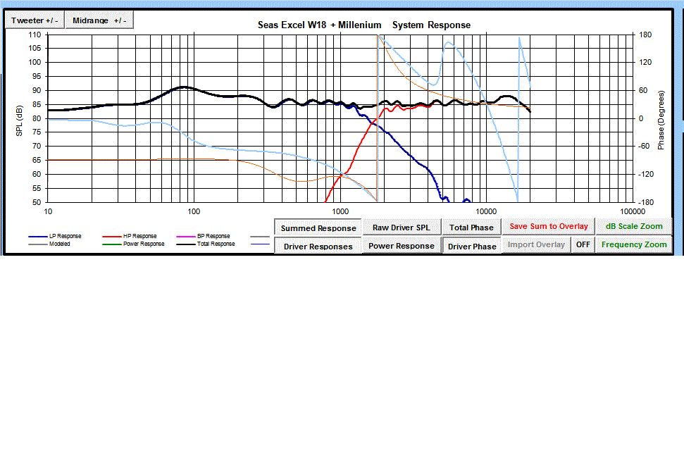

                Hi All,

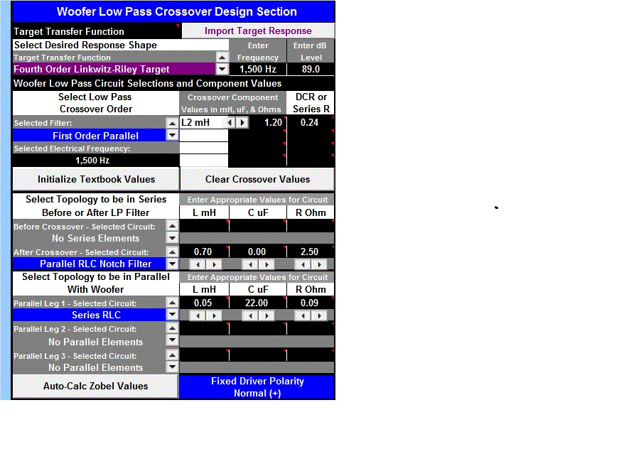

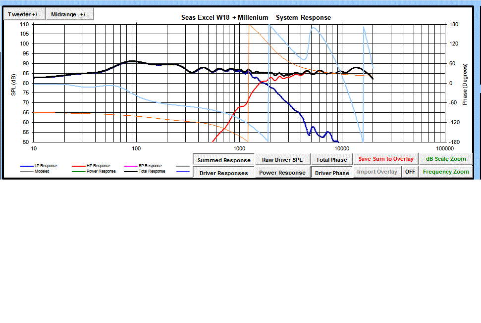

                This may take a couple of posts. I wanted to tweak my crossovers so I decided to simulate them so I could see what changes had what effect. The problrm is that my sims don't look anything like Jim's and I can't figure out why.
                I took Jim's FRD and ZMA files for the Seas drivers from page 1 of this thread (posts 28 and 29). I used those in Jeff Bagby's PCD software to simulate the crossover shown in post 227 above with the 5.7 cap in the tweeter circuit. I don't get nearly the same results as some of those above. In particular the crossover frequency is higher and the phase response is not good compared to what is shown in post 45 or 128 above. (I think post 34 is a different crossover.) I must be doing something wrong, but I don't know what. Can someone comment. I will do another post with a different crossover version.
Name:	Seas 5.7 cap crossover response.gif
Name:	Seas tweeter section 5.7 cap.gif
Name:	Seas low pass 5.7 tweeter.gif

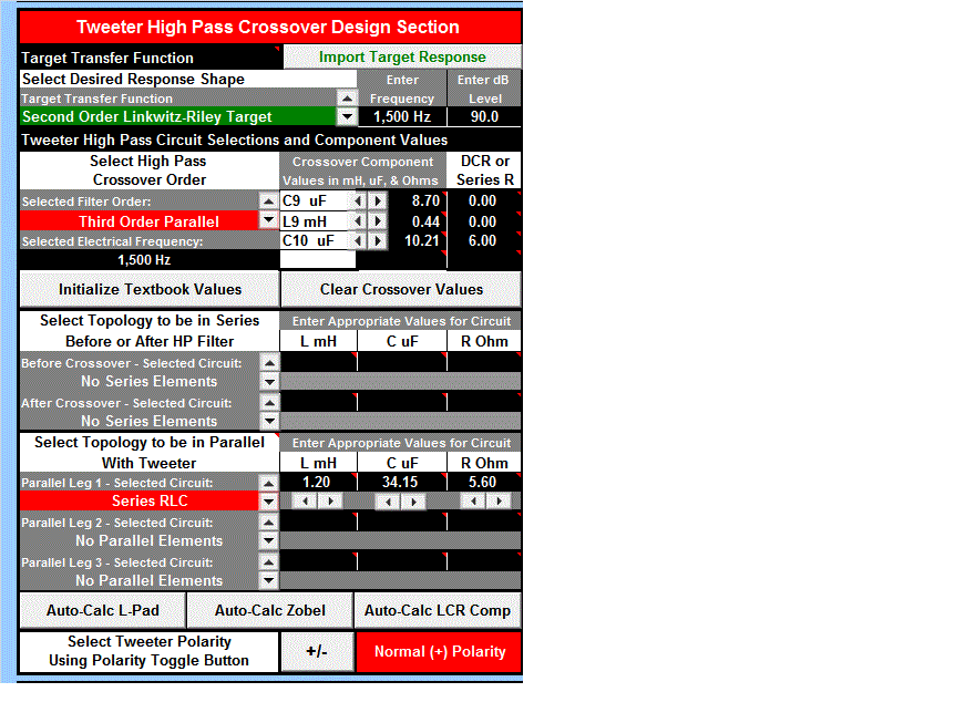

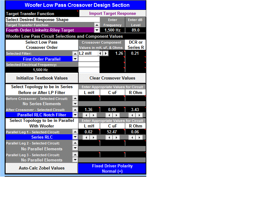

                  #233
                  Continued:

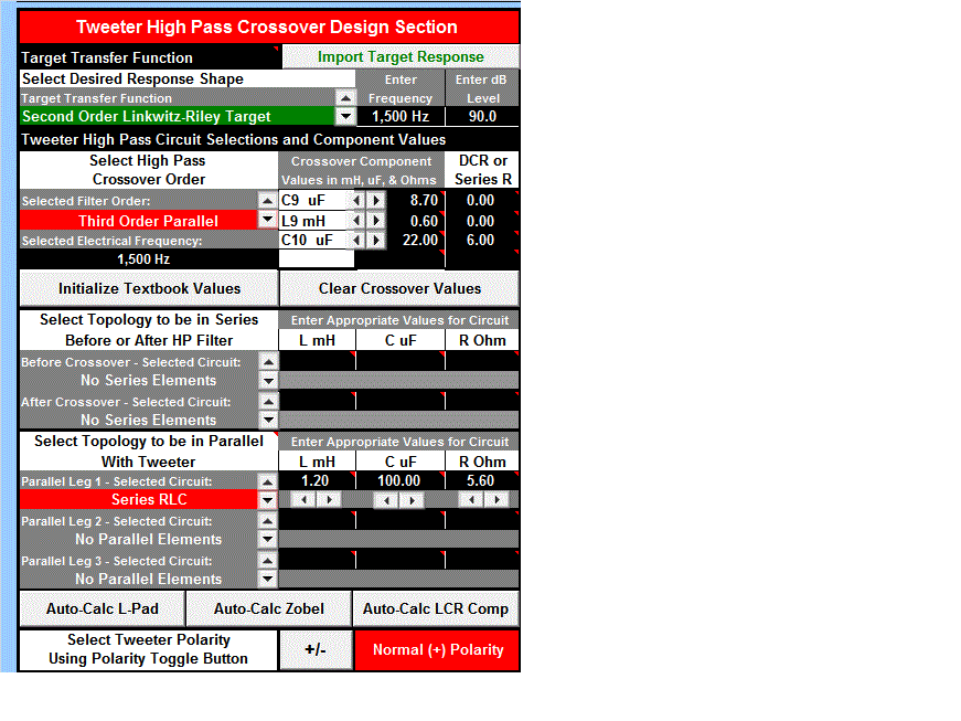

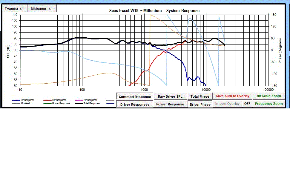

                  Next I simmed another vesion of the crossover with the 8.7 cap in the tweeter circuit. What I got is attached. The crossover point is lower but phase response still is not good.
                  Finally, I tried modifyng this version of the crossover to get better phase response and came up with the second set of attachments.
                  Could someone "check my work" and see if they come up with similar results or tell me what I am doing wrong.
Name:	Seas response 8.7 cap.gif
Name:	seas woofer circuit 8.7 cap.gif
Name:	seas tweeter circuit 8.7 cap.gif
Name:	seas 8.7 version modified.gif
Name:	seas 8.7 version woofer circuit modified.gif

                    #234
                    One more with the last part of the circuit since I can only do 5 attachments
Name:	seas 8.7 version tweeter modified.gif

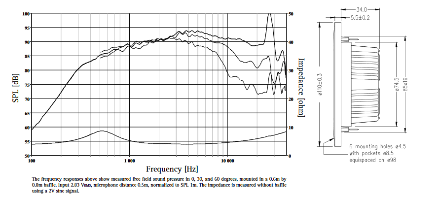

                              modification for different tweeter.
                              Hey guys.
                              I asked this question ower in the thor thread on DIY audio also, but throws it in here to in hope for a quick answer.
                              In the shop i work in we sell hifi and home cinema equipment amongst other and one of the brands we sell uses the W18E001 drivers (XTZ speakers), so i can get some good prices on these, and i have some of their speakers in my HT and like the sound of them. and on another totally useless point i am from Norway and live only an hour away from the factory making these drivers :B . This made me look at the Thor DIY kit for my first speaker build.
                              I got an bargain on a pair of new in box T29MF001 magnum tweeters ( 150$ instead of 770$ :T ) that i just couldn't resist taking. From what i have read here i have decided to build a pair of FAT THOR but i need some help remodeling the xo for the different tweeters.
                              According to seas, i mailed them and asked, they say i have to adjust the xo for the higher sensitivity of the magnum tweeters.
                              Is there anyone that can take the specs of the diferent tweeter and adjust the XO to fit theese?
                              Exept for some car subsencloshures this will be my first DIY speaker, and im total novice in XO construction so all help is apreciated
                              T29MF001 Spec PDF
                              The original T25CF002 "Millenium" Tweeter specs

                              The replacement T29MF001 "Magnum" tweeter specs
                                Hey guys.
                                T29MF001 Spec PDF
                                Click image for larger version  Name:	s_seas_excel_loudspeaker_tweeter_e0011_t25cf002.jpg Views:	0 Size:	44.7 KB ID:	936338
                                Click image for larger version  Name:	s_seas_excel_loudspeaker_tweeter_e0047_t29mf001.jpg Views:	0 Size:	44.3 KB ID:	936339
                                Click image for larger version  Name:	seas-e0047-t29mf001-fr.png Views:	0 Size:	72.2 KB ID:	936341
                                Click image for larger version  Name:	E0047_T29MF001b.jpg Views:	0 Size:	22.0 KB ID:	936340
                                I think the only way you may get something like that done is if you sent a pair of magnums over to someone who has sufficient experience with this design (jimmangie), and he felt it was worthwhile to do so. As someone who has spent way to much time tunning a system or two in car audio, the idea of spending a few hundred hours to get everything to work isn't really appealing, and I'm sure he's far for more proficient than I can ever dream of being.
                                Not to mention the driver doesn't really have current availability stateside, so it makes it an unlikely candidate for a redesign. If you're dead set on building the thors, then buy a pair of the tweets that the design calls for. Chances are you will be far happier that way.
                                I think that if a driver should be chosen to replace the original, it would probably should be a driver that would have merits in the design... a Scan-Speak 6600 or maybe even on a budget Seas 27TBCDGB-DXT, or switching to the nextel series which have a better midrange and won't require the tweeter to crossover at around 1500hz or below, but either way changing the tweeter would probably require a complete redesign of everything but the box, and at that point why stick with the original driver compliment.
