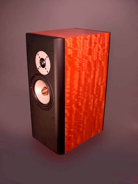

    Frequently the topic comes up of what commerical kits are good, better, or best, or what we might recommend for someone that doesn't want to go the whole hog DIY route.
    There are a lot of nice products out there with varying levels of design sophistication, but I'll admit I'm a little biased about my design preferences, and there's not too many kits from the DIY kit companies that I'm fully enthusiastic about.
    One company I've purchased components from frequently (most often custom crossover coils), and for which I have a fair amount of respect for their principle designer is North Creek Music. George has introduced a new design which looks to be quite well executed; the thinking behind it is quite sound, IMO, and bears a closer look for anyone looking for high quality and acoustic performance at a fair price. :T
    Pegasus System
    My understanding is that a dual driver sytsem using the W18 is in development, to be titled the Prometheus, which will use a configuration and tweeter ribbon similar to the Manifest.
    Now, lest everyone think I'm turning into a schill for George and abandoning my DIY projects, do note the prices which this level of quality commands. :E
    In bang for the buck, I think we're doing pretty well here with the various Modula based projects.
    But I understand that the level of DIY we do here isn't for everyone, and that high quality kits have a place in the audio universe. I think George's better designs will compare well to a lot of fairly high end commercial offerings- let's not forget the crossover work he's done for B&W and Apogee- those are fairly serious calling cards.
    ~Jon

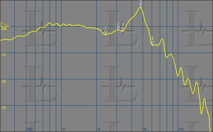

                                                Well, you might think that, and PERHAPS if you had an anti-response complement in the electrical network which exactly mirrored the driver, this could be the case...
                                                BUT, in real life, some ugly factors rear their head.
                                                The driver in no way resembles a "simple" single peaking function as regards the mechanical issues- there are radial and bending modes in vibration which can manifest in various ways in the cone response. Even expressing simple dynamics of cone vibration requires third and fourth degree differential equations.
                                                So, let's look at Geroge's analysis of the W18 modes, which is a lot more subtle and thoughtful than I usually encounter in print (I think some folks think I'm looking every where for speaker modes and blow things out of proportion because of my insistence on examining the impedance curve, nearfield plots, and shaped sine burst response).
                                                While the main breakup mode near 5 kHz is the one "everyone" pays attention to, just like many other drivers I've tested, there are other issues which occur lower and higher in frequency and are measurable with the right techniques. In principle, to fully correct these in the amplitude and time domain will work IF the driver is truly minimum phase by itself, and IF we compensate each one of these issues individually. How many tuned notch circuits are you willing to implement in your passive or active crossover?
                                                Now, all that aside, we also all know that the dispersion of a driver is quite related to the radiating cone diameter, and this also imposes (IMO) a useful upper limit beyond which we go only at peril to the power response profile.
                                                The lowest frequency issues George identified with the W18 are at ~2.4 kHz. So, while the Excel cone shape helps push the main peak up higher, there are still problems down lower that must be considered, lest we get the "signature" which has plagued Taco, George, and others working with the W18 using more conventional approaches (like Joe D'Apollito's Thor design).
                                                Considering the inherent bandwidth/dispersion limitations as well as cone modes, I'll stick by my persnickity recommendation of a 1400Hz crossover point for a high grade 7" two way using this driver (or the RS180), and no higher than 1800 Hz for a "bang for the buck" approach. IMO, a 2400 Hz crossover, as many have used for the W18, is decidedly suboptimal.
                                                But you know, this IS a free country, so we can all build what we want to our hearts content. Our only goal here (since we're not selling anything to anyone) is to share info about how to build the best speakers we can conceive of for playing back music in our homes- the best at at specific cost and complexity level, of course.
                                                What I recommend to anyone unsure of which path to take, is try several approaches. Build and investigate many different approaches yourself, then use your instruments and ears to figure out what works best for you.
                                                There's no need to take my word for it- the lessons we really believe in are the ones we learn for ourselves, aren't they?
                                                ~Jon

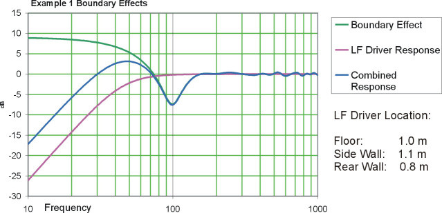

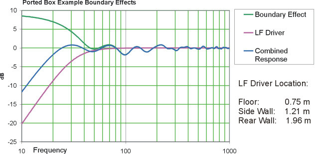

                                                                                          There could be a number of factors at work- height from the floor, distance to walls- note that the closes three surfaces should be spaced at golden mean ratios to get the smoothest midbass to lower mids, and at the right overall distance so that the boundary lift kicks in as the speaker is starting to roll off...
                                                                                          How NOT to do it... (one example- there are many variations)
                                                                                          How to do it...
                                                                                          (Calculated in a MathCAD worksheet I put together years ago- can be evaluated in SE and LspCAD, too).
