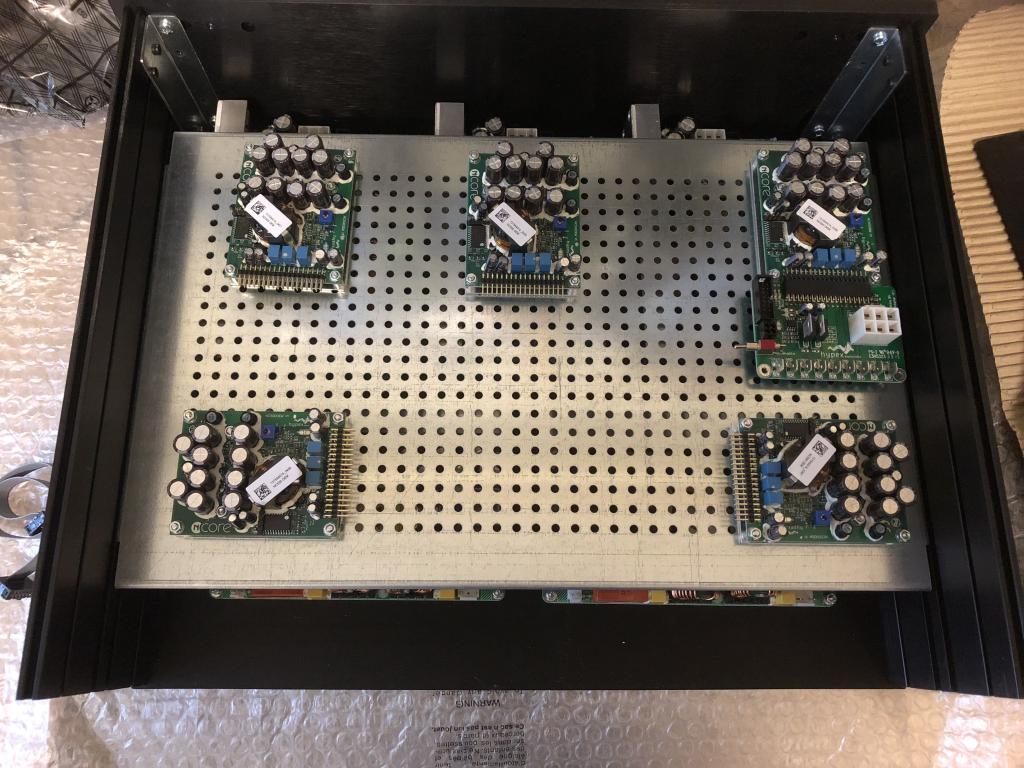

      I’m thinking about this layout:
      I’ll 3d-print some mounts for the smps, the nc500 and the oem board.
      Any comments? Do you think this will be a good layout? Should I look into some other layout?

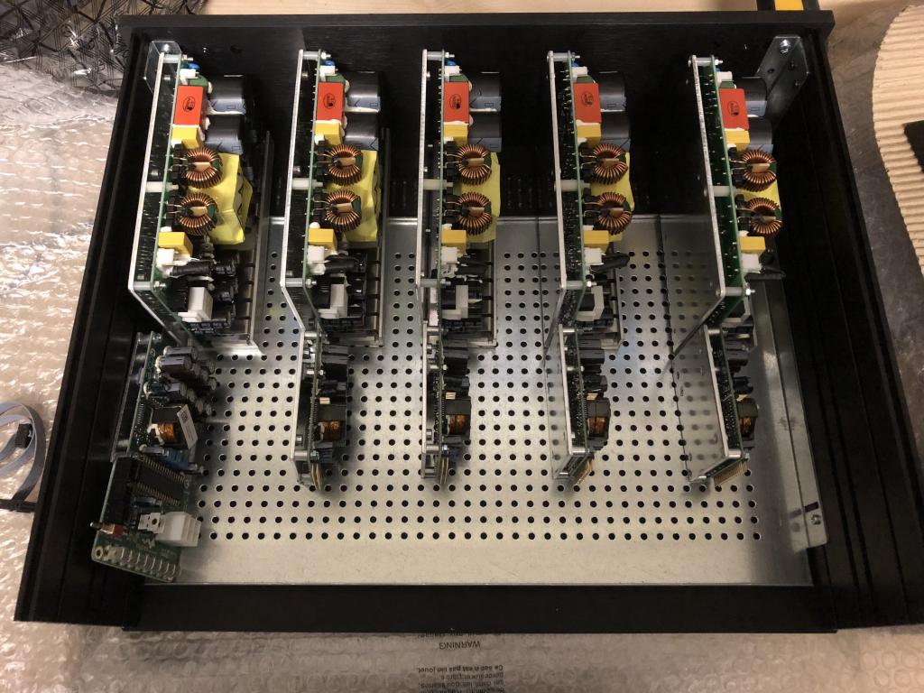

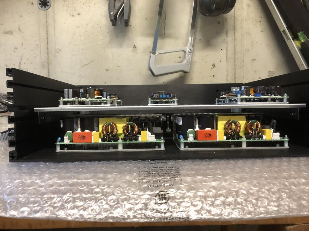

        After some pounding I figured out that I wanted to look into a different layout.
        I had concerns about to little space from the power supplies to the top of the case. I also felt that there was to little space between the back of the amp (input/output connections) and the oem converter board.
        So I’m looking into the layout shown below.
        That give me one «floor» for the power supplies and one for the amps and converter boards.

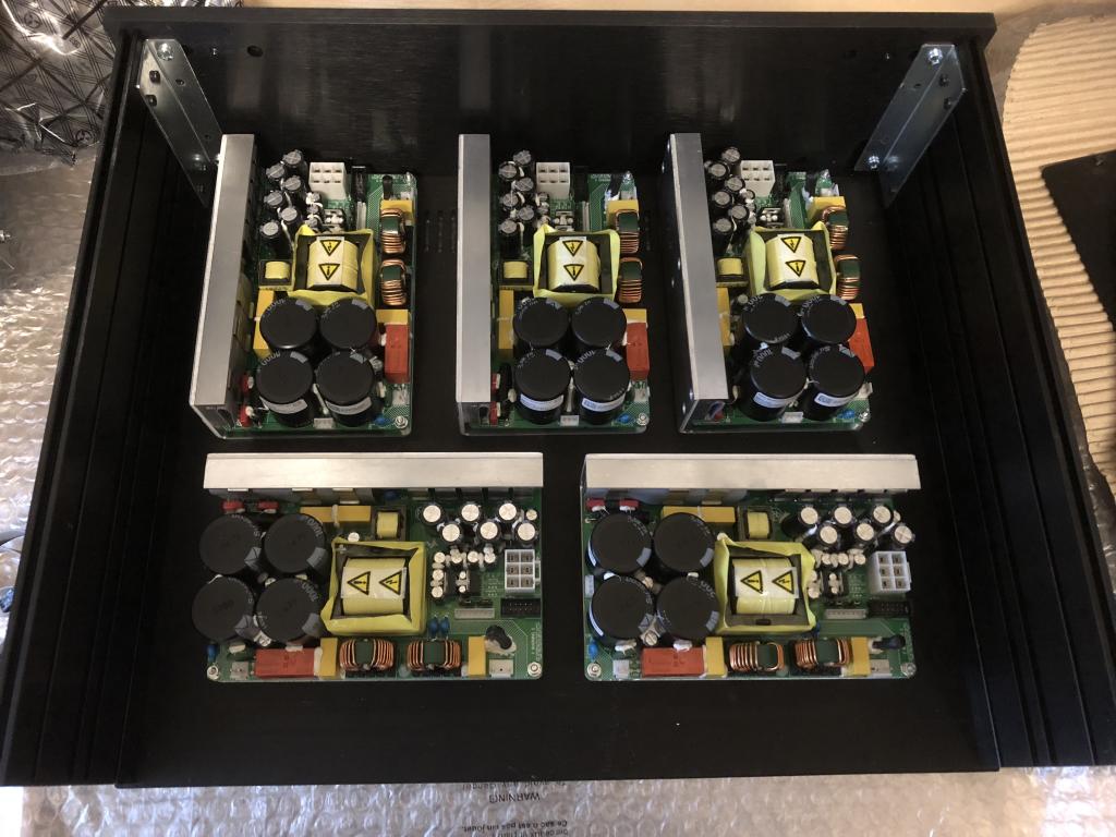

          After some more thinking I’m back to the first layout, but without the bottom.
          I think I will mount the smps’ directly to the base. Time to start modelling some mounts for the
          Nc500 and the converter boards...
