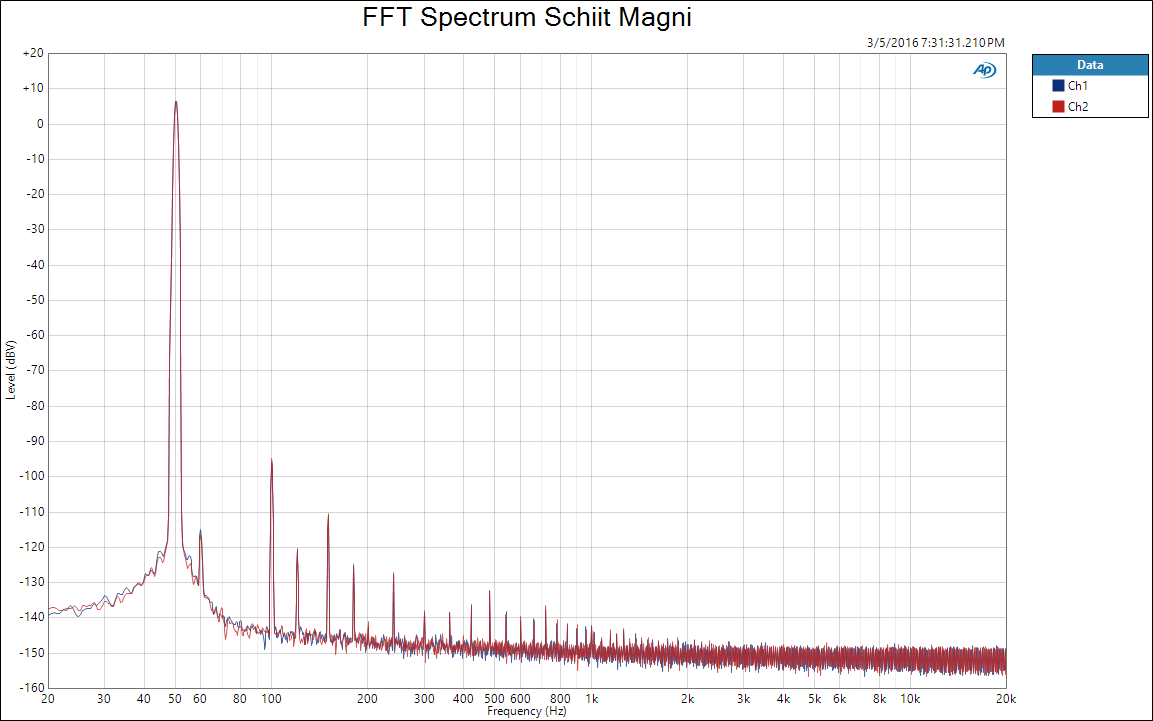

    A few more tests, which uncover some interesting things...

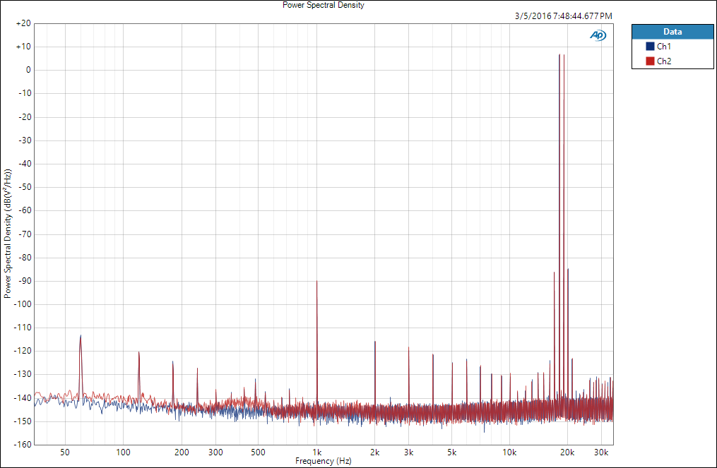

    First, a 50 Hz FFT at +6 dB output- this shows a mix of harmonics of the test signal (50Hz) and power supply residual noise... (60Hz related)

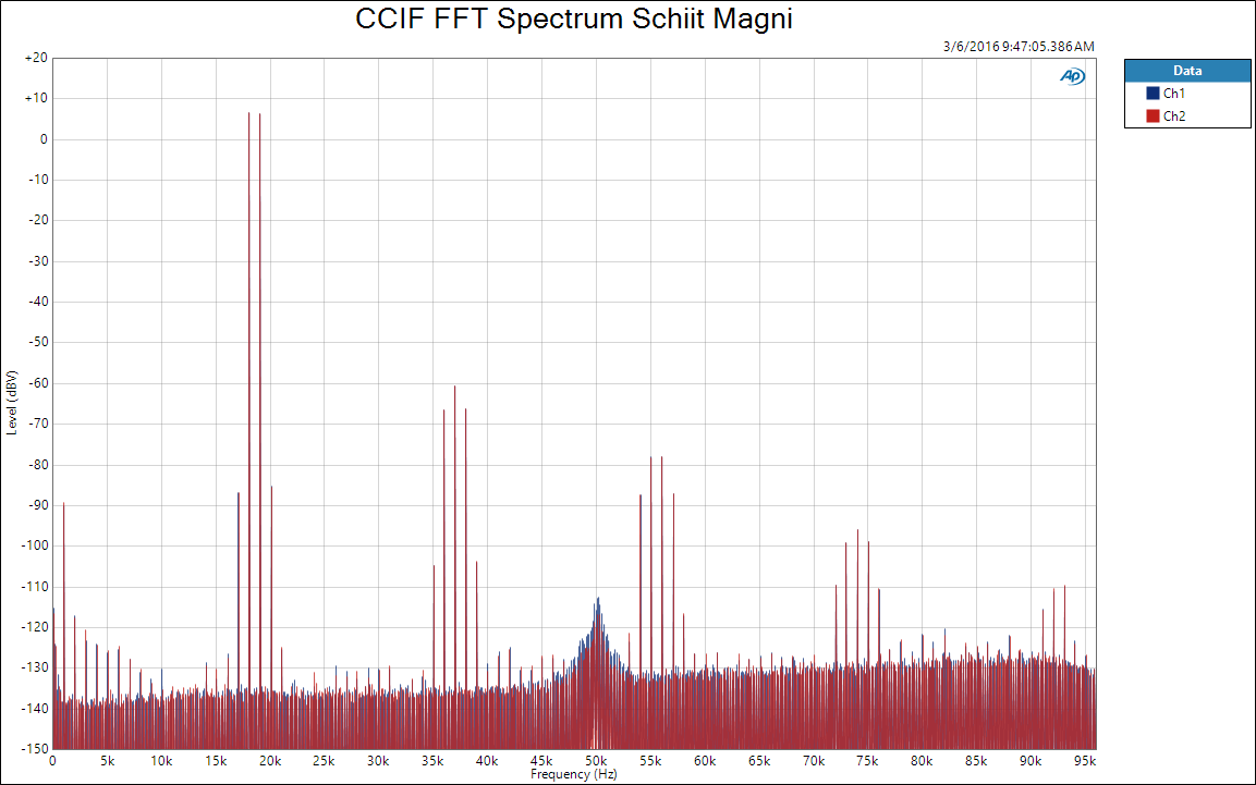

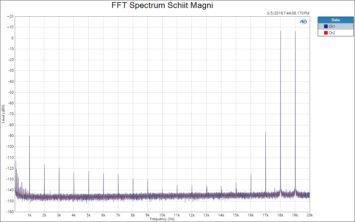

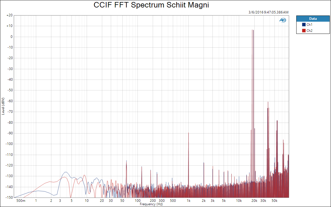

    A test I like which is fairly demanding but not unreasonably so, is the CCIF two tone HF IM test; here we have 18 and 19 kHz, though often 19 and 20kHz are used.
    In fairness, components below -90 dB are likely inaudible for the most part, at least not readily identifiable by most listeners. Usually this CCIF IM test is done with a linear scale like this, to make it easier to identify frequency components. It also shows IM sidebands above the test signal range, too.

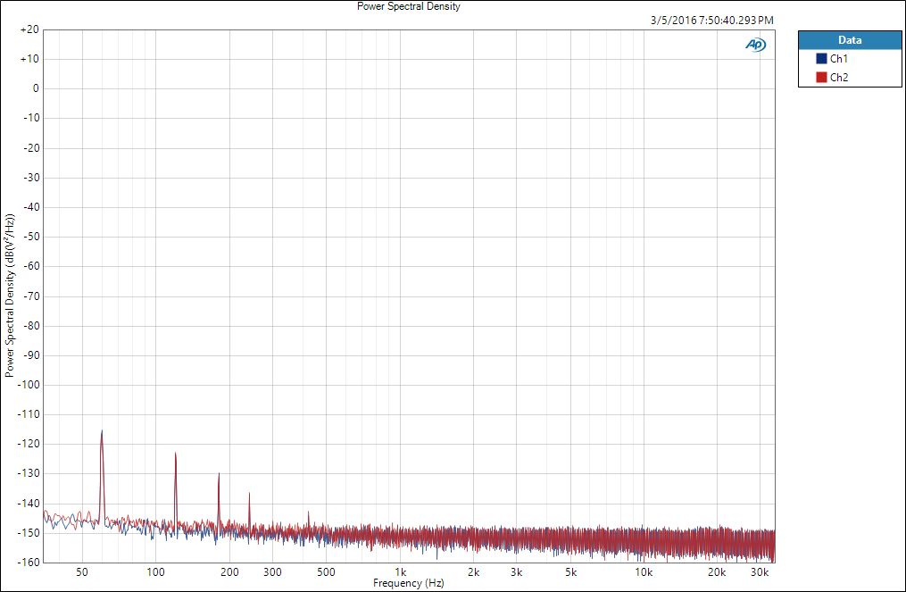

    It can also be plotted on the log scale, which gives more low frequency information, and may reveal power supply issues in an amplifier.
    Here the difference tone at 1 kHz is quite evident, but remember, it's -90 dB. The overall circuit does not appear to be a typical op amp though, the residual noise floor is very low, better than I would expect.
    In fact, this last graph is just that- input signal turned off and volume turned down on the headphone amplifier.
    This is a quiet little amplifier- you can see DACs with a noise floor 30 dB higher than this, for an SACD player, such as the Playback Designs model 210.

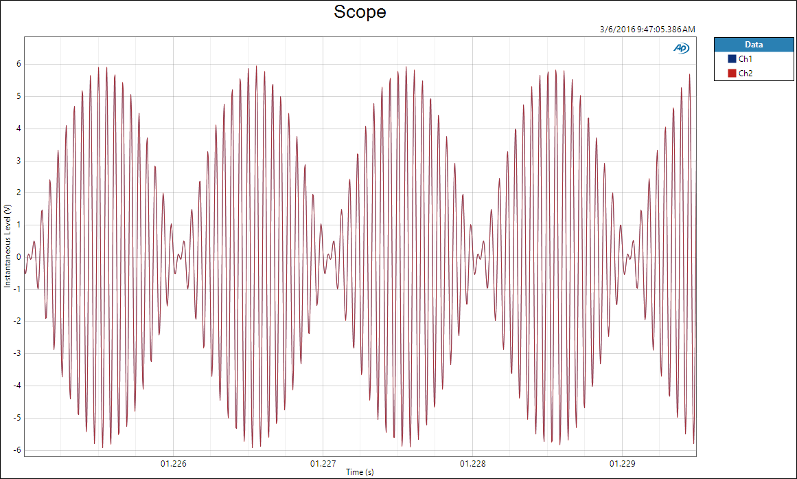

        OK, some updates and further comments about how one should be careful and look at the big picture...
        First, I'd like to show you the scope monitor of the test signal output- may give you some appreciation for why mixing 18+19kHz or 19+20kHz at high level is something of a stone cold b*tch... you get a beat frequency output that has a peak level as much as 2x the individual signals, and 2x the dV/dt, too.

        Now, we're going to go back and look at that log frequency FFT display, with only one sweep, so there's no noise averaging - this still is a pretty solid performer. This time we're displaying out to the FFT analyzer window, not just to 20kHz.

        Now, we can see that in addition to the difference frequency IM down at 1 kHz, but at -90dB, there are also some high frequency clusters garbaging things up- but with this log x axis, its hard to tell exactly where they're located. So let's redo that with a linear x axis-

        Now it's pretty easy to see that those secondary IM side band clusters are falling at nice integer multiples of the test frequencies- 2x, 3x, 4x, and 5x. The 2x one is of more concern to me- though the frequency itself is nominally inaudible, this is a lot like an image rejection issue with a CD player- that's falling in a band where a tweeter may have pronounced breakup resonance, and that can drive IM further down in the tweeter itself, due to the physical interaction. And in this case it's only at -60dB. That's actually the highest distortion product we've seen now, testing this little headphone amp. Ah, but maybe that's just it- it's a headphone amp, not a preamp. Will not likely see any kind of tweeter- though some headphones have them! :W

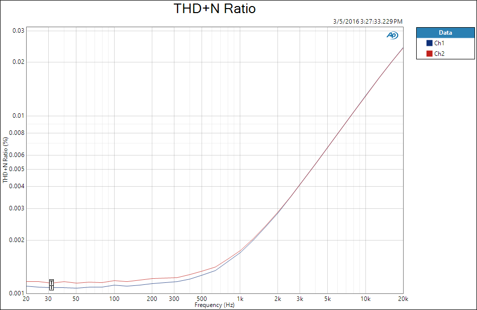

        OTOH, this relatively high level high frequency IM shouldn't be a surprise, given the trend we saw with the swept frequency distortion measurement earlier.

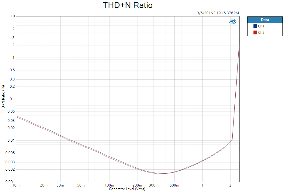

        The FFT is very, very useful, if employed with some flexibility and discrimination- while the level based distortion sweep does tell us something about overall trends, as it lumps thermal noise, power supply noise, and distortion all together, it's not very diagnostic in a detailed sense.

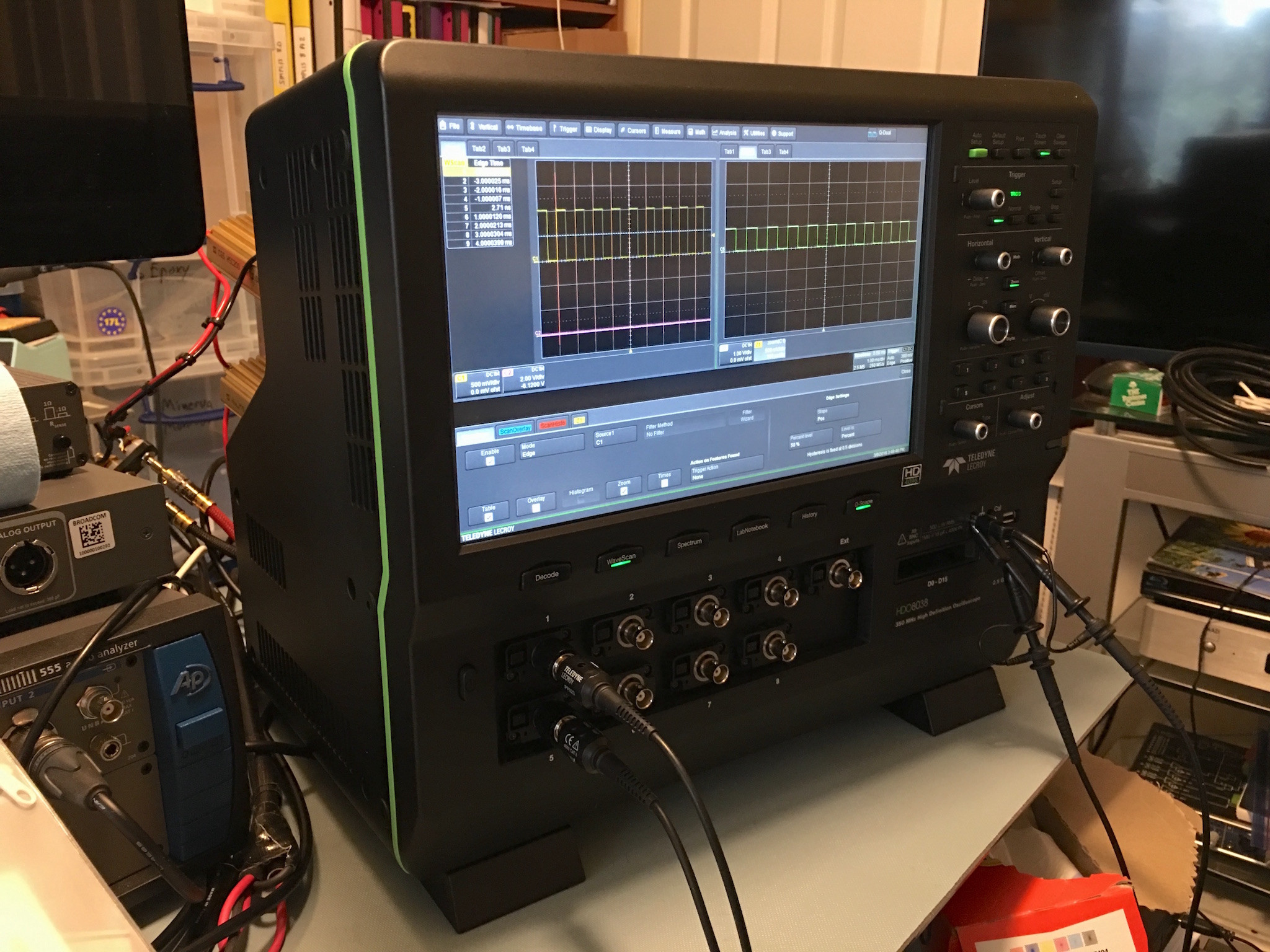

                    One of the few portable Windows 7 Professional PC's you can still buy runs 4K out
                    And it has a green racing stripe! (modern oscilloscopes are PC's at their heart- this is a big one- about twice as heavy as my 4 channel LeCroy, and can drive a 4K external monitor).
                    UPS delivered today- it's maddening that I'm so busy with other work things and getting ready for my trip to Munich that I don't have time to do anything with this beyond taking a few pictures.
