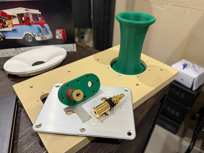

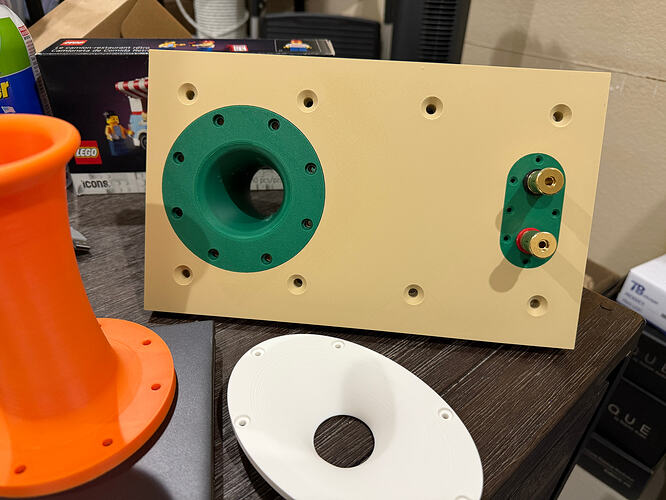

                        • 1535
                        A super minor update since this did not take long to print. I have several pairs of these binding posts for some reason. Must have been a sale a while back. I don’t care for them since the gold finish kind of looks bad for the price, but they are the largest post of any that I have (~3/8") so I sort of designed the plate around them. Conveniently, they are also designed for a metal plate that has all the dimensions shown that I needed.
                        I was set to use M3 screws to hold this on the rear but the holes printed a little on the small side so I need to widen them a hair. On the other hand, the plate itself is very tight to the rear so I think I might loosen that up a bit. It’s only barely removable at this point…unless I put it in backwards, which would then match the finish of the port. Might need to think about that.
                        IMG_0878
                        IMG_0880
                        Edit: I’m rethinking the lack of chamfer on the back. I think it kind of looks ‘off’ since the bolt holes are spaced so far in. This matches the front though, so adding a chamfer might make that look better. It’d need to be pretty steep though since the port is pretty high.
