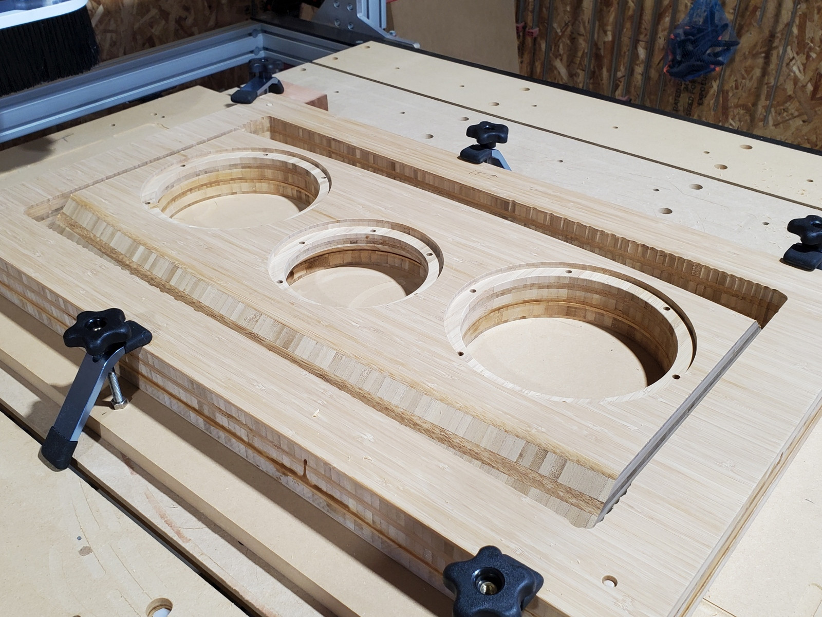

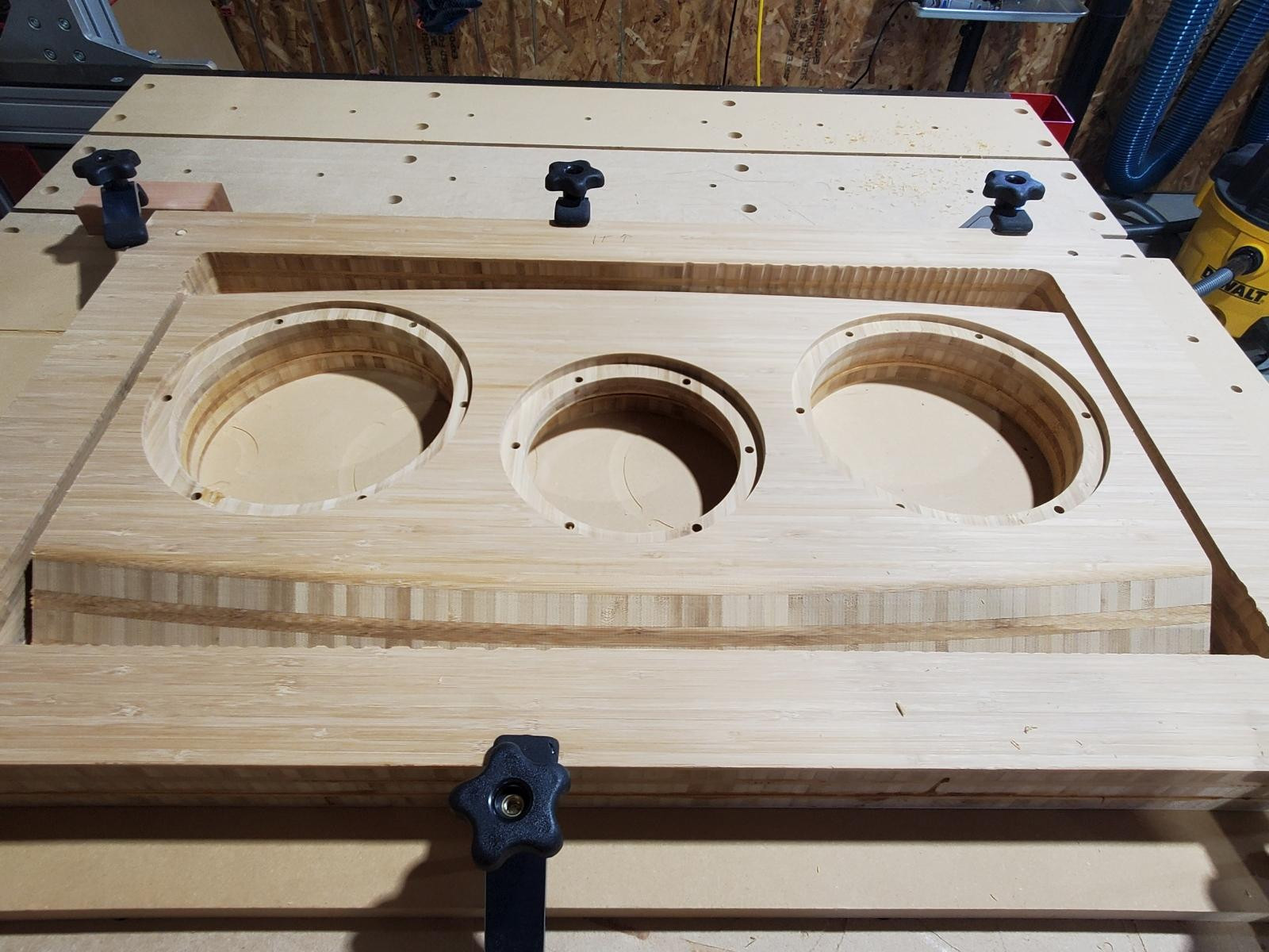

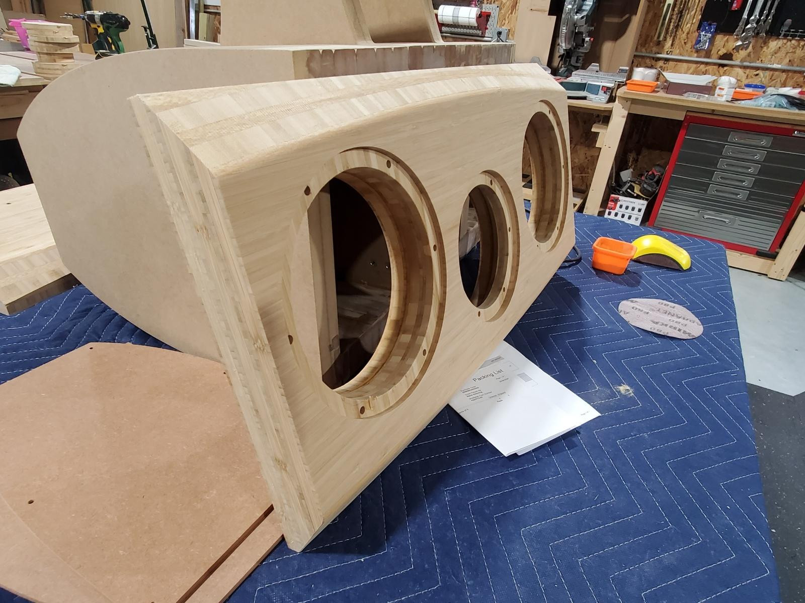

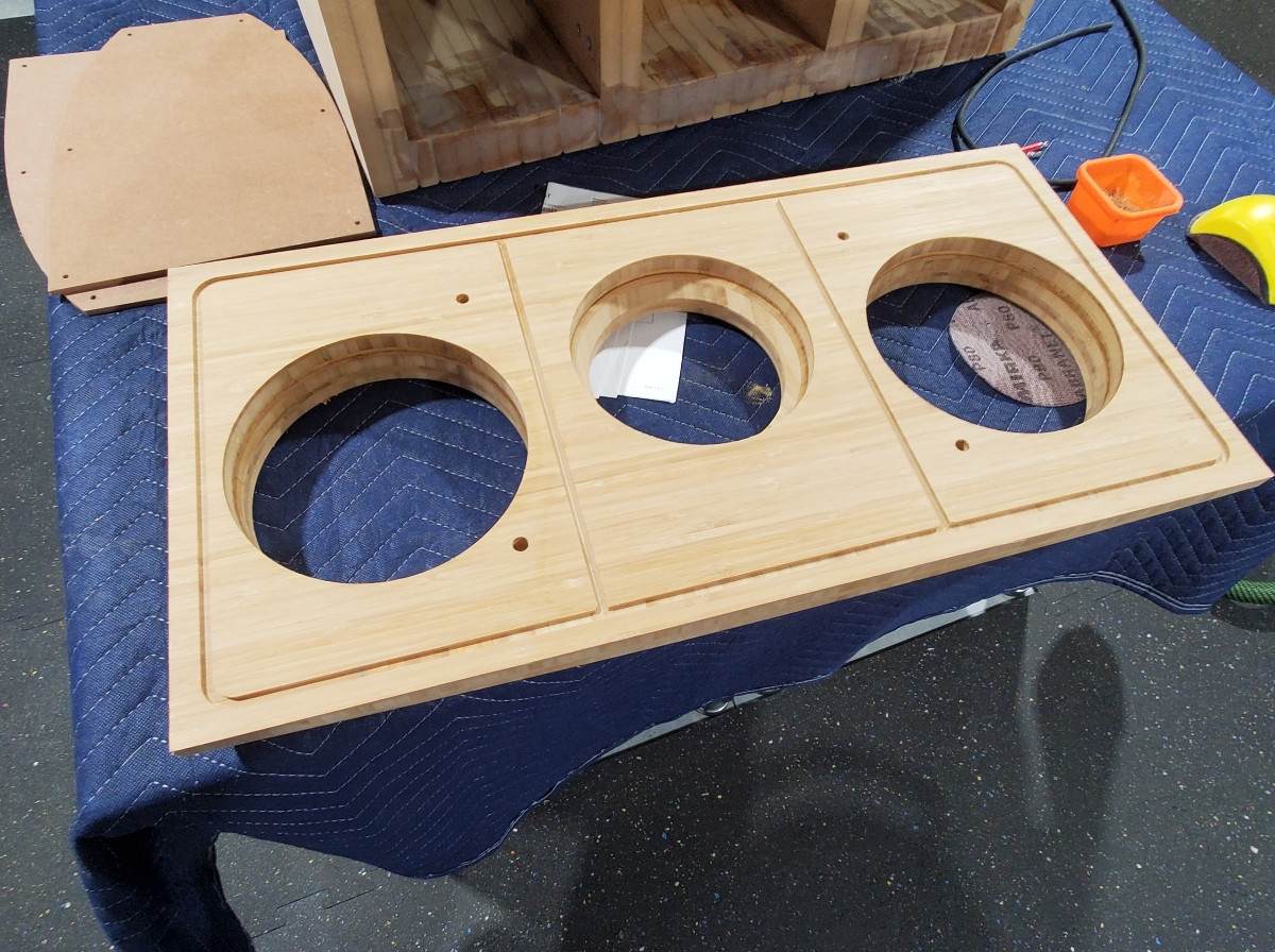

        Progress continued today and I was able to finish the machining of the baffle.
        Click image for larger version  Name:	12.jpg Views:	0 Size:	498.2 KB ID:	953279
        Click image for larger version  Name:	13.jpg Views:	0 Size:	346.2 KB ID:	953280
        Click image for larger version  Name:	7.jpg Views:	0 Size:	385.2 KB ID:	953281
        Click image for larger version  Name:	6.jpg Views:	0 Size:	366.2 KB ID:	953282
        Some rough sanding and threaded inserts are next on the agenda.

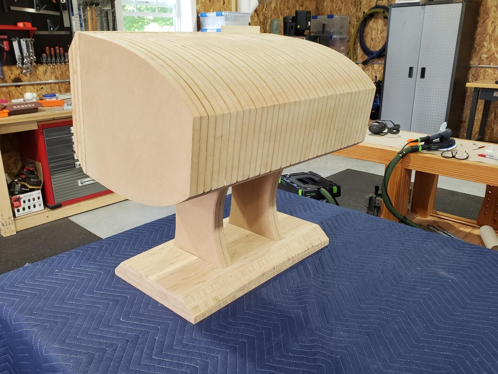

                As Jon is fond of saying about slow work taking time, some progress is being made.
                All the major parts are fabricated and initial fit up done.

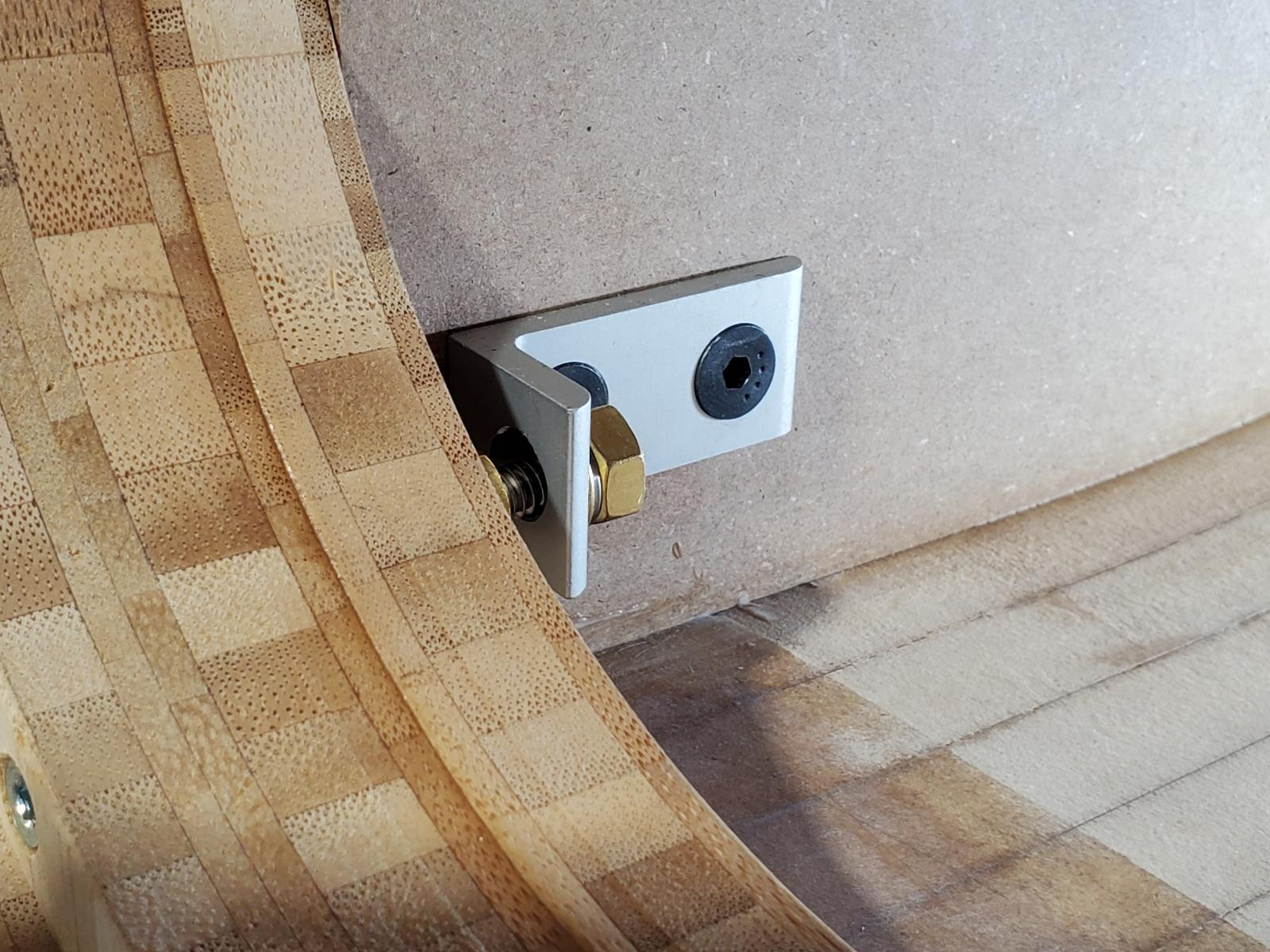

                This is one of 4 brackets that hold the baffle in place.

                  Some tweaking of the baffle needed to be done to get things aligned a little better. Then drivers were installed to check fit. These pictures are rather deceptive ..... those woofers are 8.7" in diameter!

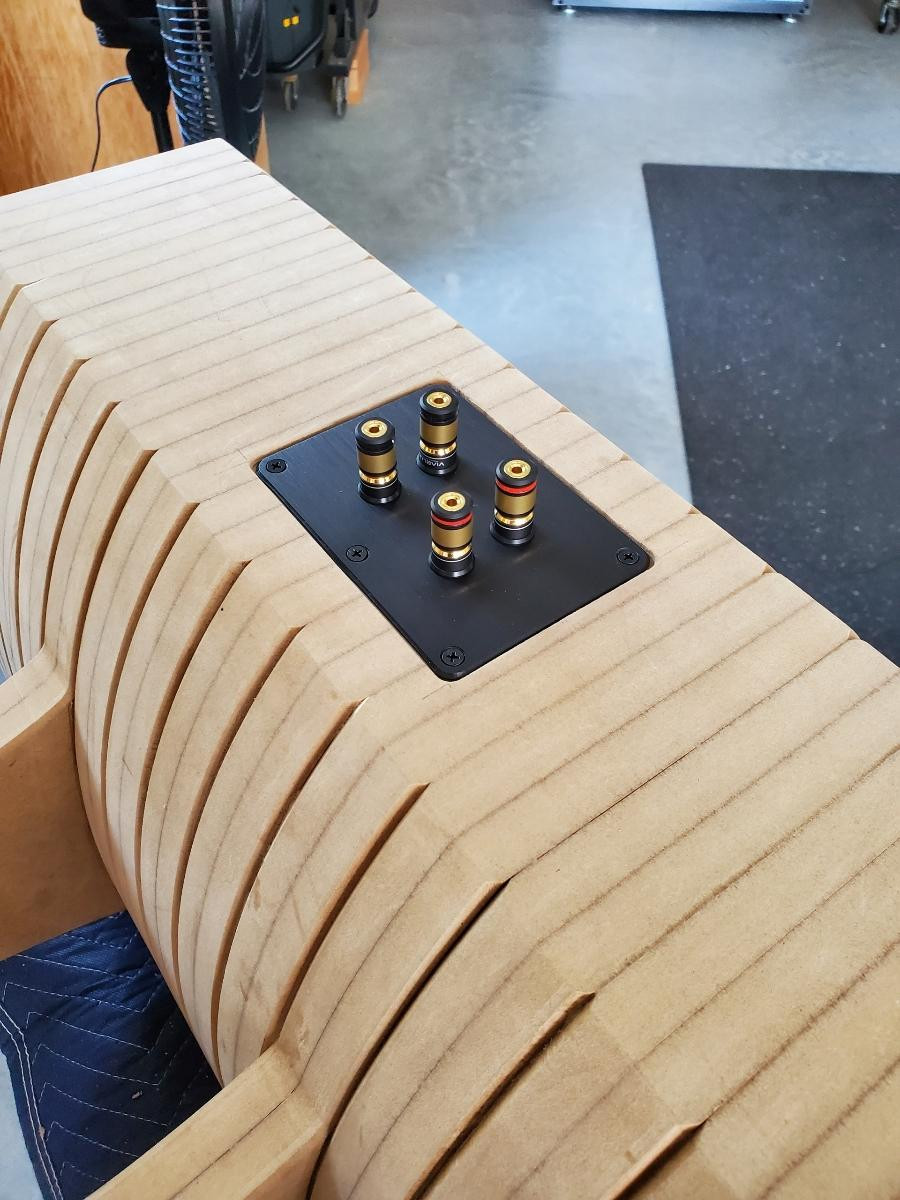

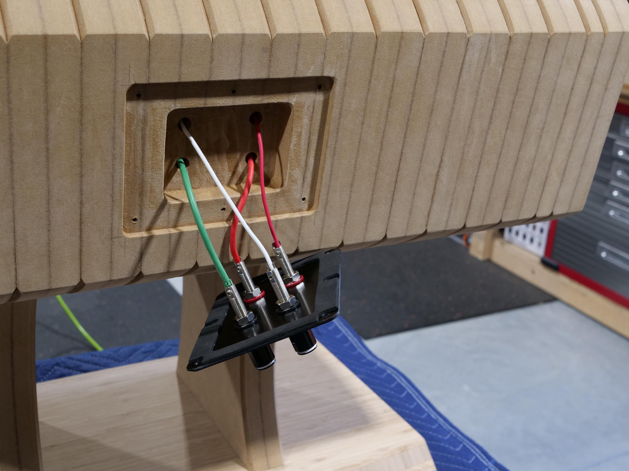

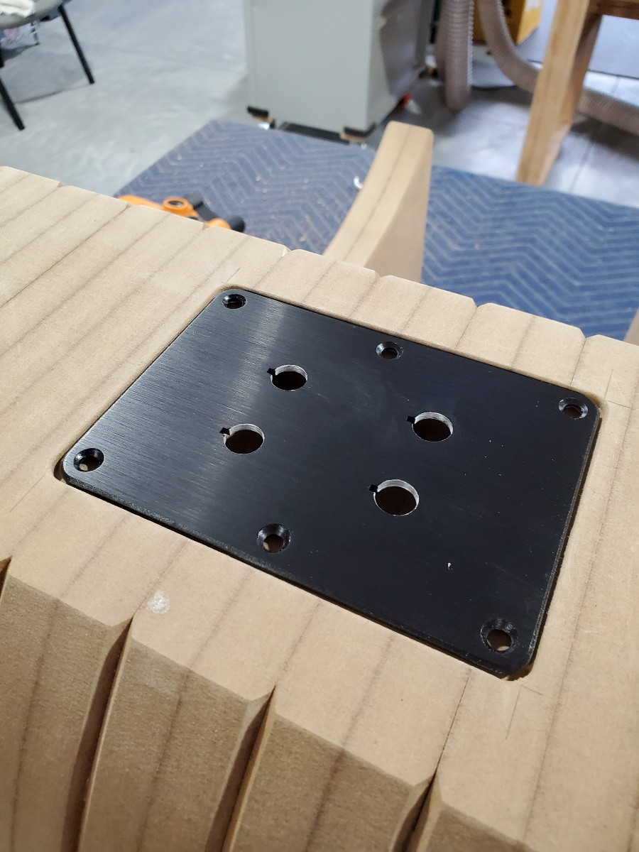

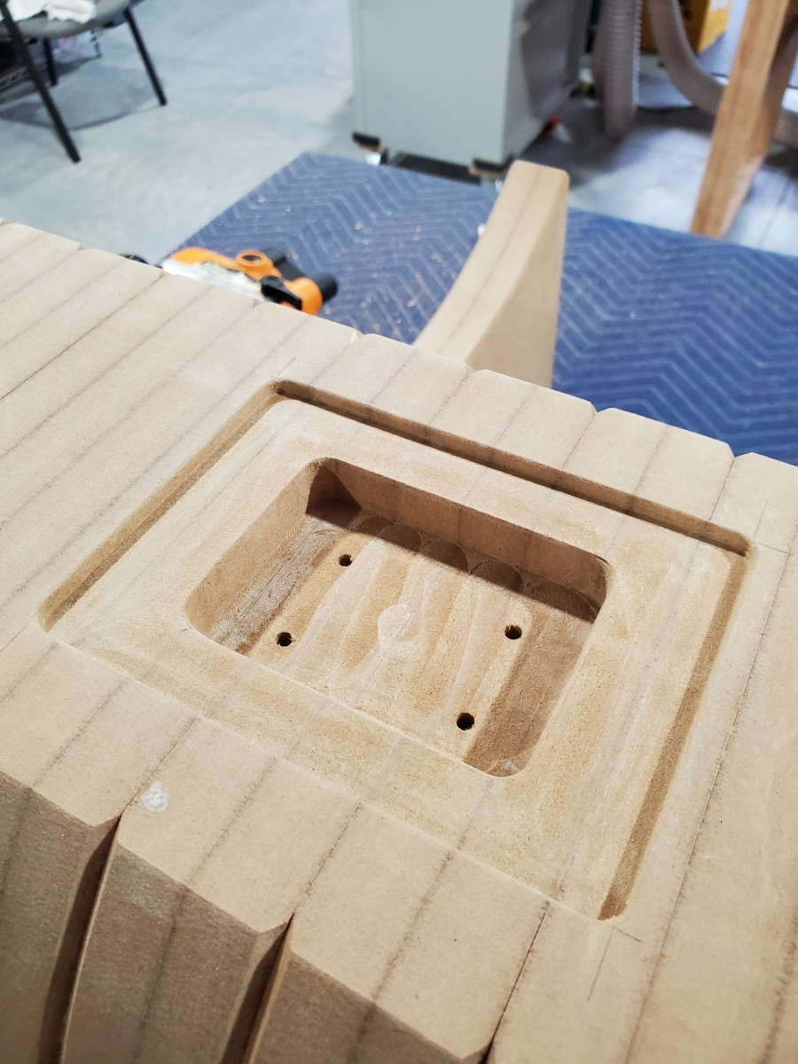

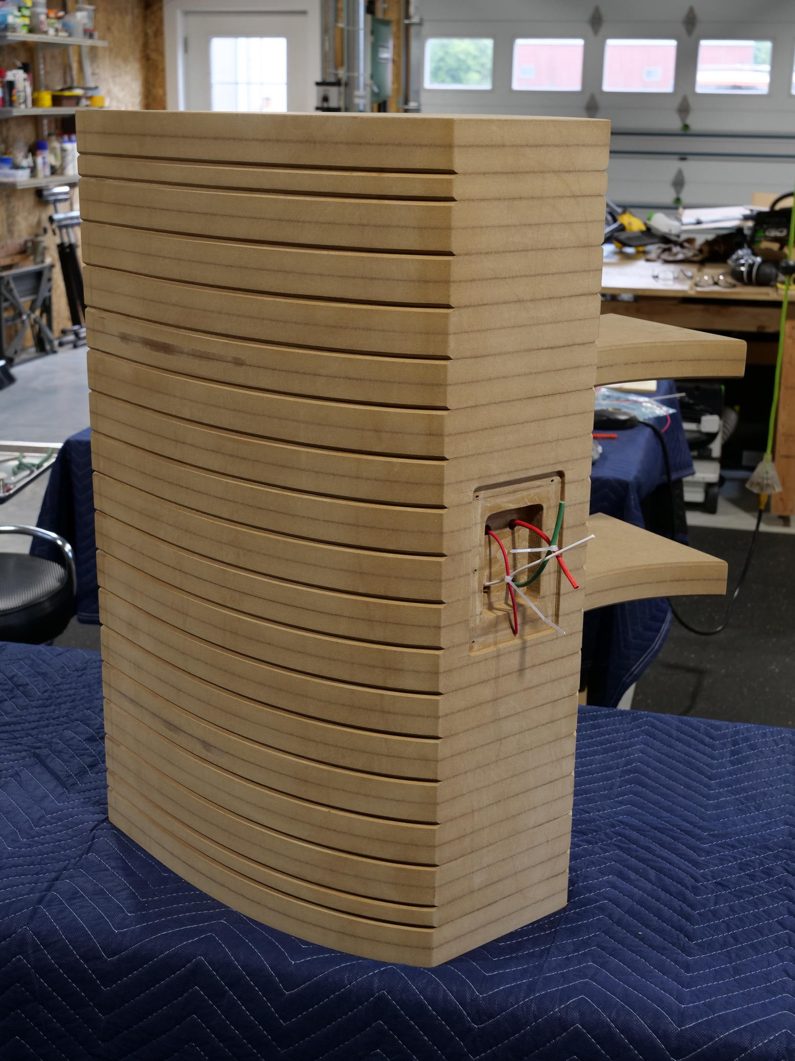

                        A quick update .... Machined a pocket for the binding post plate.

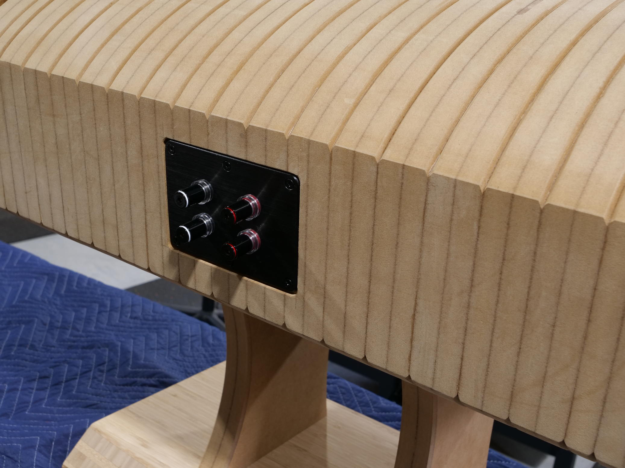

                        Binding posts installed.

                            Those are ViaBlue T6S binding posts. As I recall the Viborg's were out of stock at the time and these prices in between them and something like Cardas.
                            We opted not to go with the spacers on this build and as such just glued the ribs together. The material we had used was a combination of cork and rubber though.

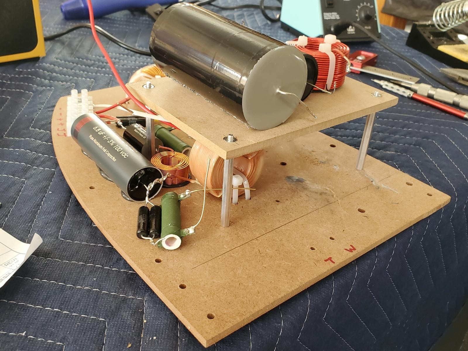

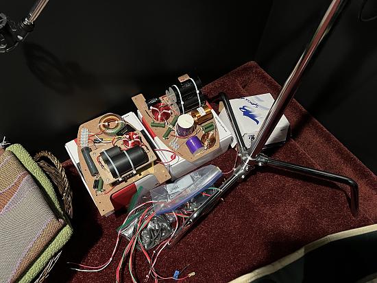

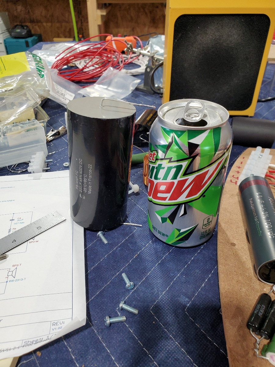

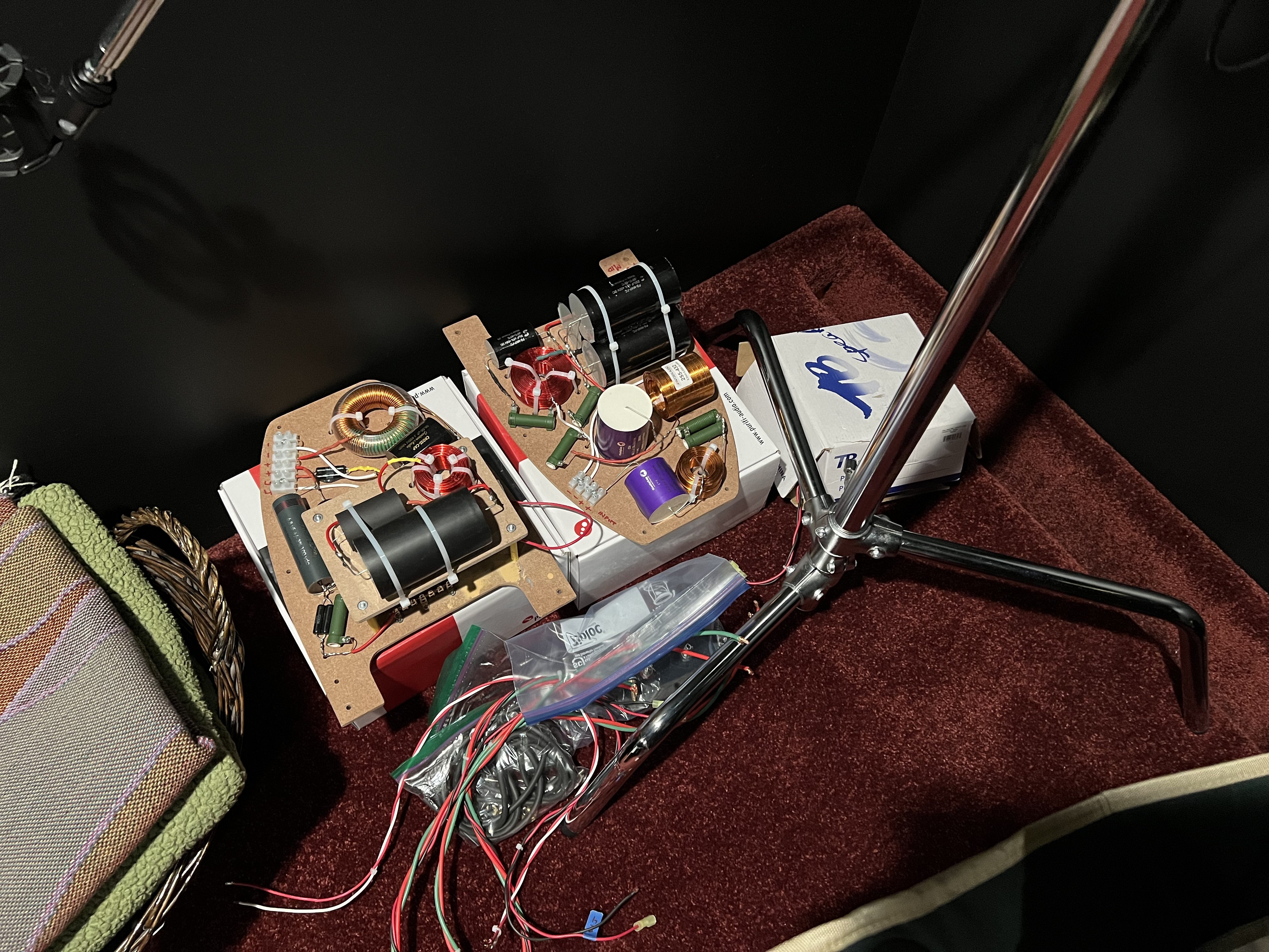

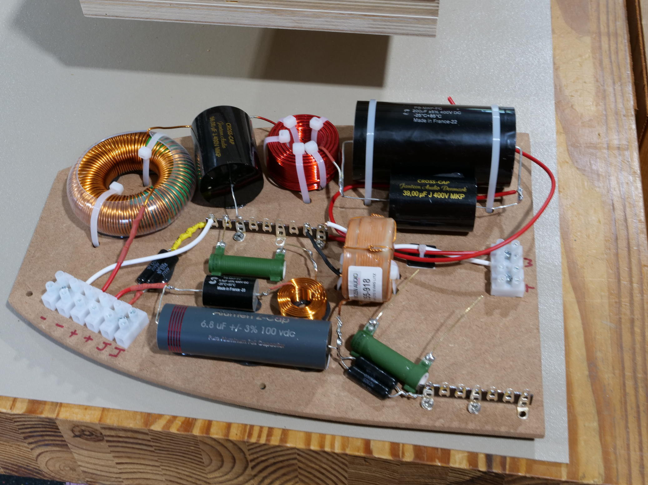

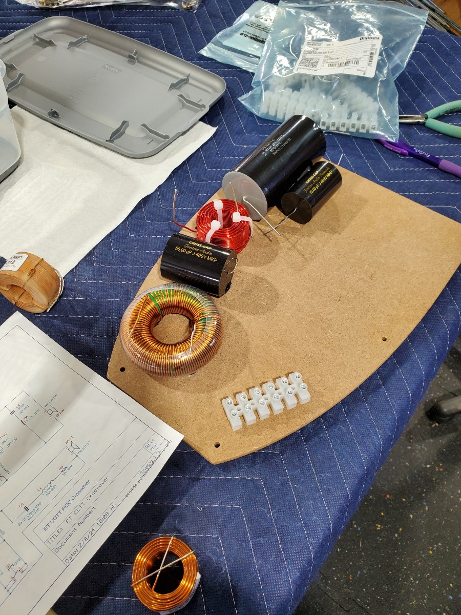

                                Well I had a minor set back on the first crossover board. Of course I'm going to blame it on Jon, he is, after all the one that picked these soda can sized caps!
                                I had just a couple of parts left to place and realized I might have a problem.
                                Said big cap and the woofer magnet were going to compete for the same volume of air. This was confirmed and now the last 2" of the board has become an exclusion zone ..... so modifications have begun. Tis always something!

                                  How much does that cap weigh? I've never seen a cap that huge...
                                  Painter in training
                                    • 16142
                                    Ah, my lad, but you have lead a sheltered life!
                                      JonMarsh commented
                                      Editing a comment
                                      Just a mere 200uF!
                                    • 2136
                                    Those caps weigh in at .7 lbs, not crazy, but since there are 4 of them it adds up.

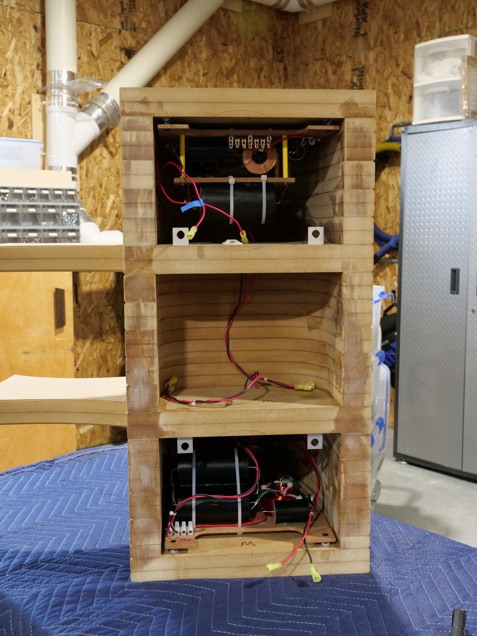

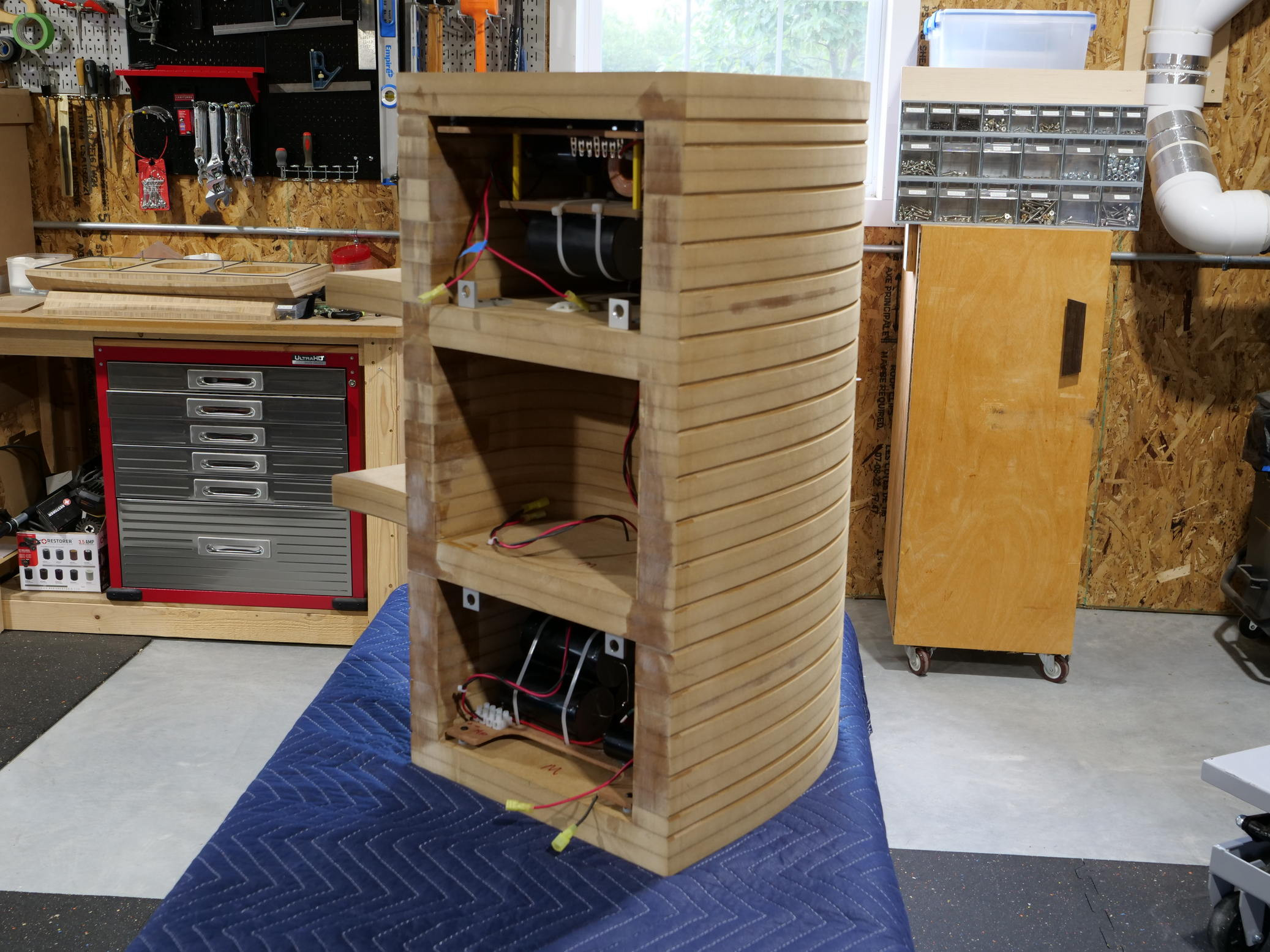

                                      Well life has been it's usual self and throwing many obstacles in the way of my plans. Finally I've gotten back on track, at least for now.
                                      Those not so little caps helped contribute to the obstacle path. What I had planed for securing the boards inside of the cabinet, just didn't work. There was not enough room to reach in and get screws in the required locations. Attempt number two, unfortunately only worked slightly better, but still failed. I ended coming up with a completely different idea than originally planed that worked out nicely.
                                      Boards finally installed and cabinet mostly wired. The top board as pictured is for the tweeter and woofers and the bottom board the midrange.

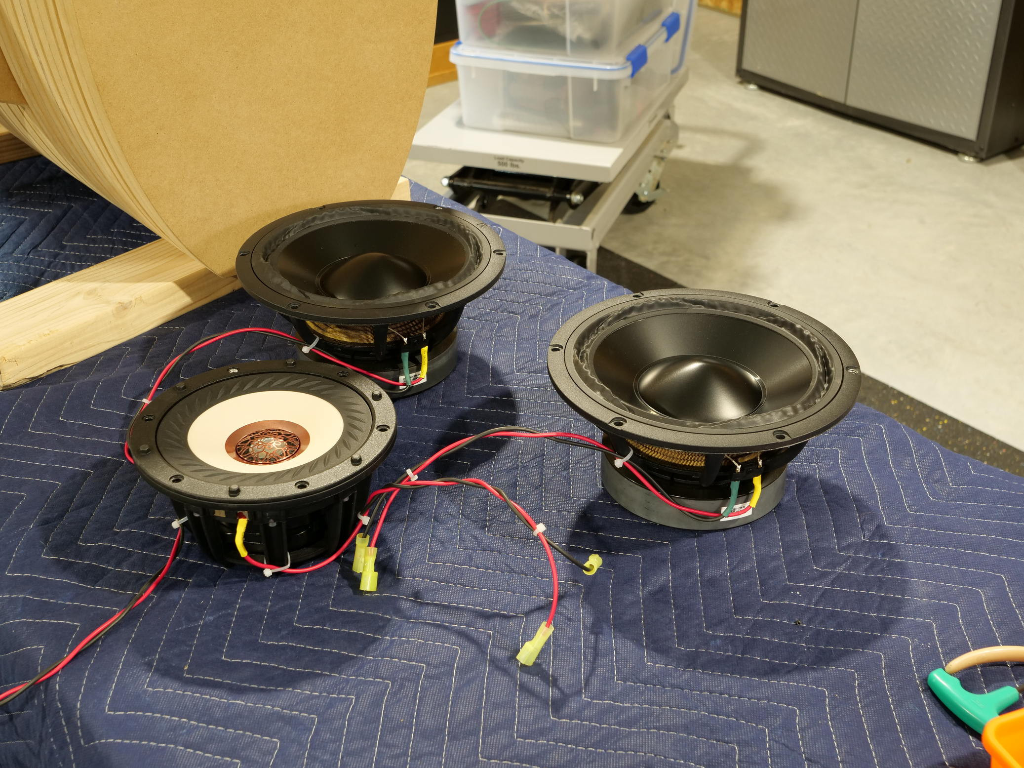

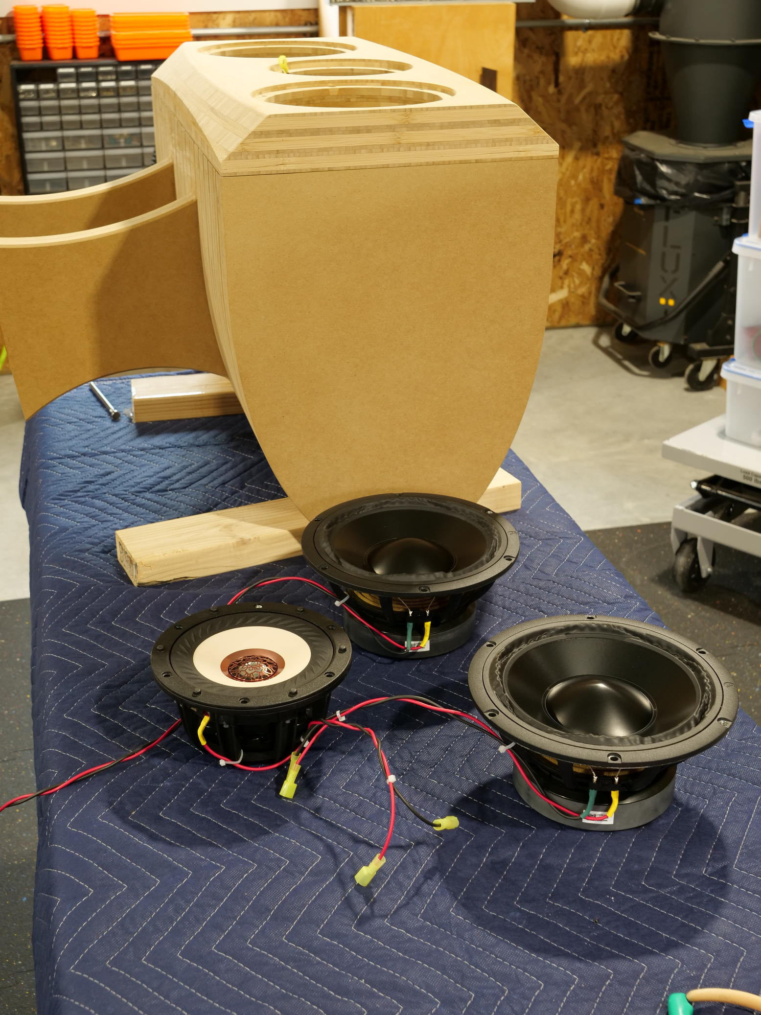

                                      Things moved on to driver prep for installation.

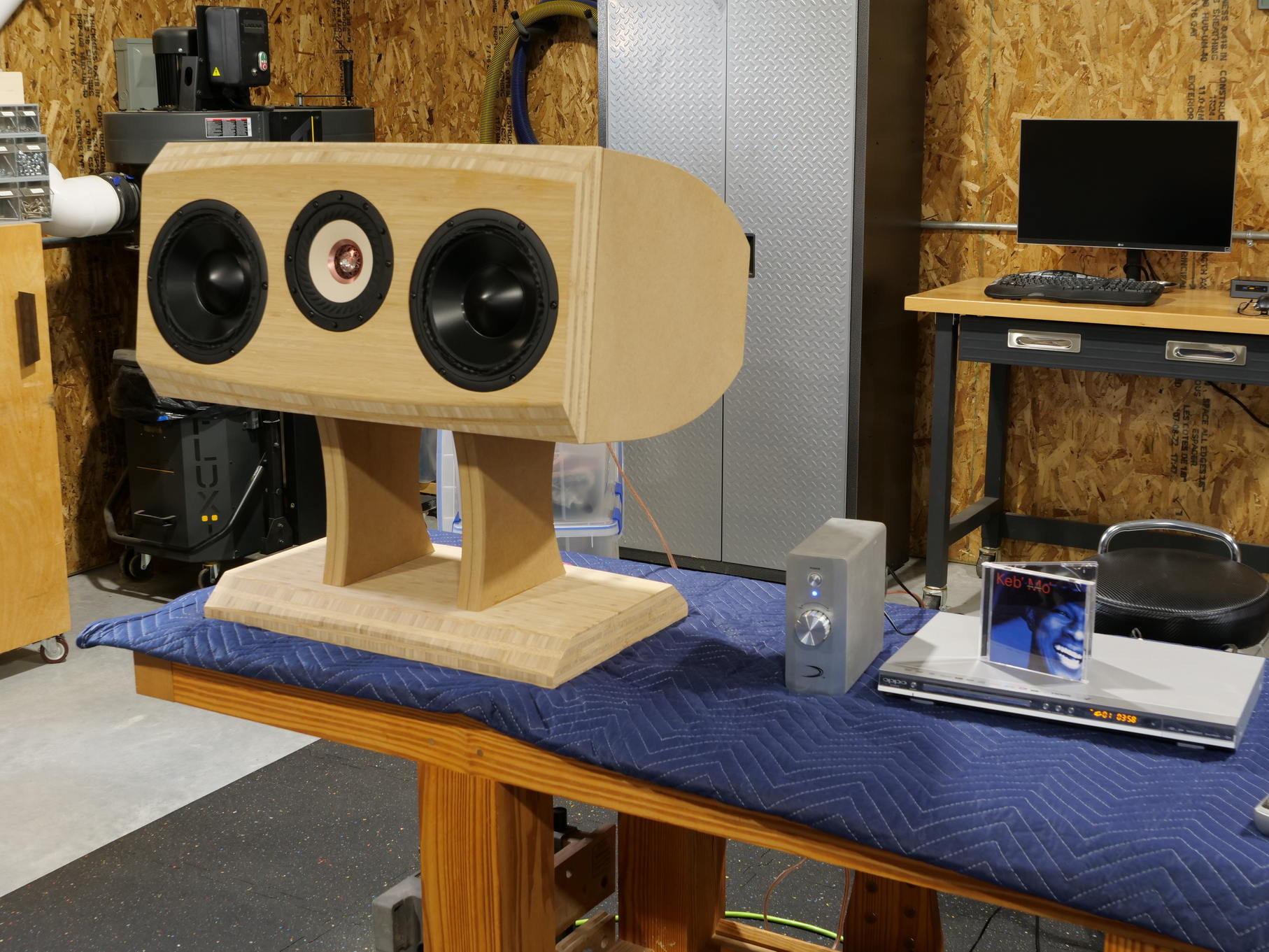

                                      • 2136

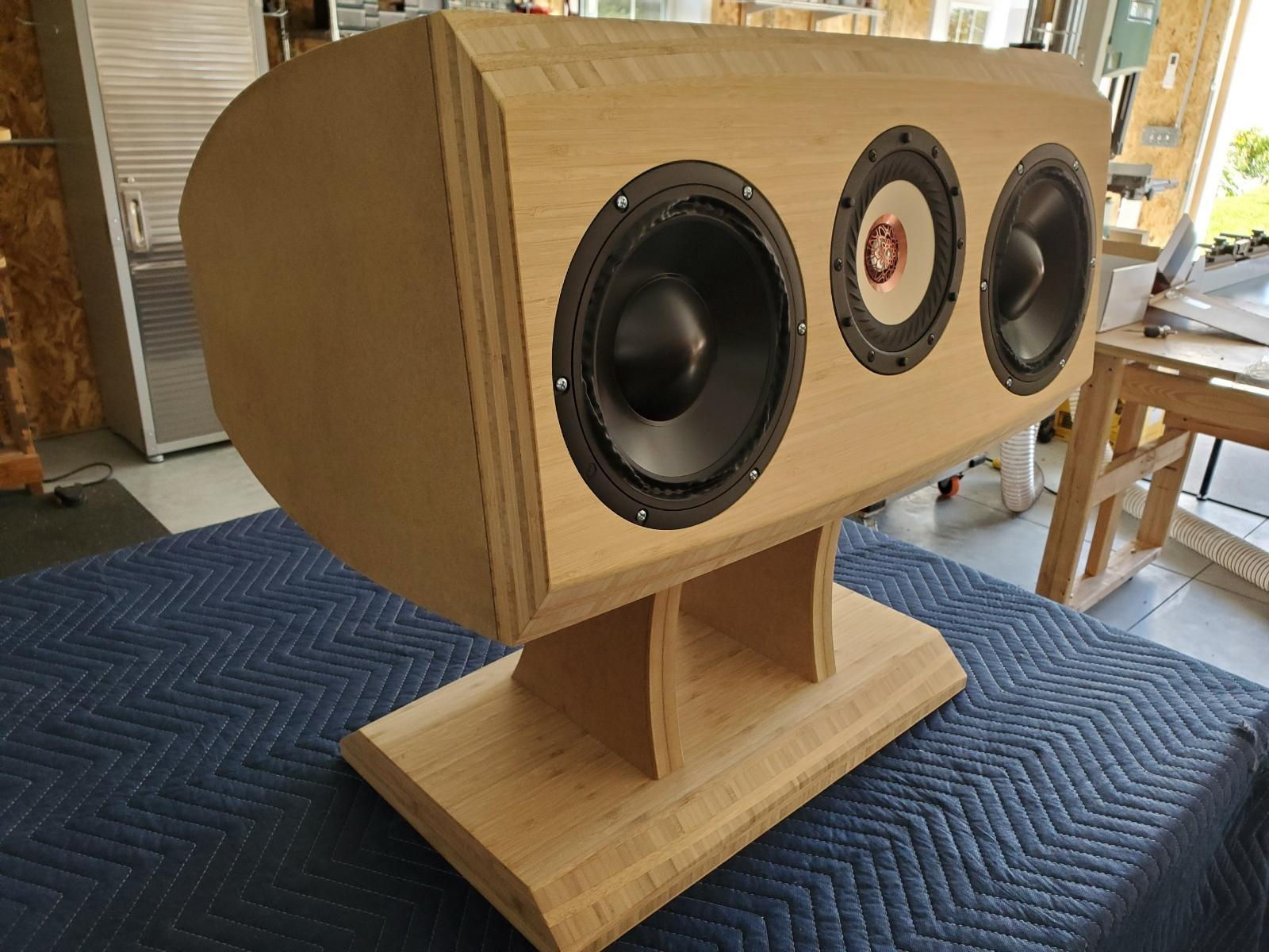

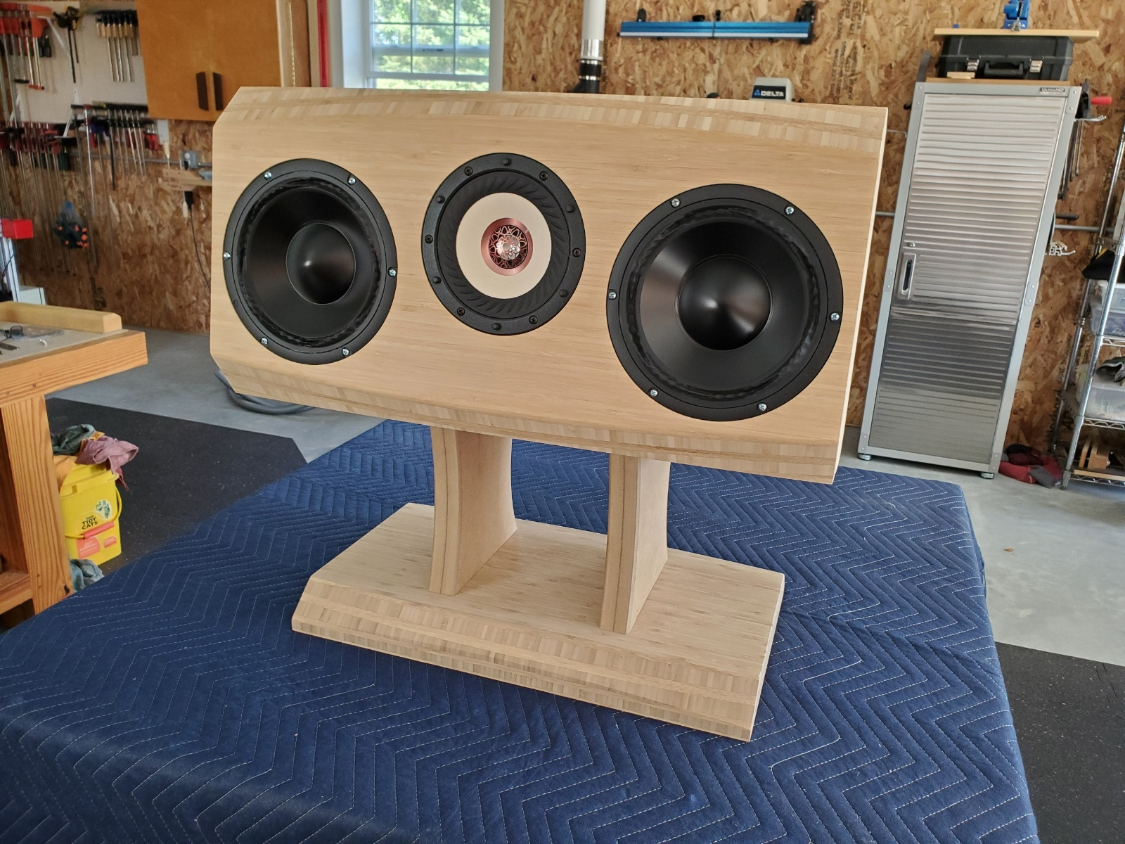

                                      That then left the big question ...... will it make music? An appropriate test disc was selected and fingers crossed .....
                                      Houston we have lift off!
                                      Tag Sven .... your up!

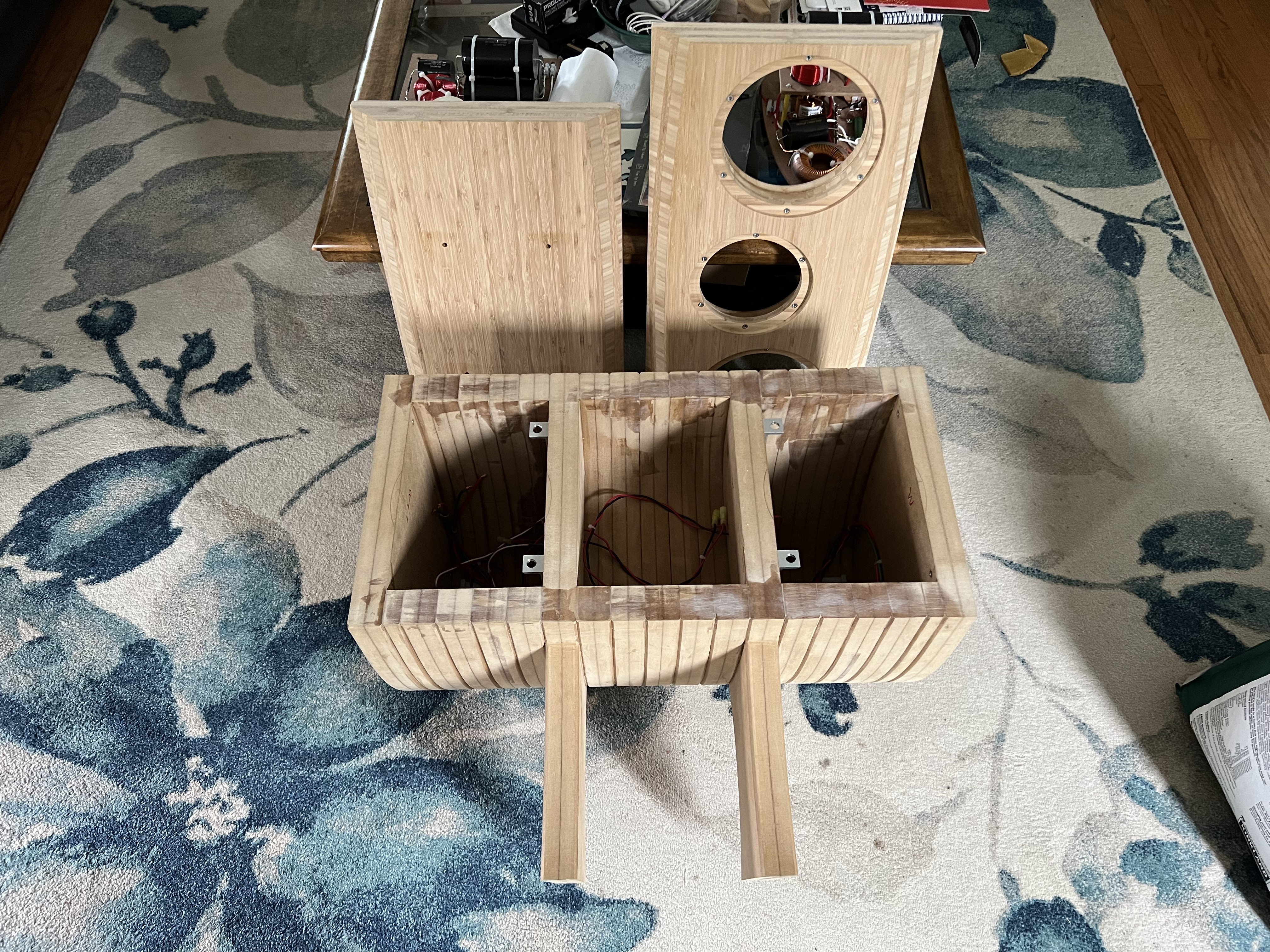

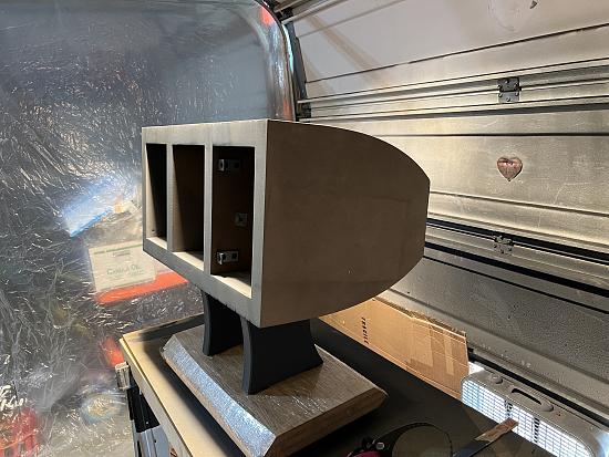

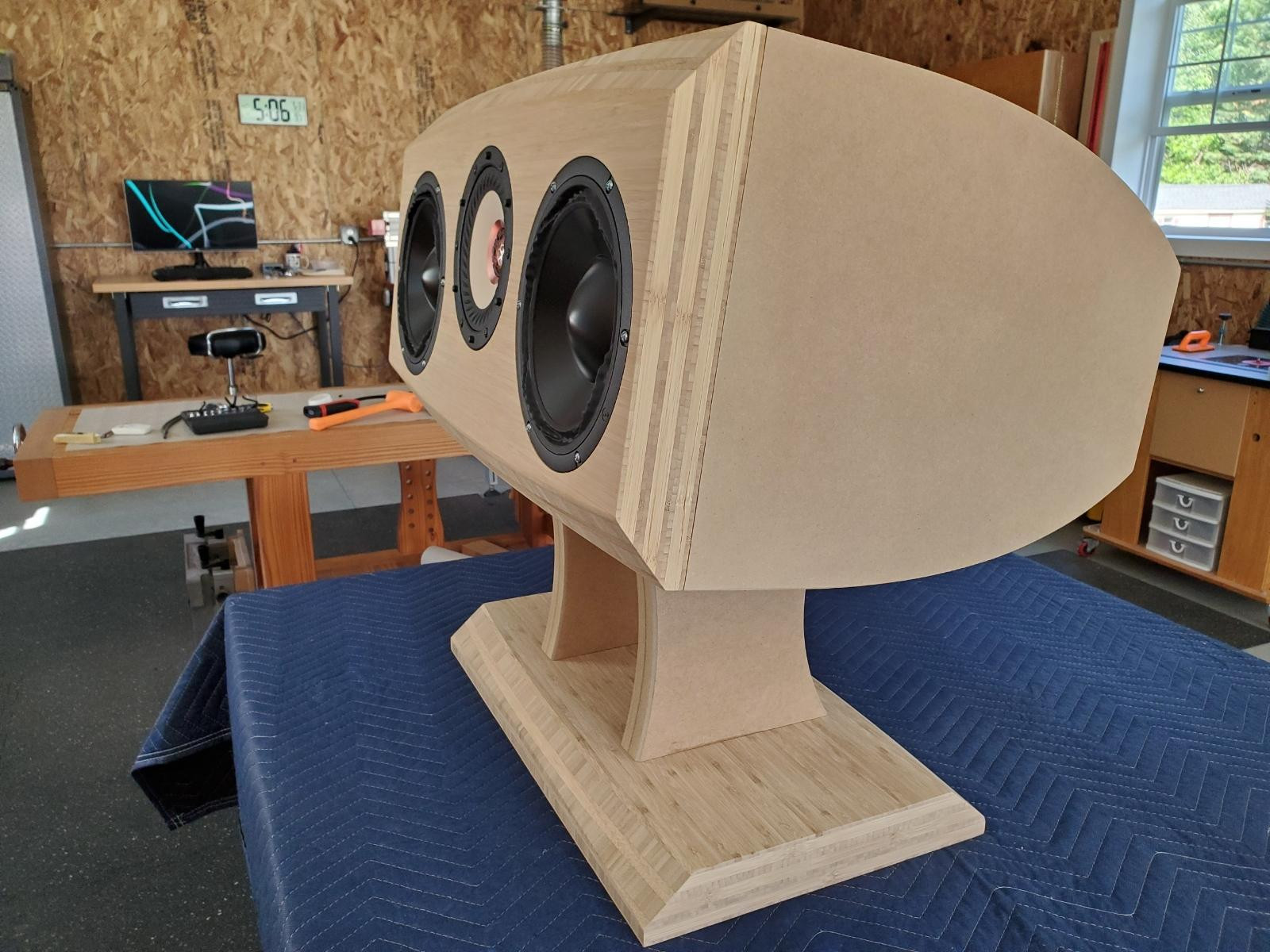

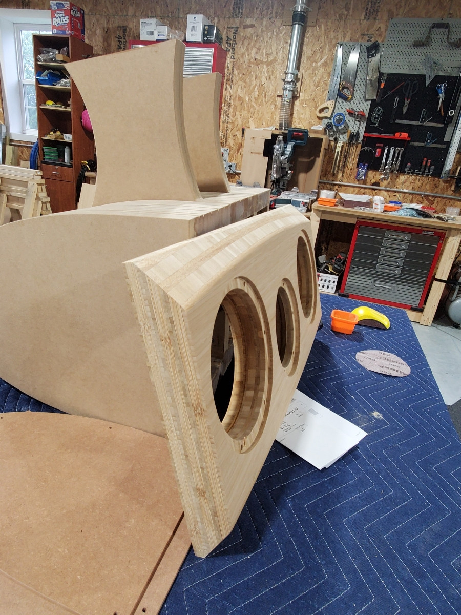

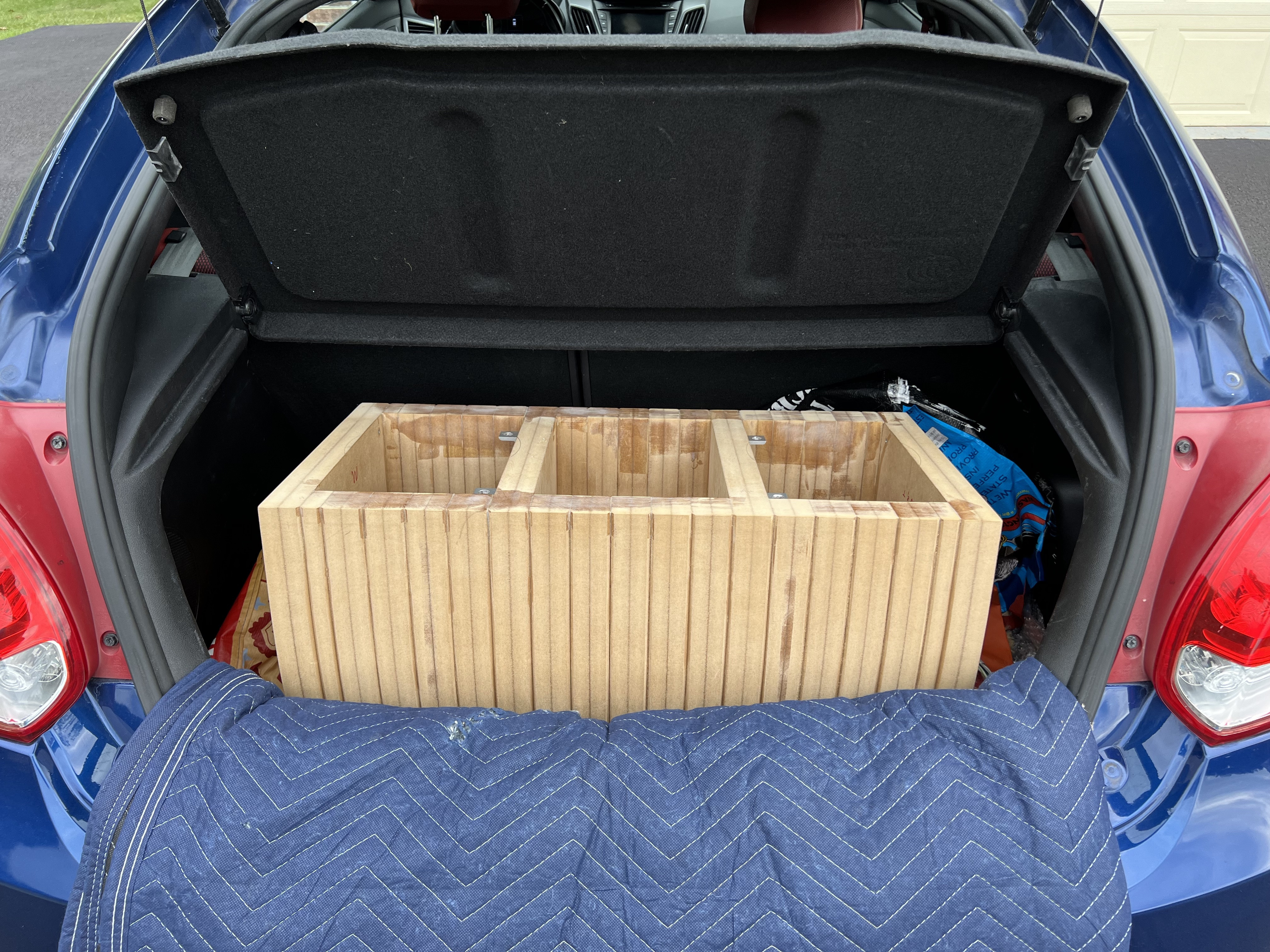

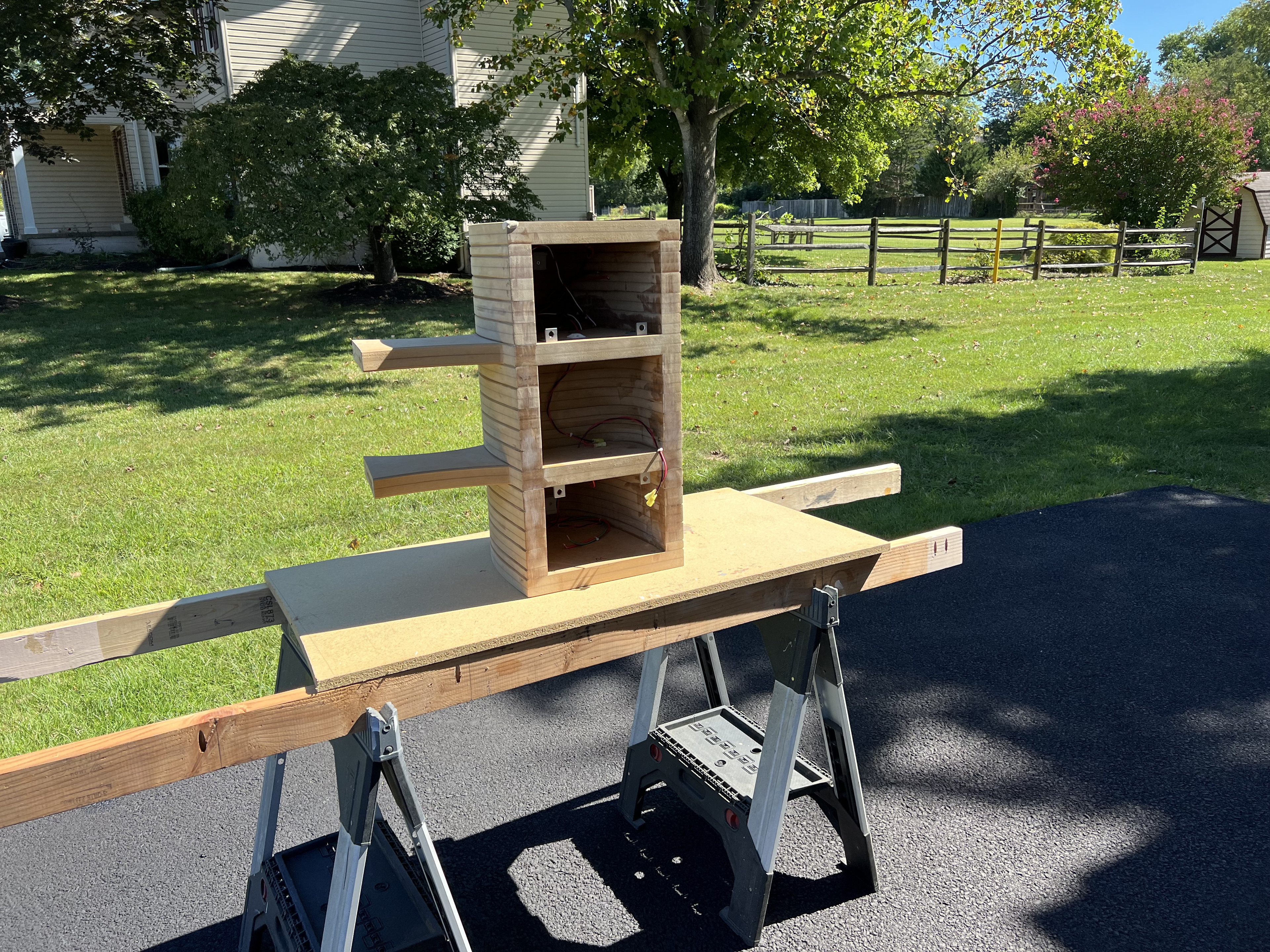

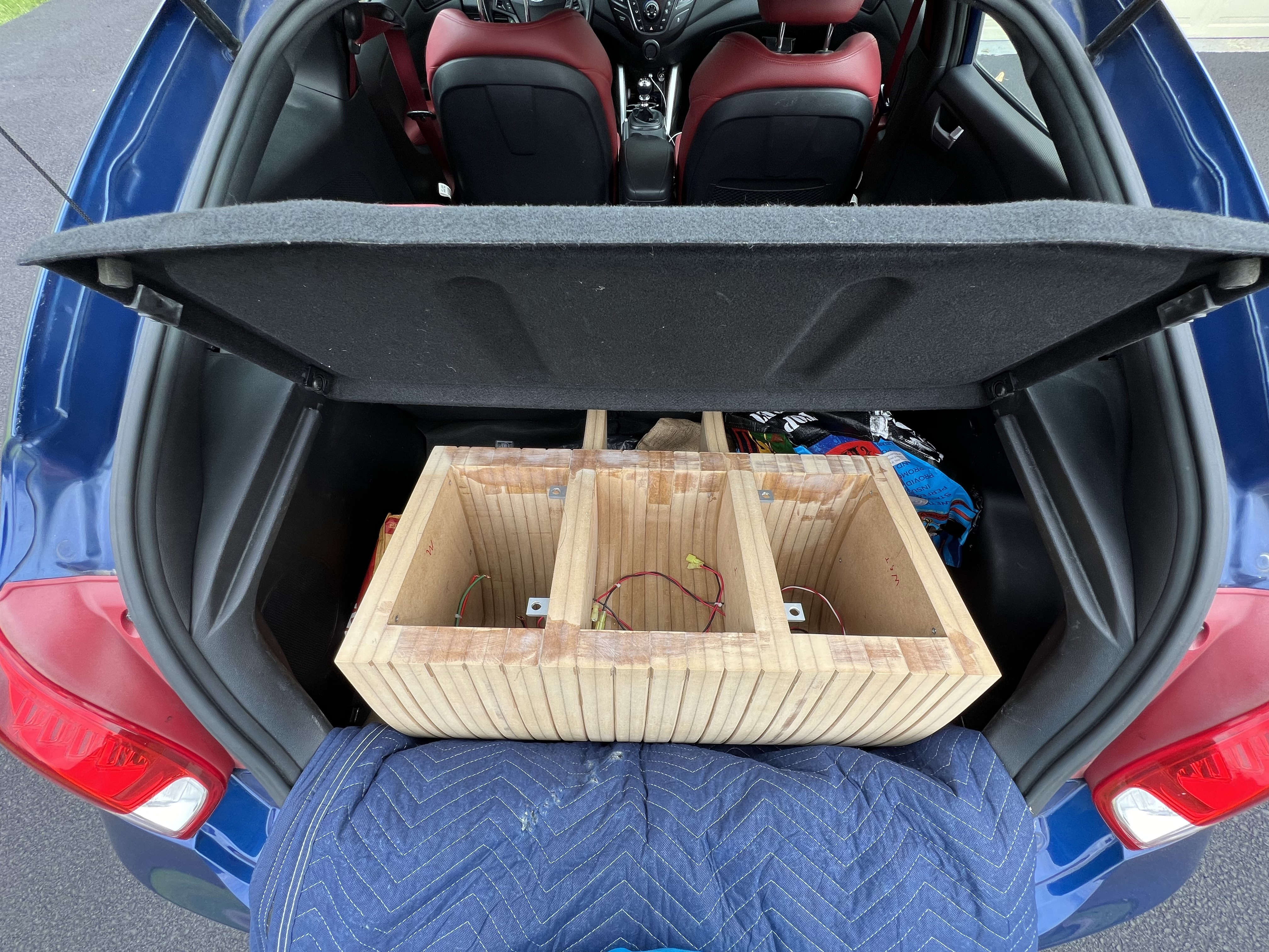

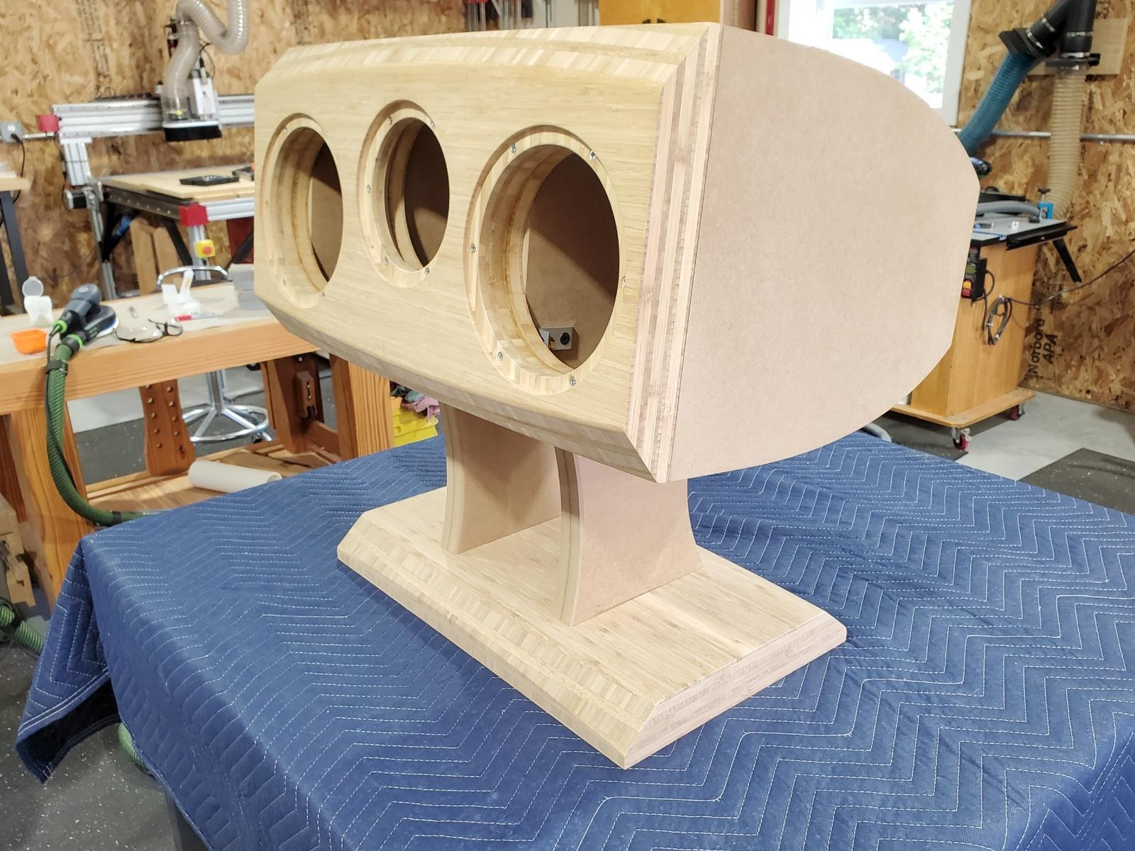

                                                                Problem after problem the last 2 weeks! Flights getting cancelled trying to get back to the Northern VA area, computer hard drive (Samsung NVME SSD) dying unexpectedly, and the wifi router deciding it's had enough of working and wanting to break. After getting the last flight out of town last Friday back to VA I didn't have time to rent a car and drove my little car up to Steve Manning to pickup the CC. I had a great morning/afternoon listening to the speaker and catching up with Steve in person. The last time I saw him was in 2021 I think when I picked up the SMJ Ardent D materials. It had been too long. On the plus side Steve now lives a lot closer than before. It's under a 2 hour drive now vs 3+ hours trying to get down South where he previously lived.
                                                                Anyhow Steve walked me through taking the speaker apart that way I would know how to get this beast back together. When all the pieces are removed from the cabinet I can man handle the moving of it. I just need to remember to be very careful I don't bump into anything while moving it. This is how the cabinet looked in my little Hyundai Veloster:
                                                                Click image for larger version  Name:	speakerInCar1.jpg Views:	0 Size:	3.55 MB ID:	954565
                                                                Click image for larger version  Name:	speakerInCar2.jpg Views:	0 Size:	3.35 MB ID:	954566
                                                                The baffle and base plate were in the back seat of the car. The speakers, crossover boards, and hardware were carefully placed in the passenger seat. The drive back home took 20 minutes longer due to traffic. I got to see a new part of Maryland besides visiting Steve that I've never seen. Traffic on the 495 beltway was really bad, thankfully Wayz redirected me through some subdivisions and got me back on 495 by the Potomac river which is the border of MD/VA. Then it's about 5 miles or less to hop onto the express lanes and get away from the traffic.
                                                                Upon arrival to the house I unloaded the parts and they have been sitting in the living room now. I have to keep them in sight to not forget about what I need to do.
                                                                Now the fun begins to get this project completed and be able to use this new CC in the theater!!!!

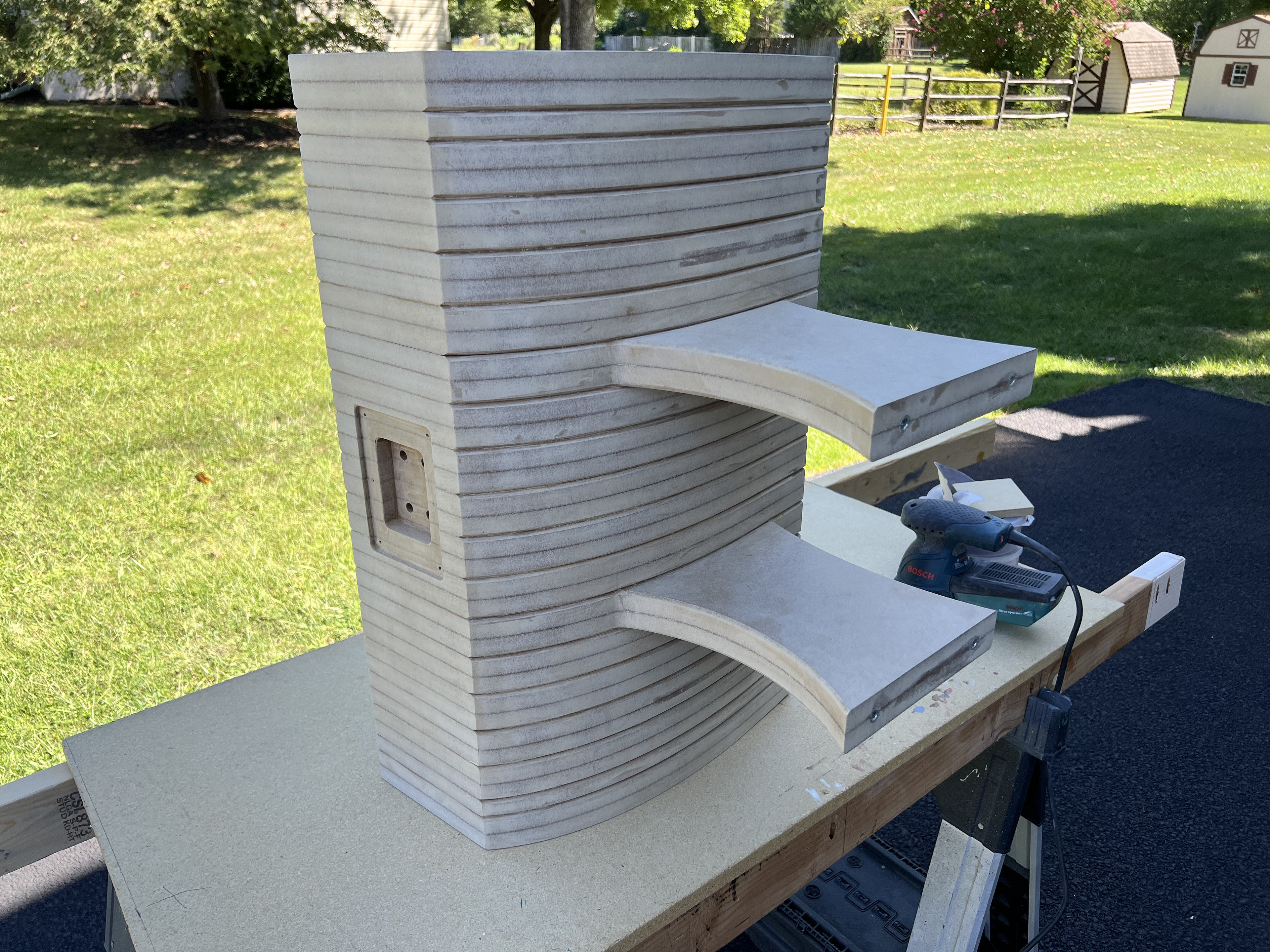

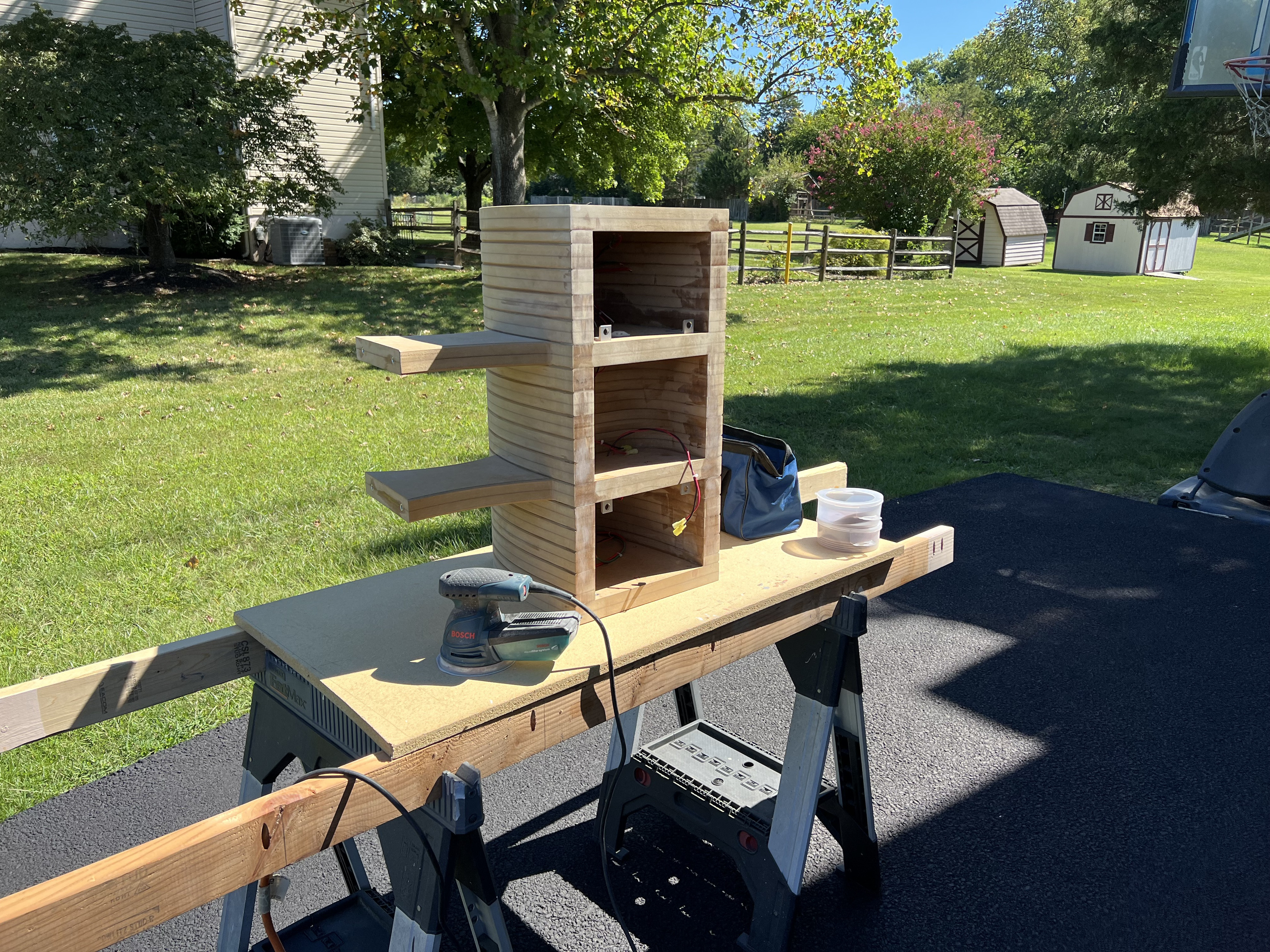

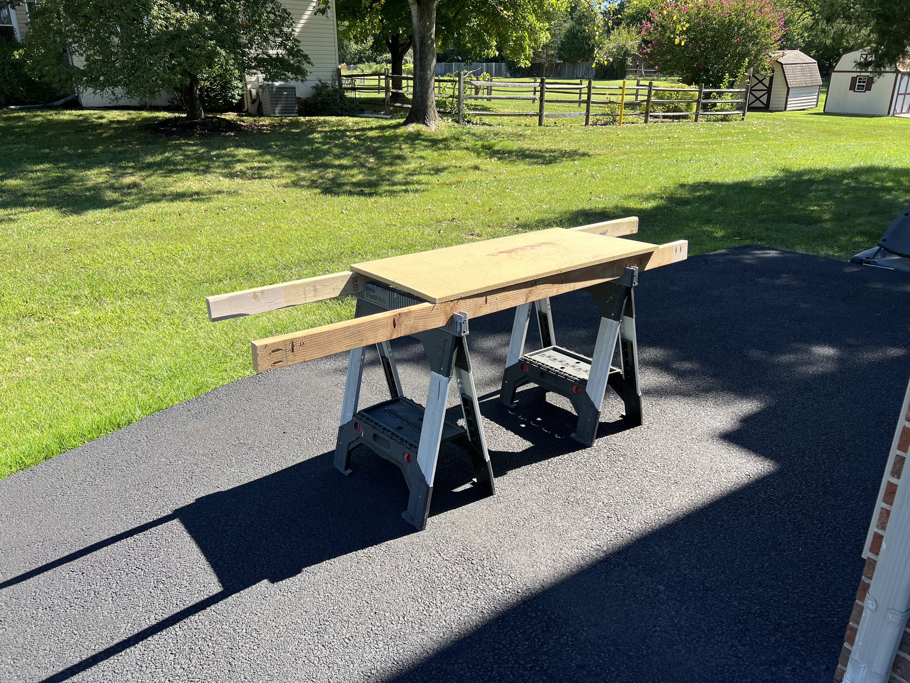

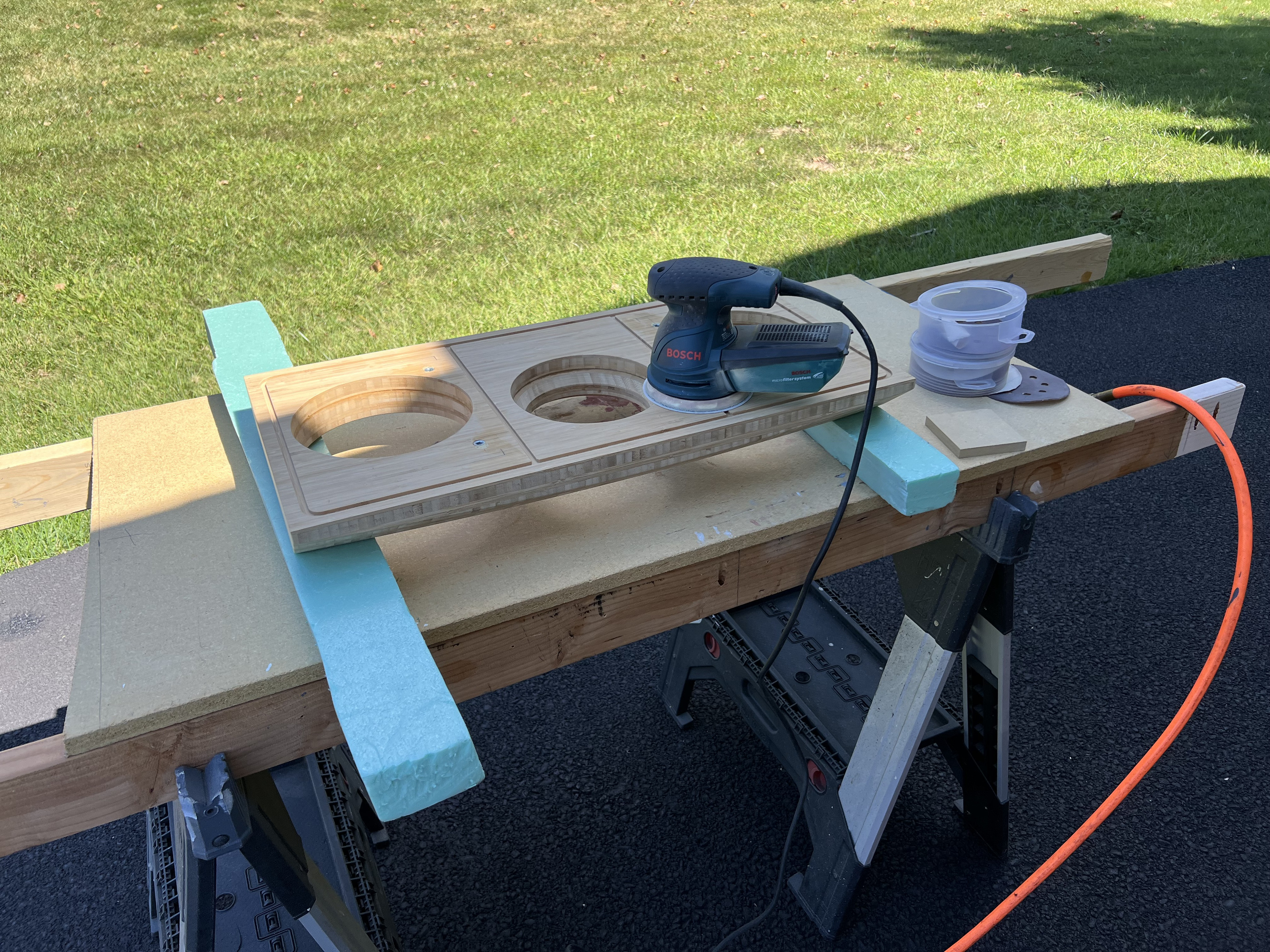

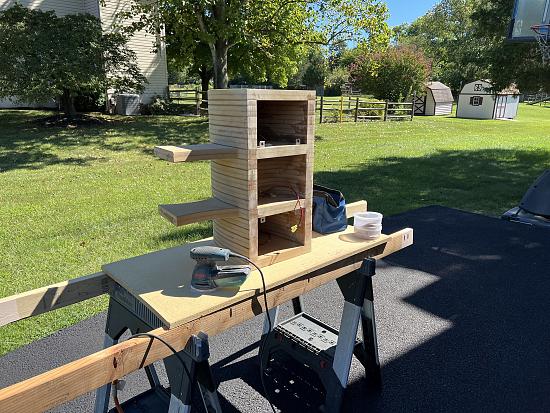

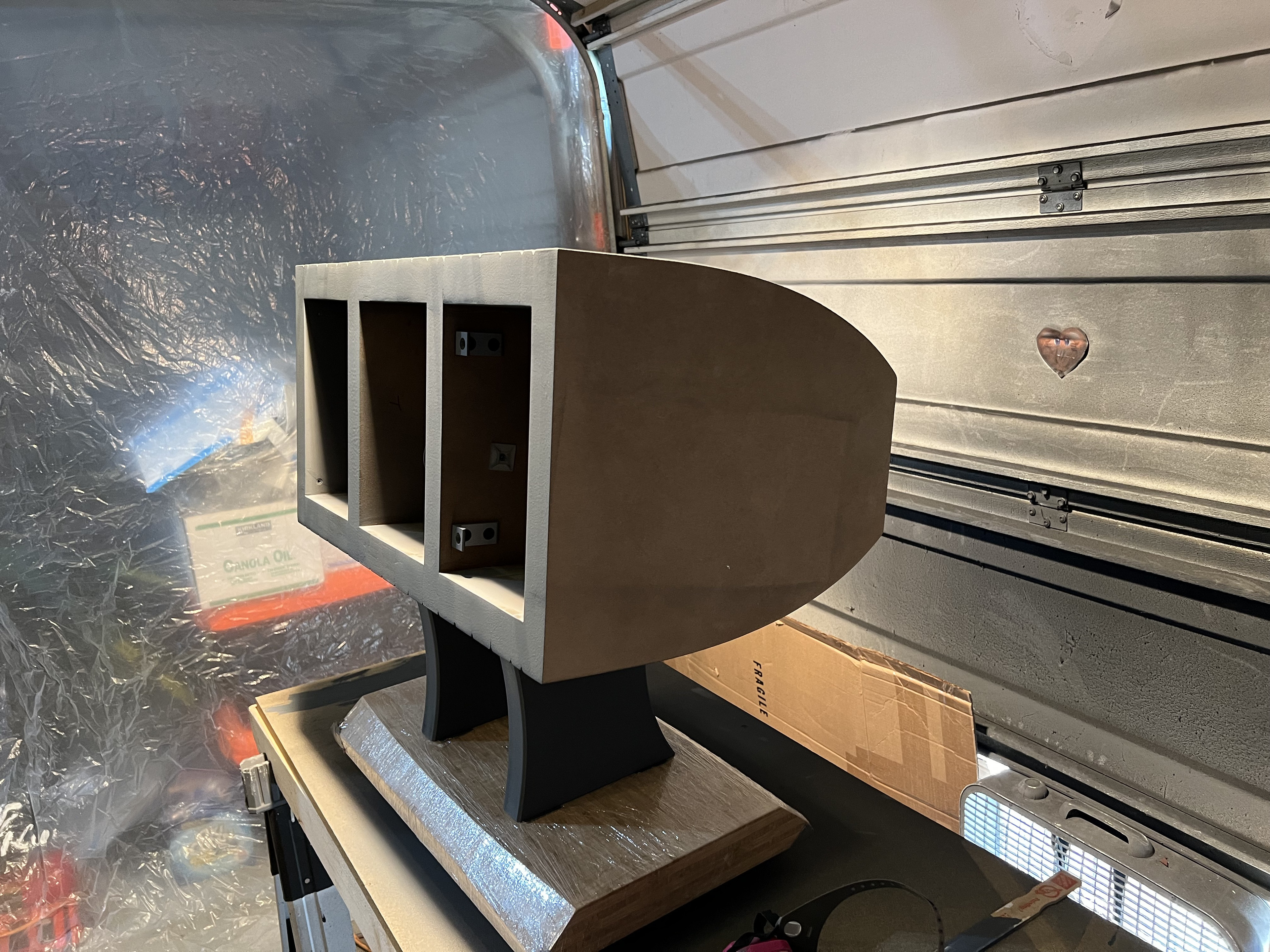

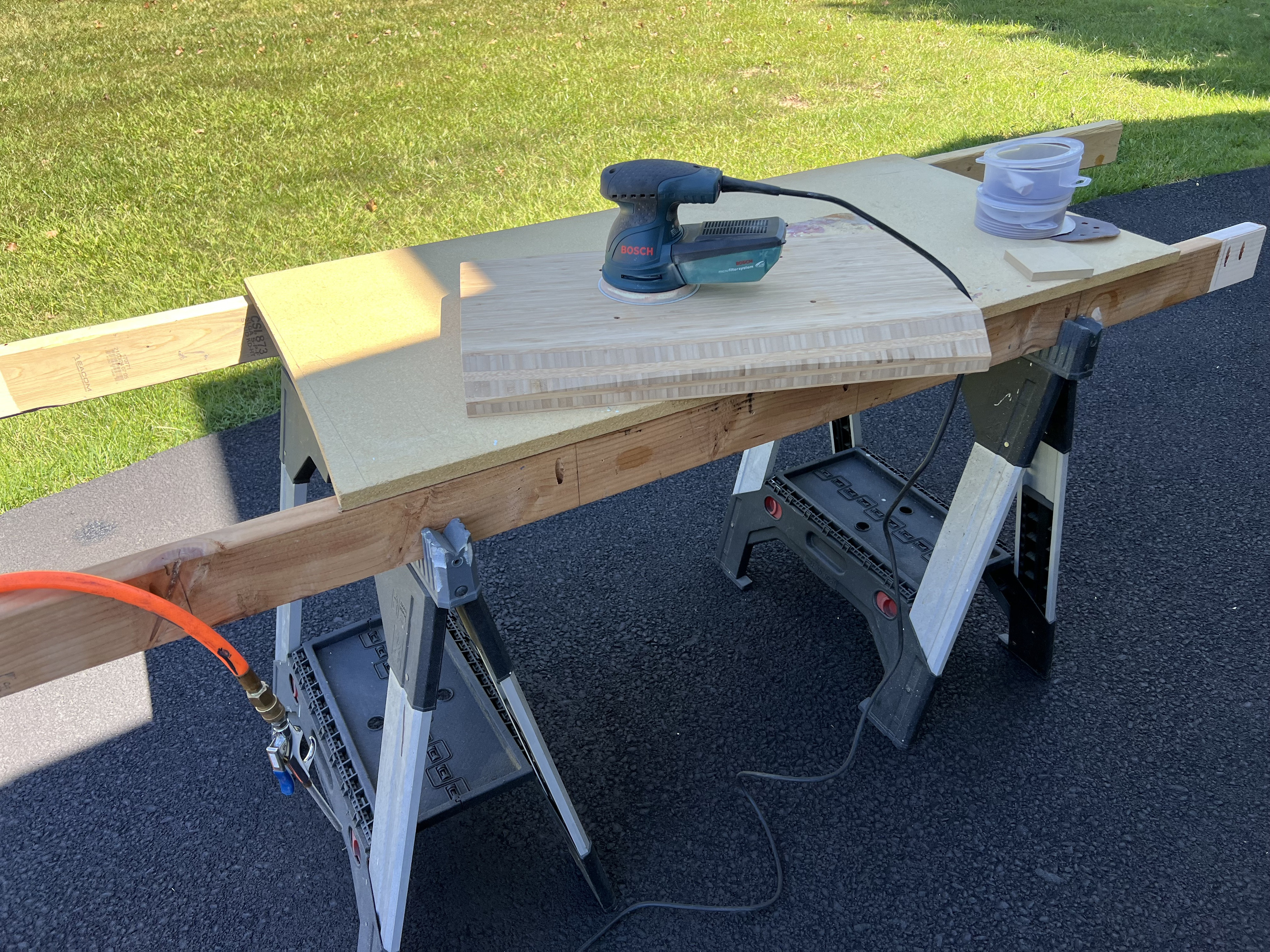

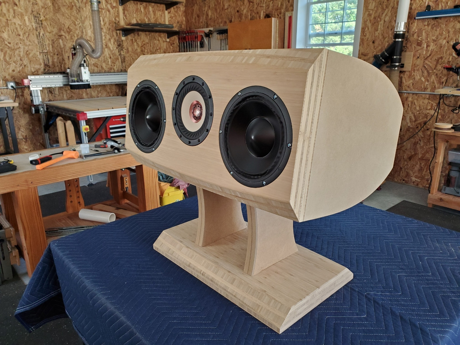

                                                                  This post is long overdue and having horrible hotel internet this weekend was no help. I flew out of town for the last three weeks for a work trip, got home for 2 days and left again for the week to the West coast. That said there will be little to no progress made till sometime in October. I was able to get sanding done and 1 coat or primer on.
                                                                  I was able to get all the pieces sanded and below are photos from the sanding process:
                                                                  Table for sanding
                                                                  The portable table setup for sanding
                                                                  Cabinet on the table
                                                                  The cabinet on the table. It's a workout lugging this cabinet around. I have to pay careful attention when going through doors that I don't damage any corners.
                                                                  Bosch sander
                                                                  The tried and true Bosch sander that has been used in the last 2 projects I've done on the site here.
                                                                  Turning the cabinet on the table
                                                                  The cabinet turned on the table and sanded.
                                                                  Sanding the bamboo
                                                                  Sanding the bamboo base of the cabinet.
                                                                  Sanding the back of the baffle
                                                                  Sanding the back of the baffle first, and then sanded the front of the baffle.

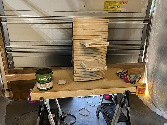

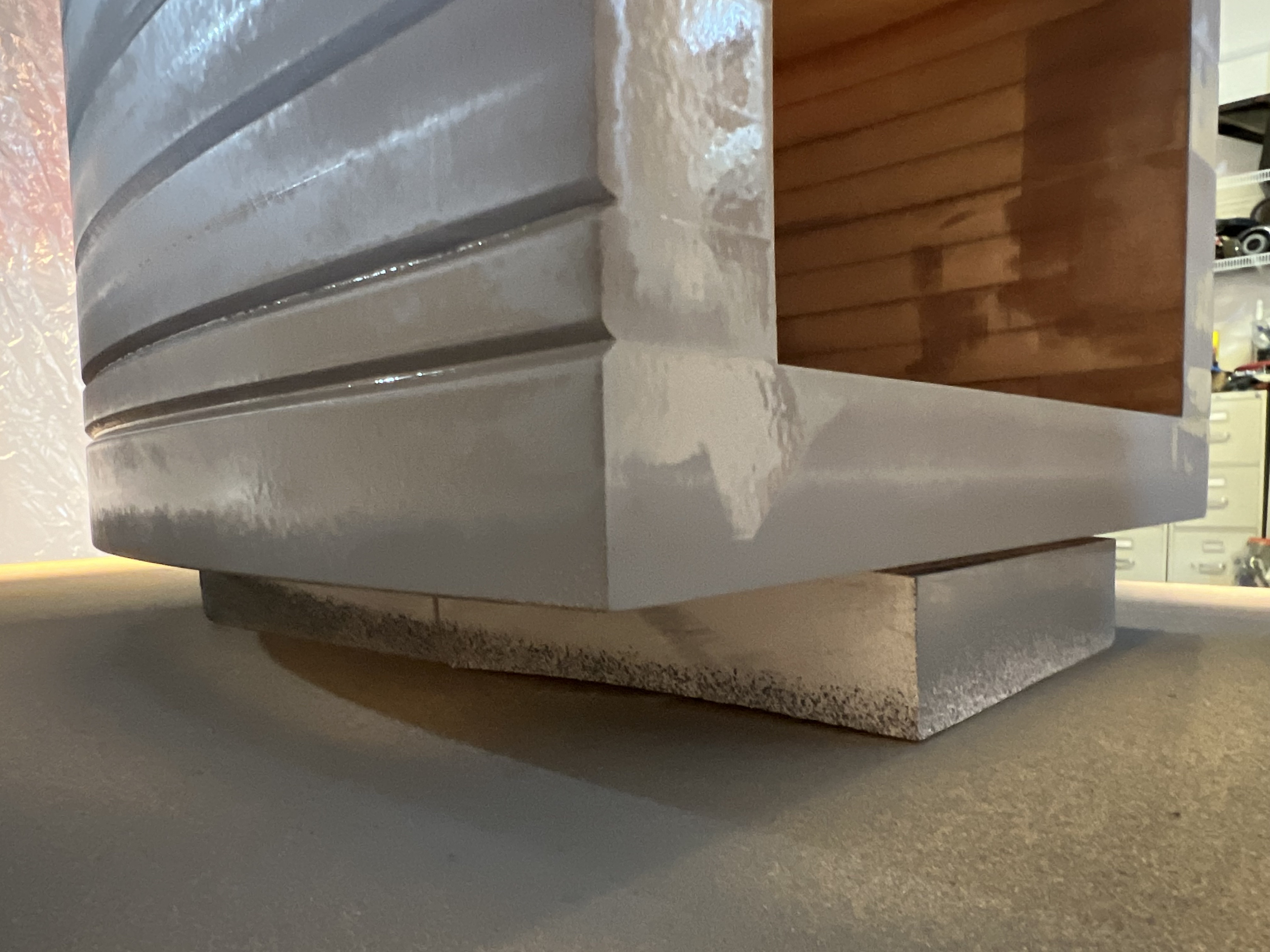

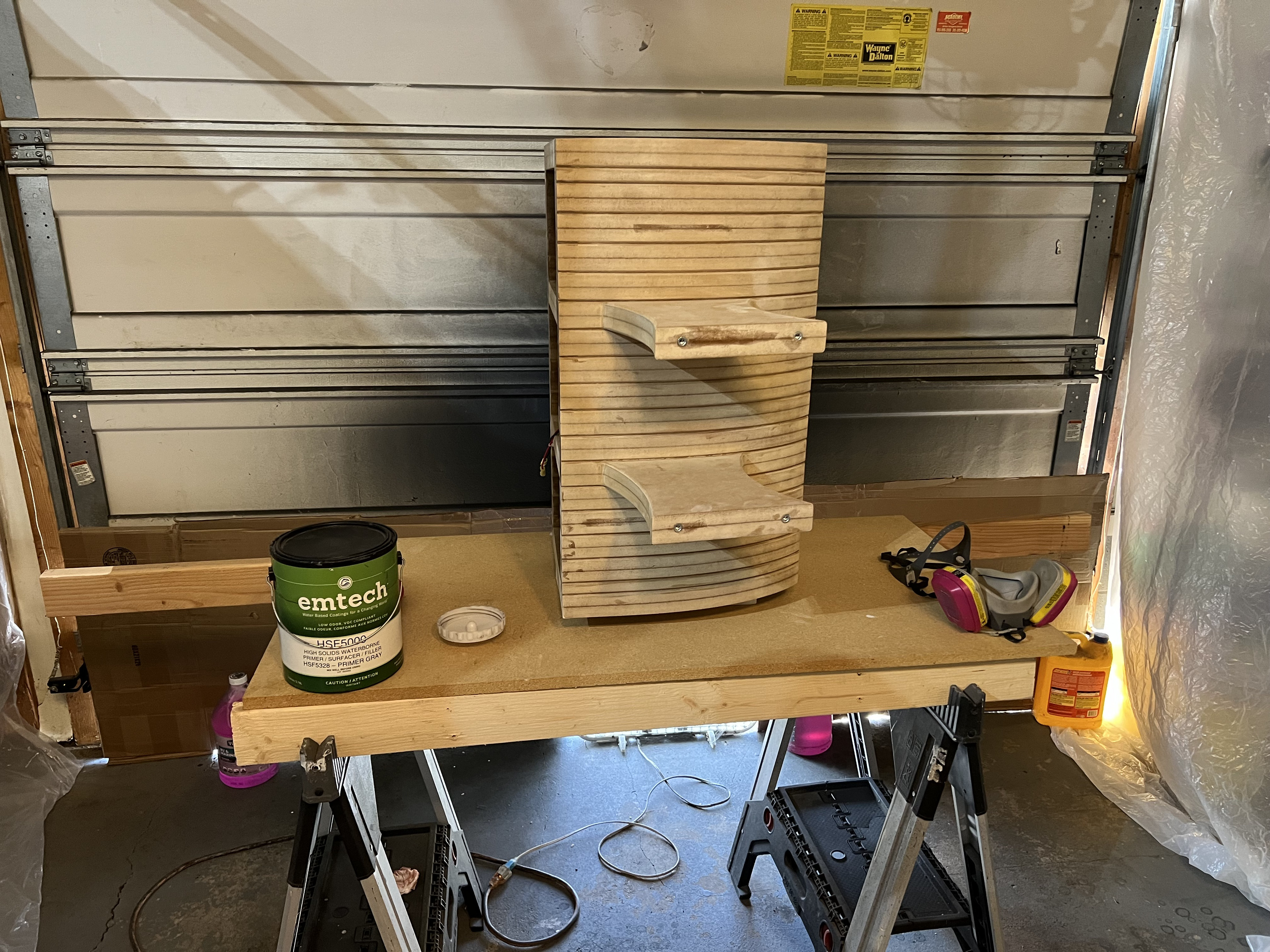

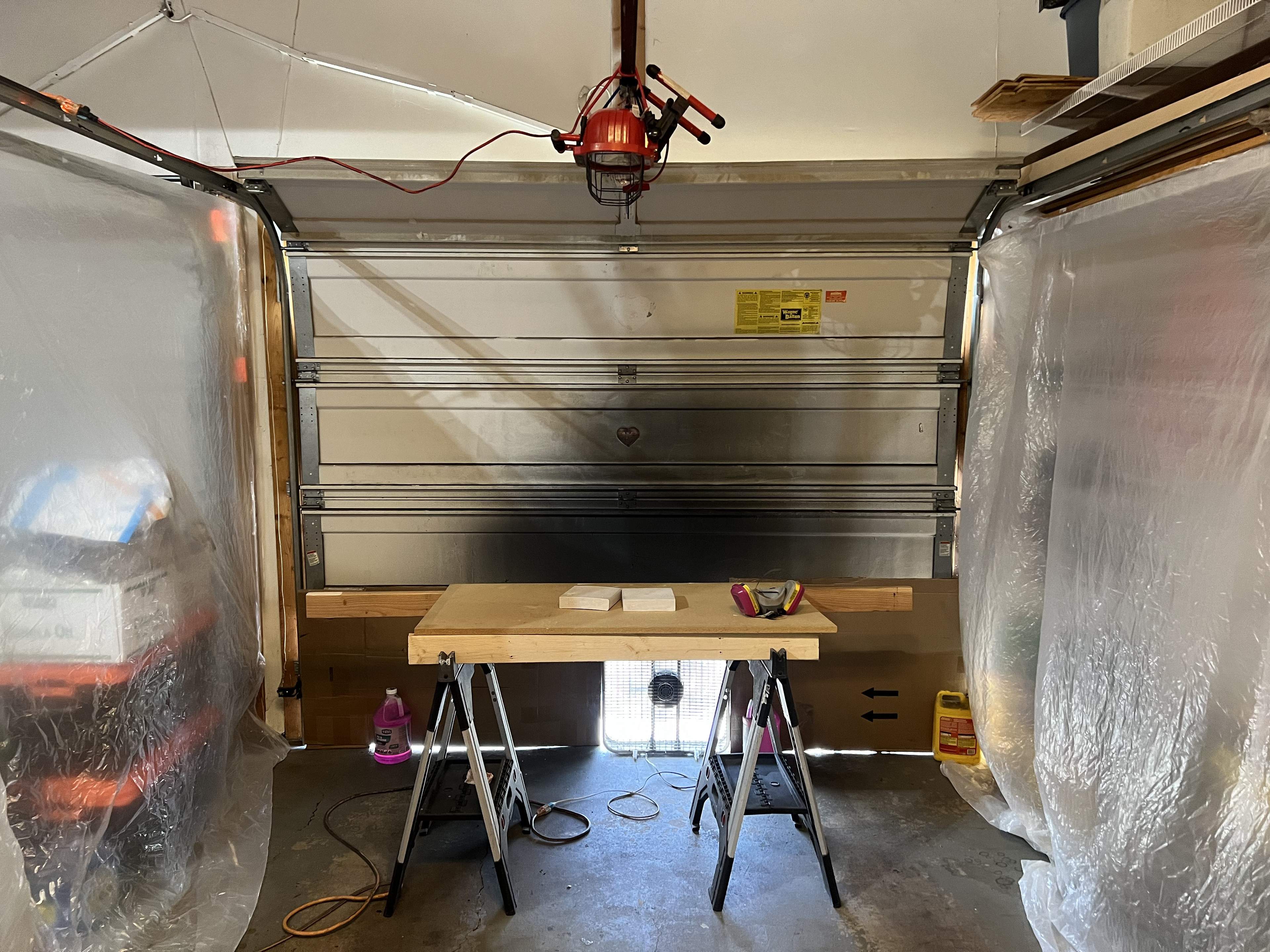

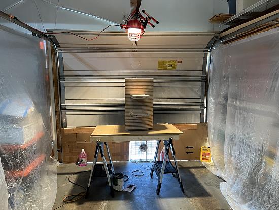

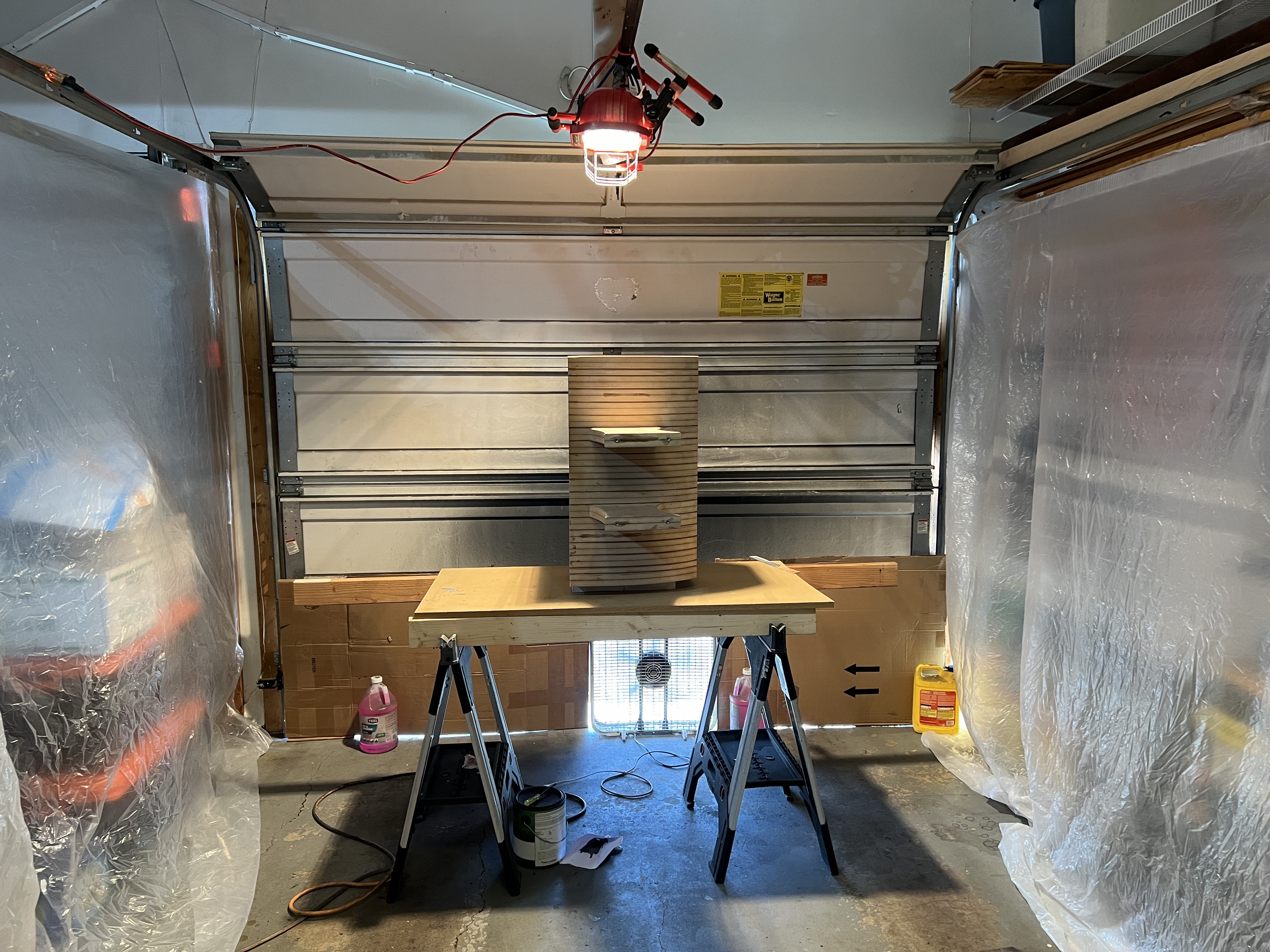

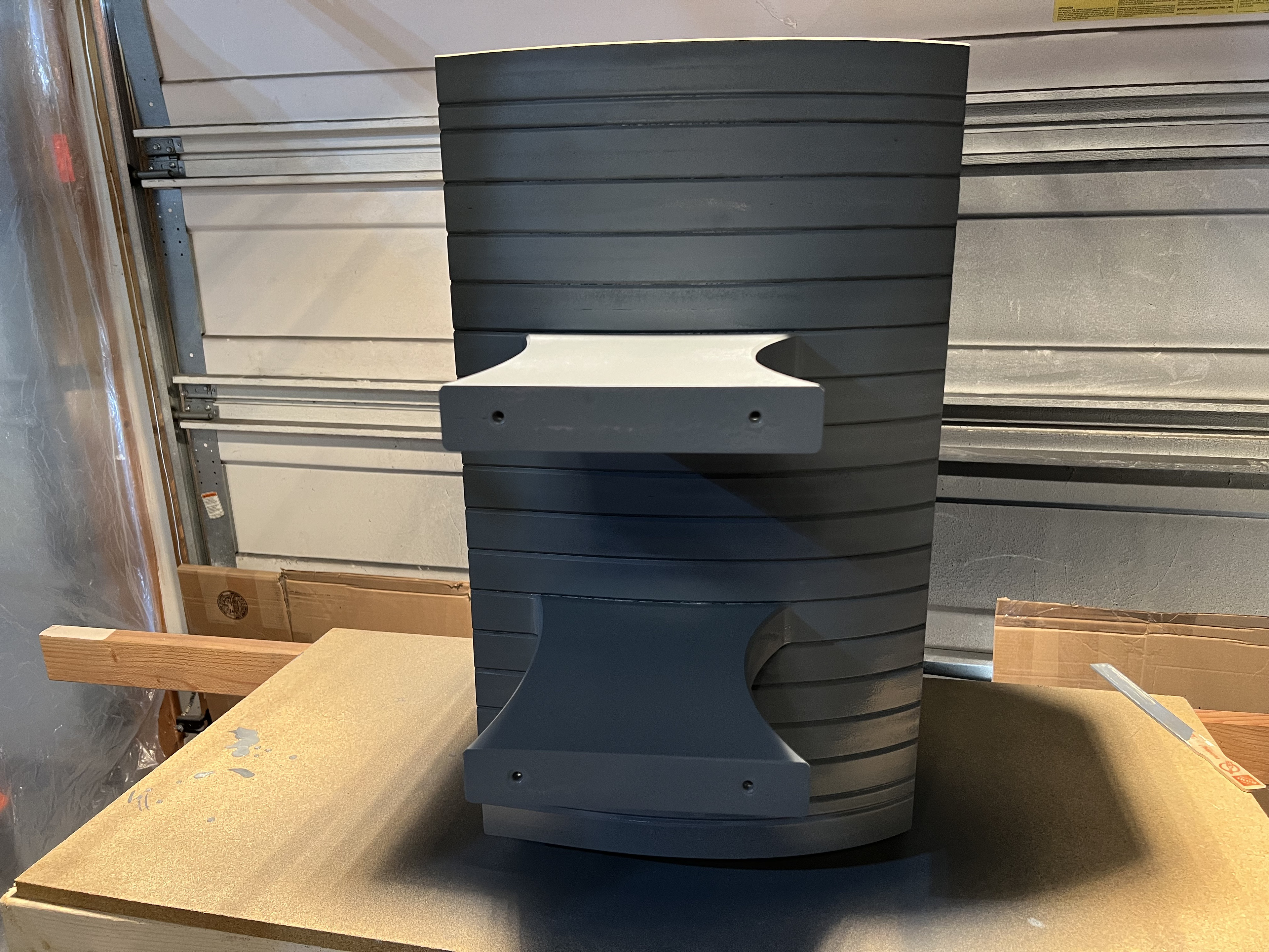

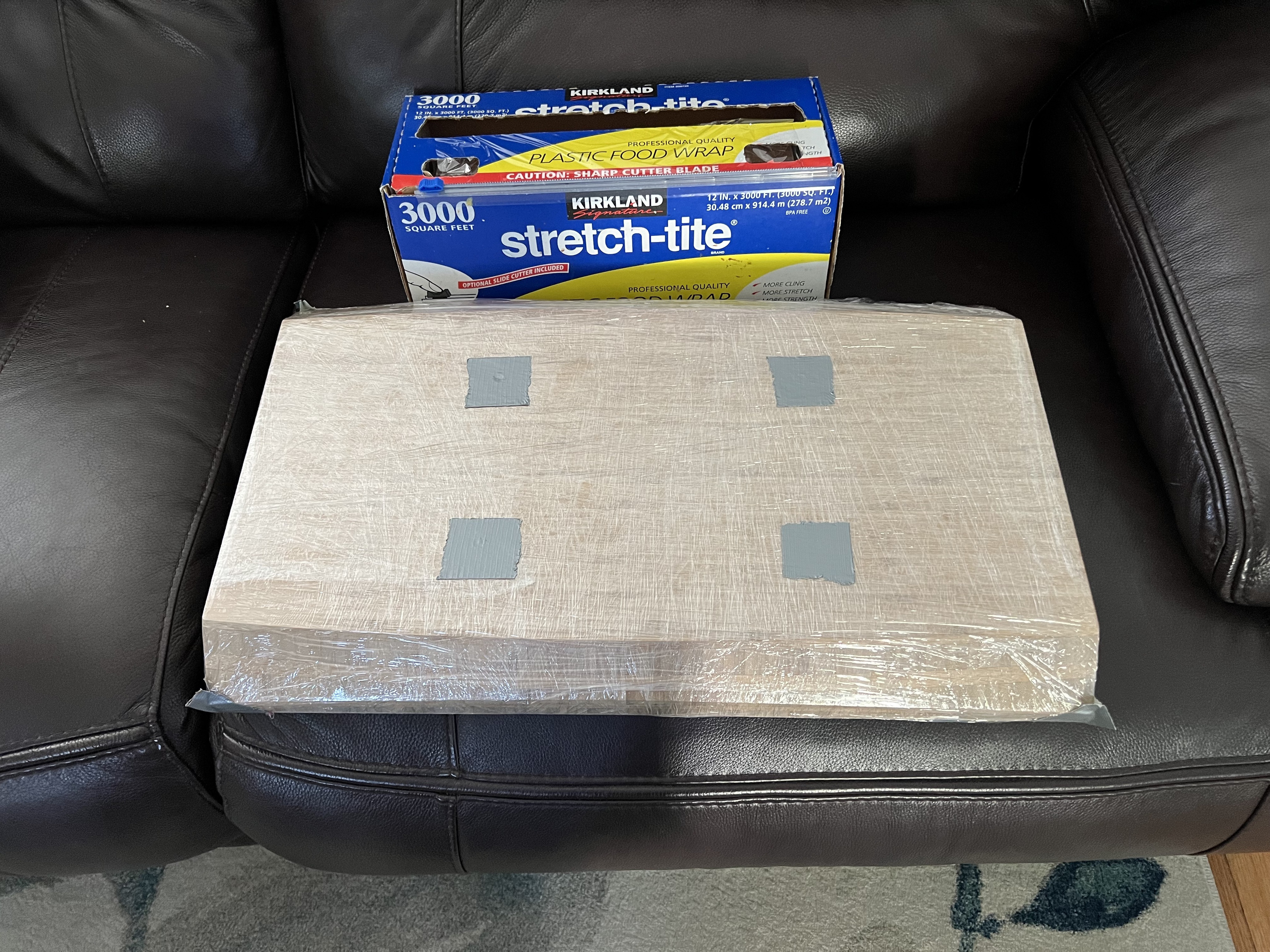

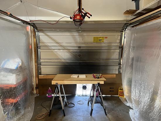

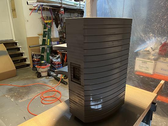

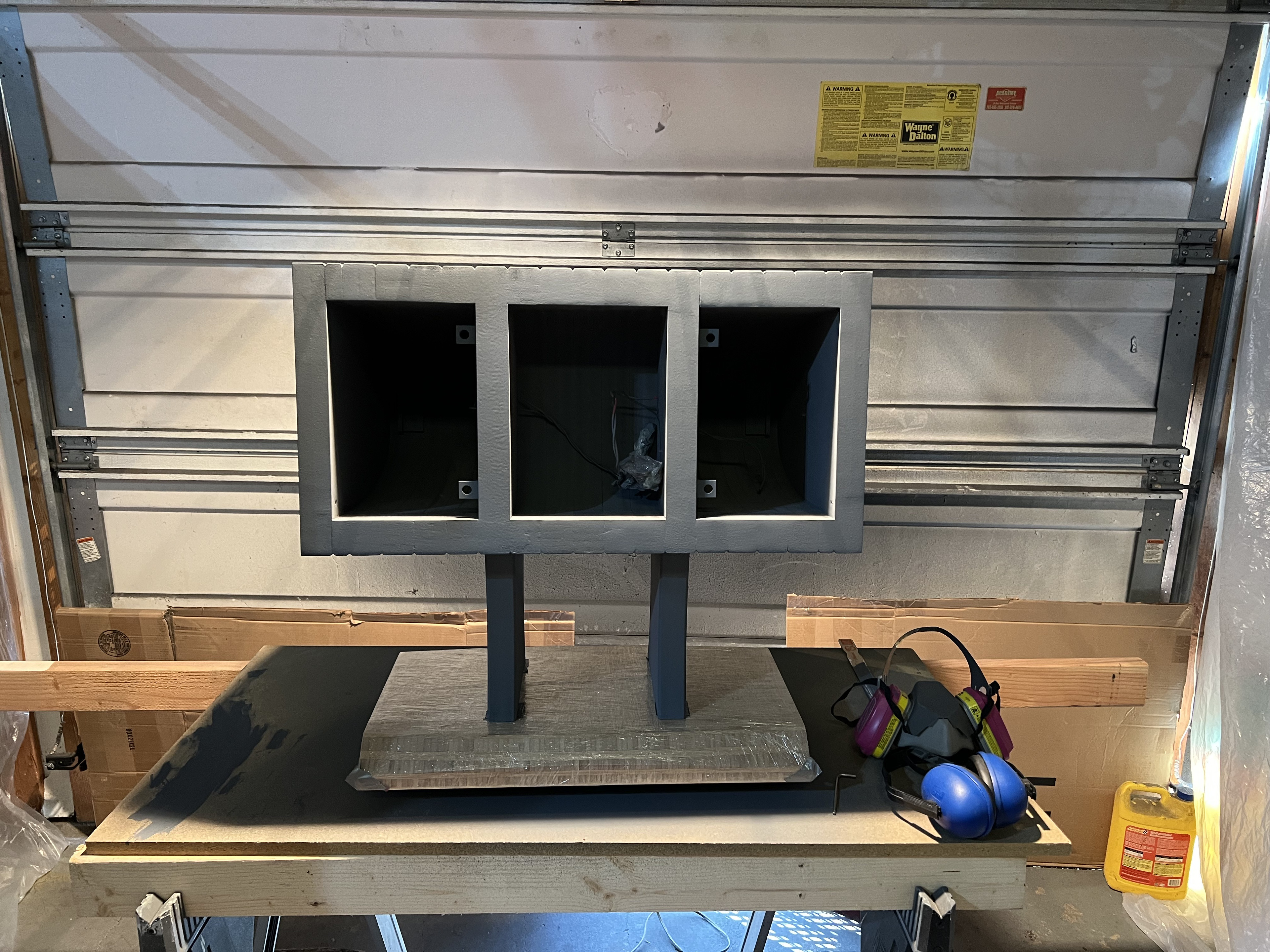

                                                                    After the sanding of the pieces were done it was paint time! Here are some photos of how the process I started:
                                                                    Wrapping the base in plastic
                                                                    Due to the weight and design of the cabinet I decided that I want the cabinet up in position for painting. The bamboo will have a clear coat applied, but until that happens I triple wrapped it in plastic wrap, and put duck tape over the holes where the bolts are used. That way there would be no bleeding or dripping.
                                                                    Setting the garage up for painting
                                                                    I put up plastic on both sides of the garage stall, a fan down at the bottom, and light with bungee cords on the garage lift. The portable table moved into the garage. Do you notice all the primer on the garage? That's from the last 2 builds.

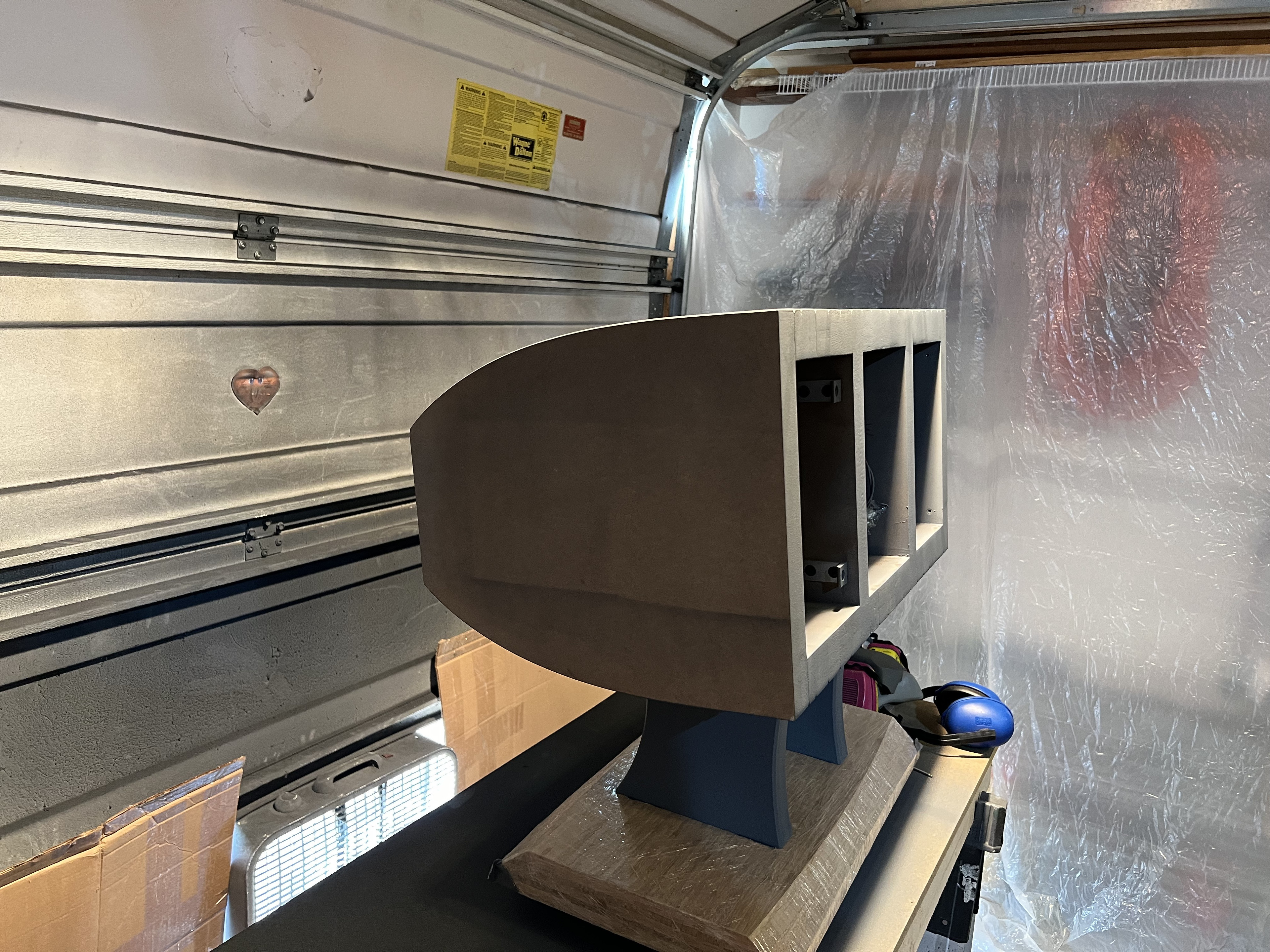

                                                                    Primer, mask, and cabient on the table
                                                                    Some of the usual suspects on the table. Steve Manning has gotten me hooked on using the Emtech primer. The primer is water based and the clean up easy. I've used this primer on the last 2 projects and I've been very happy with results! The cabinet on the table. I painted vertically like this at first, then used the base to paint the sides. Lastly a mask to protect the lungs from the vapor when spraying.

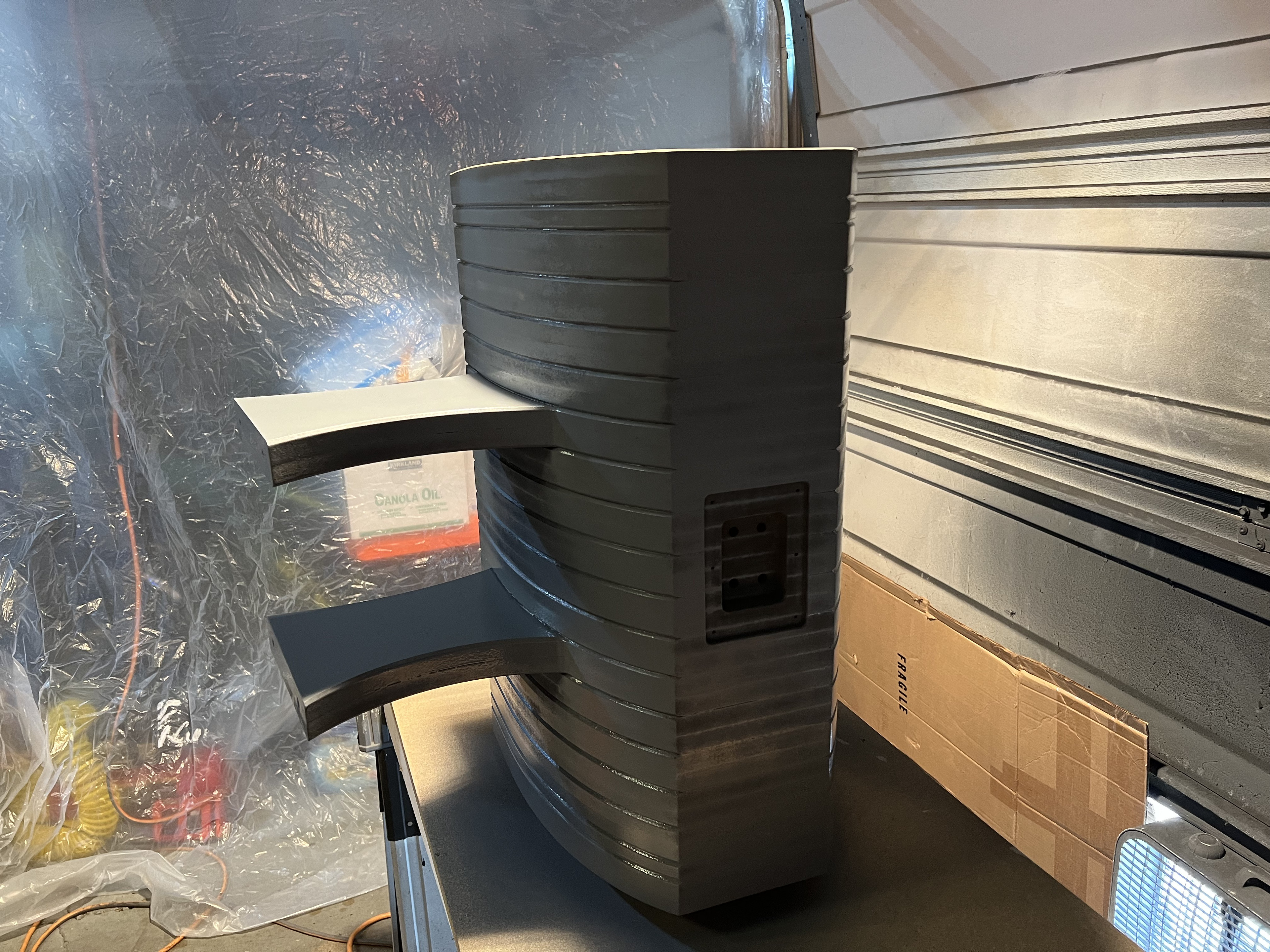

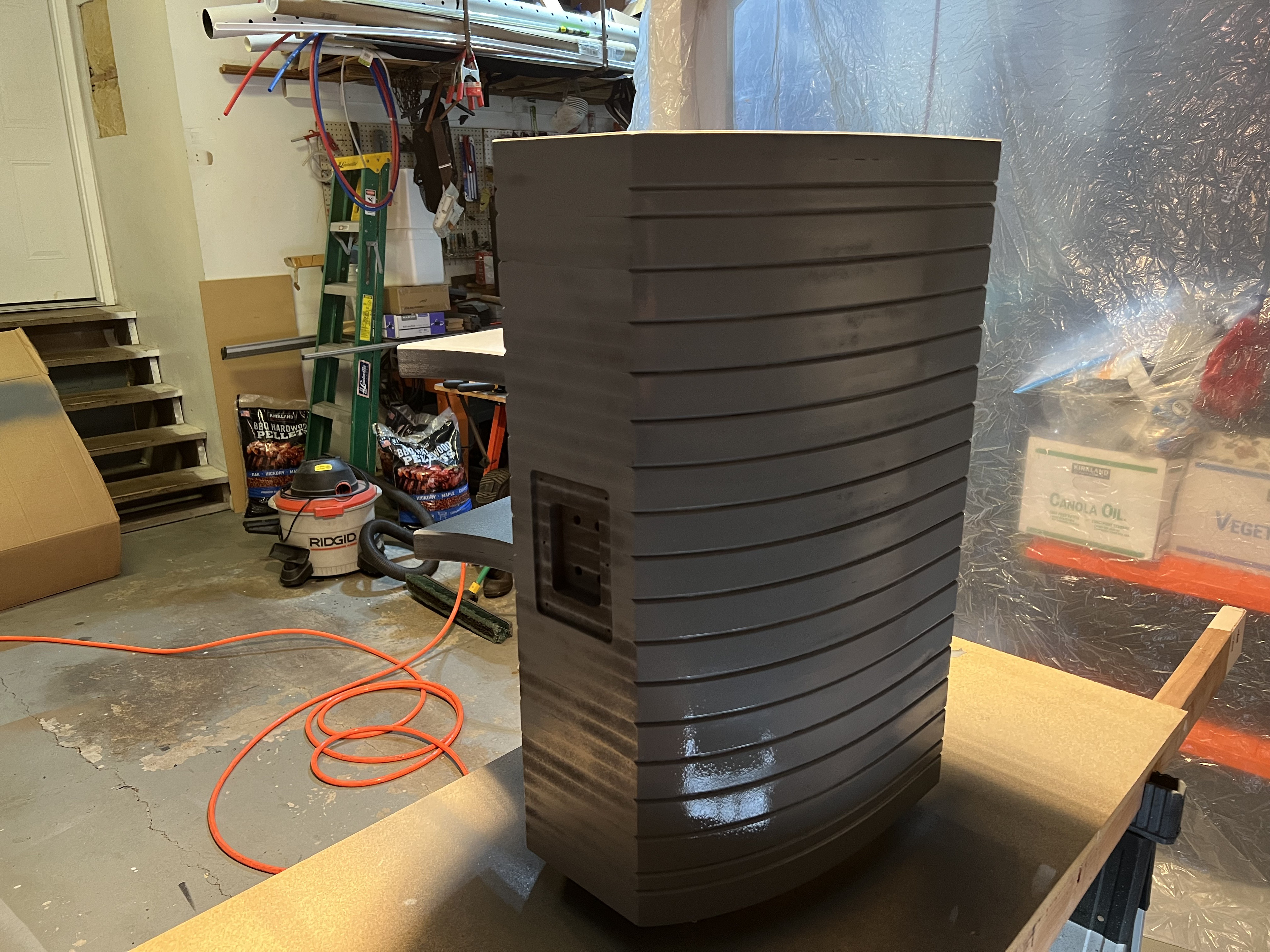

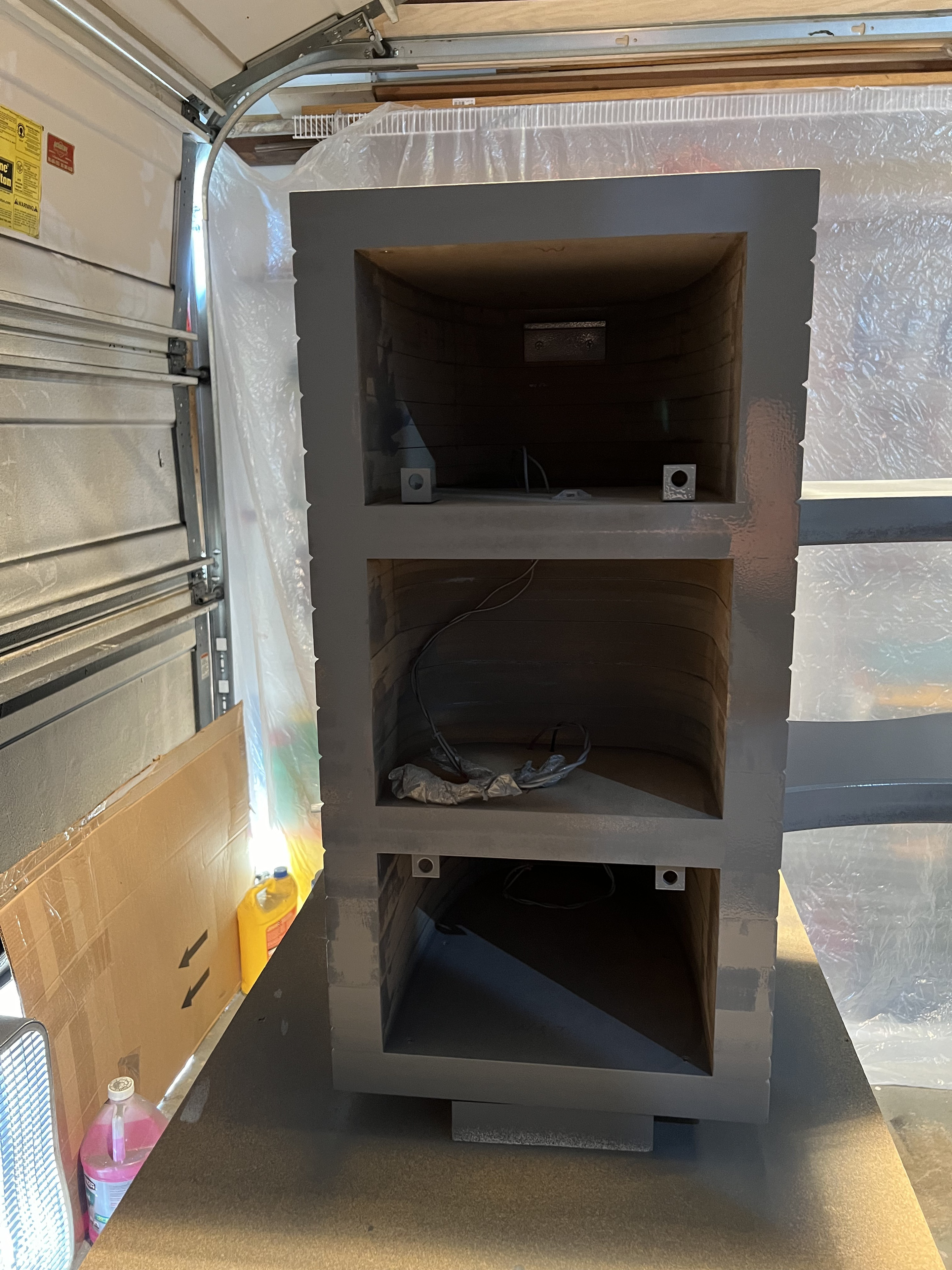

                                                                    Getting ready to paint
                                                                    Everything is in place and it's time to start spraying some primer!
                                                                    First coat or primer
                                                                    Another angle of view after 1st coat of primer
                                                                    3rd angle to view the cabinet after 1st coat or primer
                                                                    The front of the cabinet after the 1st coat of primer
                                                                    First coat or primer sprayed on the cabinet.
                                                                    A close up of the 1st coat of primer
                                                                    A close up of the primer while still web after spraying the cabinet.
                                                                    The cabinet on the base to spray the sides
                                                                    Painter in training
                                                                      Master of None
                                                                      • Jan 2014
                                                                      • 1662
                                                                      Continuing from the last post of painting the first coat of primer.
                                                                      The left side of the cabinet before spraying
                                                                      Right side of the cabient before spraying
                                                                      The right side of the cabinet before spraying.
                                                                      The crossover and speakers moved out of the way
                                                                      The crossover and speakers have been moved to the theater room to keep them out of the way for now. I will assemble the CC in the room due to the size and weight. This is not easily moved after assembly.

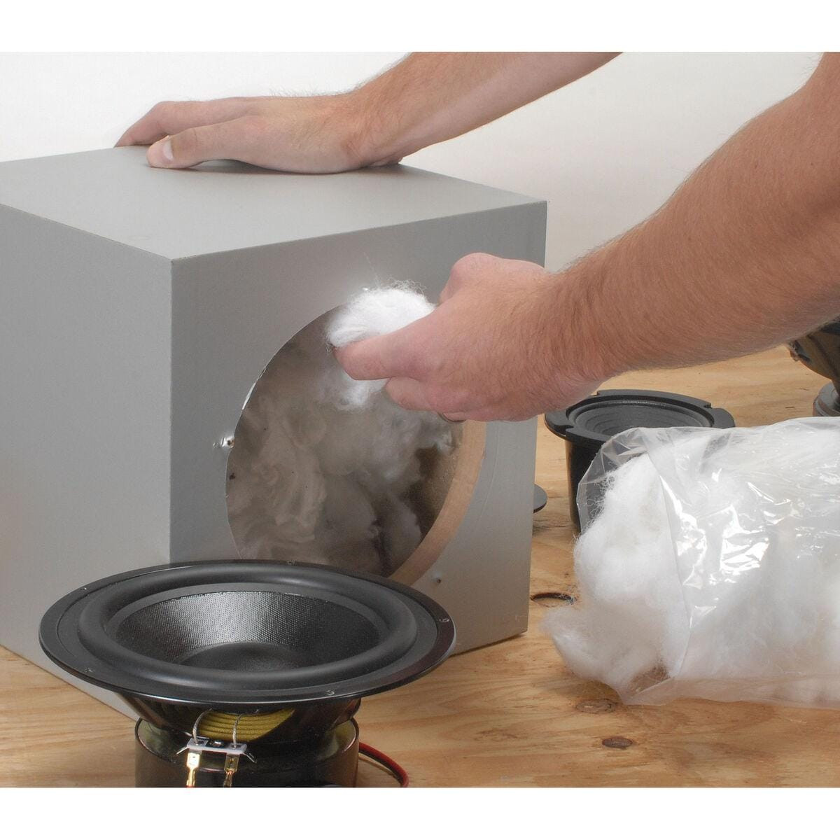

                                                                        Sitting around in meetings all day, but this morning I ordered the stuffing that will go into the center channel. I ordered a 5 lbs bag, which is probably more than I need. I can save the rest for later projects.
                                                                        Stuffing for cabinets

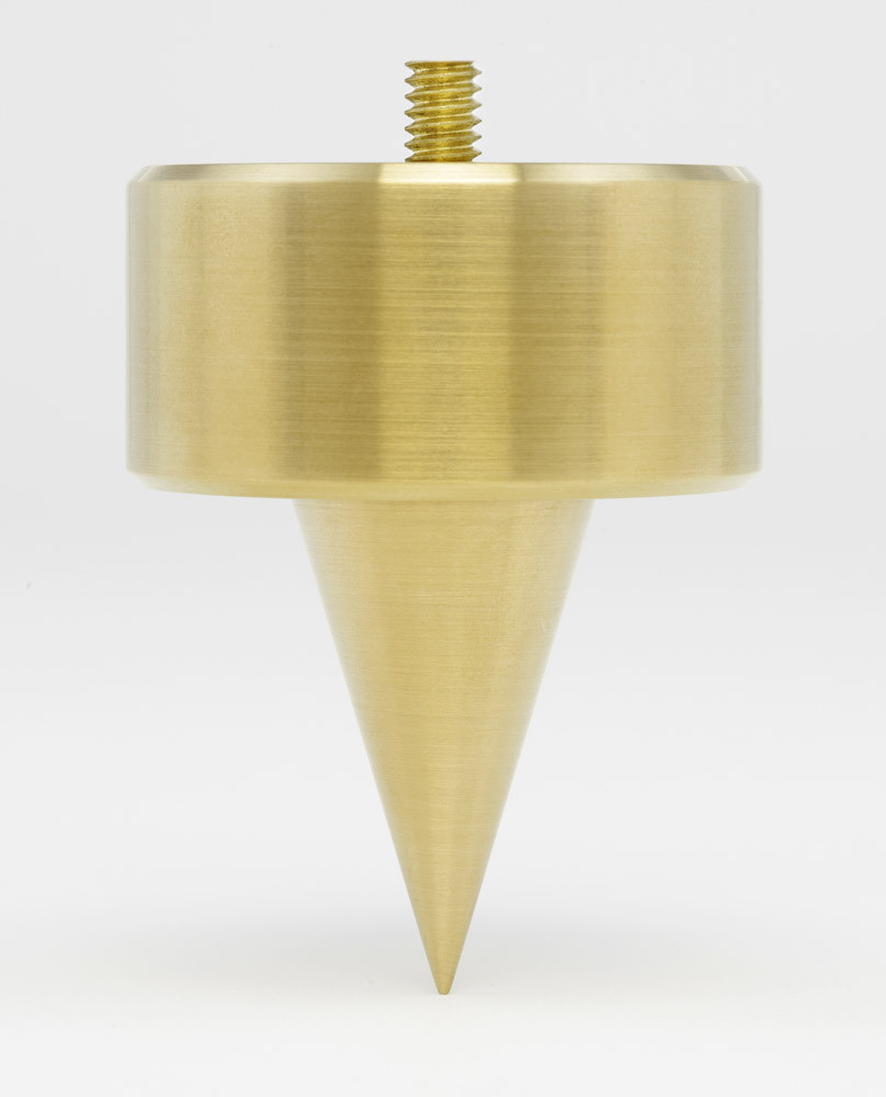

                                                                        Last night before I made it to bed I was looking at the spikes. The cheaper option that Steve Manning shared doesn't seen to be available. The website is no longer available. I either have to fork out the cash for ViaBlue or try to find another option.

                                                                          I've already got a thing going with a machinist. I should show him a picture of a ViaBlue and ask what it'd be to make a run of a few sets...
                                                                            Master of None
                                                                            • Jan 2014
                                                                            • 1662
                                                                            Yes please do. It would be great to get some other options.
                                                                            I ended up ordering 4 of these brass ones from Eden Sound Audio:
                                                                            bras spikes for speaker cabinet
                                                                            Painter in training
                                                                              • 1556
                                                                              That is a big freaking spike! Should go well with your big freaking center channel!
                                                                              Just sent an email to my guy Troy, asking for a ballpark on a run of 100 spikes and provided a picture of the above, a ViaBlue, and a Dayton spike as examples. I assume we'd also use brass, but if we're serious about this I'd want to do some research as to why that is the material of choice, or if some combination of other materials might be better suited.
                                                                              Edit: I was hoping this guy would have more spikes in stock but it doesn't seem he's gotten around to getting custom models spun out yet. I do want to try his terminal plates sometime though!
