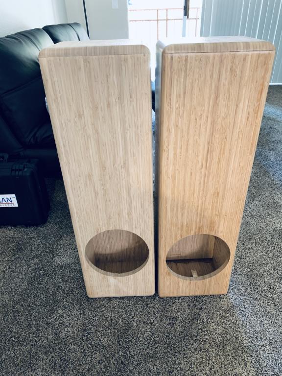

    The mark 2 version is a wide-but-shallow small tower, with approximately 38 liters of net volume, and exterior dimensions of 11.5w x 37.5h x 9d. As-designed, Helios specifies 35L of internal volume, but that is before the substantial amount of internal bracing which is at least another liter or two of volume (I'd guess two...). I'm sticking with the ScanSpeak 26W passive radiator because it has improved low bass output (in simulations) vs the as-designed SBA passive radiator, and it does so with a smaller cabinet foot print (27cm vs 29cm). Using a different PR is really what allows this tower to work without resorting to some other extreme option. Finally, the cabinet construction is all carbonized vertical bamboo, and it is a mix of both single ply and three ply versions. Both have a nominal thickness of 19mm, or 0.748". I primarily used Northwest Bamboo to source my raw material.
    Click image for larger version  Name:	Helios Tower.jpg Views:	1 Size:	46.0 KB ID:	872531
    Before I dive into either the design modifications or the build discussion, here's the current progress as photographed from the workshop of the San Diego Fine Woodworker's Association. I'm incredibly pleased that I have a resource like this available to me. Highly recommended for those within striking distance of Miramar and the 805.
    Click image for larger version  Name:	IMG_9547.jpg Views:	1 Size:	61.3 KB ID:	872530
    In making the shift from a monitor to a tower, I'm making changes to two design elements. The first is obvious because it's one of the biggest rules among the DIY speaker community: don't change the baffle! The second issue is one that will be less obvious to people, and it can matter a fair bit, as well: changing the depth. Changing the baffle dimensions and layout affects the diffraction signature of the design. In practical terms, the change in the baffle will alter both the frequencies and amplitudes of the baffle-induced constructive and destructive interference. More on this in a moment....
    The change to the depth of the cabinet changes the frequency and amplitude of the effects of the rear wave of the drivers. Since (mid)woofers are not acoustically opaque front-to-rear, the rear wave can have an audible effect on the overall speaker performance. While I do not have any simulation tools at-hand to quantify this, based upon how the discussion went a long time ago when the Grimm LS-1 was launched into the market, I would expect to see higher amplitude rear wave effects (less absorption) with a shallower cabinet, but with those rear wave issues happening at a higher frequency. In this case, the half-wavelength should move from about 566Hz based upon the original design to closer to 1kHz in my mk2 tower. With a Fc around 1300 Hz, the move up to 1kHz may not create too much of a penalty.
    One will also note that the original design did not include any stuffing or surface treatment of the rear wall of the cabinet. Thus, the original design took a "let the chips fall where they may" attitude towards this rear wave issue. For the mk2, I have Sonic Barrier in inventory, and based upon Augerpro's findings in the construction methods thread, I'm likely to invest in some denim insulation, as well. Lacking a reliable modeling tool, I'll skip further commentary on this second issue until I've made more progress on the build.

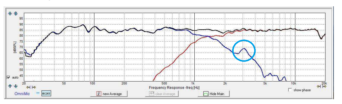

    Now, let's talk diffraction...
    Click image for larger version  Name:	Diffraction Sim.png Views:	1 Size:	27.4 KB ID:	872529
    Using Jeff's Diffraction & Boundary Simulator (because it's fitting that I use his tools, plus I'm an Excel junkie), I put together the chart, above, showing five different scenarios overlaid on one another.
    1. Scenario 1 is the predicted diffraction of a 29mm dome tweeter placed 4.375" below the centerline of the speaker (edit: apparently 4.44 is the official number, which is 4 7/16 rounded to two decimal places). This is my guess about where the tweeter centerpoint is located in the original design. It's pretty ugly.
    2. Scenario 2 is the diffraction effect changing the 29mm dome to a 15cm driver (close to the usable diameter of the wave guide). This is much better, obviously.
    3. Scenario 3 expands the baffle from 11.1" to 11.5". There is almost no difference compared to the original design.
    4. Scenario 4 models the as-built cabinet, with the tweeter being 5.75" below the top of the cabinet. Ouch. That may be an expensive aesthetic choice.
    5. Scenario 5 maintains the 11.5x37.5 tower baffle, but moves the tweeter back to being just 4.375" below the top of the cabinet.
    Based upon the simulations, above, I would expect to see about 1dB of more extreme (positive and negative) swings in diffraction between about 500Hz and 2kHz. The major deviations are between 500 - 900 HZ (excess SPL), but this is more than a half octave below the 1.3kHz Fc - so it will be -12dB or so below the design level. Between this and the directional nature of the waveguide's output, I'm optimistic that it might not be audible. If I had kept the original spacing, then the deviation would have been less than half of the as-built simulation. Also, as mentioned above, a waveguide increases the directivity of the tweeter, which should reduce the interaction with the baffle even further than what should be predicted by the increased effective radiating area alone (I'm guessing here).
    All of that is great in theory, but I don't know that I could hear it and having such a big tweeter so close to the top of the cabinet just looked a bit odd to me. Aesthetics won out on this decision, and if I need to "fix it in post", then that's what I'll have to do.
    Net-net: changing the baffle width had a trivial effect. However, changing the baffle height and the placement of the tweeter does seem like it will have a measurable effect.

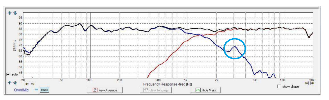

    • 16194
    Baffle modeling is an under sung hero or necessary evil, depending on who you talk to... especially if you want to consider modifying an existing design, as opposed to fundamentally taking the same drivers and doing a new design with all new measurements, one should exercise some caution.
    I have used EDGE quite often, and I hear ET has modeled the new NatalieP Ultra using it, and coming to some interesting conclusions and directions for when he can proceed with an actual construction and test... I think time doing that carefully is well spent considering the surprising level of impact that may occur, especially in regions near the crossover. I think your "optimism" in this case is well justified..
    Best of luck, and keep us posted!

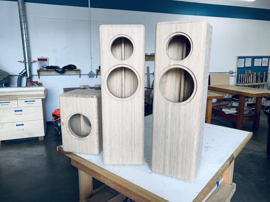

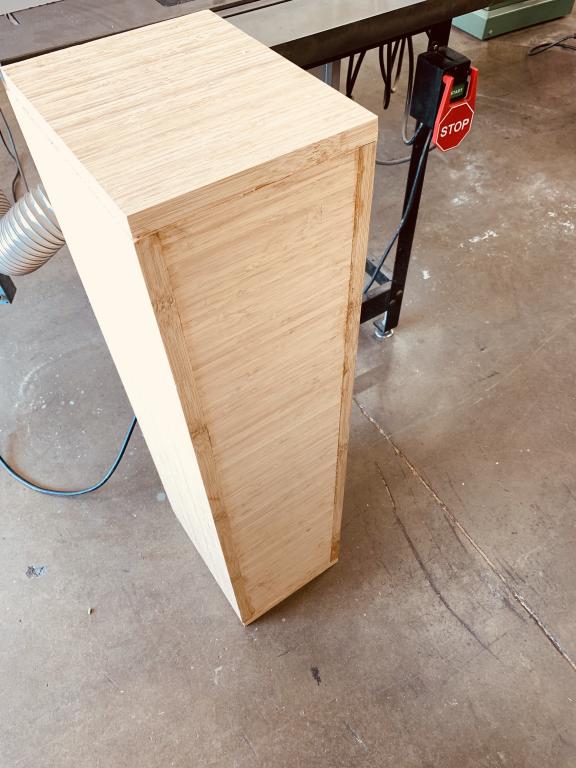

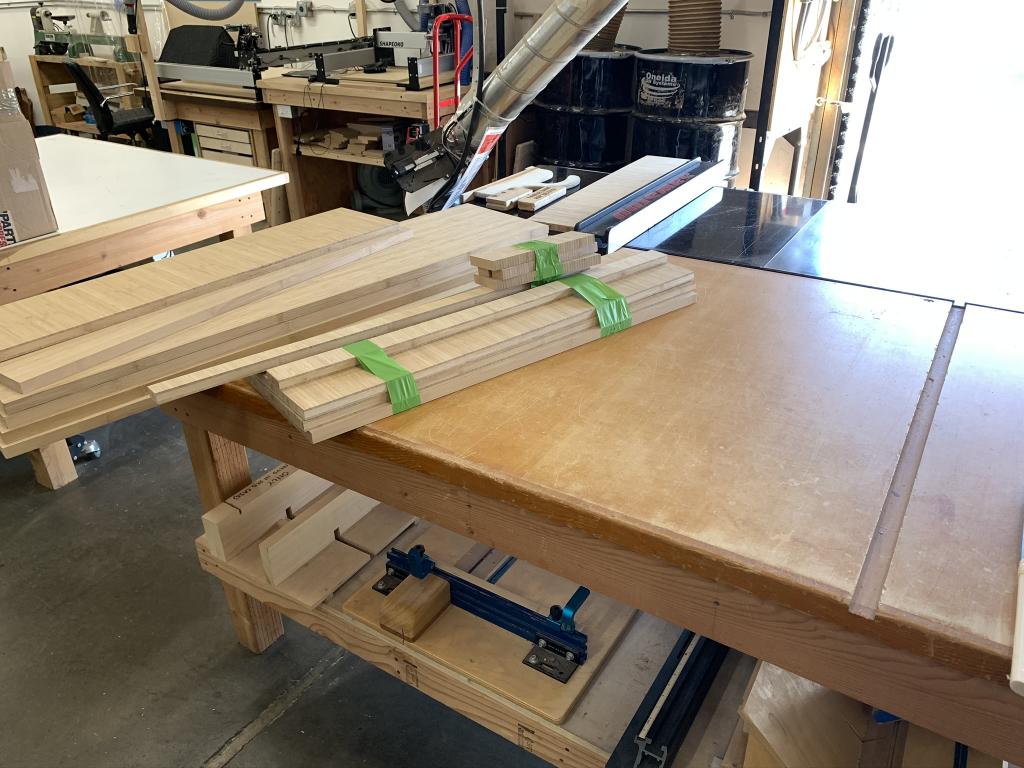

            Basic Construction Photos
            I have mentioned the SDFWA shop in before, and I will mention it again. This place changes a lot of things for me. There are two 10" SawStop table saws, a couple of CNC machines, a sliding compound miter saw, jointer, etc. A lot of the toys that I would be hard-pressed to shoe-horn into a garage. Once the shop opened back up, I just needed to get my shop safety certification, and I could start the mark 2 build in earnest.
            Back in my bathroom phase, I had gotten kinda-sorta-maybe close on getting the various pieces cut to length and square. But it wasn't good enough. The first step was to size and square the boards on the table saw. Note: my as-built dimensions were drawn after I knew what was salvageable, not necessarily what was planned. I was aiming for a touch larger (taller), if I'm honest.

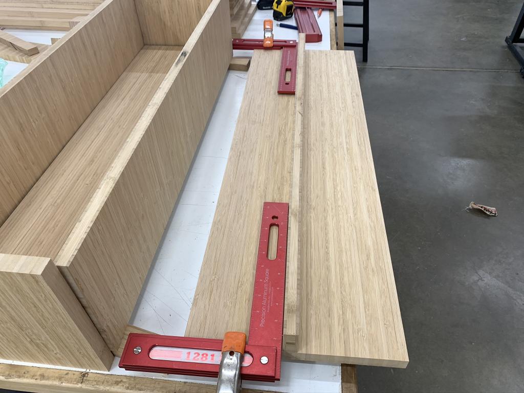

            The single-ply wood came in a 12" nominal width, and the interior baffle only needed to be 10" wide. After a cut to make a straight edge on one side, this left me with about a 1.5" off-cut on the other side. This was planned all along to be used as a "spine" for the rear cabinet. The rear of the cabinet is a single layer of 1-ply material with that same 10" dimension between the supports (side walls). I spent a little time playing with the Sagulator to model how the deflection of a shelf would change with varying lip sizes. Something in the 1.5" - 2" range adds quite a bit of stiffness without a lot of additional volume. I put a double 3/8" roundover on the end that receives the rear wave from the WO24P, and glued it into the centerline of each rear wall.
            Because there is only 6.75" of unsupported distance between the rear wall and the inner baffle, I made the explicit decision not to put any front-to-back bracing into the design. I would change this decision only a little to have some corner structure to aid in alignment for glue-up. The as-built cabinet is fairly stiff (knuckle wrap test) otherwise. There are two additional horizontal braces on the front baffle providing further stiffness to it focused on the top and bottom of the woofer (where there mechanical forces are greatest.

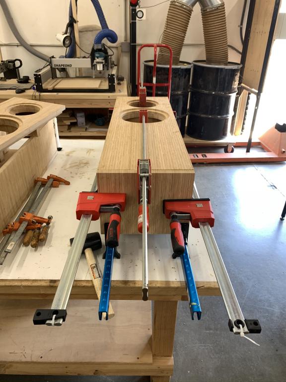

            After that, it was almost a pretty typical glue up. I used all butt joints, which did not have as much inherent alignment potential as I had hoped, and the shop's clamps were not as sturdy as I'd hoped. This created a number of panel gaps; a worryingly large number of panel gaps.

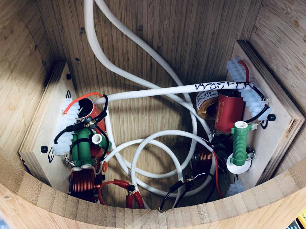

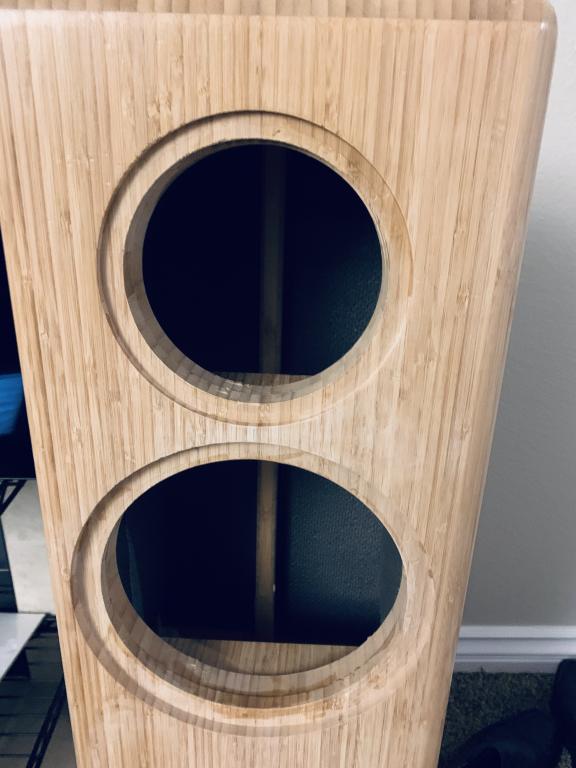

            The PR will be surface mounted on the rear of the cabinet down low. I'm hoping for a little extra boundary reinforcement for the low-end, plus it makes a conveniently large opening through which to mess with crossovers. The spine board provided support for the final pass with the Jasper Jig, but I did need to use a Japanese pull saw to cut all the way through.

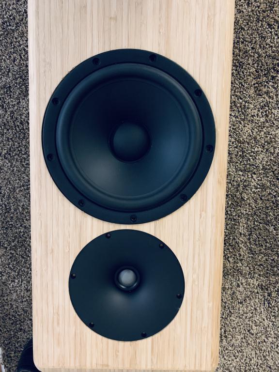

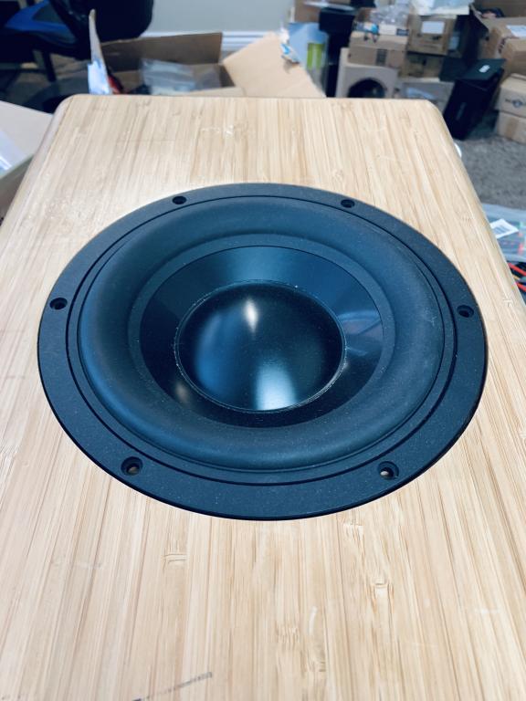

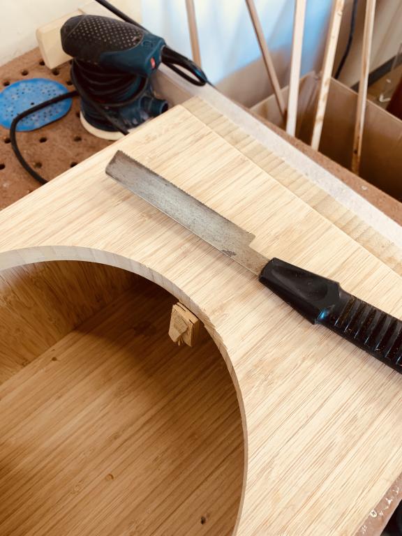

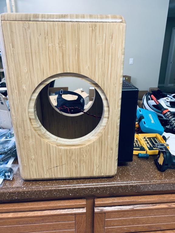

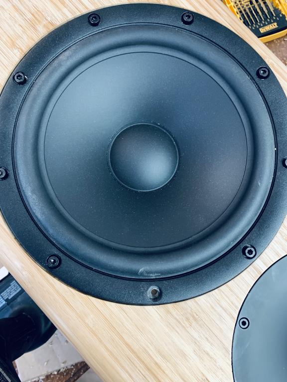

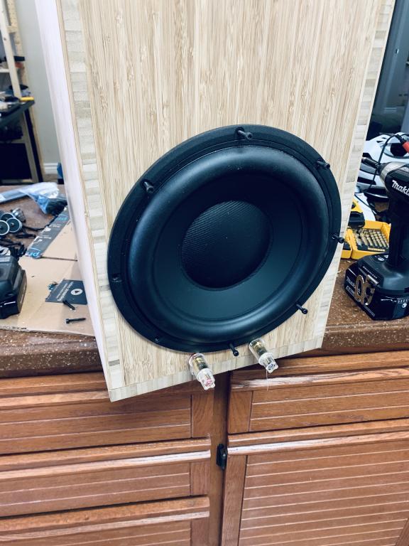

            Here is a test fit of the drivers in their recesses. The woofer is a little proud, and the tweeter is a touch deep. Measuring plunge depth on my little Makita router is a challenge. I'll invest in a digital depth gauge before Saturday's work day where I can take a rabbeting bit to add some depth to the woofer recess. I'm off by maybe 1/8" (3mm).

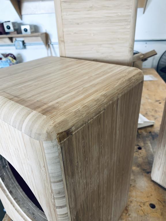

              Am I this big of an idiot?

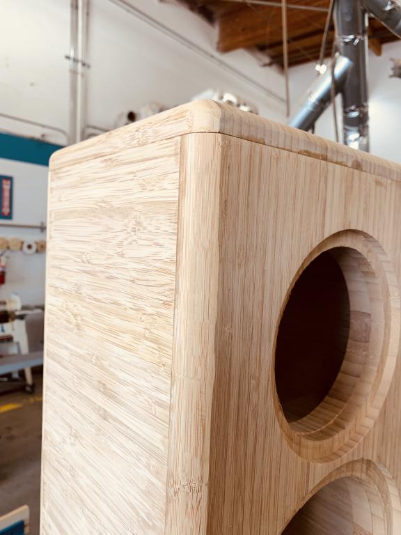

              One of the problems of using the SDFWA shop is that you have to "pack it in, and pack it out". As a result, I did leave the in-progress pieces in the back of my SUV for the three weeks that I was working on this. San Diego weather is weird because you have almost all of the radiant heat from the sun of the local deserts, but you have a cool to cold sea breeze that makes the ambient temperature generally pleasant all year. It can fool you. Er, well, it can fool me. Despite solar tinting and parking in the shade, etc., I think a couple of the pieces that were most exposed did warp a bit between the table saw and glue-up. I wasn't willing to lose mass/material using the jointer, planer and surfacing sander (plus the risk of tear-out!), so I tried to using clamping pressure the fix the issues in glue-up. With Bessey clamps, this is more doable than it otherwise might seem. But I don't have the eight pack of Bessey's that I left behind in Houston. So I had to deal with the shop clamps, plus the couple of 54" Bessey's I had invested in back in March.
              Then I added two more because my approach/plan was reliant on being able to use that monster parallel clamping force. I was only moderately successful, as you can see in the top left corner here.
              Close up

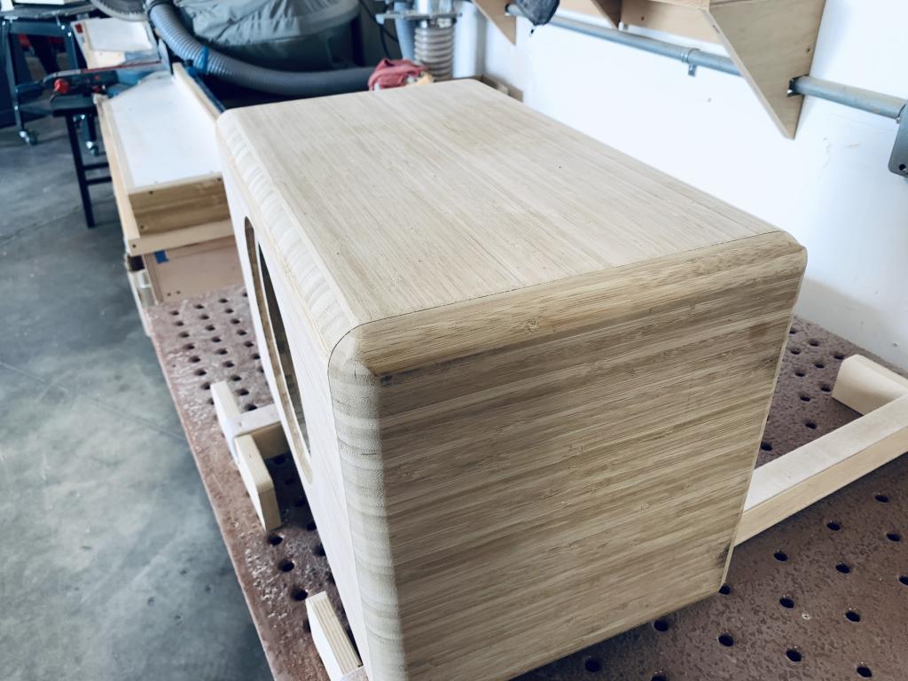

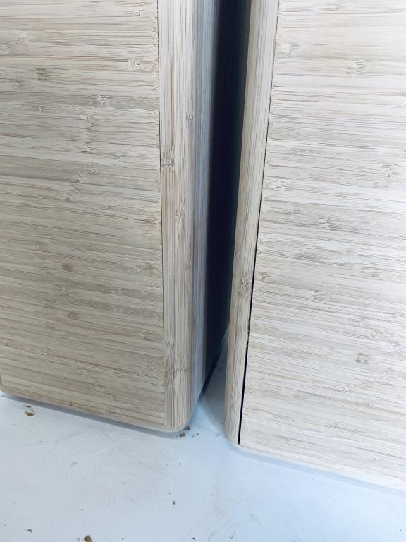

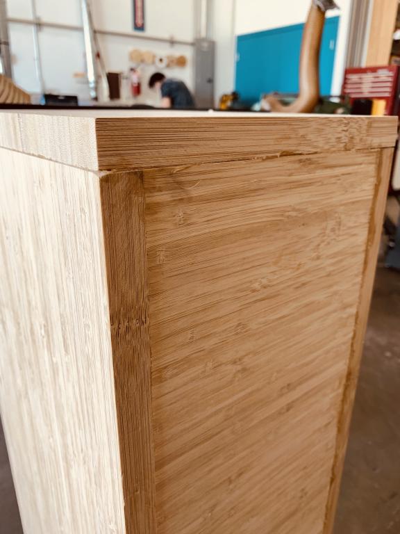

              Aside from the acoustic (diffraction) benefits of a roundover, it also helps smooth the transition from one surface to another. This is a different corner after the 3/4" bit has done its work (I stepped into it -- I didn't just go straight to the 3/4!).

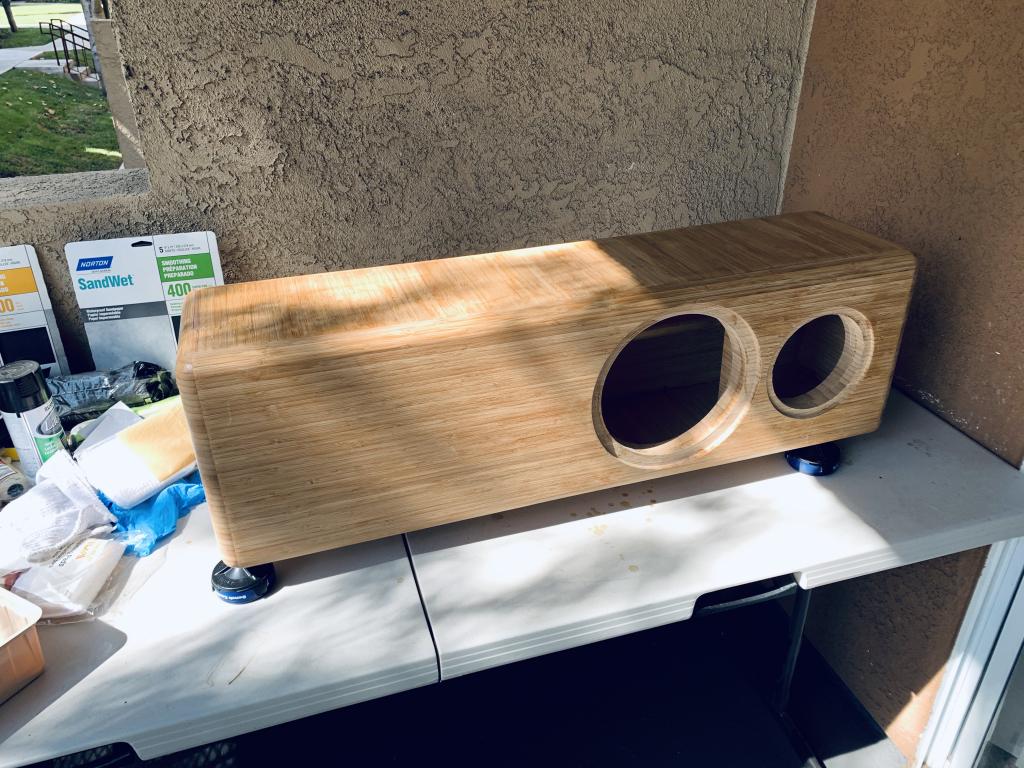

                    Sanding Ego

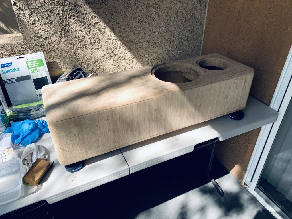

                    Yesterday was sanding day. I also put the subwoofer box up against my new 1" roundover to see if I could clean a few areas where I got some tear-out with the 3/4" bit. That was mostly a success. I did get some odd "points" on the corners where three different passes of the roundover bit came together. I was a little surprised at that, but my hypothesis is that they are caused by the intersecting panels not being 90 degrees to each other. I had to spend some careful moments kissing these nubbins up against the big, burly table belt sander. Plus a ton of sanding pads for my Makita 5" random orbital.
                    Corner detail (subwoofer box):
                    Putting the Sand in Sandy Ego. The downdraft table works even better when you remember to turn it on.
                    I have not used the carbonized bamboo until this set of builds. I am curious as to whether I just sanded away all of the carbonized color, and I am left with the bare bamboo. I'd really like a darker color than what I got with the natural bamboo color the last time, and something a bit darker than a typical hard maple.
                    I now believe that Freud SandNet discs last 10x longer than traditional discs only once they hit a landfill. I sure chewed through a ton of them. This was ~20 discs in total, with the bulk being the 80 grit rough sand and then the 400 grit finish. Oddly, the 180 grit middle pass had the greatest longevity. I do have to comment that I really like the way the fine sanding makes the wood feel. It almost feels like a warm stone, rather than a wood. That tactile quality was one of the main factors that drove me to choose the material.
                    Here is a close-up of my main shame on the build. I'll need to look into some form of filler to hide that gap.

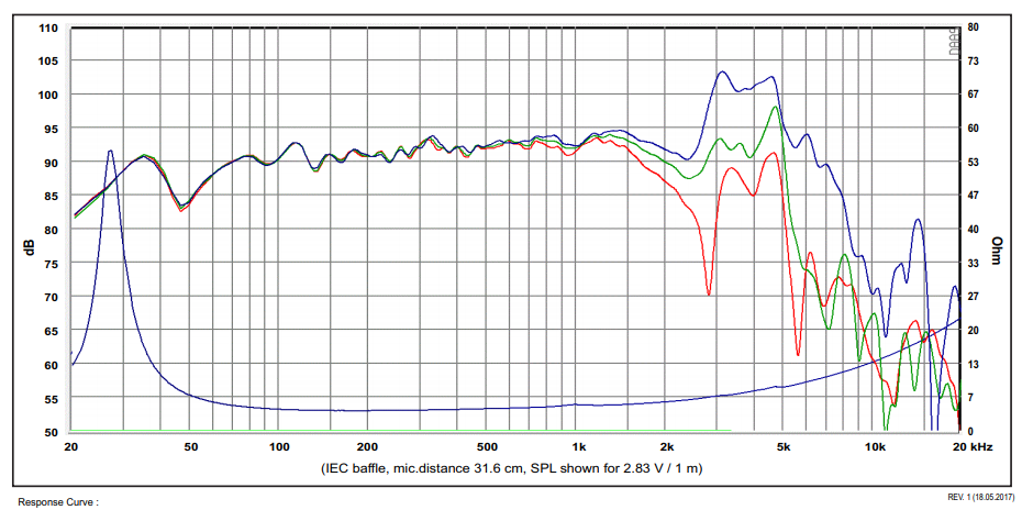

                            • 16194
                            Thanks for keeping us posted, Bear, and sharing all the messy details as the construction progresses- many prefer just to share the final product and not the tears and fears that can occur during the problem solving process, but those are very useful to new entrants to this endeavor so that they have a realistic notion of how issues can be successfully dealt with during the course of construction of a new project with new materials, tools, and techniques- adaptability for problem solving is always important.
                              Originally posted by bambadoo
                              Very interesting project. It is still very unclear for me whether that WG tweeter is available for purchase or not. Still no datasheet.

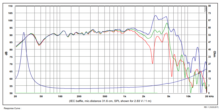

                              they are shipping and available, but I have suspicions that the delay in the data sheet is due to the lack of desire to publish the most expected data for this kind of part, the frequency response versus measurement axis.
                              The pair I bought and measured last summer have a smooth overall response, but increasing fall off at high frequencies as you go off axis- a steady increase in the downslope of response. they do not come close to matching custom waveguides with the original RS28a tweeter fabricated a few years ago. I suspect the wide surround and the resulting gap between the throat and the dome edge may be a factor in this performance.

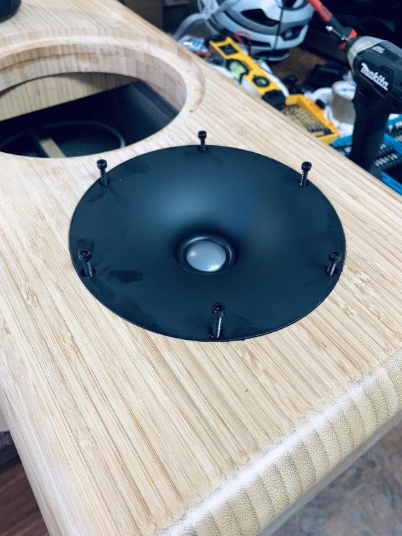

                                  • 1044

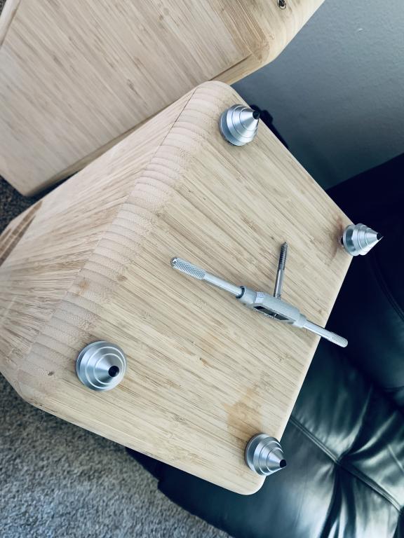

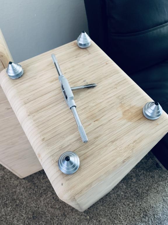

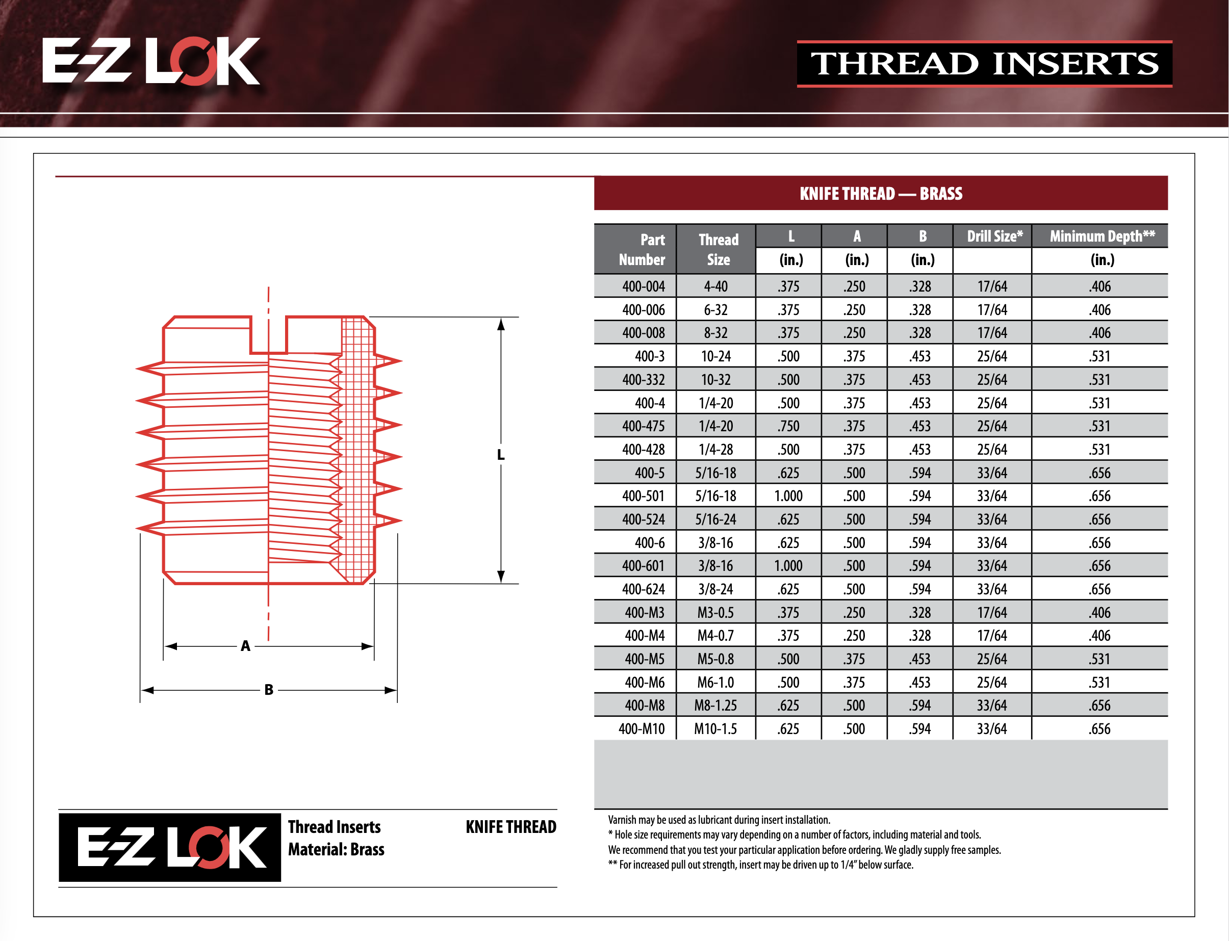

                                  EZ Lock? Not as EZ for me
                                  So, this will be a couple of catch-up posts since I spent a fair bit of time on other things the last several weeks. Let's start with getting some feet on these things. Attractive outriggers are ... Not Cheap. I have carried a set of Via Blue spikes for a long, long time, and since I couldn't find outriggers at a price I was willing to pay, these are being called into service.
                                  So, I grabbed some M6 EZ Lock inserts and the relevant drill bit. Yet again, I think I need to heed the advice given to me and slightly oversize the holes for the inserts. Of the eight that I did, four had problems, with two of them being severe. Also, being a novice, I got too much epoxy in the insert, causing issues (top right was the worst).
                                  However, an M6 tap and just a touch of effort was able to materially improve things. I'll need to go back and caulk several of the holes that went through the bottom of the cabinet before I close them up. Also, I'll need to adjust the feet to level the speaker, but at least the spikes are within a couple of millimeters of each other as a starting point.
                                  You can also see the excess epoxy that I had to sand prior to finishing them.

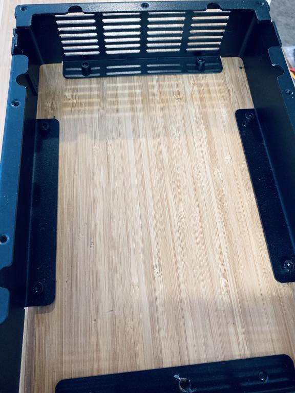

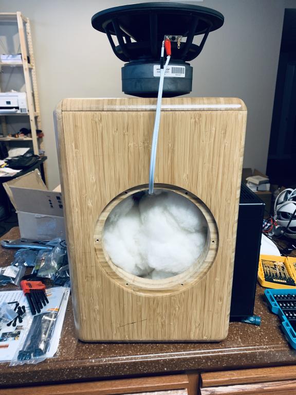

                                    Subwoofer gets closer

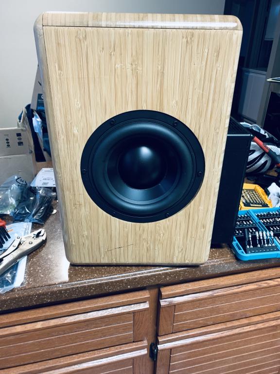

                                    The dual subwoofer cabinet that is my lemons-into-lemonade test mule is getting really close to completion at this point. It was the first through the big roundover bit to see what that would do. It was the first cabinet to go through the finishing process (three coats of MinWax Wipe-On Poly), and it will be the first to get buttoned up.
                                    Because I didn't want to scavenge any more cabinet volume than my haphazard build approach had left me, I decided to mount the amp externally in a bracket I got from PE. I don't expect that the amp will be anything special, but these should just be low bass reinforcement for the Helios. It also helped my decision that the plate amp specifically said that it was not sealed and that a separate sub-chamber would need to be built. I'll just hide it on the back of the box.
                                    Mounting the amp bracket:
                                    Getting close
                                    PR223 used to drill screw holes. I'm yet again trying to use the socket head wood screws, but with a larger pilot hole (11/32) this time.

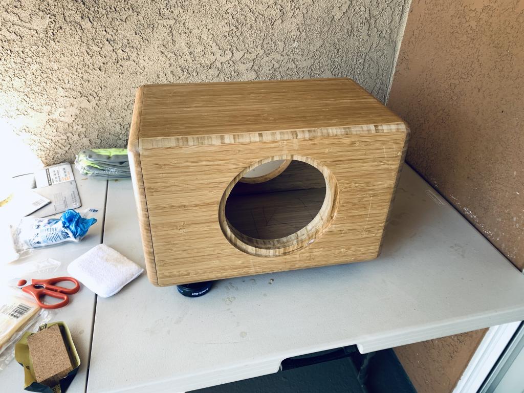

                                      The Finish Line?
                                      Having gotten Not Terrible results with the subwoofer box, I started on the towers next. The goal was to get three coats of wipe-on poly for each cabinet, aiming for a satin (less reflective) finish since I care about video quality first and foremost (e.g., CalMan).
                                      The process was a little bit evolving. The process for cabinet #1 was:
                                      • Wipe down the cabinet with a tack cloth
                                      • Apply the poly on all six sides
                                      • Wipe off the excess with a staining pad
                                      • Dry for 2 - 24 hours
                                      • Lightly sand with 400 grit, and repeat
                                      I got a couple of runs that had to be sanded away, so for cabinet #2, I spread the poly then wiped. I still got a couple of runs from excess poly, but a lot fewer. I hadn't realized that I was putting that much onto the cabinet for it to run that way. Again, learning....
                                      Here we go:
                                      In-process:
                                      Comparison between the two before the second was finished.
                                      I ran a 0000 steel wool pad over the first cabinet, but that didn't seem to do much. That may be a result of my sanding the wood itself down to 400 grit before I ever started finishing. I've got some beeswax that may go on as a final buff before I load them up.
                                        • 2141
                                        [ATTACH=CONFIG]30760[/ATTACH]
                                        [ATTACH=CONFIG]30761[/ATTACH]
                                        Looking good Bear. I use those ViaBlues a lot. As an FYI on the hole size for the inserts and bamboo, go 5% over size as well as chamfer the holes, works like a charm. McMaster Carr is a good source for crazy sized bits to do the 5% over. Also, I found these a while back. https://www.amazon.com/dp/B07SNSMW7D...v_ov_lig_dp_it. Jon is using them on the Ardent D test cabinets ..... very well built was his impression of them.
                                          • 1044
                                          Thanks, Steve. I wish that I'd found this before I bought the kit:
                                          The drill bit that EZ Lok includes in their installation kit is ridiculously sharp for a drill bit, but it looks like a 13/32 bit would do the trick, and I've already got one of those.
                                          Also, I found these a while back. https://www.amazon.com/dp/B07SNSMW7D/?coliid=I53MFNVRNENJY&colid=1VRILJ6X65H23&psc=1&re f_=lv_ov_lig_dp_it. Jon is using them on the Ardent D test cabinets ..... very well built was his impression of them.
                                          Solid tip, thanks! I'll look into those for my next tower. A center channel and surrounds are next on the agenda, and those shouldn't require feet, unless I'm doing something wrong.
                                          Last edited by theSven; 09 April 2023, 04:00 Sunday. Reason: Update image location
                                            • 2141
                                            Yeah, I don't know what they use for wood to obtain their numbers, but as you found out with bamboo it's too small. I've gotten in the habit if I try a new material, I do some testing up front before I screw up the real parts. You might waste an insert or two, but it's a lot less frustrating in the long run.
                                              • 1044
                                              The other thing that I found with the EZ Lok bit was that it really needed a stop collar. A standard tape flag just didn't work beyond the first hole. Yeah, I'm learning to increase my waste factor and practice, practice, practice.
                                                • 1044
                                                No good deed goes unpunished...
                                                So, the plate amp has to go back, and PE won't have stock until the end of November. It was straight-up DOA - no 'magic smoke' ceremony at all. My summer of a new system may turn into a Christmas present. Maybe.
                                                The subwoofer box (~24L) is stuffed with 1lb (0.4kg) of wool, which should get close to the 1.2 - 1.4lb/cf that approximates the "heavily stuffed" setting in Unibox. The subs are a pair SW223BD03s that I got from Solen before PE took over distributing Wavecor in the U.S.
                                                I wish this was a finished look, but I've got six weeks to wait before the replacement amp shows up.
                                                I also installed 0.75" of Sonic Barrier into the towers.

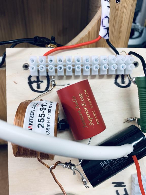

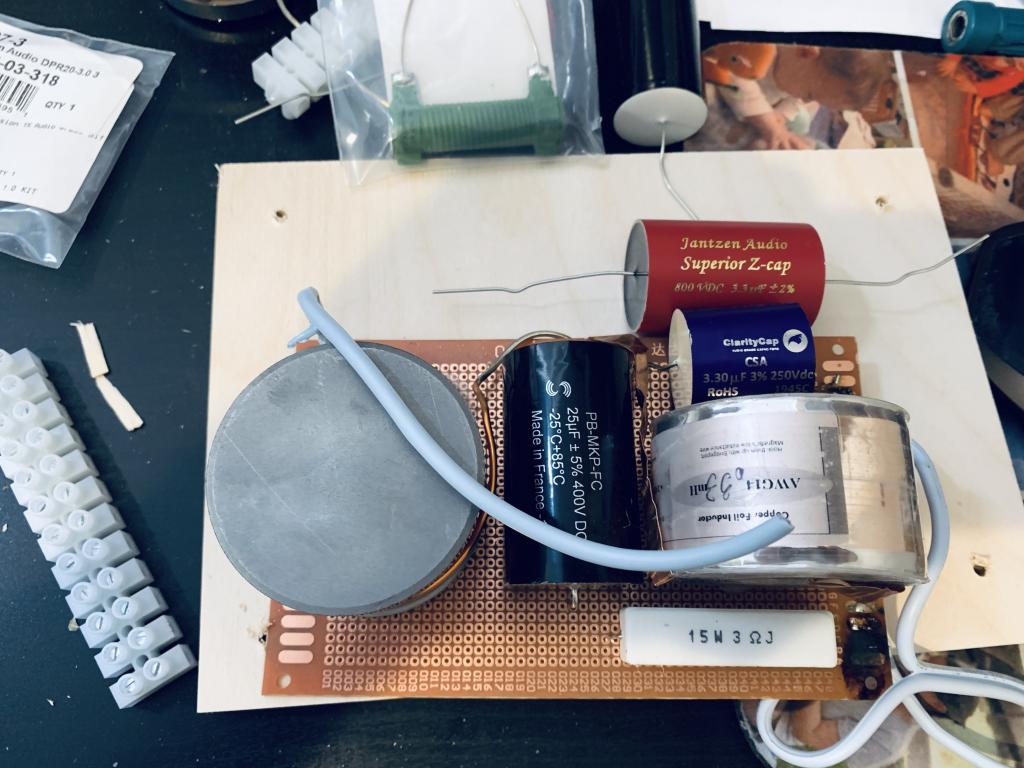

                                                  • 1044

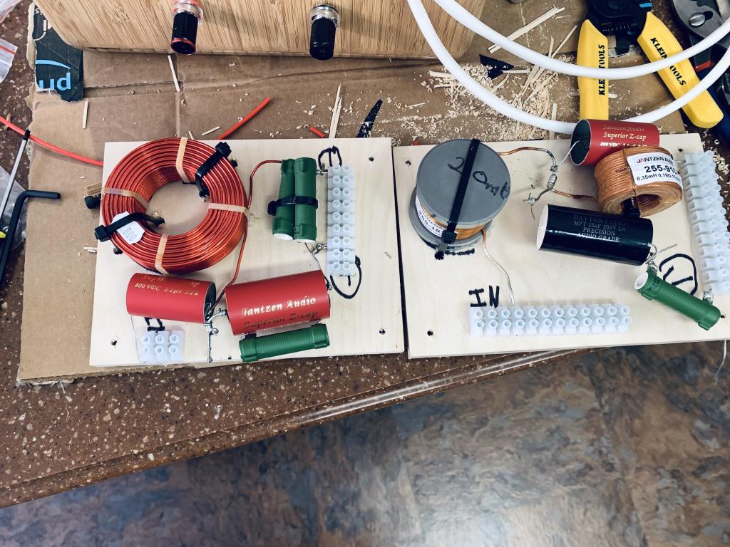

                                                  Cross with Crossovers
                                                  With the Sonic Barrier in place, it's time for the electrical work. I "upgraded" from the Clarity CSA caps to Jantzen Superior. I doubt that I'd ever hear the difference, but the higher spec is appreciated. Also note that I was able to find a 0.35mH inductor, as-specified, rather than substituting the 0.33mH foil inductor. However, since my DCR budget was about 0.3Ohms, it was still an expensive, Litz wire part.
                                                  Size comparison: Jantzen Superior vs Clarity CSA 3.3uF capacitors
                                                  All told, I'm at $200/side with this set of crossovers, rather than $100/side with the first attempt. Realistically, if I'd have used the Eurobus terminals in round 1, then I'd have just re-used those. The terminal strips are cheap and they made hookup so much easier than in any of my prior builds. Highly recommended.
                                                  The tweeter board is on the left, and the Woofer board is on the right.
                                                  The 14ga 1.8mH inductor on the tweeter board is probably overkill from a DCR perspective. The higher gage options were both cheaper and more compact. All of the inductors are held down with hot glue and nylon electrical "zip" ties. The Eurobus strips were held down with just hot glue. I drilled pilot holes at the corners for a 4mm socket head wood screw, but I only ended up using 2 per board.
                                                  Spot the wiring error. After a right shift (thanks for finding that Audyssey!), everything was good.

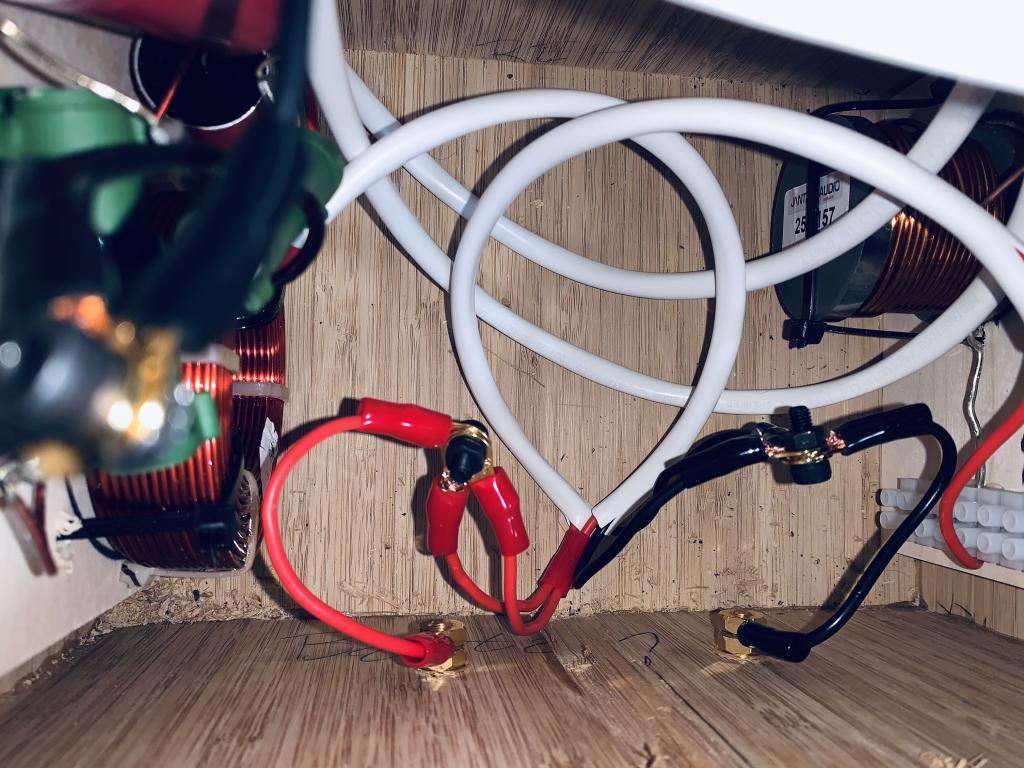

                                                  Boards are installed on the side walls. Getting my impact driver into the cabinet was actually somewhat annoying for the far (front) screws.
                                                  The Parts Express binding posts continue to annoy me with how short they are. I had bought longer, non-PE ones from Amazon (as recommended by Jon and Steve), but I didn't have big enough ring terminals to fit over them. Since I ended up having to use a bunch of ring terminals to make a T-junction (M512mm through bolt) anyway, then I could have used those instead. Note: invest in some 8mm ring terminals for next time.
                                                  I did use a damp towel to clean out a fair bit of the residual saw dust. After that, I'll just say that if I were a chef, I'd call that "rustic" and charge you an extra $10 for the privilege.
                                                    • 1044
                                                    Putting things into overdrive(r)
                                                    Here are the obligatory photos for installing the drivers. The only trick is making sure that the mounting holes line-up with the pilot holes. It's a good idea to drive the first few screws no more than about halfway so that it is still possible to get everything aligned. As with putting a tire on a car, use a crisscross pattern.
                                                    The tweeter used M4 socket cap screws.
                                                    The woofer and the passive radiator were both installed with M5 screws.
                                                    Using an appropriately-sized pilot hole (a touch large, actually), and none of the screws snapped on installation.
                                                      • 1044

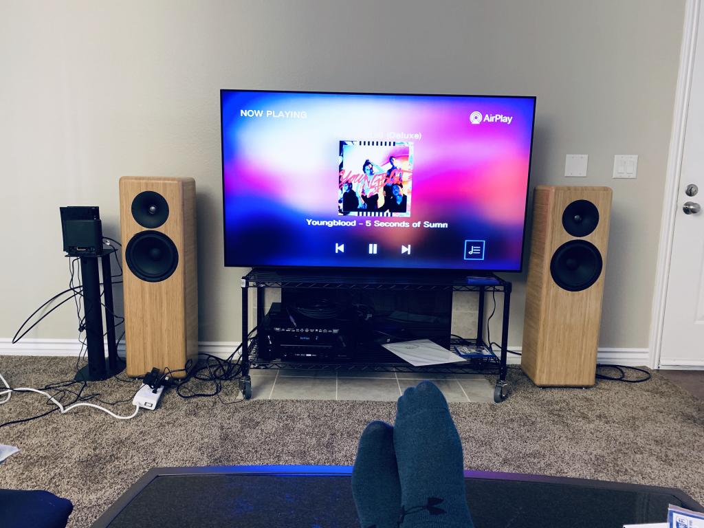

                                                      The End?
                                                      So, the build journey is over. Bass is decent, maybe even a touch on the boomy end of things, given the proximity to the wall and the rear mount for the PR. I'll play with that over the coming weeks. Already, I've got a night-and-day difference in audio quality over the POS sound bar.
                                                      Next up: a center channel and surrounds. Yol Bolsun (May there always be a road)!

                                                                              • Zvu
                                                                                • Oct 2013
                                                                                • 436
                                                                                Hey B,
                                                                                I have just checked the crossover for Helios and found a few measurements of it. I am a bit worried about midwoofer's slope. Here is the pic:
                                                                                Rounded bit is break up that is only 15dB under tweeter level. No point of using a midwoofer with -50dB distortion if resonance is gonna tickle your ears just -15dB at 3kHz. Problem is that even 60 degrees off axis it still persists almost at the same level as 1kHz in raw measurement. It is very visible here and quite strong.
                                                                                https://hificompass.com/en/speakers/...satori-wo24p-4
                                                                                I'm guessing that a tank filter (small capacitor and resistor in series conected across the midwoofer coil) would fix things significantly. If you have the time to disconnect the tweeter and measure it, i can suggest the tank values but you would probably have to tweak it a bit since i don't have the crossover schematic or raw measurements of woofer in that cabinet
                                                                                Last edited by theSven; 09 April 2023, 03:56 Sunday. Reason: Update image location
