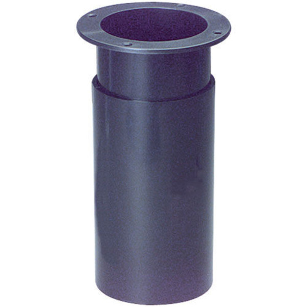

I'd like to make the MLTL version of the Doceros, which specify a 2.5" port (7.25" long). Parts Express has two ports advertised with a 2.5" I.D., but reviewers state that one is bigger (2.625"), and the other is smaller (2.25") for part of its length. Does anybody know where I can get a real 2.5" port? Are those size differences small enough to ignore?
Docero project
This is the 2.5" port I've used on some of my builds that works well. http://www.parts-express.com/parts-e...table--260-386 However, Meniscus should have a port that works well with the kit since it's their design. That said, the minor difference you're talking about in port diameter shouldn't make any difference at all.

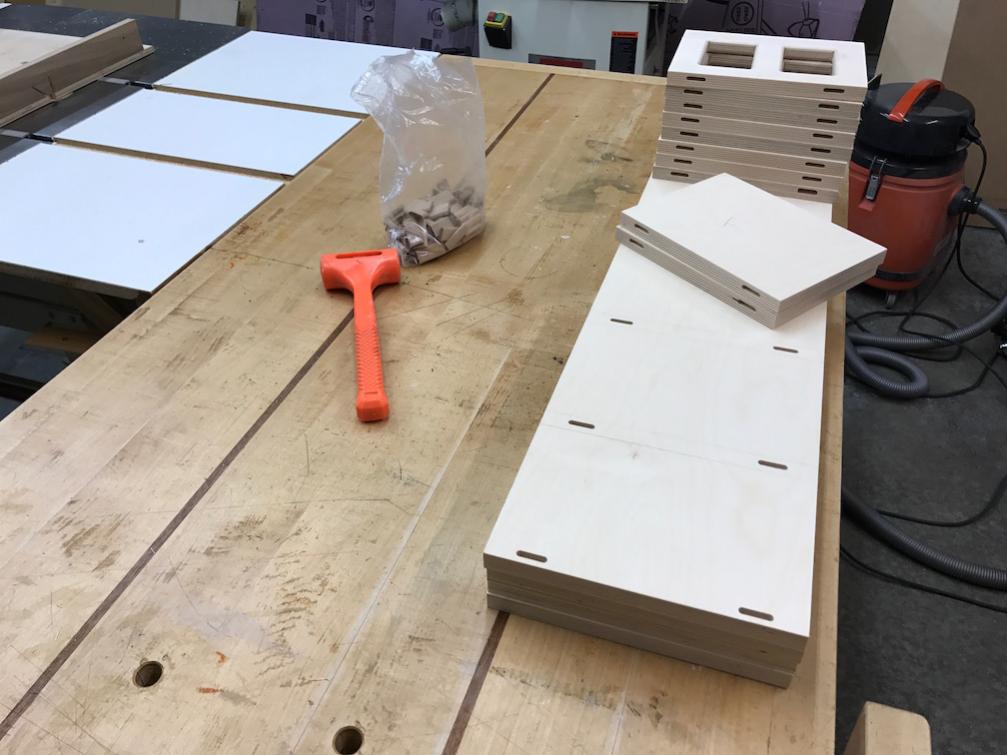

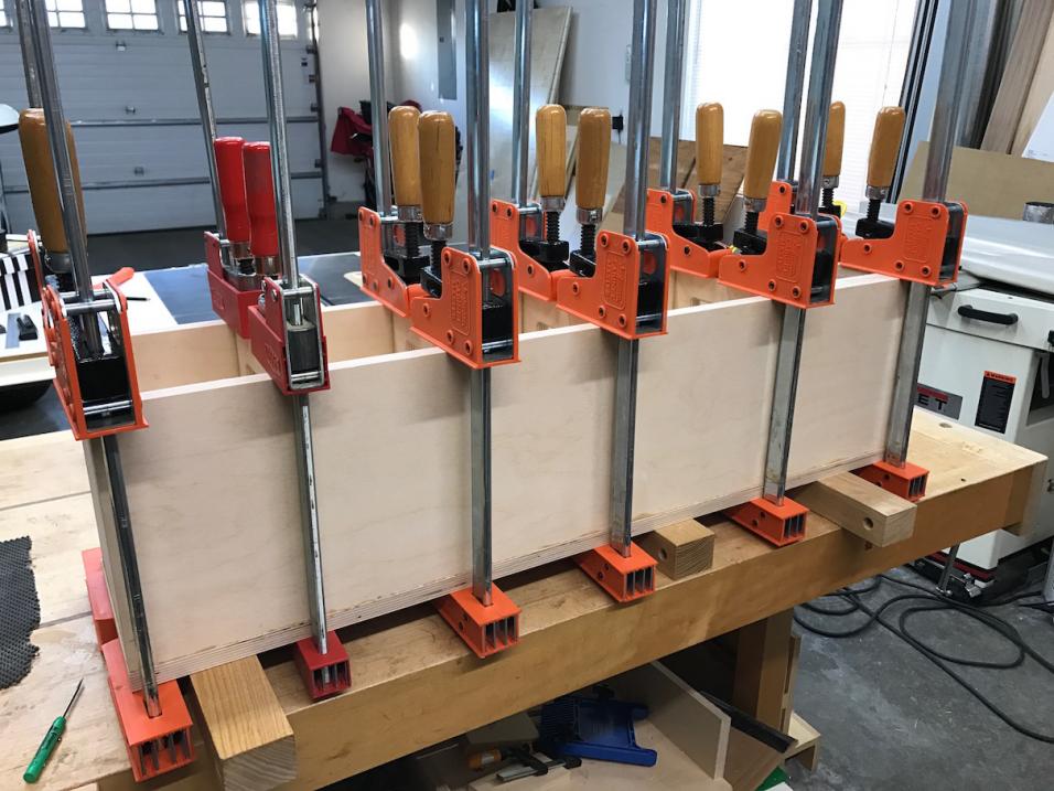

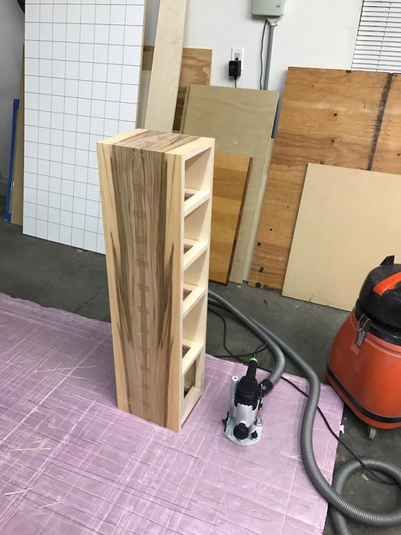

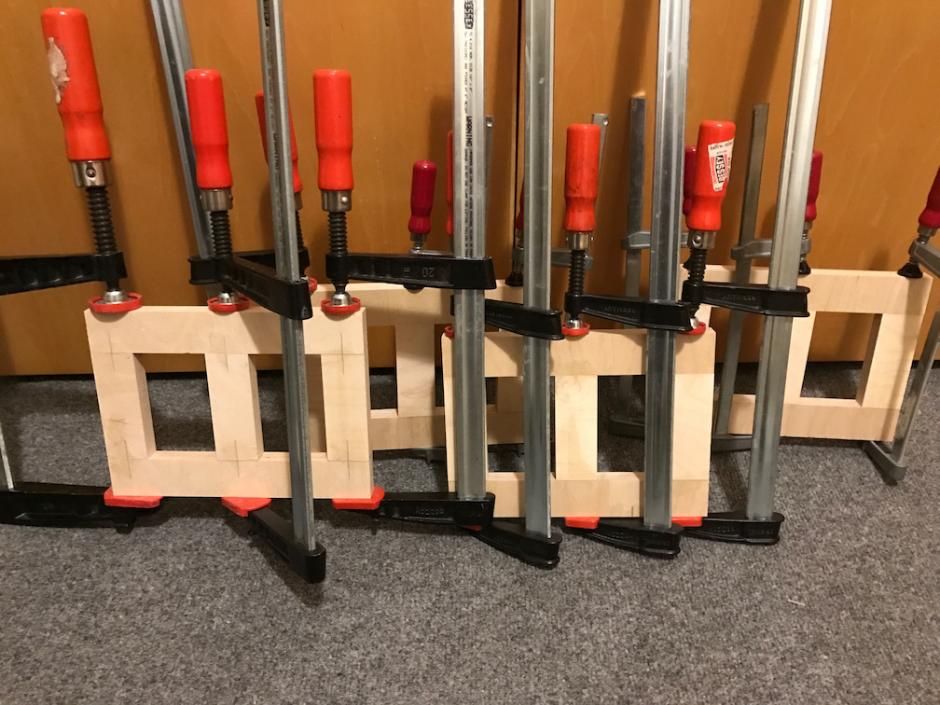

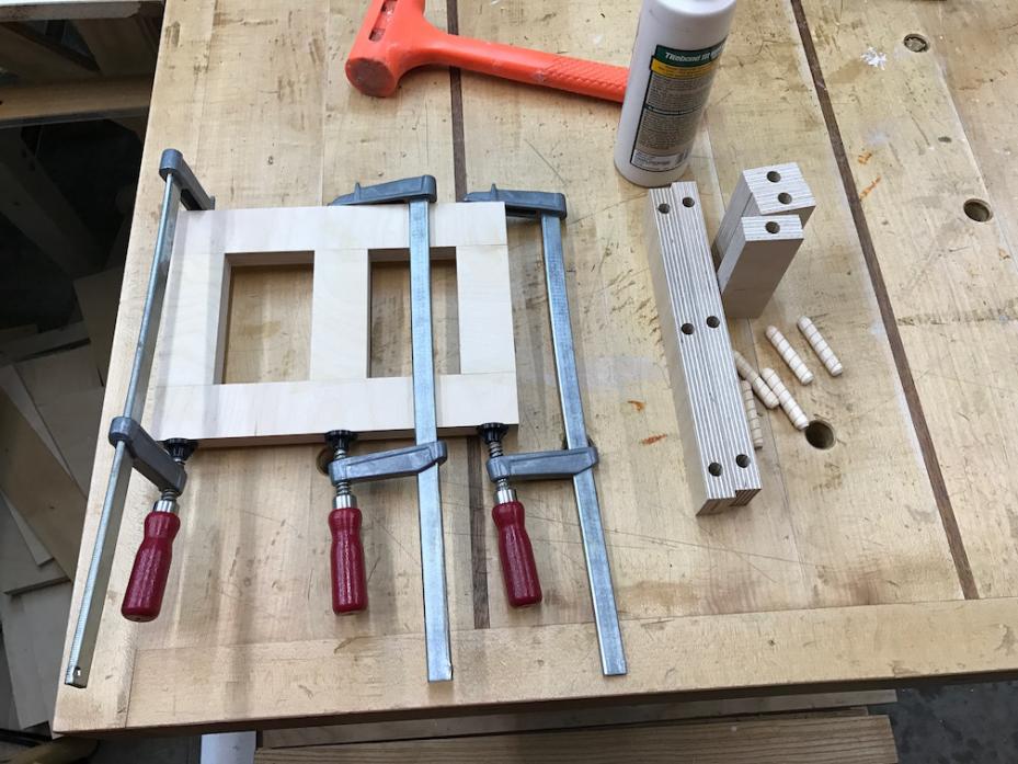

I used a dowel jig that automatically centers the drill bit on an edge. It works best for rail/stile type joinery, but I rarely use it anymore. This was a good opportunity to get rid of some scraps (including dowels) that I had lying around.
Yep, the other holes are for Dominos. I love those things!- Bottom

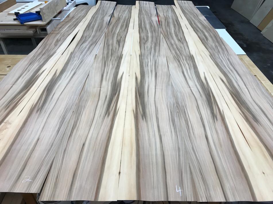

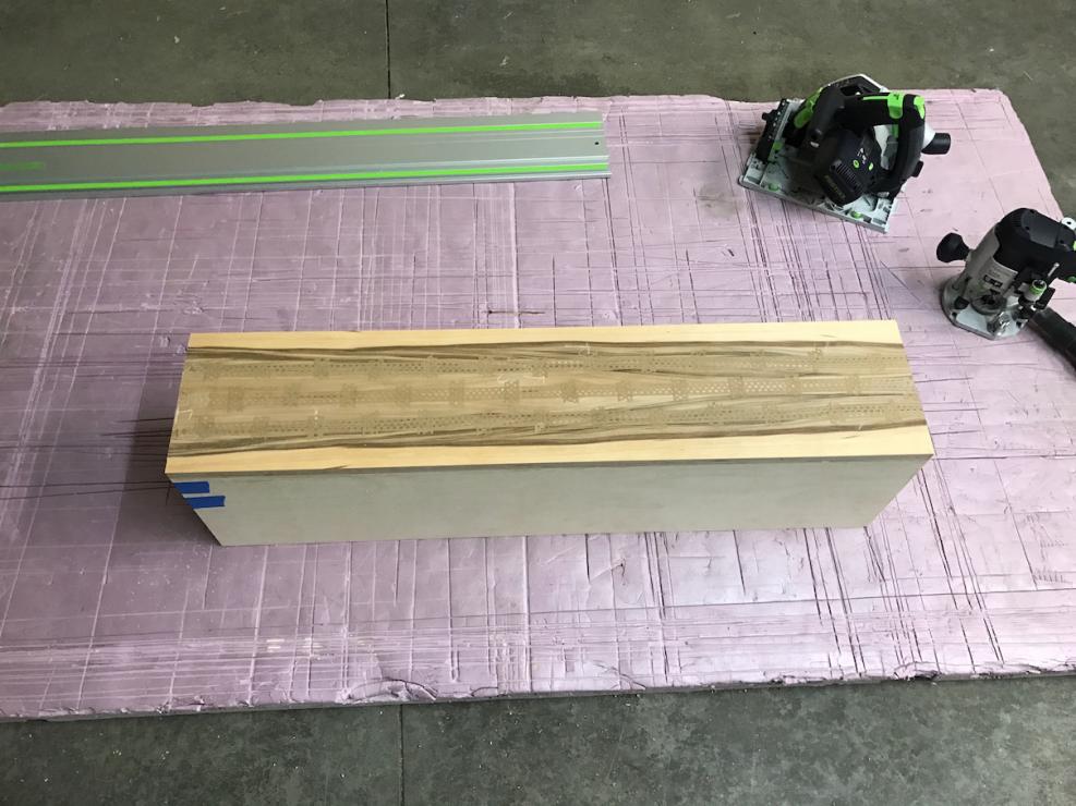

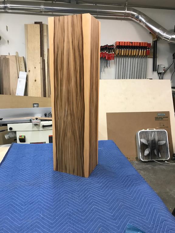

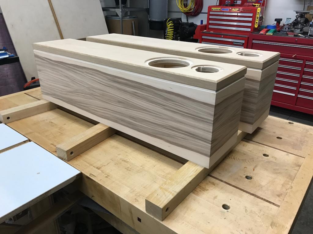

Love the look of the veneer, what is it?- Bottom
Red gum. I've never used it before, but it's domestic, which I prefer. I really dig the sapwood, but I wonder if it will look too busy on these little boxes.

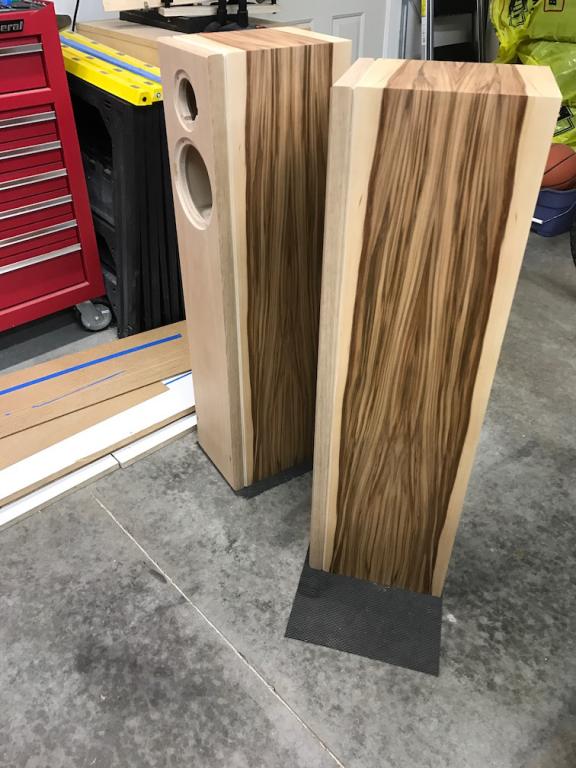

BTW, I think I mentioned in another thread that I didn't want to do another painted baffle, but my wife said she likes the look of black baffles, so here's me eating my words.- Bottom
At least from the pictures, a black baffle might work well in this case.Red gum. I've never used it before, but it's domestic, which I prefer. I really dig the sapwood, but I wonder if it will look too busy on these little boxes.

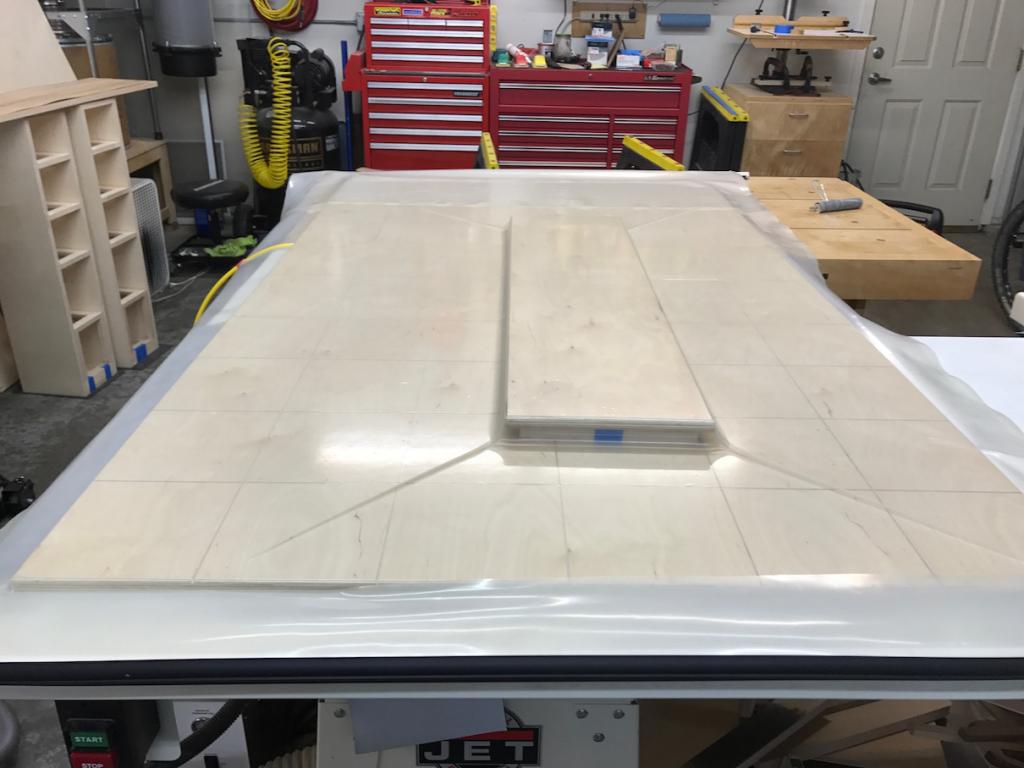

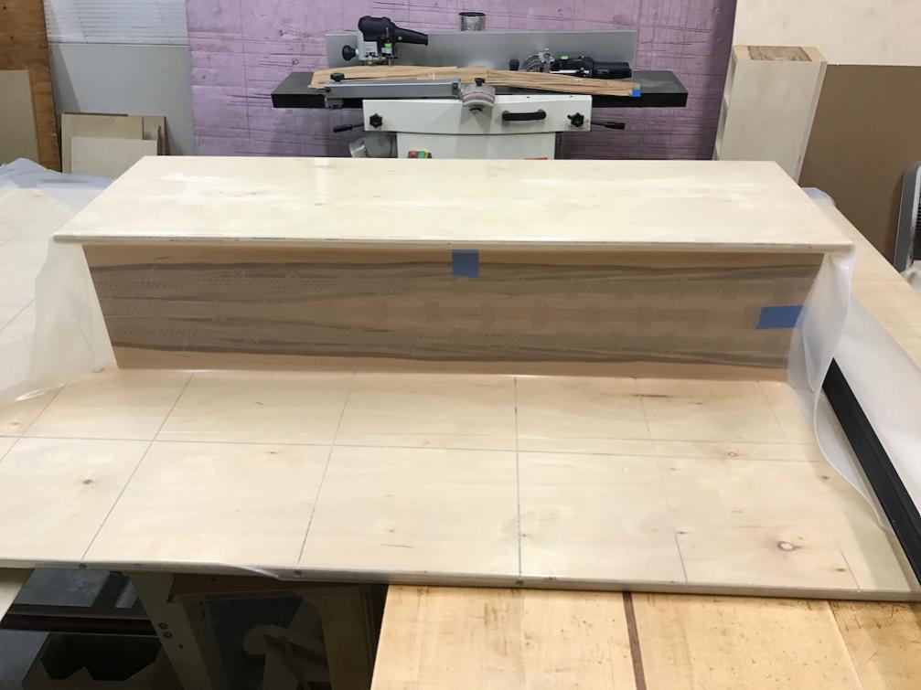

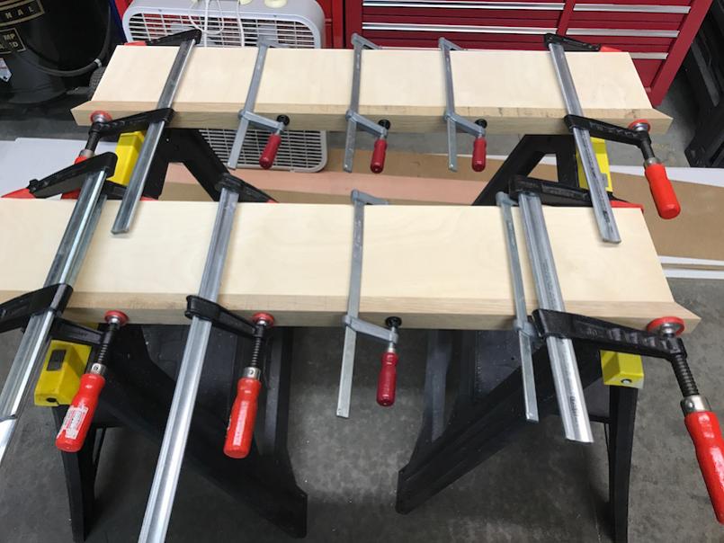

Thanks for the kind words. I glossed over the part where I ruined the veneer on the second panel I glued up, forcing me to completely rework my layout with barely enough left to cover the project. That's the kind of thing I was referencing earlier

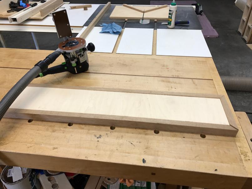

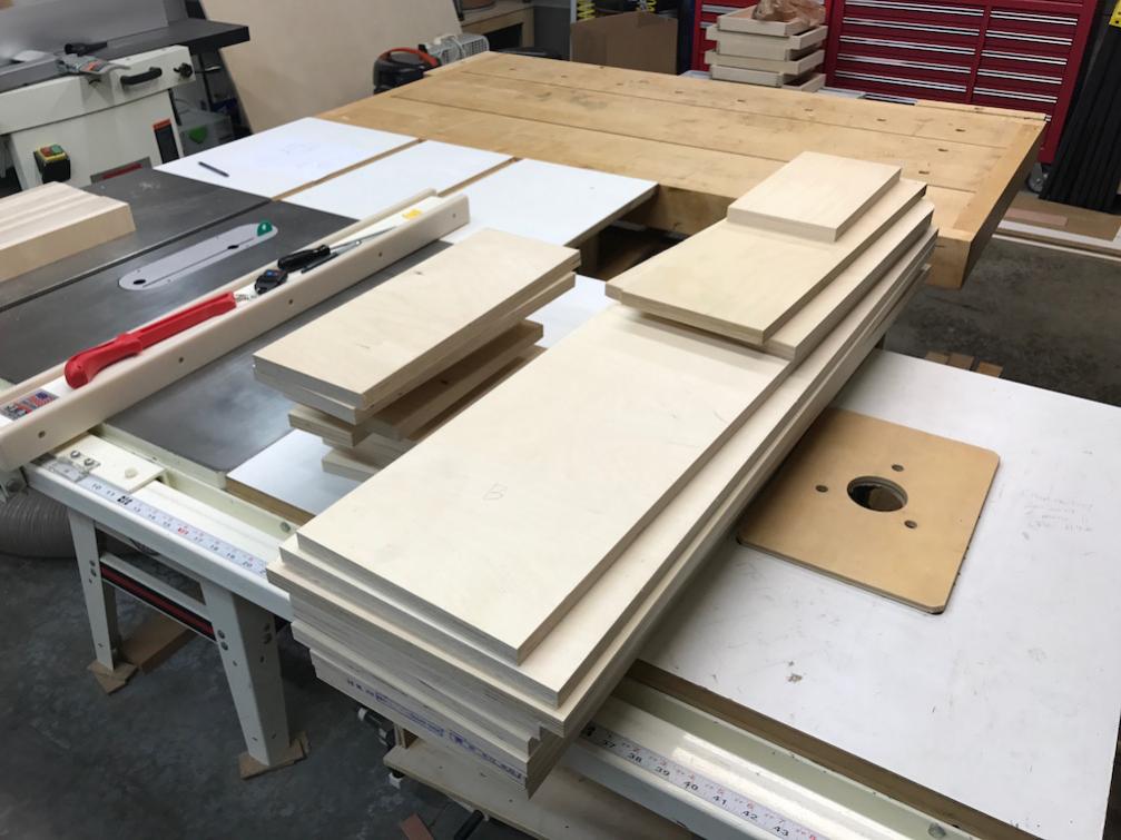

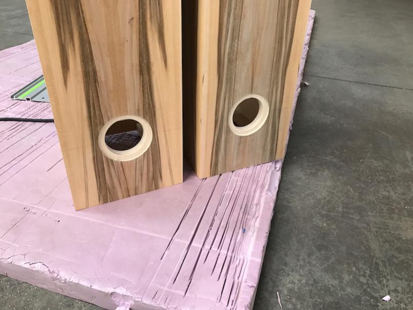

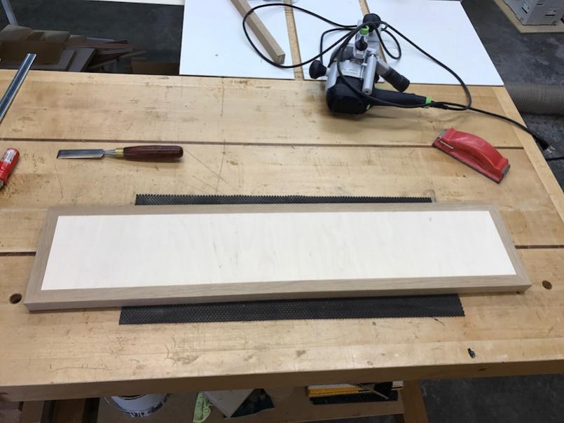

Got the ports fitted, and started working on the front baffles I had some extra plywood lying around, so I made them 1.25" thick.
I don't know about you guys, but after sanding, lippings are my least favorite task
. In any case, I'd was thinking of doing a chamfer or roundover, and I thought this would be easier than trying to wrap the veneer around.

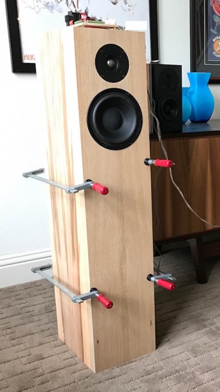

I was aiming to finish the baffles this weekend, and got 90% of the way there. I don't have any measurement equipment, but I gave them a quick listen, and I like the way they sound so far. Not surprisingly, they have more low end than the Speedsters, but perhaps more significantly, they aren't as laid back, and they sound bigger.

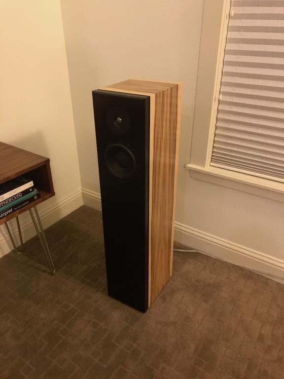

seriously good looking- Bottom

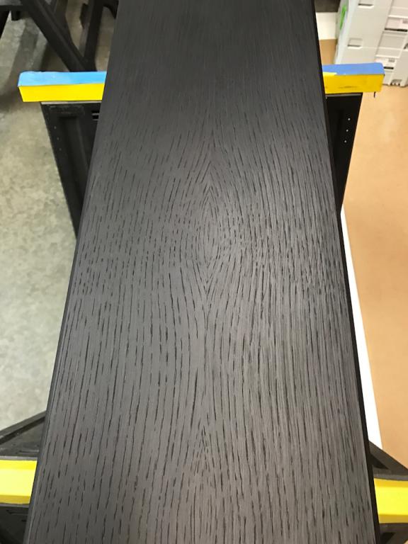

Looks like the ebonizing turned out really well.Not much progress to show on these, since I've been working on details and sanding. I decided to try "ebonizing" the baffles instead of painting them. So far, so good, but this is the first time I've tried this.
[ATTACH=CONFIG]27178[/ATTACH][ATTACH=CONFIG]27179[/ATTACH]- Bottom
agreed, the ebony finish is V nice!- Bottom
I think that they look VERY NICE!
