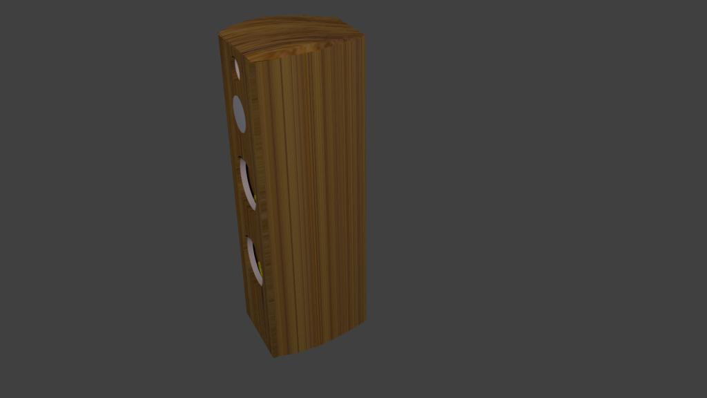

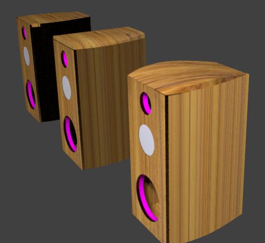

    I am posting some CAD screenshots to kick off the post:

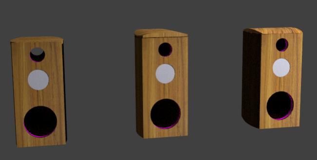

    Design Iteration #1, Finalists with different dome curve. I liked the front to back curve
ID:	872055Click image for larger version
ID:	872054Click image for larger version
ID:	872053Click image for larger version
ID:	872056Click image for larger version

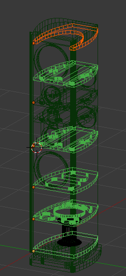

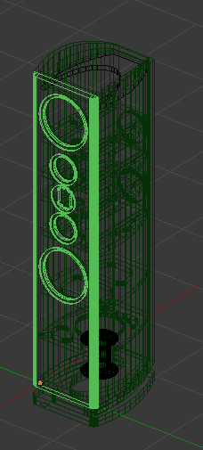

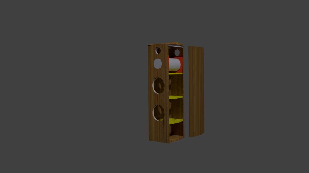

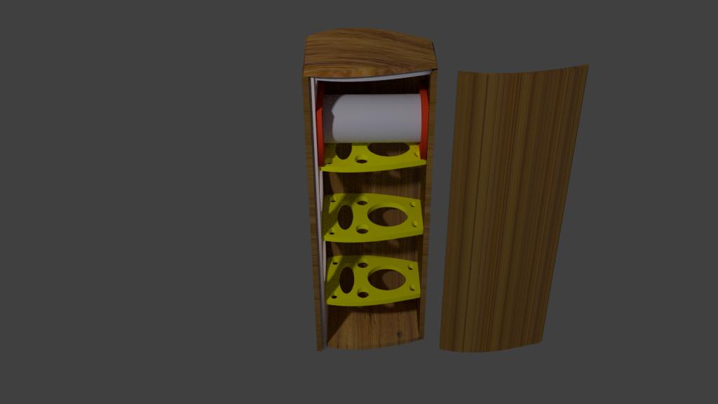

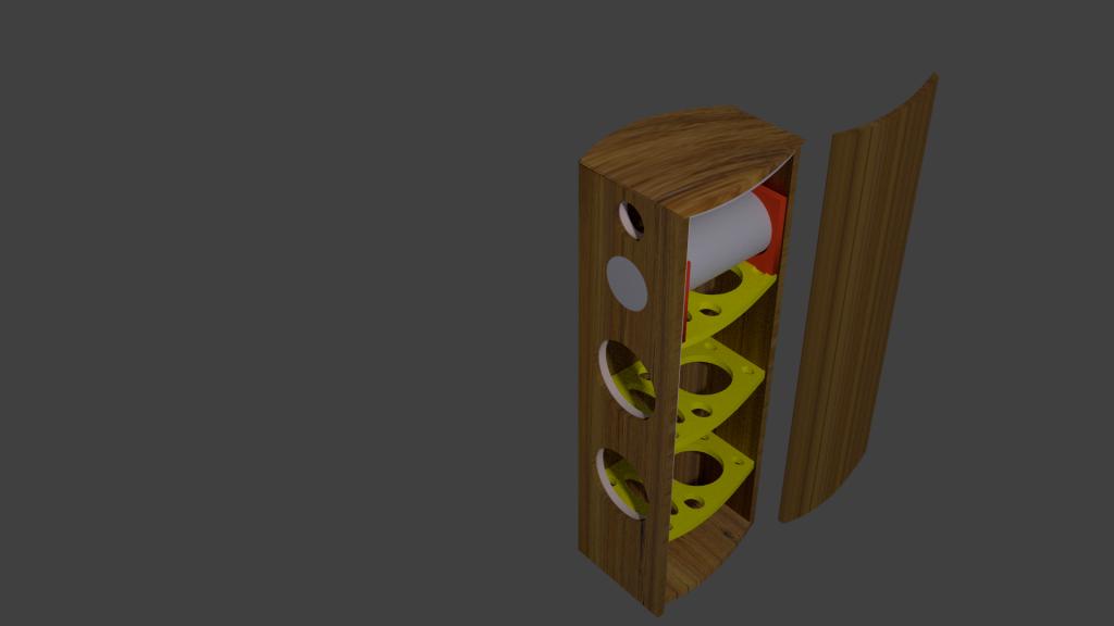

    Iteration #2 Finalists internals
    Design Iteration #2, drawing the curved finalists with internals.
ID:	862197Click image for larger version
ID:	862198Click image for larger version
ID:	862199Click image for larger version
ID:	862200Click image for larger version

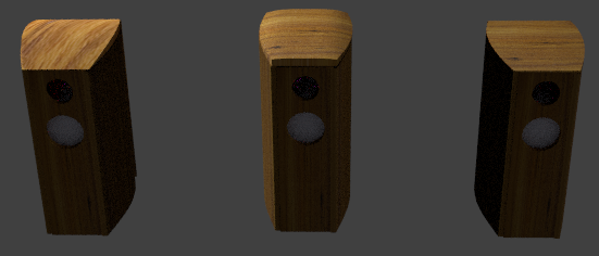

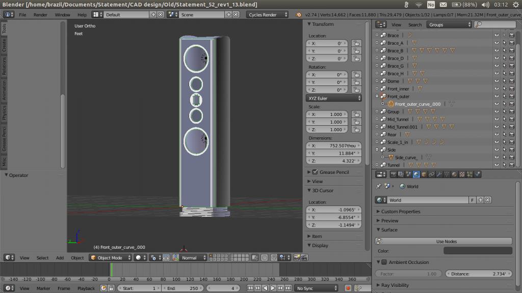

      Iteration #3 WTMTW statement II
      And this is iteration number III
      at this point I decided I wanted to go with the statements, curved side and curved dome. I really like the ribbon tweeter for some reason...

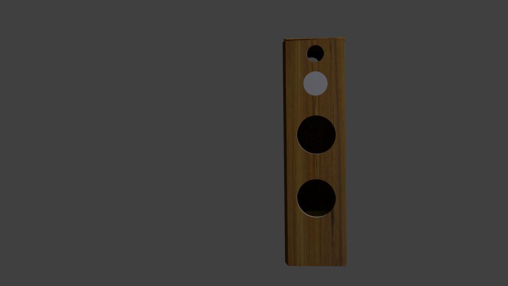

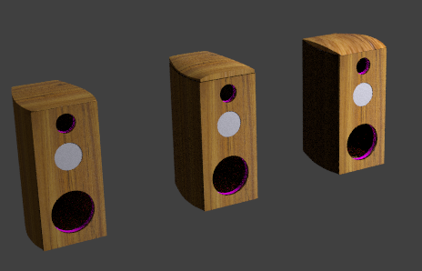

        Iteration IV - Truncated statements
        At this point, I decided that I wanted to go for truncated statements to reduce the height, and increase the WAF. According to Deewan, his truncated statements worked out great:

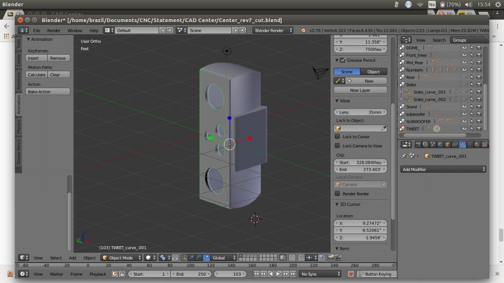

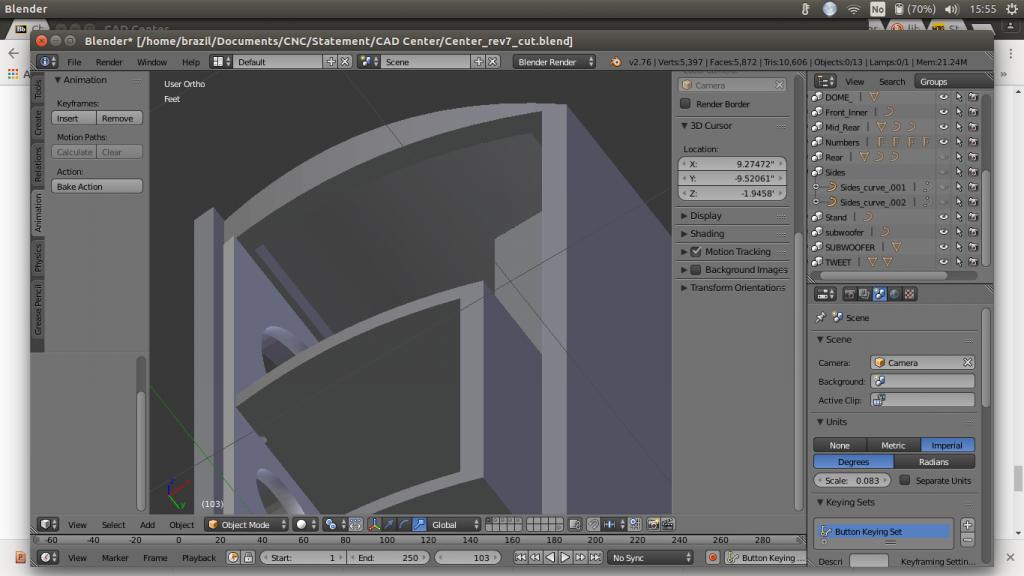

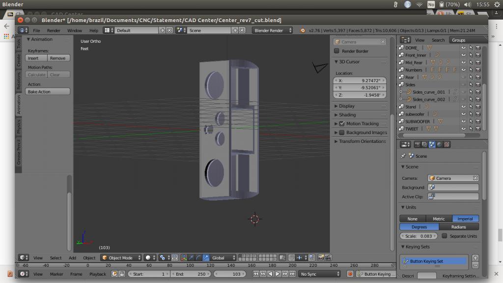

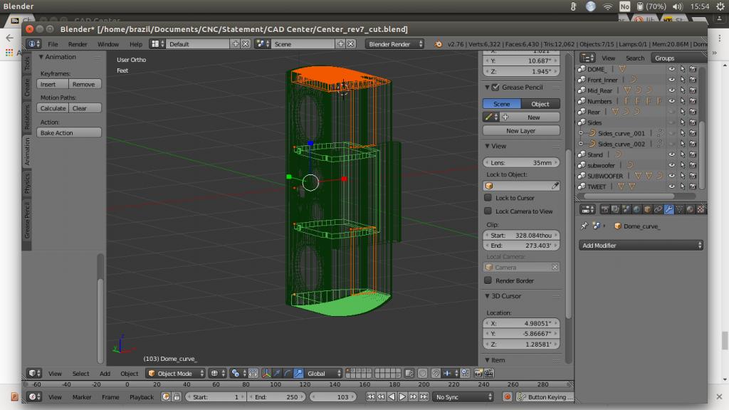

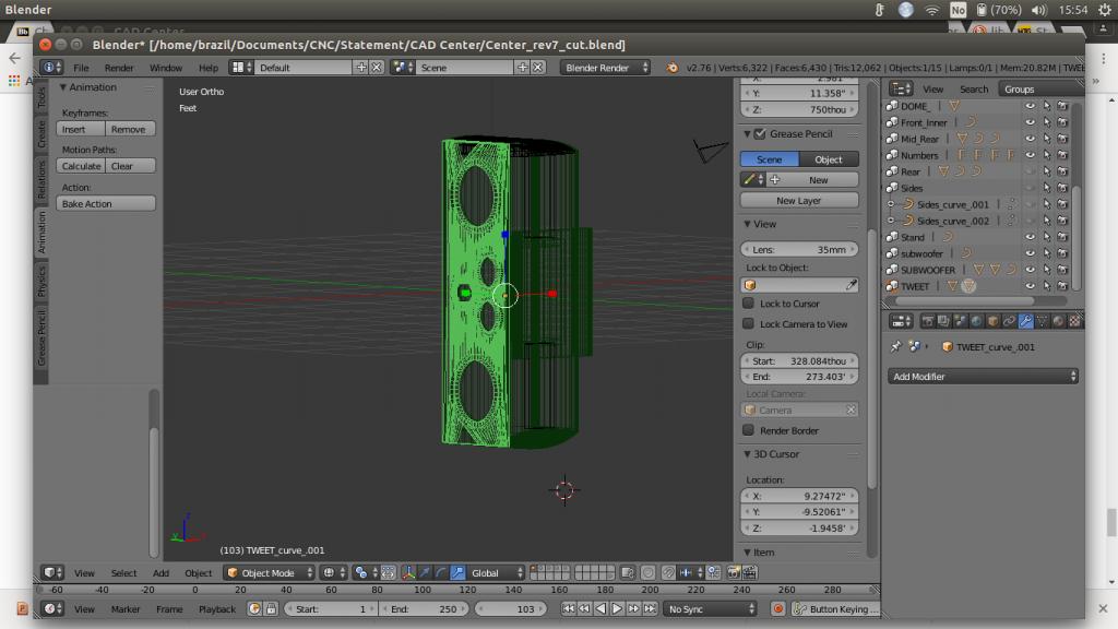

          Centre design
          And with the curved statements do go the curved centre speakers.
Name:	Screenshot from 2016-08-14 15-54-15.jpg
ID:	862212Click image for larger version
Name:	Screenshot from 2016-08-14 15-54-31.jpg
ID:	862213Click image for larger version
Name:	Screenshot from 2016-08-14 15-54-43.jpg
ID:	862214Click image for larger version
Name:	Screenshot from 2016-08-14 15-55-17.jpg
ID:	862215Click image for larger version
Name:	Screenshot from 2016-08-14 15-55-41.jpg

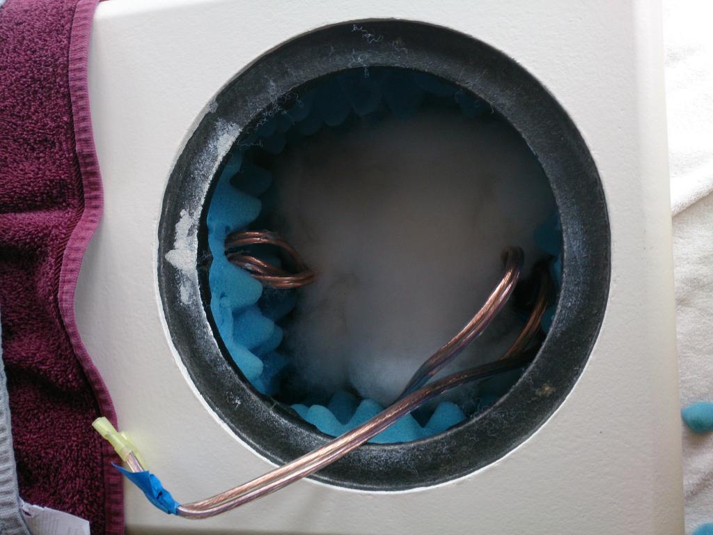

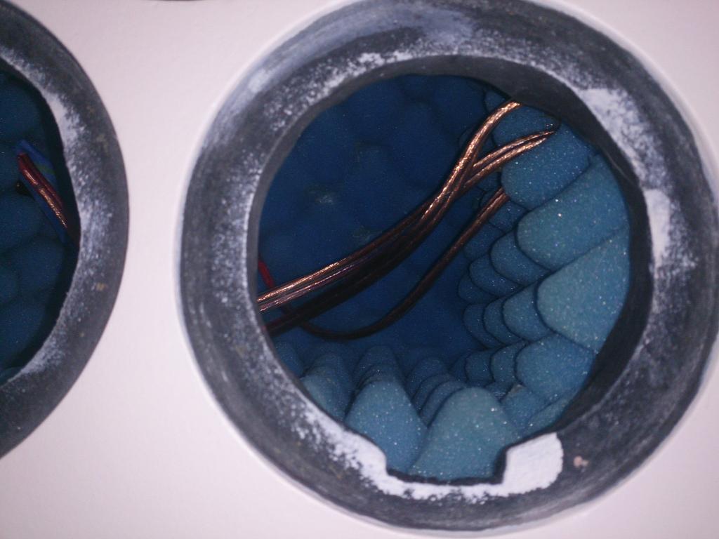

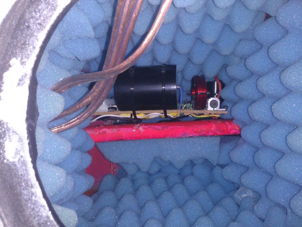

                  Liner
                  The design phase is over, and the parts have been cut. I will post some pictures of the process soon. In the mean time, I am thinking about the lining and the stuffing. This is what I am planning to use as liner for mid and woofer chambers:
                  Do you think this would work?
                  And planning to use stuffing for woofer (inter connection), mid chambers (as directed by Jim roughly 1/2 of mid chamber). Jim indicated that stuffing for the woofers is optional, how much should I use in the woofer section?
                    Hi Salty,
                    Make sure you can blow through the mattress foam which would indicate it's open cell foam and can be used for acoustic purposes. Closed cell foam will not work in speakers. The woofer and mid compartments should both be lined with foam everywhere you can see when looking through the driver cut out hole. I also included a 2-3 handfuls of fiber fill in the back 1/2 of the mid compartment. You can do the same in the woofer compartments too if you wish. Just be sure the fiber fill doesn't crowd or get into the back of the driver. It' needs to "breathe" freely.
                    HTH

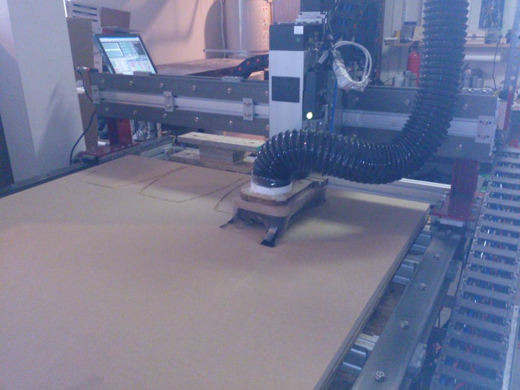

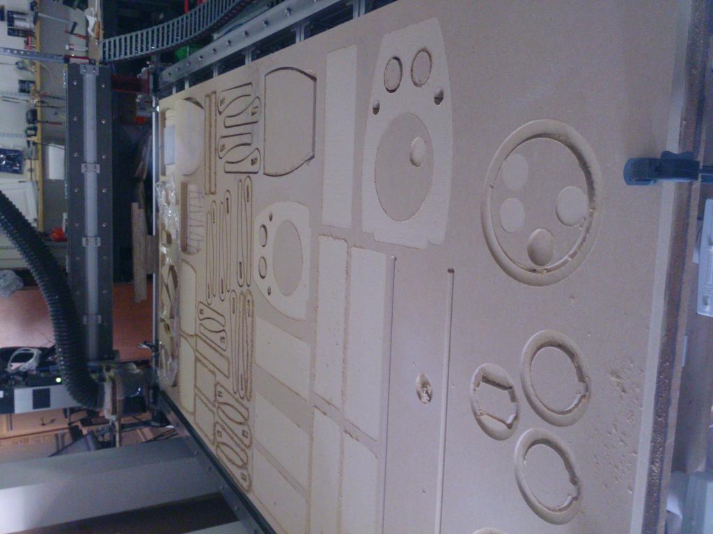

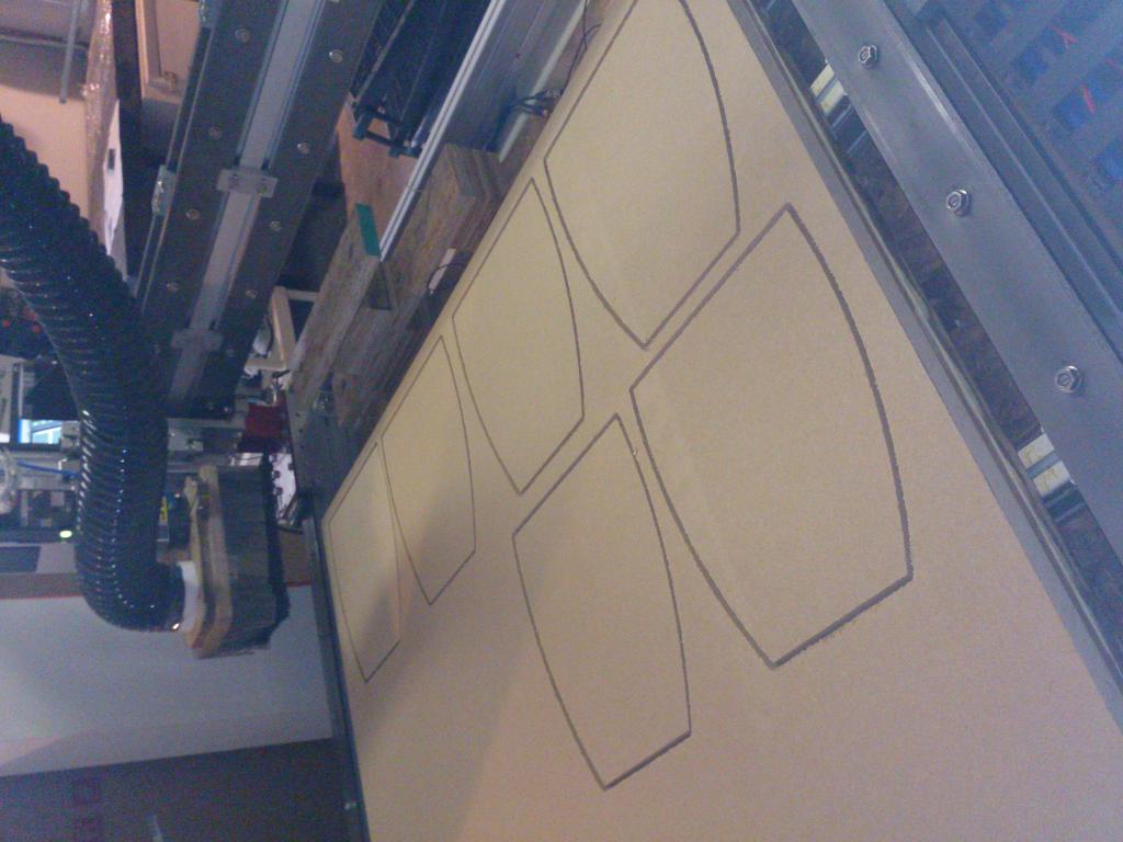

                      MDF dust Aflying
                      Cutting the parts out on my CNC

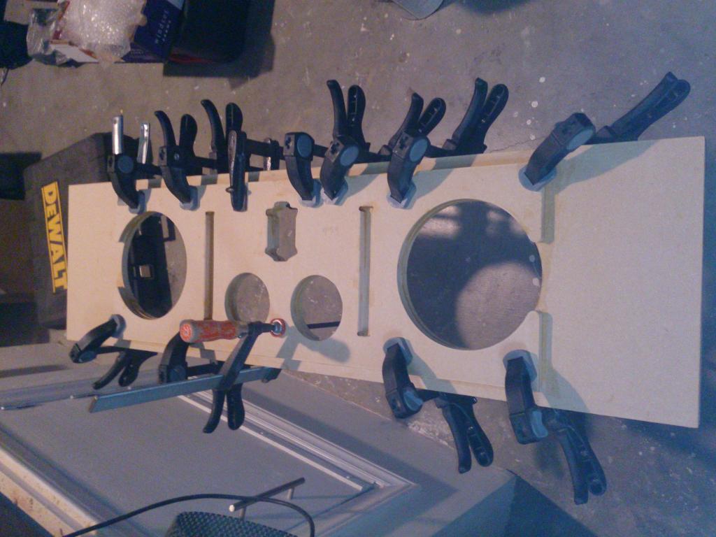

                        Test fitting
                        Test fitting (no glue jet)

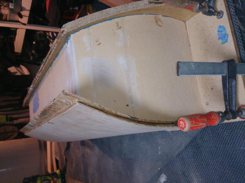

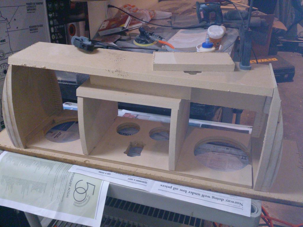

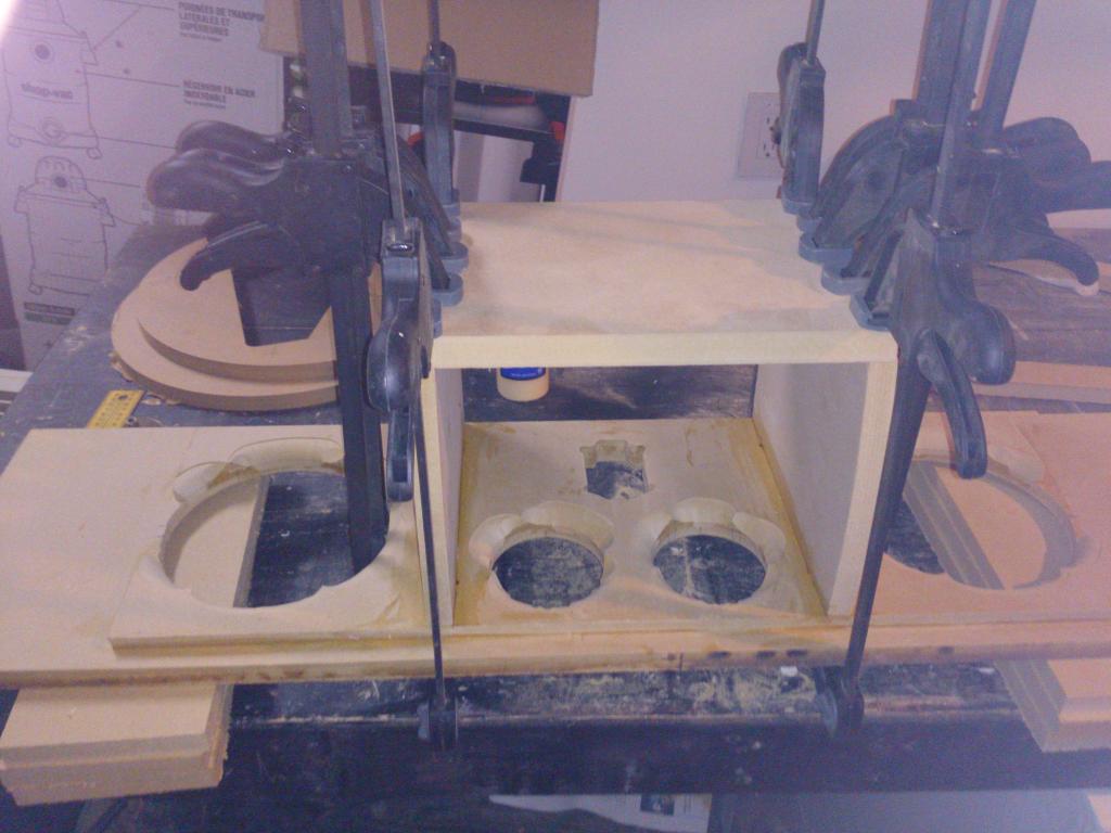

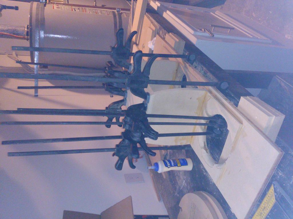

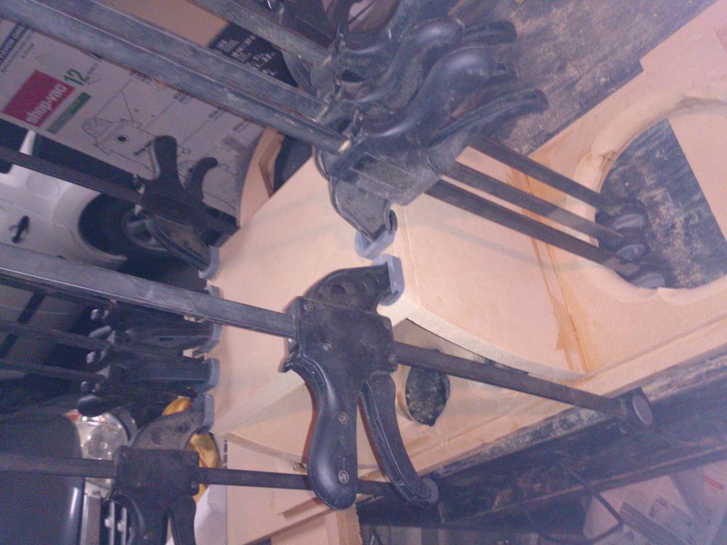

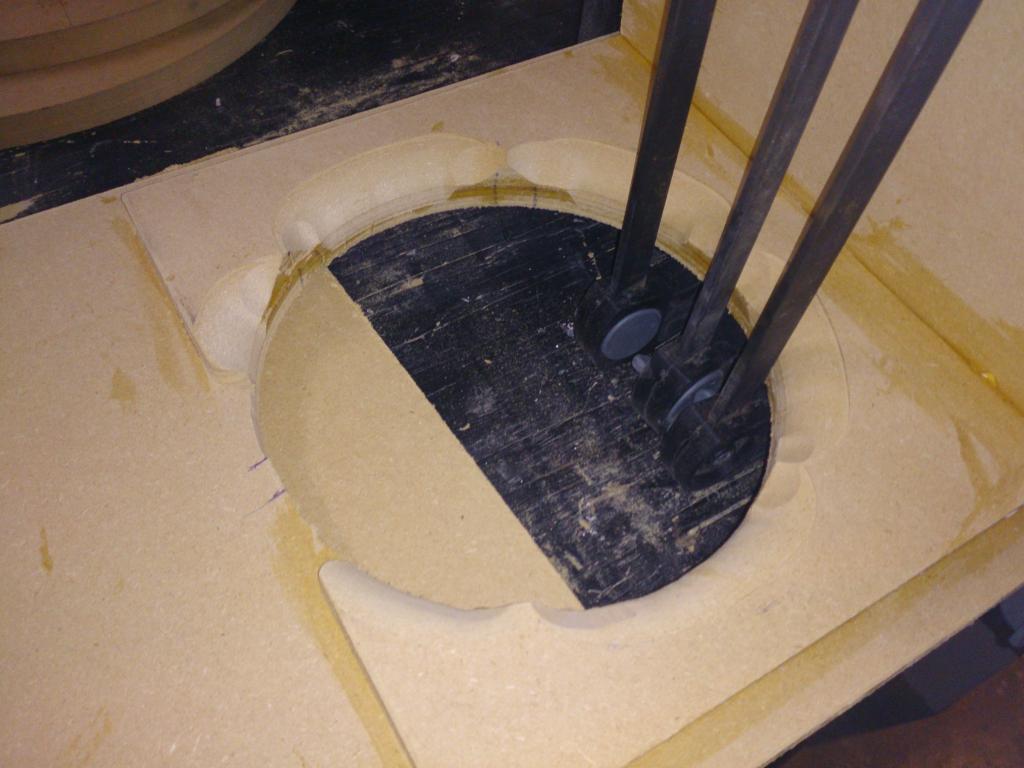

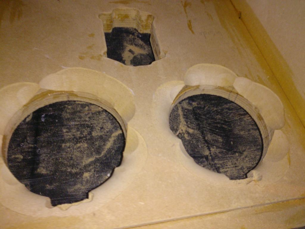

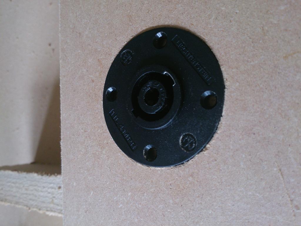

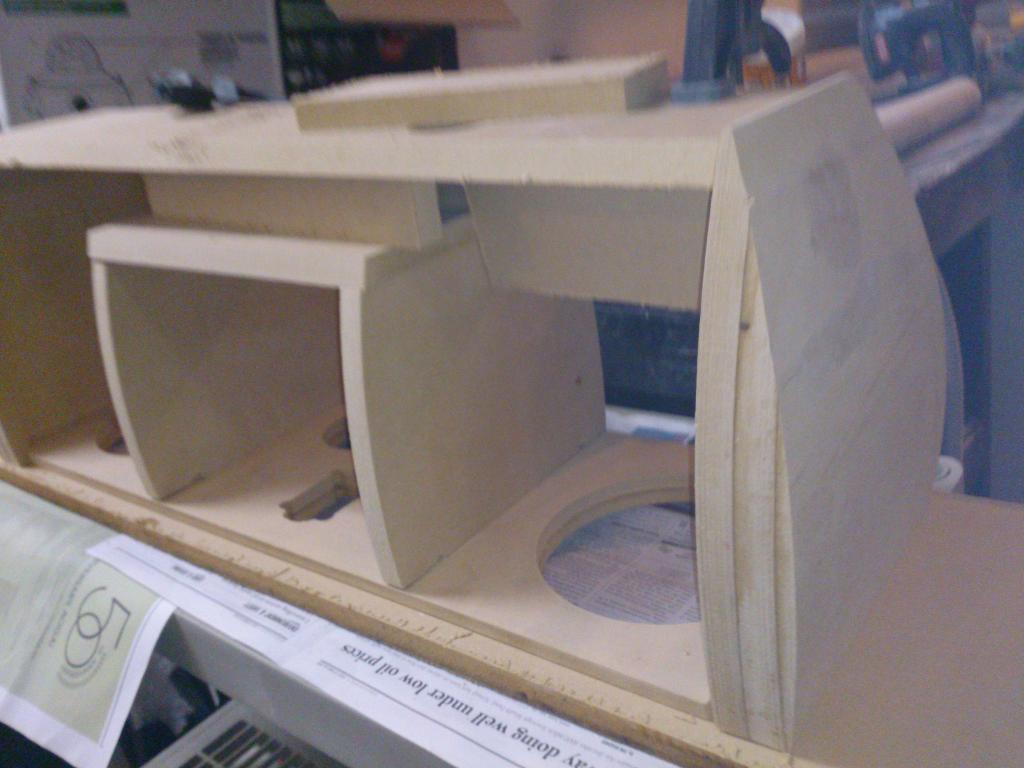

                                Build Progress
                                Test fitting the cones and speakon connector.
                                Gluing the front inner and outer baffles (notice the nice dadoes)
                                Scalloping the mid and woofer (3/4 inch roundover and 1/2 inch V) - Hope this answers your questions
ID:	862294Click image for larger version
ID:	862293Click image for larger version
ID:	862292Click image for larger version
ID:	862291Click image for larger version

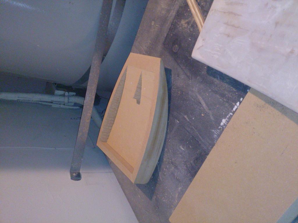

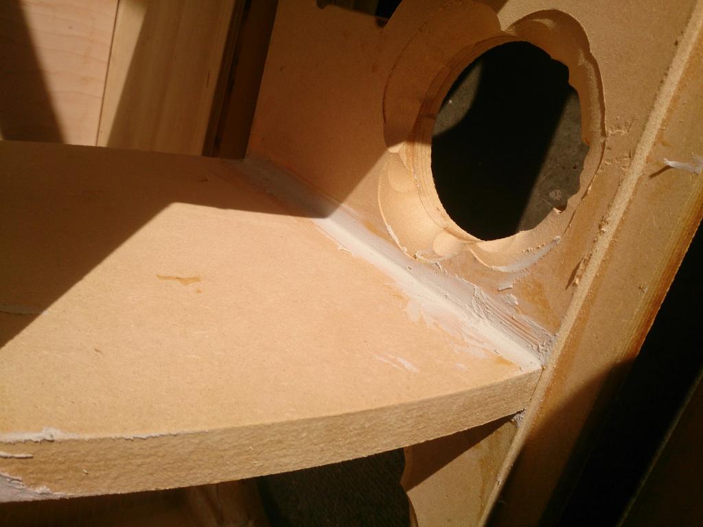

                                  The Dome cap, hollowed out inside is now visible
                                  Gluing in the mid sides, with easy dado positioning
                                  All of the edges sealed with bondo, to ensure there is no leakage between mid, side and outside.

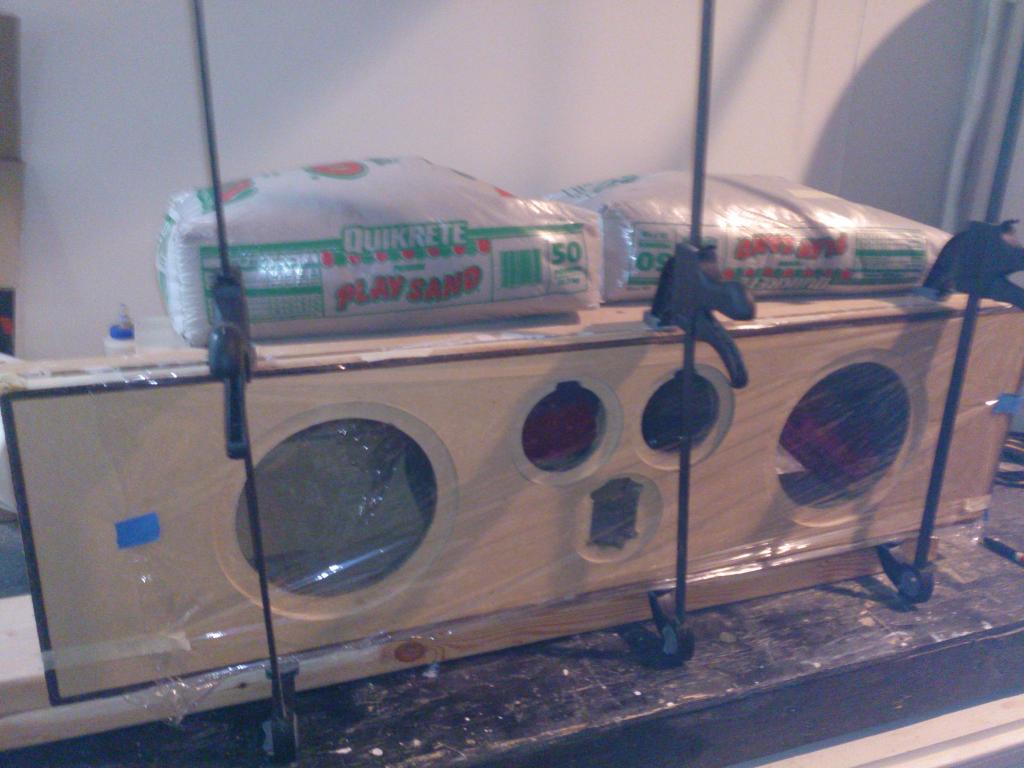

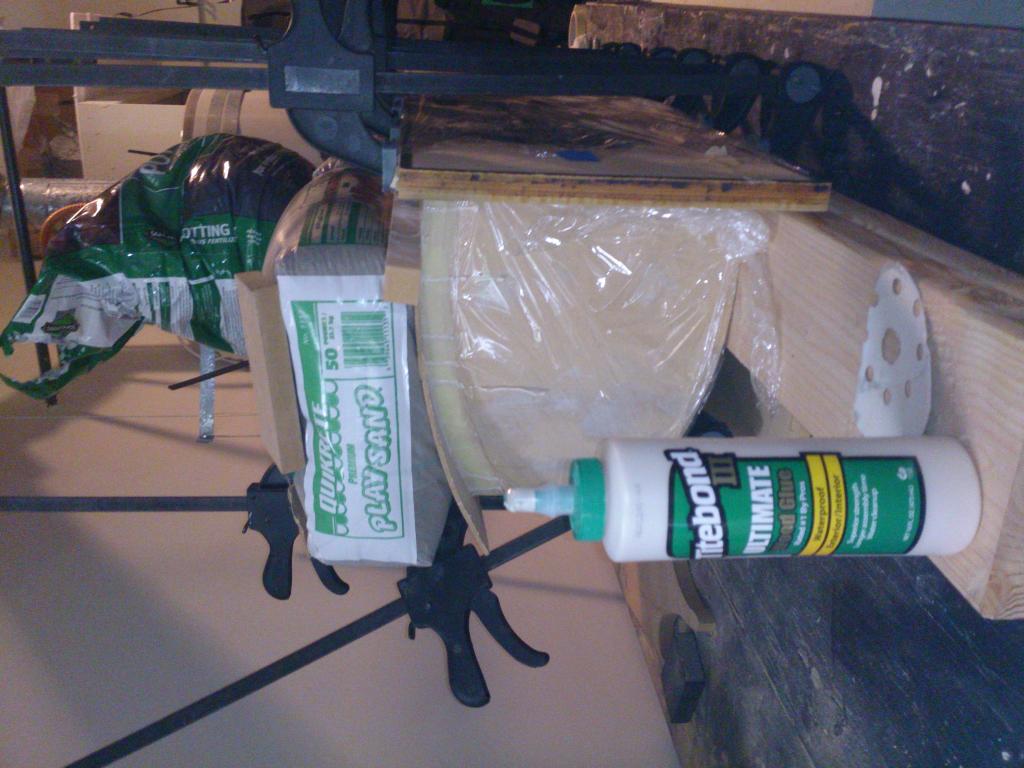

                                  • SaltyPaws
                                    • Jan 2015
                                    • 22

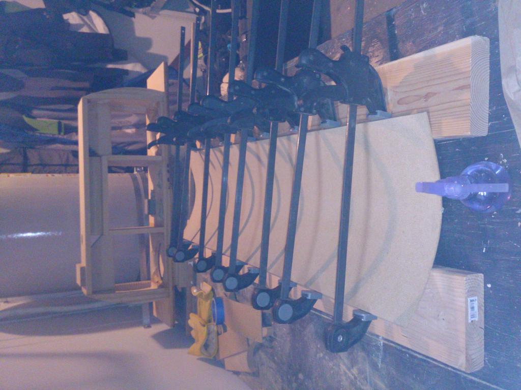

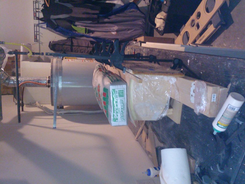

                                    The inside is now painted with left over paint from other projects. Maybe overkill, but I like to paint the inside of all my speakers.
                                    I am using titebond III for the curved sides, mainly because the longer opening times (titebond extend is hard to obtain here). Titebond is having a good customer in me, as I am using 6 oz per panel. Yes, I decided to go for the gallon! :T
                                    I am using bags of sand to press the curved sides on. From here on the operation is a little like Intels tick and toc. One day I use my clamps for pre-bending a plywood side, the next day the clamps are in use for the gluing. With 5-6 panels per side this is an arduous process... I will be putting the 3rd panel in tonight.
ID:	862300Click image for larger version
ID:	862301Click image for larger version
ID:	862302Click image for larger version

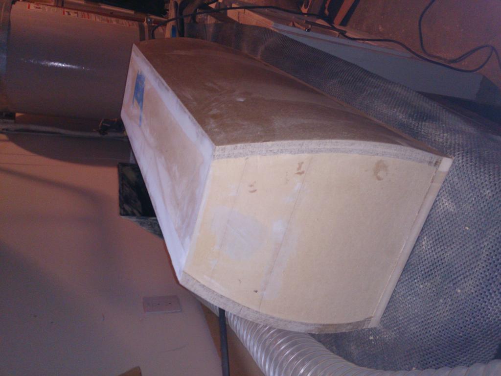

                                                        Sides are glued on
ID:	862857Click image for larger version

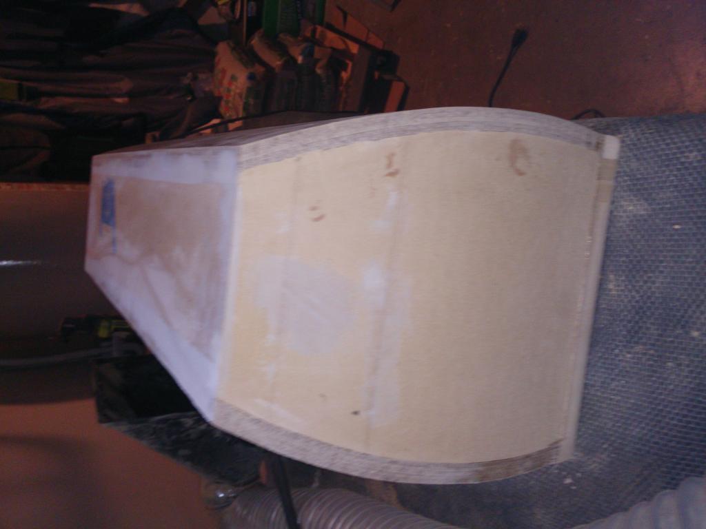

                                                          Trimming the edges straight
ID:	862859Click image for larger version

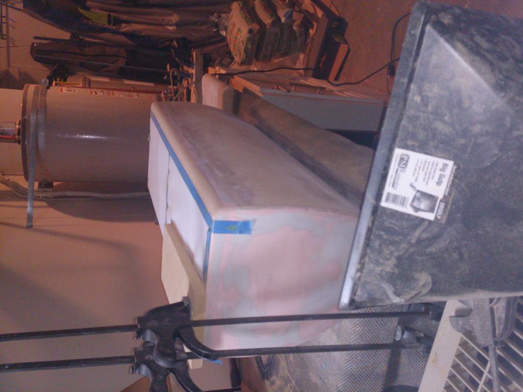

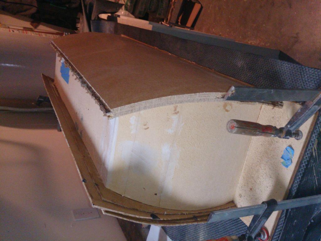

                                                          • SaltyPaws
                                                            • Jan 2015
                                                            • 22

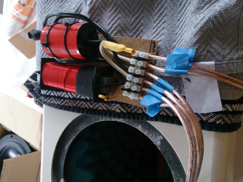

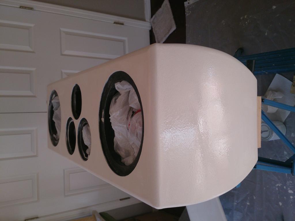

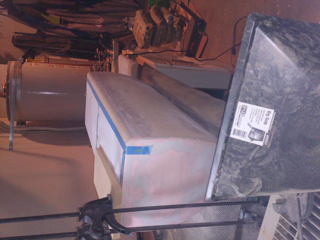

                                                            Almost ready for paint

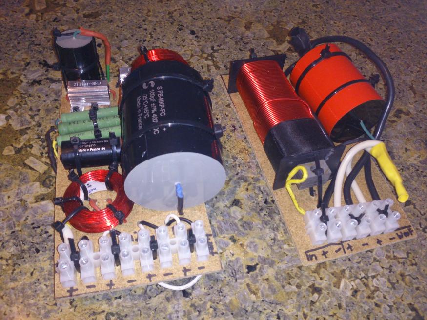

                                                            Almost there! I finished the X-overs and did the difficult roundovers (non 90 degree angle means manual corner roundoff). I ran out of tape to protect the front baffle from the roundover bearing.
                                                            I Placed Bondo on the soft cnced mdf
                                                            I also used bondo for the hardboard to baffle transition. I will post some more pictures soon.

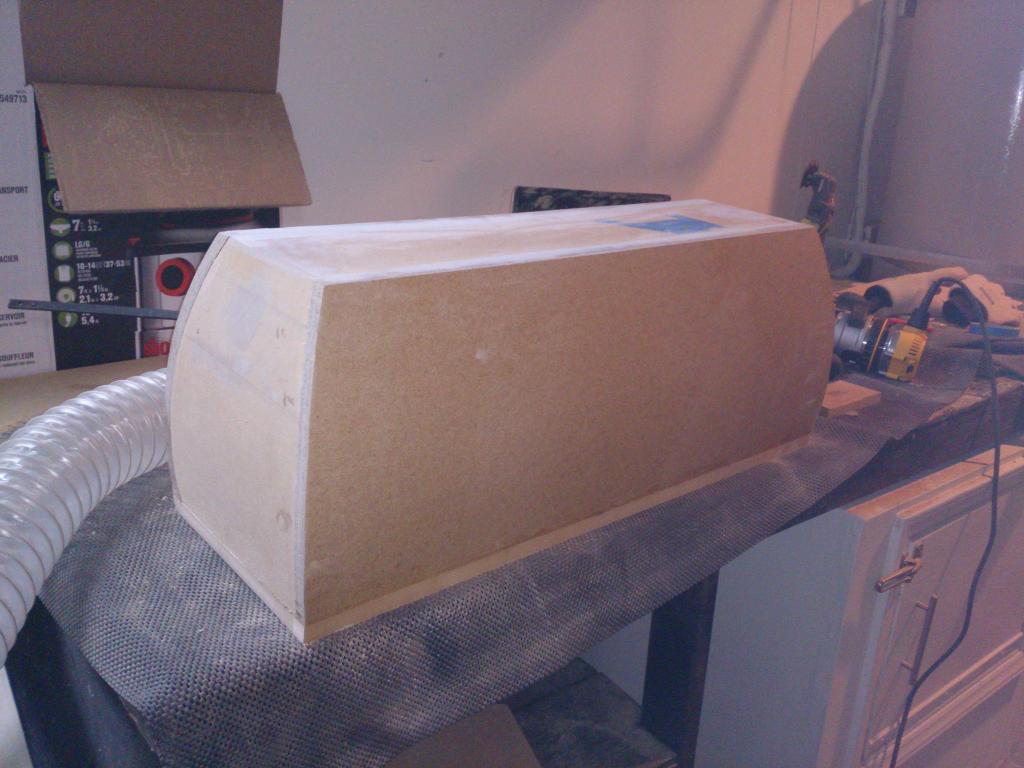

                                                                Rounded over corners and smooth domes

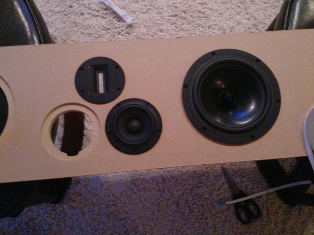

                                                                  Salty paws...is there a reason for orienting the ribbon tweeter sideways instead of vertical. the lengthy way ensures a tighter side to side window with a greater vertical dispersion. Also, I would look into madisound or parts express for open cell acoustic foam. I use madisounds natural wool stuffing and a lb bag should be more than enough for your speakers. Just make sure that you leave enough space behind your midrange drivers so that you don't muck up the midrange frequencies.
                                                                    gzubeck (DigitalMaven)
                                                                    maybe you are referring to the Center speaker enclosure?
                                                                    speaking of which, my previous statement regarding the curved 'top hat' would also apply to the Center channel 'end caps'.
                                                                    • SaltyPaws
                                                                      • Jan 2015
                                                                      • 22
                                                                      It is a centre speaker... Orientation: horizontal on top of my subwoofer. This will orient the ribbon tweeter in the correct position. I already put foam lining in, before starting the second wall. I have a bag of stuffing for the woofers that will go in after as per advice from Jim.
                                                                      • DigitalMaven
                                                                        • Feb 2017
                                                                        • 36
                                                                        I went back threw the thread and I can see it now...makes sense now....

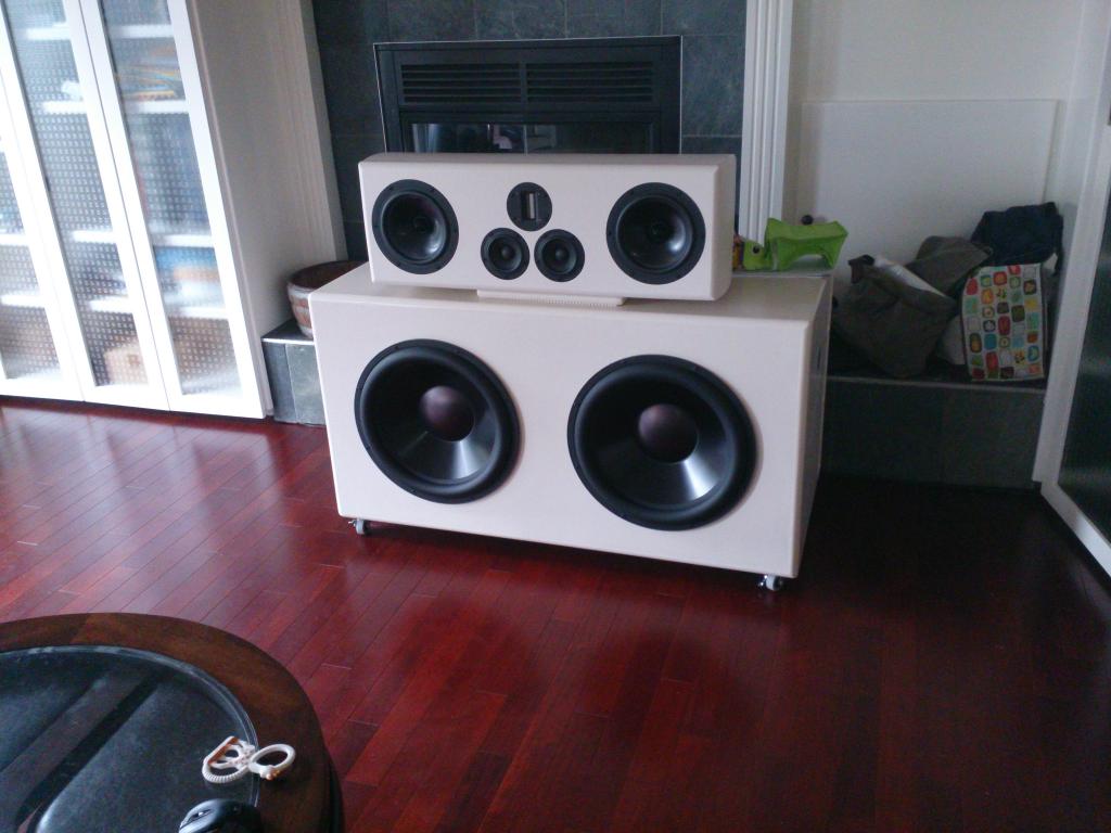

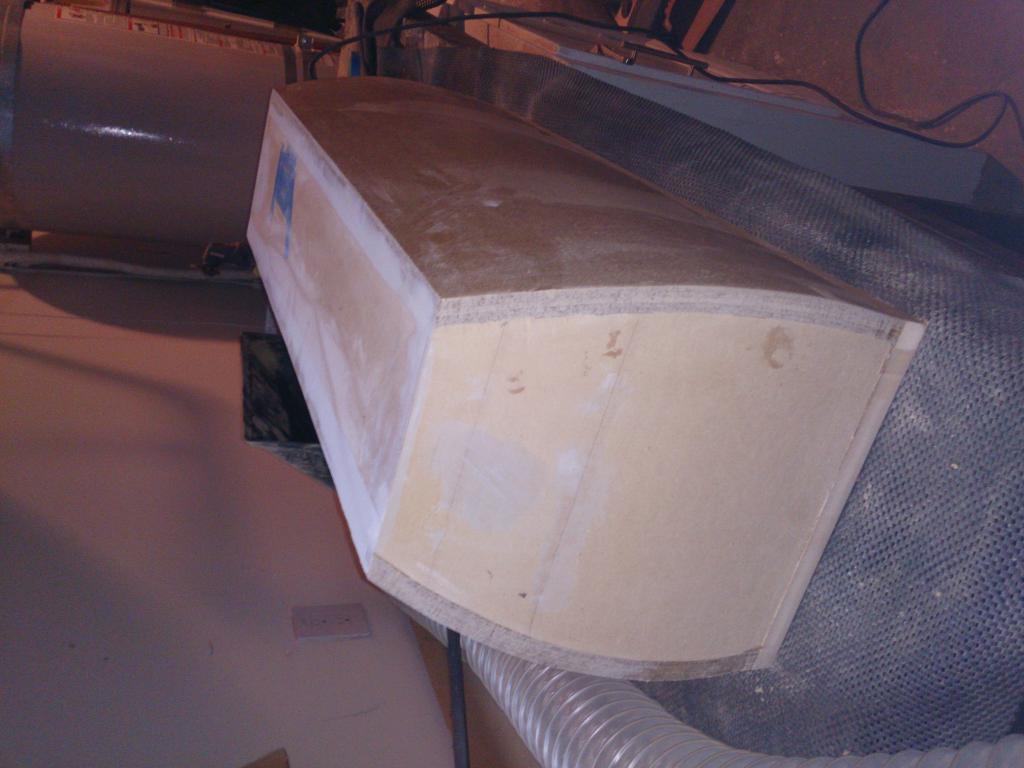

                                                                          Centre is Finished!
                                                                          I finally got to do my victory dance, as the centre speaker is finished! Some rain over the last weekend did help me in getting the box wired, and the cones and X-overs installed. First listening impressions: I can hear voices much better, even with background noise, something I struggled with on the old tv speakers. Breaking glass sounds like glass, bass really pops. The frequency sweeps sound good. I start to get good bass at around 50 Hz (With the sub on during the sweep, the sound starts at 20HZ +0db at (amplifier turned up to 25%) Needless to say cutlery rattles in the cupboard. In case I wasn't sure about the subwoofer being on, all I need to do is test the wall for vibrations :twisted.
                                                                          On to building the left and right now...
