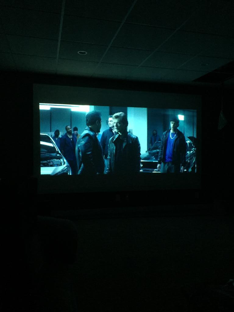

                krips' HT Build Log
                screen is up, but still have to do velvet trim, calibrate, etc. Trying to play it through my speakers in the ht1075, but I seem to only be hearing the surround settings. I remember also having this problem when trying to run surround on my receiver - I had to set it to stereo. Source is my PS3. I might try the blue ray player upstairs and see if that fixes it.
                Edit: seems it was my PS3 not liking John wick in atmos. Sony bluray does just fine.
                Sent from my iPhone using taps talk

                          • krips
                            • 264

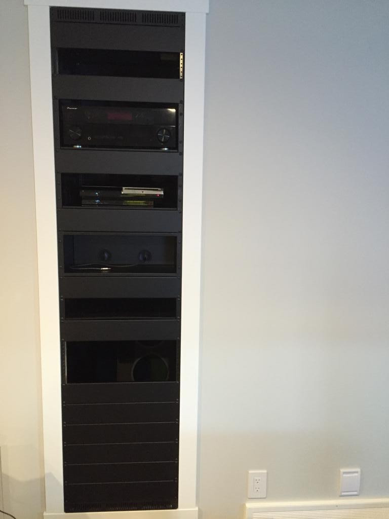

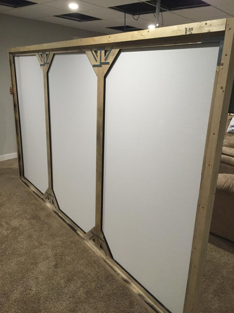

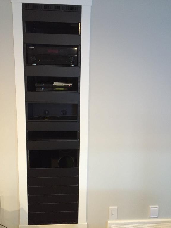

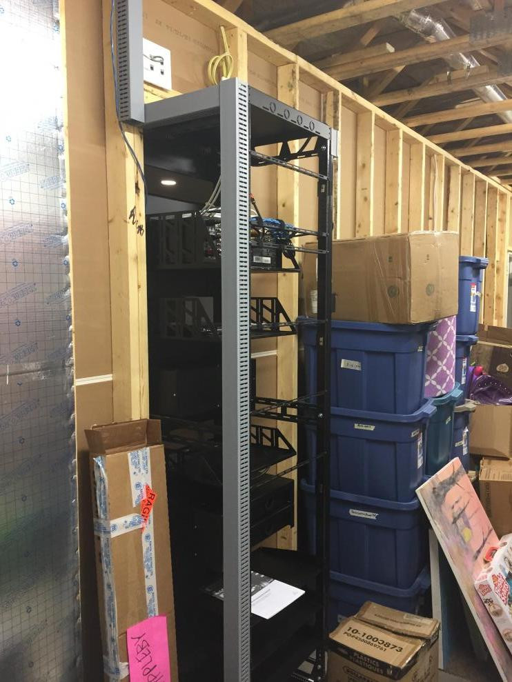

                            Can you see these pics?
                            Sharp LC-42D64U
                            TriTrix MTM (Sealed)
                              I can see them, but they make my neck hurt.
                              • scottvalentin
                                • May 2015
                                • 175
                                My neck hurts as well, but that screen looks great - nice job!

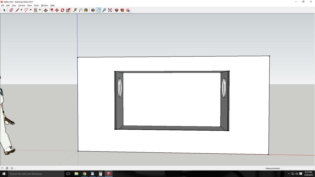

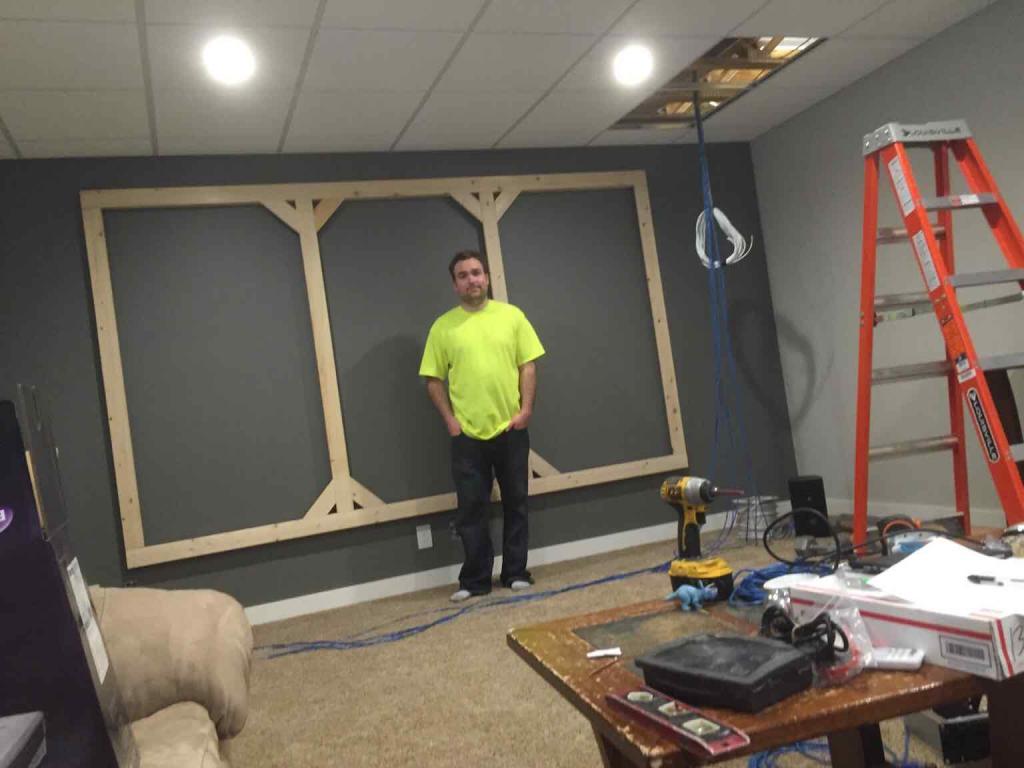

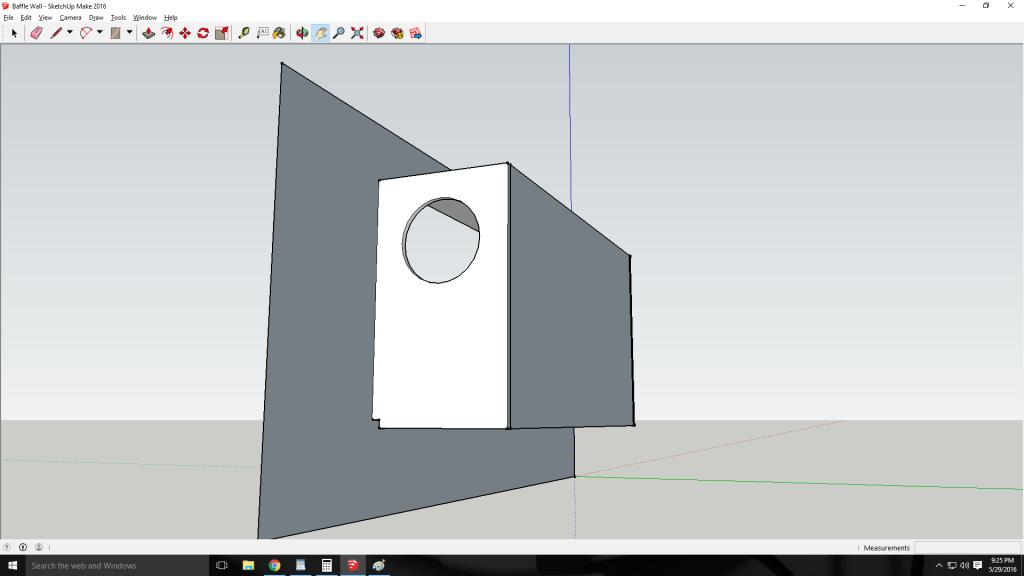

Name:	HT Wall 1.jpg
ID:	861891Click image for larger version
Name:	HT Wall 2.jpg
                                              Here is a rough idea of what I was thinking for my baffle wall. The rear of the cavity will be attached to my foundation wall. The cutouts are for mach5 21" LTE subs. It's roughly 3' deep x 9 1/2' wide x 5' tall, would leave 10x vas for the drivers in the room behind, and would have the horns at ear level-ish. My main concern is that I've never seen IB subs in a 'manifold' like this before and I'm not sure if this design would be strong enough. Any suggestions would be appreciated. Thanks.
