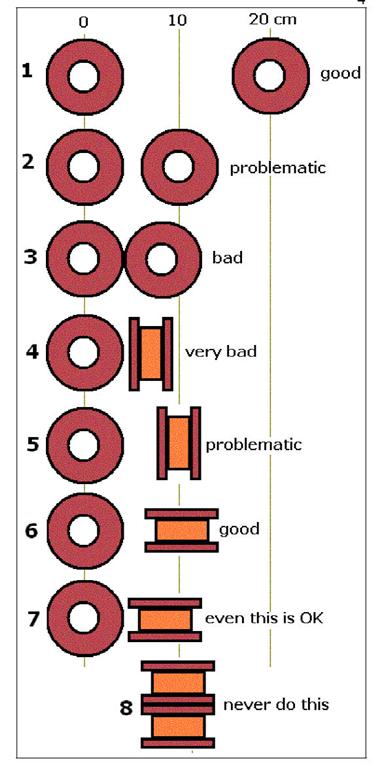

          #94
Name:	Inductor placement (Large).jpg
          Hi darren,
          This is what I use as a guide when space is tight.

              #96
              Hi darren,
              It appears if I rotate the tweeter board 90 degrees clockwise from the orientation I have pictured above, I should be fine. The coils between the woofer and tweeter boards would match the #6 option in your photo. I will have to measure the distance between the woofer and midrange coils (#5). That could be an issue... and those boards are 'glued' into place. ops: But I think there is about 3-4 inches between them. *fingers crossed*
              Thanks for your help Jim!
              The Old Woods Theater
              My Various Speaker Builds
              Statement II Remix build
                #97
                I wouldn't stress over a 1/2". I take this as a guide rather than an absolute must do. I've seen tests on placement and the effects are minimal if any unless you really jam the inductors together.

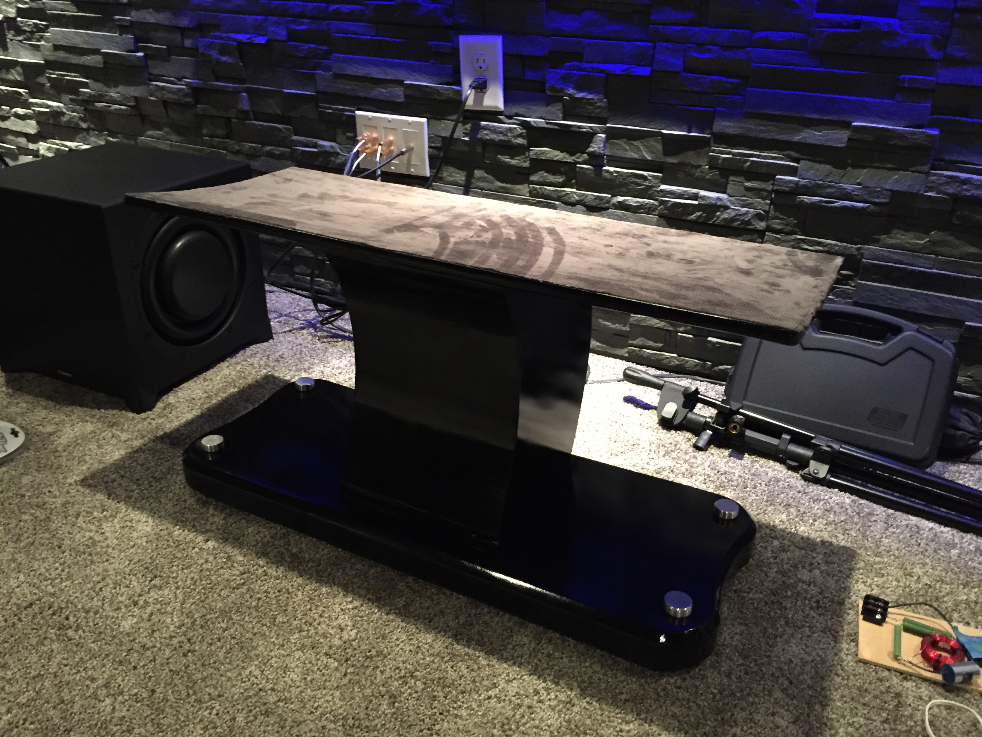

                                #105
                                Shape of the stand goes nicely with the speaker ...... bet the stand weighs a ton all by itself with all those layers.
                                You know it. It might be the first time I've built a stand that weighs more than the speaker. I think the stand weighs a solid 30 pounds.
                                Well, the weather tried to stop the paint priming tonight, but I pushed through. High winds and rain are never good to paint when working out of a garage, but it got done. I'll wait 48 hours then do some wet sanding.
                                Images not available
                                Speaking of the center channel stand, here are the pictures of the finished item. Gloss black paint. Charcoal velvet fabric on the top of the stand to protect the finish of the center channel cabinet. And the last touch, four metal pucks in the corners.
