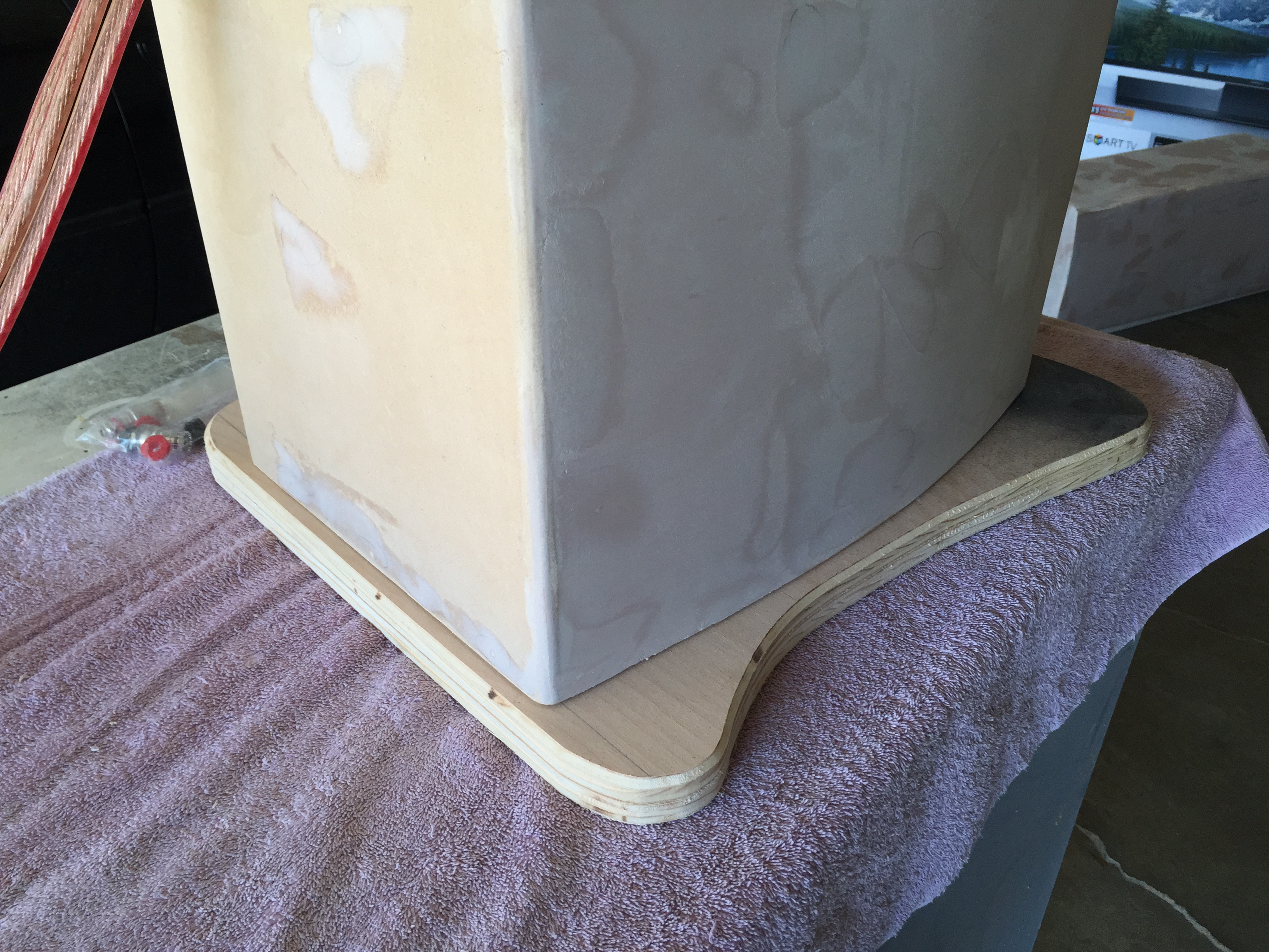

                      I also did a dry fit of the base. I'm on the fence if I love it or if they're just ok. I may mess around with another base design.
                      Click image for larger version  Name:	JN5iShq.jpg Views:	55 Size:	2.06 MB ID:	928945
                      The good news is, the crossovers fit like a charm. The crossovers are sitting in their slot right now, once secured they would be upright (not leaning to the side).
                      Click image for larger version  Name:	hX4IbaJ.jpg Views:	48 Size:	417.3 KB ID:	928946

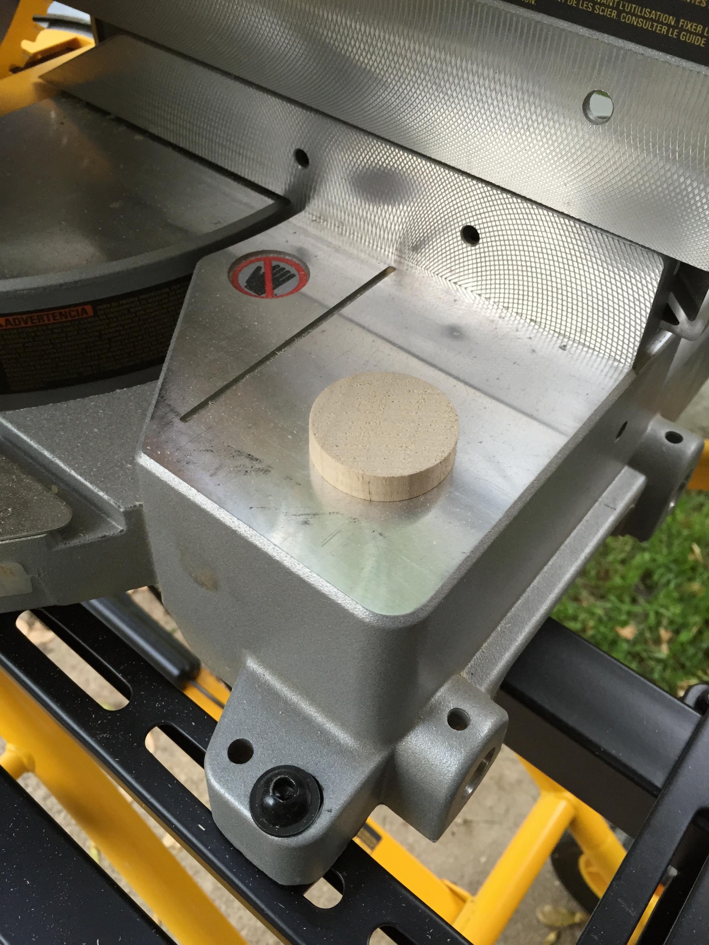

                                    I also decided I will make some top 'pucks' for the outrigger area of the bases. I wanted something similar to Paradigm's base.
                                    Here is my inspiration:
                                    Click image for larger versionName:	prestige-95f.pngViews:	58Size:	72.0 KBID:	928948
                                    I bought a 48" long dowel that is 1.5" in diameter. I trimmed off 12 pieces that are roughly .75" thick.
                                    Click image for larger versionName:	1u6qu8D.jpgViews:	57Size:	759.2 KBID:	928949
                                    I then hand sanded them with 200 grit sandpaper, impaled a nail half way into their bottomed and prepped them for paint. two coats of black primer tonight and tomorrow they will begin the "chrome" paint job.

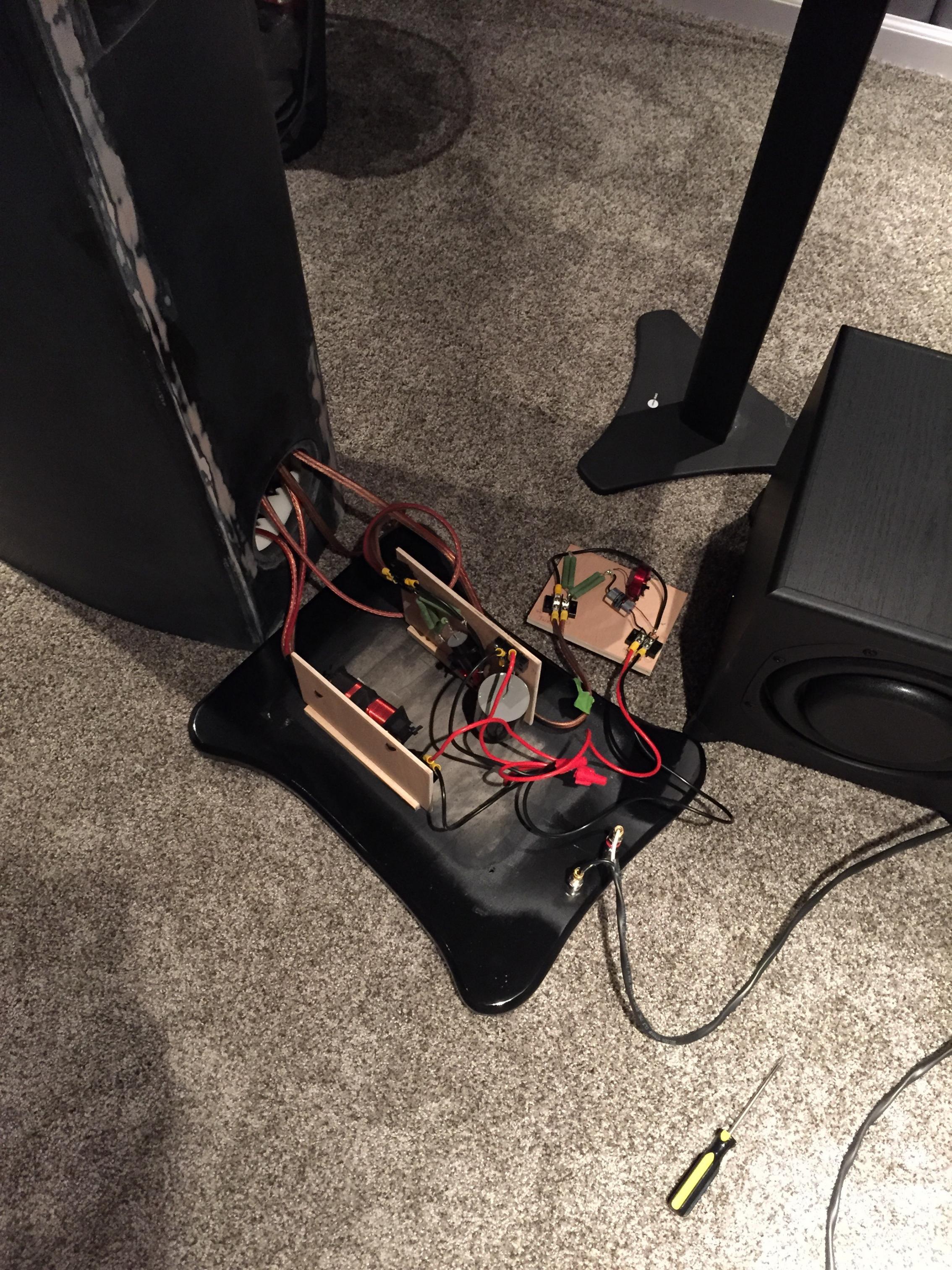

                                      It's been a while since I had an update due to a crazy work schedule, travel for work and helping a family member with a bathroom remodel. I was able to finally get two coats of primer laid down on the cabinets. Now the hours of wet sanding starts so I can finally throw on some black diamond paint and satin finish. The wet sanding as been done in places, which should explain the differences in paint color seen in the pictures.

                                                                                            The tower bases are complete. Speaker spikes and all wiring installed. Still waiting for the final paint.
