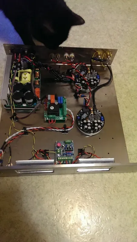

        Bah I goofed and didn't realize the smps I ordered didn't come with any cables. The price for the cables is fine but shipping from the Netherlands sucks. Also my buddy making the case didnt follow my model and has to remake the front. I still may be able to work on it these days off but I'm dobtful everything will arrive in time.
        The nc400 modules are tiny! I knew they were small but seeing them in person is something else haha.

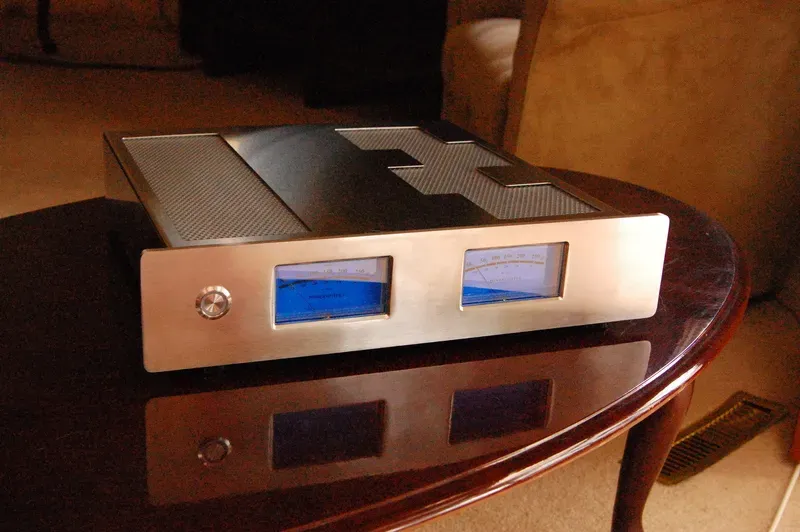

                      More spy pics.

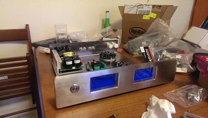

                      Was going to do a chamfer but he didn't have the bit so it will stay square with the VU meters. The laser cut finish was good enough and he's going to buff it.

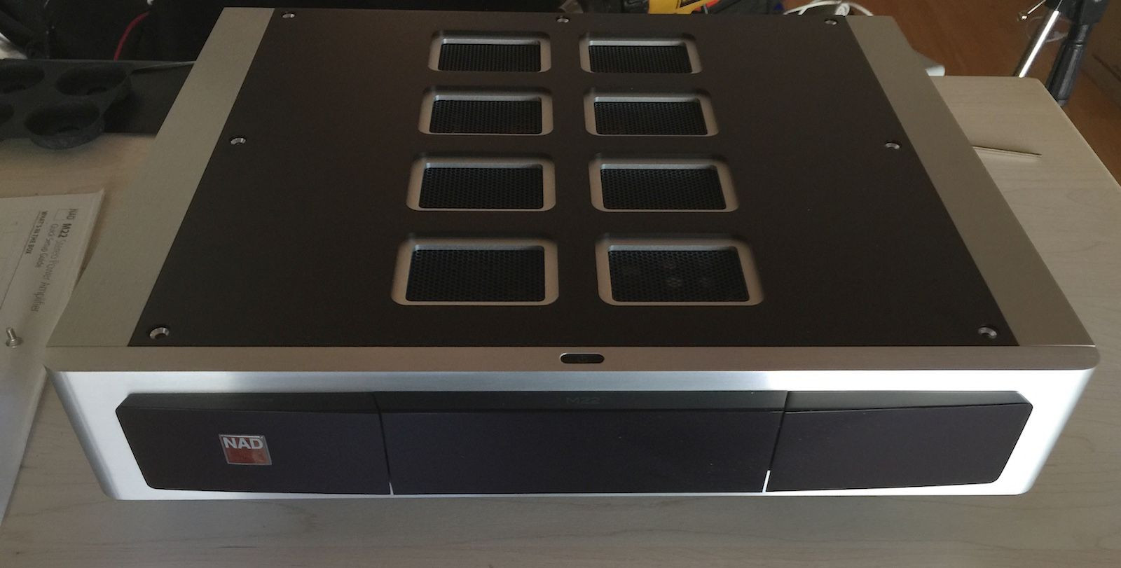

                        Unpacking the M22
                        So, this is like the unboxing photos and open it up and see what's inside... another internet cliche! :W
                        Let's skip the box and all- not so interesting.
                        Click image for larger version  Name:	IMG_2027_zps830tz1we.jpg Views:	1 Size:	161.0 KB ID:	940657
                        Just phone pictures- which is appropriate with Photo-bucket and their compression- what the picture doesn't convey is the build quality, which I'd say is a distinct step up from earlier Mastersound components- like the M51 or the M50. :T Metal work, feet, everything is a bit nicer, though the design language is basically the same. Tolerances are very snug/tight. OK, it's not a $30K Boulder Audio amplifier, or a $20K Ayre, but it's nicely put together. That funny oval shaped thing on the top center of the front panel appears to be the on off switch.

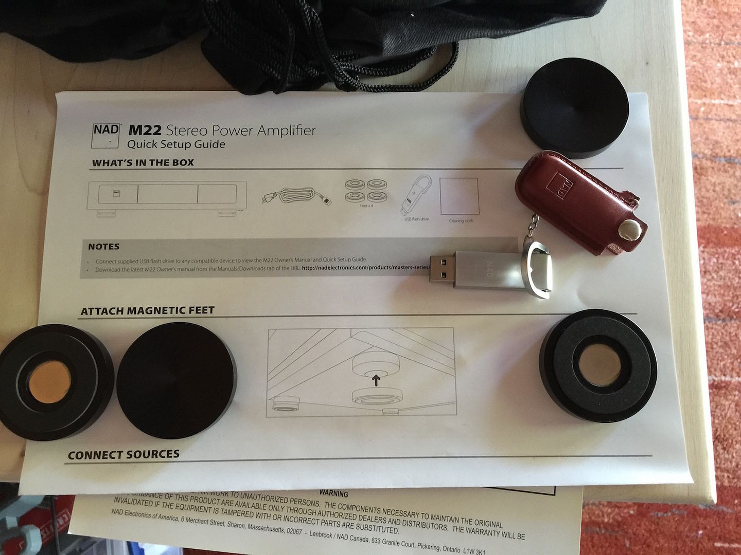

                        Haven't read the manual yet...
                        Note, the only paper work is the unpacking guide- the manual comes on a very nicely made USB stick with it's own leather holder, all quite well made, too. Very British or Canadian in feel, to me...
                        Click image for larger version  Name:	IMG_2012_zpse02ujyfv.jpg Views:	1 Size:	295.5 KB ID:	940658

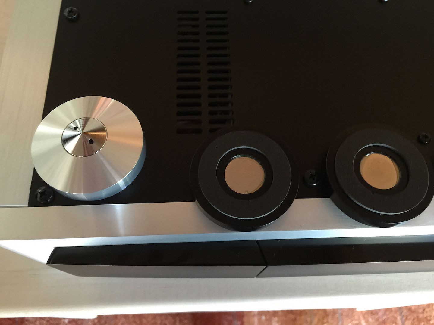

                        Built in feet are made with points, but also come with magnetic lower feet as supports on the shelving. Interesting that they think this level of vibration management is important- or that their marketing department thinks it is! :W
                        Click image for larger version  Name:	IMG_2017_zpswaq0wfhh.jpg Views:	1 Size:	190.3 KB ID:	940659

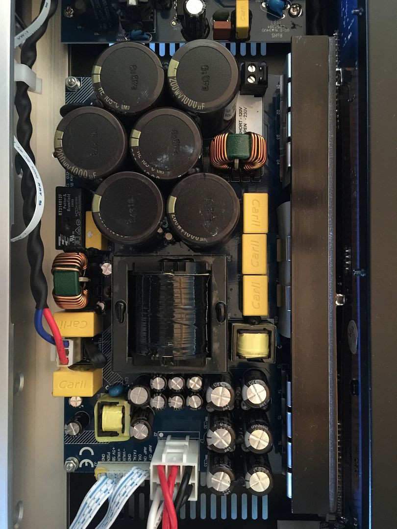

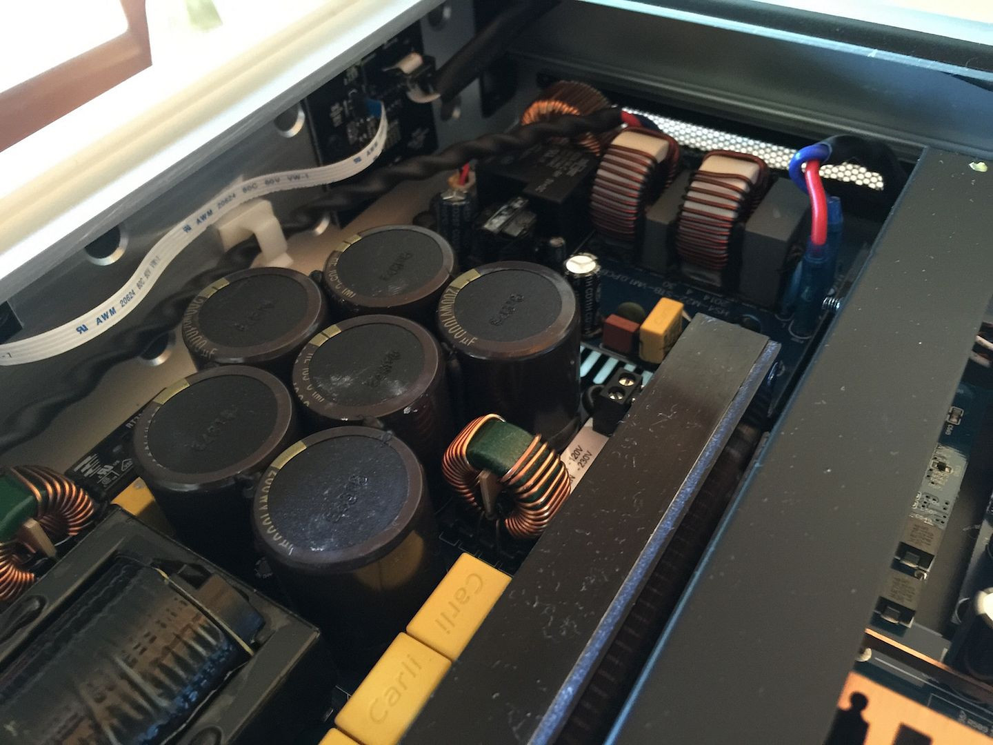

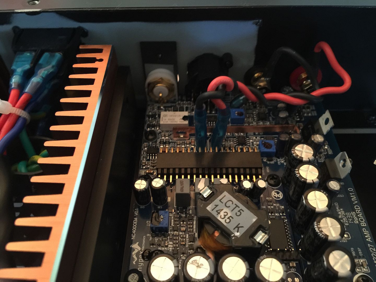

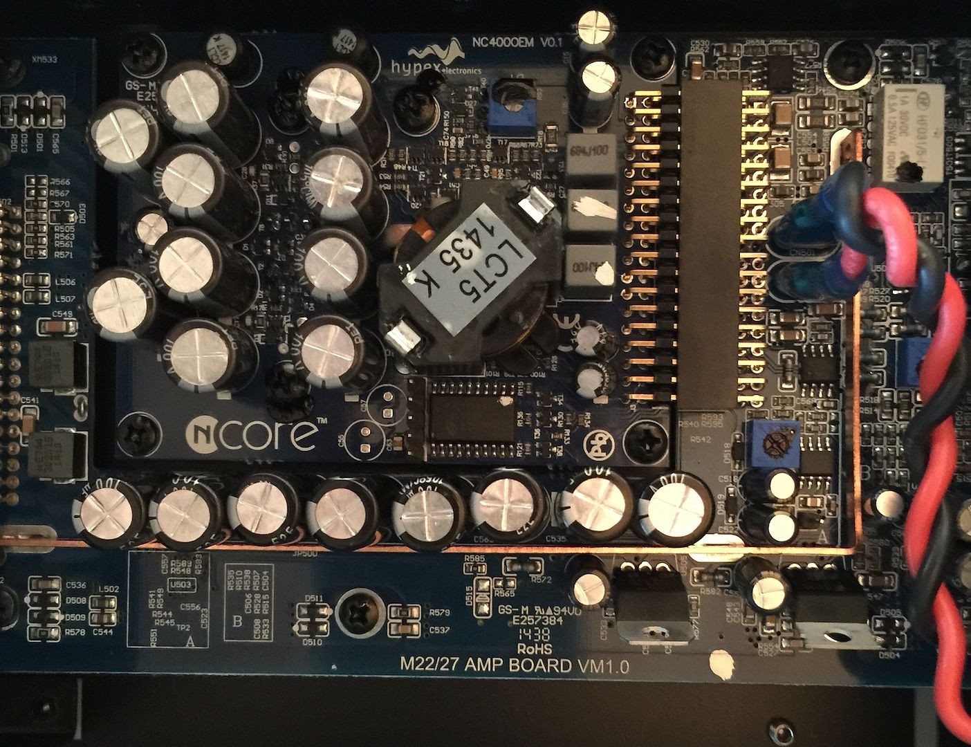

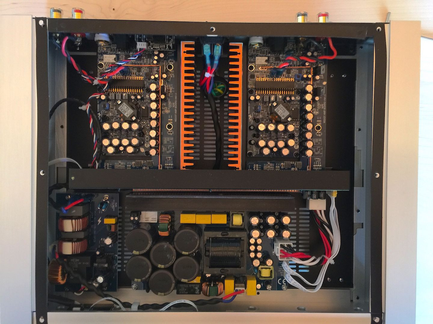

                        And for Ben and all the other hardware nerds, here's the money shot of the interior construction:
                        Click image for larger version  Name:	IMG_2023_zpsvtnpjfio.jpg Views:	1 Size:	371.2 KB ID:	940660
                        I've got a ton of chores and errands tomorrow, but hopefully Sunday I'll be able to set it up and start running it and give it a preliminary listen...

                          So a single power supply? Makes me feel better about cheaping out haha. Looks like a nc400 on a square pcb! Similar cap layout at least.
                            • 16142
                            That's what it's basically supposed to be, but they've added their own input circuitry and soft limiter, and SUPPOSEDLY have done some "cool stuff" with the power supply... Looks like some small SOIC opamps in the front end, maybe for a little extra filtering and isolation (I have bought Jensen transformers for that, it's probably OCD over kill).
                            Anyway, pics are worth more than words, so let's have some more pics.

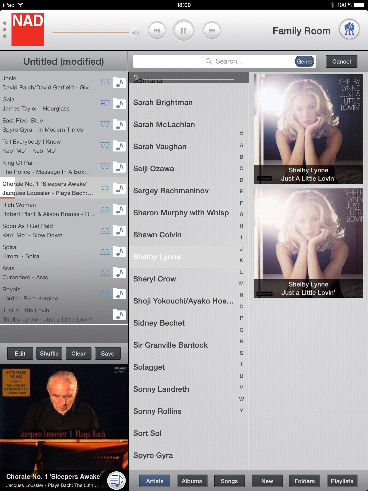

                                        Well, I found a little time to do some listening... here's a screen capture of the playlist, as that's much easier to do than write down all the song titles! :W

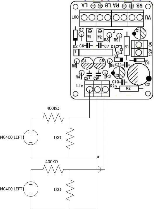

                                            Can someone help me decipher this?
                                            http://www.ebay.com/itm/VU-Meter-Dri...:X:RTQ:US:1123
                                            Is the input for the driver board between the pre-amp and NC400s or between the NC400s and the speakers?
                                            If it is between the pre/NC400 how do I attach it considering I'm using a balanced connection.

                                              Based on what the funny blocky text says, the sensitivity is 97mV RMS for +3 dB on the meter. Mind you, that's a steady state- of course, they may have peak detector unit in this.
                                              Solution? Use an attenuator network from the single ended speaker output, this is about a tenth of a volt, from something like 40V RMS, so 400:1 is the range to start with.
                                              A passive attenuator should take into account the impedance of the input connection, but that may be reasonably high- if it's 10K, and the shunt resistor is 1K, and the series resistor ~400K, nothing should blow up... :B

                                                Like this?
                                                Oops the bottom should say nc400 right.

                                                  Yeah, based on the sketchy information, that's what I'd try. Safest way to test would be with a high power load resistor and a scope or DVM to check signal levels in volts RMS.

                                                    Yeah for sure. Any recommendations for pots so I can adjust as needed?

                                                      You could change the 400K resistor to a 220K pot plus 220K fixed resistor, for example-

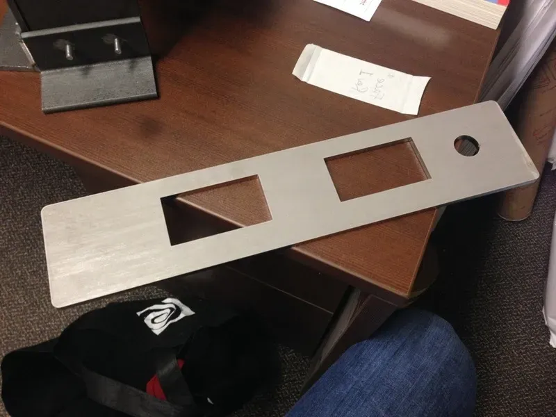

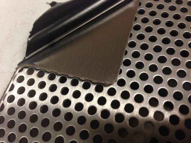

                                                      • benthe8track
                                                        • 371

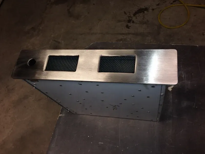

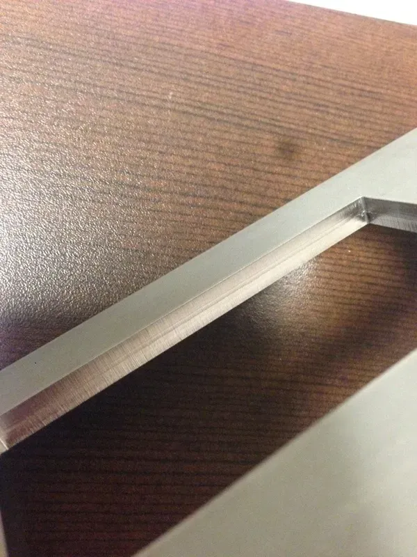

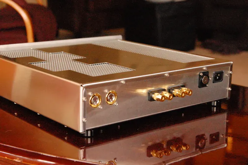

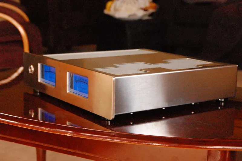

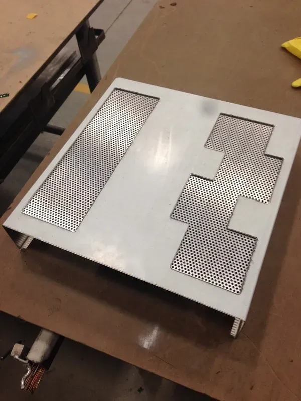

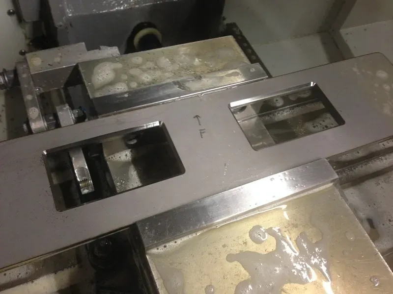

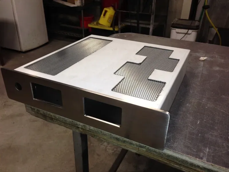

                                                        My original design called for 50 million holes. Luckily my friend had the much better idea to just use perforated aluminum.
                                                        Wish I was a little more creative with the layout. Would have been a good opportunity to take some design cues from NAD.
                                                        Close up with the plastic peeled back.
                                                        Looks like he's shipping it tomorrow. Laser eye surgery on Friday so I'm looking forward to getting it all together early next week.

                                                            The anticipation is almost over.
                                                            Got these along with a tracking number today. Should be here on Wednesday along with the digikey order containing the resistors, big load resistors and some more wire.

                                                                              Quick update from this eve:
                                                                                • 16142
                                                                                Mmm, good things are happening! :T
                                                                                  I assume you are referring to what appears to be a mostly empty bottle of Stella Artois?
                                                                                  • benthe8track
                                                                                    • 371

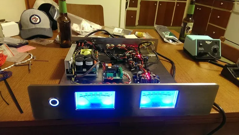

                                                                                    Wow what a long day working on this thing. Started at 7 this morning with my coffee and just finished some trouble shooting. I'll snap some better pics tomorrow but for the most part it's together. Had a bit of a scare when I first plugged it it, things lit up and I had no sound. Turns out I had pin 1 and 2 reversed on the XLR inputs, an easy fix but cost me 2 hours of frustration. I'm supposed to go hiking tomorrow but if the weather doesn't cooperate I'll be trying out Jon's attenuator for the VU meters and listening to it!
                                                                                    Some more crappy cell phone pics. I promise I'll take some good ones when it's all done.
                                                                                    Most of the wiring (Cat approved).
                                                                                    Wife made the executive decision that the white LED in the switch looked better than the blue:
                                                                                      • 16142
                                                                                      I think I'd be willing to go along with her, whether I fully agreed or not! If the blues don't match exactly, then having a white would be better esthetically.
                                                                                      Hmmm, I got an interesting request dropped in my lap yesterday- to prepare an SMPS power supply with our parts to match up to one of the IR Class D modules, and to have this ready by the August FAE training. And they want the controller to be our XMC ARM based micro. And because technically everything above 75 W SHOULD have PFC, though this is ignored for audio most of the time, this is really a combo of PFC front end and a PWM isolation/regulation stage, with all the doodads needed to keep a Class D setup happy- I.E., prevents pumping of the unloaded supply rail, possible requirement for clock synchronization (though many of the IR reference designs don't have a way to do this- there are self oscillating designs, but only 2nd order, so are not truly fixed frequency- just as the Hypex aren't.)
                                                                                      Expect to have a big discussion about this today with my boss- that's a very tight schedule, and would require dropping all other activities to have any hope of pulling it off. And there are other concerns, including issues of code re-use and licensing. OTOH, I finagled my way into finishing the Application note for the one LLC reference design we have running, which has an alternative controller running our XMC, but the code was developed by a 3rd party vendor. Depending on the terms we agreed to, this could be tricky.
                                                                                      It's a shame the IR designs are about 10x the distortion and noise of Hypex nCore, even though they are popular on the DIYAUDIO forum. Of course, that's not terrible, means they might be 0.01% where Hypex is 0.001%. But that first 25 watts just isn't quite as nice, though it is pretty good. If this does get off the ground, I'll have to look into the idea of making the design and interface compatible with Hypex modules. My boss doesn't know anything about Hypex, or that they even exist. I'm sure Jun Honda does, though...
                                                                                      This could be awkward... but interesting.
                                                                                      Oh, and is it making waves on the scope yet? Or sound through a speaker (use inline fuses for first tests!)
                                                                                      Today I'm going to try to figure out which of the IR modules is most electrically similar to the nCore 400. :W :B
                                                                                        • 2136
                                                                                        Very nice job on the build ..... out of curiosity, do you have a total for what the cost was on this?
                                                                                        • benthe8track
                                                                                          • 371
                                                                                          I didn't keep as diligent a tally with the costs for this project, mostly because I started buying the odds and ends a long time ago. Things like 10 different push buttons to see what looked the best, ect. The CDN dollar is terrible right now so that added another 20% but I think everything was under 2k.

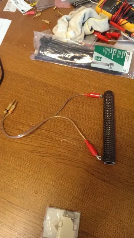

                                                                                          Took your advice and got this big ass resistor for setting up the VU meters.

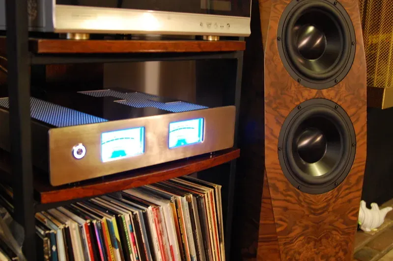

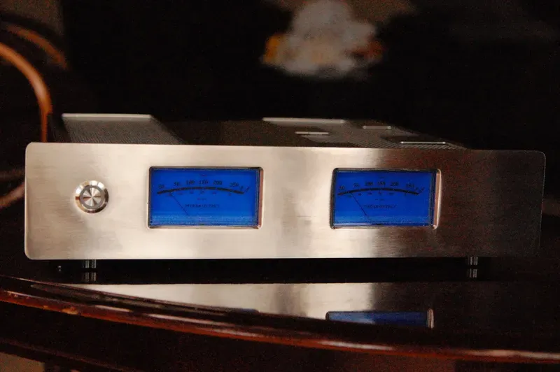

                                                                                          I tried to take some nice pictures, didn't realize the ISO was jacked to the max. So at least I'm consistent I guess.
                                                                                            That is looking better than high-end retail. I'm impressed.
