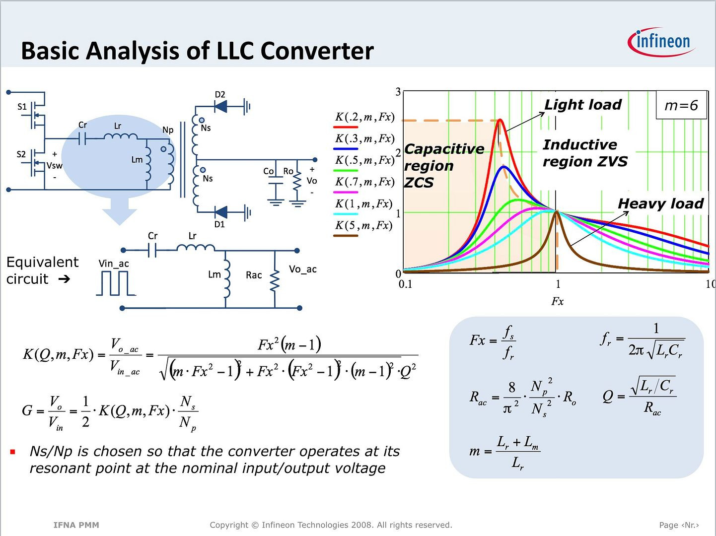

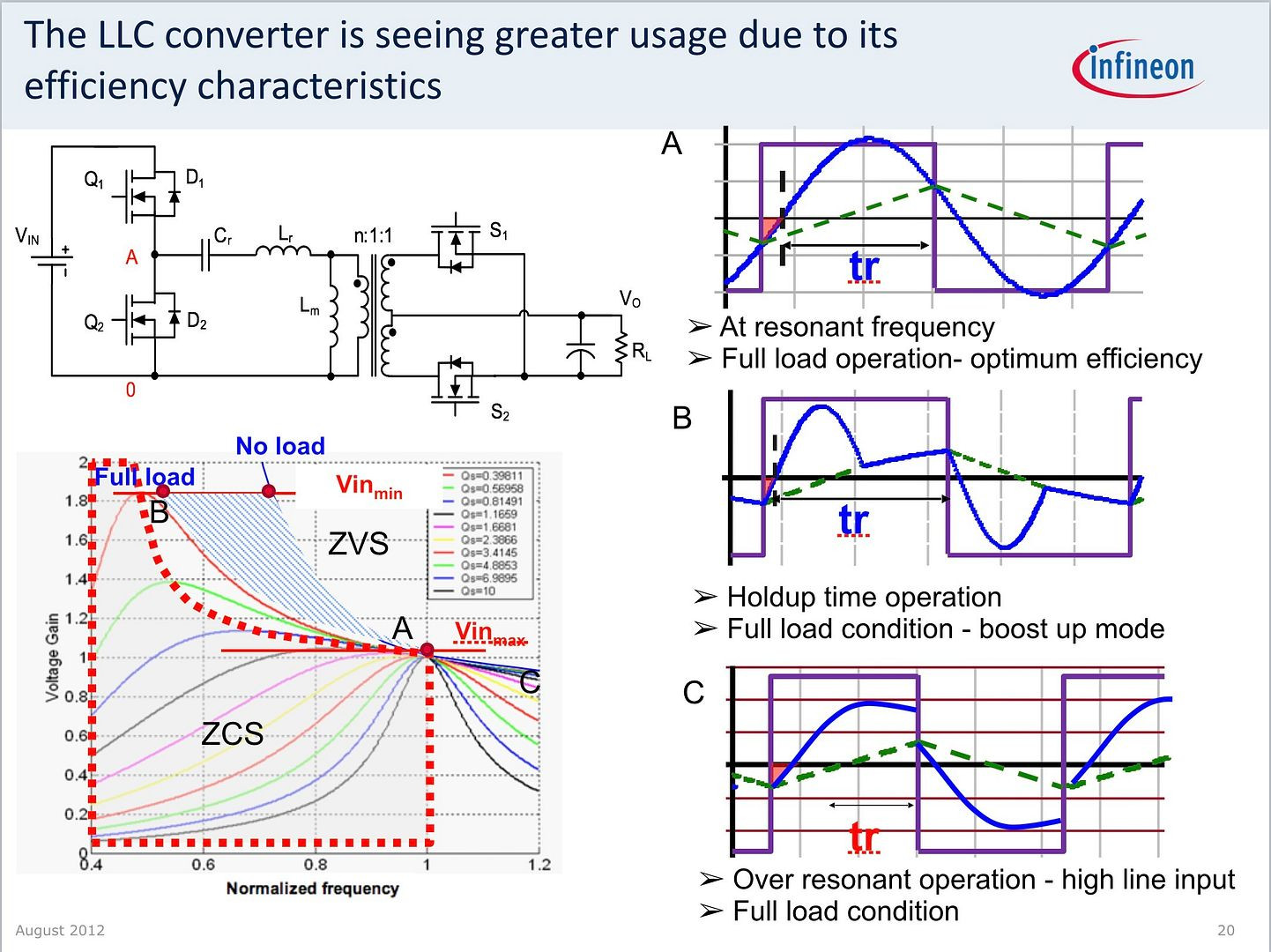

                Actually, going through a bunch of the IR reference designs, it looks like the sweet spot minima for THD+N is around 0.02% on most versions. Given the THD+N slopes, I suspect part of the problem is the noise performance of the summing comparator- that's a really critical part of designs like this, because basically the Class D amplifier is just a big ass switching opamp, and the front end comparator is like the front end of an op amp.
                BTW, LLC is a multi-resonant variable frequency SMPS converter that uses two L's (inductors) and one C (capacitor) to define the resonant tank network, though in more advanced designs the C is split in to two parts and located differently from a typical LLC.

                As you might imagine, there are many ways to tune or mistune the design of the resonant tank- LLC's are like Spiderman- "With great power, comes great responsibility (complexity)". But done right, the resonant switching provides low EMI, high efficiency, and the capability to operate at high frequencies with high power density.
                Welcome to my Day job, where I play a power conversion systems engineer on TV. :W
