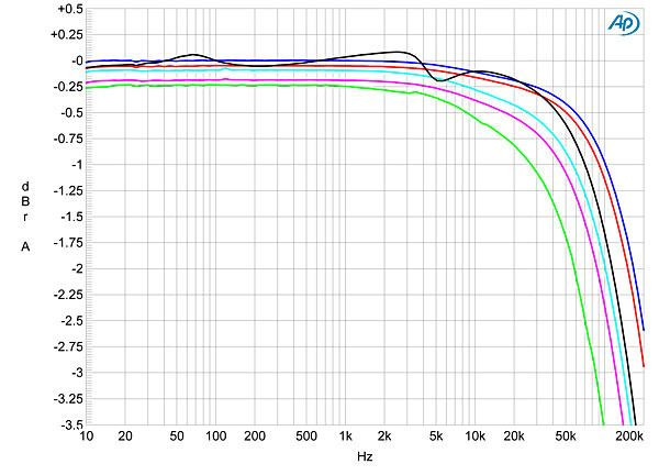

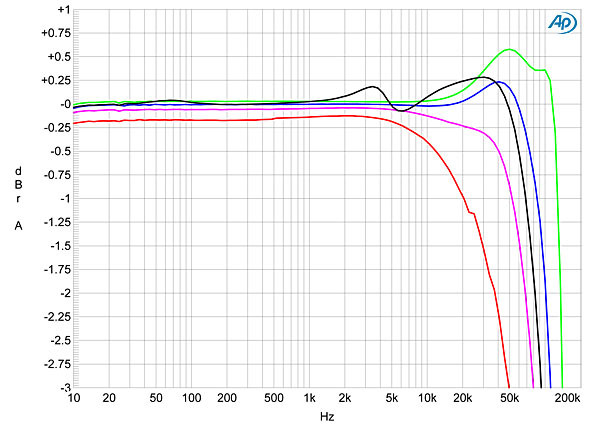

    Let's lead off with the Theta Prometheus, one of the earlier nCore OEM designs, as reviewed on Stereophile. $12K per pair.
    Theta Prometheus, frequency response at 2.83V into: simulated loudspeaker load (gray), 8 ohms (blue), 4 ohms (magenta), 2 ohms (red) (1dB/vertical div.).

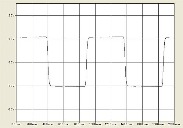

    Small signal 1 kHz square wave, with Audio Precision LPF
    1 kHz distortion into 8 ohm load
    Theta Prometheus, THD+N (%) vs frequency at 20V into: 8 ohms (blue), 4 ohms (magenta), 2 ohms (red)
    Two tone HF IM distortion
    Last edited by theSven; 12 July 2023, 21:03 Wednesday. Reason: Update image location

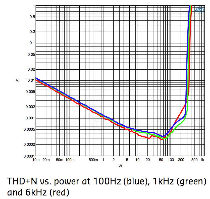

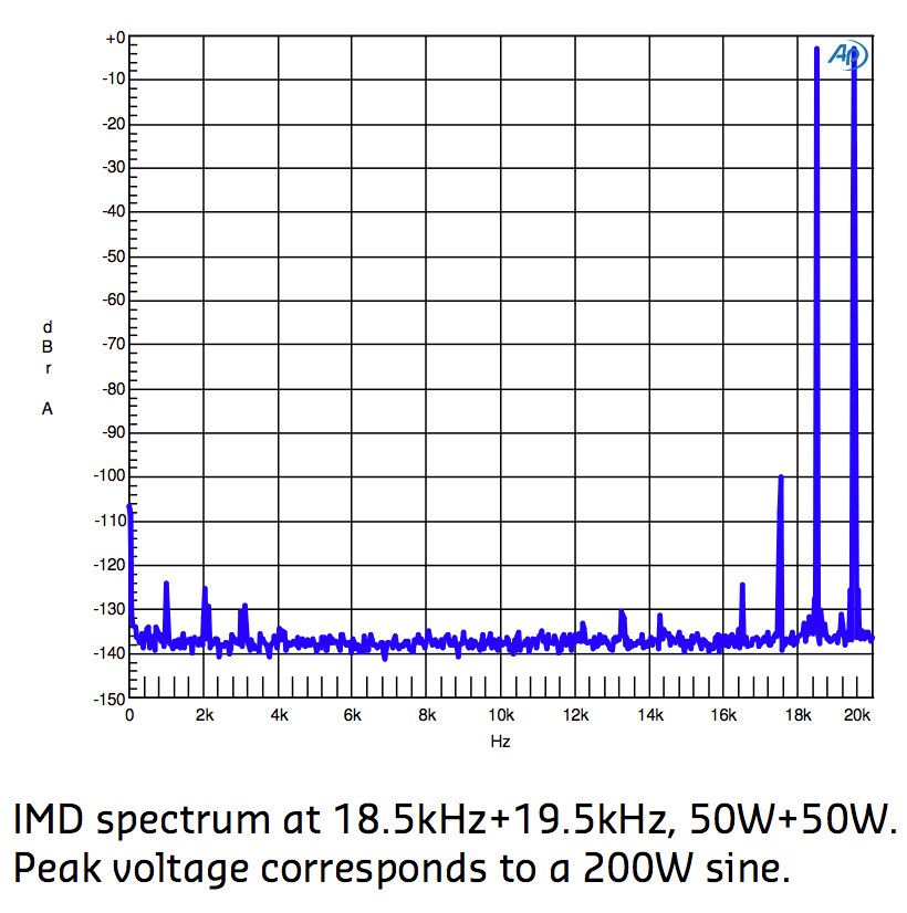

    Claimed performance for nCore 400 DIY module
    This is information from Hypex, not independently verified. Need that AP, I do...
    Unlike companies that talk about making the 1st watt as good as possible, this design makes the 1st 50 watts as good as possible, if these measurements are correct. Getting 0.002% at 500mW output power is pretty stunning- very low input noise floor. Most people that I've seen add their own front end to the OEM module wind up with a higher noise floor.
    Last edited by theSven; 12 July 2023, 21:04 Wednesday. Reason: Update image location

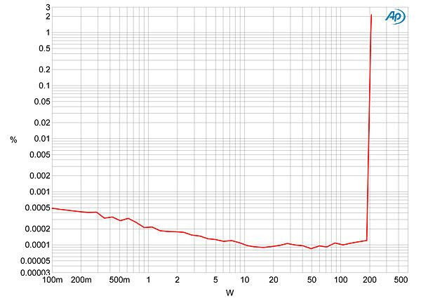

      • 16183

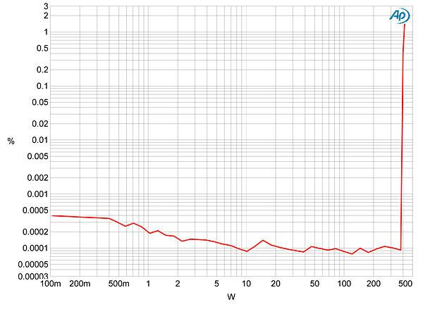

      Benchmark AHB2- a reference standard?
      SMPS power supply, but linear amplifier.
      One of the few that can compete with Hypex on numbers- and then some.
      Benchmark AHB2, frequency response at 2.83V into: simulated loudspeaker load (gray), 8 ohms (left channel blue, right red), 4 ohms (left cyan, right magenta), 2 ohms (red) (0.5dB/vertical div.)
      Benchmark AHB2, small-signal, 10kHz squarewave into 8 ohms- NOT 1 kHz as usually shown for CLASS D designs.
      Per channel, 8 ohms - 0.0002% at 500mW!
      Per channel, 4 ohms
      Bridged mono, 6 ohms
      Last edited by theSven; 12 July 2023, 21:06 Wednesday. Reason: Update image location

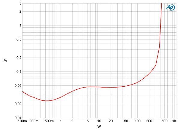

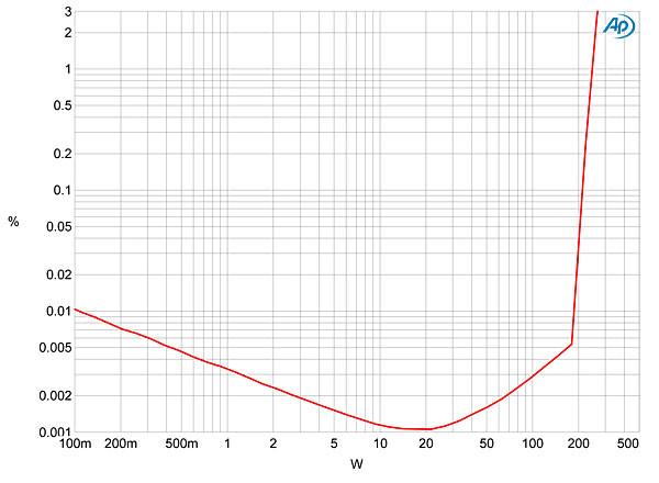

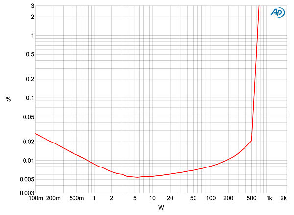

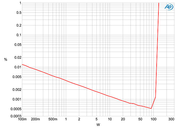

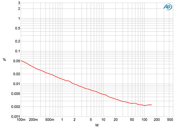

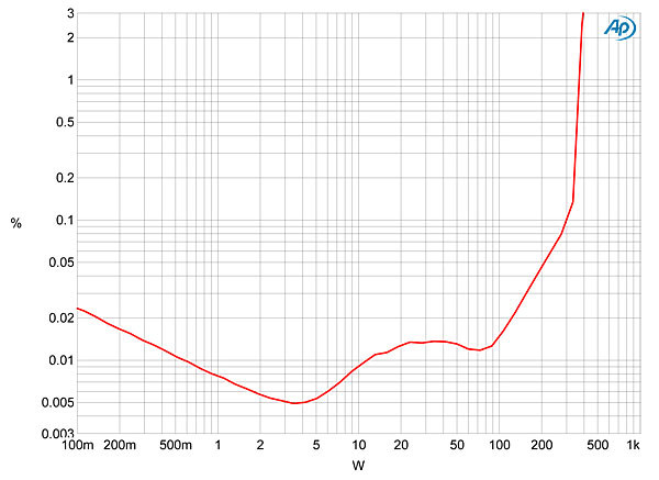

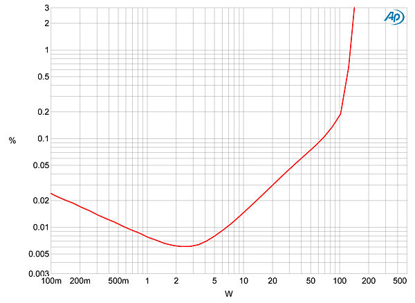

        • 16183

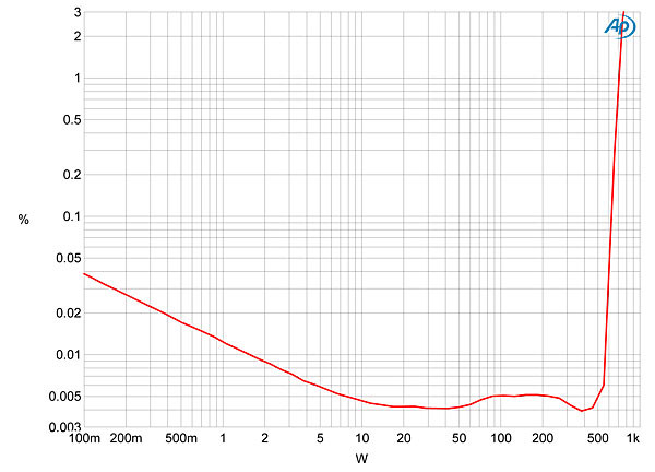

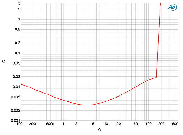

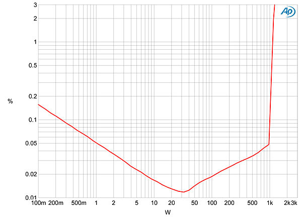

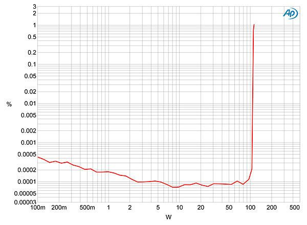

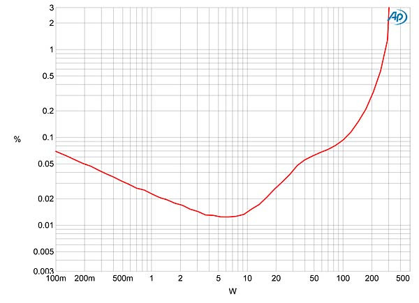

        Some "quickies" THD+N at 1kHz, variety of recent reviews, linear and class D, as not
        Krell 575 Solo, reviewed 2015
        Simaudio Moon Evolution 860A, reviewed this year.
        Ayre Acoustics MXR 20
        Bel Canto Black amplifier (protection circuit cuts in just before clipping)
        Bricasti M28 monoblock, $30K per pair.
        MBL Corona C15 monoblock, $25K per pair
        Pass Labs XAS60.5
        D'Agostino Momentum Monoblocks, $55K per pair.
        Anthem Statement M1 Class D amplifier, $6998 per pair.
        Mark Levinson No.53 Reference Monoblock Class D amplifier ($50K per pair)
        Solution 710 Amplifier, $45K
        Last edited by theSven; 12 July 2023, 21:14 Wednesday. Reason: Update image location
          Interesting numbers Jon.
          Seem like the AHB2 peforms extremly well on these measurments. But when it hands down beats components like Mark L. thats in the 50k pricerange, it makes me wonder if there should not be other measurements as well.
          Maybe there are other performance criteria that would change or influence the differen in other directions.
            • 16183
            A very reasonable question, but when you check other measurements, it just as much a leading performer, or more so.
            The reason I only put in this one measurement from each amplifier was the time it would take to cut and paste all the others, and this measurement gives a very good idea of the results of the designer's choices in gain structure and signal to noise ratio as well- generally, anything in the sub 10W area is mostly driven by noise performance, which is why you see these downward sloping lines at the same angle for most amplifiers in the 100mW to 2-5W region- this is limited by the amplifier front end noise. Note how much variation there is in this, and many expensive amplifiers don't really have optimum front end designs.
            This was something I noted back in the 70's, and the amplifier designs I started doing for my own company and others had a front end derived from a high performance phono preamplifier, using large very quiet JFETs, in order to keep the noise and distortions performance at 1W output good. Note, 1W output from a power amp is 2.83 VRMS, not that far off from the 2V output requirement for typica AV preamp designs.
            Now, the big conventional amplifiers spend a lot of money on chassis work, and also on conventional linear power supplies, which are much more expensive to build component wise than a well designed switching supply. Not that many people in audio know how to do the latter, though. And of course, for the expensive conventional amplifiers, there is much more money in heat sinks, too!
            My thought is that Hypex amplifiers are the equivalent in their market of Apple iPhones- intelligent design, and much greater profit margins even at lower prices. This is why OEM's are interested in using the modules, because they can't get to the same performance levels and gross margin with other techniques.
            BTW, I believe the Theta Prometheus also uses NC400/500 class modules.

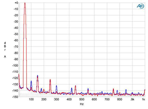

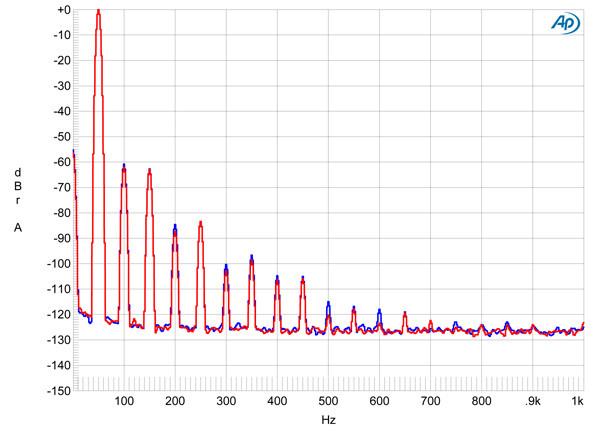

                                          Here's the Vega with 0dBFS output, at 50Hz, and the spectrum up to 1 kHz.
                                          That's sitting right on top of the residual limits of the older AP System 2 analyzer Stereophile borrows from AP.
