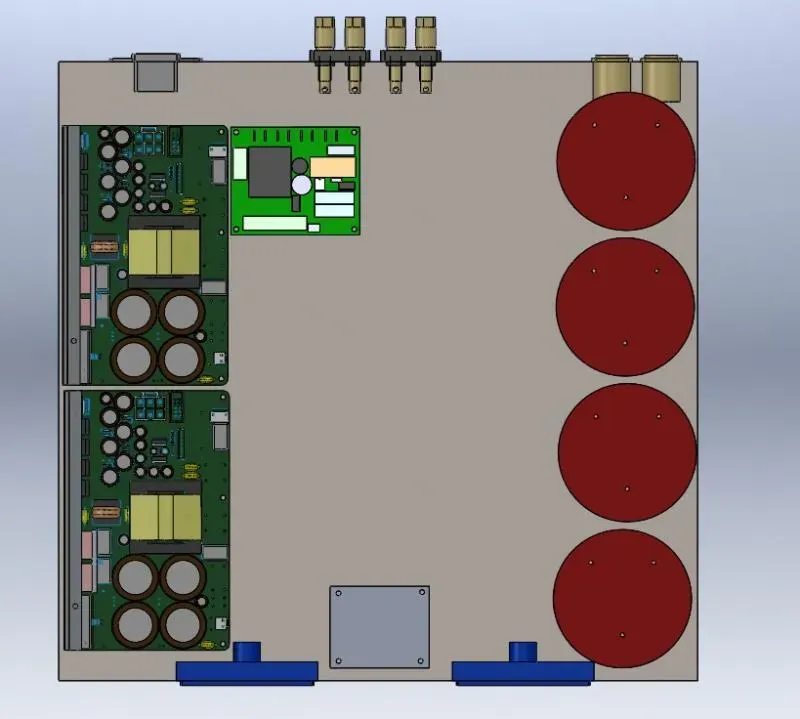

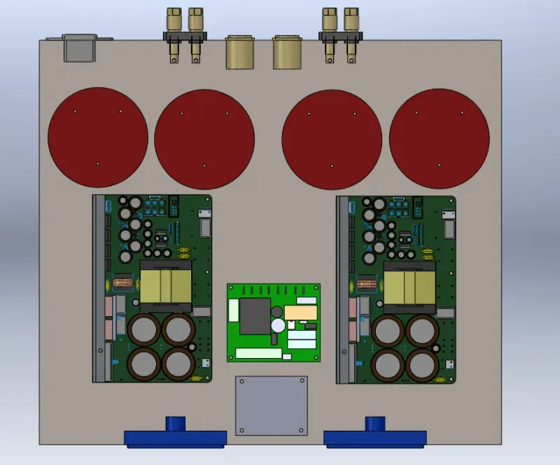

    Other than the case I'm pretty out of my element on this one so looking for some input from you electical guys.

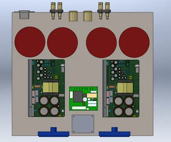

    This came up in other spots and I'm still not sure if I will go bridged or not, in either case I'll cut/tap the holes for it just in case. I'm shooting for are more standard 17" wide than the tiny cases people typically use with class D amps. The red things are the NC400s, the SMPS1200s are self evident, as well as the soft start. The grey pcb up front is the driver board for the VU meters. The only thing I haven't drawn yet is the pushbutton I ordered (well I ordered a few to make sure the stainless matches).
    Looking for some input for this layout before I get to far into the industrial design aspect of the case.

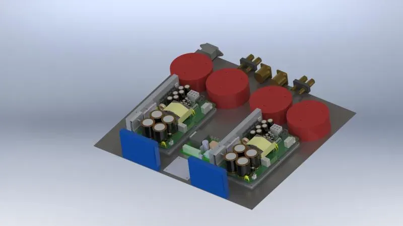

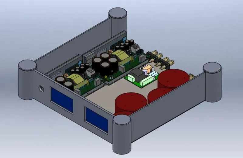

    And an ISO render. Everything is to scale.
    This kind of thing is quite important for making sure that noise and mains buzz/issues are kept to a minimum. A SMPS does help with this as it is free from traditional rectification noise and the otherwise induced transformer currents, still it's prudent to keep the layout as clean as possible to ensure satisfactory performance.
    I know that this is going to overlap with some of your current overlap so bear with me on this.
    First of all you want the mains inlet to be on one far side of the cabinet. You then need to place the softstart and SMPS units as close to the inlet as possible. My recommendation would be to place them down the left hand side of the cabinet as it is now, keeping the mains inlet in the same place.
    Then place the input connectors as far to the other side of the cabinet as is possible.
    The inputs work at a low signal level and are of a high impedance, this makes them the most susceptible part of the design to picking up any noise that you don't want. The mains inlet and the SMPSs are the noisiest parts of the circuit, radiate magnetic fields and work at high voltages, making them the most capable of coupling into place you don't want them to, so keeping the two as far a part is always a good idea.
    Looking at the ncore modules, if you place the side with the input connectors to the north, the large connector to the left is where you input power, the connector to the right of it is the loudspeaker output and the connector to the right of that is the signal input.
    The way you wish to lay this out is with the 4 ncores facing north with their connectors facing the back of the case. They should all be placed in one line, one closest to the back of the enclosure, then with each one further south of the other towards the front of the case.
    The input connectors on the ncore boards should then all be closest to the right hand side of the case, the same as the input connectors. You then wish to take the cables you've got for connecting the ncores to the input connectors and run the wires directly to the right, to the right hand side of the case and then up along the side of the case to the input connectors.
    Next you've got the power to route. Your power supplies, being down the left hand side of the case, are in a good position to connect to the power connectors of the ncore boards. Take the power wires directly to the left of the power connectors on the ncores and towards the power supplies. Make sure the power wires are twisted together, or braided. If you're using the ncore power cable then obviously just go with that.
    Finally you've got the outputs of the ncores. The connectors for these should be placed away from the signal inputs and closer towards the power input end of the case. Loudspeakers are low impedance devices that require large voltages to operate, they do not couple easily with interference and the like, but the loudspeaker outputs can and will couple into the input circuitry, so again, you want to keep the loudspeaker outputs away from the inputs.
    Run the loudspeaker output wires off to the left a little, from the connector, and then up to the outputs.
    If you arrange things like this you don't have any wires crossing each other that could otherwise lead to problems and you also keep the sensitive areas of the circuitry away from the parts that could inject noise into them.
      Those beautiful Wavecor Ardents of yours are just crying out for an amp like a Pass/First Watt F5Turbo or F5X if you want to go DIY. A couple of honking 100W+ class A monoblocks would be a great compliment. 8) :twisted:
      5th has provided good guidance. I will just add keep all wires pairs twisted. Signal and return, positive power and negative, Mains neutral and live. Be mindful of where the current flows to minimize the effects of loop area. You don't want antennae radiating or picking up noise inside your enclosure.

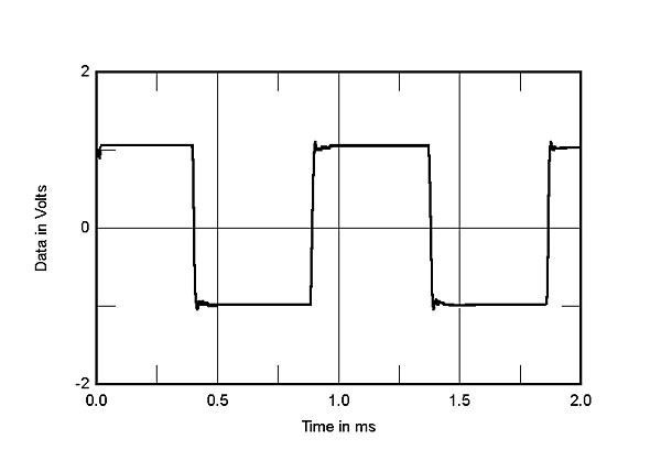

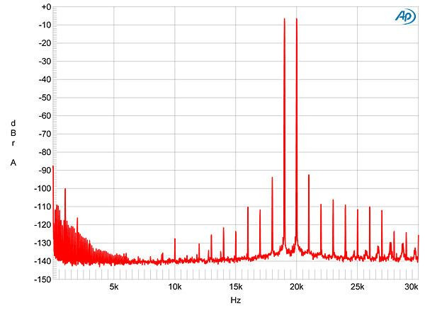

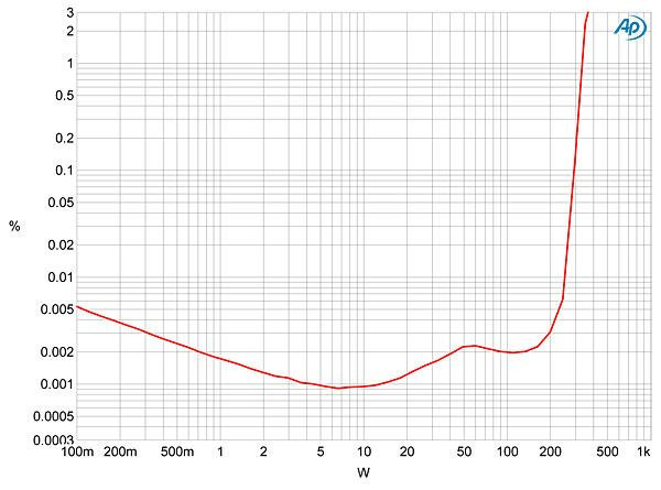

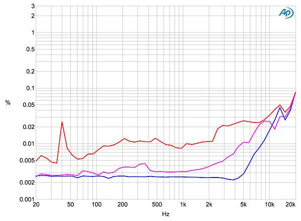

        Good suggestions here; for example, a wider, more shallow enclosure might help with implementing some of Mat's inputs.
        Now, as far as that first watt business goes, I'm more interested in the first 20 watts, and with THD+N that is mainly limited by the noise floor of the driving source, the nCore 400 doesn't give up much to anyone....
        One might even argue that this is a First50 design...
        And with the somewhat lower sensitivity due to the characteristics of the Wavecor SW223BD01, that's a good thing! :T

          Thanks for the great feedback guys.
          5th Element, is this what you were thinking? I've seen (especially on the machined cases) dividers added between the power supplies and amp modulus, think there is any actual advantage to that?
          This still maintains the 16" wide floor I'm shooting for, will be posts in the corners that will fill it out a little bit. The depth is at 15" and I'm fairly limited by the size of the NCORs. The only thing I'm not really sure of are the mounting holes of the amp modulus in relation to the connectors. Can someone with the ncores kicking around take a picture of the top and bottom of them lined up with this image?

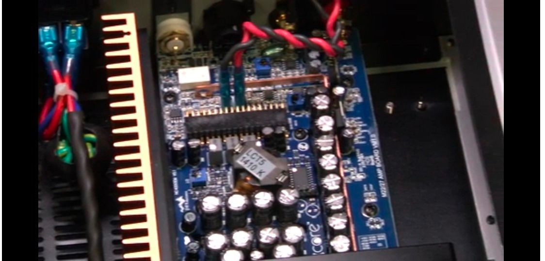

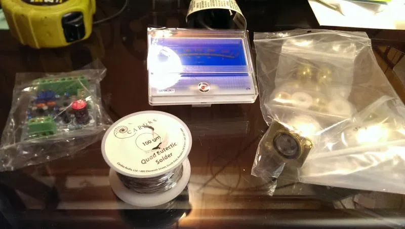

          And some parts started to show up today. I'm a bit unsure of the blue VU meters:

            Yes, that is pretty much what I was getting at, although I would put some distance between the ncores and the right hand side of the case.
            Dividers can help, but usually the best method for reducing interference is simply good layout and putting space between the various parts of the design.

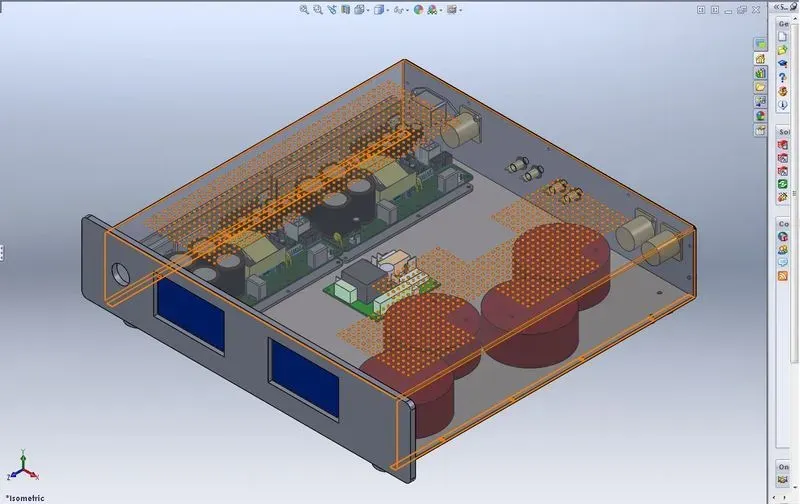

                    Found a few minutes to put into this project this past week. I think I got the case concept roughed out now I'm just waiting to hear back from my sheetmetal guy about how he wants to preform the stainless origami. So the front will be waterjet cut, then the recesses on the VU meters chamfered. I'm looking for some sort of off the shelf tapped blocks so I can uses fasteners, I can weld it but that's not very professional. Right now the top, sides and back may all be one piece.
                    I had a thought, is there a cheap/easy pre-made board I can add that would facilitate some sort of LED clipping indicator? This goes back to the suggestion of only adding 2 more NC400s if I find I'm running out of jam.

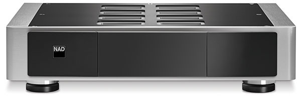

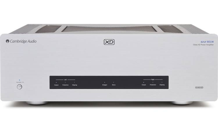

                                              I'm enjoying seeing you work through these issues- I'm HUGELY frustrated that I have so little time to work on my own that I can almost foresee being able to buy a NAD M22 before I can find time to assemble my nCore mono blocks!
                                                Click image for larger version  Name:	316nad.promo_.jpg Views:	0 Size:	19.0 KB ID:	940640
                                                Haha well this electronics stuff can be frustrating--designing the enclosure is fun at least. It was interesting, I read that the M22 is based on the NC400 and not the NC1200 that we initially thought. That gave me more reassurance of the value of this project.

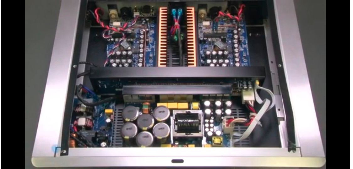

                                                    That's interesting- where did you hear about that? I came across this thread on Audiocircle which mentions it, and also has a lot of trash talking by people who haven't seen or heard one or held it in their hands, but are willing to pass summary judgements (OK, pretty normal for the internet, I guess....)
                                                    That's an interesting idea, too- compare a standard NCORE 400 build against the M22. OTOH, my build won't be particularly standard, with balanced input transformers and what not... the problem as always, is finding the time, and at the moment, setting up someplace to work on it!
                                                      Rod Elliot's sequencer circuit http://sound.westhost.com/project144.htm might offer the basics you need to trigger your amp. Tie the Collector of the BC549 in the "12V Trigger" section to the power control pin of the SMPS1200 and a 1-2K resistor to an always on power supply of appropriate voltage to shut it down. Apply 12V to the circuit's trigger and the SMPS power pin goes low. The 1K resistor to the always on power supply limits the current. Hope this helps.

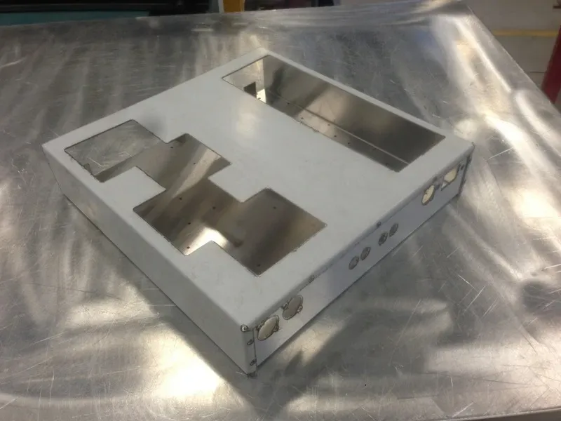

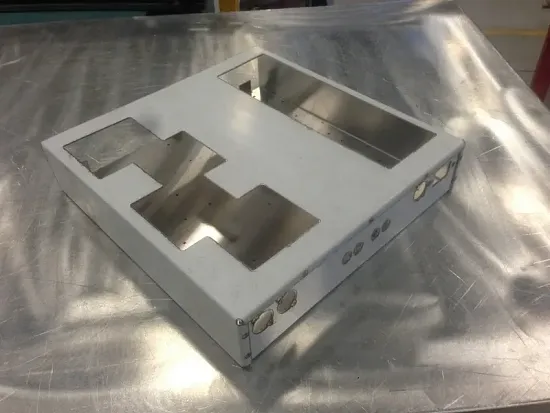

                                                                      Laser cut and CNC formed:
                                                                        Pretty.
                                                                        I wish I knew local people who could do cnc and metal work like that for a reasonable price.
                                                                        • benthe8track
                                                                          • 371
                                                                          It will be a lot prettier with the plastic off haha.
                                                                          Laser cutting can be surprisingly cheap, it's often more cost effective than buying the raw sheet, at least in my experience.
                                                                              Click image for larger version  Name:	IMG_3077_zpsnm1rrq5c.webp Views:	0 Size:	29.1 KB ID:	940642
                                                                              I'm jealous! :W :B

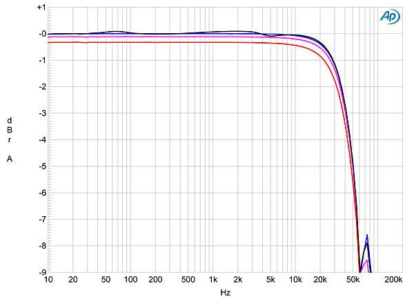

                                                                                  Just to stir the pot a little more, build the sense of anticipation, here's a review of another nCore design, just out on Stereophile... online finally.
                                                                                  Several seconds after I began listening to it, I knew that Theta Digital's Prometheus monoblock amplifier ($12,000/pair) was different from other amplifiers. The violins and brass were more dynamic, and had more pace. The orchestra sounded more three-dimensional, depicted in relief by a degree of hall ambience I hadn't heard when I played the same recording through my reference solid-state stereo amplifier, a Mark Levinson No.334.
                                                                                  They're mono blocks, and they're purty, and purty expensive, too, at $6K each. But they're not crazy expensive... well, by some standards. Go price some of the new Boulder amplifiers!
                                                                                  Output impedance is low, so frequency response is pretty good, including minimal response interaction with the simulated loudspeaker load.

                                                                                  1 kHz square response is quite clean for a CLASS D amp- too bad we can't get CD players that look this good.

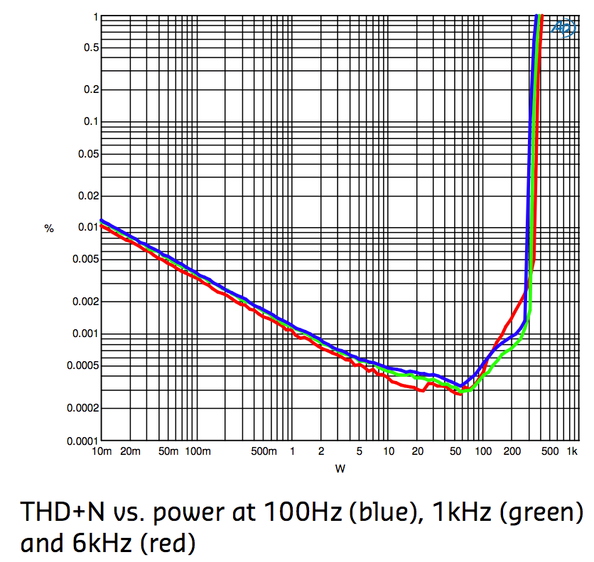

                                                                                  1 kHz distortion versus output power is in the ball park for what I might expect for an nCore design, though not quite as good as the published nCore 400 specs. Certainly you could call this a "First 10" amplifier as regards the quality of the first 10 watts, which appears to be limited only by noise performance.

                                                                                  Distortion versus load impedance and frequency are shown here at 20VRMS, moderately high output power: obviously, not so happy with 2 ohm loads, but it's actually lower than many other tested class D amps at 8 ohms.
                                                                                  That rising harmonic distortion at the top end might raise concerns about high frequency intermodulation distortion...

                                                                                  After reviewing project commitments and the flaky protection circuit behavior of my Cambridge Audio 840 amplifier (which still sounds great, just doesn't want to turn on with a speaker load connected), and seeing how long it will be until I work down the to-do list to my own nCore DIY project, I (watch out, here come the internet cliches) broke down and pulled the trigger on an NAD M22, as I'd really like to get the audio system fully functional again in the near future, not just by next Christmas... (this includes wrapping up the data prep on the new drive for the music server, and setting up the Mutec MC3 and the new Rubidium oscillator and linear power supply for THAT....
                                                                                  Most places are quoting 1-2 weeks before shipping; Crutchfield just reported "Low Stock". We'll see how that turns out... stay tuned.

                                                                                  BTW, this is the only place I've seen interior shots- (captured from video, though)
Name:	NAD%20Masters%20Series%20M22%20Stereo%20power%20amplifier%20at%20Crutchfield.com%202_zpsv7djl4pn.jpg
Name:	NAD%20Masters%20Series%20M22%20Stereo%20power%20amplifier%20at%20Crutchfield.com_zpsnrkuaxdo.jpg
                                                                                  Definitely not a stock nCore module- but I didn't expect that, based on the write ups I've read about what NAD brought to the table for this project. Note the copper bus bar on the top side of the PCB. Pretty clean looking layout all in all, and lots of small low impedance caps... (big caps have more inductance- not a good thing in the power supply for a Class D amp).

                                                                                      The new version of the Cambridge amp looks pretty good, too,
                                                                                      But I'd promised GF to look into the Class D to "save energy" (40 watts idle power versus 180W; output efficiency around 90%, instead of 40% for an AB amplifier). The 840W I've got is a regular space heater, which is OK in the winter, but not so great in the summer time down here in the more southern parts of the world!
