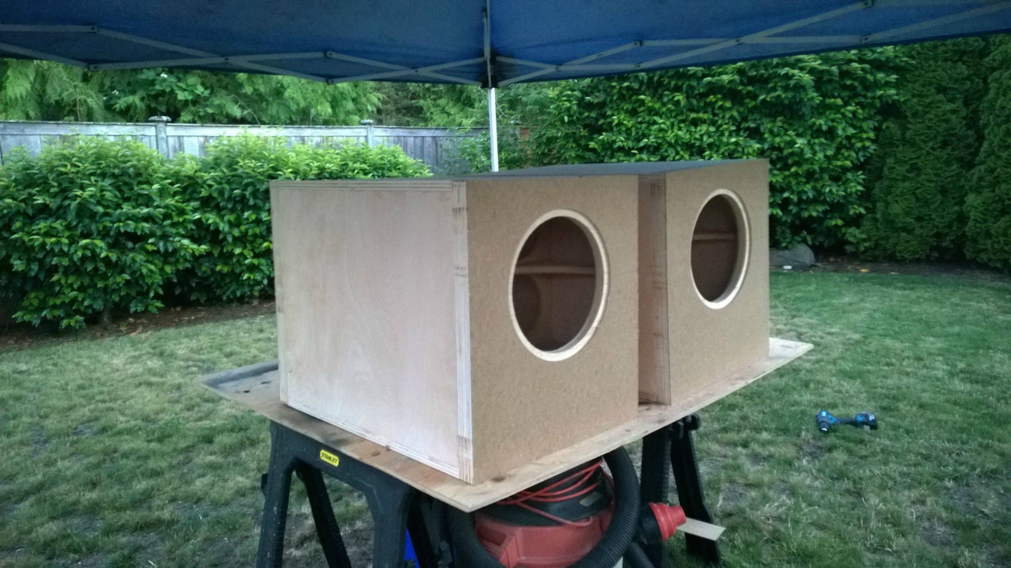

    I have (4) Dayton Audio DVC310-88s that are split between in 7 cubic foot enclosures (see below). I was gearing up to start finishing them when I decided it'd probably be almost the same amount of work to just build new enclosures that needed less prep. Additionally, I think I'd like to make them smaller and with better bracing. Better yet, I won't have to go LFE-less while I build, prep, paint and finish
    So, I'm looking at 4.5 cubic feet (probably will bump up to 5 to account for bracing and driver displacement) per pair of drivers. They'll be powered by a Dayton Audio SA1000 amp (about 950w to power all 4).
    From what I've seen online, there aren't many HT subwoofer designs using dual drivers that are 12s ( at least that I've found, please feel free to direct me if you know of anything). Most are 15s and 18s in front loaded designs. Does anyone have any recommendation on driver orientation that I should look into? Stick with both front loaded? Opposed drivers? Any others?
    Mostly looking to keep the box size below 5 cubic feet per pair have a clean look (when finished) - will probably end up with Piano black. What do you guys think?

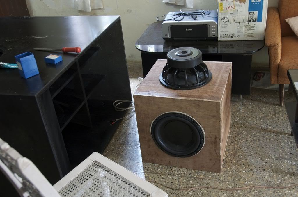

      Thanks for jumping in 5th! Congrats by the way!
      So I assume you are referring to this design, but dual opposed.
Name:	dual opposed out woofer.jpg
      From what I've read, this reduces linear distortion. Does the reversed mount increase vas? Is it more beneficial than a more traditional dual opposed design such as these? Maybe to answer my own question, but these designs seem to be all sealed - so would that be part of the reason why these won't be optimal for my particular situation?

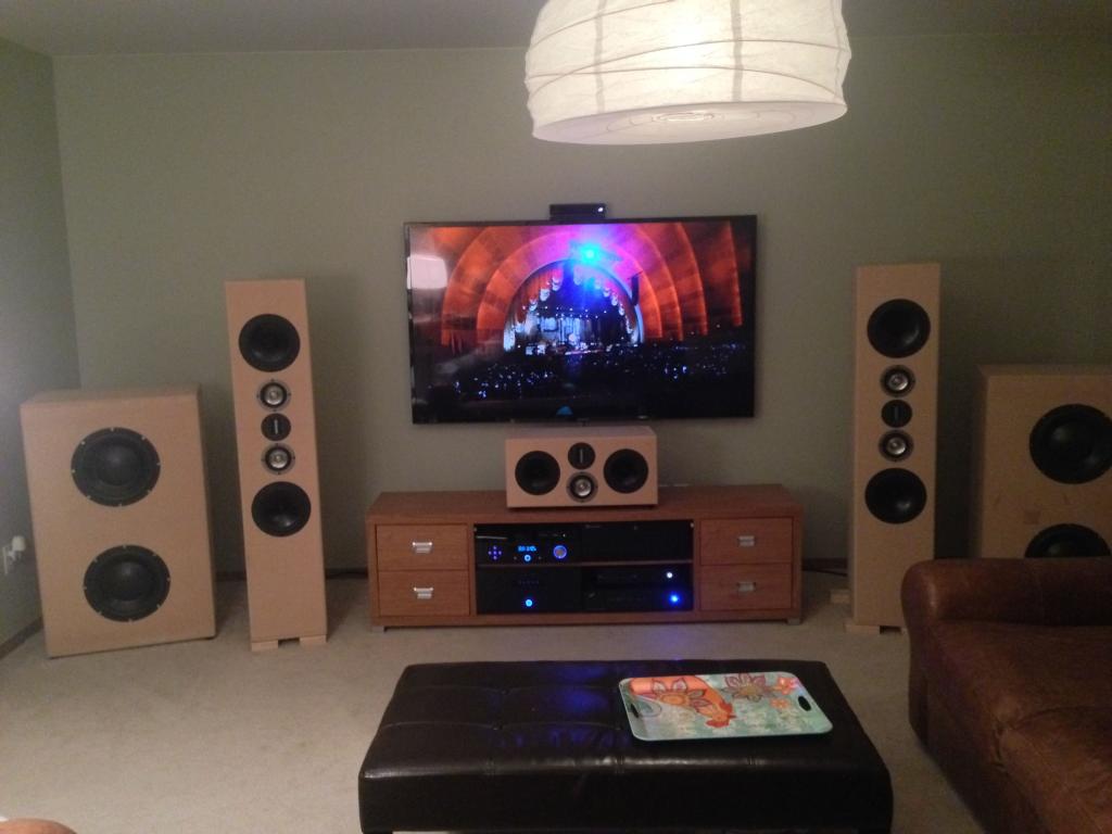

      Lastly, I have seen a few of these....
Name:	weird design.jpg
      Any experience or knowledge of this type of design?

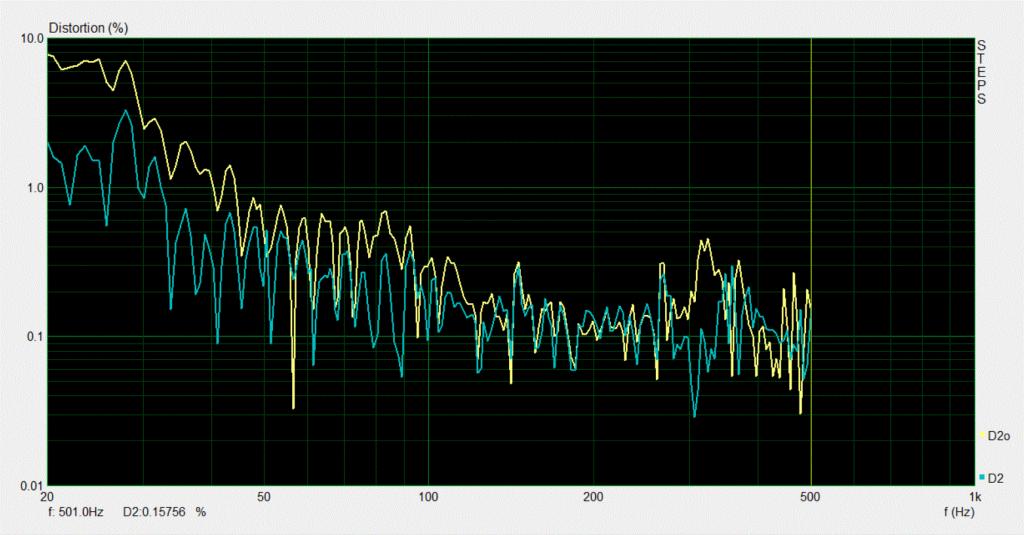

        You can see an example of this in a measurement I made of some Peerless XLS drivers. The upper trace, the kinda yellowy one, is two drivers mounted in the standard push-push fashion. The bottom, greeny-blue trace, is with one driver flipped with the magnet facing out. You can see there is a significant decrease in distortion. This only shows the 2nd order distortion as the others remained pretty much unchanged. Needless to say, for a sub, reducing the distortion at 20Hz from 8%, in this case, down to 2% is rather significant. And you can see it has a noticeable effect up to just above 100Hz - just the range we want to the sub to realistically cover.
        Now those cabinets with drivers mounted push-pull, but with one driver concealed within a hidden chamber, or on the adjacent face compared to the front firing driver, still benefit from the push-pull arrangement, but I would imagine that the decision to mount them like that is more due to how it looks. Having the second driver mounted like in the X12 is certainly fairly unobtrusive and most people probably don't appreciate having magnets sticking outwards.
        It's a shame though because putting the magnet side driver on the rear would be the icing on the sub-woofer cake. When configured as such, when the driver on the front moves forwards, the one on the back moves backwards and any force that would encourage the enclosure to shake or move is completely cancelled out.
        A ported enclosure benefits from these just as much as a sealed one does, it's just that small sealed cabinets are very much en vogue when it comes to domestic acceptance. I am in agreement with this as I like my small multiple subs, but if I had the space I'd sure go with a large vented cabinet, at least for the main sub.
        Reverse mounting by the way is just the same as standard mounting in that you need to double the enclosure volume when using two drivers. There's no special to it, unlike an isobaric arrangement which halves the VAS.

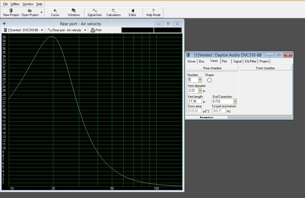

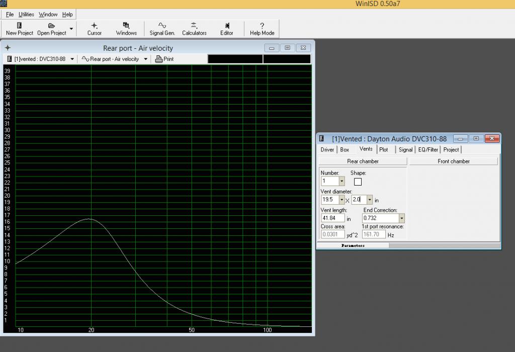

                Alright, so to explore the push push idea 5th mentioned up above, I am seeing that 21in height x 21in width x 25in depth will give me the needed volume. In order to keep the ports away from any walls, that leaves me with front firing or top firing. Front firing can easily be concealed with a speaker grill, so I think that this is the best bet.

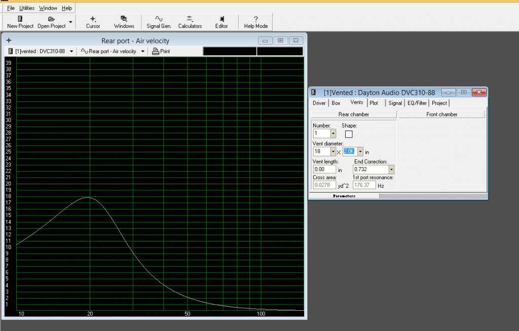

                As for ports, I am thinking the best option is a an 19.5in width x 2in tall slot is the best option. Minimal velocity and probably the most aesthetically pleasing. OTOH, PVC ports are the easiest to adjust. hmmmm
                Below are the options I'm looking at.

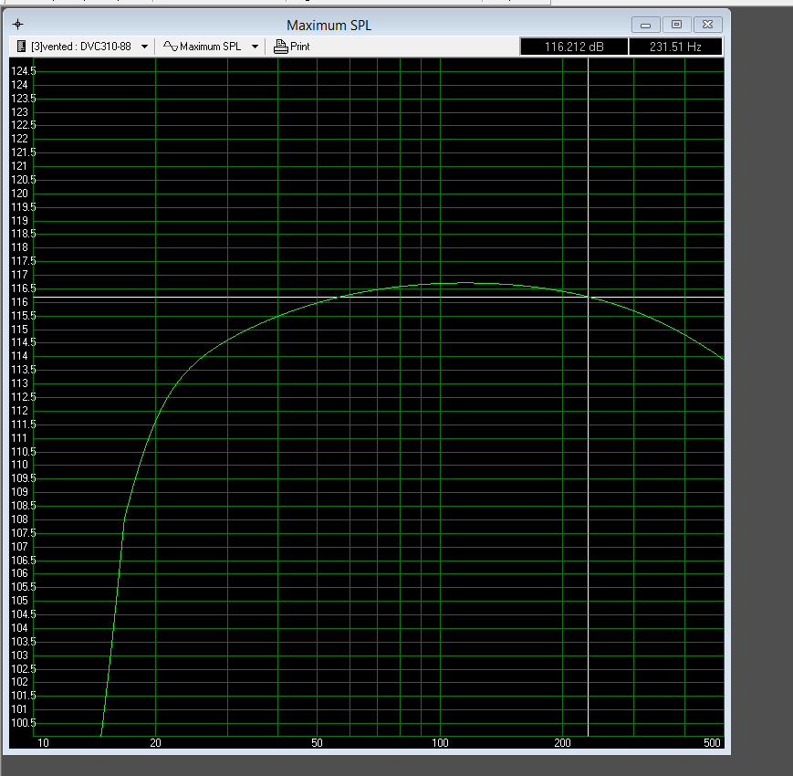

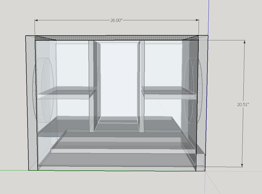

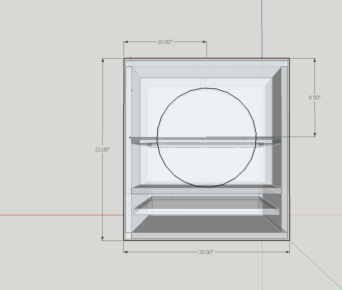

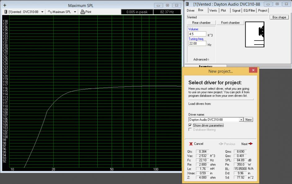

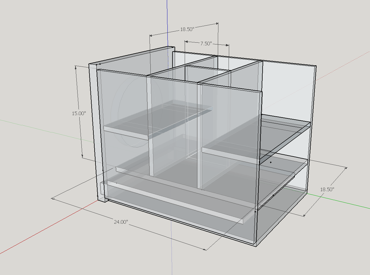

                      I think I mostly finalized the design and have settled on an 20in x 22in x 29 enclosure for net 4.5ft^3 after driver, bracing, and port displacement. The port length should give me a tuning right at about 20hz give or take a hertz. I had a chance to check out Google Sketchup today and learn the basics, so I made a little model. All calculations are for one enclosure with 2 drivers.
                      Here is modeled SPL
                      Click image for larger version  Name:	uNtufVP.png Views:	3 Size:	21.4 KB ID:	935426

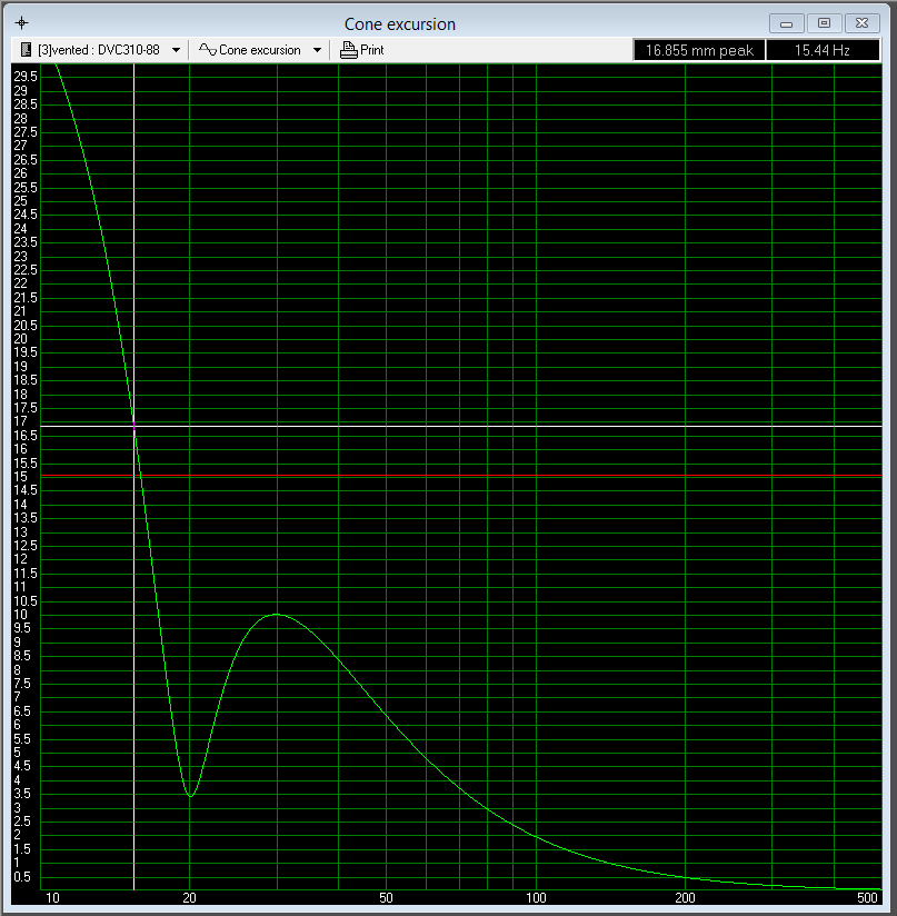

                      Modeled cone excursion at max power
                      Click image for larger version  Name:	AEw2viR.png Views:	3 Size:	22.1 KB ID:	935427
                      And here is the sketch up....I didn't add the cutouts to the internal bracing...but there will be plenty of cut outs for air flow
                      Baffle shot
                      Click image for larger version  Name:	tMFkIZF.png Views:	3 Size:	24.2 KB ID:	935428
                      Side shot
                      Click image for larger version  Name:	VZ8LwAV.png Views:	3 Size:	26.1 KB ID:	935429
                      Angle shot
                      Click image for larger version  Name:	drN47BP.png Views:	3 Size:	47.8 KB ID:	935430
                      Any red flags? advice?

                            Indeed.
                            I'm liking the design and the slotted port.
                            You're going to be getting plenty of output out of those that's for sure!
                            They remind me of the Wilson WatchDog and are certainly more WAF friendly than what you currently have.
                            110dB at 20Hz 2pi no doubt, but floor and corner mounted you'll get all that back. I wouldn't be surprised if you can push 120dB+ at 20Hz in room on transients for the pair.
                            Construction looks fairly simple, I bet you're rather exciting to start making saw dust

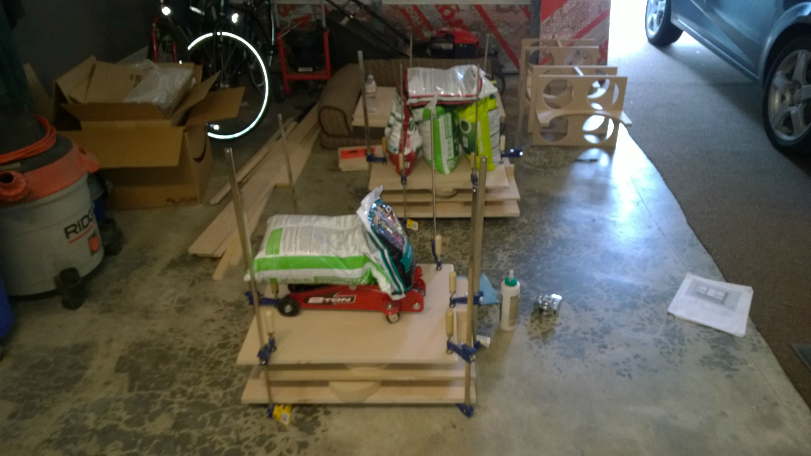

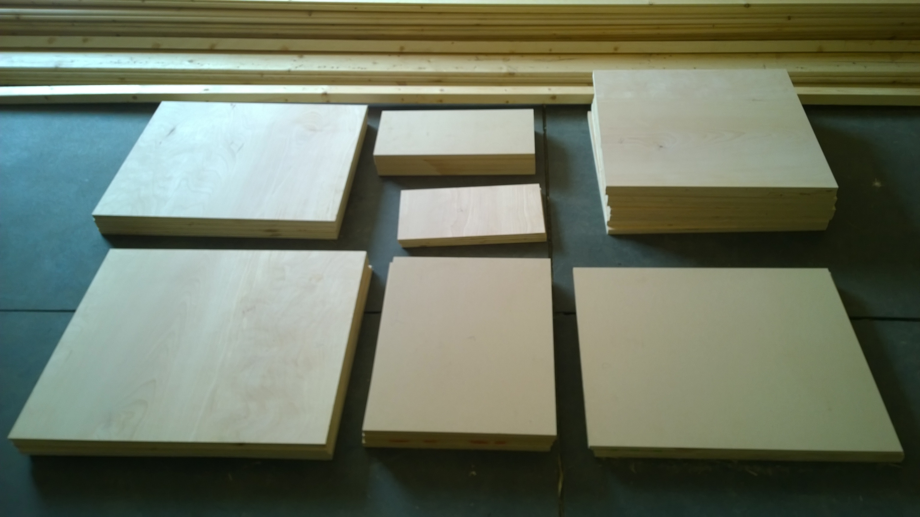

                                      As promised, cut the wood this weekend and received the Fuji spray system yesterday. Now I'm getting excited!!

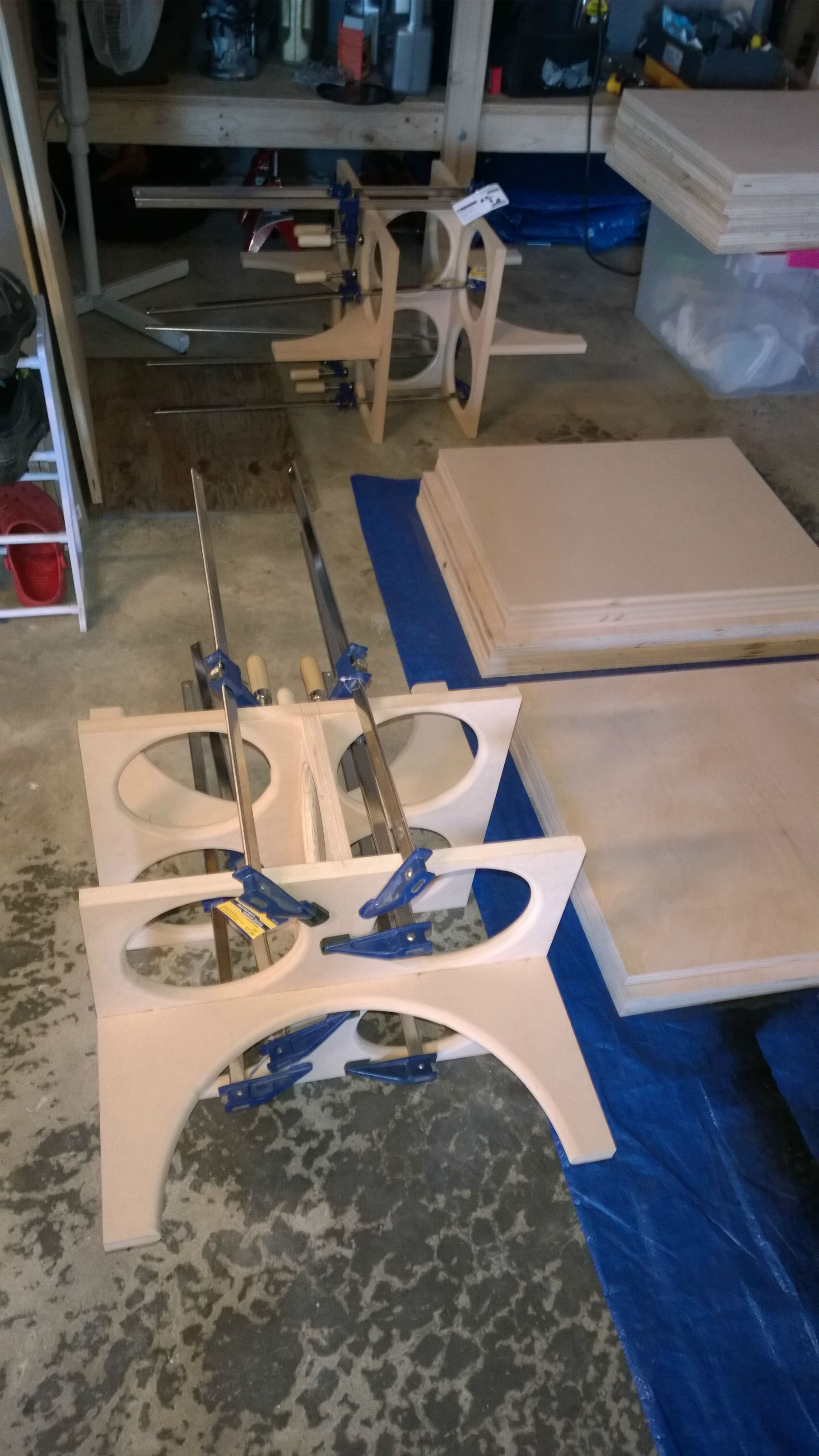

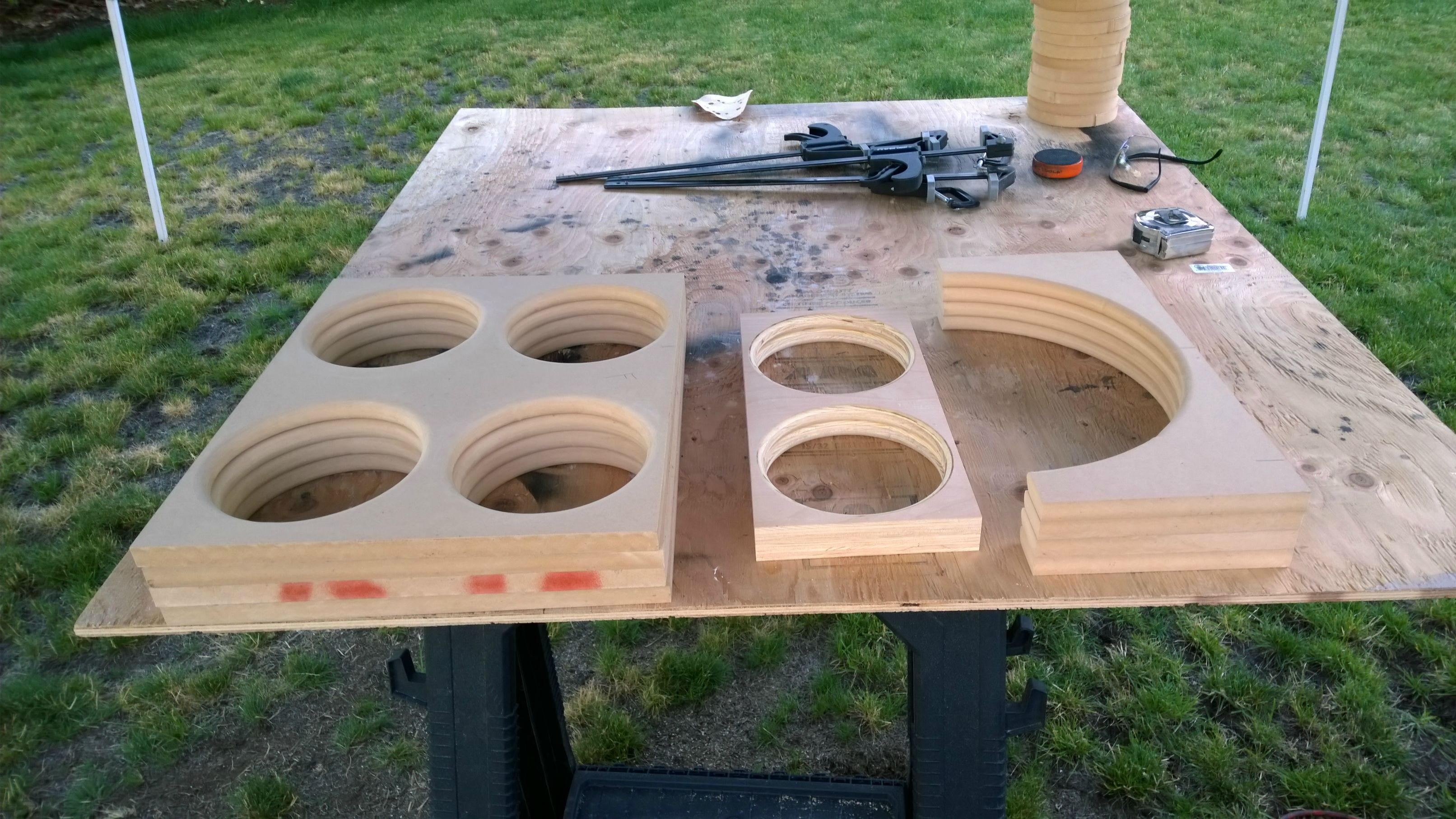

                                            Small update - managed to get the baffles glued together, braces routed, rounded and clamped. Before I routed and rounded, I would never have believed how labor intensive that is. Wow!
                                            This weekend I am hoping to get the boxes glued up. Then it'll be time to start covering in hardboard and prepping for finish. I am excited to try out my Fuji spray system!

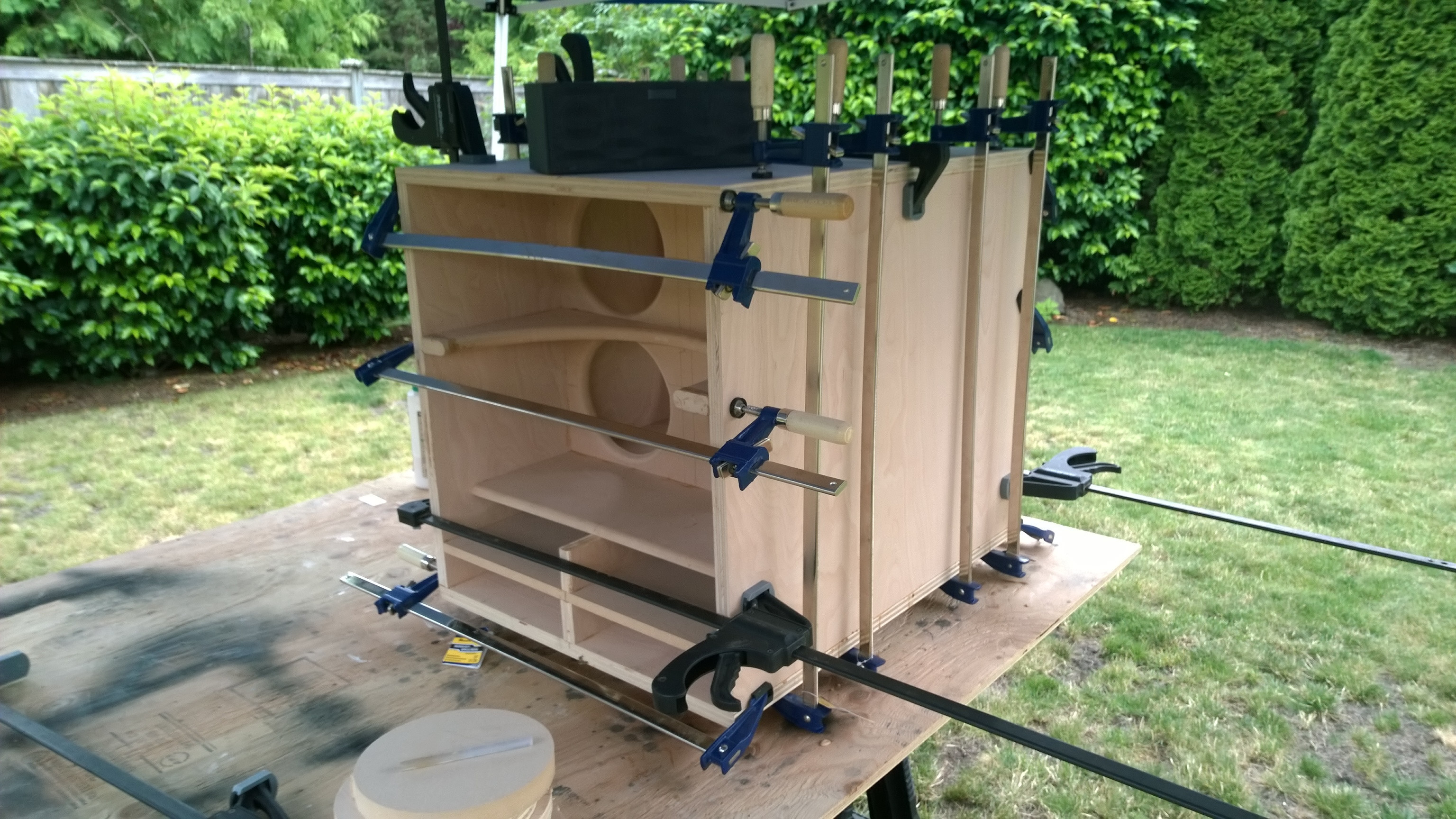

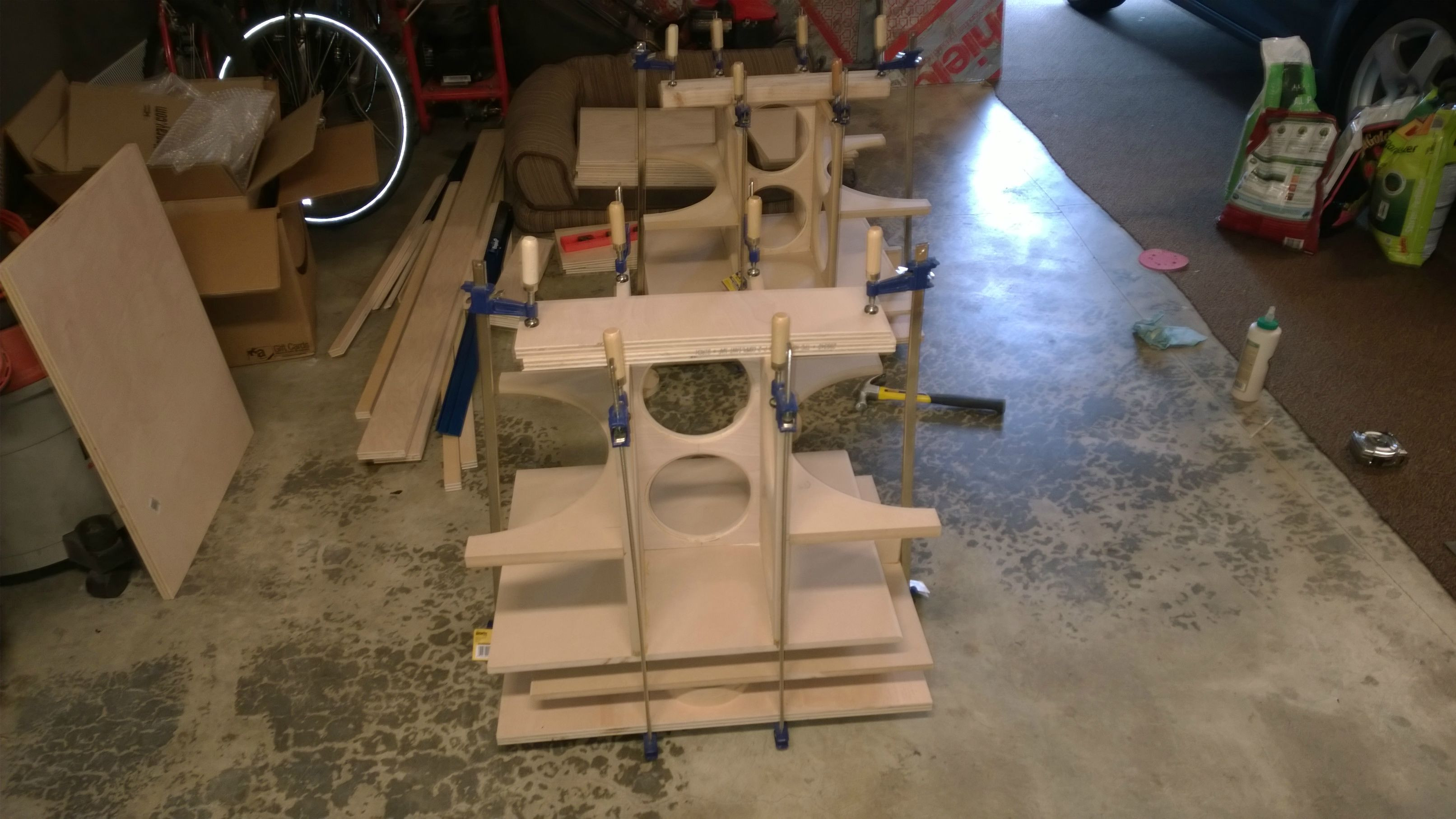

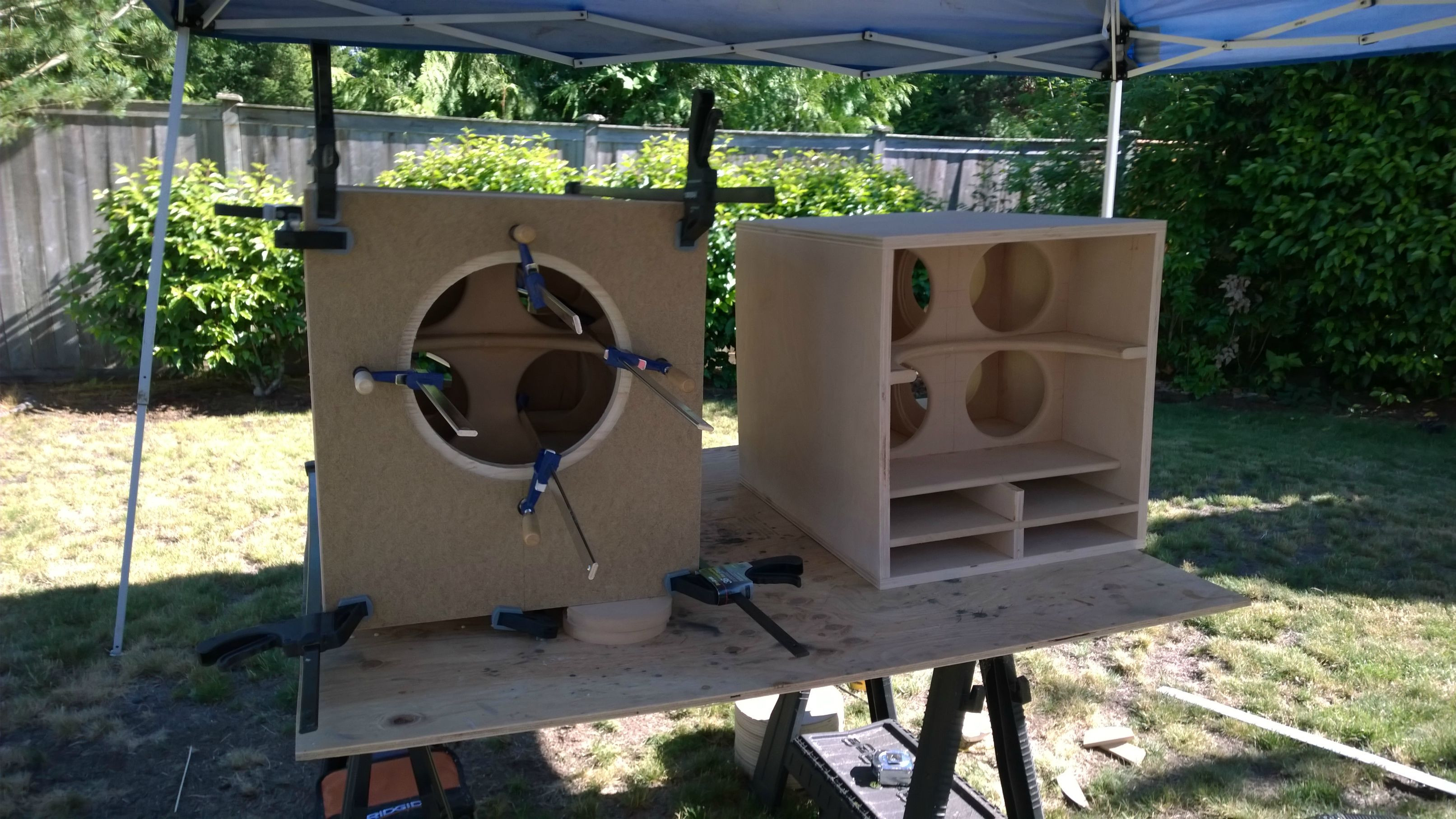

                                                Made more progress today - got the ports glued and the bracing on top of that. The port gluing was actually quite the brain teaser - took a little experimentation to get a viable option. Ended up gluing the port brace (2in tall, 3/4in wide) first, then placing 2in "supports" (spare wood) on either side to support the port board. Worked rather well.
                                                Did hit a snag with the bracing though - all in all, it ended up being about 1/8in - 1/4in taller than the side of the outer box. So, I need to shave about 1/8in off the top of brace...i'm thinking sanding is my best bet. Any thoughts? I could also add 1/8in to the top of the side board. Whatchu guys think?
                                                  Loadsa clamps, yes!
                                                  It's difficult to know what to recommend. Personally I'd try and clamp a straight edge in and remove the excess with a router, but if that's not possible, both sanding and gluing will work. If you've got material of a suitable thickness, ie like adding in a few of layers of veneer, then that would work well. Sanding can be very hard work and 1/8" is quite a lot to sand away.
                                                  • knowledgebass
                                                    • May 2013
                                                    • 159
                                                    Could you cut a dado on the capping piece? For me, I'd probably use a hand plane if it had to be trimmed.
                                                    • kevinm
                                                      • Jun 2013
                                                      • 417
                                                      I thought about doing that too. Ended up with 5th recommendation on using a router. Worked pretty well. I just added scrap on each side of the piece that needed to be reduced to use as a guide. Just did a little sanding after that and was good to go. I have the first one gluing up now - sans the baffles!

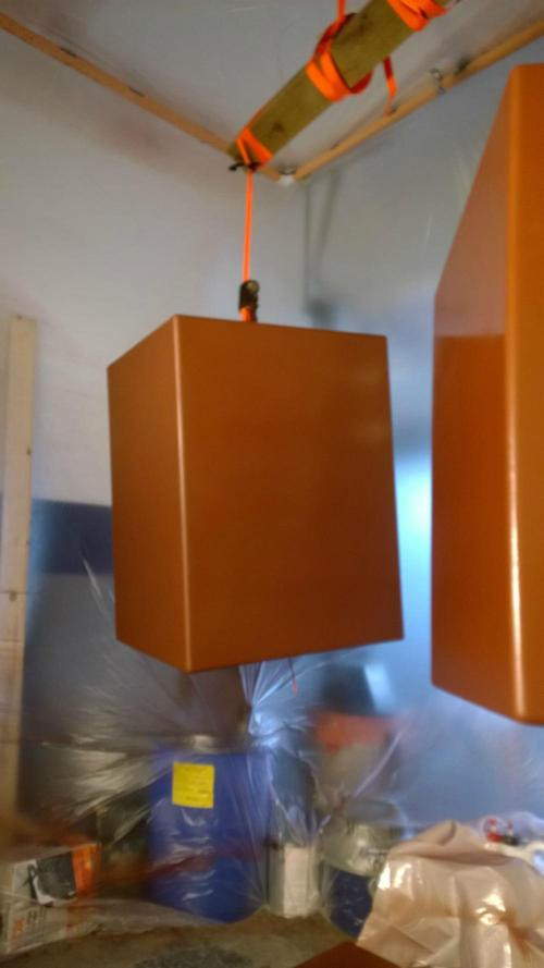

                                                                I am planning the painting stage, anyone have any idea how I could hang them while I paint them? I could put a 2x4 across the driver opening and attach a string to it, but I need something to hang that off of. Anyone have any ideas?

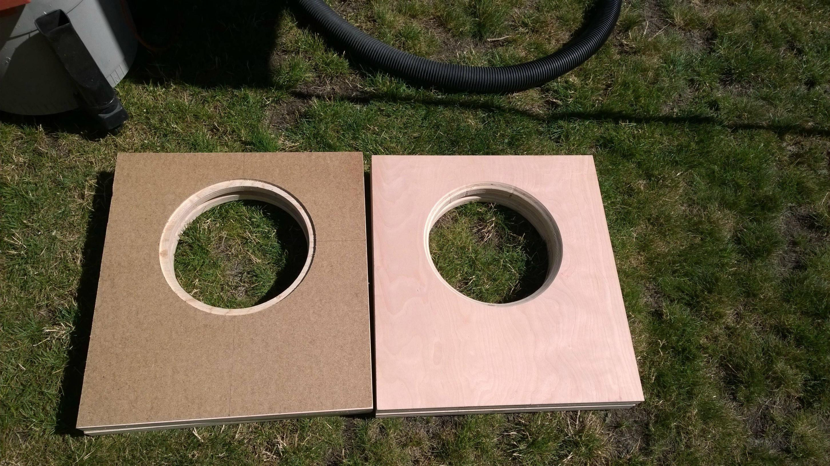

                                                                  Finished routing the driver recesses and cut outs with 1/2in chamfer on inside

                                                                  Both glued together and flush trimmed.
                                                                  Now onto cutting out the port opening cover the remaining 4 sides in hardboard.

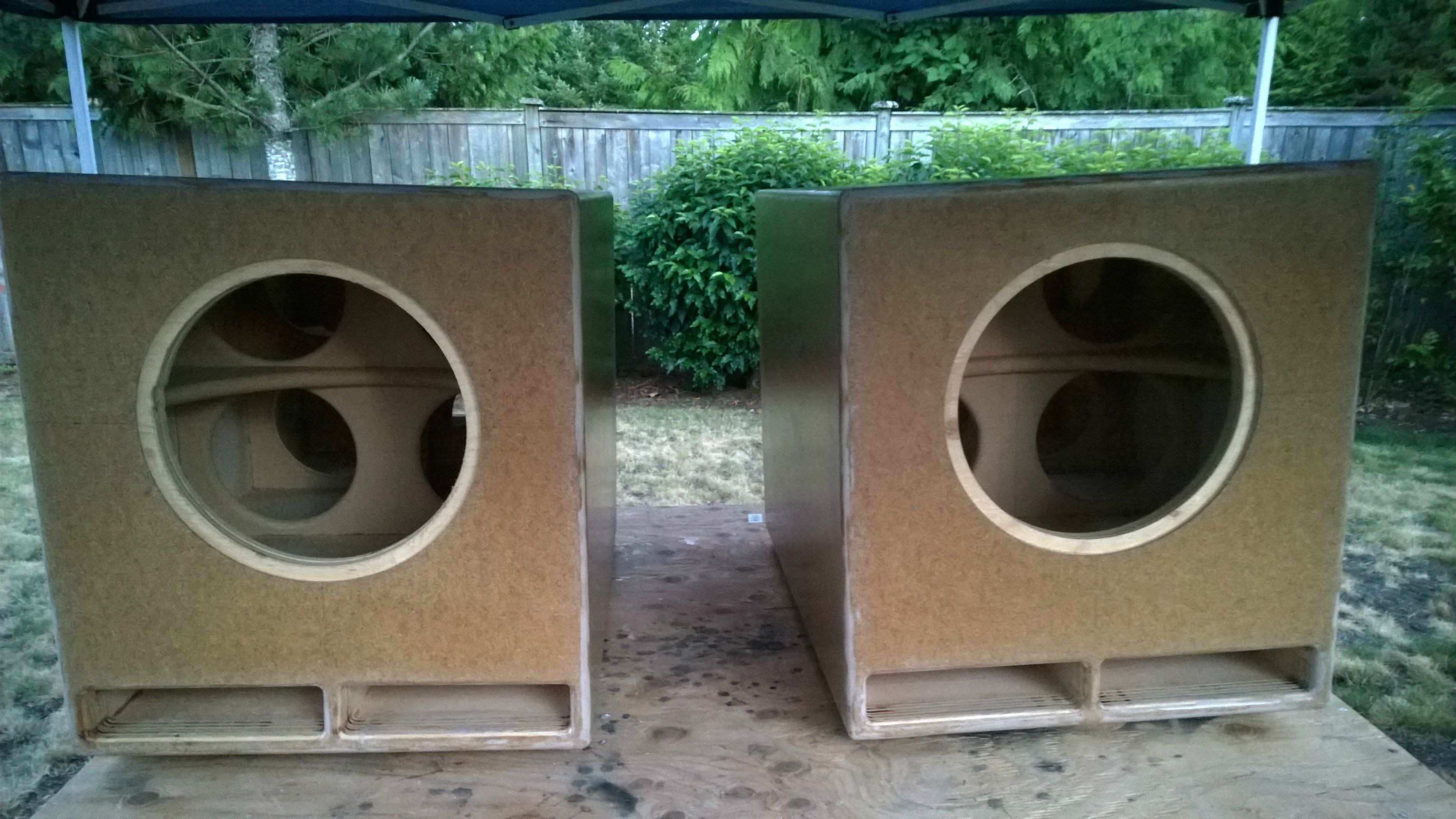

                                                                                    Update!

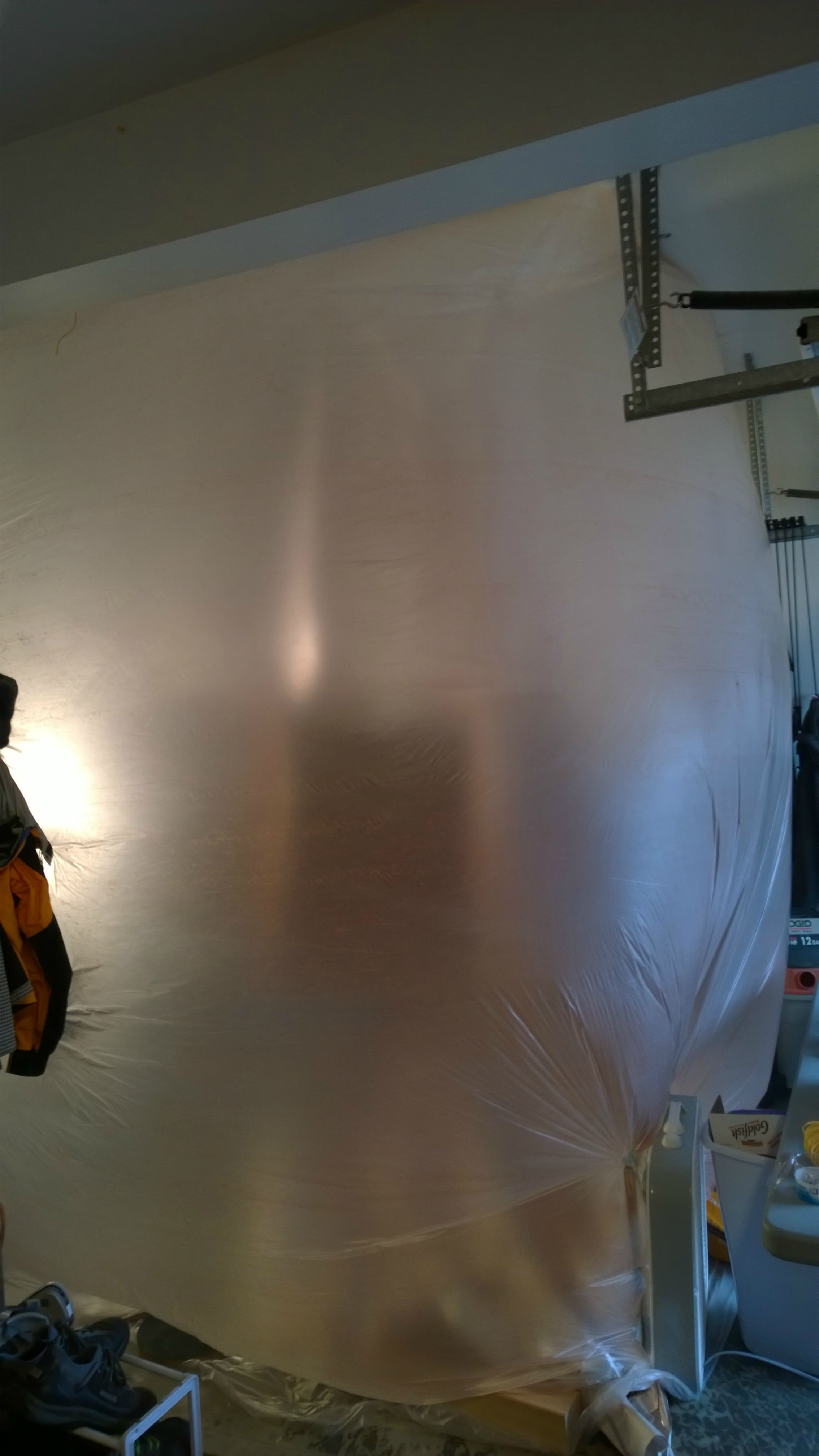

                                                                                    I managed to get my "paint booth" setup. Seriously half-baked looking when compared to the one I found on Pinterest, but it works! Even has positive pressure inside. The cabinets are hanging from the rafters through the access panel to the attic in the garage (benefit of having an engineer for a father when you need ideas!). I just ran a 4x4 across the opening, then two ratchet straps to another board that I could use to space out the cabinets. Then hung two more ratchet straps off that board (one on each end) and to a 2x4 stuck in the driver hole. Overall, I think it works pretty out pretty good as none of the surfaces are touching anything and I can spin them if I need to.

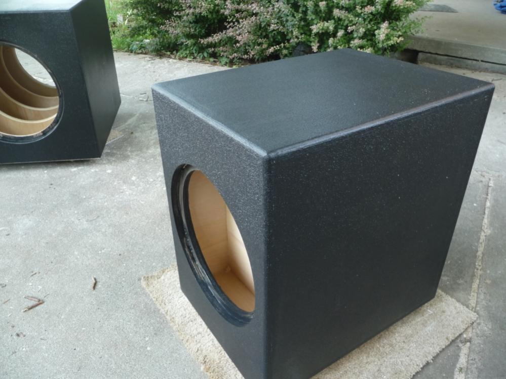

                                                                                    Shot my first coat of primer using my Fuji spray system. Took quite a while to learn the whole acetone/enamel ratio for the gun and then another 45 minutes or so to dial in the gun. After about 1.5 hours of tinkering, I think I got it to work pretty well. The cabinet picture below has a really even coat on it - even though the color is really strange.
                                                                                    Tomorrow will be another coat of primer or 2 and then starting some wet sanding!
                                                                                      That looks fantastic

                                                                                          I showed her my progress and the look of horror on her face before she learned that was just the primer coat was priceless. I think a nice polished orange would look pretty good
