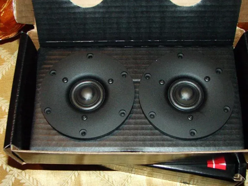

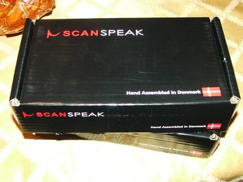

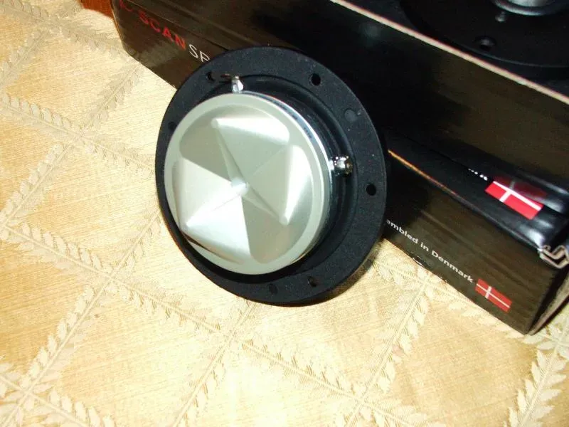

    Santa makes an early delivery at Casa Curmudgeon today!
    Two for me & two for Dan (PewterTA)

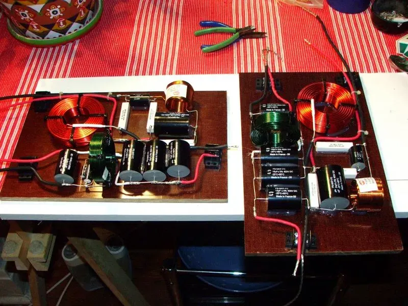

        Time for an update on the "Duded Up" Nat P.
        First off, be aware this is NOT a pure 'drop-in' upgrade for those who already have made this speaker as the crossover requires modifications.
        Secondly, The Maestro has graciously configured two schemes for this project, however I have some opinions relative to the available options.
        This is not a budget-minded endeavor.
        We are talking about $280 tweeters here.
        Not constructing the slightly more sophisticated circuit The Maestro has developed with the Zobel network seems foolish.
        So too, skimping on the quality of the crossover components would seem, as Ben F might state, somewhat 'penny wise' but 'pound foolish' after one has already crossed substantially beyond the threshold of a 'budget-minded' project.
        Jantzen Superior Z, Jantzen Z-Standard & Mundorf M-Resist Supreme make up the BOM for this 'Duded-Up' project.
        I don't have the disposable income to source all these components at once, but if I took a few shortcuts I could speed things up for sure.
        And you know what, I did do that when I began construction of my Nat P's some eight years ago!
        I went with budget crossover components, thinking I could always go back & upgrade later.
        Besides, just how much better could all those fancy-ass thingies be?
        For crying out loud, they have the same frick'n values!
        Now, eight years & many many equipment upgrades later, I regret that decision over & over.
        I am missing the better performing components every time music is produced by my speakers.
        Do not get me wrong, I love my 'Twins' (as I call them).
        They have held forth against many much more high-priced commercial offerings.
        But I have learned in the long term, there is no value in rushing the completion of a speaker build by shaving a few percent off of the BOM.
        Just some food for thought based on my personal experience for those who may feel the urge to pinch a few pennies during a build.
        I will be placing my order for the xo components next week (thanks to a small xmas bonus The Wife is not aware of :W & still with a little left over for some small sparkly shiny things for her stocking).
        Then, since I made no provision for accessing the crossovers in my cabinets, I will need to cut an access on the rear baffle.
        Hopefully, I'll be finished in a couple weeks.

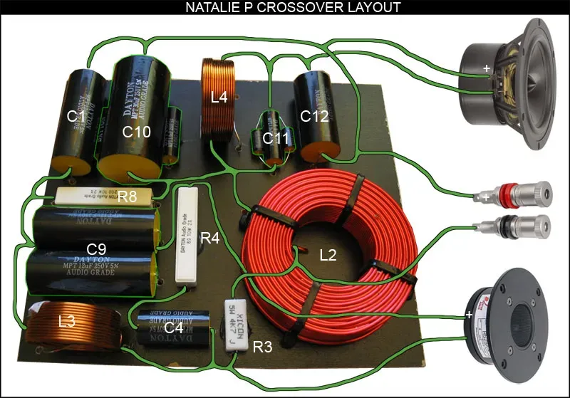

        This is the original Nat P crossover:
        This is a typical layout of that original crossover:
        And a shot of my original xo's:

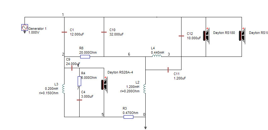

        Next are the two syms purposed by The Maestro:
        NatalieP Deluxe for Bill....
        OK, making some progress this Saturday, my comp day yesterday got blown off by my boss, but today is wife his probably keeping him busy and at bay... :W
        So, what we've got here is an updated schematic proposal for Bill, considering his plan to use the nice and spendy Scanspeak tweeter instead, which is about 4 dB more efficient. And some nice shiny new expensive caps in the crossover, too. Not being one to leave well enough alone, I also have dreamed up a more deluxe version, using a zobel network for the tweeter, which makes things a little more happy in the tweeter roll off. Sort of the OCD approach to a NatalieP, as if one really wanted an Ardent, but was settling because that dip Jonmarsh can't ever seem to finish the Ardent design, and besides, your wife wouldn't approve that much money for crossover parts!
        So, first the "standard" upgrade, without the zobel network added:
        Click image for larger version  Name:	NataliePSSDeluxeSchemNZ_zpsbb36083e.png Views:	17 Size:	14.8 KB ID:	934887
        Click image for larger version  Name:	NataliePSSDeluxeSPLNZ_zps1f9e61e1.png Views:	16 Size:	37.4 KB ID:	934888
        Quite respectable performance for a budget setup (a few more things tweaked slightly in component values), but no way to fix that unsightly bump in the response of the tweeter that arises from it's Fs impedance peak around 500 Hz.
        Next, the slightly higher priced spread:
        Click image for larger version  Name:	NataliePSSDeluxeSchem_zpsfcd3f048.png Views:	15 Size:	16.8 KB ID:	934889
        Mmm,mmm, good!
        Click image for larger version  Name:	NataliePSSDeluxeSPL_zps261c1334.png Views:	16 Size:	37.5 KB ID:	934890
        And just for good measure, the usual sanity check with a reverse connection of the tweeter:
        Click image for larger version  Name:	NataliePSSDeluxeSPLInverted_zpsf21c8829.png Views:	9 Size:	37.7 KB ID:	934891
        Nothing to complain about there...
        well, you could probably build this just on my LspCAD sims and things SHOULD work out just fine, but if you're not in an all fired hurry, I should be able to get parts on hand in early October to build a test channel, (excepting the SS tweeter, which will be a slightly less sensitive version) and build and test this out by Halloween. Right now my discretionary budget for September is tied up in a couple of parts orders for the Isiris midrange re-build, and in a ludicrous amount of new gear to support the music server- as they say, I'm all tapped out! Can't even afford a new guitar this month, not one!!! :roll:
        I will have a complete BOM with costs of the xo which includes the Zobel circuit posted up shortly.
        Last edited by theSven; 30 June 2023, 12:59 Friday. Reason: Update image location and quote

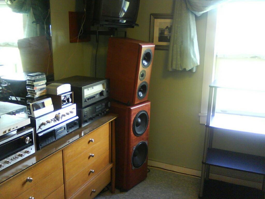

                                  Originally posted by speedle
                                  I'll need to replace the 1 cubic foot sealed ones that I built. I'm seriously considering going with the prefab black gloss ones from PE, and refinishing the bass bins to match. Kinda tired of the mahogany look anyway.
                                  Are those the ones in your avatar?
                                  My friend Dan is making a set of these too & already got the PE curved 1 cf cabs.
                                  They are really V nice, especially for the price. :T
                                  • speedle
                                    • 103
                                    #107
                                    No, those are my Tarkus, in the Wilsonesque cabs. These are the Natalie P Maxx :
                                    They seriously need a different cabinet.

                                                                        7100's are in house, and pending completion of all Honey-Do tasks this weekend, will hopefully get tested Sunday afternoon- otherwise some evening next week. Then we'll integrate design data into the crossover design and prepare an update for you. I'll probably have to turn this over to ET, I'm pretty booked for time already, what what with all the electronics stuff. He's on a work release program from Coruscant, as his legal representative was able to prove that he had nothing to do with the establishment and operation of the First Order.
