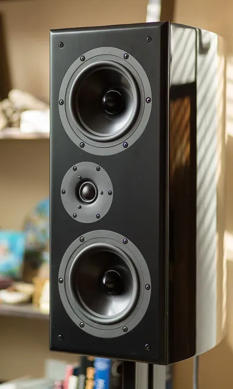

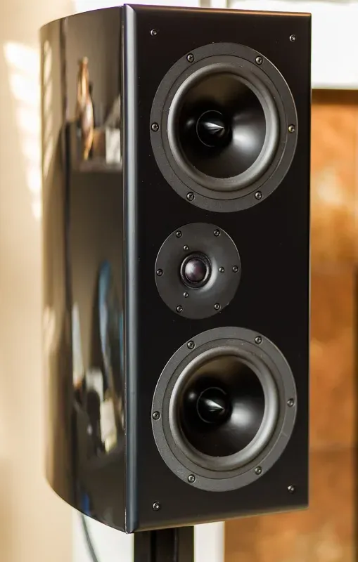

    A few quick snaps of the new Nat P's. Hope to get some measurements soon.

      Nice! That's what we're looking for. Now I have a target cabinet pic to show my GF, too! These will be for "monitor" speakers in the music room, formerly known as the living room. Just moved most of my guitars into there this weekend....

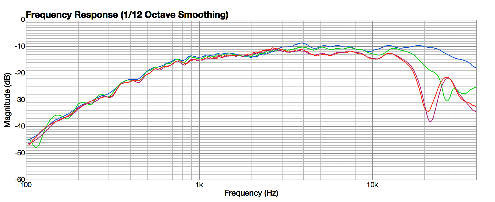

        I had a chance to measure a few things, and to compare the output response of these new Nat P speakers with my current Modula MT ones.
        The measurements below were made at 1m from each speaker. Seems like there's a bit of a bump in the Nat P's around 1.2kHz. Interesting how one of the SS tweeters is a bit hotter than the other on the very top end. The rising top end overall could be the mic response (ECM8000). The speakers were measured in exactly the same position within the room.
        Red & Blue lines are the right and left Nat P
        Green line is a Modula MT

            • 16205
            Click image for larger version  Name:	test_zps944a5878.webp Views:	0 Size:	9.6 KB ID:	943610
            This bears some investigation on my part- but heading out to work at the moment.
              • 16205
              BTW, how were the speakers setup, what was the measuring distance, and were those 6620's you used? And which gen of RS180-8?
                Thanks guys... like I don't have enough to spend on...now I have to look at my cabinets and RS180s sitting there and now I want to start moving on those again. UGH! ha ha.

                  Speakers were on stands, about 18" from a back wall, and no walls within 15 feet to either side. The microphone to speaker distance was 1 meter.
                  I used the ScanSpeak Revelator model D2904/7100-03
                  The RS180's are the new generation, purchased within the last 2 months.
                  Hope this helps

                          I'll re-measure at several rear wall distances. When we speak of rear wall distance, do we measuring from the front baffle or back of speaker box?
                          May also try different measurement gates to remove as much room interference as I can.

                              Either one, as long as it's specified.
                              For development measurements, I usually use 40-50 msec, and have the cabinets 4-6 feet out in to the room, and use a Half Hamming window, which tapers off the sensitivity to the longer reflections. In determining room placement and final setup, I go out to ~150 msec.

                                    Those look great.
                                      +2 - Definitely very sexy speakers in the Piano Black.

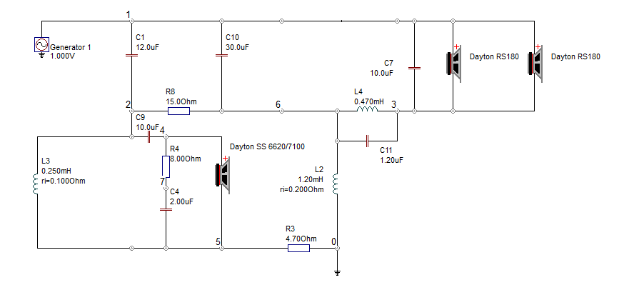

                                          OK, thanks for that lower cost tweeter option too! One last question, although it might be easy to work out, I can't divine where the tweeter L-pad is for sure, it is R4? I'm guessing it might go back to something like 6 ohms to accommodate the lower sensitivity of the 6600? (trying not to look too stupid!)
                                          There's no such thing as a dumb question, and in this case, consider that several people "complemented" me at the first release of this design by saying it "hurt their brain to try to figure out how this worked". In fact, many folks were still using LspCAD 5 or other simulators that couldn't handle this kind of series network.
                                          In this network, R3 is the series element, and R4+C4 act as both an impedance zobel and the shunt side of the network. To adjust sensitivity, best to start with R3; the various tweeters used in this system have a pretty flat impedance curve, so there's not much interaction with response with changing the source resistance over the expected range (~3 Ohms up to 6 Ohms).

                                                  Wooow - that's impressive!

                                                    Yeah if those pictures don't inspire speaker lust I don't know what would. :-)

                                                                      I've said it before and I'll say it again, those are the sexiest damn stand mounts I've ever laid eyes on, and I simply must have some. Eventually.

                                                                                    Errands completed this morning. That means I picked up from storage the ScanSpeak 7100-02's, the TL N26, the RS210H, a 4 ohm RS225, and some precut MDF at Home Depot for making test baffles. Time to make some holes and some measurements!
                                                                                    The 9900 are on order, as well as some more 1 cu ft MTM cabs, and I have test baffles and RS180's to test with the original NatP configuration, too.
                                                                                    So, the intent is to check out how the 7100-02 works as an upgrade for the existing design and whether any tweaks are desirable, as well as develop the version with the Esoteric 5.5" woofers in the 1 cu ft MTM cabinet (this version models very flat in the low end, the same way the RS180's do better in the larger enclosures recommended for those with the DIY chops to move beyond a pre-built cabinet. You know who you are... :W
                                                                                      Four ScanSpeak Revelator D2904/7100-03's ordered (two for me & two for Dan PewterTA who is building the same "Duded Up" NatP version in the curved PE cabinets).
                                                                                      I should be dropping these my 65 liter cabinets some time next week.
                                                                                        • 16205
                                                                                        I should have the network stuff simulated for them by sometime next week! (if we're lucky- there's a bunch of stuff scheduled already for the week- might be the weekend, realistically...
                                                                                        Note that these guys are about 4 dB more efficient that the original drivers- see the CatZ measurements if you haven't already. Measured on a NatalieP size and width baffle.

                                                                                          And accordingly I've started following prices on the D3004 - 6600 again, assuming again that it's primarily an efficiency difference and nothing insurmountable in the frequency domain. Woot!
                                                                                            .....Note that these guys are about 4 dB more efficient that the original drivers- see the CatZ measurements if you haven't already...
                                                                                            Duly noted.:T
                                                                                            I plan on having a few different values of resisters on hand for R3 to do some voicing utilizing Dan's 'Golden Ears'.
                                                                                            Eventually, the xo's will be re-built with the Jantzen Z caps the Mundorf M-Resist Supreme components once your sims are completed.
                                                                                            I am going to have to cut an access panel in the rear baffles of my 65 litre towers, however, in order to access my xo boards.:M
