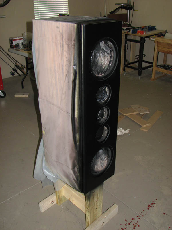

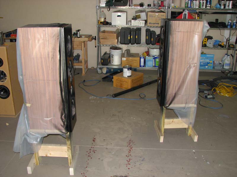

    So I am back at it. The temps in the garage have risen into the 100's during the day so I have a much harder time getting myself out there. On the up side it will help the paint dry quicker! Got the baffles painted black.

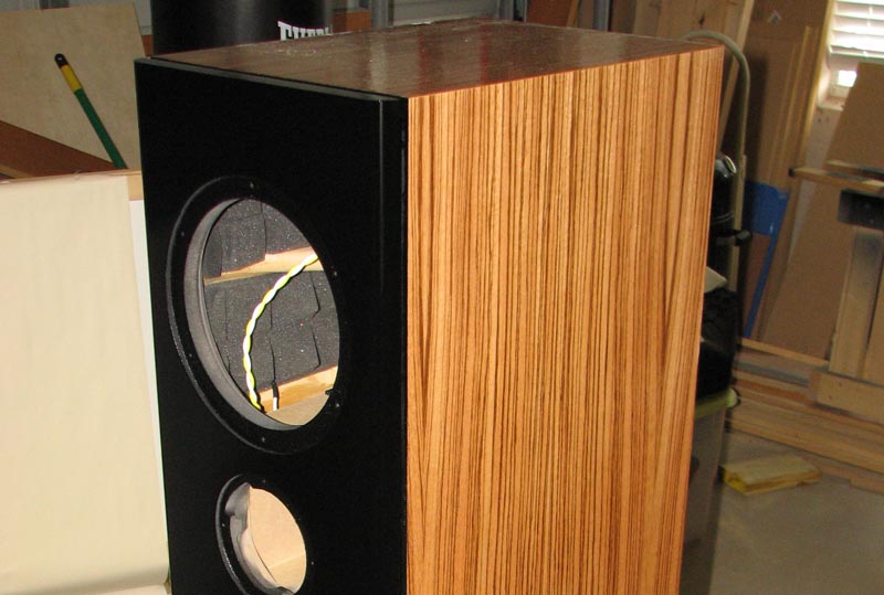

    Now I will be putting 3 coats of clear lacquer on the entire cabinet each day for a while. I will be lightly block sanding every other day or so. I needed stands that would allow me to comfortably reach all sides and the top so I made a couple out of some scrap.

      Some pics with the masking removed. Ready for today's coats of clear.
      Last edited by theSven; 13 August 2023, 15:07 Sunday. Reason: Update image location
      • BeerParty
        • 475
        #93
        <snip>
        Click image for larger version  Name:	aStatements_20110613_0114.jpg Views:	1407 Size:	82.8 KB ID:	856090
        Why did you remove the plastic from the speaker holes? It wasn't just so you could take a good picture, was it?
        My Statement Monitors Build
        My AviaTrix Build
        • BigJim_inFLA
          • 203
          #94
          Don't need it there anymore. I'm not set up to spray here so I will be brushing the clear lacquer on. I will probably end up installing the drivers so I can listen to them after I have the clear coating done, but before it cures fully for the polishing to begin.

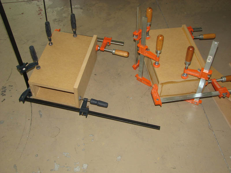

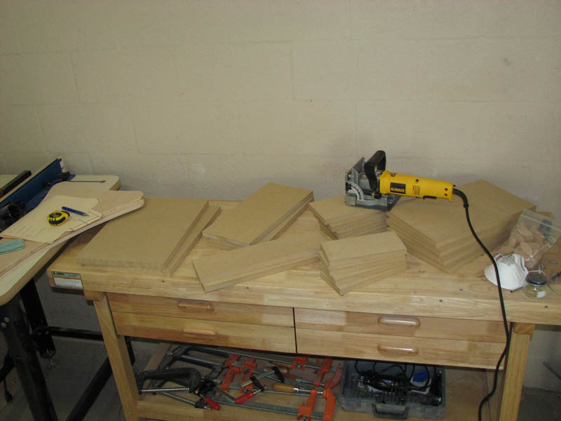

          • BigJim_inFLA
            • 203

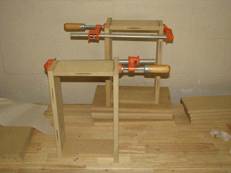

            #95

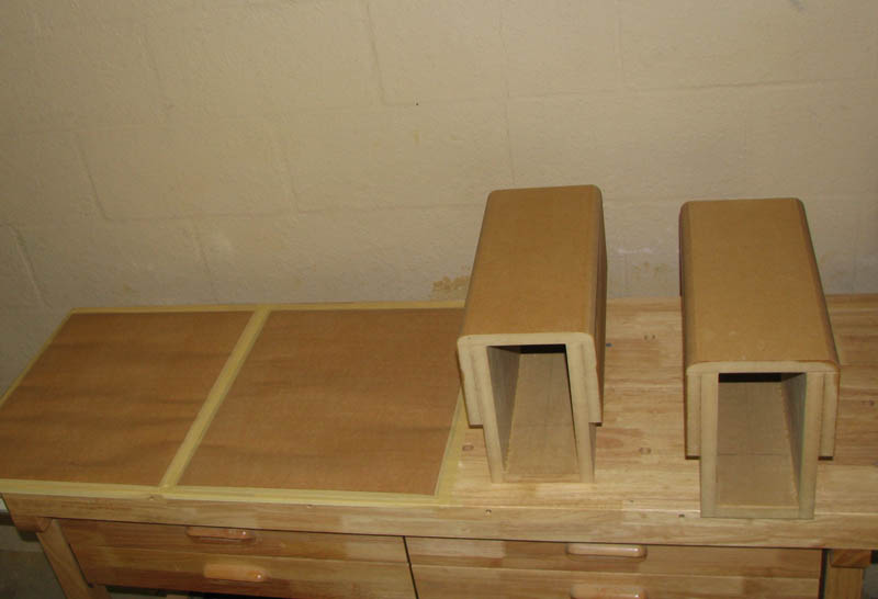

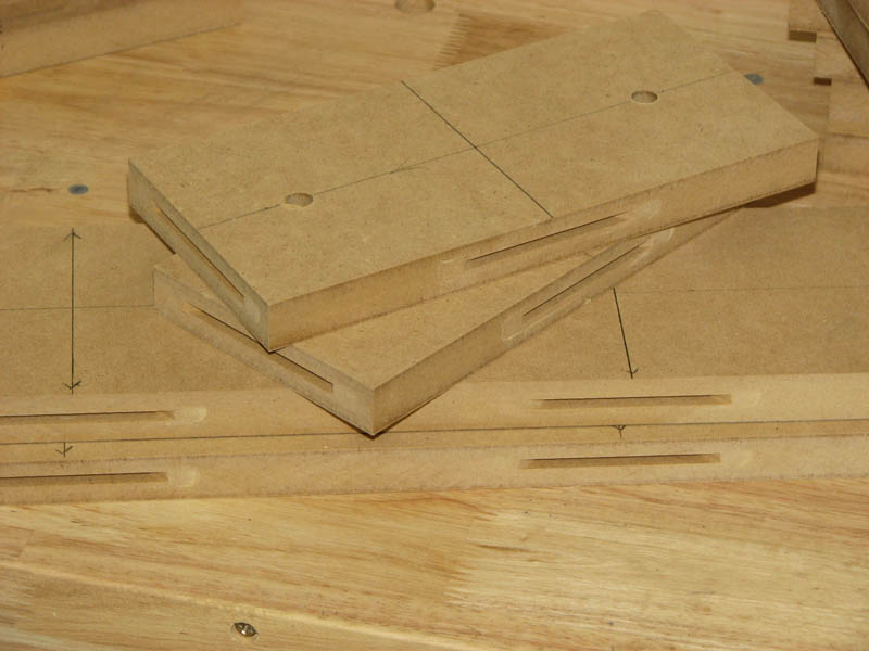

            Taking a break from painting to build up the stands. All the pieces cut and ready to assemble.
            Slots cut for the biscuits I will be using.

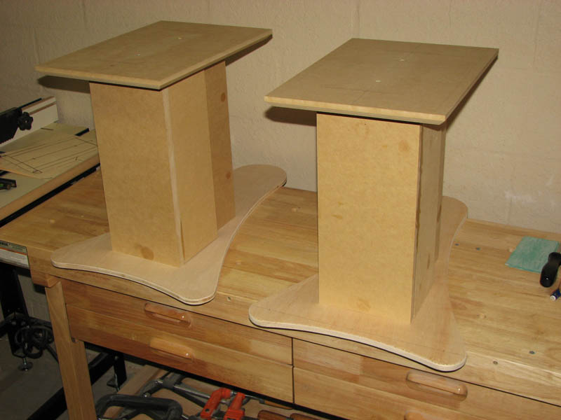

            1st step of assembly.
            Column is almost complete.
            Last edited by theSven; 13 August 2023, 15:09 Sunday. Reason: Update image location

              As far as I can go today. The base will have 1" of granite on top of it, under the column, and adjustable spikes at each corner. Top and base will be black, the column will be veneered with left over zebrawood.

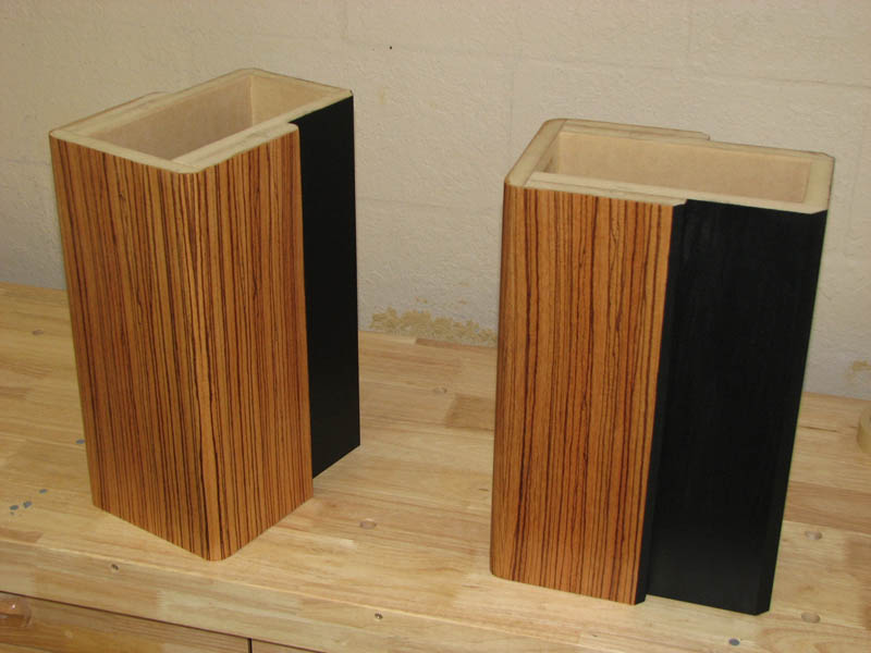

                          #102

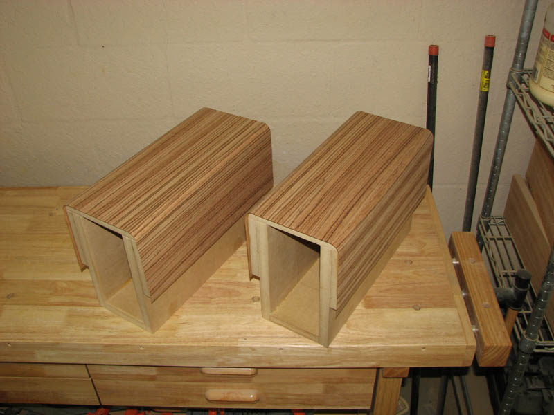

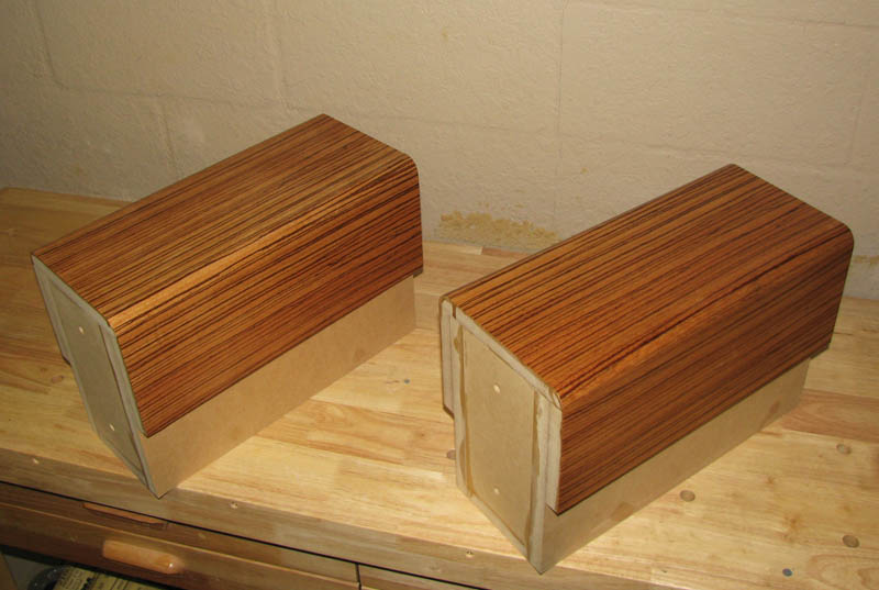

                          Hello again, back from vacation and ready to get a little bit of work done to these. Still painting and sanding the clear lacquer. I did talk to some granite shops about the bases for my stands and have gotten some crazy prices. Higher than I thought, and very different from shop to shop. Still waiting to hear back from some, but I may have to go a different direction if I don't get some more reasonable estimates.
                          Today's latest is more work on the stands. Here I am coating the column and veneer with glue.
                          And here are the columns after ironing on the veneer.
                          Last edited by theSven; 13 August 2023, 15:10 Sunday. Reason: Update image location
                          • BigJim_inFLA
                            • 203
                            #103
                            Done for today. Veneer is trimmed, sanded, and shellac applied.

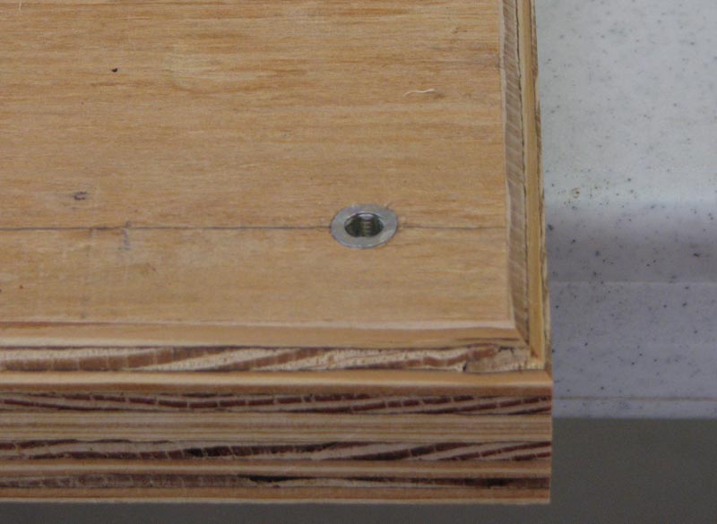

                                #105

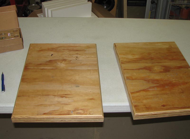

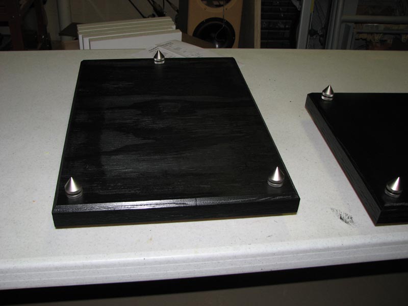

                                So it has been a while. I have learned a few things. Evidently it is really expensive to cut and polish granite on an arc. The curved triangular bases would have cost me almost 10 times as much as simple rectangles. I decided, after visiting many local granite shops, to redesign using rectangular bases. They will be ready for pickup on Monday. Today I cut the plywood bases that will be under the granite. These will provide support and give me a place to mount the spikes. These will be about 3/8" smaller than the granite on each side.
                                Here are the bases, cut from doubled up 3/4" plywood, and finished the edge with a bevel.

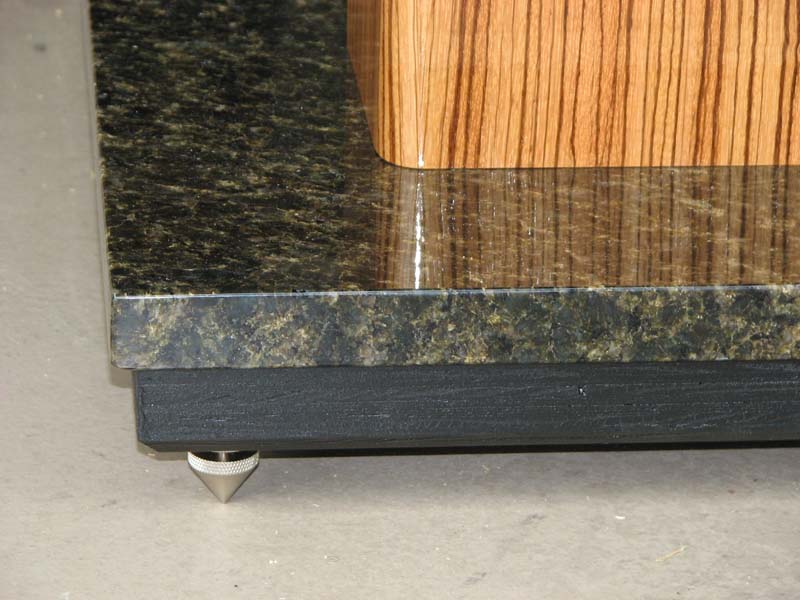

                                I installed screw in threads for the spikes
                                Here they are painted black with the spikes installed.

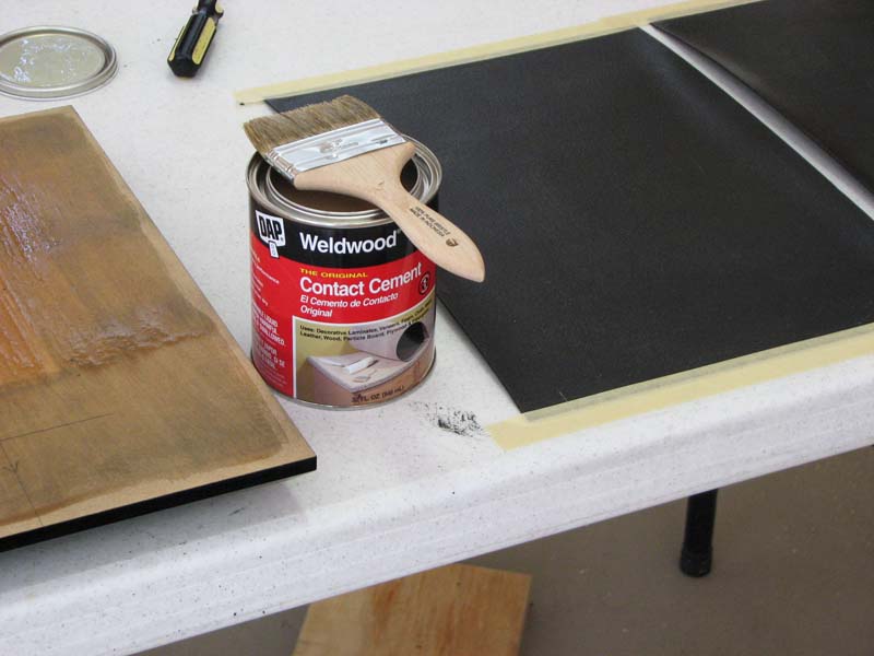

                                • BigJim_inFLA
                                  • 203
                                  #106

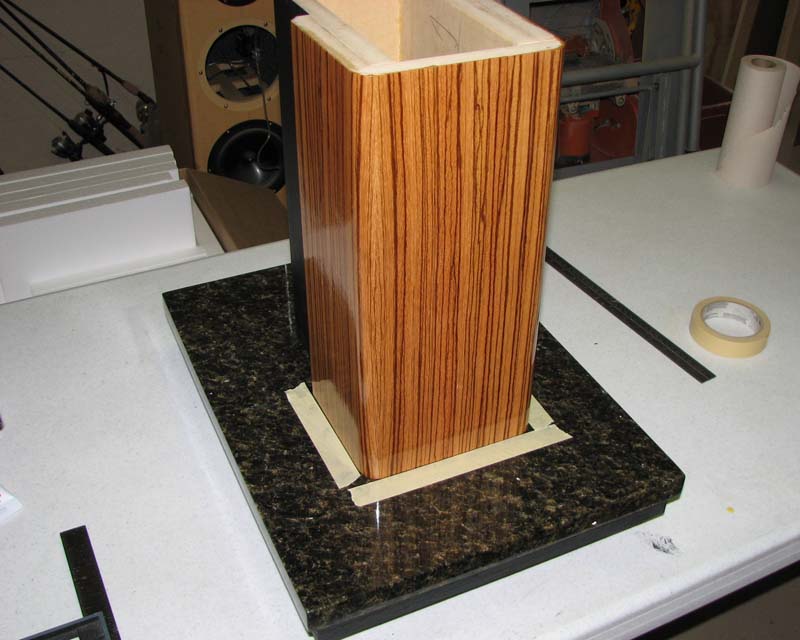

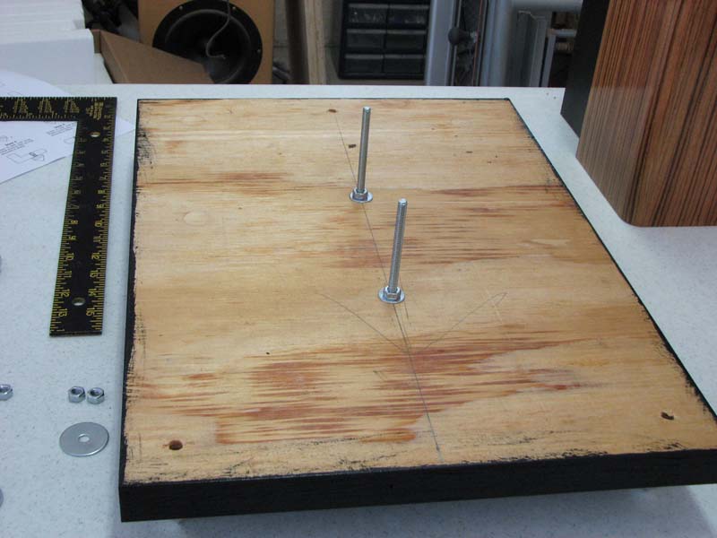

                                  Some more progress on stands...

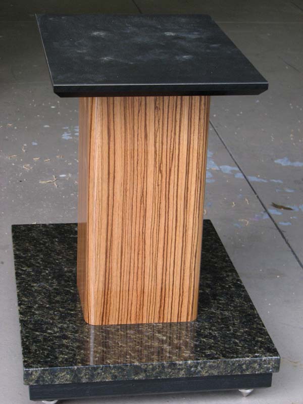

                                  4 1/2 inch carriage bolts through the wood bases will hold everything together.
                                  Contact cement will hold a layer of non skid shelf liner on top of the stands.

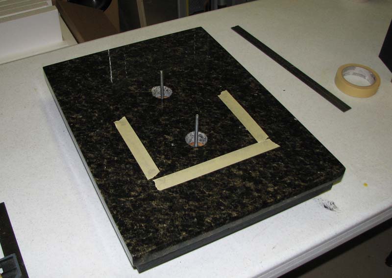

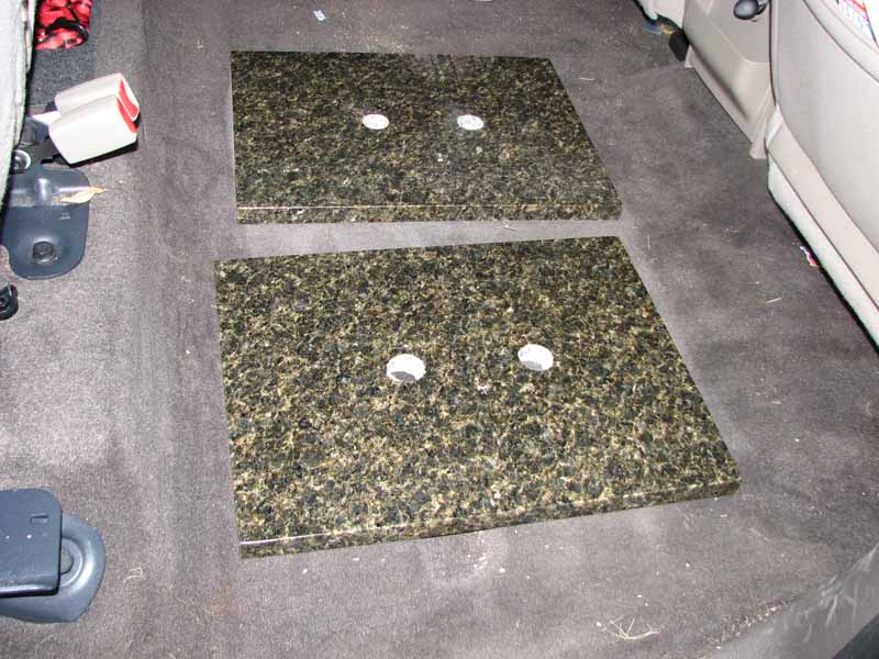

                                  Home from the granite shop!!

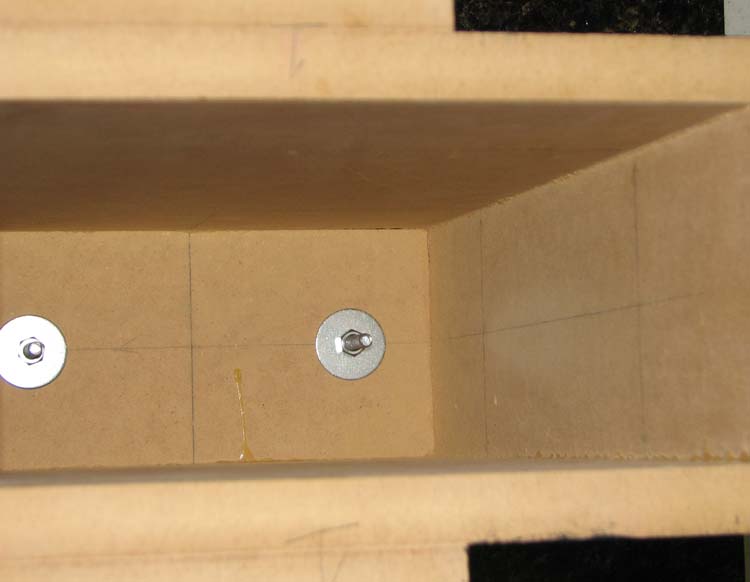

                                  Layer of construction adhesive will keep everything nice and vibration free. The large holes allow a little movement during placement. I test fit the column on the base and mark with tape before adding adhesive to the top of the granite as well.

                                  • BigJim_inFLA
                                    • 203
                                    #107
                                    The column fitted onto the bolts.
                                    Held together with nuts and fender washers.

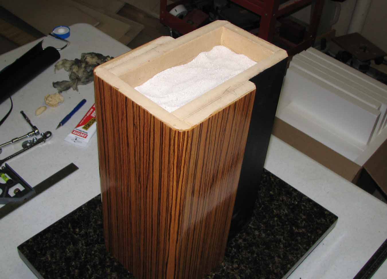

                                    And if the granite wasn't heavy enough, lets fill the empty column with sand to add some weight and density. These will make a very stable base for the Statements.
                                    Last edited by theSven; 13 August 2023, 15:12 Sunday. Reason: Update image location

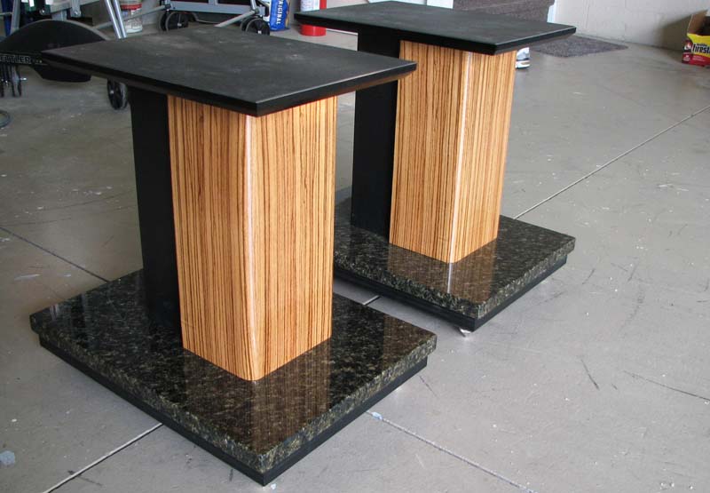

                                      The tops are then glued and screwed onto the column and we are done!
                                      Now with its twin.

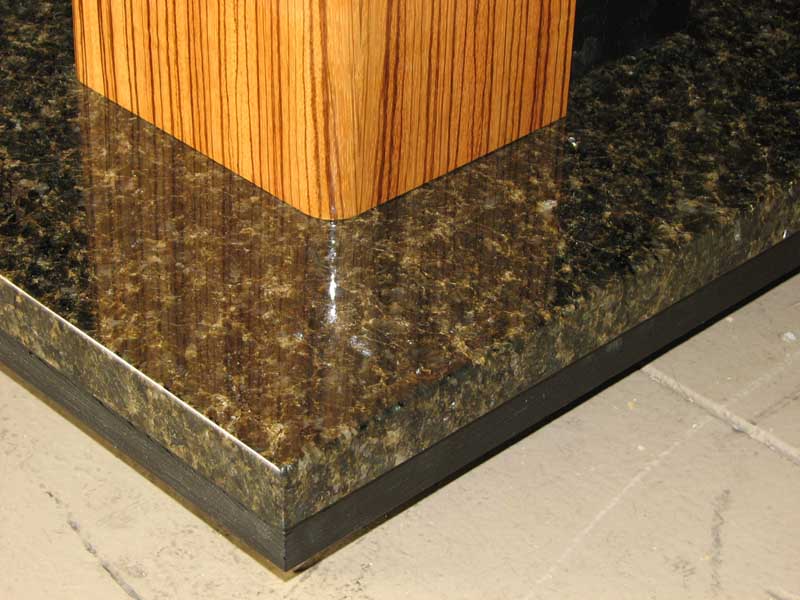

                                      And some close ups.

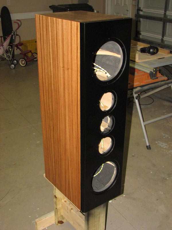

                                        #109
                                        I just had to get a look. Still working on the messed up baffles, but they are gonna look nice...

                                                  #114

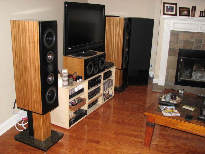

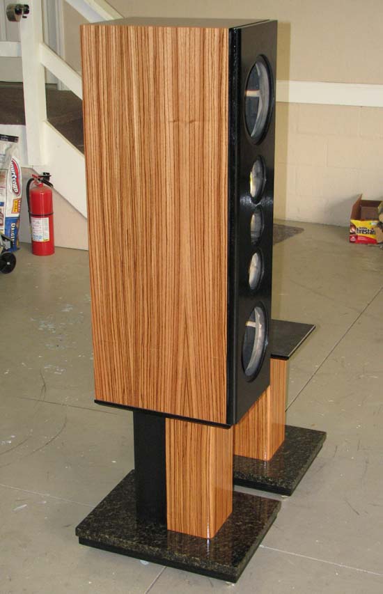

                                                  Not quite finished, but this is how they will be for the next few months. Final polish will wait for the lacquer to fully cure.
                                                  I have to say thanks to Jim and Curt, these sound amazing! Playing music without the subs I was surprised by the amount of bass. Full and deep, yet very tight. Even sealed you almost don't need the subs, almost.
                                                  The mids and highs are very revealing, I find myself listening to favorite pieces over and over hearing things I've not noticed before. I've never used ribbon tweeters before, but I like these quite a bit. Overall I am very happy with these!

                                                                      Zebrawood Veneer
                                                                      Hi Jim. Great job on the speakers. Could I please ask you where you purchased the zebrawood veneer? I am looking for exactly the same veneer and love the way it came out on your speakers.
                                                                      I also sent you a PM with my contact info.
                                                                      • BigJim_inFLA
                                                                        • 203
                                                                        #125
                                                                        VeneerSupplies.com
                                                                        PM sent.

                                                                          Now you've had time to run them in, how do they sound? Has to be the most important question!
                                                                          Fish
                                                                          • BigJim_inFLA
                                                                            • 203
                                                                            #127
                                                                            They sound great! So good that I have not finished polishing them yet. I can't bring myself to move them back out to the garage.
