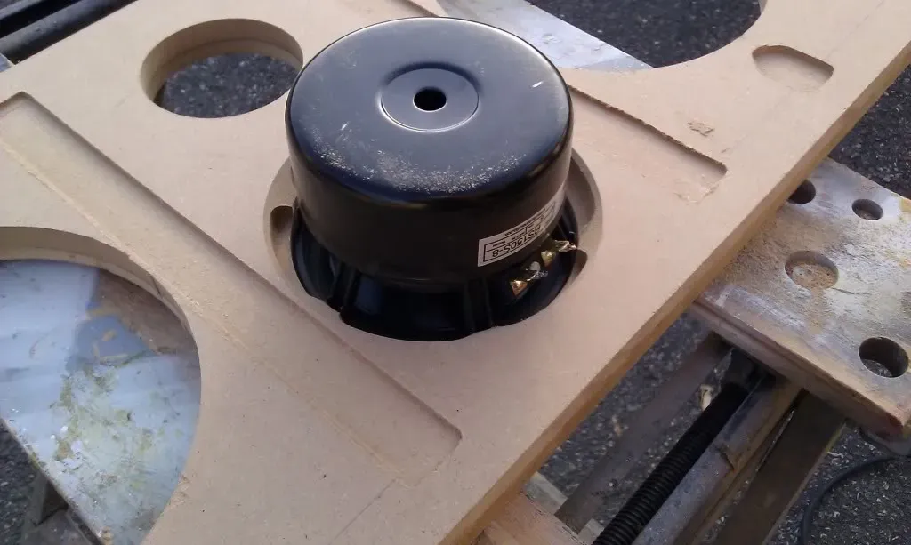

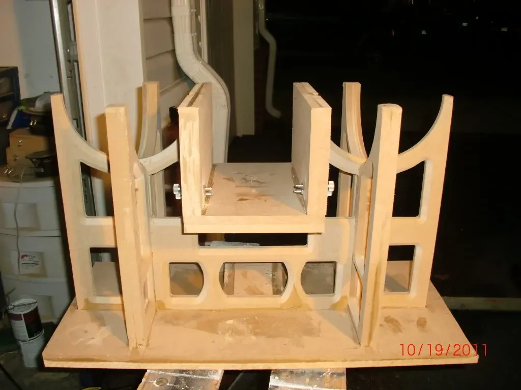

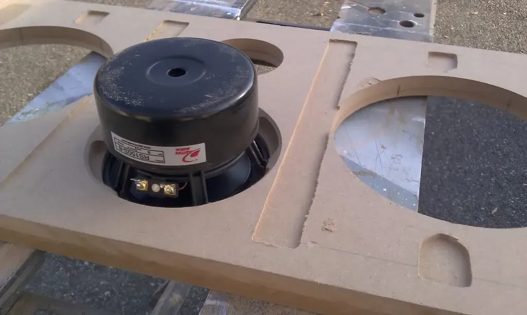

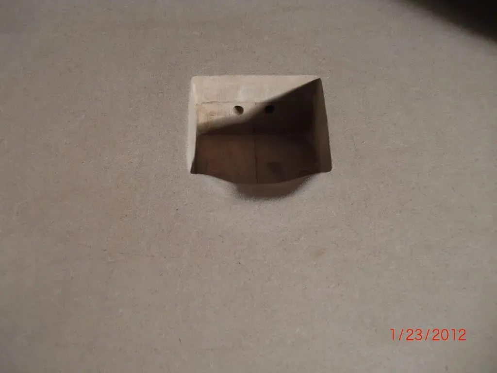

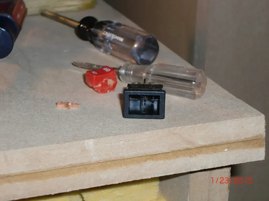

    Got some work in tonight.....Terminal cup is in, binding posts to the mid/tweet are in, and most of the insulation is in.....
    Lots of pics.
    Last edited by theSven; 07 June 2023, 18:01 Wednesday. Reason: Update image location

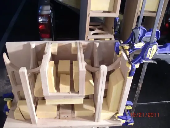

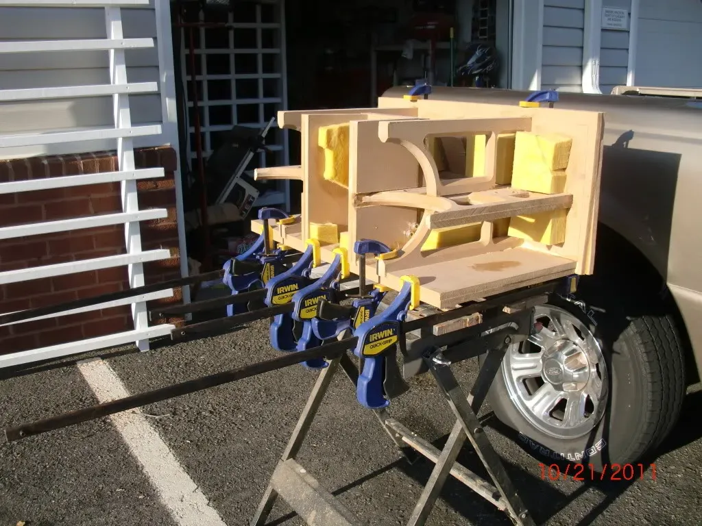

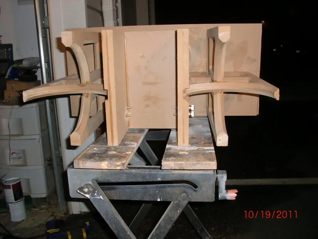

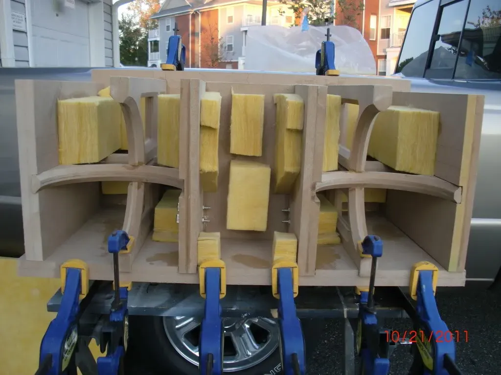

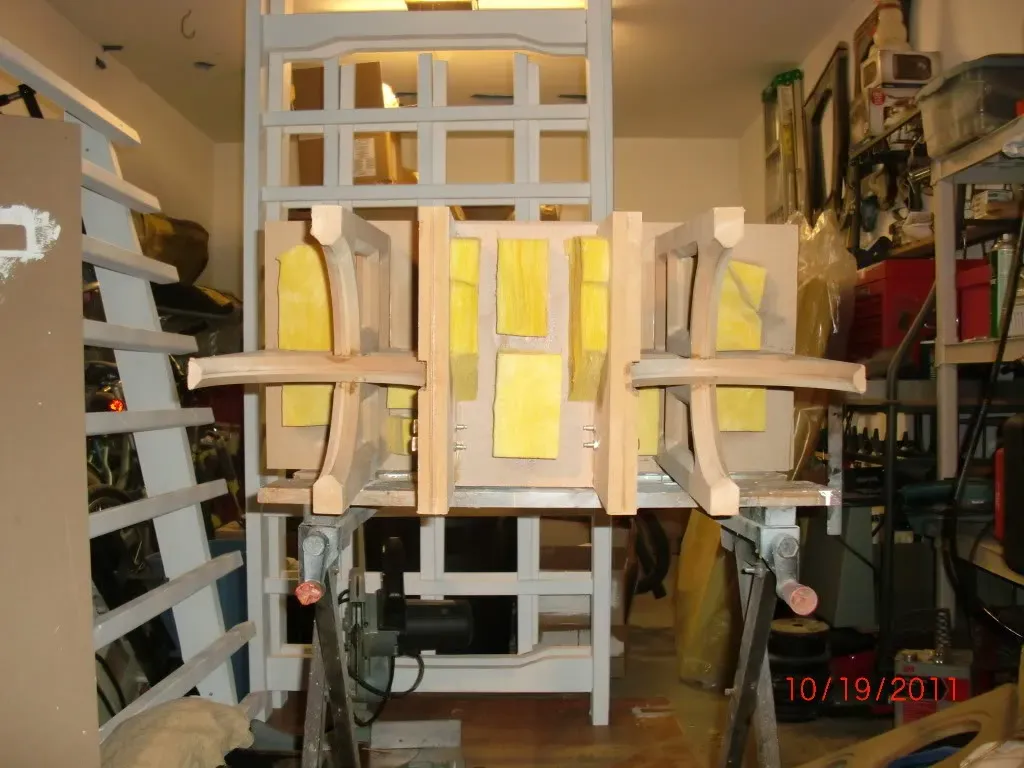

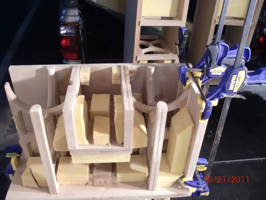

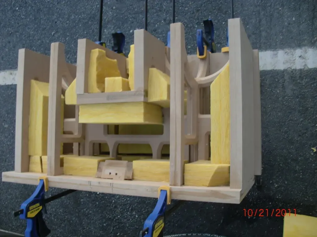

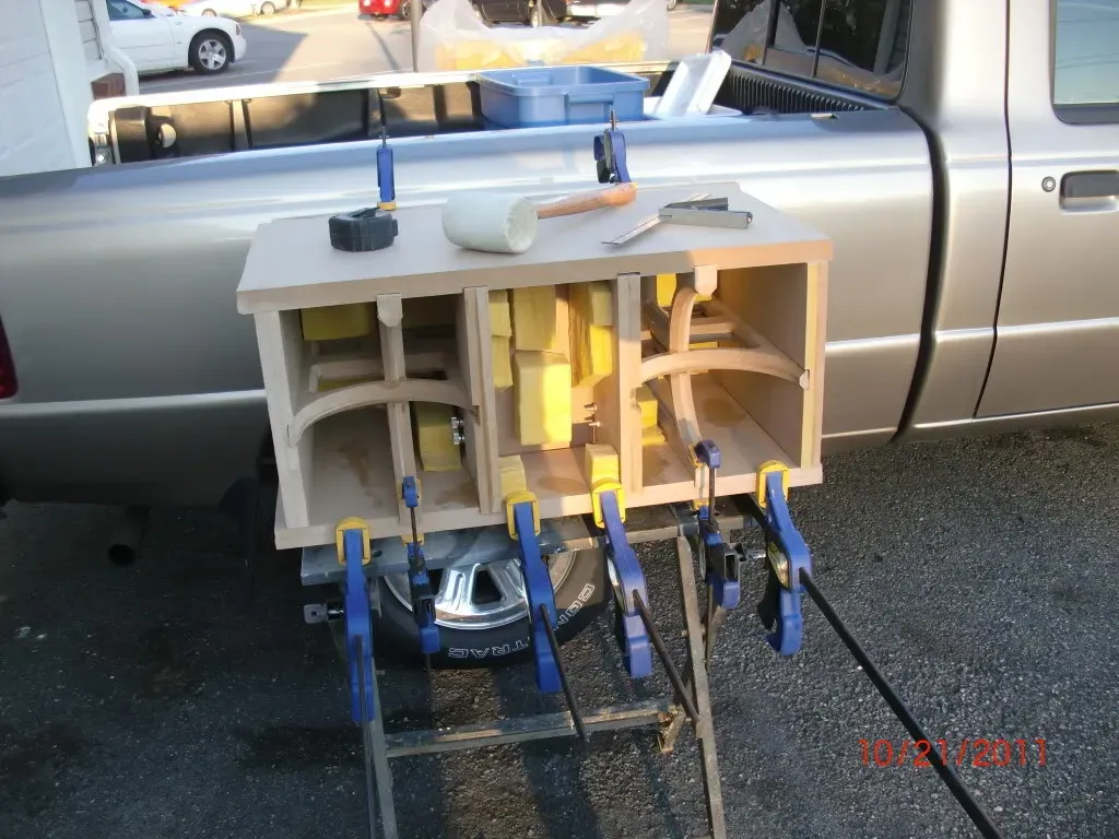

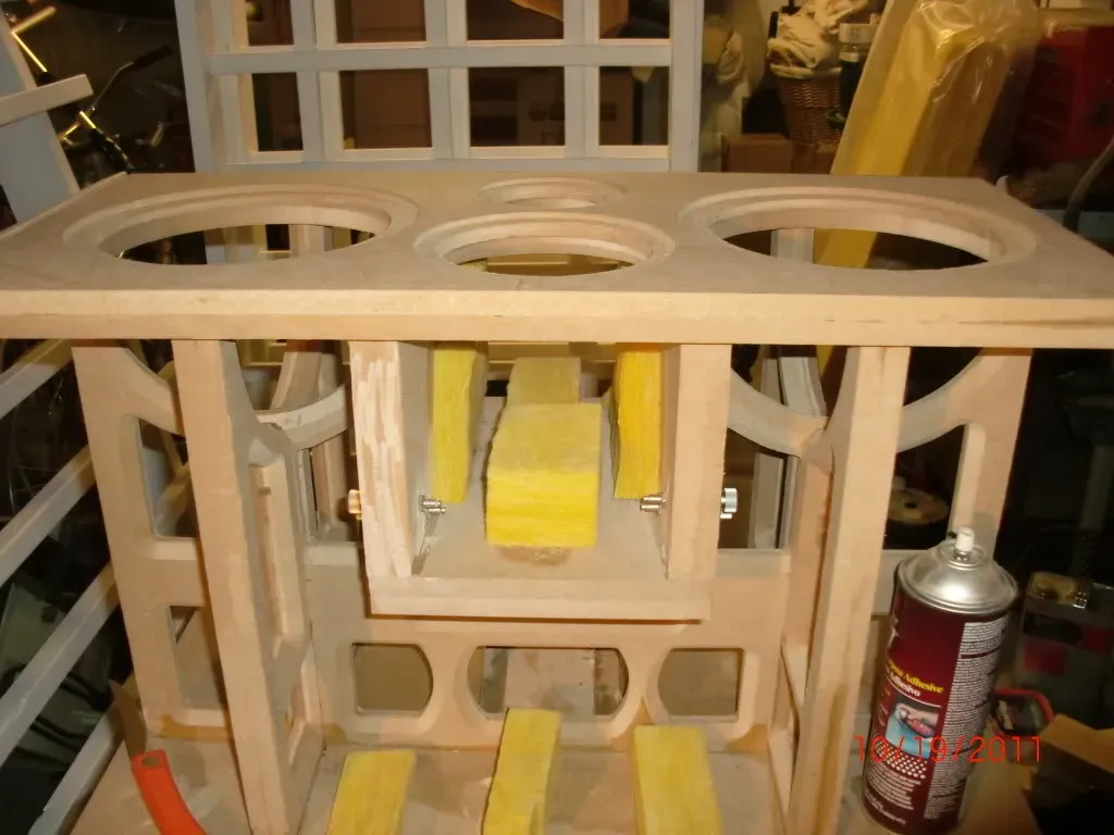

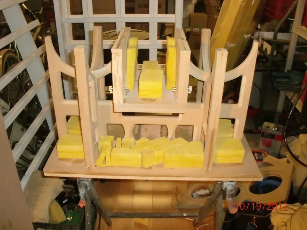

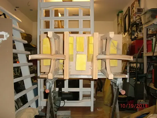

      Bottom glued on.

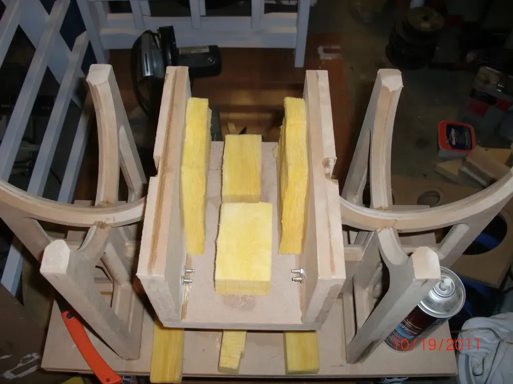

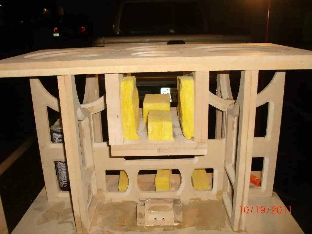

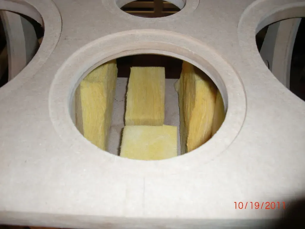

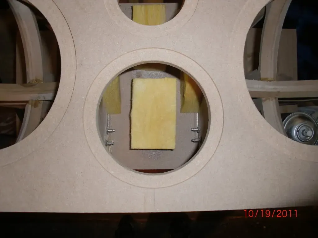

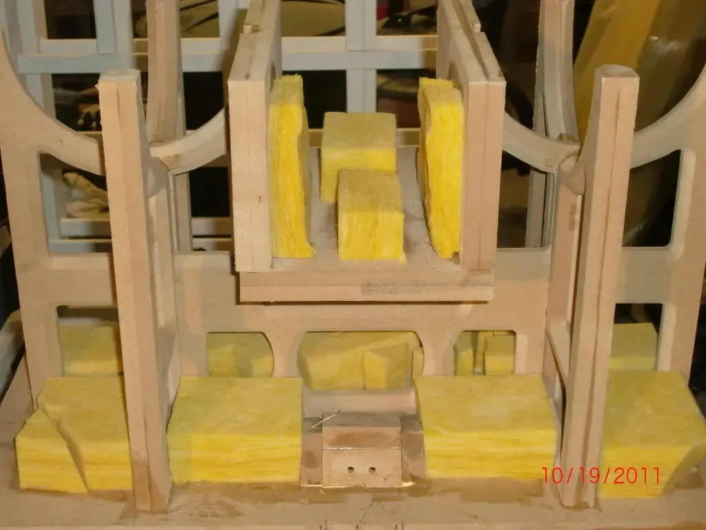

      Just about all 703 is in, and other panels test fit for gluing.

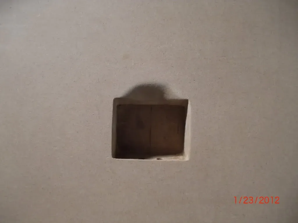

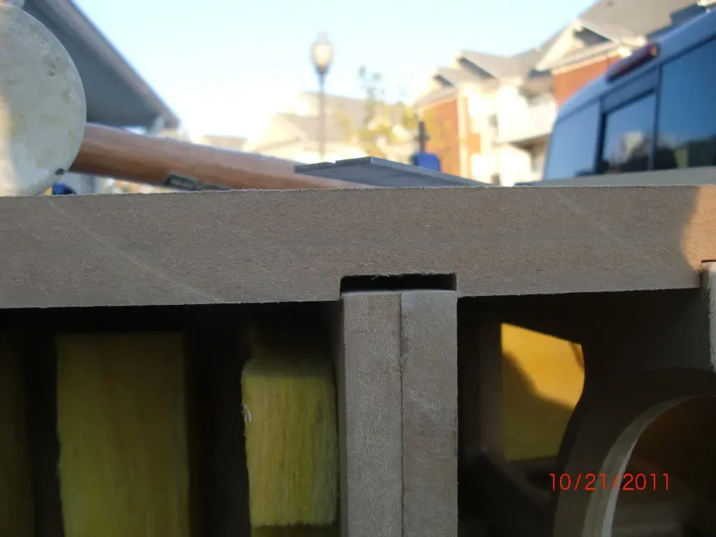

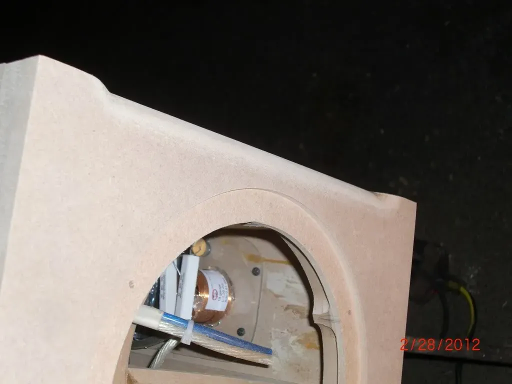

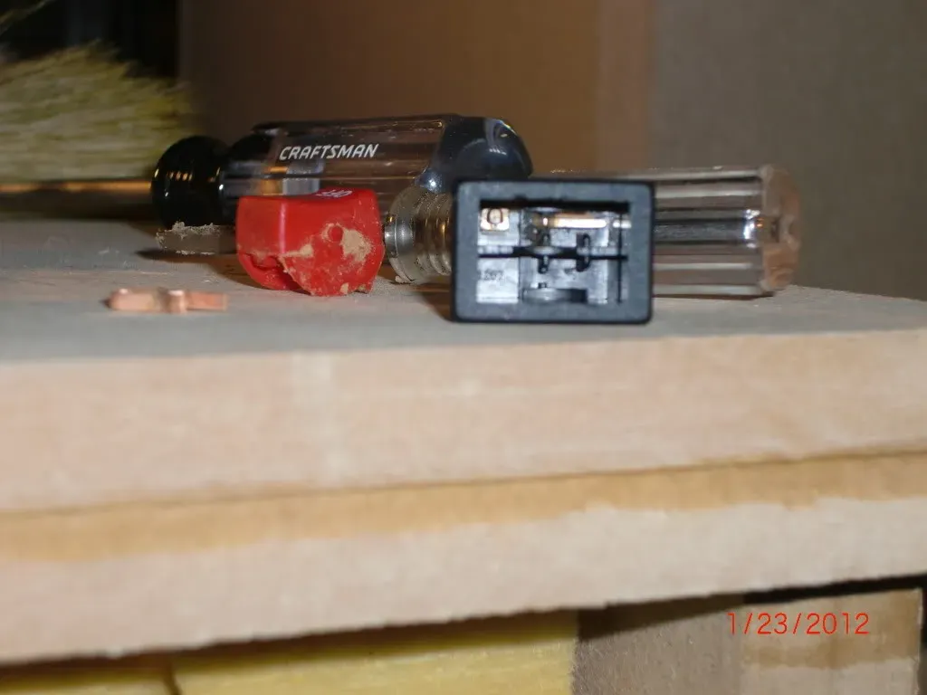

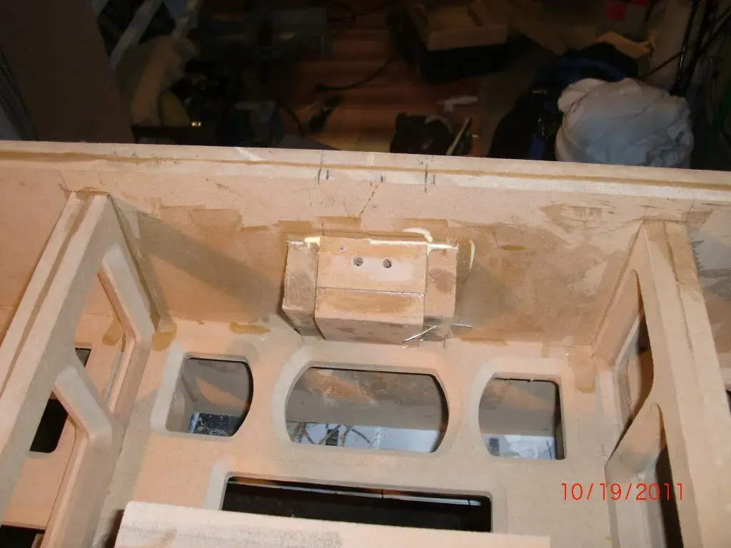

      Have a small issue here. Any ideas on how to fix this? It's less than 1/4"....

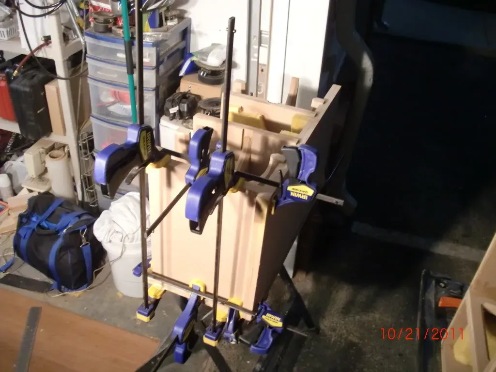

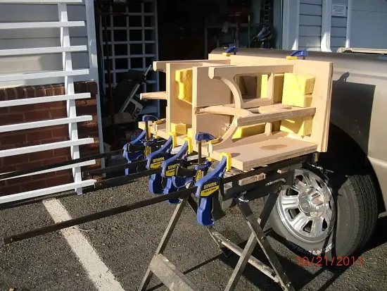

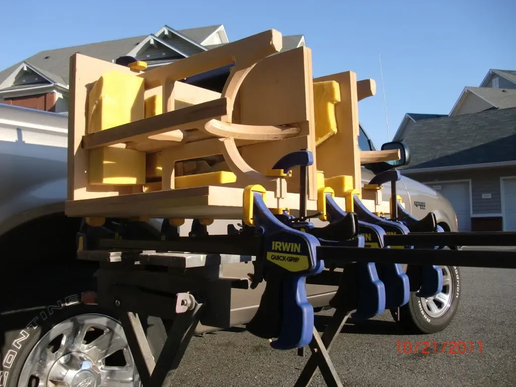

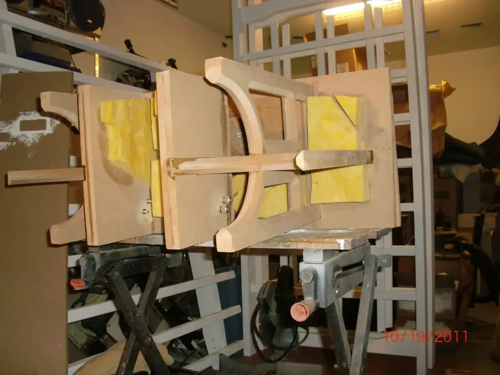

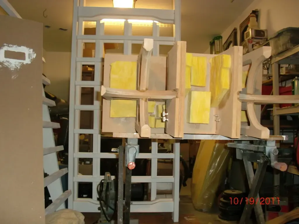

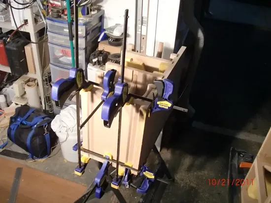

      Side being glued on
      Hoping to have this done by the end of the weekend! Only issues I'm having are that gap and how I am going to bolt up the binding posts after doing the finish. I may have to put the posts in now and work around them when doing the finish.
      Also, if someone can let me know if I have too much/too little 703 that would be awesome. It's 2" 703.
      Last edited by theSven; 08 June 2023, 11:47 Thursday. Reason: Update image location
      • baniels
        • Nov 2006
        • 158
        It wouldn't be any fun if you didn't have things like that gap to solve along the way.
        I'm sure you can find something to shim that gap. Strip of MDF or other wood at the right thickness. Do you have a planer?
        •L&R Build•
        •Sub Build•
          Gaps. How big? Big gaps fill well with PL adhesive. Small gaps, make a putty from wood glue and fine sawdust.
          Binding posts. Well I used the PE aluminum plates.
          • joeybutts
            • 476
            Thanks fellas. No planar, but that PL adhesive technique would be pretty easy.
            hahah. Thanks Ryan. I could switch to those, but I love the recessed look, and too late to switch it up now.....I'll test if I can get the hardware on the binding post with the top and baffle on before I glue them on.
            • Paul W
              • Oct 2004
              • 552
              You could run a temporary seal of tape down either side of the seam and then fill the gap with either epoxy or polyester resin.
              Paul
              • joeybutts
                • 476
                Thanks Paul! I think for this time I am going to do the PL adhesive.

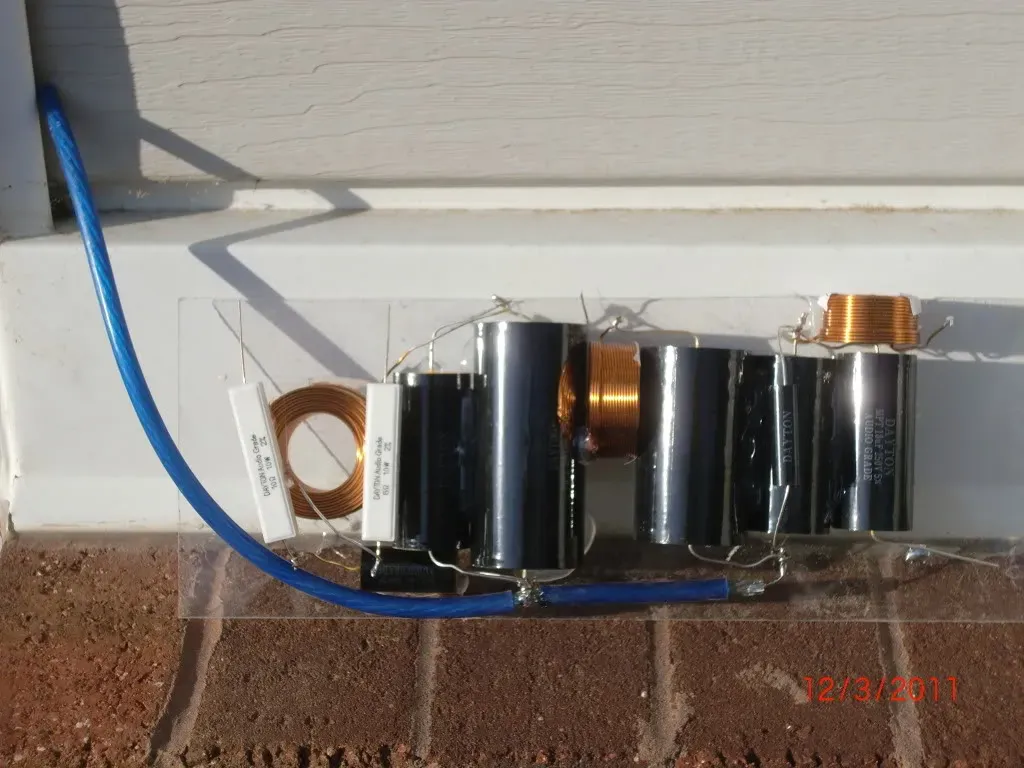

                I just planned out the wiring in this thing. What a snakes nest. I hope I have it right.
                If I am reading this right, the positive from mid network AND the tweeter network are in reverse polarity with the mid and tweeter?
                Also, the woofer's are in series with proper polarity?
                Thanks!!
                  You got to post a picture of the crossover you're using. There were at least 4 different ones. I'm to lazy to dig back through this thread to figure it out.
                  • joeybutts
                    • 476
                    Crap. Totally forgot about that. CJD's x-over.
                    Last edited by theSven; 08 June 2023, 12:14 Thursday. Reason: Update image location
                      Yep. Mid and Tweeter reverse polarity. Woofer positive polarity. This is directly opposite of what the Khans will be. CJD likes to make life difficult.

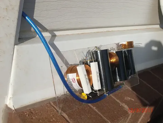

                                    Crossover...

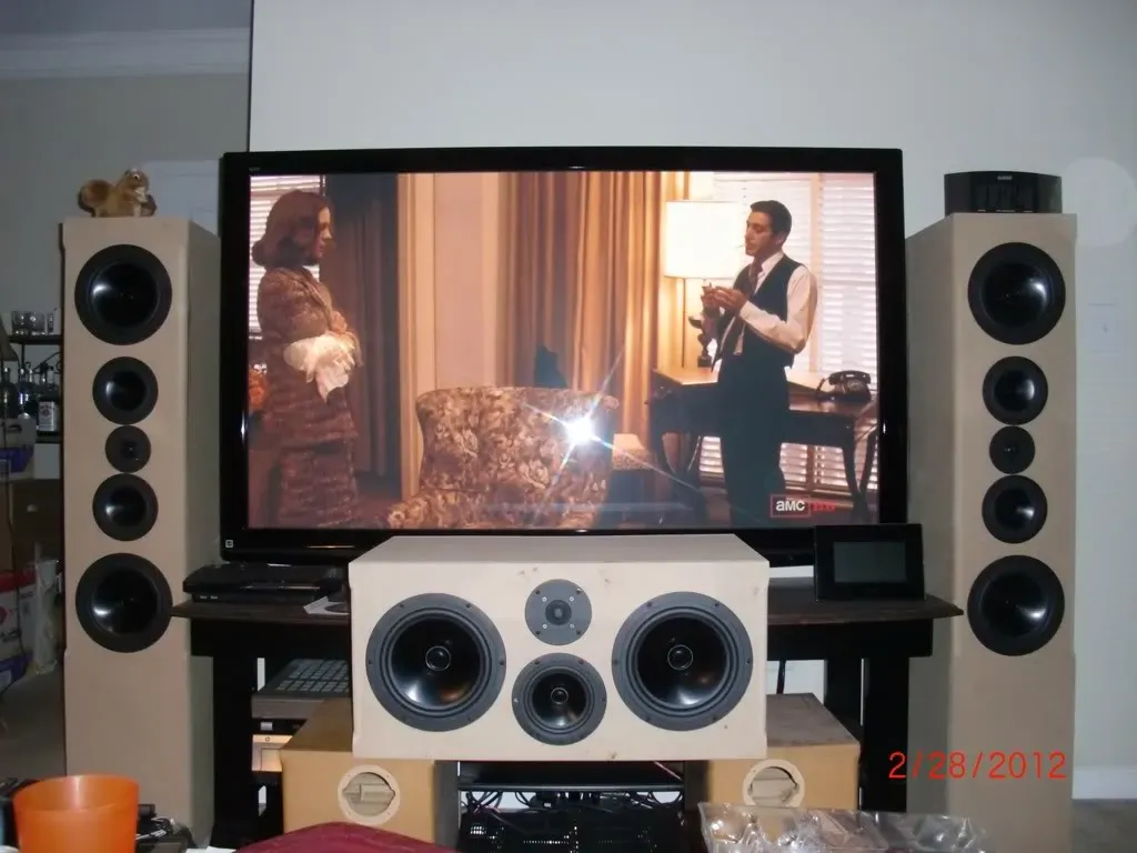

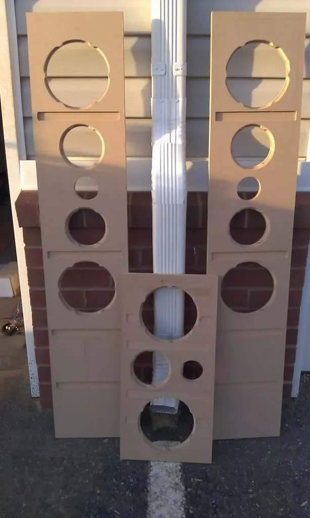

                                        Getting REALLY excited. Khan's cabinets should be all done today. WOOOOT!! :E :E :E

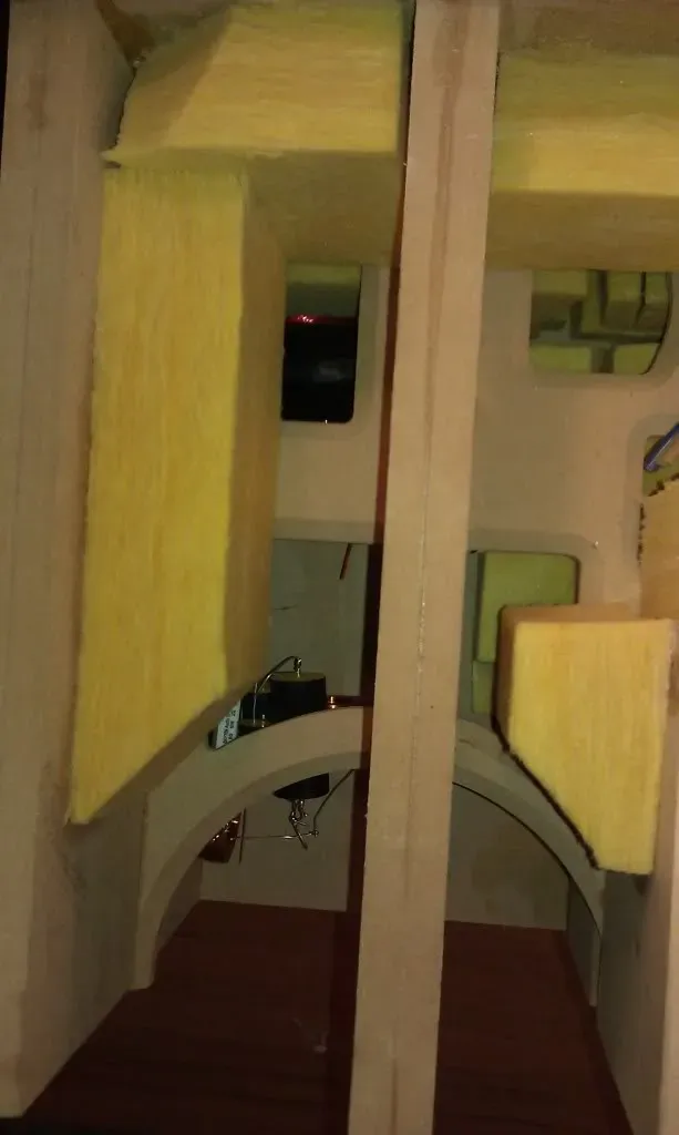

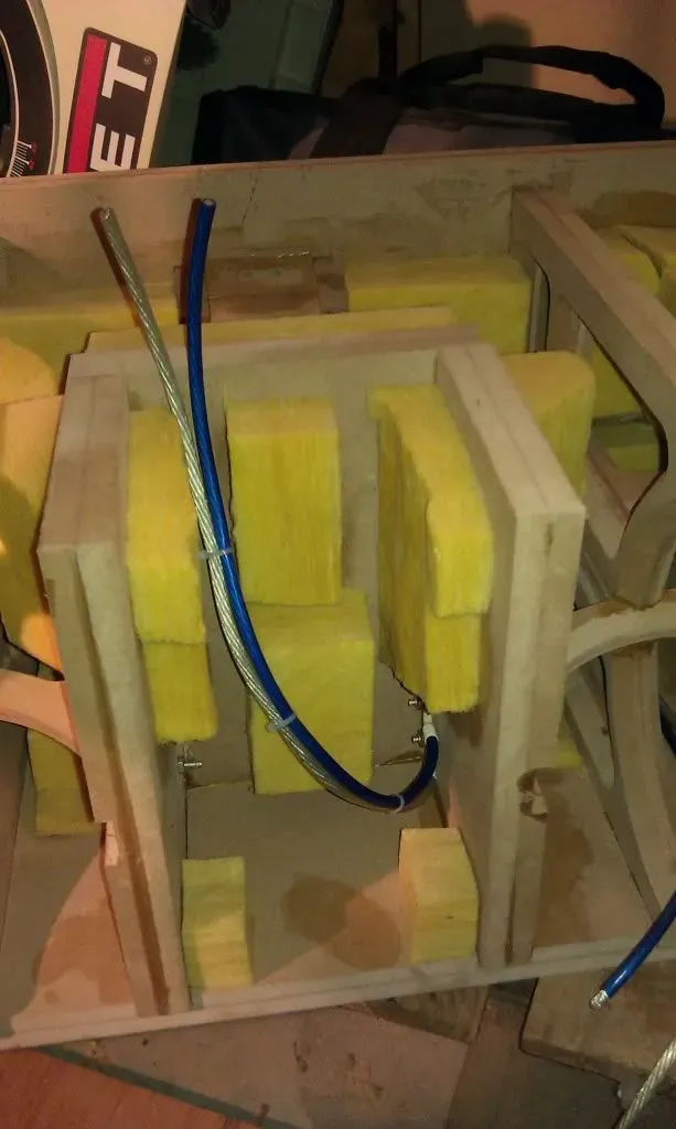

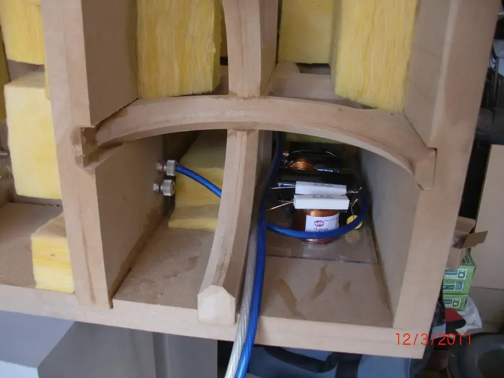

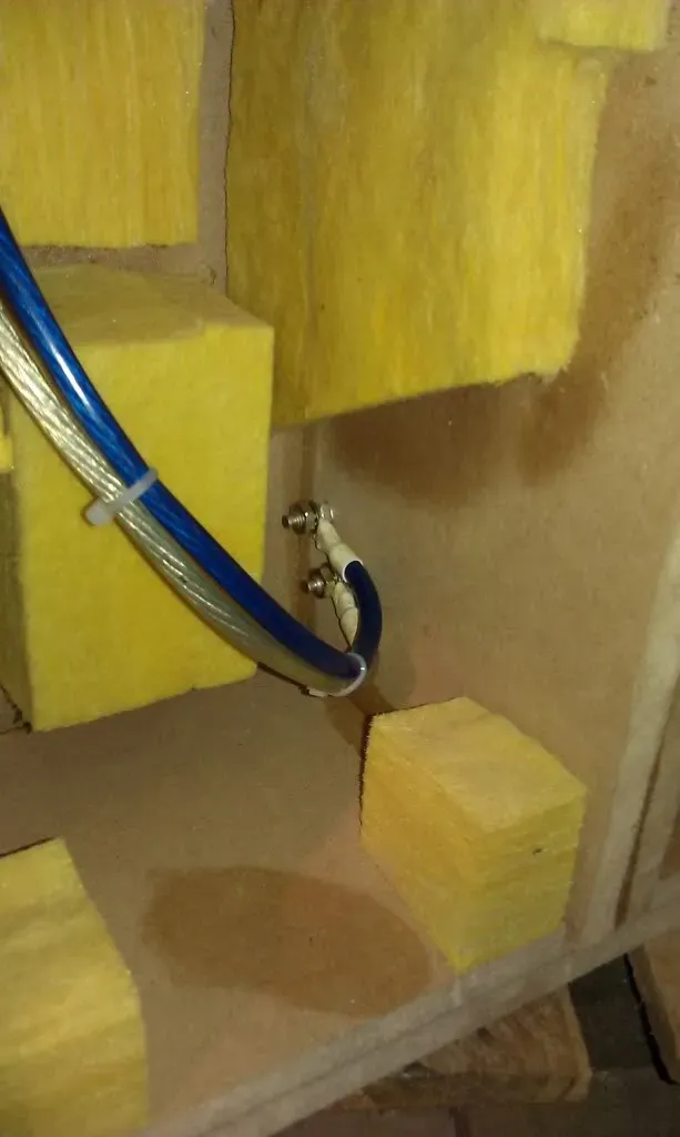

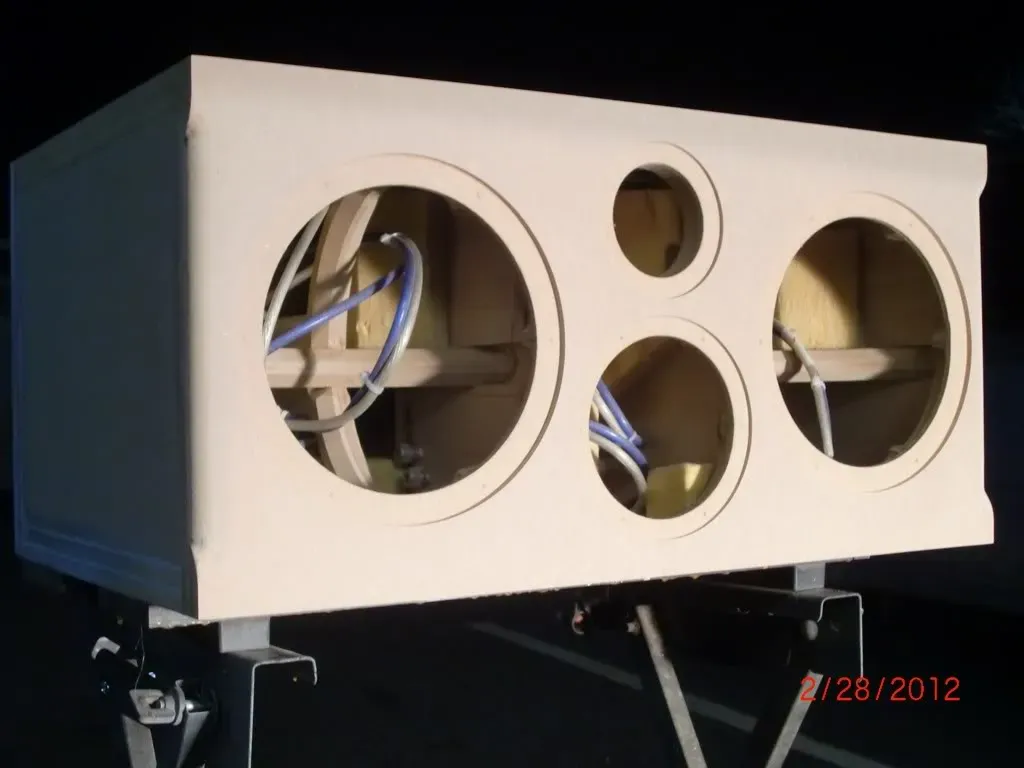

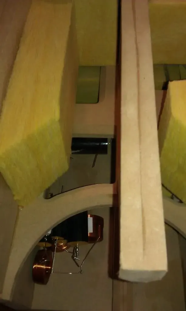

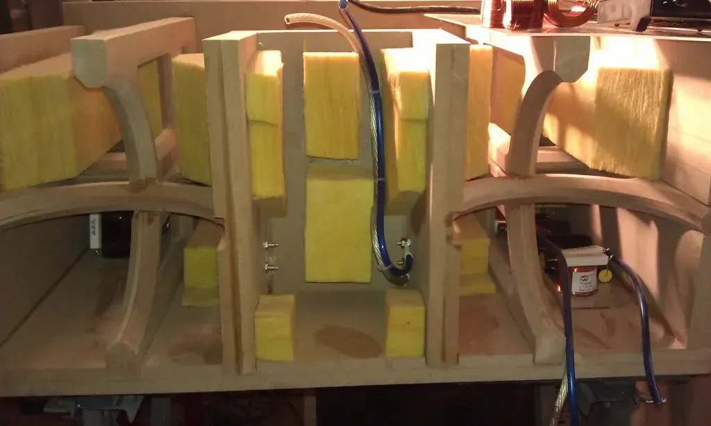

                                            Small update on this, got the wires done for the tweeter in the chamber and opened up the backs for the mid and woofers.

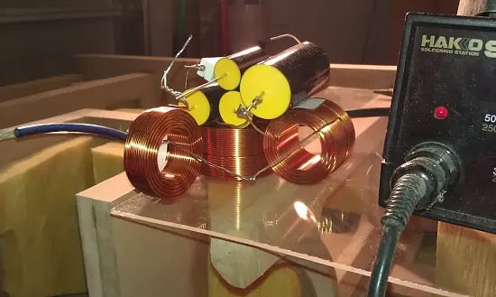

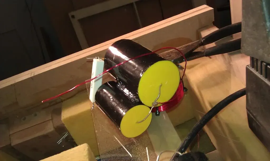

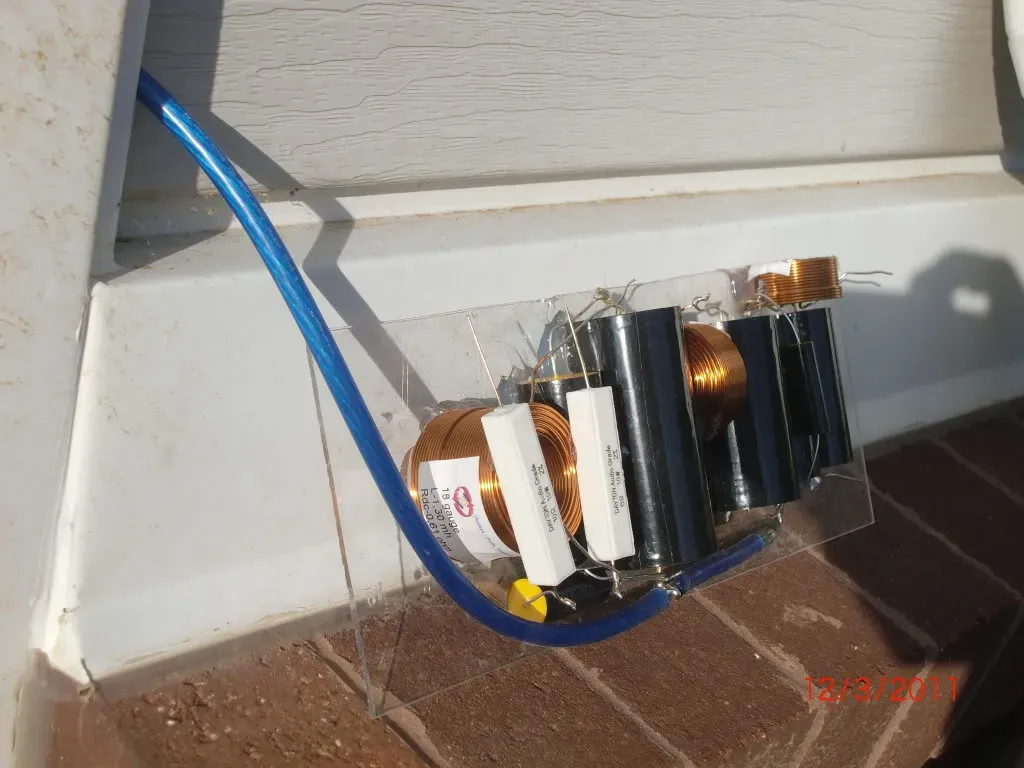

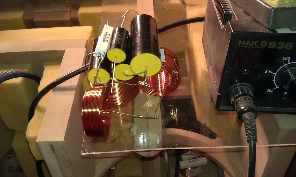

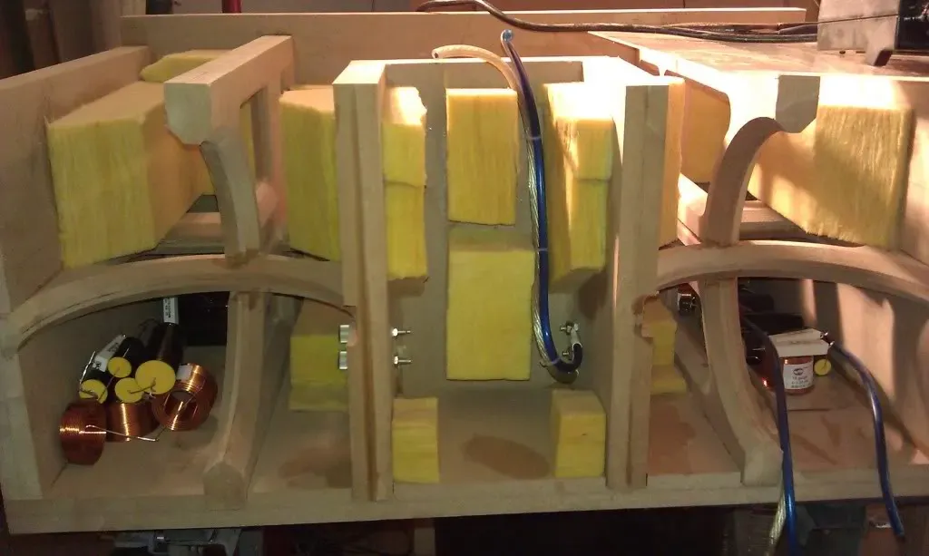

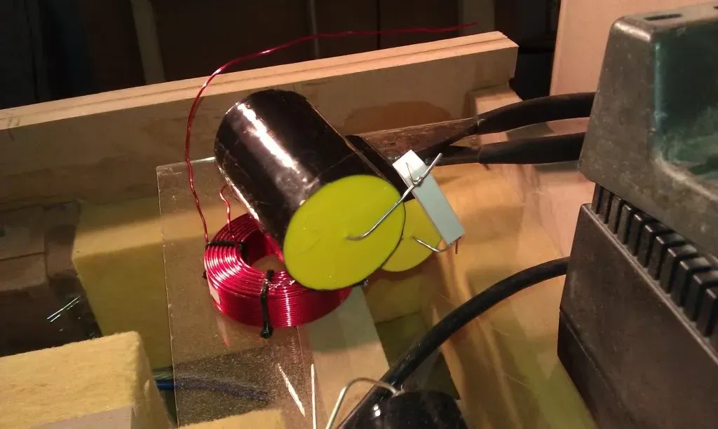

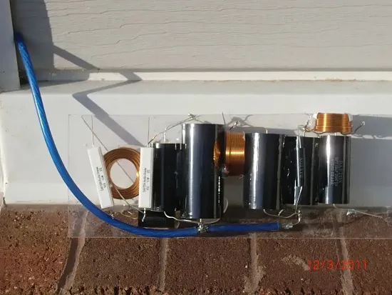

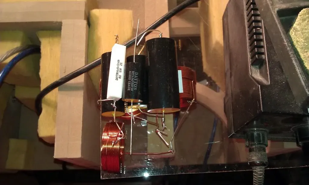

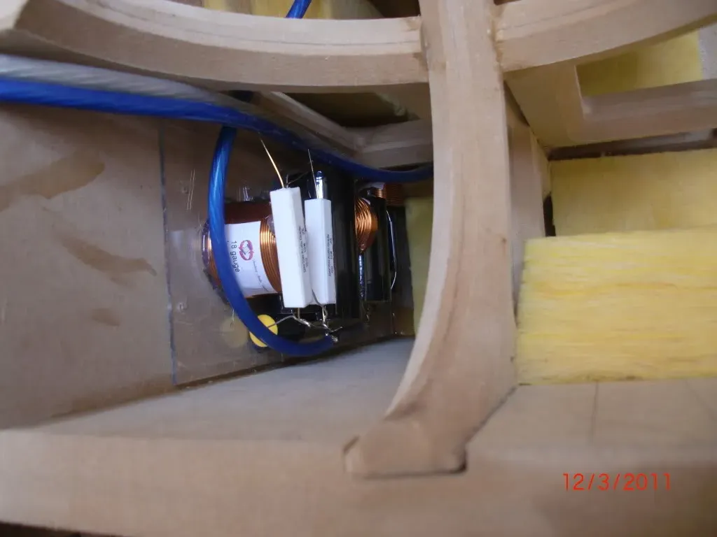

                                                  Ok. soooooooo thought I had all the components taken care of for the crossovers.
                                                  SOME HOW LOST A 12 uf CAP. :evil:
                                                  Sooooo waiting on that. But the crossovers are built as far as I can take them and they will be boarded and installed this weekend.

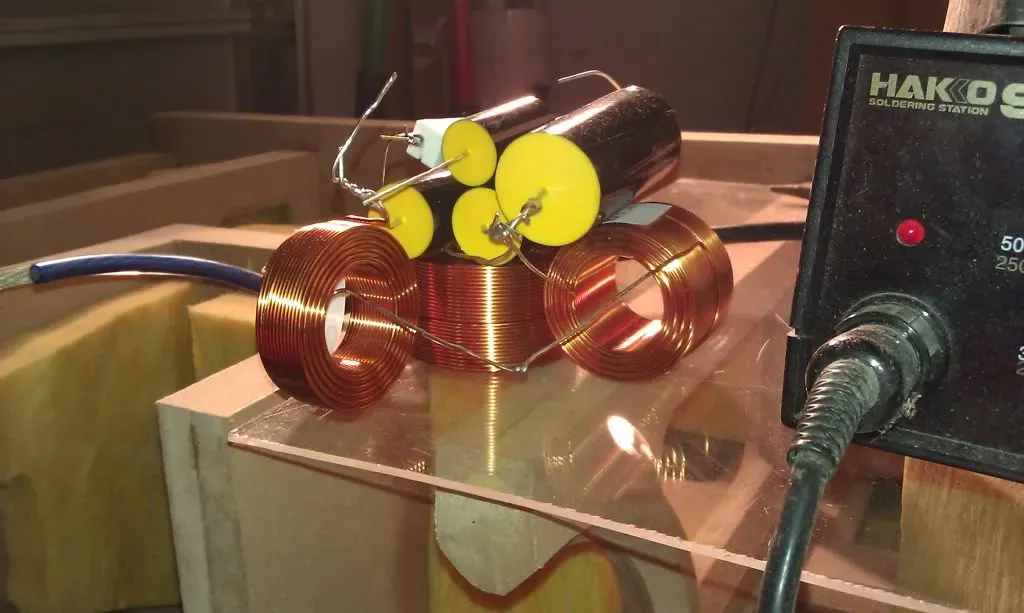

                                                  Some pics and some confirmation that I have the inductors aligned appropriately.
                                                  QUESTION:
                                                  Mid crossover; are my inductors ok in this orientation?
                                                  Woofer crossover done -
                                                  Woofer crossover in it's final residence -
                                                  All crossovers in final position -

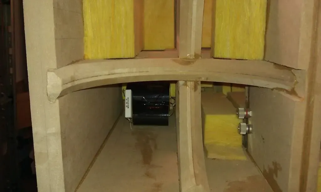

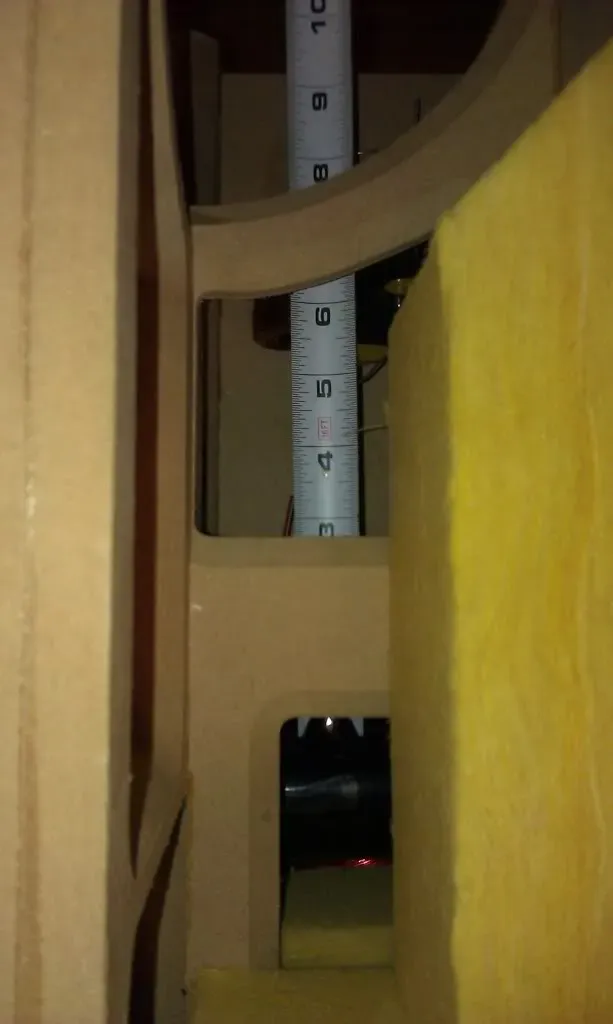

                                                  QUESTION:
                                                  Is 6 inches enough distance between my woofer inductor and mid inductors?
                                                  Last edited by theSven; 08 June 2023, 11:59 Thursday. Reason: Update image location
                                                    yes your inductors look correct.
                                                    yes. 6" is more than I have in my Khans.
                                                    • joeybutts
                                                      • 476
                                                      Thanks Ryan!! I was 99% sure they would be ok, on both accounts.

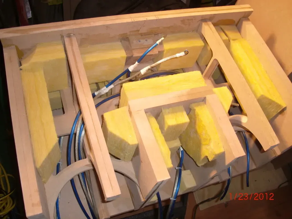

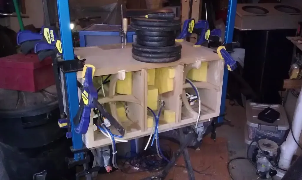

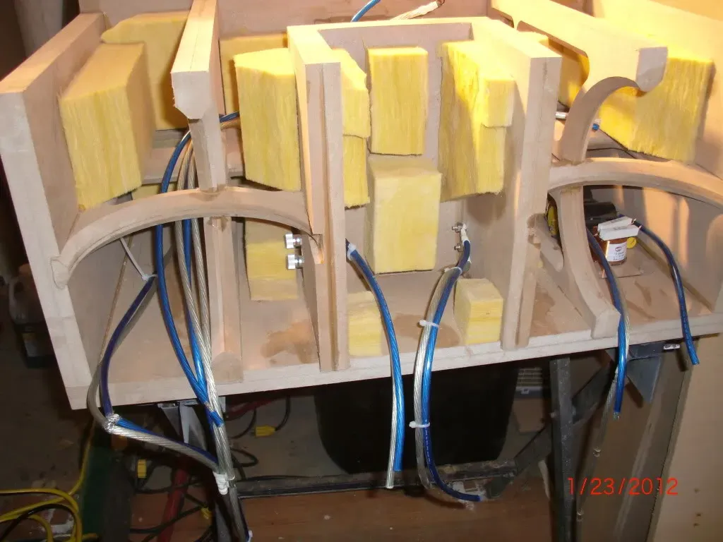

                                                        All wiring is now run! Waiting on the weather to warm up a bit before I finish up the gluing!

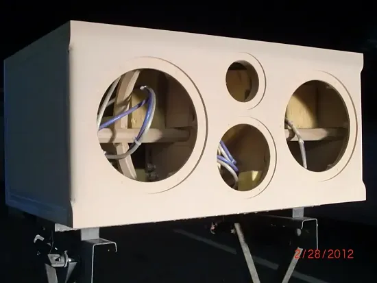

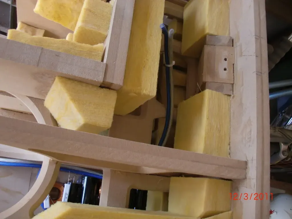

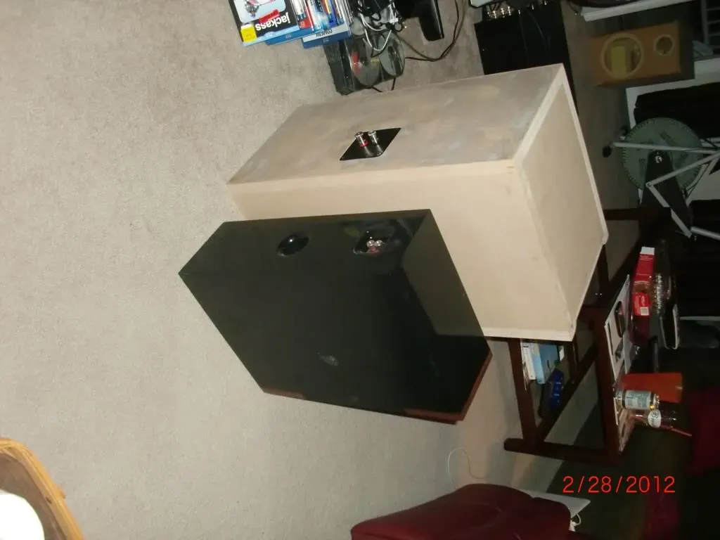

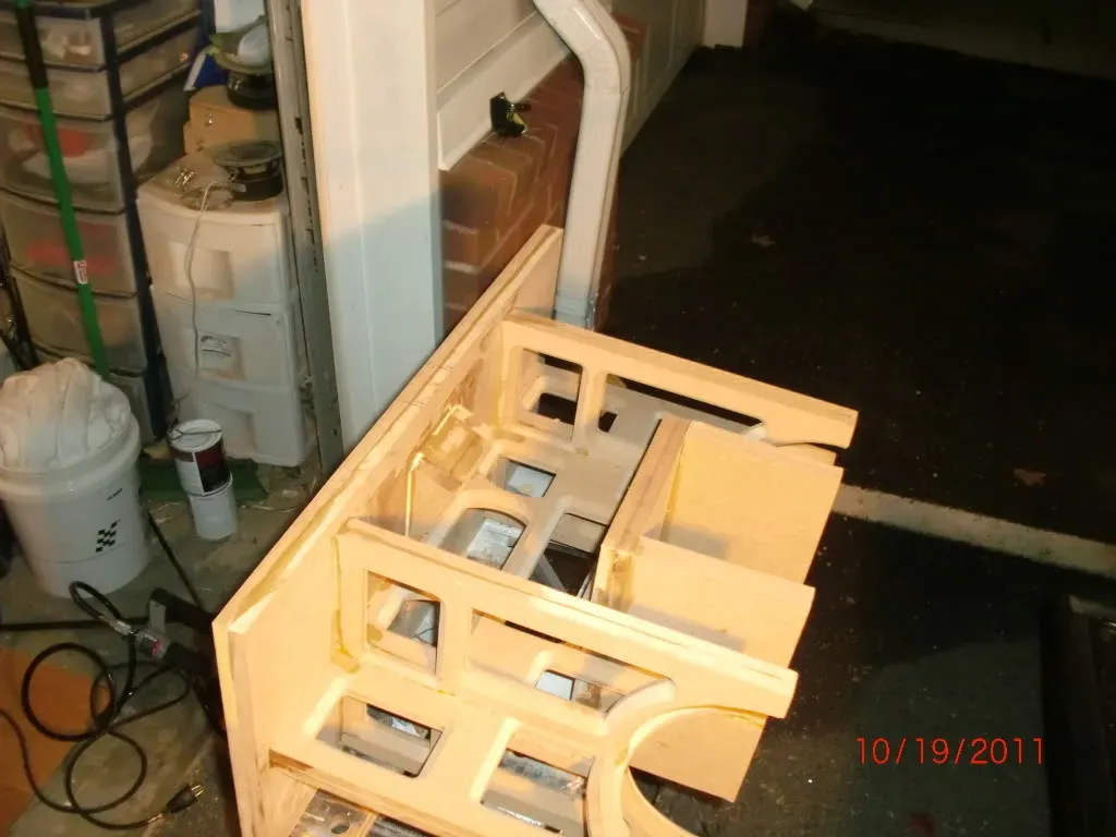

                                                                      Ok. An hour at a time.
                                                                      Wires run for cabinet -

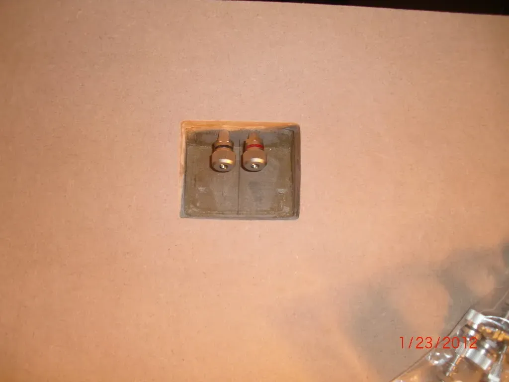

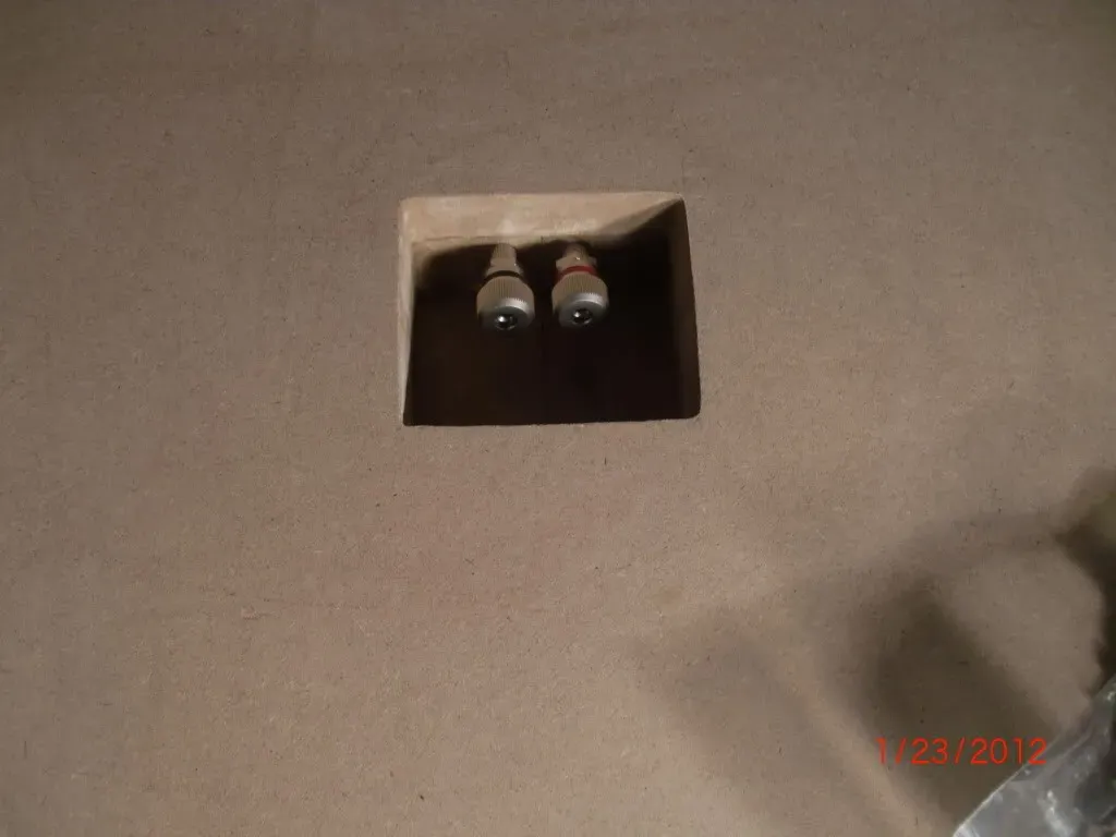

                                                                      Got the terminal cup all done and ready for finish work -

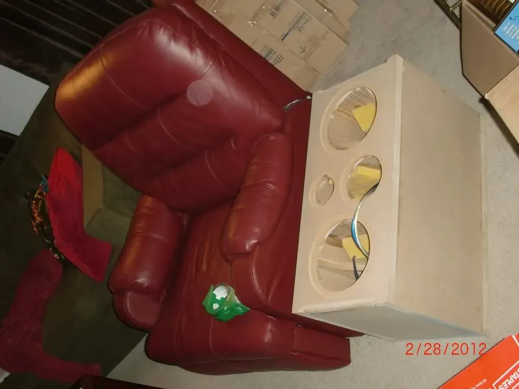

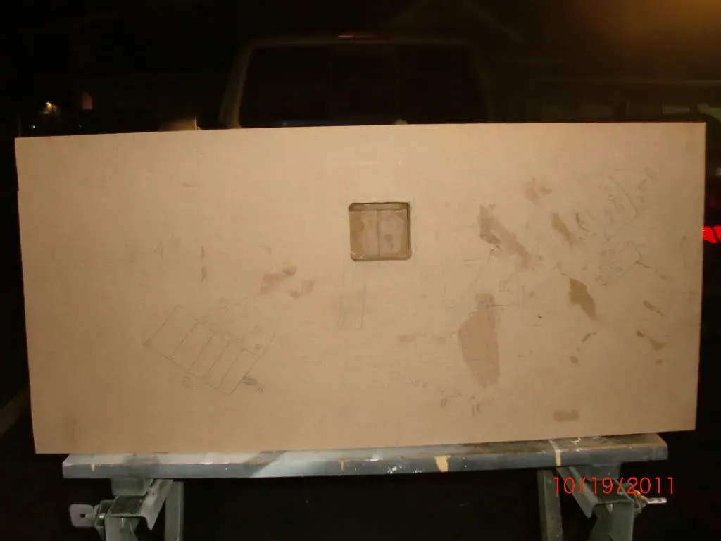

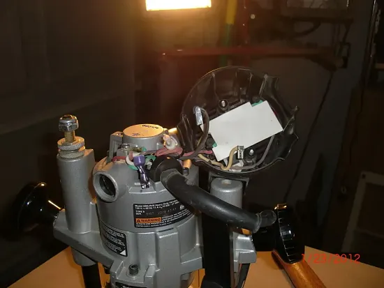

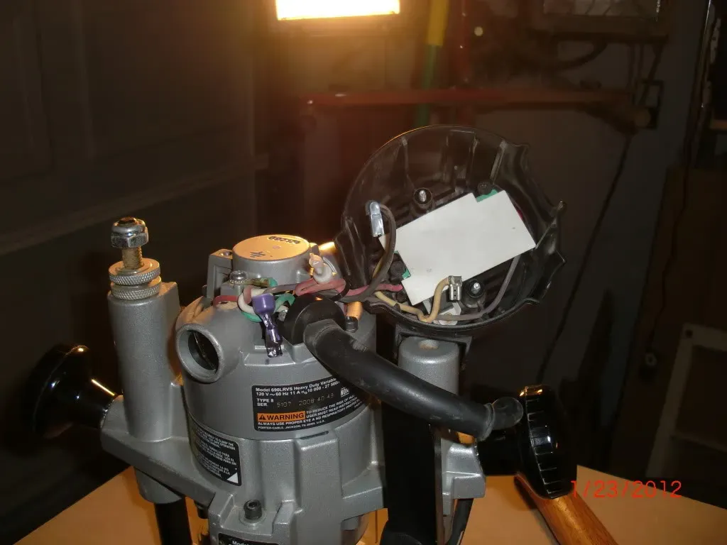

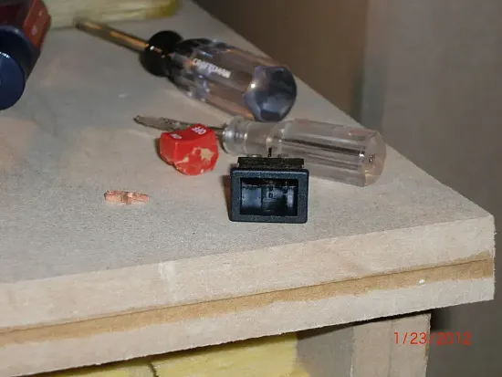

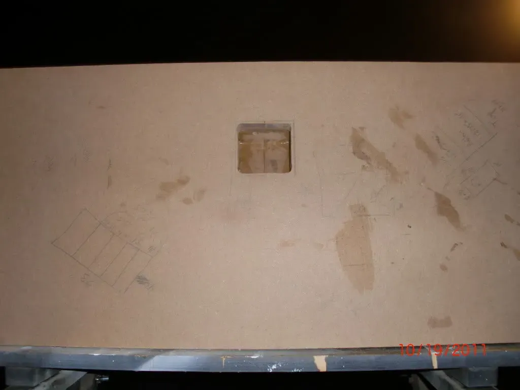

                                                                      Only got so much done the other night because of a slight mishap with my router. too much sawdust in the on-off switch.
                                                                      All fixed and like new!
                                                                      Time to finish the terminal cup and then can finish the rest of the cabinet and try it out. Ugh. I feel like I've been working on this since birth.
                                                                      Last edited by theSven; 08 June 2023, 12:04 Thursday. Reason: Update image location
                                                                        I've had that happen to my router as well - but only with MDF.

                                                                          Began bondo work on terminal cup. Hoping to have it ready for primer by tomorrow night.
                                                                          I hatttttte finish work. :M

                                                                            CAN IT BE?!!??!?!? Joey is gluing up the CENTER CHANNEL!?!?!?!?
                                                                            Last edited by theSven; 08 June 2023, 12:05 Thursday. Reason: Update image location
                                                                              You can knit more sweaters while waiting for that glue to dry?
                                                                              • joeybutts
                                                                                • 476
                                                                                LOL. Had to go there did we, Christopher? :P

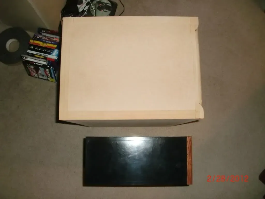

                                                                                      I know no one is going to believe me, even with a pic, but the baffle is glued on.
                                                                                      Just need to trim up and sand the cabinet and then I can test out this beast!!
                                                                                      P.S. HEAVIEST CENTER EVERRRRRRRRRRR.
                                                                                      • joeybutts
                                                                                        • 476

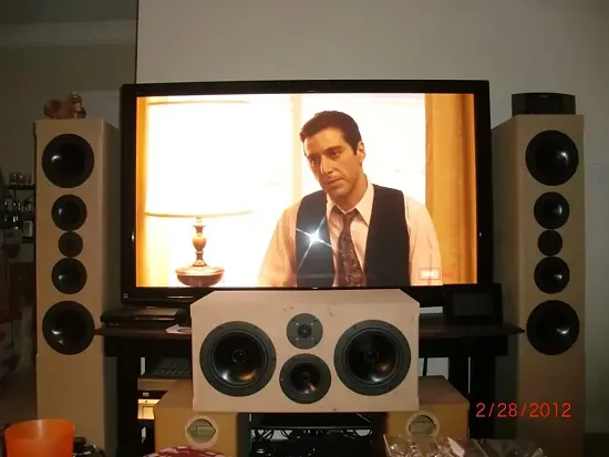

                                                                                        This 84 lb beast is playing! Pics tomorrow. I'm tired. Hoping to get some time soon to really listen and open it up, but might not be for a while. Also need to reclaibrate Audyssey. Wait till you see the comparison pics between this and the ported tritrix. insane.
                                                                                        • joeybutts
                                                                                          • 476
                                                                                          That is a real size recliner, not a kid size.
                                                                                          Oh that poor tritrix.

                                                                                          Temp set up that my wife woke up and wanted to kill me about since she went to bed before it was set up last night.
                                                                                          The Godfather approves.

                                                                                            DAMN! That's HUGE!
                                                                                            p.s. Nice amp.. I have one too! (5-channel)
