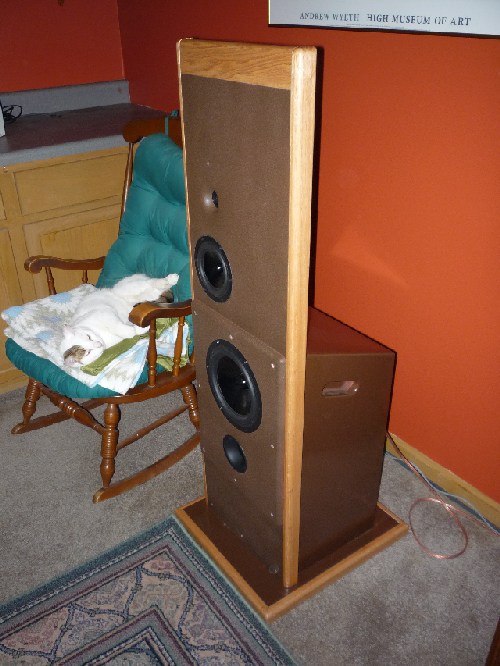

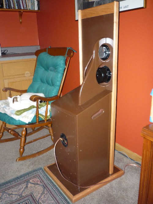

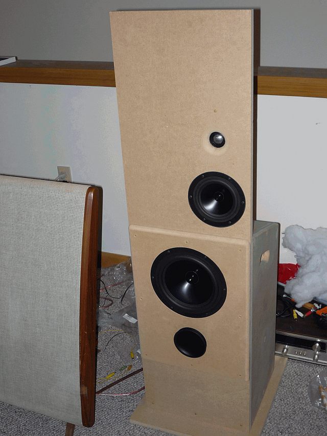

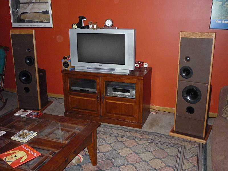

    It's been a while since we had a new project on the board, so if you don't mind, I would like to show you the speakers I've been working on for the past two years. I call it simply the B3 project. I took these to DIY Atlanta unfinished in summer 2009 and they were well received, tying for first in the unlimited class. I'll explain the name later, but first, some pictures and a quick description of components.
    This is not a small speaker. As you can see, this is a four foot tall, dipole hybrid. As such, they have to be pulled away from the back wall so that the front is about two and a half feet out. It uses some fairly standard DIY drivers: The 8" Dayton RS-225S-8, the 6" Dayton RS-150S-8 and something a little different, the 1" Seas 27TBFC-GTV shielded metal dome. The total cost for drivers and crossover components is around $550 for the pair - not cheap, but not terribly expensive either.
    You can see from the first picture that I still have a CRT type TV, so I chose all shielded drivers. I probably didn't need to, given the distance to the TV, but I also wanted to make use of the flatter low end of the shielded tweeter vs. the standard 27TBFC. I also have a center channel in the works and I wanted to use the same driver. More on that later.
    Despite its somewhat standard driver lineup, there are some suttle refinements. First, the drivers are mounted so that their acoustic centers are very closely aligned. The wooofer is mounted on an extended front baffle and the tweeter is rear mounted using waveguide loading. These two details match their ACs with the mid on the main baffle.

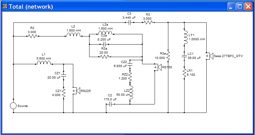

    Something I did that not everyone will agree with is that I used first order electrical crossovers for both the woofer-mid at 250 hz and mid-tweeter crossover at 2000 hz. I also used notch filters as needed for the metal drivers. I'll discuss more about the crossover choices later, but I found that all drivers in phase sounded much better than anything else I tried. Here is the working crossover. I have some more testing and there are two small areas I want to improve, so don't consider that a finished design just yet, but I don't foresee any changes other than modifying values on the existing components. The minimum impedence is over 5 ohms, so any amplifier can drive them.

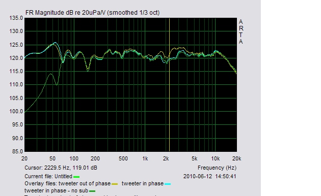

    And finally, here is the raw ungated, in room, 4 meter measured frequency response. I used ARTA and a calibrated microphone for this, and I also showed the response with and without my sub.
    That's it for now. In following posts, I'll walk you through my design decisions and construction details. For those of you that are a little gun shy about designing your own crossovers, I'll show you what each part in the crossover does and how I arrived at the values. It's not always textbook, but you will at least see why I did what I did.
    Enjoy
    -Bob

    I'm interested to see more details. Looks like fun.
      Looks good. I'm looking forward to the additional details to come. :T

          Very cool project, Bob! I like the nice clean lines. :T This forum can really use some new designs, IMO! The way you supported the OB back panel with the curved central piece and circular cutouts is almost exactly the solution I arrived at back when I did my NaO mini's.
          How does the excursion model on the RS150 crossed at 250 in a OB dipole? I guess the Seas did fine in the shallow waveguide. That's good to know.
          What was your thinking behind the significant driver offset on the OB panel?

            Thanks, Dan. I tried my best to make them presentable. I wish I had your woodworking skills. I learned woodworking just to make speakers. But my guess is that you had plenty of practice before you learned speakers.
            The excursion of the RS150 stays within xmax limits as long as I keep the high pass filter cap at 150 uF or less if I remember correctly. You can see from the latest version of my crossover that its up to about 175 now. I'm still working on that part. But I have a few more tweaks to try, so I might not need that much.
            The tweeter turned out great. You can see that it's almost dead flat from about 2500 on up to the rolloff over 12,000. I probably could have moved the tweeter a little closer to the mid, but I was trying to get part of the back brace to fit in between them. They are still just 6" apart center to center, which is just barely under one wavelength at the 2000 hz crossover, so it's OK.
            I also moved the centerline of the drivers over to the side after playing with the Edge program during development. This gave the flattest response in the program, but after I built it and measured, it didn't really work out that close to what the Edge said. I still had to make big adjustments in the crossover to compensate for the dipole peak I was hoping to minimize by offsetting the drivers.
            I'll go into more detail later. That is just one example of where I found theory not to match reality as closely as I hoped.

              Love your work Bob. Aligning acoustic centres certainly makes crossover design a lot less of a headache.

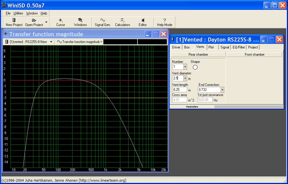

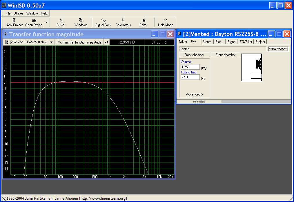

                    I've gotten pretty good with WinISD, so that's what I used to get a bass alignment. I wanted to get down to 40 hz with the bass and the RS225S-8 modeled pretty well and met that goal. I also wanted to keep the box size blow 2 cu. ft. So here is what I came up with.
                    Click image for larger version  Name:	WooferTransferFunction.jpg Views:	1401 Size:	94.6 KB ID:	855305

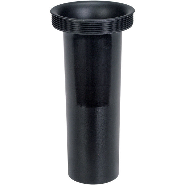

                    As I said before, I had some hesitation using a ported bass, so I purposely designed a little less than maximum bass extension. I was afraid if I maxed it out using a 2 cu. ft. box, it would begin to sound boomy. I think the slightly smaller 1.75 cu. ft. box worked out very well. It also allowed me to use this standard 2.5" X 8.5" port from PE without modification to tune it to ~27 hz and get an F3 of 32 hz:
                    Speaker Cabinet Port Tube 2-1/2" ID x 8-1/2" L FlaredThis high-quality port tube features an external flare for reduced port turbulence and enhanced aesthetic appeal. Perfect for tuning high-performance bookshelf or standmount speakers. Ports are a press-fit style and can be trimmed to length if needed. Requires 3-3/4" opening. Outside diameter of flare is 3-7/8".

                    Click image for larger version  Name:	Port_model.jpg Views:	1474 Size:	94.5 KB ID:	855306

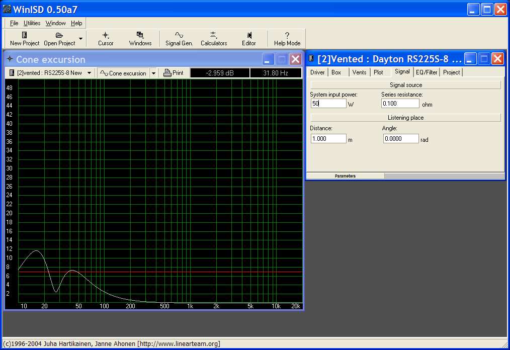

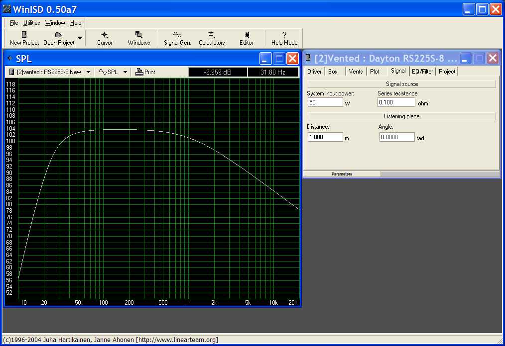

                    Next I wanted to see how much output it was capable of. It looks like 50 watts would produce 104 db while just barely exceeding Xmax. That looked like enough for me. (I assumed a 20 hz high pass filter for woofer protection):
                    Click image for larger version  Name:	ConeExcursion50Watts.jpg Views:	1471 Size:	93.9 KB ID:	855307
                    Click image for larger version  Name:	SPL50Watts.jpg Views:	1412 Size:	94.4 KB ID:	855308
                    (Darn, I just realized that I forgot to add .25 ohms for the crossover inductor resistance. Oh well, I just checked and in this case it doesn't make enough difference to put together new jpg's - maybe half a db more at 35 hz.)

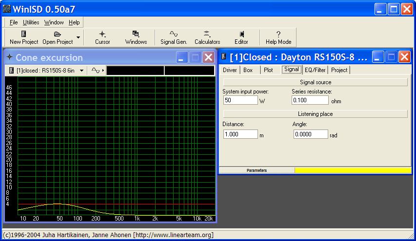

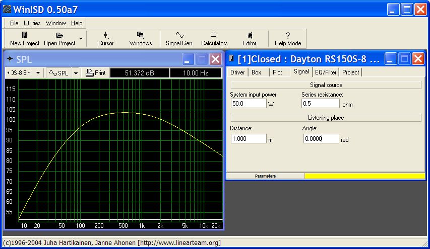

                      To model the mids, I used a 5 cu. ft. closed box as a proxy for the open back. This results in a Q only .02 higher than the free air parameters. Open back speakers are not well modeled in WinISD, so I had to use something close. This was close enough for modeling SPL and excursion.
                      For the mid, the same 50 watt input yields the same 104 db SPL:
                      And doesn't exceed Xmax if you use a 135 hz or higher first order electrical high pass filter (about 150uF):
                      What this showed me was that only one woofer and one mid was needed, since I wasn't looking for head banging loud. 104db is still louder than I want to listen at for any extended period of time. Even adjusting for a 4 meter listening distance, it's at 92 db which is almost freight train loud.
