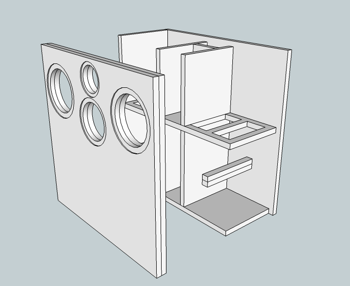

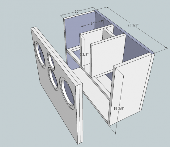

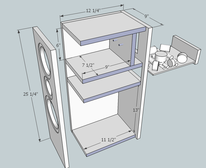

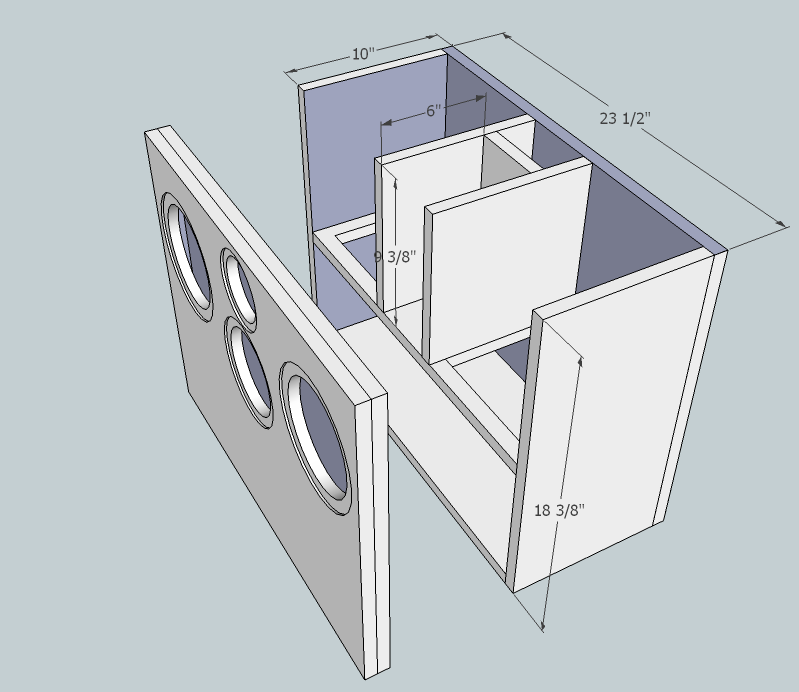

    Original cabinet design:
    Proposed modification:
    Click image for larger version  Name:	KhanCenter.png Views:	2087 Size:	45.6 KB ID:	870341
    Any opinions on the change? How about bracing in the expanded lower section--do I need anything there?
    I wasn't sure how important the volume in the mid chamber is, so there's a divider to keep it the same as the original. If it doesn't matter, I could simplify construction a bit by omitting it, but I may just leave in there to create a recess for terminal posts (opening up the back wall, of course).
    Last edited by theSven; 06 May 2023, 21:50 Saturday. Reason: Update image location
    Looks good. I would add some bracing in the bottom. If you put a pair of braces beneath the mid sides, I think that would be good.
    I would probably leave the mid chamber as-is.

      Are you going to use the design using the RS180's, or the RS225's?
      • CraigG
        • Jun 2010
        • 57
        ---k---: Thanks--that's what I'll do then.
        dpc rep: RS180s. The bigger version would be tough to fit horizontally, so I would have to build them as a single 76" wide cabinet, which would then be a structural component of the wall holding up the IB sub. That alone wouldn't completely rule them out, but their full-BSC crossover also makes them less suitable for in-wall use than the KhanCenter.

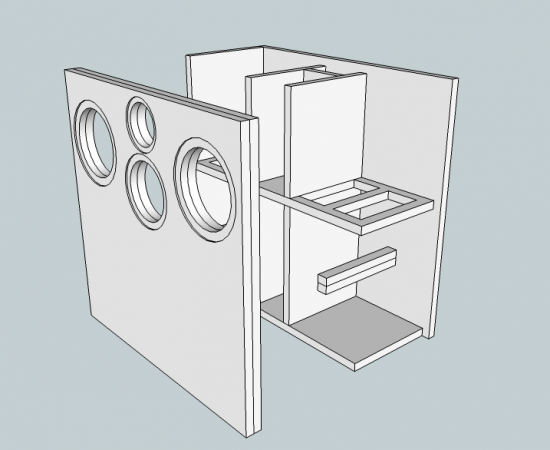

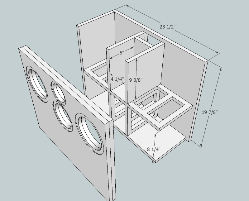

          Revised version with bracing, and rear cut-out behind mid chamber:
            YEAH! I think that properly maintains the spirit of overkill that we worship around here. :T
            Though the big hole in the horizontal braces would have allowed you to place the crossovers down in the hole. Which I think is better than the back wall or on that brace.
              I seem to gravitate towards overkill--it's moderation I have problems with.
              I was actually toying with the idea of sealing off the lower center section, and sticking the crossovers in there with their own access panel. Since the parts haven't arrived and I haven't done this before, I don't have a good sense of the size of the crossovers, so this might not be realistic. If you think they won't fit through the holes in the horizontal brace, they're probably not going to fit in the center section either.
                It depends on how you build them. If you use NPE caps or poly caps for the woofer. Some people can make them quite small... but no matter how small they get built, I wouldn't be able to fit my hand through there.
                BTW, there is still room for more overkill... but, I'll keep my mouth shut.
                  PLEASE don't hold back! I'd rather have as many ideas as possible on the table now, than find out later I could have done it better.

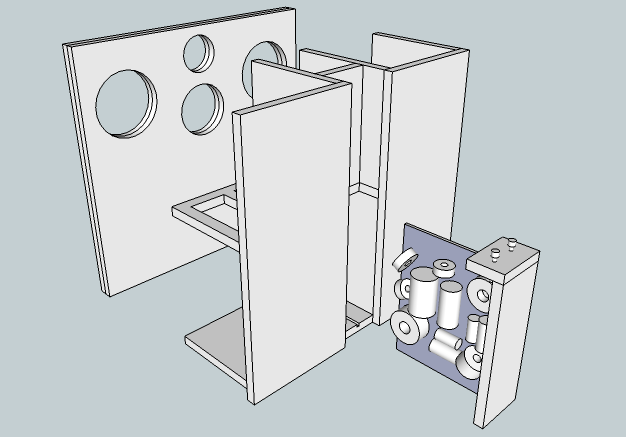

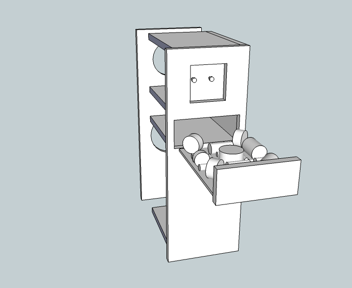

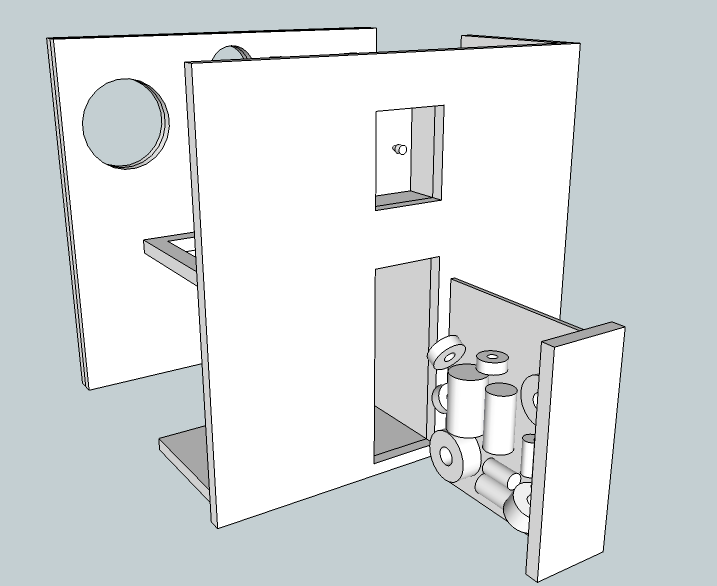

                    Updated--sealed off the lower center compartment, and put the crossover components and terminal posts on a board which slides in from the back:
Name:	KhanCenter w xo.png
                    Component sizes are accurate, but the layout isn't. I just wanted to see if I could get everything into the available volume, and it looks like that won't be a problem.

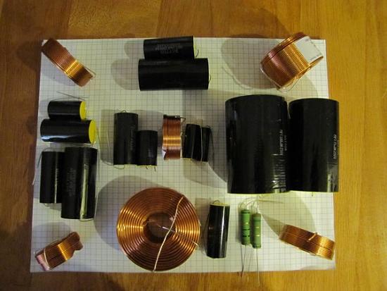

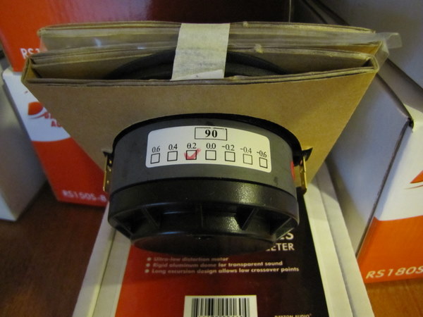

                          Stupid question #1: The tweeters have stickers on them like this:
                          Any idea what that means? I'm guessing it's a QC test result--maybe variance from the nominal impedance?
                          I've got four marked "0.2", one marked "0.4", and two marked "0.6". I imagine this makes little (if any) difference, but in just case it does, should I go for symmetry (using 0.6 / 0.4 / 0.6 across the front, and 0.2 for the surrounds), or keep the low values up front and mix up the rest?

                            Stupid Question #1 - the sticker indicates the sensitivity of the tweeters. I would match them up as best as possible, but don't get too hung up on it because those are pretty consistent. FWIW, I had bigger variability in a some of mine. But, when CJD measured them, he said there was a lot less variation then indicated by the sticker. We didn't do anything special with the crossover to compensate for the differences. Mast manufacturer's don't put the stickers on them (does anyone else?), they are probably causing more questions than fears alleviating.
                              I'm glad I asked! I'll put the higher values in the front, then--they'll be behind a screen, so a little extra sensitivity in the tweeters won't hurt, and might even help a tiny bit.

                                More revisions...
                                Center, now with the binding posts in a recess, and crossover on a separate board:
Name:	KhanCenter w xo-2.png

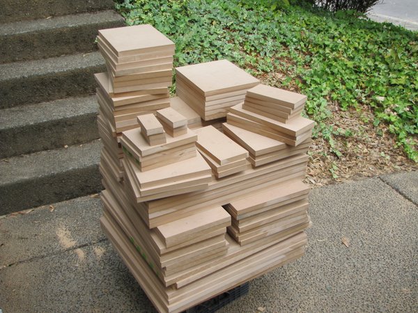

                                I picked up four sheets of MDF today, so if it's not still over 100 degrees here tomorrow, I'll be ready to do some cutting!
                                Last edited by theSven; 06 May 2023, 21:51 Saturday. Reason: Update image location

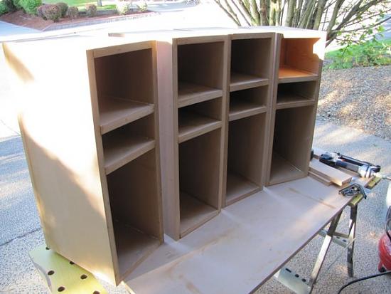

                                  Some progress...
Name:	Pile o MDF.JPG
                                  Last edited by theSven; 06 May 2023, 21:52 Saturday. Reason: Update image location

                                            Am I missing something here? The original design of the In-Khan-neato does not have a separate compartment for the tweeter.
                                              no, but it doesn't hurt.
                                                The back of the RS28 is totally sealed. So, it doesn't need to be sealed off. But, perfectionist may seal the back with wood. JonMarsh does this with his ModulaMTM. I think it mostly helps to add to baffle strength. It will also keep the woofer backwaves off the back of the tweeter... don't know if this helps. I haven't bothered and am happy.

                                                  Like they said, it doesn't need to be sealed. I'm not doing it for any acoustic reason--I just wanted a handy spot to stick the crossover. There was a functional reason to do this for the fronts (couldn't get the crossover in through the holes in the brace), but I'm just doing it on the In-Khans because I want to.

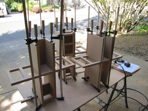

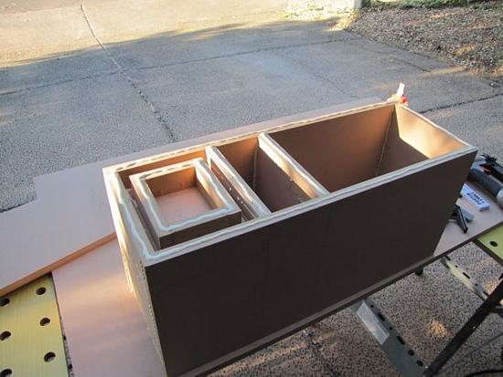

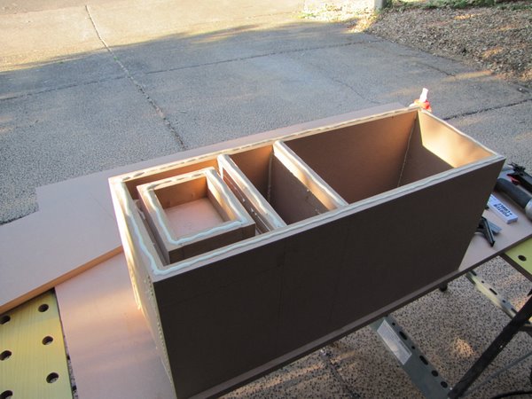

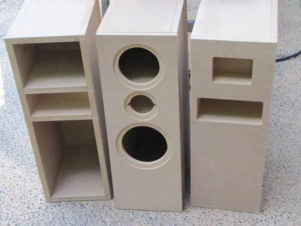

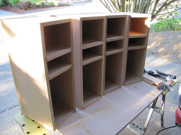

                                                                More progress!
                                                                Center sections for the fronts glued up:
Name:	Center Sections.JPG

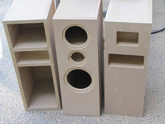

                                                                Also got the baffles routed for the surrounds. Here's a shot showing the front, back, and a baffle:
                                                                ...and here's how the back looked before the rear panel was attached, showing how I did the binding-post recess:
Name:	BP Recess.JPG
                                                                Last edited by theSven; 06 May 2023, 21:53 Saturday. Reason: Update image location
                                                                  Nice. Don't forget to drill the holes for the wiring between each chamber prior to gluing it all up. (I've made that mistake once or twice.)
                                                                      :lol: Yeah, good thinking! It would be a little tough to get a drill in there through the speaker holes.

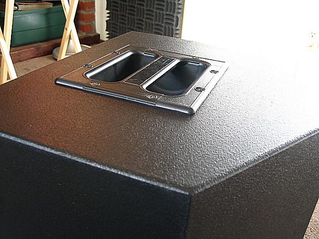

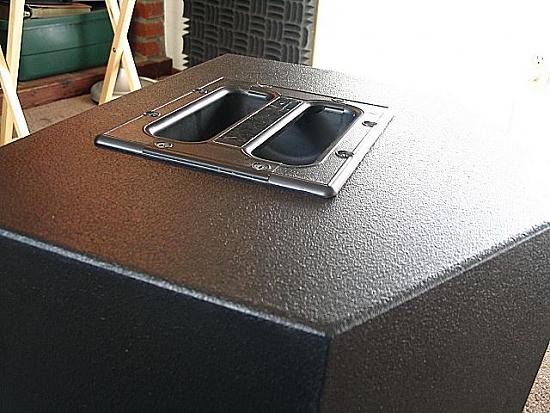

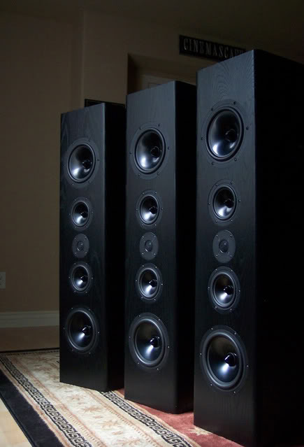

                                                                        Since they're going behind a screen, they need to be black, and relatively non-reflective. I'm probably going to use DuraTex. I was thinking of using truck bed liner, but I probably don't need THAT much durability, and from what I've read, it has a tendency to collect dust in the texture. DuraTex is a little smoother, so it shouldn't have that problem. I found a great example someone did with DuraTex and a roller:
                                                                        Click image for larger version  Name:	DuraTEX2.jpg Views:	6705 Size:	58.3 KB ID:	855214
                                                                        If these were going to be at all visible, I'd probably attempt what Phisch did on his KhanSpires--that black ash looks fantastic!
                                                                        Click image for larger version  Name:	Phisch-BlackAsh.jpg Views:	3381 Size:	36.3 KB ID:	855215
                                                                        Last edited by theSven; 06 May 2023, 21:54 Saturday. Reason: Update image location
                                                                          For behind an AT screen I recommend wrapping the baffle in black felt.
                                                                            I agree with CJD. Do felt.
                                                                            But, if you're going to do paint, go to Sherwin Williams and get their All Surfaces low sheen paint in black (it comes pre-mixed in white or black) and roll it on. It is what I've used. It is a very tough acrylic paint and will be much cheaper than the truckbed liner. Depending on the roller you use, whether you back roll, or what, you can get different textures, if that is what you want.
                                                                            • CraigG

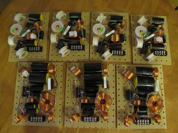

                                                                                    Crossovers are done:
                                                                                      Those look nice. Jammed a lot in a small space. Looks like all of your inductors are at 90 degrees to each other.
