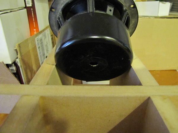

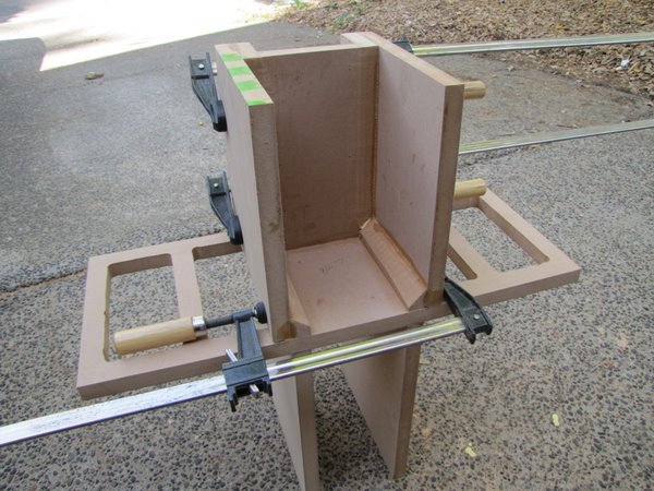

          OK, so I got some PE Sonic Barrier foam, and I was working on laying out dimensions of the pieces for the mid chambers. I figured I might need to make the sides a little shorter on the KhanCenters to clear the sides of the mid magnet, so I did some test-fitting to check.
          Well, let's say I attempted some test fitting. Turns out the mid chamber from the original KhanCenter sketch is 4 1/4" wide, but the magnet on a RS150S-8 is 4 1/2" wide.
          So, before I go nuts with the file/rasp/router/laser/explosives, is it going to cause a problem for the mid to be pinned in there on three sides? Should it have more room to breathe?
          Also, what's the volume supposed to be for the mid chamber? When I calculate based on the original sketches, the mid in the KhanCenter only has about half the volume of what the same driver has in the In-Khans. Clearly, I've gone wrong somewhere, but where?

            The volume of the mid chamber really isn't super critical, unlike a woofer, because of the crossover point is above where they start to drop off. If you read the original Khanspire thread there is a little bit of talk about it. CJD was proposing 15L - 16L for a pair, or about 7 - 8L each. CJD is a big believer in allowing the drivers lots of room to breath, so this is more than others would probably say is 'required'. For some reason, I dropped down to about 5L for the Khancenter (probably because I didn't do enough planning ahead of time with this one, but luckily a talent like CJD's can make anything sound great!). I think I was actually a lot wider than the 4.25" shown...maybe like 5.5". (5.5"*6"*9.375" = 5.0L) Really sorry!
            Can you post pictures that make show how tight it is? Maybe we can come up with some ways to fix it without getting to crazy.
              Jed likes the oversized mid chambers as well, They've always sounded great in the designs of his that I've built.

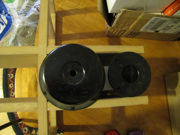

                It wouldn't be too much trouble to take 1/8" out on each side to allow the magnet to at least fit in there, but there's not much breathing room except at the top.

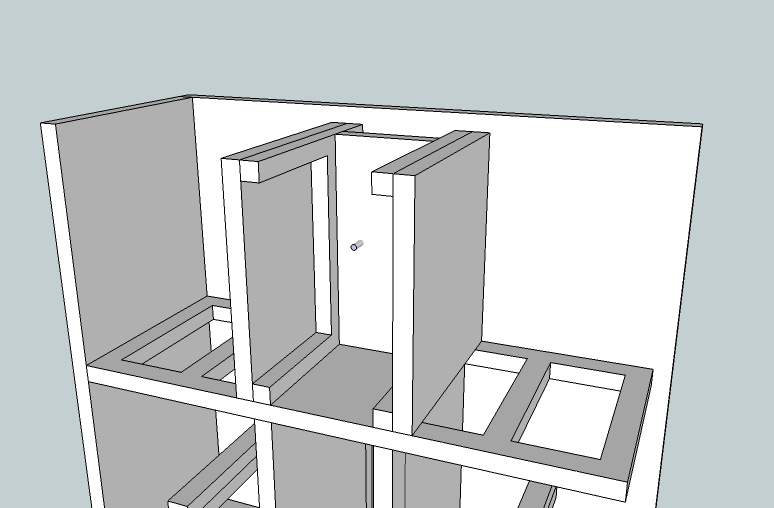

                I suppose I could cut most of the existing mid-chamber sides away, and add another piece on the outsides:
                The only drawback is that it would take a little volume away from the woofers...

                  I would do option 2(sketchup drawing), that little bit of volume wouldn't make much of a difference at all.

                    OUCH! Yeah, that is a typo. I put a big red warning in the original thread to hopefully prevent other people from making that mistake... I'm really sorry about that.
                    You're not far enough along with that piece, that the mod you show in your sketch-up is a no brainer or just redo it completely. I wouldn't mess with a rasp; it is likely more work and the rs150 likes to breath.
                      Just make sure that your modification doesn't put you in the same position with the RS180s.

                        OK, by adjusting the height of the chunk I cut out of the mid chamber sides , I can get 5L for the mid.
                        I calculated the woofer volume from the original sketch to be 48.7L, but with the mid chamber width corrected to 5 1/2", it looks like it really should be 47.4L.
                        The woofer volume for my version was going to be 48.8L, and adding the extra side plates to the mid chamber drops that to 46.8L. My version also doesn't lose any volume to crossovers, so I think I'll still end up really close to the actual volume of the original.

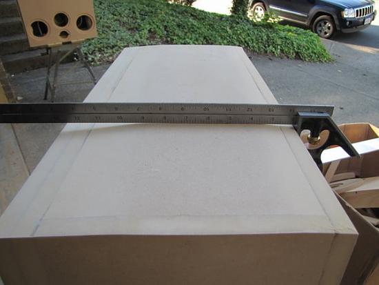

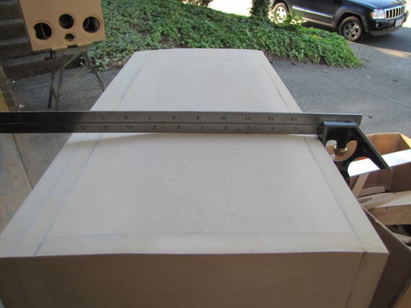

                        Ryan, as long as you're making corrections, what's the baffle width supposed to be on the In-Khans? That thread mentions both 9" and 9 1/2", and the sketches show 9 1/2". When I calculated the woofer volume, it was closer to the 18L target using 9" for the width, so that's what I used. EDIT: Looks like I made a mistake there, too--I forgot to account for the bottom thickness when I calculated. I get 17.4L @ 9" width, or 18.6L @ 9 1/2" width.
                            Well... that is another funny one. ops: I just got out the tape measure and measured it. It was 8.875" I then remembered that I was shooting for 9", had my fence set wrong and ended up with 8 7/8".
                            The great thing about building sealed speakers is that the volume doesn't have to be exactly anything. Small variations in size isn't going to make much of a difference and you can do a lot with polyfill to adjust the tuning to suite. Nothing to get too worried about and gives a lot of room to put the 'I' in DIY.
                              WoW 9, 9.5, finished speaker 8.875 :B Oh well junk happens.

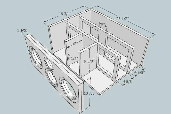

                                Here's a revised sketch of the original for your main KhanCenter thread:
Name:	KhanCenter - Revised Original.jpg
                                Last edited by theSven; 06 May 2023, 22:00 Saturday. Reason: Update image location

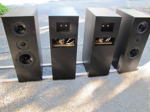

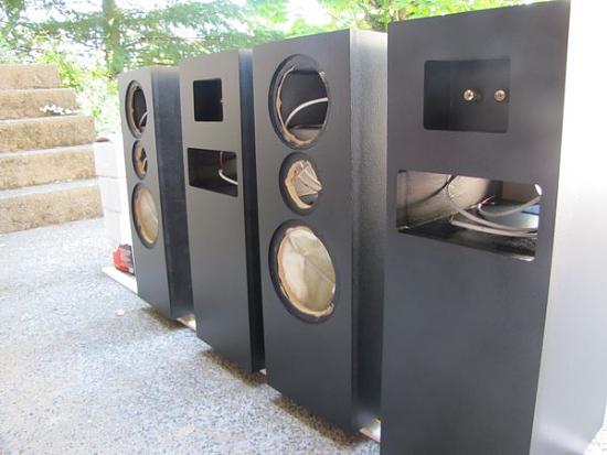

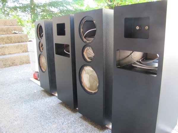

                                    In-Khans are DONE!
                                    Good tip on that Sherwin-Williams All-Surface stuff--I really like how it turned out. If these weren't going to be buried in the walls, I would add a second coat--the difference between MDF faces and edges is slightly visible, because the edges sucked up more of the paint.
                                    So how do they sound, you ask? All I've got at this point is a quick first impression. I put a pair of them in place of my front left and right speakers, and despite having them poorly positioned, not running through the Audyssey setup to re-EQ them vs. the settings for the current Klipsch speakers, having made NO effort to integrate them with the existing center channel, and only having about 20 minutes to try them out, I can say that they sound friggin fantastic! There's certainly more bass available than with the Klipsch, and it's beautiful, lovely, tight, controlled bass. There's a stunning, and I mean really obvious, improvement in midrange clarity. On the high end, the improvements aren't as immediately obvious (although I certainly haven't LOST anything here)--I would have to take more time to set up properly and more listening time to make a fair assessment. So far, though, these seem to be everything I had hoped for!
                                    I'm REALLY excited to get the fronts finished, get everything in place and set up properly, and start enjoying them!

                                        Wow that's a pretty interesting cabinet.... So does the bottom driver have more cabinet space then the top?
                                        Yes, the volumes for the mid and the woofer are the same as Ryan's original In-Khan-Neatos. I just shuffled things around a bit to close off the tweeter and crossover into a separate section.
                                          It looks like you recessed your tweeters exactly like I did - TOO DEEP!
                                          Zaph uses some of that ~1/8" thick pink foam that you get in packaging sometime or that you can buy at a craft store to fill in the gap behind the tweeter. I've built up the thickness using a couple of layers of paint, and more recently duct tape. Not being able to do an A/B comparison, I'm not sure how subtle the improvement is, but it will show up in measurements... AND, besides it will impress your wife and friends even more if that tweeter is perfectly flush!
                                          Really though, the look great. I'm glad the paint worked out for you. I'm really glad (relieved) that you're digging the sound.
                                            I figured as much. Well, if I'm going to be pulling one driver, I might as well pull all three, and add that second coat of paint!
                                            Me too! After ordering all the parts, I started to worry that there might be some aspect of the Klipsch speakers that I would miss related to the horn, the ported woofer, etc. I fully expected the In-Khans (and KhanCenters) to be better speakers overall, but I didn't know if the Klipsch would still have any points in their favor, and if those would turn out to be important. Well, they don't. The Klipsch are fine speakers and never gave me reason to complain, but the In-Khans are in an entirely different league.
                                            My only reservation now is that I almost think I went too far. It seems almost embarrassingly decadent to use these as surrounds--like buying a Ferrari just to drive to the mailbox. That's the point of overkill, though, right? That's why I jumped over some of the more budget-friendly, get-your-feet-wet type of projects, and went straight for the big guns--to be sure they would do everything I could ever ask of them.

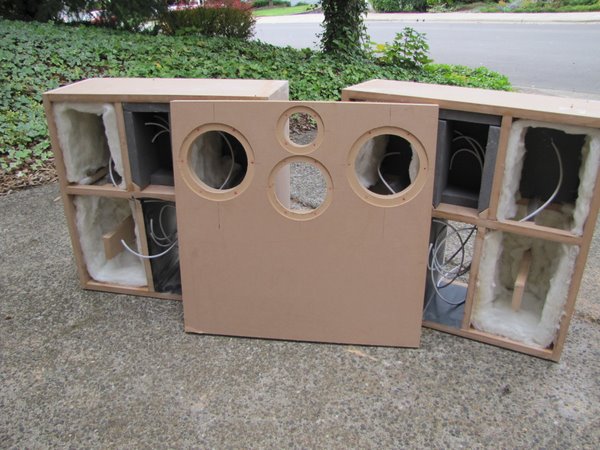

                                                            Mid chamber problem in the KhanCenters fixed:
                                                              Looks like a good fix!
                                                                Cool. I'm glad you found an easy solution.

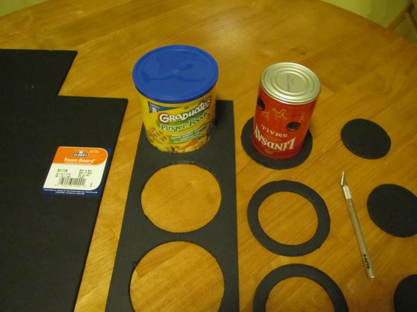

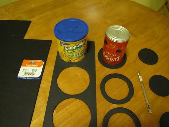

                                                                  To correct the not-quite-flush tweeters in the surrounds, I found some black foam board at Target. I located some appropriately-sized cans in the pantry, and used an Xacto knife to trace around them to make some spacer rings:
                                                                  They're thicker than what I need, but they can be compressed down quite a bit, so I should be able to just tighten the mounting screws until the tweeters are flush.

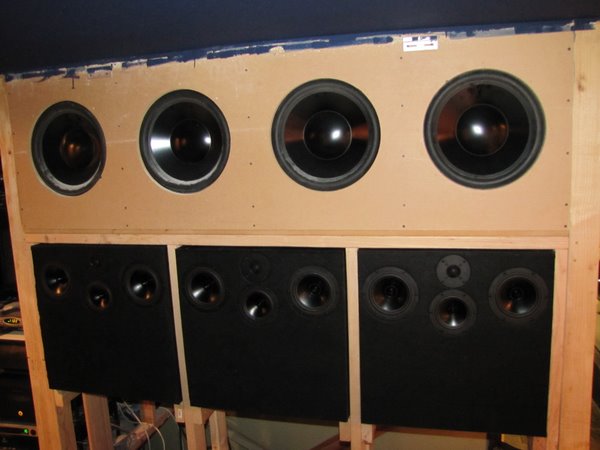

                                                                    Done!
                                                                    My wife suggested that it would be nice to have these ready in time to watch Iron Man 2 (released on Blu-Ray today), so I busted ass the last couple of days to get it done. I got the fronts painted and covered in felt, drivers & crossovers installed, rebuilt the wall under the sub, got all 7 speakers installed, and re-ran the receiver's Audyssey calibration.
                                                                    The verdict: THESE THINGS ARE AMAZING! I really couldn't be happier.
                                                                    Thanks to everyone for your support & advice, and especially ---k--- and cjd for these fantastic speaker designs!
                                                                    Last edited by theSven; 06 May 2023, 22:01 Saturday. Reason: Update image location
                                                                      Awesome! I'm glad you're liking them. That looks like a pretty sweet setup. I would love to see a photo from even further back.
                                                                      I am a believer in a little driver break-in. Don't do anything funky with them, but give them a few hours of good usage before you go critical listening or playing with the stuffing. Iron Man should just about do it! . Let me know how Iron Man2 is, I got to wait Netflix's 30 days.
