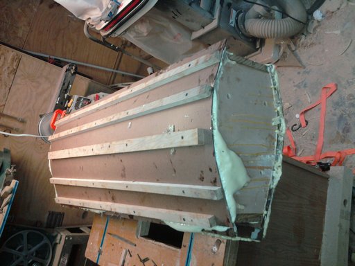

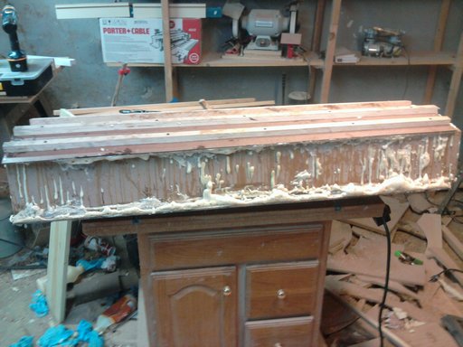

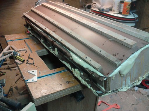

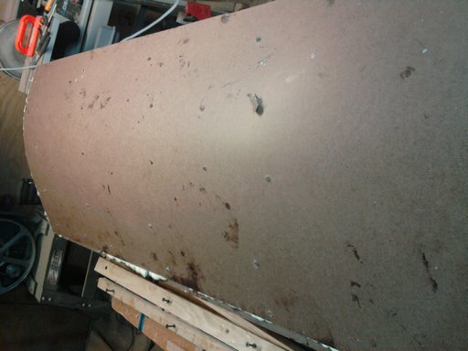

            Ok, here are the pics of the first speaker... it's getting there. Once the sides are done, it'll be time to clean up the squeeze out and trim the overhang. I'll use a flush trim bit on the top/ bottom, but I'll use a flush trim multi-tool blade to cut the curved sides. I plan on rounding over the front, but I'm still working out how I'll be doing that.
            Using Gorilla glue is definitely expensive, so I hope that this turns out well. Each 32oz glue bottle costs $25, and I need about one per speaker side. So that's about $40 in HDF and $100 in glue! But I honestly think it'll provide better results than PVA, and after all this work why not spend the money and do the best you can?
            Once it's all built, then it's just about saving up the $$ for the actual kit/ parts.
            I was going to get everything completed first, including the veneering. But I think I'll just leave them raw at first. $500+ in veneer and supplies will be a hard sell until I can confirm that the speakers are correctly set up/ installed.
                Just curious why you think that Gorilla glue is the best?
                I hate the stuff, and have always found that Elmer's Wood glue to be (obviously) cheaper, easier to work with, and more than sufficient to hold for your material of choice.
                You have a good start, but it might be easier for you to think about a different adhesive. Also, if you leave screws in under your veneer, you should have no worries whatsoever.
                Not trying to criticize - just hate to see you suffering needlessly!
                  Suffering I am! But I don't think it's needlessly. I agree that PVA is MUCH cheaper and MUCH easier to clean (especially considering that you can't really clean poly glue). But, I really like the fact that the poly glue will expand and fill any gaps. That means that if there is a bend in the HDF that's not 100% conforming to the curve, it'll still be solid. And why not make sure that there's nothing that going to be an issue, considering how much time I'm putting into this either way?
                  Also, I find that it takes a day for the poly glue to cure fully, it's solid enough to add the next layer after an hour or so. So in that respect I like it better, as I wouldnt' feel comfortable unclamping the PVA-glued panel until at least 4-5 hours afterwards.
                  Trust me, I use TBII for 90% of my gluing needs, and rarely used poly/ gorilla glue. But in this case I think it's worth that bit of insurance to use it.
                  I'll be heading over to my shop this evening I hope, so I'll have the last layer on the first speaker, and I plan to start the next one!
