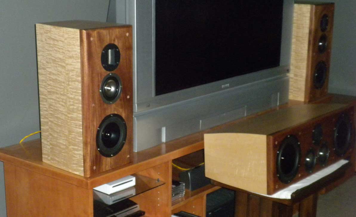

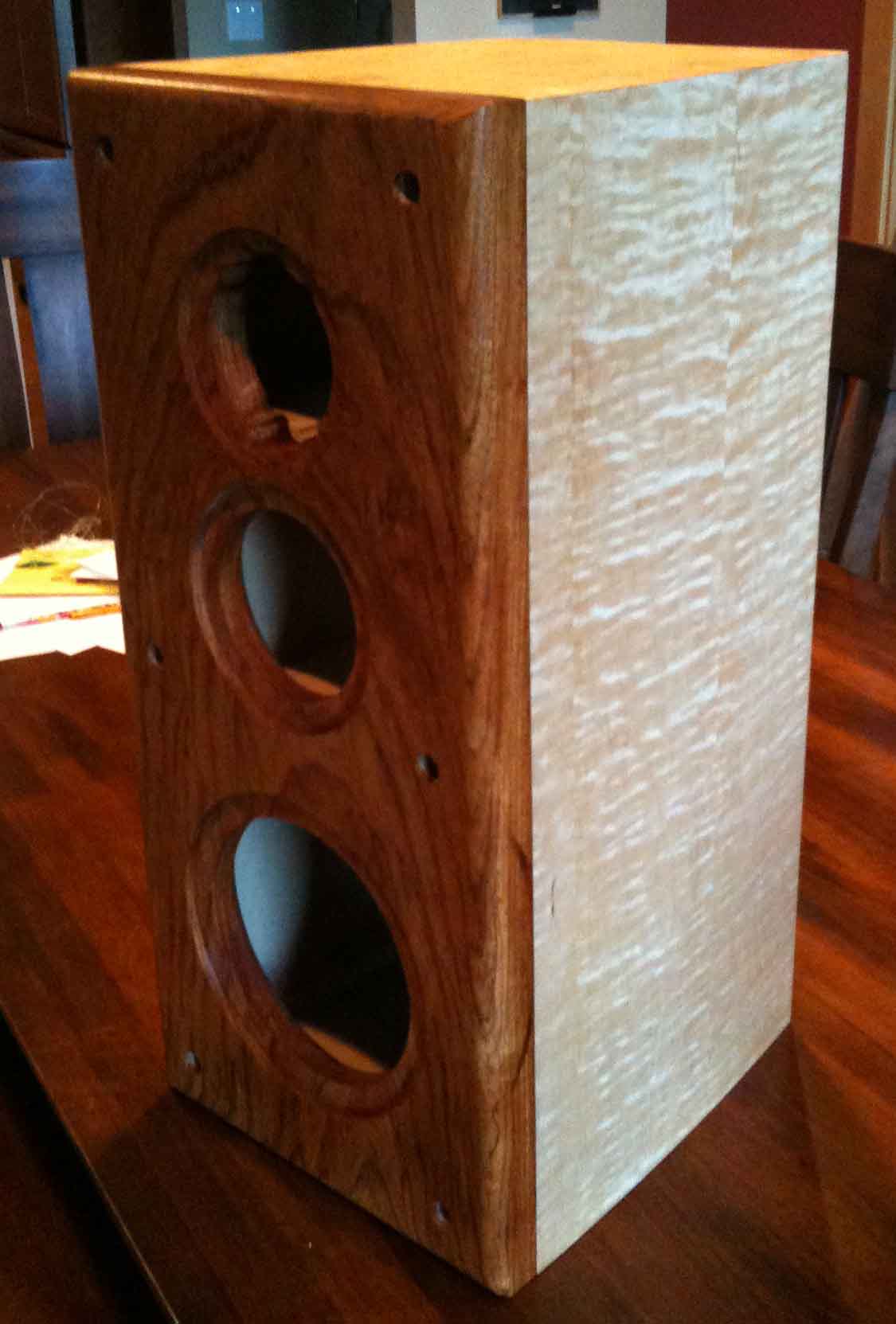

    I am finishing up the finish on the speakers and thought I would post a pic of one of the Monitors. I am very happy with how they are turning out. I didn't use any stains or colors and only a satin oil-based finish. I think I may put one more coat on for a total of four coats and call it good. The finish really brought out the character of the curly maple and also the beauty of the Jatoba. I guess I am at the point of having to build the crossovers. I am really dreading this task as it all looks very foreign to me. I can still call my brother-in-law to help but I am very impatient and it will likely be a while before he could get over. Anyone live near the Columbia Gorge in Oregon/Washington and feel like jetting out to build a few crossovers :B ?
Name:	Monitor - Finish Applied.jpg

      WOW, nice
      • richnen
        • Jul 2010
        • 117
        Those look great!

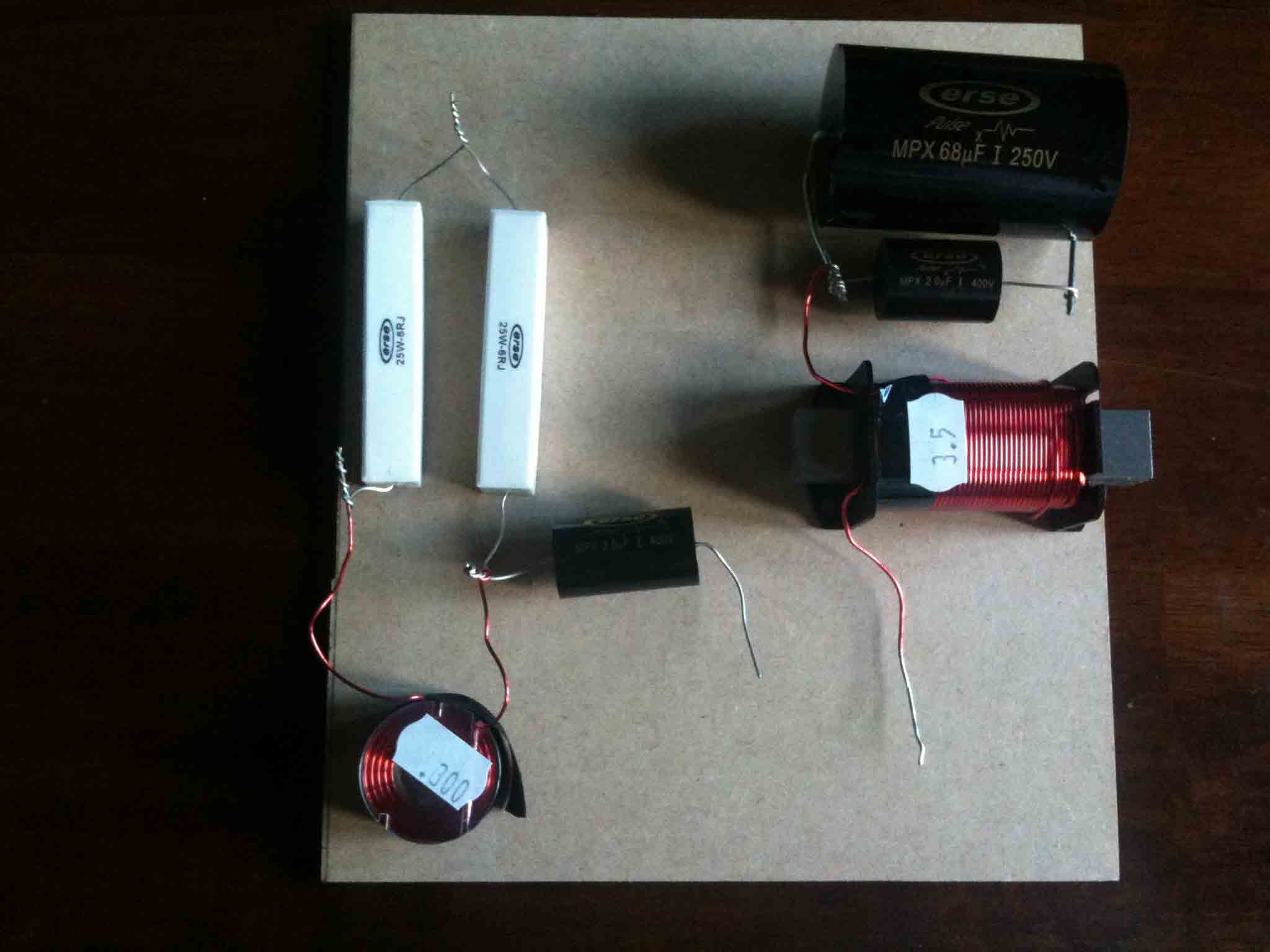

                                        In addition to my above questions, I thought I would post pics of what I've got so far for the crossovers. I have the parts twisted together for the Monitors but still have to add the wire. The first pic is the woofer and tweeter crossovers and the second in the mid. On a few of the junctions it seems like I am going to end up with a huge bundle of wire once I add the wires going to the drivers or binding posts. Should I twist those wires into the junctions or just hold the wire in place while I solder. Also, the inductors in the pictures are on a clear plastic spool and have a black nylon tape wrapped around them. Do I take the tape off or leave it on? Any other comments on what I've got so far?
                                        Matt

                                        • BOBinGA
                                          • 303
                                          Matt,
                                          Your wiring looks fine. I compared it to the schematics on Curt's site and they are correct. (I assume your are using a 5 ohm resistor on the tweeter to get something between a far wall and close wall tuning.)
                                          When you add the speaker wires, it usually helps to wrap them into the juction as well. It's kind of hard to get the wire to stay in place by just holding it against the rest of the wires. Twisting it in helps keep it in place while soldering.
                                          The black tape should be left on the inductors. Its to keep them from unraveling.

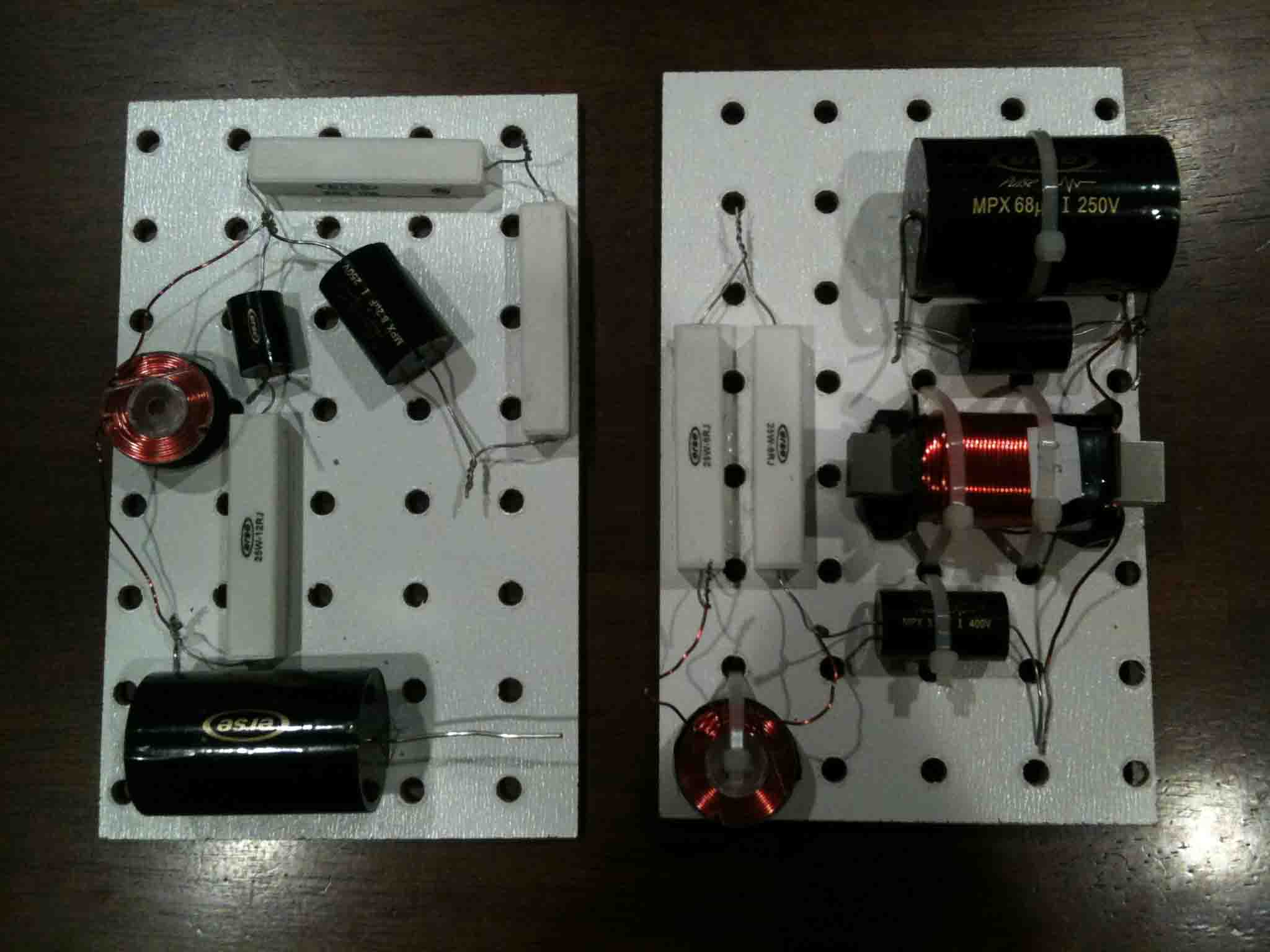

                                              I went ahead and mounted the components to pegboards. I used silicone cement for almost everything and then zip tied a lot of them as well. I may take the zip ties off once everything dries just to clean things up a bit. Still need to add the wire and solder everything together but thought I would post pics to see if I need to change anything or get the all clear. First pic is one of the Monitors and the second in the 2RCC. I probably should have mounted one of the two smaller inductors on it's side, as the inductors on the two different boards are going to be parallel to each other. I could look at an alternate mounting location for one of the boards in the Monitor to make sure they end up perpendicular. However, as it is planned right now, the boards are going to be mounted across from each other on the Monitors so I think they should be more than 20 cm apart from each other. In the 2RCC I am going to mount them on completely opposite sides of the speaker so it should surely be fine there. My crossovers seem like such a jumbled mess compared to some of the others that were posted but I guess they should still work. Anyway, feel free to comment.
                                              Matt

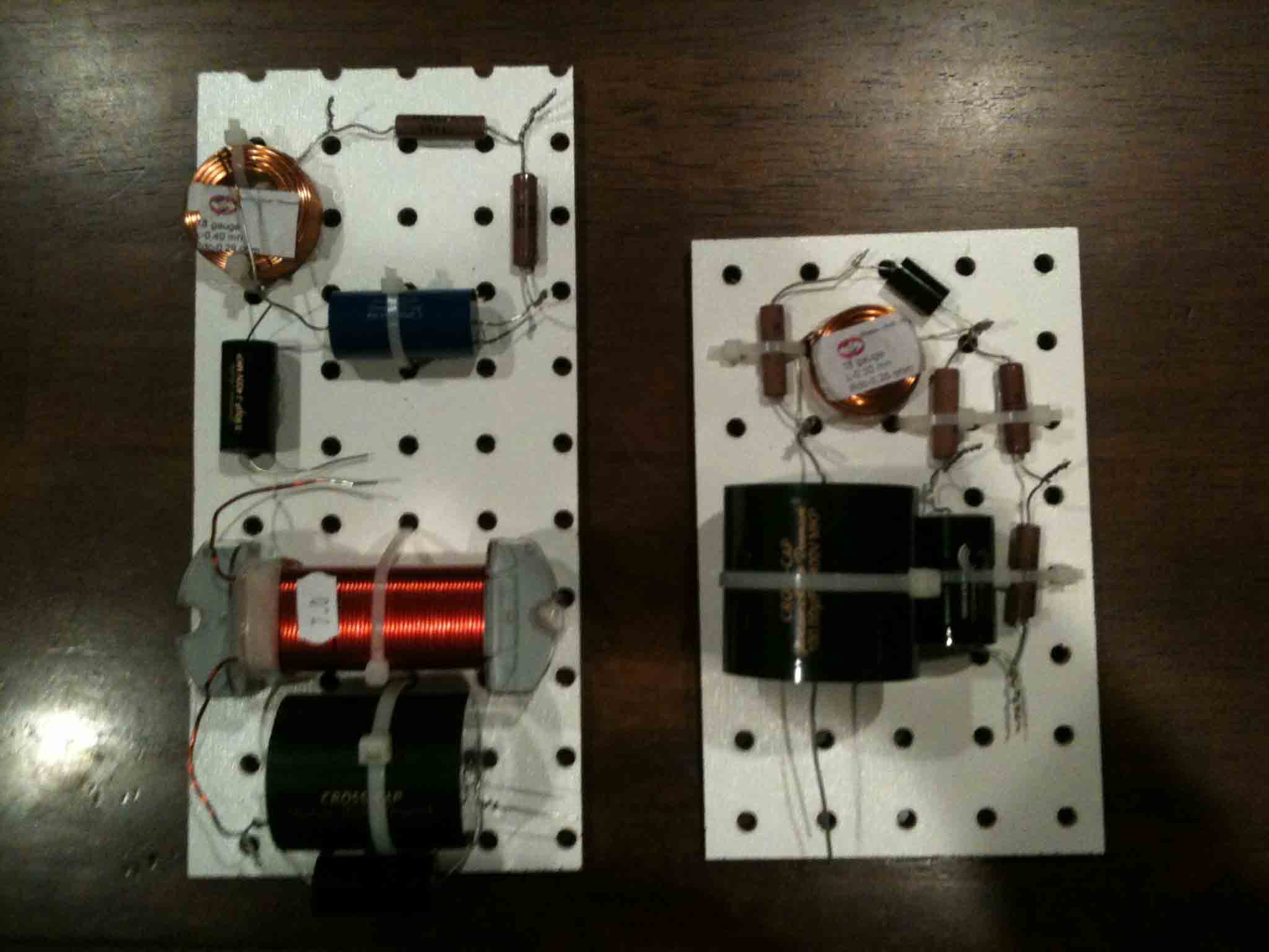

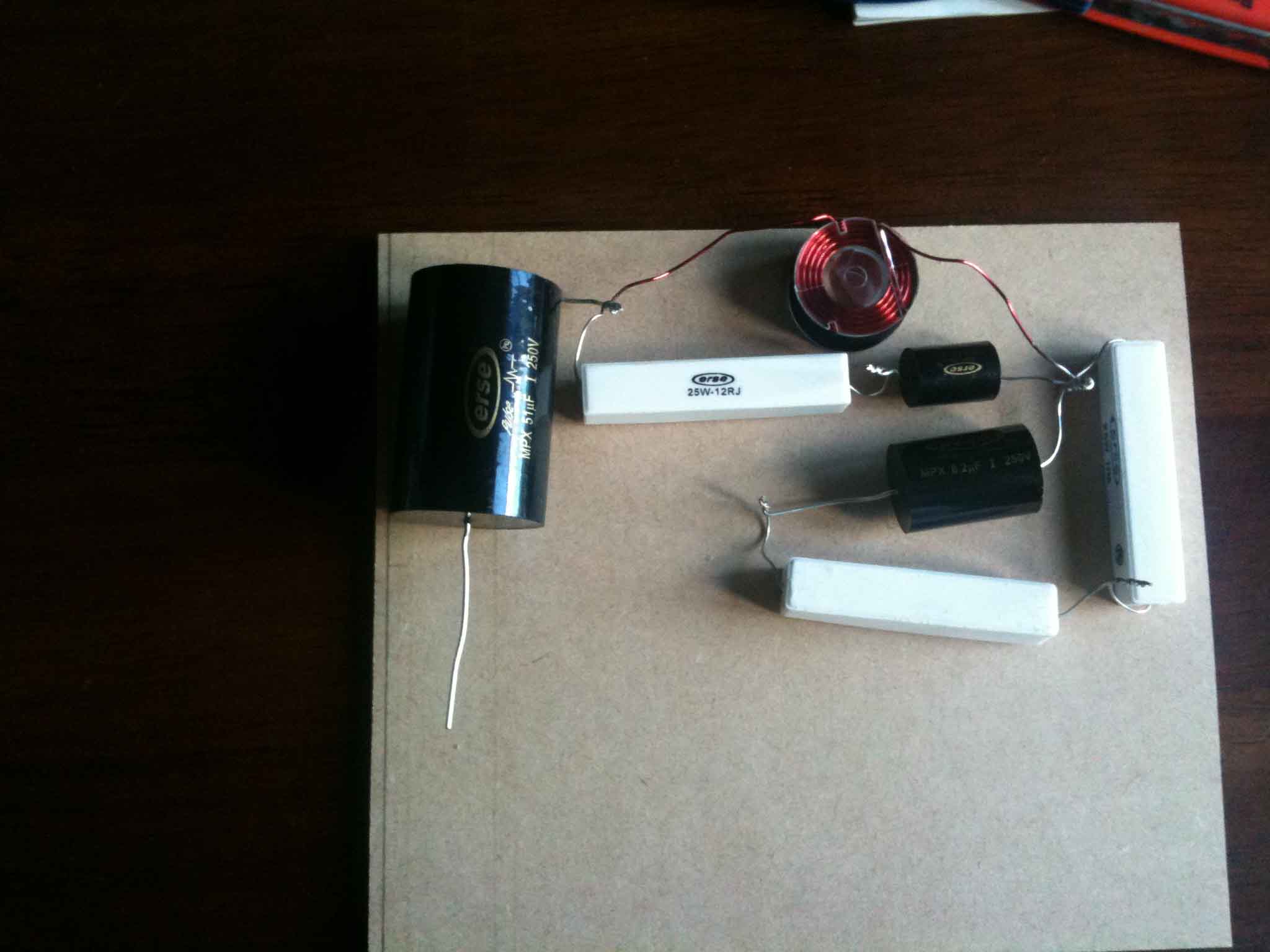

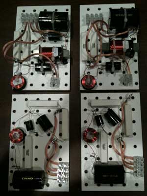

                                                OK, I have been diligently working on the crossovers. I soldered everything up on the Monitors and got started on the 2RCC but I think I need to stop for the night. I have a few questions I am hoping I can get some help with.
                                                First, I am including pictures of the finished Monitor crossovers. I think they are ok but it would be great to get someone to confirm that for me. One thing I am not sure on is that rather than going to the ground terminal on the woofer circuit I hooked into the ground on the tweeter circuit so I wouldn't have to have two wires going into the ground in the terminal strip. That's ok, right?
                                                Second, I am new at soldering and some of the components heated up a bit when I was soldering. Nothing got too hot but some of the capacitors in particular got a bit warm to the touch. Is there a chance I did any damage or are they likely ok? Also, Some of the 14 gauge wire I was soldering got very hot and the plastic melted a bit but I assume as long as it is still in one piece it should be fine.
                                                Third, looking at the 2RCC crossover diagram, it almost looks like I could just jump each speaker to the ground on my terminal blocks rather than solder a separate wire from another to the ground. Is that correct? I am attaching a picture of the crossover diagram for reference. Of course, I would need to keep the polarity reversed and jump the positive to ground on the tweeter and mid.
                                                Finally, as I am new to soldering I ended up with big globs of solder wherever I had to solder the speaker wire. Other than aesthetics that really shouldn't have any negative effects, right?
                                                I will also add that after this experience I think I would definitely use the thinnest wire I can for crossovers. The 14 gauge wire I used did not twist on to the thin leads from the components very well at all. It also took quite a while to heat up enough to melt the solder. If I was doing it again I think I would use 16 or maybe even 18 gauge wire on the boards and save the 14 gauge for going from the crossover to the drivers.
                                                Thanks for any advice,
                                                Matt

                                                • BOBinGA
                                                  • 303
                                                  1. Your pictures are a little too fuzzy to check your connections. In general, you can tie the grounds together, but be careful. I don't remember the Monitor's tweeter polarity but ground could actually be its positive terminal like in the 2RCC diagram you attached. You won't hurt anything if you get it backward, but the tweeter will not be in the correct phase with the woofer and it will affect the sound. Look carefully at the circuit diagram and you will see the + terminal marked on the drivers. Make sure they are connected like in the diagram.
                                                  2. Soldering 14 gauge wire is indeed very difficult. (I learned that the hard way, too ) Most components will take a lot of heat and are probably OK, but check the capacitor with a multimeter if you have one. If its a complete short (zero ohms), it probably needs to be replaced or at least taken out of the circuit and tested separately. If it starts at zero ohms and then slowly goes up over the next ten seconds or so, its probably OK.
                                                  -Bob

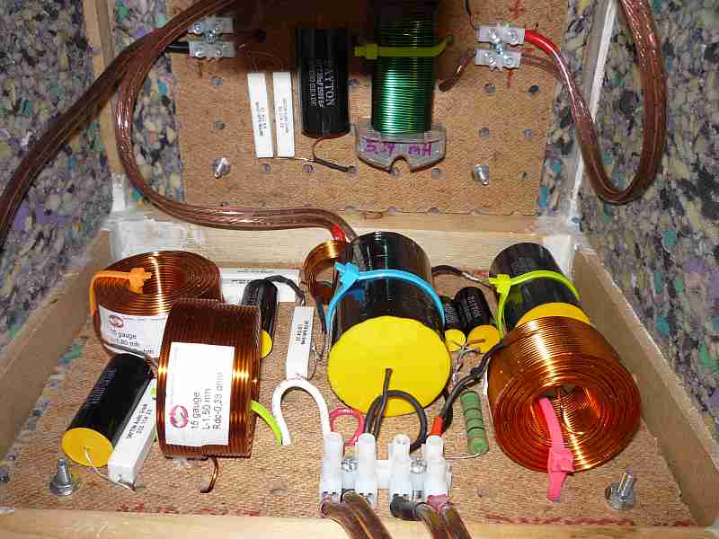

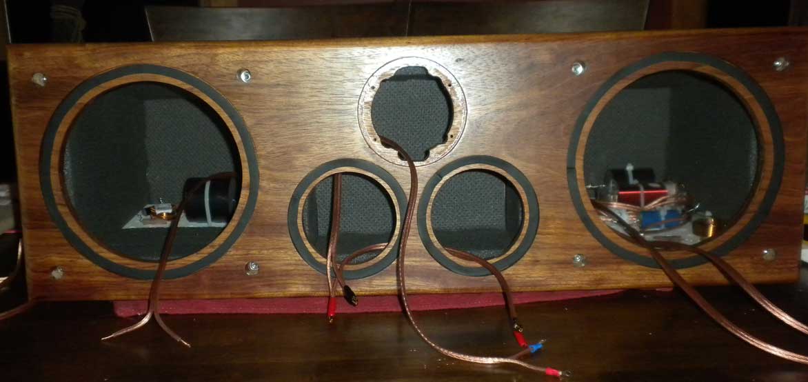

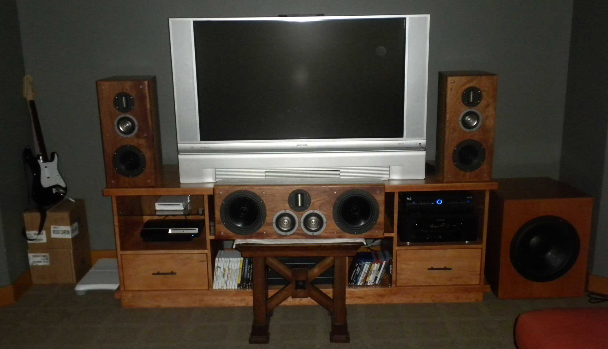

                                                              So, here they all are up and running. Hopefully the pics come out ok. I am quite pleased with the results. The pictures don't really do them justice. Had some questions on the 2RCC that I made a separate post for but I think I've got them worked out. We watched Prince of Persia last night as our first formal listening and it was great. Very crisp and clear with absolutely no undesired background noises. I've also watched parts of Terminator Salvation and Star Trek and all of the movies sounded spectacular. Finally, the dialog comes through nice and clear and isn't drowned out by all of the other noise. As good as these are for HT, where they really shine IMO is music. The music I have played so far has sounded so much better than what I'm used to it's almost hard to believe. I can now understand what everyone is talking about when they say that the music is only going to be as good as the recording. In both music and HT these are very revealing and I am hearing all sorts of effects that I haven't heard before.
                                                              There is still a few things I need to finish up. I need to redo the dampening and reposition one of the crossovers in the Monitors. I want to find black screws for the drivers. I need to make grilles for them (three kids - the youngest turns three is February). We're eventually going to get a projector/screen but until then I need to make a riser for the TV so that I can put the center up on the console. Finally, I think I am going to make a second sub to match the first and put it on the left side of the console and then move the monitors so that they are on top of each sub. Finally, as I mentioned in my '2RCC Questions' thread, I am kicking around the idea of building the sealed Statements and moving my Monitors to surround duty or to another room. Sonically, the Monitors are awesome, however, visually, the sealed Statements would sure make a, um, statement. Thanks to everyone for their help throughout this process. If anyone lives near the Columbia Gorge and wants to give them a listen just let me know.
                                                              Matt
