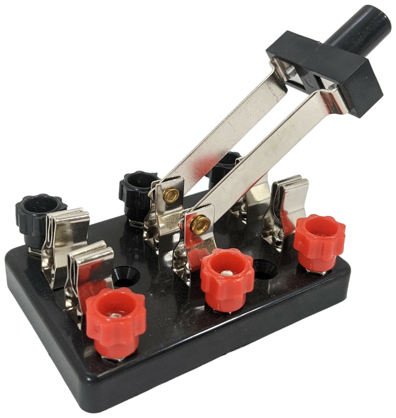

        those switches are referred to as "break-before-make" switches, so at no time does it have a complete circuit between all contacts.
        A "knife switch" is this kind.

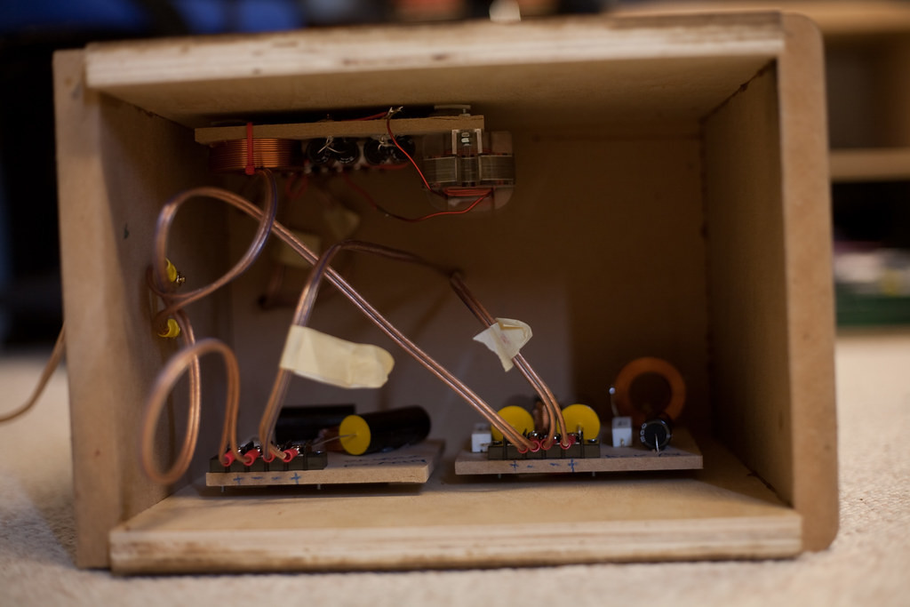

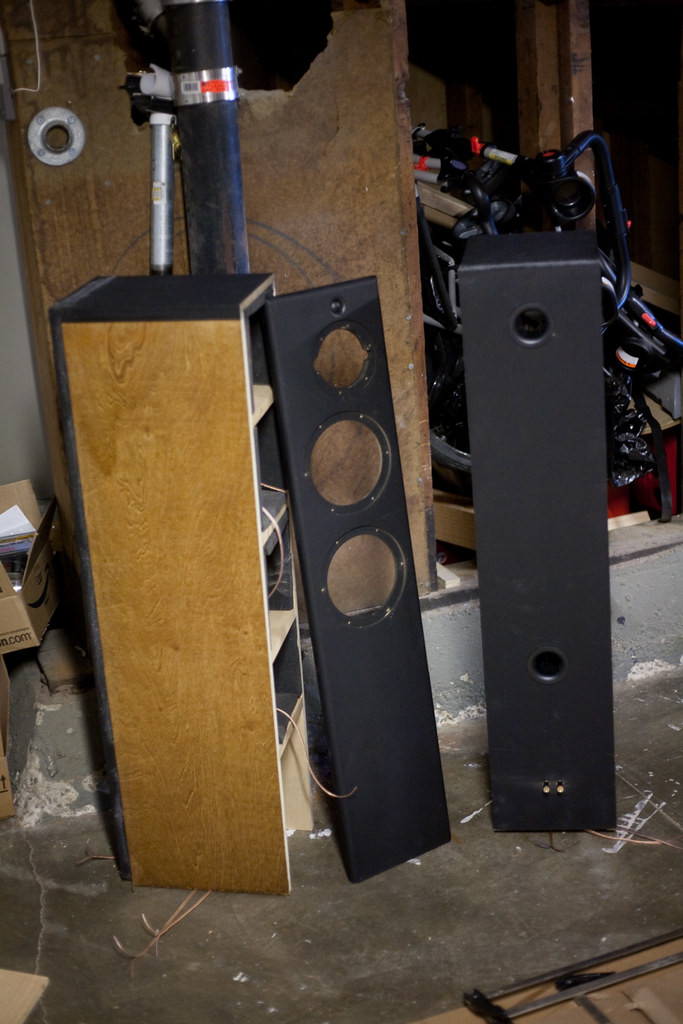

                                Well, good news is that I got the crossovers built and have glued the rear baffles on. Bad news is that I probably should have waited to paint the baffles until nearly the end.
                                You can see that I have some paper towel residue where I had to wipe some excess glue away. Not a huge deal... I may be able to brush it off, but the fibers get caught up in the textured paint pretty well. Plus, there's probably some excess wood glue helping there. I'll probably have to tape it off and do another coat to cover it up.
                                Also, I did end up taping the ports together. Seemed to work just fine.

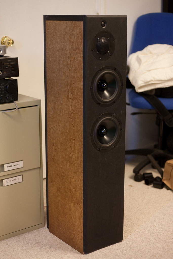

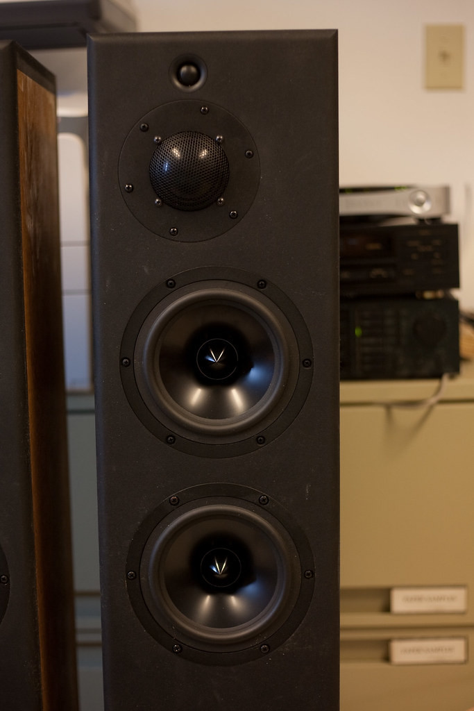

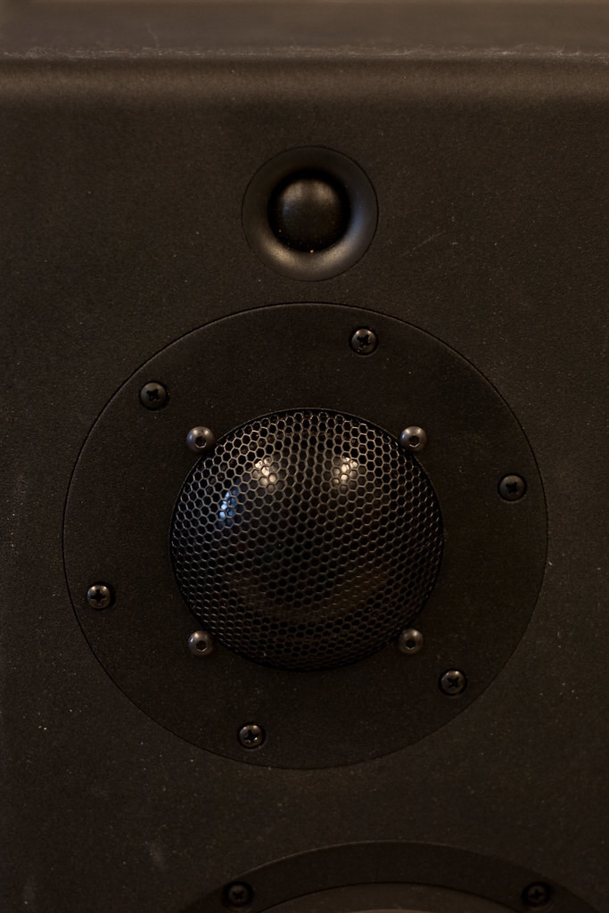

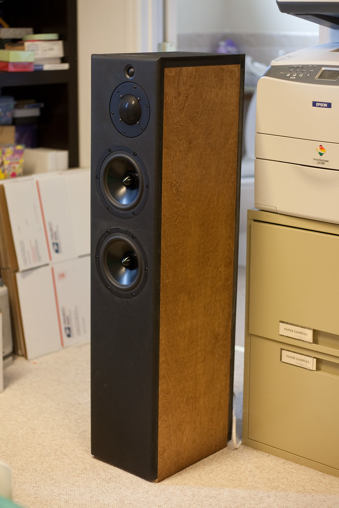

                                    They're done! Sort of.
                                    Got everything glued up and wired. I still have to fix the paint as I mentioned previously. And since taking the pictures, I've already made some little outriggers.
                                    They sound pretty darn good. I'll reserve my thoughts for a more thorough review after they break in a bit and I get a chance to listen to a bunch of stuff. But initial impressions are that the imaging is very good even at close listening distances. The crossovers seem to be doing a very good job as I can't discern any distortion or other bad behavior. And I think there's enough bass response for my needs. I have yet to try any home theater stuff, but for music, I think I'll be happy.
                                    As for build notes, I did make that one mistake with the mid recess but it's not too bad. Otherwise, I was very happy with the textured paint although I might polyurethane on top of it next time. It tends to hold on to dust and everything else pretty tenaciously.
                                    More to come. In the meantime, here are some pics.
