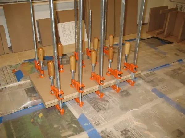

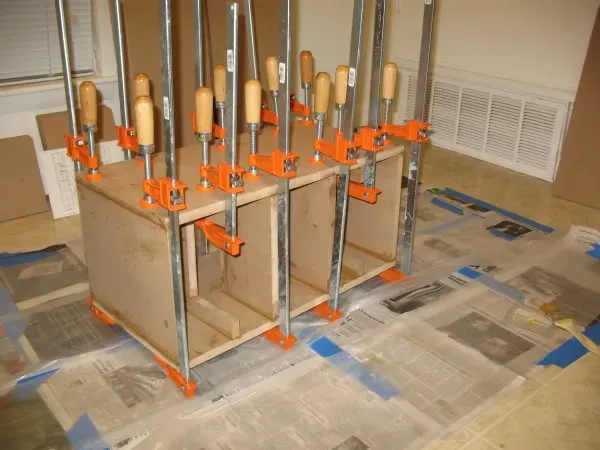

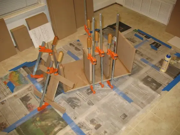

    Glueing together the side panels and the Mid enclosure:
    Click image for larger version  Name:	IMG_0348.webp Views:	1 Size:	25.0 KB ID:	942770

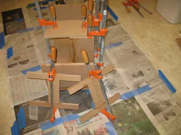

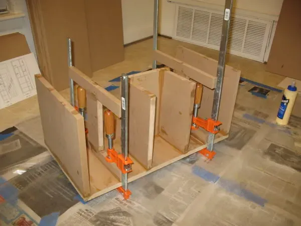

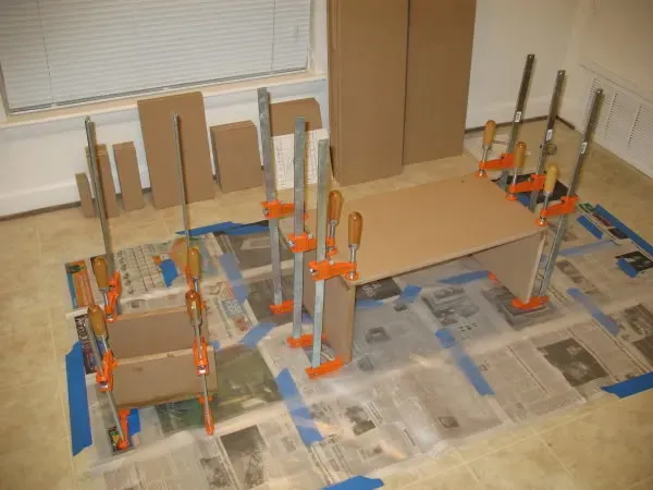

    I chose to glue the braces together rather than cutting them out with a jig saw because it's easier :P and because it results in less wasted MDF. You do have to be careful to keep the ends even when putting them together. I used the floor as an end plate to keep them aligned and it worked well. When attaching the Mid enclosure the rear wall was to far into the interior for the clamps to reach, so I used a piece of scrap MDF as a bridge and placed a clamp on either end to apply pressure.
    Click image for larger version  Name:	IMG_0349.webp Views:	1 Size:	27.1 KB ID:	942771
    Click image for larger version  Name:	IMG_0350.webp Views:	1 Size:	26.0 KB ID:	942772

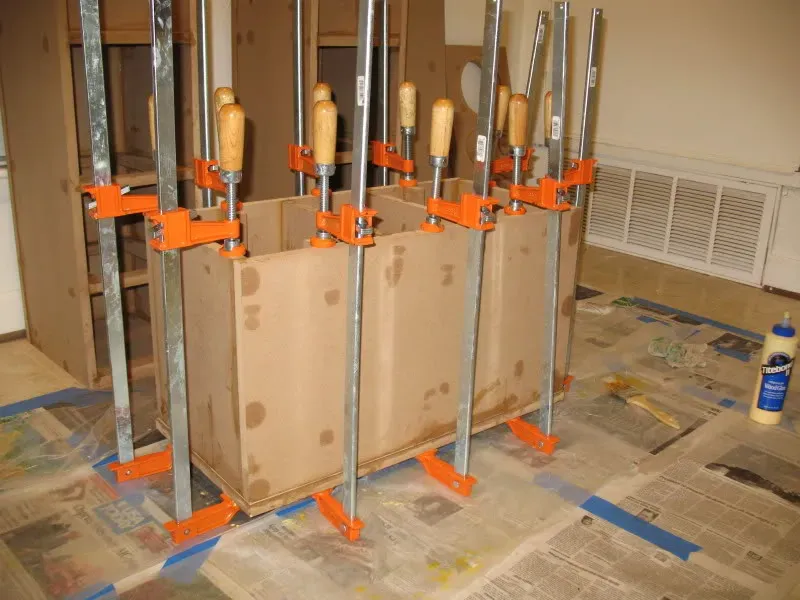

    Attaching the braces to the bottom:
    Click image for larger version  Name:	IMG_0351.webp Views:	1 Size:	22.7 KB ID:	942773

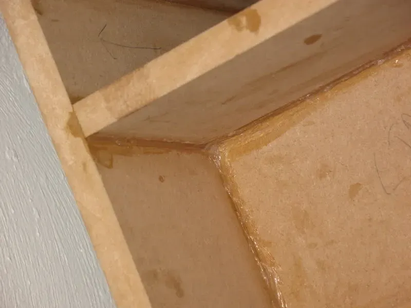

      I sealed all of the cabinet joints with silicone to help prevent leaks:

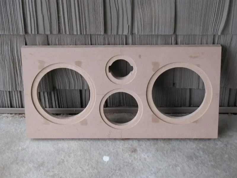

      The front baffle is all routed up and looking good. I'll be giving it a 1/2" round over after it is attached to the cabinet:

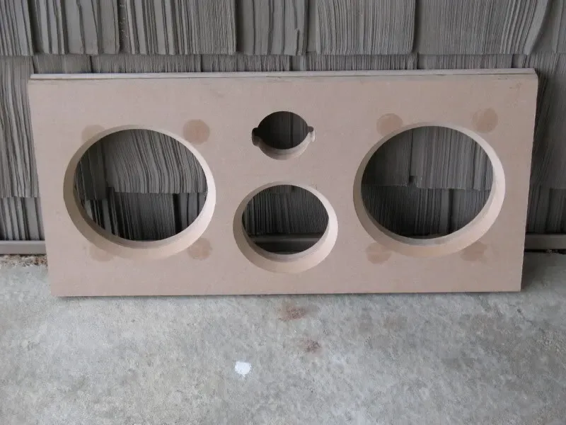

      The camfered edges for the woofers:

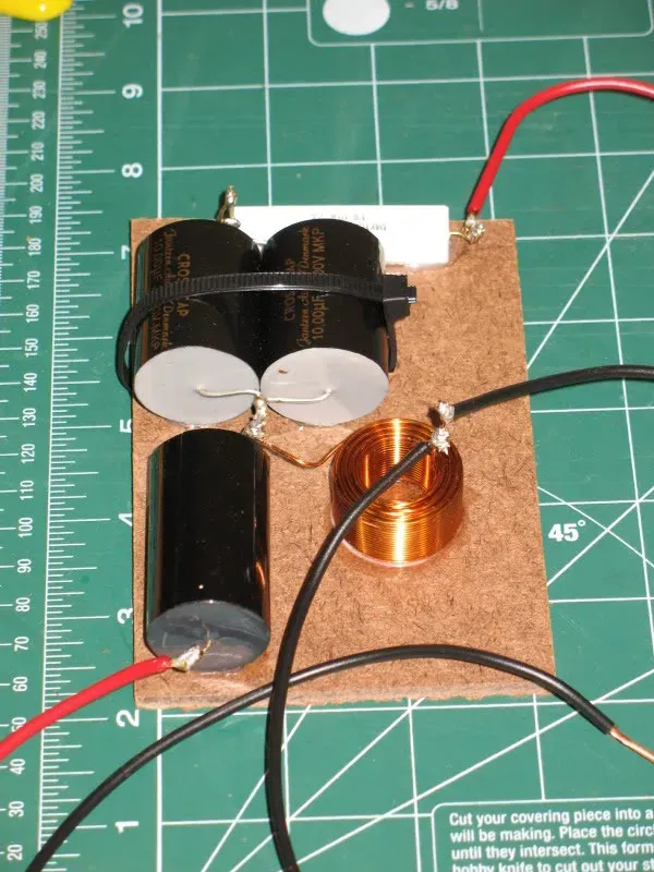

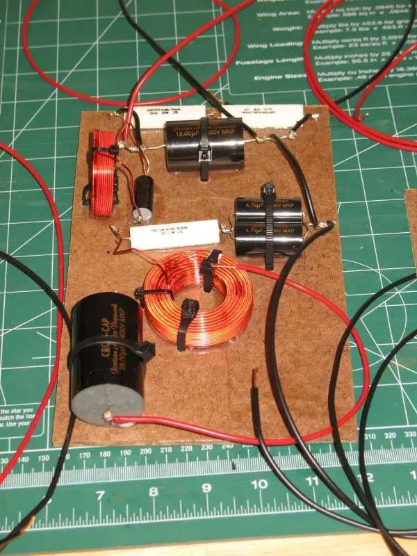

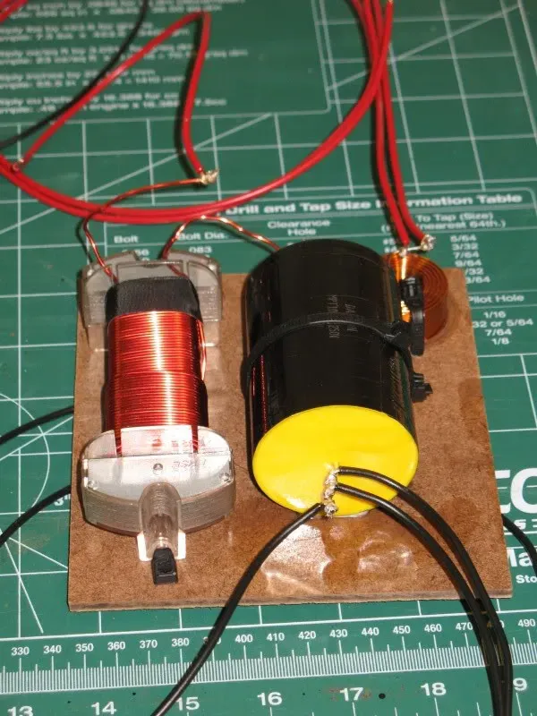

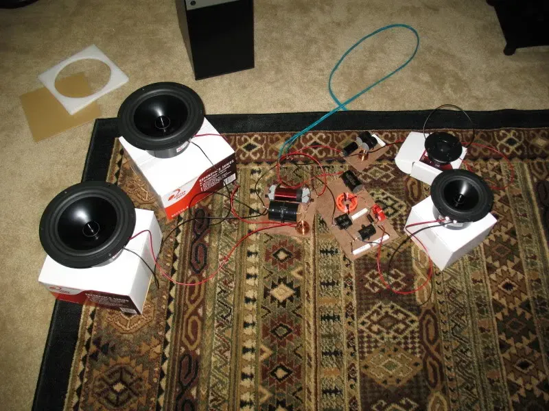

      I also managed to get all of the crossovers wired up.
      Here's the Tweeter:
      The Mid:
      The Woofer:
      All of the joints tested great with the continuity tests on my multi-tester. I also hooked them up to the drivers outside of the cabinet to make sure everything was functioning properly. My apartment didn't burn down so it seems everything works great. Out of curiosity does running them like this pose any risk to the drivers?

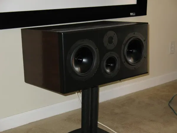

              I think I missed taking pictures of a few steps, but here it is finished and put in place in my theater.

                  Please see my Khanspire build thread for comments on the sound of this system.
                  Like the Khan's the WTMW ended up a little closer to the front wall than it is in the previous picture. This is an excellent center channel for the Khan's and I would recommend it for anyone needing a free standing center channel instead of placing the speaker above or below a TV like the khancenter is designed for.
