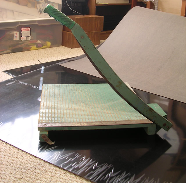

                              Switching gears back to the stands, the bases really have been a PIA throughout the project. Using this paper cutter, I was only able to get one perfect 90deg side on the black laminate base trim. So I used the Harbor Freight trim router to flush trim the bottoms, and the same router with a 45deg chamfer bit to do the edges on the back of the bases. Then the miter saw saved the day again to create a 45deg edge:
                              Click image for larger version  Name:	bases 45 deg angle trouble.jpg Views:	1104 Size:	82.7 KB ID:	854707
                              So the trouble was how to get a piece of black laminate on the 45's. I couldn't use a flush trim bit, a chamfer bit, nor the miter saw. The only option left was the LAST option I wanted: I had to cut each piece to fit perfectly WITH a 45deg edge on their edges. It took a while, and a few wrong processes, to figure out how to make them consistently and predictably. Once again the miter saw saved the day... I'm really amazed how accurate you can cut with it. Essentially the process was to sandwich a piece of laminate between two pieces of wood to prevent the laminate from chipping. I used two small ratchet clamps to hold the sandwich in place, then tightly wrapped the end close to the miter blade in tape, and then re-clamped the other end to the miter saw once the cut was lined up. One cut was made fast, and then using measuring calipers the second cut could be made. It really took a long long time to do this, but still faster than I could have painted these glossy black.
                              My dad came up with a cool way to clamp the pieces on by making a jig on the opposite end:
                              Click image for larger version  Name:	bases 45 deg mica clamped.jpg Views:	1126 Size:	79.2 KB ID:	854708
                              Here is a pic of the bases finished; I still have protection on the black laminate because it would be a bummer if something happened to it now:
                              Click image for larger version  Name:	bases done.jpg Views:	1113 Size:	42.5 KB ID:	854709
