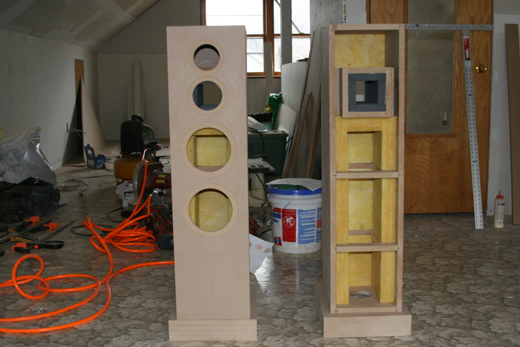

                                    I got the insulation installed today and the foam cut. I read through the minis thread and found that I should hold the 1in foam 2in back from the front baffle and then cut a 45 degree angle. Is this still what is considered the best? I have everything I need to finish except the X-Over still waiting waiting on Skip :x. I was planning on mounting the X-Over on top of the mid tunnel, you think that is a good place for it? I will post more pictures of my progress Monday if I get time.

                                      Hi Mike82,
                                      Yes, the 45 degree angle on the 1" mid foam and 2" back from the front baffle is what I'd recommend to start. I would not glue the mid foam in place until you're completely done, however. You can "tune" the mids depending on the reflectivity of your room by sliding the foam closer/further away from the back of the mid driver.
                                      Also, holding the foam/insulation back from the front baffle 2" should also be followed in the woofer compartments.
                                      I would not recommend mounting the crossover on top of the mid tunnel. The closer to the binding posts and the ability to remove the crossover after completion is important. At least the part about being able to get it out through a woofer hole after the speaker is built. "Opps!" happen and that allows you to fix the crossover if necessary.
                                      HTH

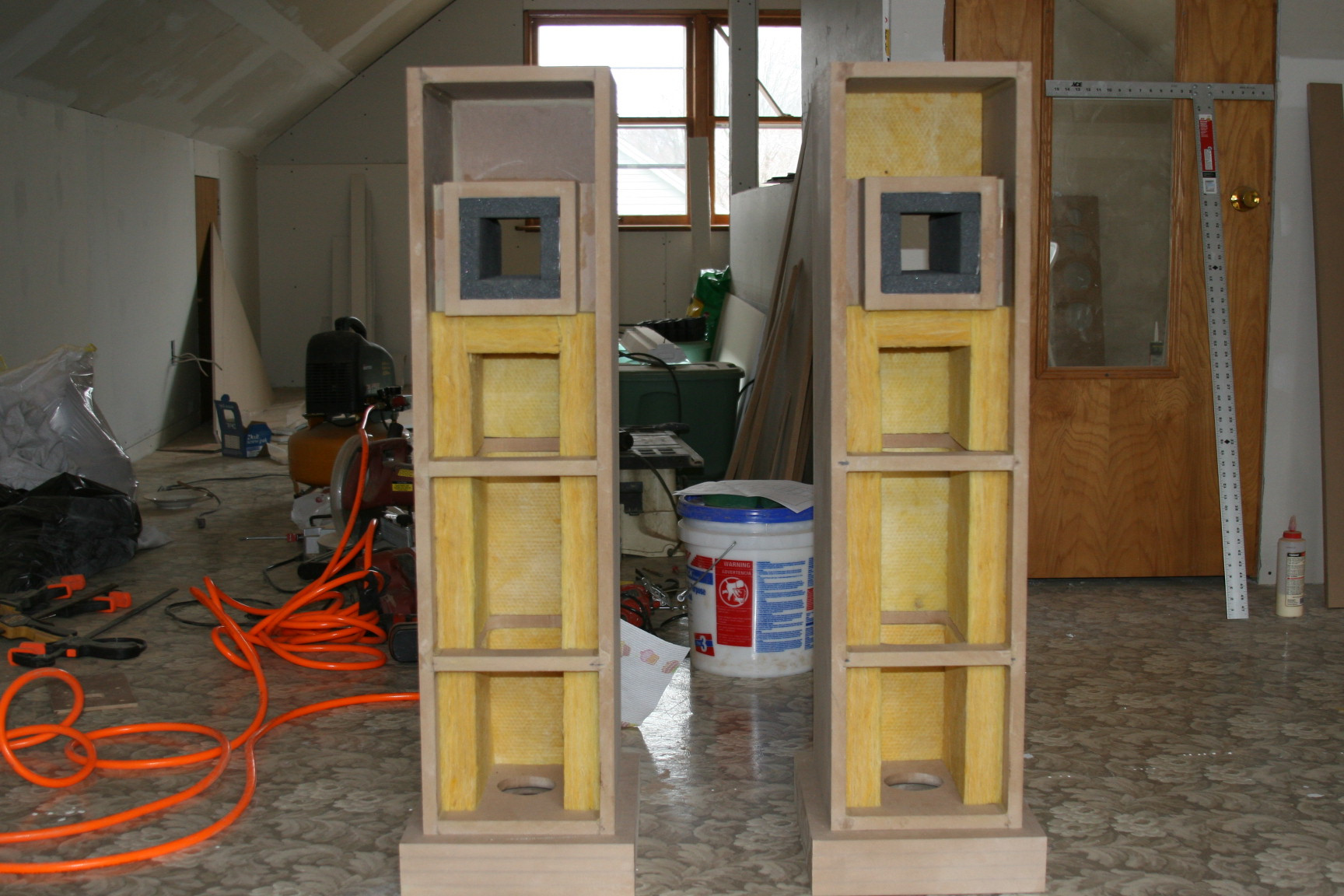

                                        Here are a couple of pictures of the insulation, seems like it takes up too much room. I held it back from the front baffle 1 1/2in. I have to trim the piece under the mid tunnel so that the top woofer dont hit it. Do you guys think it would hurt to put some in on the top I have some left over I could throw up there.
                                          Click image for larger version  Name:	3459062029_fd65920660_o.jpg Views:	0 Size:	439.1 KB ID:	952668
                                          Click image for larger version  Name:	3459876894_e7f5d43aea_o.jpg Views:	0 Size:	447.4 KB ID:	952669
                                          I think I'd recommend beveling the fiberglass at a 45 degree angle too. If it crowds the RS225's they'll have a dead sound. No rocket science, just lay it back for a smooth transition.

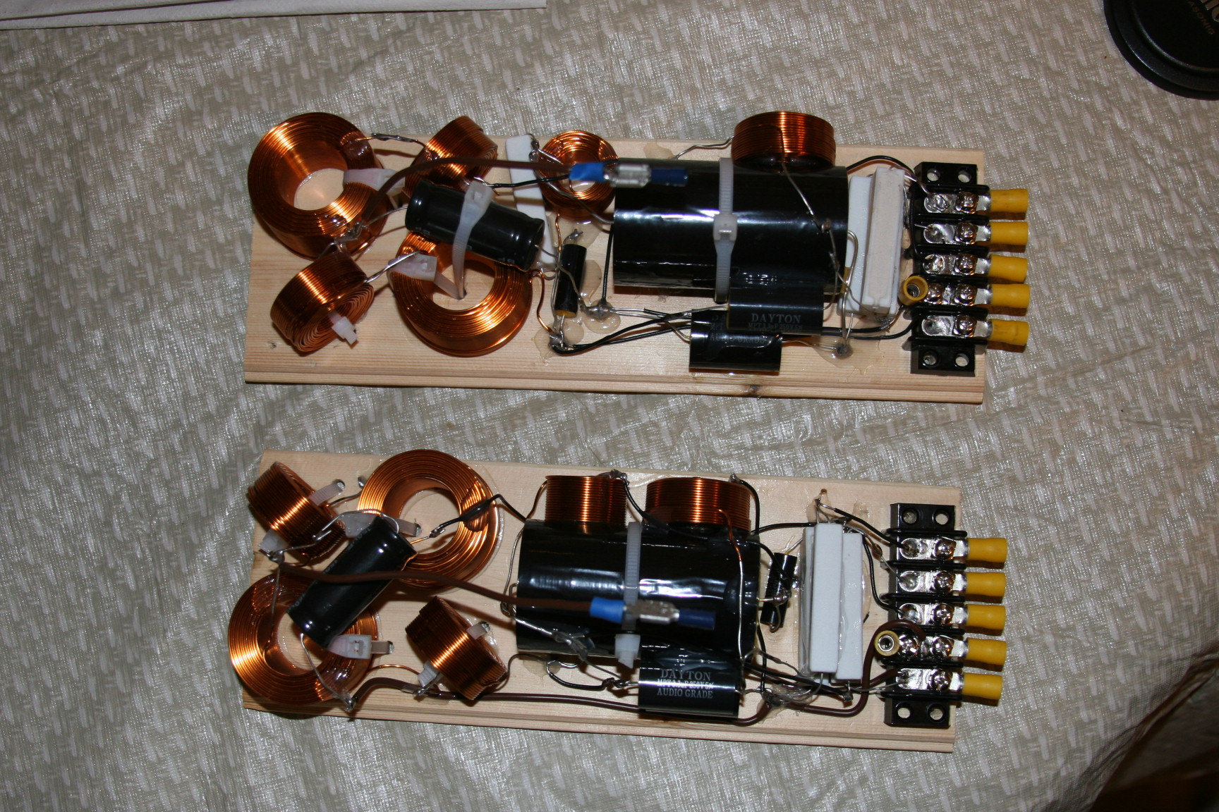

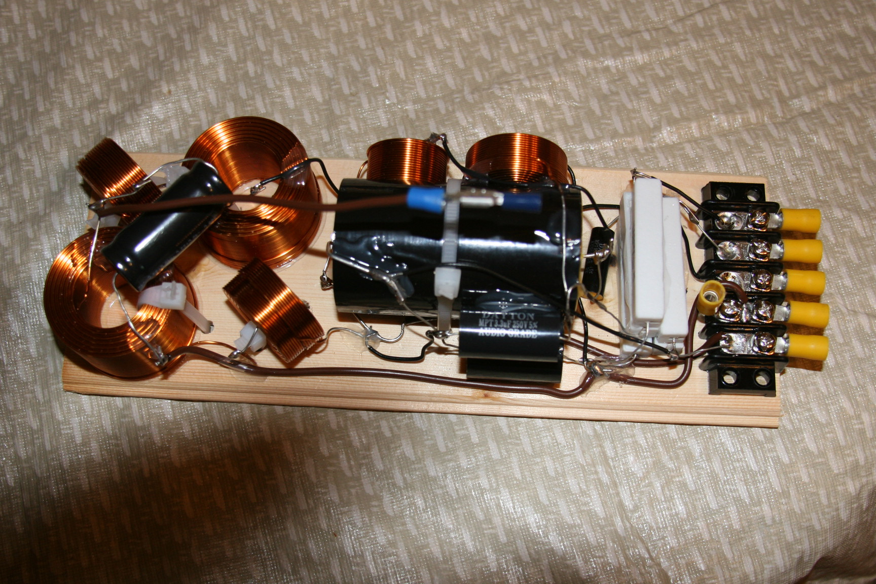

                                                    I finally got the X-Overs today only took him about a month too do lol. After doing a little research about how to lay a X-Over out and how not to get the inductors too close to each other makes me wonder if this was done right. Please take a look and let me know what you think.

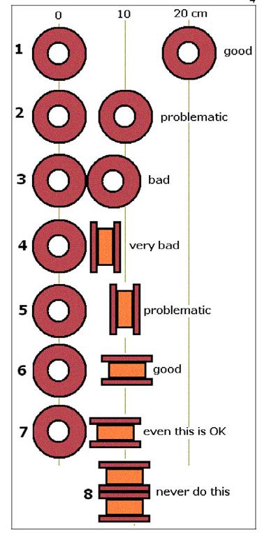

                                                      Air core are more forgiving of close proximity than iron core, but those are too crammed together ..... IMO
                                                      • savage25xtreme
                                                        • 305
                                                        technically speaking, I don't see any of the cores lined up on the same axis unless some are too close... what happened to the iron core inductors? replaced with air cores? I'm certainly no expert though. Looks like it was a royal pain to get it packed that tight though :B
                                                        Edit: I would listen to Thomas 8)
                                                        Last edited by savage25xtreme; 30 April 2009, 13:48 Thursday. Reason: Thomas beat me

                                                          How do i know for sure if the placement of the inductors is compromising accuracy is there any way to test it. Curt said I could test the DCR of the inductors with a milliohm meter but can you test the whole board anyway. I am pretty frustrated at this point I payed 55 dollars for this guy to do this right and in a timely fashion considering I dont know how. What I got was bad work which took him a month to complete after lying to me over and over again about it will be done the next day or it will be shipped the next day :M . And after all that getting jerked around it is done sloppy. He still wont tell me what he used to replace the 4.7 mH 18 gauge Dayton inductor with. All I can say is this guy is lucky he lives 500 miles from me.
                                                            Inductor Chart..
                                                            Here's the inductor chart I go by. Get your ruler out and do a little measuring. If you're close, it'll be OK.
                                                            Reposition the ones that could be an issue and you'll be good to go. It looks like the extra money your builder suggested you spend bought Jantzen air cores to replace the Dayton steel core inductors. Curt can comment on the effect of the different DCR.

                                                              Disregard parts of my PM regarding this crossover, as I forgot I spec'd a cored inductor for the woofers. ops:
                                                              From looking at the pics, I'd guess a 2.7 mH and a 2.0 mH was substituted to make up the 4.7 mH, and it looks like 18gauge inductors were used. The DCR will be significantly higher, and in this instance is an unnacceptable substitution, regardless of the less than optimal component layout.
                                                              I sent you a PM with resolution suggestions.

                                                                Not seeing Curt's PM recommendations, I'd add that you should position the resistors with a little space in between, so they can dissipate some heat. Not a lot of space, but not stacked on top of each other as they currently are.
