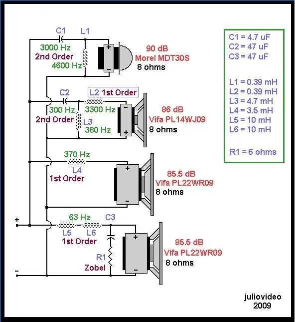

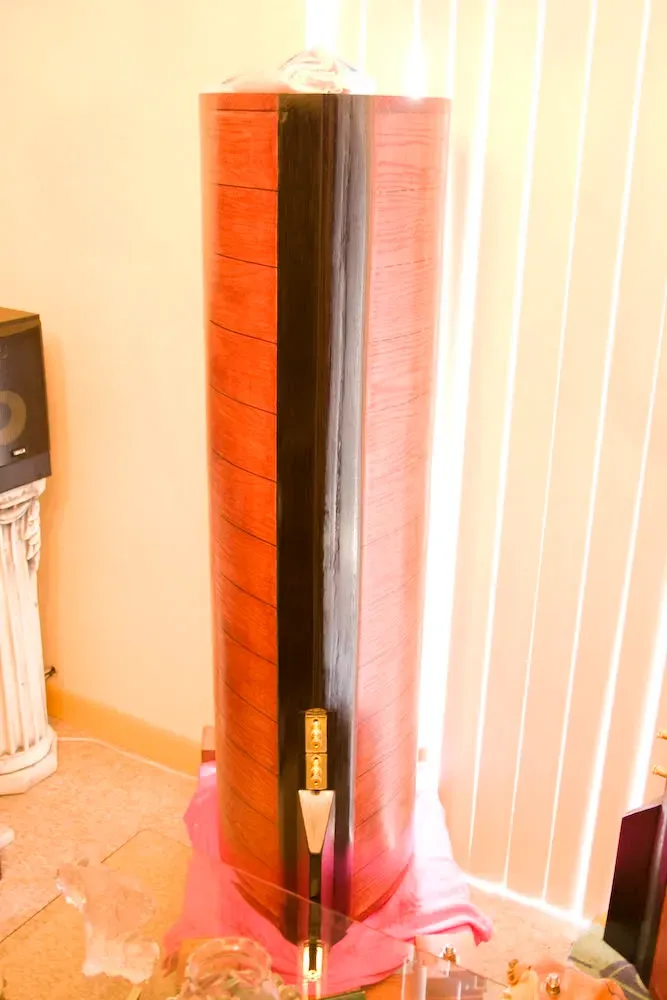

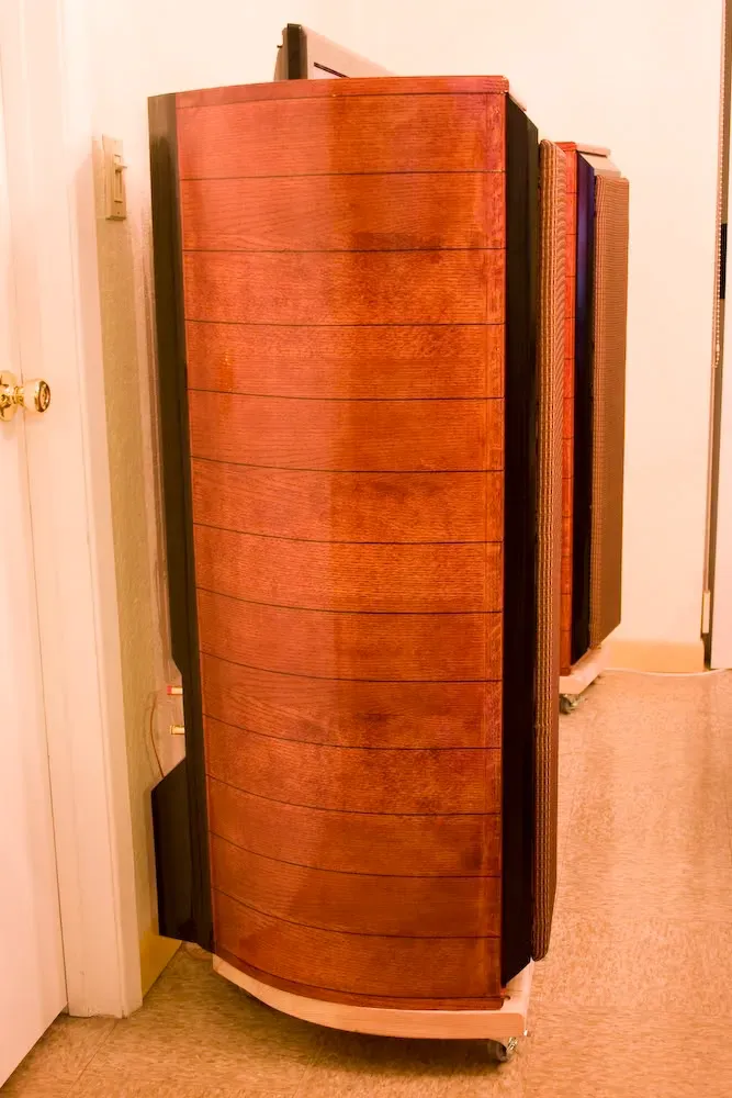

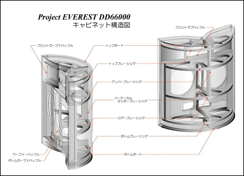

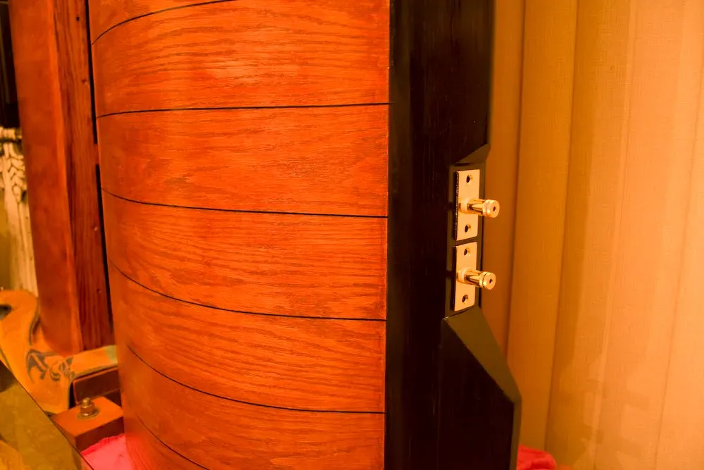

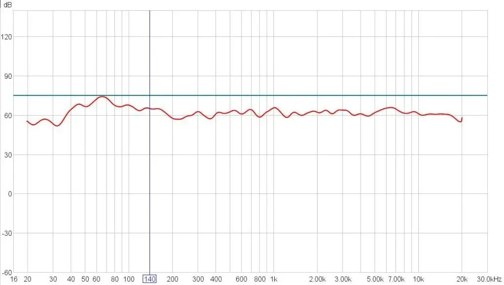

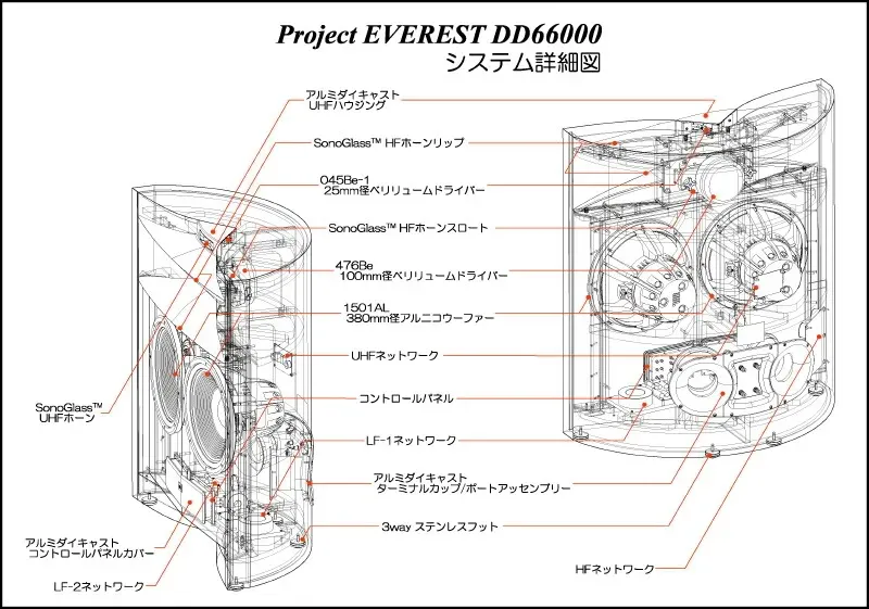

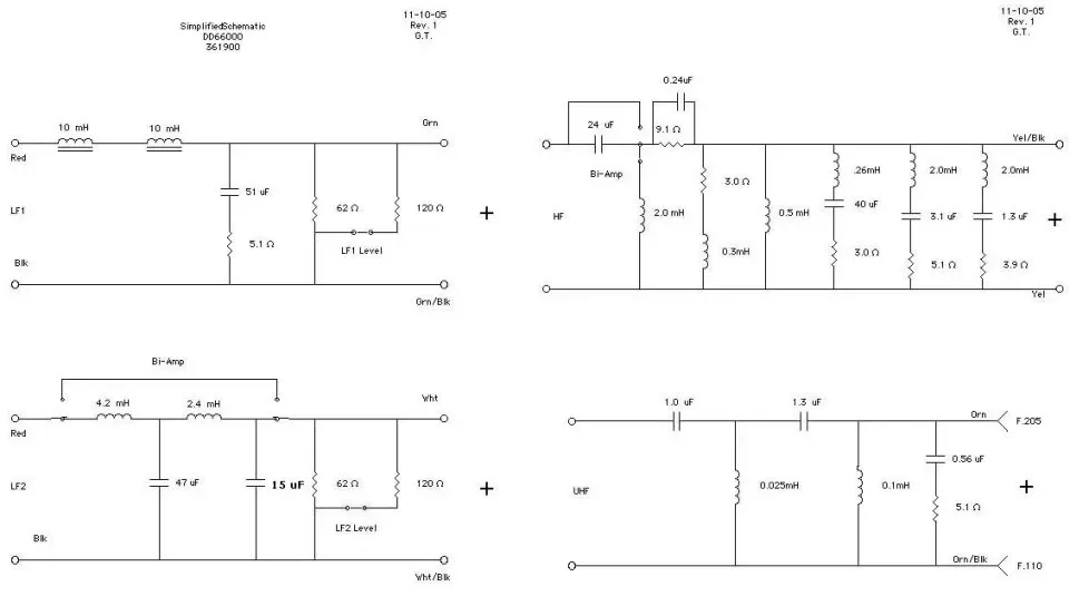

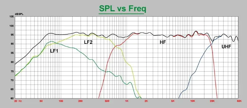

        It is possible to conect two woofer and to have 8 ohms. ! :T .........not parallel,not series.
        Maybe my design is not the best in the world but it works ;I will bring the measurement it in the future and post it here.
        Inspired by the design from JBL Everest DD66000 ,I was able to do something like it.
        Project JBL Everest DD66000
        :yesnod:

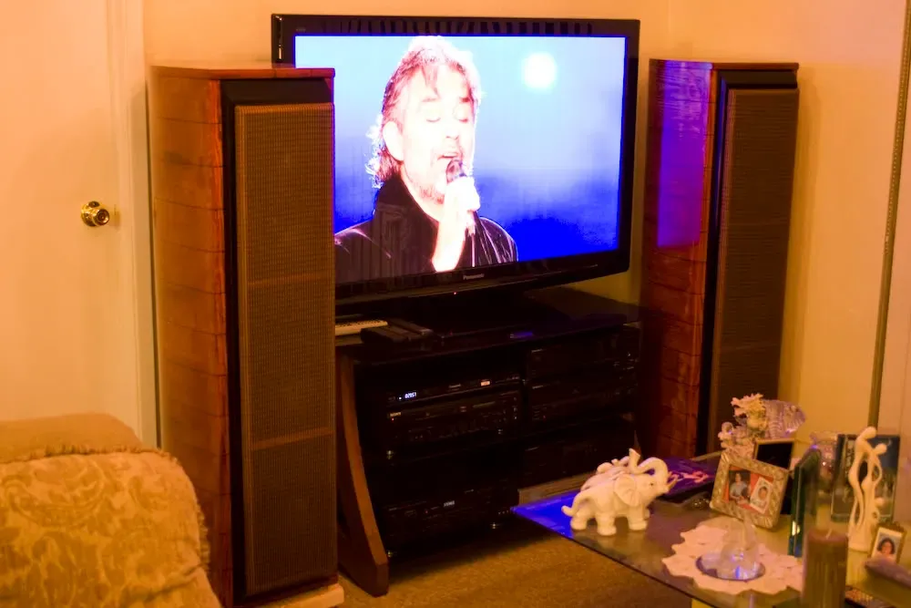

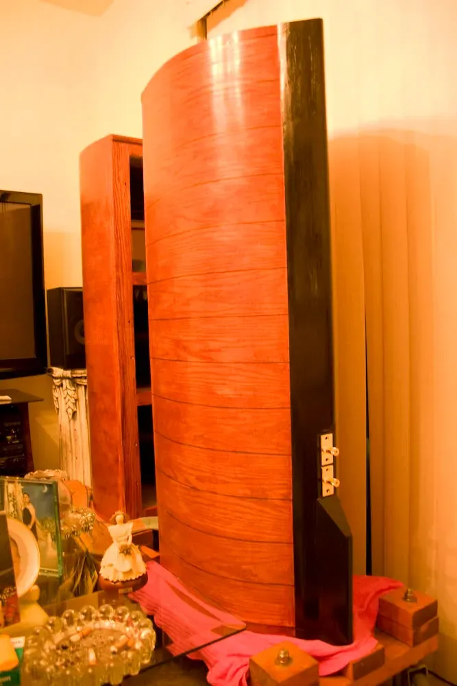

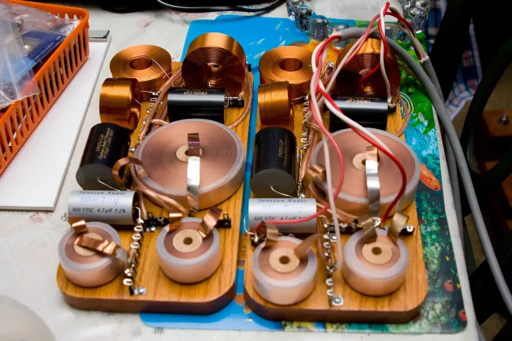

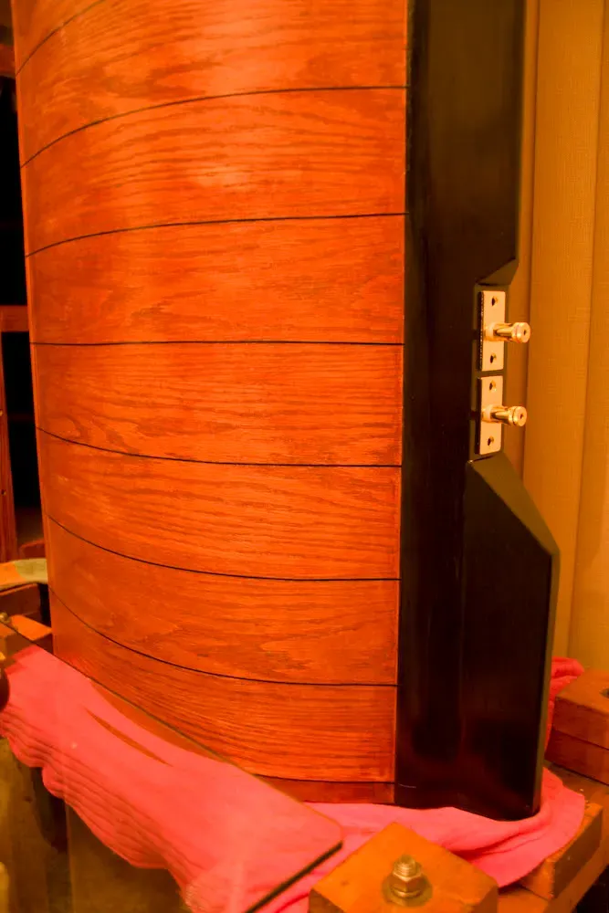

          Update friends !!

          http://www.diyaudio.com/forums/multi...amati-diy.html

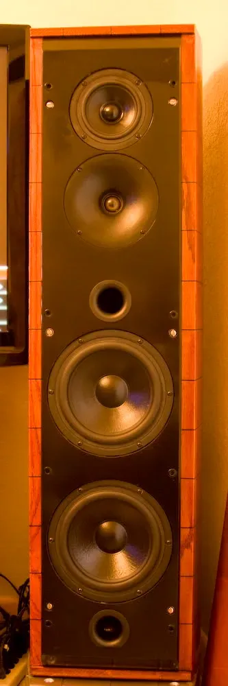

            Hey Julio,
            Way to go with the speaker. Very, very nice!!! :T

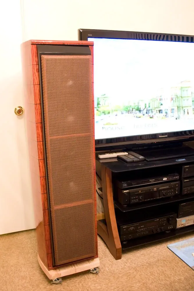

            Can we see them without the grills on. It looks like you have more drivers than your schematic would indicate. But, not sure with the grills on.
            Glad you came back and posted your design.
            John
            Edit: Okay, I had time to go check out the links you posted and I see you used a waveguide on the tweeter. Looked a midrange behind the cloth.

              Thanks John !! :T here the picture..................
