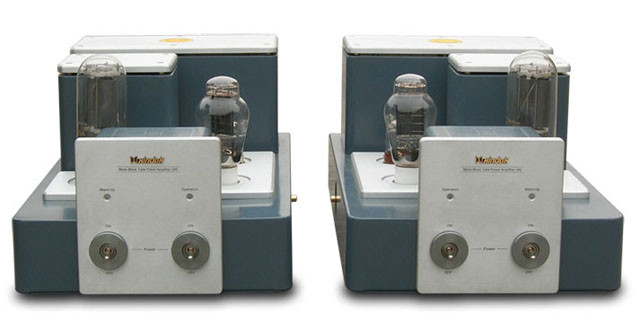

    Thanks, interesting amplifier ,.........I have been watching this site for some time and are good things.
    ...................and I also like this amplifier,but the problem is that I've seen in 220 volts. 8O
    XINDAK - V60 Mono Block Tube Power Amplifier
    .........or.................
    XINDAK - XA8800MNE Mono Power Amplifier
    Link to retail site removed by moderator.

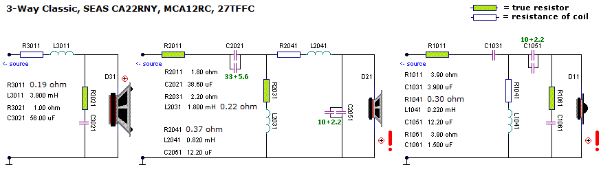

                      He does have a crossover design for the drivers, it's in this post:
                      Hi ,I'm a newbie......................and I pulled on an adventure to built the Sonus Faber Diy . 8O http://www.hifi-notes.com/sonusfaberamatifabrikage-nl.htm http://www.sonusfaber.com/eng/index.html Here are some DIY photos of my creation at my apartment in Florida. :T materials. Oak wood MDF 48" H x 12"
                      It's from the 3W Classic kit on this page:
                      So, if Julio decides on this design, he's got a crossover design for it. I think Julio might have misunderstood you. The active part of the crossover for the subwoofer is a fairly trivial matter - many options for that.
                        The same speakers with a different design (DIY Sonus faber "Stradivari Homage" ) http://www.sonusfaber.com/eng/home.html
                        ............. and using alternative Midrange 5.5" and tweeters

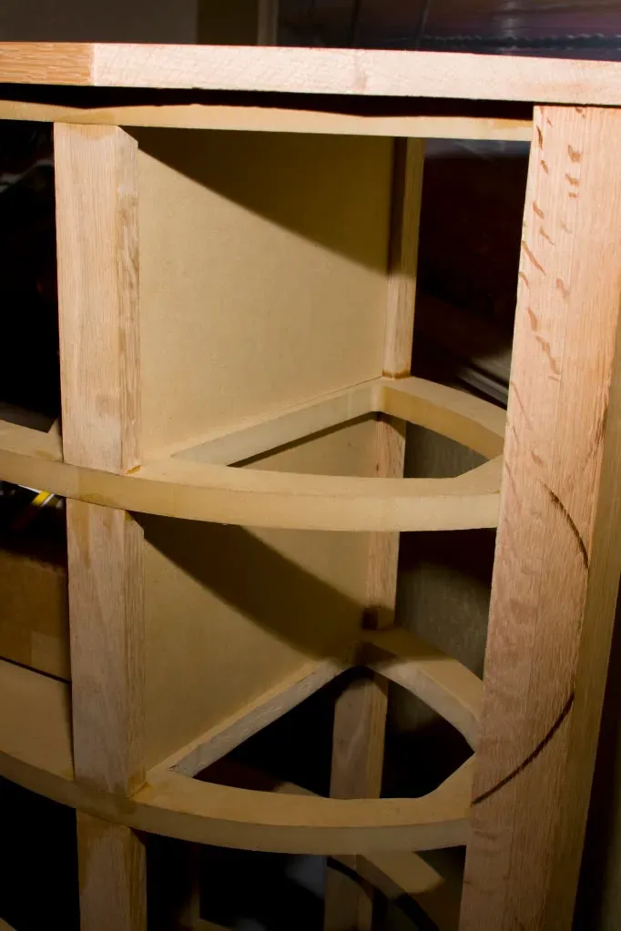

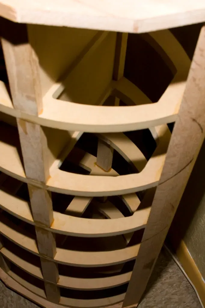

                                These are measures of the inside for the two woofers, ..................Some experts help me to calculate the total area?
                                thanks

                                  Julio, here it is. :T The total approximated volume for the woofers.
                                  I just estimated the area with rectangles that I thought came close to your specifications. I then calculated the area by adding up the different areas A. - F1,2. Area F1+F2 combine to form a rectangle which is easy to find the area of it. Below are the individual areas I calculated in Square Feet.
                                  I suggest you double check my work, just to be sure - I won't be held responsible for a mistake.
                                  To get the individual areas first convert the lengths from inches to feet.
                                  Example: Area F1,2 = (4"/12") X (6.75"/12") = 0.1875 Cubic Feet
                                  Then just add up all the areas. This gives you a total cross-sectional area of the exclosure. To get the volume just multiply this area by the height (28.75"/12" = 2.40 Feet).
                                  Total Woofer Enclosure Volume = 3.1 Cubic Feet or 88 Liters.
                                  You'll also need to section off part of the midrange enclosure since it's too big. Then you can use the left over volume for the woofers. I think you'll be able to add a 10" or a 12" sub in there with that extra volume left over from the top section of the speaker. But you'll need to make a hole in that divider between the woofer section and top section of the enclosure - just in the area outside of where the midrage enclosure is sectioned off. I think the midrange enclosure is 2 liters (as I remember - check that). Also 28.32 Liters = 1 Cubic Foot.
                                  Have you decided to do a W3 Classic with a Subwoofer? No rush ... if you want to check the internet for other designs. Although, I kind of doubt you'll do better than this for your enclosure, but I haven't looked either.

                                    I can say, with all these calculations ..........thanks my friend !
                                    You know John, I have a few days ago the cabinet ready to put the side panels, but sixth sense told me to wait ! .
                                    Now your talking to me to increase the capacity up to improve the volume of the woofers,I can do yet, and I can take 2 hours to complete.

                                              thanks John ,Increase the capacity ..............

                                              About Midrange of the enclosure is almost 2 Cubic Foot,I think that this area is very well for midrange.
                                              What do you think of the new area, it's fantastic ?

                                                Yes, very fantastic! :T I hope you haven't glued those boards in yet ... it doesn't look like it. If so, it won't be difficult to fix. Very nice work though!
                                                I noticed on the "3W Classic" web page he used a pre-made plasitic enclosure for the midrange driver:
                                                "When ordering the drivers I included a ready-made enclosure for the small MCA12 drivers. I never used these plastic containers before, but it appears to do better than expected - and it saves an awful lot of time. The mid cab is lightly stuffed with MDM3 from Monacor."
                                                It's not included in the kit though - does anyone know where you can buy these midrange enclosures?
                                                But, you can build a small midrange enclosure if necessary. And use the rest of the volume for the woofers, which you'll need with a 12" RSS315.
                                                Also, you need to keep the driver layout exactly like he designed the W3 Classic.
                                                One problem is that the midrange is 200mm ( 7.87 inches) from the top of the speaker. So the second brace blocks the midrange, but you could cut out part of the front brace for the midrange enclosure. Or buy a midrange enclosure.
                                                The 8" woofer can be mounted a just below second brace, since it's position is not as critical as the tweeter and midrange. I think we might get rid of the port and make it sealed. Then you can crossover to the Sub at 60Hz with a second order filter.
                                                The other option would be to add a small passive 2nd order filter that connects to the amp. I can show you how to build it. It's easier than putting a speaker crossover together. Then you use a 4th order crossover with the subwoofer.

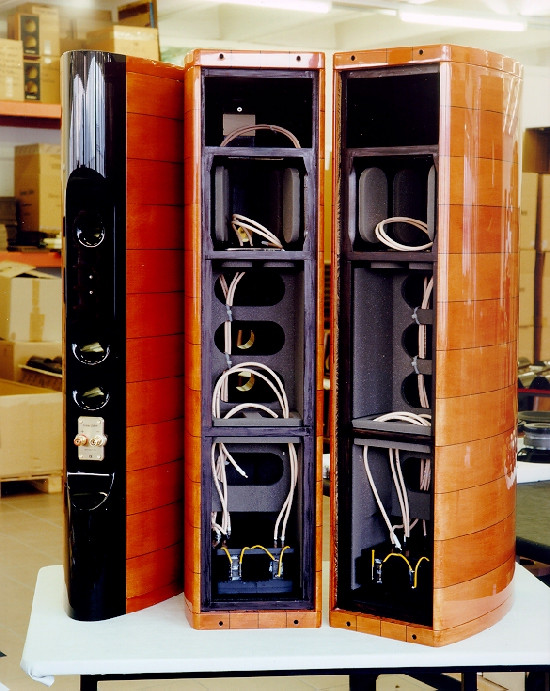

                                                  This is a DIY from Spain, the thread it has 20 pages.......enjoy !!
                                                  DIY Sonus Faber Cremona
                                                  Translated to English http://translate.google.com/translat...hl=en&ie=UTF-8
                                                  spanish http://www.mundohi-fi.com/portal/ind...b&tid=8&pid=13

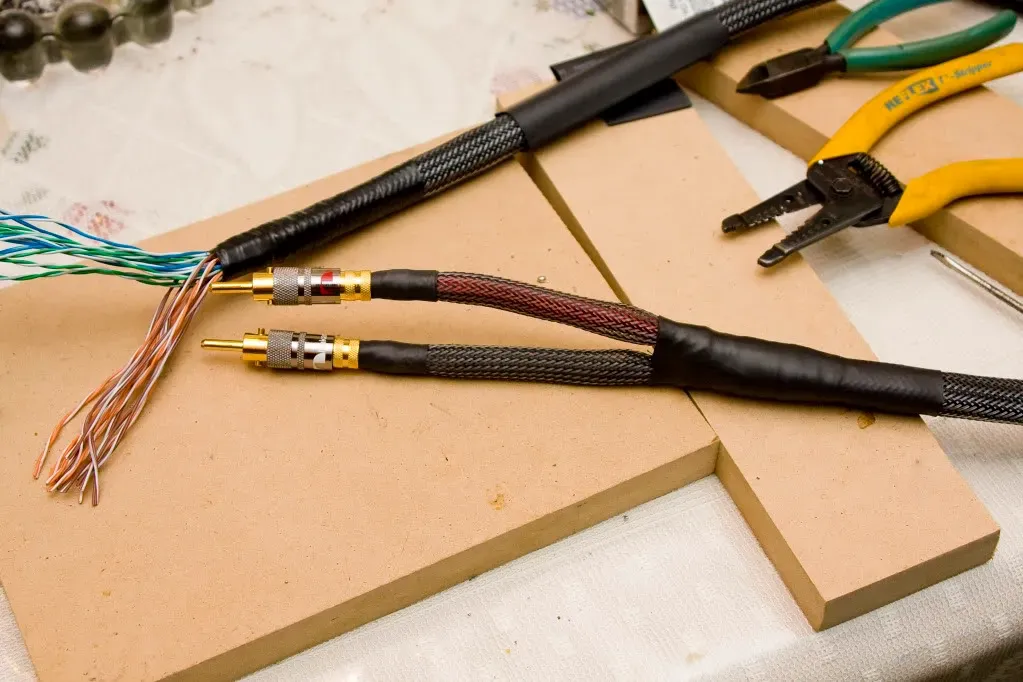

                                                                                      • juliovideo
                                                                                        • 63
                                                                                        My DIY cables :dancenana:
                                                                                        ;b>
                                                                                        Parts
                                                                                        WBT 0800 Silver Solder 4% Silver
                                                                                        Belden RJ45 CAT-5e Crossover Cable
                                                                                        http://cgi.ebay.com/ws/eBayISAPI.dll?ViewItem&ssPageName=STRK:MEWNX:IT&it em=270323593127#ht_2140wt_1165
                                                                                        EXPANDABLE SLEEVING
                                                                                        Nakamichi Speaker AMP Lock In Banana Plug 24K
                                                                                        http://cgi.ebay.com/ws/eBayISAPI.dll?ViewItem&ssPageName=STRK:MEWAX:IT&it em=180331933618#ht_921wt_1165
                                                                                        .................... Home Depot 3M tape (black and red) and Heat Shrink Tubing.
                                                                                        Last edited by theSven; 21 June 2023, 09:30 Wednesday. Reason: Update image location
                                                                                        "Liberty is the right of every man to be honest, to think and to speak without hypocrisy.."
                                                                                        José Martí (1853 to 1895)
