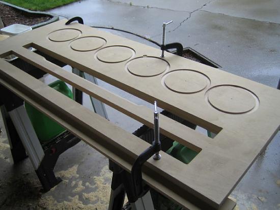

            I don't blame you Hank, if I hadn't already jumped into this project I might follow your foot steps.
            Here's what I got so far. The thin board is just there for support. I plan on cutting the holes ASAP, then doing the round over work, and putting on the walnut veneer. I made a few errors I need to cover up.
            I'm new to real wood working for the most part, and haven't done much, and never used a rooter before. My sound sensitivity issues slow me down as well. Then the weather hasn't helped much. Excuses, excuses, .....
            Click image for larger version  Name:	baffle_work.jpg Views:	1170 Size:	79.4 KB ID:	854809
            Slow and steady gets it done, John... the slow will seem inevitable some days, but as long as YOU remain steady, it will get done. :B

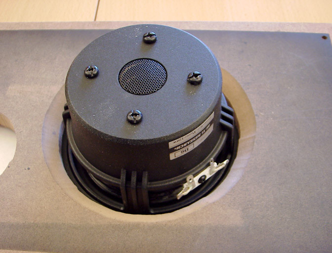

                Not Chuck, but hopefully I can help keep you moving...
                I start with a 3/4" chamfer (you don't have to plunge it all the way down, depending on the thickness. I don't take more than 1/2 the total thickness. I've also used and Ogee bit after the chamfer to open it up more and also a hand rasp. Now that I've done a few speakers, I just lay hands on the baffle and wait until it tells me what it needs.
                This is from Jon's Modula MT:
                Just get something that looks like that. It will vary based on the driver and the thickness of the baffle.

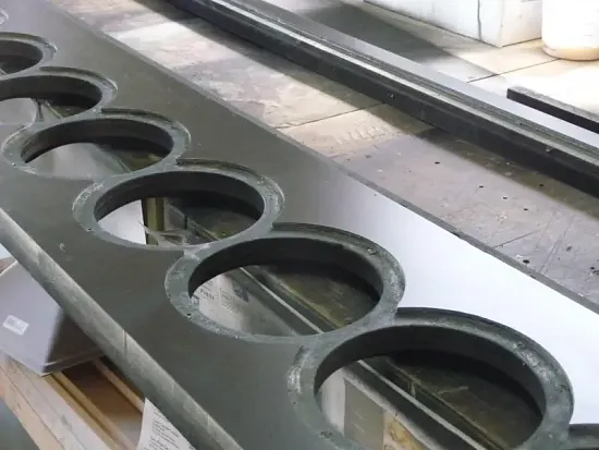

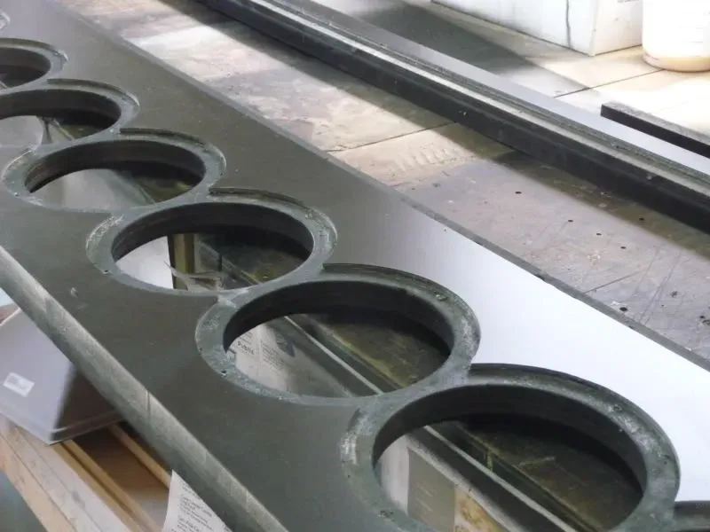

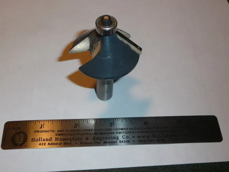

                    #504

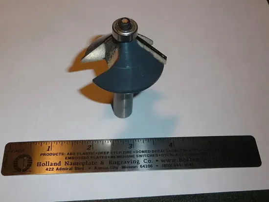

                    Chuck, just wondering what size chamfer bit you used on the back of the woofer cutouts?
                    John
                    Hi John
                    A little late but here is a picture of the bit I use to relieve the back of the cutout.
                    It has a 45 degree angle, measures 1 inch from top to bottom (cutting surface) and 1.875 inches in width. It has a 1/2" shank. It is called a 'chamfer' bit available at MLCS Club Denon
                    Discover MLCS woodworking tools trusted by professionals and hobbyists alike. Shop precision routers, saw blades, jigs, clamps, and accessories built for durability, accuracy, and reliable performance.

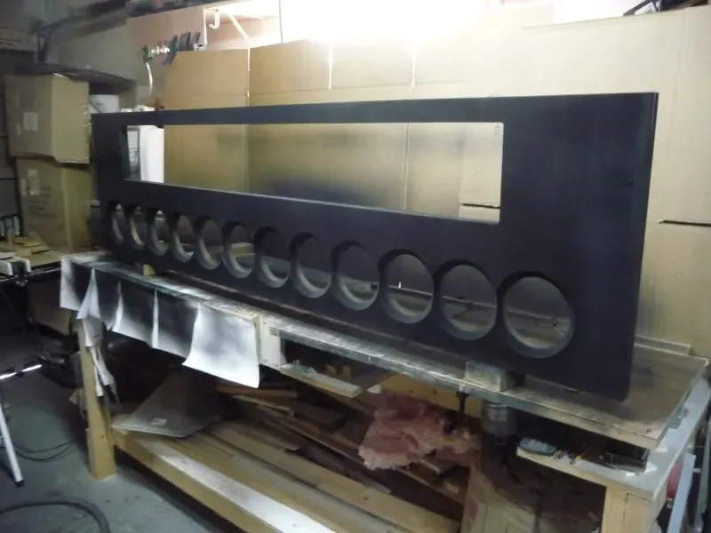

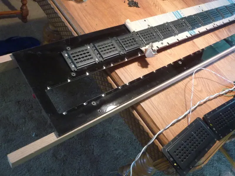

                          • chasw98
                            • 1360
                            #508
                            It's now been almost 2 hours, where's the update.
                            Be careful what you wish for :T
                            After more than a year in the making, finally peeling the protective paper from the plexiglass that holds the planar elements...
                            What else can you do while paint dries?

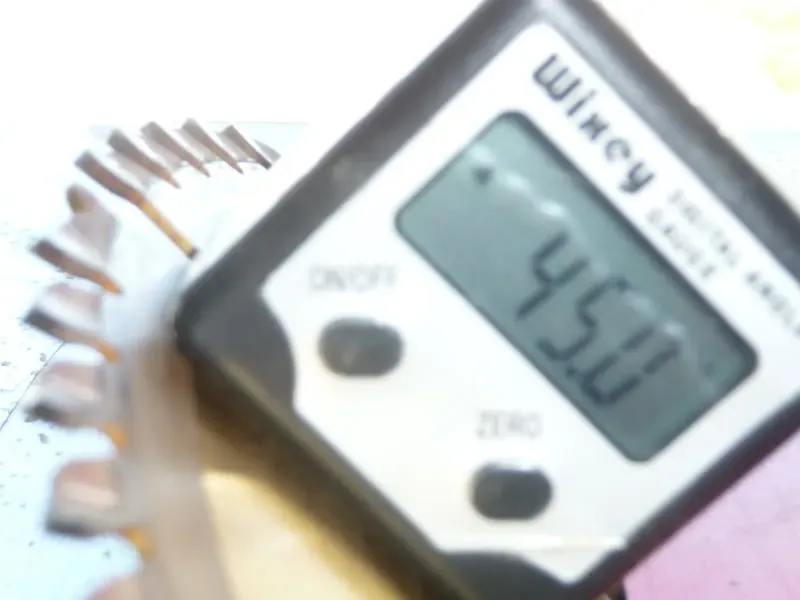

                                        For all you toolhounds (Ryan & jonmarsh), this is how you set your blade at 45. Oh, and there is a picture of the formica on the array and routed out.

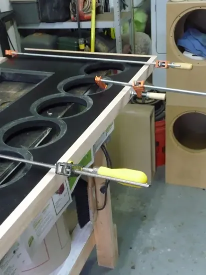

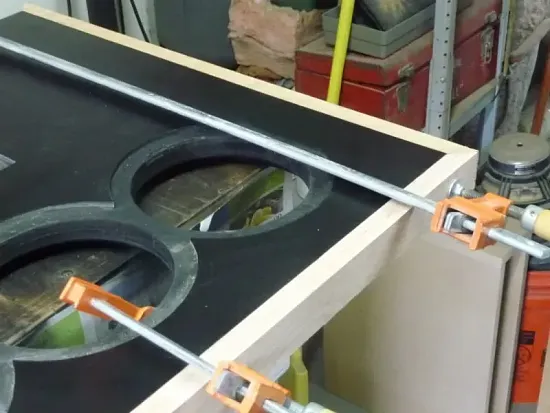

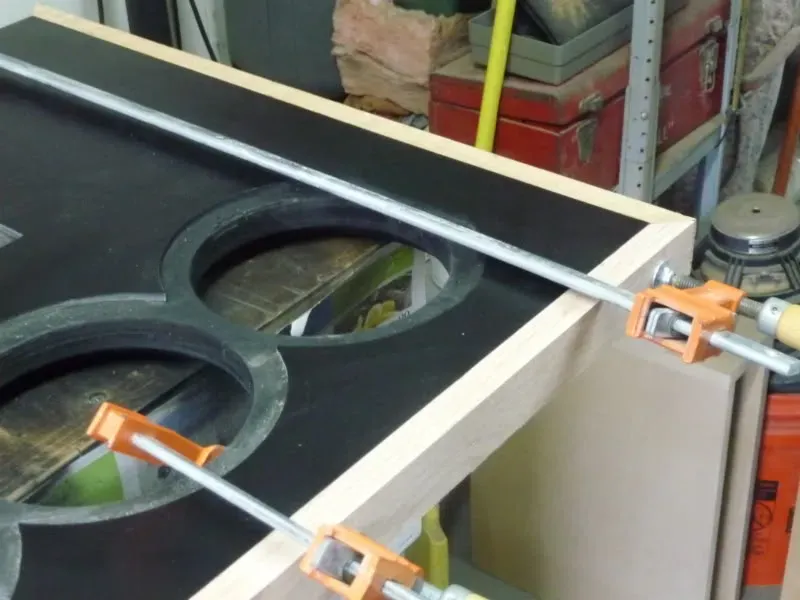

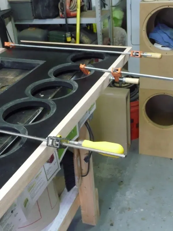

                                                And here are some pictures of the oak trim being applied and, of course, being held in place with a bunch of CLAMPS! No project is complete without clamps!

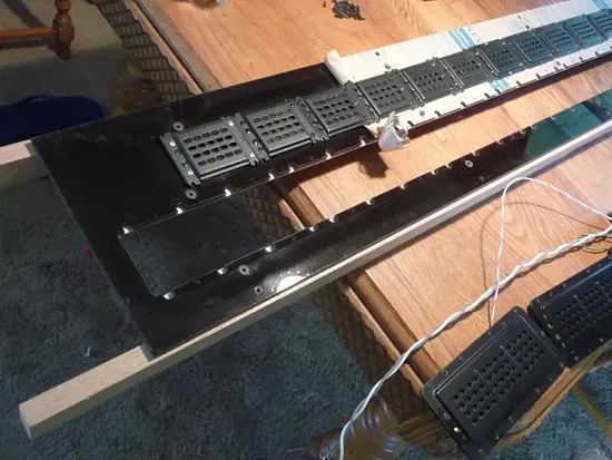

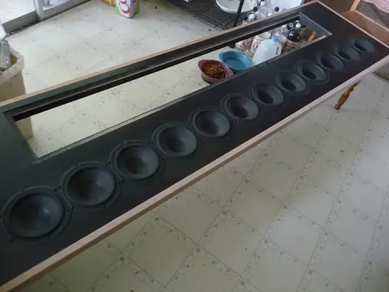

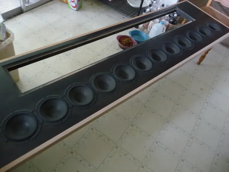

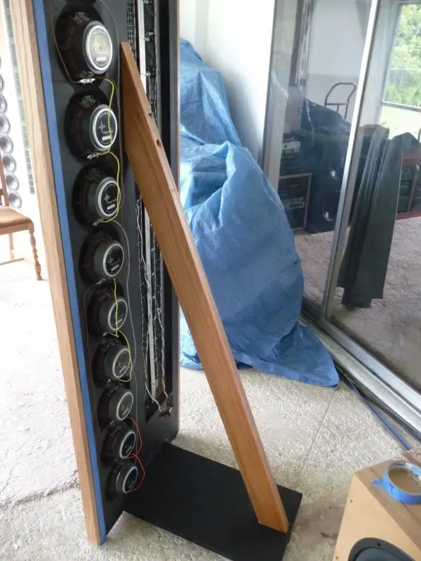

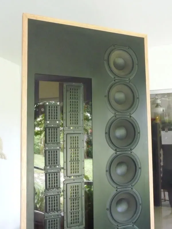

                                                      And so it goes. The woofers are mounted and wired. I have "refitted" the plexiglass array so that it is a nice snug fit in its cutout and I am reassembling.

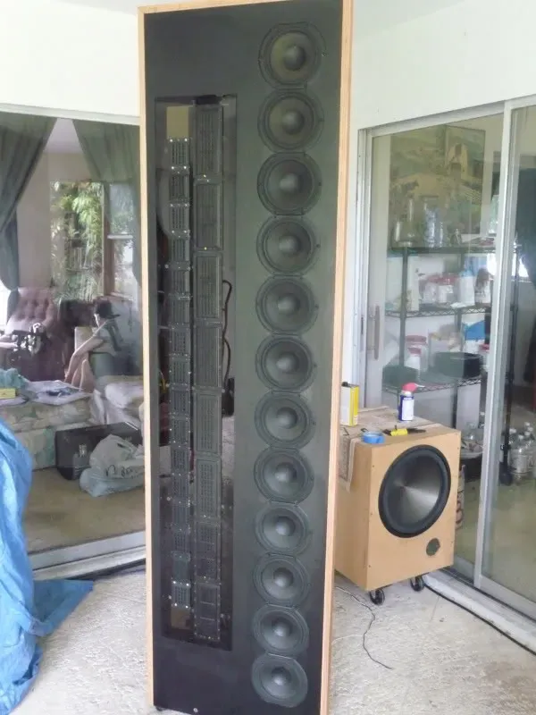

                                                          It's getting there. Here is the first one asembled and ready to make music. Paint still drying, oil still curing, though.

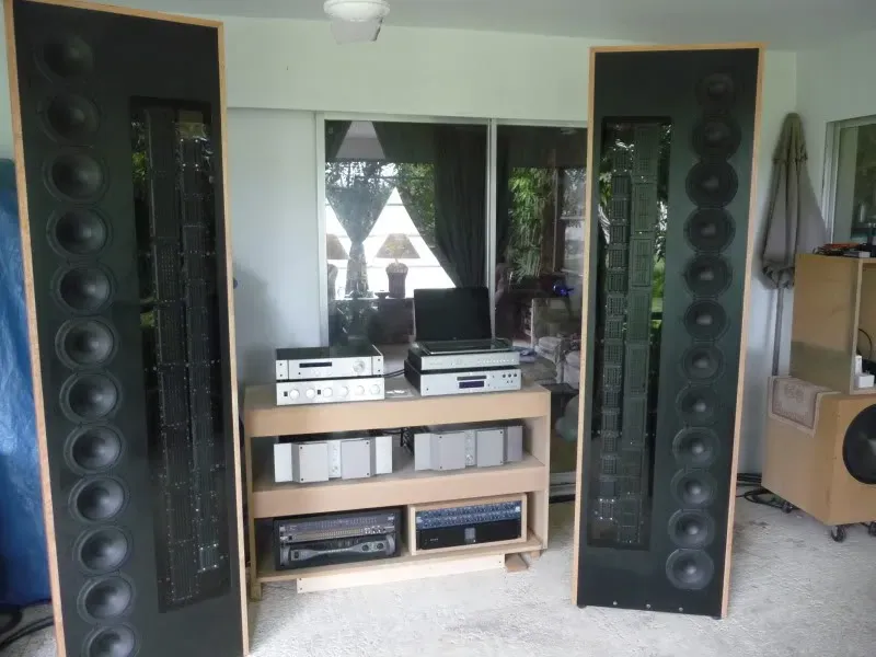

                                                                  Now playing with a TADAK dac - my first experience with tubes as I missed out on all the '60s fun . . .
                                                                    #528
                                                                    Chuck boy, you are ON FIRE! Go, go, go, go!
                                                                    • chasw98
                                                                      • 1360
                                                                      #529
                                                                      Thank you, Hank.

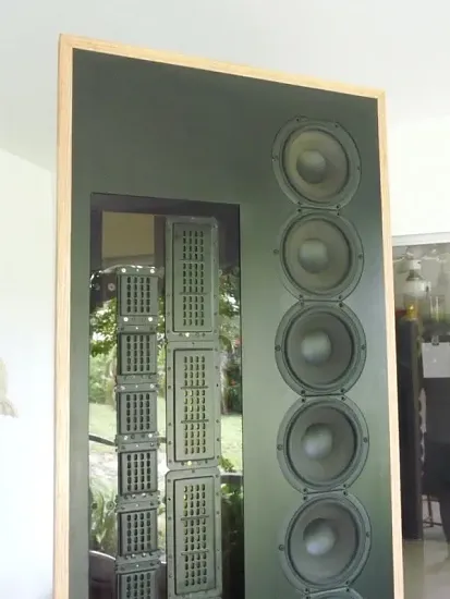

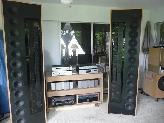

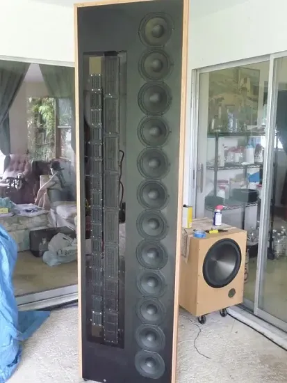

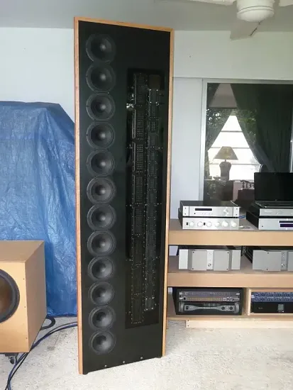

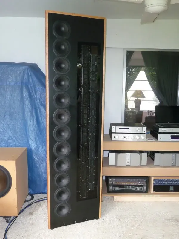

                                                                      Here they are in their finished form.
                                                                      Now all I need to do is get the energy to finish the subs and the equipment rack.
