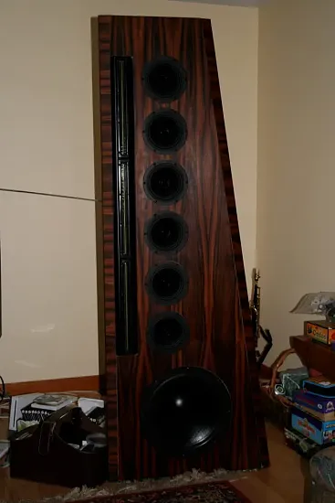

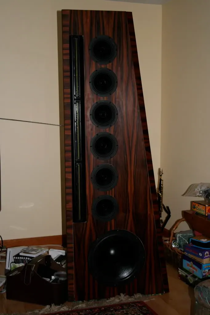

                  Craig, let's see the back of those beauties! ;x( I'm curious how you hold them up.
                  John,
                  Here you go:

                    Bigger image...

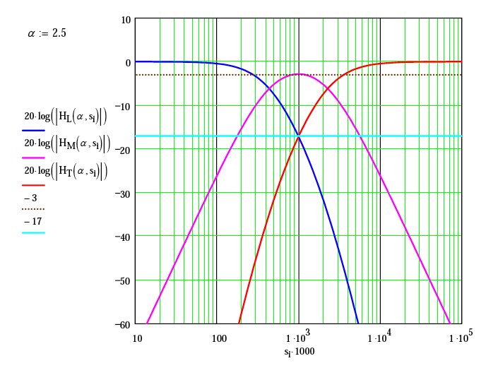

                        This is the target transfer function for the Indra Klone, center frequency of 1 kHz and aleph of 2.5.
                        The cyan line indicates the level at which I think the drivers must track well for it to all add up; done correctly, the drivers are in the same relative phase through out that bandwidth. OTOH, another way of looking at it, is that for it to work correctly, the drivers MUST BE in the same relative phase from 200 Hz to 6 kHz for this to sum correctly. But it was pulled off OK in the NeoD CC after some work, and I think it's even more doable in this project.

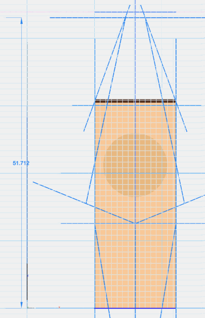

                          And to take Tim's thread even further off track....Just when I was about to build "my version" of the M12ta,
                          You mention the "Indra Klone", I'm in! Reminds me of Paul Ebert's beautiful Trillium speaker.
                          Craig

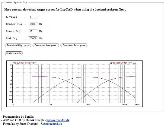

                              I would like to direct your attention to the following web page.
                              Here you can generate target files.
                              The wording is in danish at the moment, but I'm sure you can figure it out. I will try to talk to the web-site owner anf get the wording change to english.
                              A 4-way Duelund calculator has also been made, but not uploaded yet.
                              Best regards,
                              mkc
                              Edit by moderator to add link using Google translate
                              http://translate.google.com/translat...istory_state0=

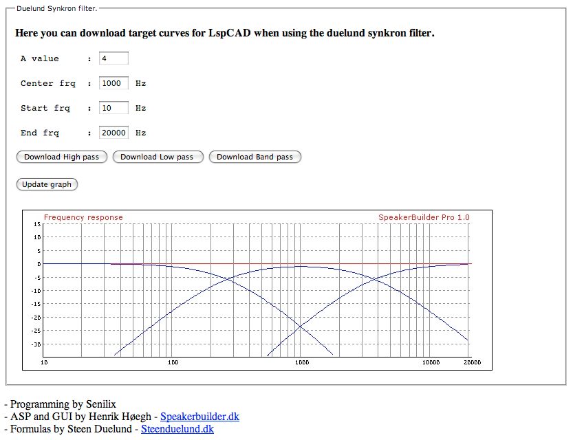

                                  http://translate.google.com/translate?prev=_t&hl=en&ie=UTF-8&u=http%3A%2F%2Fpro.speakerbuilder.dk%2Fsynkron %2 F&sl=da&tl=en&history_state0=
                                  It's in English when I just tried it this afternoon! Thanks for the link and to the gentlemen putting in this effort!
                                  I won't toss away my MathCAD files, but this can be a big help to others wanting to experiment. :T

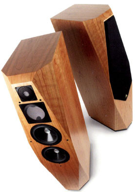

                                    Are we talking about the same "Indra", as in by Avalon?
                                    Just checking, as I have no idea what Paul's Trillium looks like. ops:

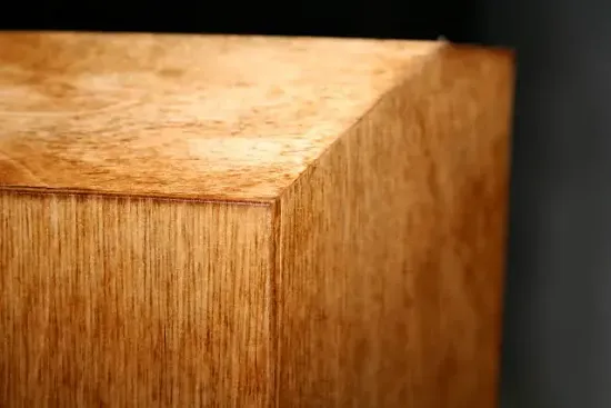

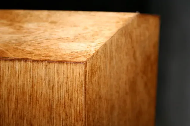

                                        Yes, and I just completed course 101 in multi-facet veneering for the "big" project. Oh, and I would not recommend the inexpensive and super thin veneer that Menards/HD sells. May even get to build my second crossover without the help from Madisound.
                                        Craig
