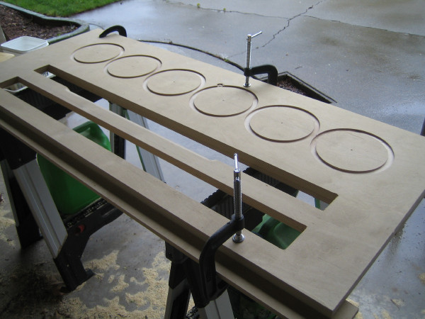

                                                                                          I don't blame you Hank, if I hadn't already jumped into this project I might follow your foot steps.
                                                                                          Here's what I got so far. The thin board is just there for support. I plan on cutting the holes ASAP, then doing the round over work, and putting on the walnut veneer. I made a few errors I need to cover up.
                                                                                          I'm new to real wood working for the most part, and haven't done much, and never used a rooter before. My sound sensitivity issues slow me down as well. Then the weather hasn't helped much. Excuses, excuses, .....
