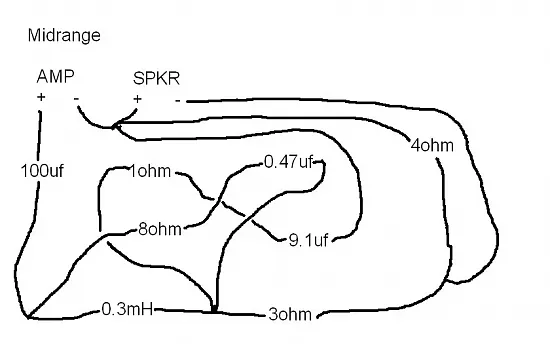

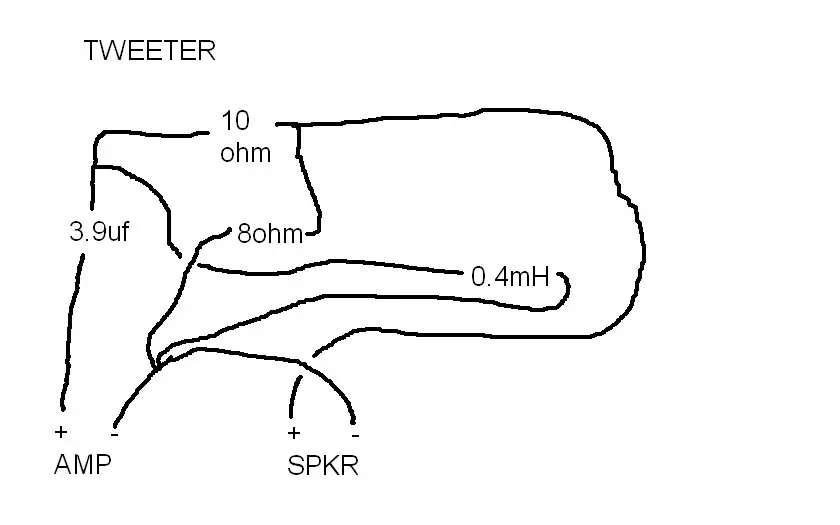

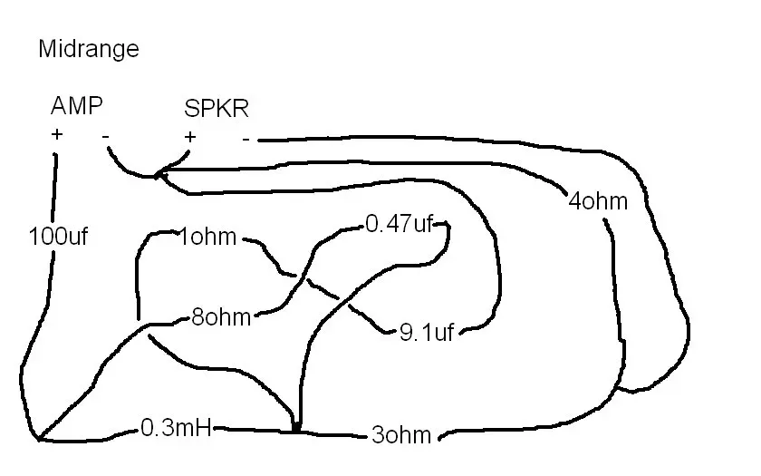

        Here are my crossovers EXACTLY how I have them wired on the board

          Tracing crossovers isn't my greatest strength but all looks well except that there is a 3.9 uF cap missing in the woofer circuit that parallels with the 56 uF cap to create the 60 uF cap spec'ed in the crossover. I'm not sure what effect that would have but it would impact the crossover.

            doh.....i did get the parts and thought they messed up the order, wow that just never clicked.....ok i will fix that up asap.

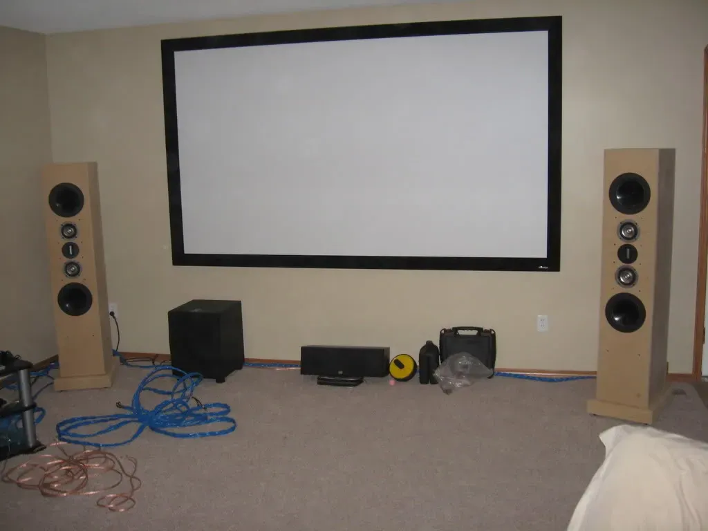

                            Here is the speakers finally done (but not "finished")
