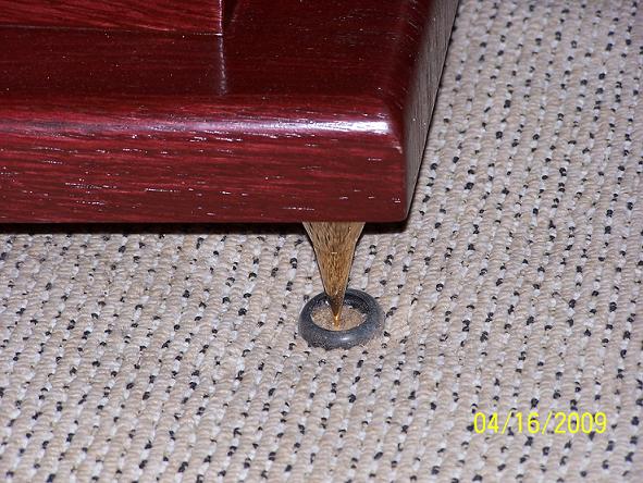

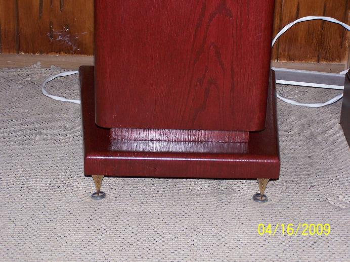

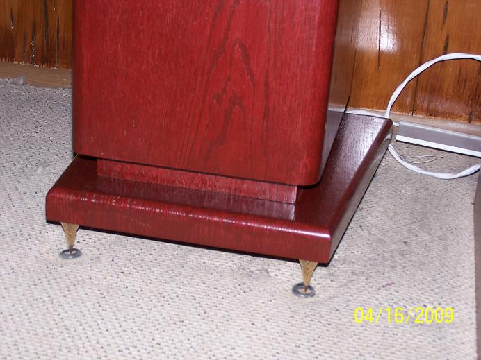

        You can see how close they are to the wall, when I want to do some better quality listening I may pull them as much as 3' towards the room without too much effort.
        I tried to rock them a little yesterday and they are very stable.

            Great idea and thanks for the pictures! I'll buy some of these soon. Since I'm using rubber feet I'm now wondering if they are partially to blame for the instability I'm having? (Along with not having them at the corners)

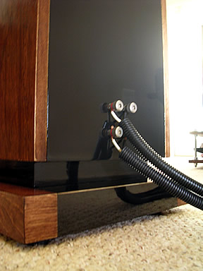

                      Can you post a rear photo of your Statements?
                      I'm planning on a rear port like yours. I'm mainly wondering how much of the binding posts, wiring and crossovers need to be installed prior to finally attaching the baffle. The final finishing of the cabinets will be easier with no binding posts in the way.
                      Can you reach through the lower woofer hole, through the lower shelf brace and past the rear port and foam to install the binding posts and connect wire to them? How close to the bottom did you drill for the binding posts, and do you think it made it easier because your cabinets are shorter?
                      Mine are ported out the bottom; you can see the inside flare in the foam pictures. I had the cabinetry finished and was able to install binding posts, foam, and do wiring / mount crossovers; in that order. Although my cabinets are shorter, the driver array is to spec. In other words, 4" was taken off the top but it did not effect the height of the driver array.
                      The binding posts were 1.5in from the bottom of the cabinet and then spaced 1.5in apart vertically; horizontally they are 1.25in apart. You won't be able to see the binding posts while installing the nuts on them, you'll have to do it by feel. If you can do that, you're set! Here is a picture:

                      Haha no sweat! I didn't know for sure until I actually tried it during assembly. As Jim said you can put your arm through the port hole cutout (I'm sure he meant before he port is installed), and I was even able to put mine through the bottom woofer cutout and reach the bottom.
