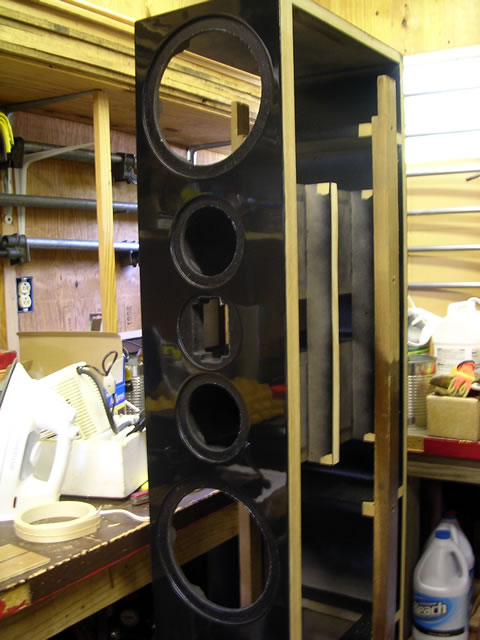

    In any case, things are progressing somewhat since the last time. On Friday, the "good" cabinet got its last coat of poly! Woohoo! Patching the problem areas as time consuming, but it turned out good:

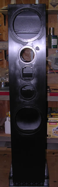

    The "bad" cabinet is still being bad, though! I finally have a process that is giving me relatively predictable results. It's slow, but it is moving forward now:
    Last edited by theSven; 22 August 2023, 09:37 Tuesday. Reason: Update image location
      That one looks quite good. Not perfect but good enough in my book.

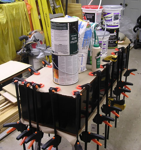

                  I'm beginning to work on these again. I picked this back up where the "good" cabinet was finished with the poly stage, and the "bad" cabinet needed patchwork done still. I tried for a couple more months to get the bad cabinet patched up like I did with the good cabinet, but I ended up taking several months away from the speakers and worked on something else.
                  Recently I came back to this and made a decision to make the best out of the situation with the bad cabinet. I did a few more iterations of black paint / sanding to fix up the patchwork to a point.
                  So here is a picture of the "good" cabinet getting one of the sides glued on:
                  Yup, that's pretty much every clamp I have... I think it was somewhere around 20 or so

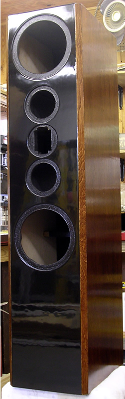

                        Just a quick update, the "bad" cabinet is finished with the polyurethane gloss! It's not perfect under direct florescent lighting, but most of the flaws can't be seen in the indirect lighting in the living/HT room; even with indirect sunlight.
                        Here is a picture of the "good" cabinet with sides on:

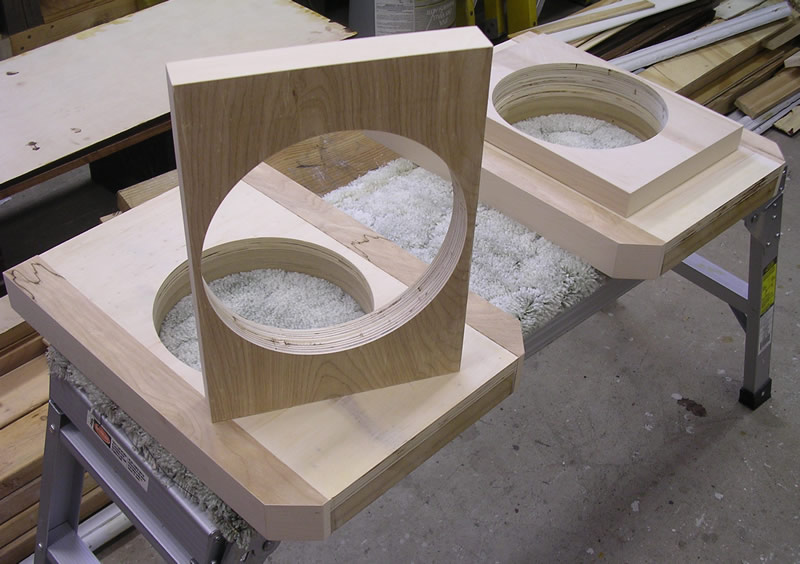

                        Below is a progress picture of the speaker bases. They will have the 3d look similar to what ahaik did with his. The base collar is two 3/4in pieces of birch plywood laminated together, and the base is 3/4in birch, 3/4in MDF, and 1/2in MDF laminated together. Both the base and the collar weigh about 15lbs together. I have veneer edging on them and they are ready for finishing:

                          FroDaddy,
                          Those look great! :T
                            Wow, those look great.
                            BTW, how did your friend's Khans turn out? I hope he is happy.

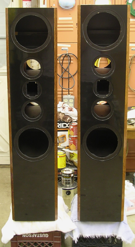

                                • FroDaddy
                                  • 274

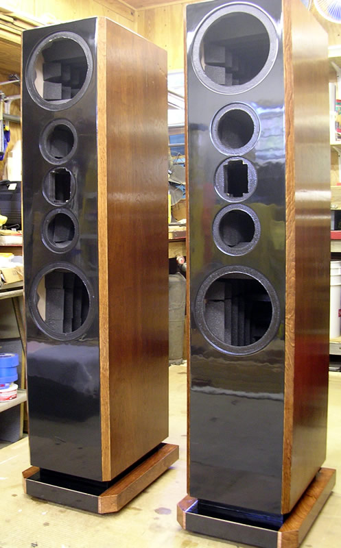

                                  Which one is the "bad" cabinet? I'll never tell (those are different size milk crates they are sitting on btw)

                                    Beautiful Fro', beautiful! ;x(
                                    • TacoD
                                      • 1080
                                      Wow great finish on these speakers.

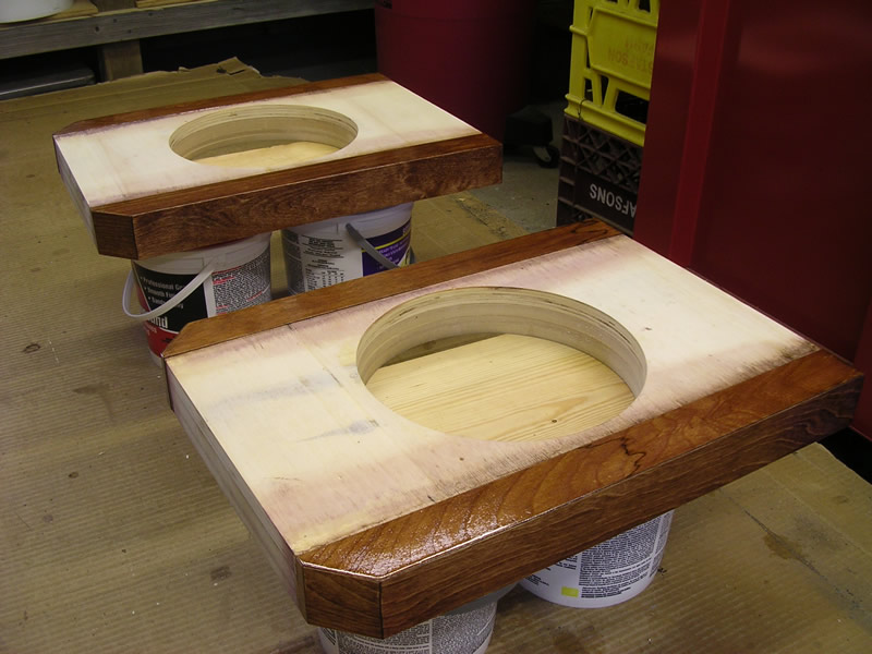

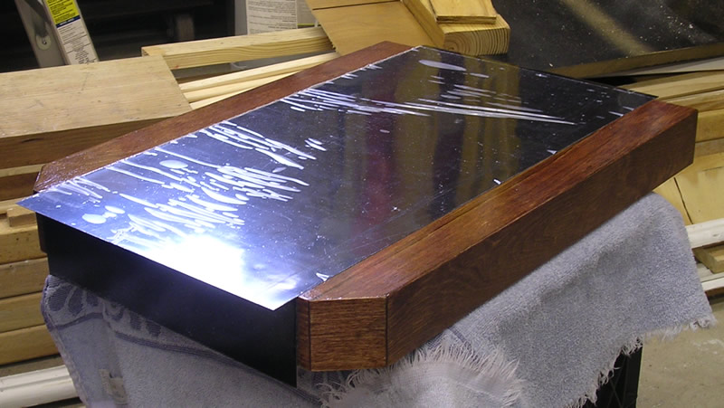

                                                  Assembling the bases
                                                  The Statements are finished! I had Good Friday off of work, so I took the weekend to put the hammer down and finish the project. I put in a lot of hours, about 12-14 each day, and on Sunday I finished one tower right at midnight. The next night (Monday) I finished the second tower! Phew!
                                                  I wanted to show a few pictures of the assembly of the bases. Continuing from the previous picture of the bases, I applied Minwax Red Mahogany stain doing an immediate wipe on / wipe off on the top birch veneer, but leaving it on for about 10 minutes or so on the edge veneering. Some mineral spirits was used to color match to the tower stain and to bring out character in the wood, then a three coats of poly to match the gloss level of the towers:
                                                  Did I forget to stain something? Nope...
                                                  So what the heck am I gluing to the top?
                                                  Last edited by theSven; 22 August 2023, 09:38 Tuesday. Reason: Update image location

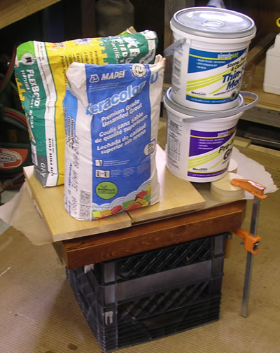

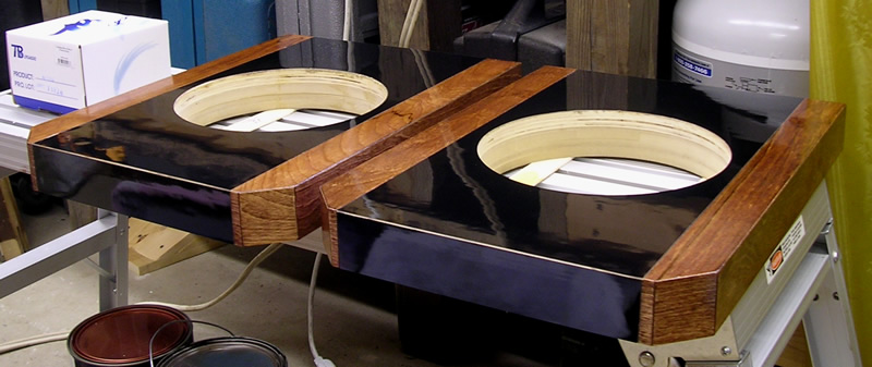

                                                    Your shortcut to a glossy black finish!
                                                    Click image for larger version  Name:	bases3.jpg Views:	4009 Size:	96.4 KB ID:	853011
                                                    I'm finally ready to let the cat out of the bag! This stuff is a solid laminate surface from http://www.decotonesurfaces.com internal part number FL121GPC070BU, web part number is Formplac L121. You can order samples from them for free as well! They have different levels of gloss and texture, and I ordered two glossy black untextured 4ft x 10ft sheets for about $150! I wanted a shortcut to glossy black but couldn't find one. After all the headaches I was going through on the tower cabinets, my father took it upon himself to try to find something and this is what he discovered:
                                                    Click image for larger version  Name:	bases4.jpg Views:	4173 Size:	92.4 KB ID:	853012
                                                    What I did was inlay the laminate into the wood. I'll buy a paint pen to take care of the wood edge. I made a more in-depth post about the material here: https://www.htguide.com/forum/showthread.php?t=33523
                                                    All I have to say is if you always wanted a good looking and even glossy black finish, order a free sample to see if it's good enough for your tastes. It was for mine, the pricing was so inexpensive it blew me away, and the install is MUCH MUCH easier than trying to do a finish like this using traditional methods. In fact, the finish on the laminate is better than I could do by hand ops: (I don't get any kickbacks from the company, I'm just a happy customer.) I plan on finishing my 2rCC Statement Center channel AND my upcoming Mini Statement surround speakers build with this laminate too!
                                                    Last edited by theSven; 22 August 2023, 09:38 Tuesday. Reason: Update image location and htguide url

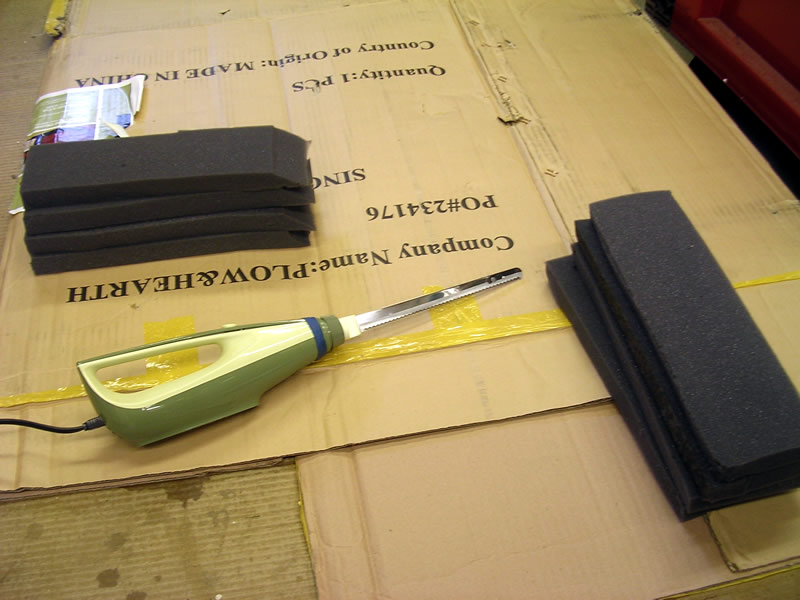

                                                      As said in a previous post, I had Good Friday off and worked all day and night on the speakers. First thing was to line the cabinets with foam. From the original Statement thread, I used Curt's trick with an electric knife to cut the tunnel lining. The foam cuts like butter with this! I borrowed this one from my father; circa 1970 I'd say :rofl:
Name:	electric knife.jpg

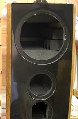

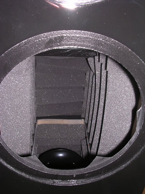

                                                      Per the design spec, the upper cabinet was lined with 2" wedge foam from Foambymail and glued to the cabinet with 3M Super 77 spray glue:
Name:	upper woofer foam.jpg
                                                      I lined the entire lower section with the foam as well. The cabinet echoed too much for my tastes until I lined the entire thing. I used precision ports to port out the bottom of the cabinet:
Name:	lower woofer foam.jpg
                                                      Last edited by theSven; 22 August 2023, 09:39 Tuesday. Reason: Update image location

                                                        VERY nice!!!!! I just received the drivers today for my Statements, and I was going to start a web search for some kind of gloss black veneer. I'm not sure if I want gloss black, matte black or a light maple veneer on mine. There is no way I'm painting them black!
                                                        I was also wondering how people were attaching the foam...your thread answered that one, too. Great build thread! I can hardly wait to see the finished product...

                                                          Did that Formplac L121 bend around that sharp corner on your bases, or is that 2 pieces? I'm hoping that the Formplac L121 will go around the 3/4" radius on the baffles.
                                                          • FroDaddy
                                                            • 274
                                                            Hi John, this stuff is like countertop formica so it's not flexible at all. It has a thin panelboard like backing to it.

                                                              Hi FroDaddy,
                                                              That electric knife is really slick. Did you use the 1" charcoal packing foam from foambymail.com for the mid tunnels? I was thinking about using it for my project. Your cabinets look really nice!

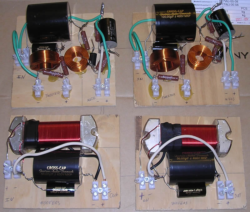

                                                                After the cabinet was lined, I flipped the speakers over to paint the bottoms black so that the bare MDF wouldn't reflect onto the bases. The rest of Friday's daylight was spent trying to work out a method for the laminate inlay and finishing up the collar bases. Later that night I made all the physical connections for the crossovers until around midnight or so.
                                                                Saturday I was up-and-at-em early ready to get the laminate inlay finished, but that proved to be much harder than I originally anticipated. Being that I had to actually route the original inlay lines at slight angles to cover up routing mistakes, it made accurately cutting the inlay much harder. I tried a paper cutter which was useful to cut the pieces out of the main sheets but not for perfectly straight lines. A router WILL scratch this stuff even through the protective covering, so after cutting a perfect piece I had to throw it out after realizing this. The solution to that was to use painters tape + painters paper to add a couple extra layers of protection. To cut the inlay pieces, I worked out a solution after much more trial and error than I wanted. Since the original inlay lines were absolutely routed straight, I was able to measure the front / back widths and setup a jig to cut the inlay pieces with a router trim bit. I got within 1/32 of an inch on the whole, so each line is within 1/64th. I glued all but one piece with Titebond III, in which that choice was made after testing contact cement versus the glue earlier in the day. Daylight was fading fast so I cut the crossover boards and finished them up late that night. I will bi-amp the speakers:
Name:	completed crossovers.jpg

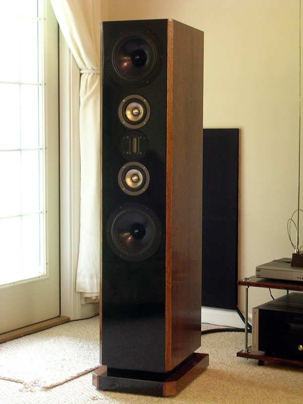

                                                                Sunday the goal was to get them up and running, and I partially met that goal. First order of business was to finish up the bases, so while the final inlay piece was drying I had to come up with a method to trim this stuff. The best method I could come up with was to use scrap pieces and tape them to the edge the laminate bit's bearing would ride on. The surface the router will ride on absolutely has to be protected with painters tape + painters paper even though the laminate comes with a protective surface. In the afternoon it was time to assemble the bases.
                                                                I hadn't said anything up to this point about the collar finish. After the edges of the collars were trimmed with birch plywood veneer I primed them, then painted them with two coats of glossy black with a bristle brush, then after drying for a day I applied one coat of poly using the same method as the main cabinets but minus the sanding steps. Since the collars would be in the shadows, perfection wasn't top priority. They look decent if you lay down on the floor to inspect the finish on them :lol: So after obtaining the measurements to square them up to the base, screw holes were tapped and countersunk, then the bases installed with a thin layer of glue in between that was spread with a cheap brush.
                                                                The bases largely had the same alignment process and were installed to the speaker cabinets which produced this result:
Name:	finished towers.jpg
                                                                So I didn't reach my goal of getting BOTH towers done on Sunday since the inlay was more difficult than I originally anticipated the day before. But, I managed to get one tower up on Sunday! After wiring the cabinet, I mounted the crossovers to the shelf braces inside the tower with some high strength velcro, then mounted the speakers. On Monday I finished the other tower, and they sound great! I'll have to post back with a more in depth review and better pictures, but for now here is the pic I have:

                                                                  Originally posted by tomdro
                                                                  Hi FroDaddy,
                                                                  They definitely don't make them like they used to. It's a shame puke green went out of style! That is the 1" foam from foambymail.com as well; I ordered both the 2" wedge foam and the 1" in the same order. Thanks for the kind words!

                                                                      • john trials
                                                                        • 449
                                                                        Bummer...I was so excited last night about that stuff...too good to be true!
                                                                        Your finished speakers are gorgeous. I also like the bases that you made...not as 'chunky' as most. I'm going to look into some kind of granite as a possibility for a baseplate. I'm not sure how that will look, though. Too many possibilities!
                                                                          It's possible to use the laminate on a 45deg angled edge. The stuff must be trimmed with a router trim bit, so the trouble with a 45deg edge would be how to setup the router to trim it. If your trim bit is long, this probably wouldn't be an issue. Just throwing that idea out there.

                                                                                    • rmht
                                                                                      • 15
                                                                                      F-in beautiful......absolutely gorgeous.....
                                                                                      • juliovideo
                                                                                        • 63
                                                                                        FroDaddy .......very nice speakers , congratulation !!!!!
