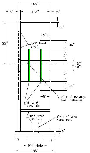

                      I have two quick questions:
                      1) My dad asked if the highlighted piece below is suppose to be one continuous piece or cut into sections as the other pic shows. I told him others had cut the piece into smaller sections so the tunnels don't actually connect but I didn't know a reason why and was wondering which way should it be.
                      2) Would it be okay if I made a square 5'' x 5'' cutout in the back of the center and minis just like the statements or does it have to be that 5'' circle?
                        Hi Nate,
                        The tunnels could be connected but wiring for the ribbon needs to be available. There is flexibility in the assembly as long as you don't change volumes.
                        Square or circle, it doesn't matter. Do what is easiest.
                        • Brian Walter
                          • 318
                          Nate, I drew up the drawings slightly different than Jim constructed his cabinet, and several people had constructed cabinets before the drawings were available. It shouldn't matter whether those braces are continuous or separate pieces. I drew them up as continuous simply because you needed less pieces that way and it would provide slightly more stiffness to the cabinet wall. Whether or not the additional stiffness would help or hurt panel resonances is hard to tell without actually measuring it.
                          Brian Walter

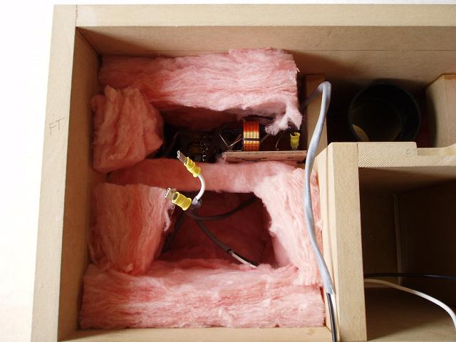

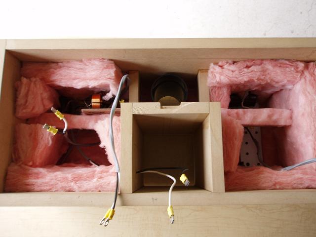

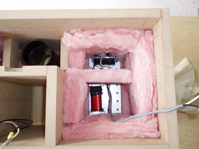

                                      I have a few questions if anyone has the time to answer I would appreciate it.
                                      1) Is there a specific brand of poly to use on veneer? I was just going to pick up some standard minwax gloss poly but if there is a better kinda I would like to know. I have a nice veneer that I just want to bring out its natural colors.
                                      2) How thick should I leave the fiberglass insulation when putting it into the speaker? I know I need to stay back a couple of inches from the speaker but I probably also don't want to fill it full so the port becomes useless. I have the standard 3''-3.5'' thick.
                                      3) I was thinking of places to put the crossover boards in the speaker and wondered if it would be a problem if the crossover board covered a good portion of the airflow. Attached is a picture of what I mean.

                                      • Brian Bunge
                                        • Nov 2001
                                        • 1389
                                        As far as #1, I buy my poly from unfinished furniture stores. Many of them sell a product under their own label that is made by a company called Old Dad's www.olddads.com. I know of several people who've contacted them and they've been able to direct them to a store in their area.
                                          The crossover is no problem. You're good to go.

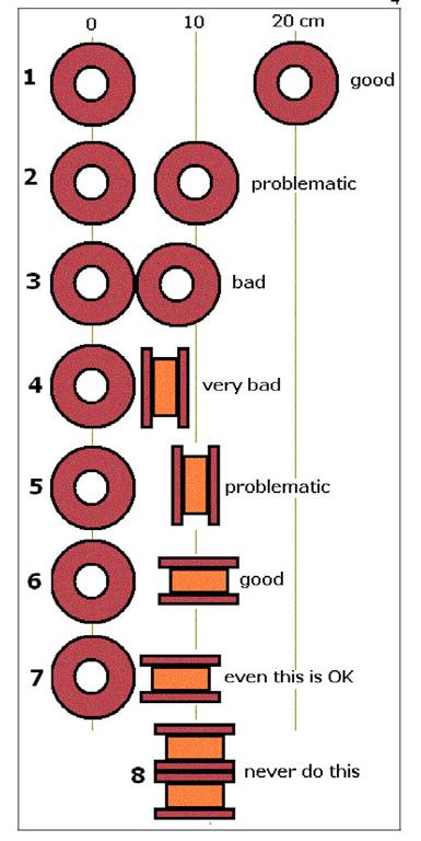

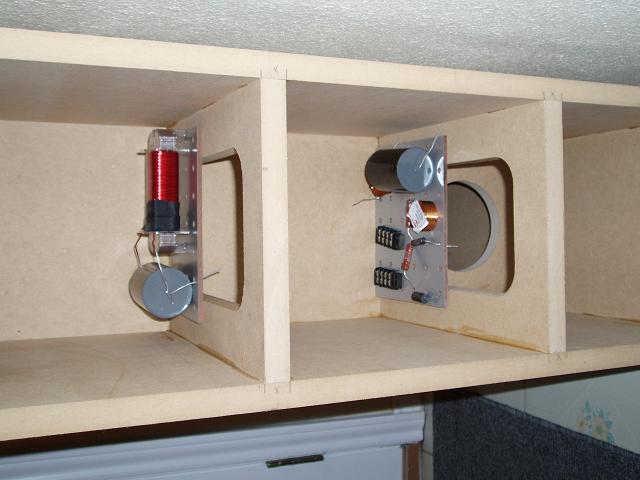

                                                        In the mini statements crossover there are a couple of large inductors and I was wondering if it was important to keep some sort of orientation like it is with all the other air coil inductors. Attached is a picture of the type of inductor I am speaking of.
                                                        Last edited by theSven; 03 December 2023, 17:32 Sunday. Reason: Update image location
                                                        • Curt C
                                                          • 792
                                                          Yes, all inductors shoud be orientated 90 degrees from any adjacent inductors. Spacing of 3" between them lessens the need for this orientation, but its good practice anyway.
                                                          Curt's Speaker Design Works
                                                          • NateTTU
                                                            • 205

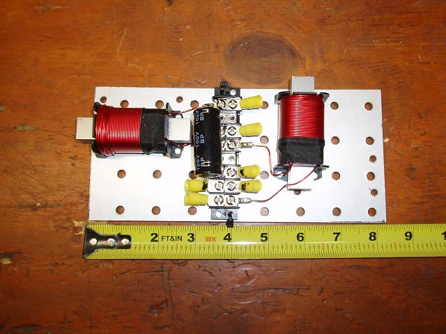

                                                            Alright, with the odd shape of these iron core inductors the only way I can seem to arrange them in a 90 deg fashion isn't listed on that sheet, but it should look something like the image below. Would this be ok?
                                                            Edit: I took out the camera and for a quick shot to give a better picture of what I was talking about.
                                                            Last edited by theSven; 03 December 2023, 17:33 Sunday. Reason: Update image location
                                                            • Curt C
                                                              • 792
                                                              Couldn't have done it better myself, Nate!

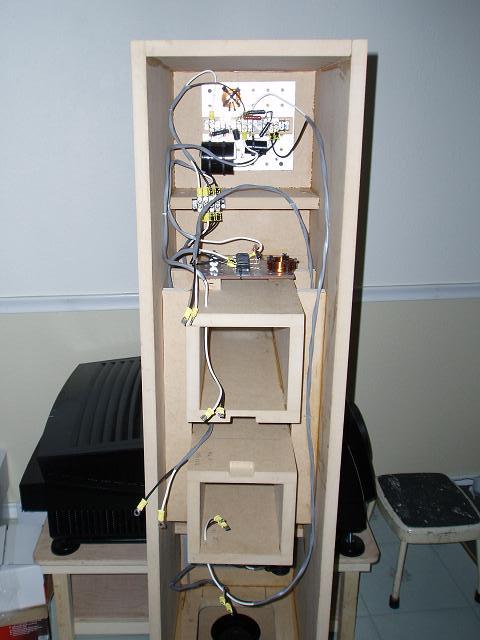

                                                                All the speakers and now have the crossovers in place and the wires installed. They seem to check out ok so now I'm going to begin putting in the fiberglass. However, before I get started I had a quick question. My crossovers are on pretty large boards (like in the picture but some are larger) and they are attached to the back of the speaker walls. With such a large surface area, sometimes directly behind a woofer, should I place some fiberglass over the crossover boards? I can take some pictures when I get home later if it would help describe what I'm talking about. I just want to make sure that the sound waves aren't bouncing around off those boards. I was planning on just covering them loosely with the fiberglass so I could remove the fiberglass if needed to have access to the boards in the future.
                                                                  Hi Nate,
                                                                  Loose is fine as long as it staysin place and doesn't get into the back of the woofers.

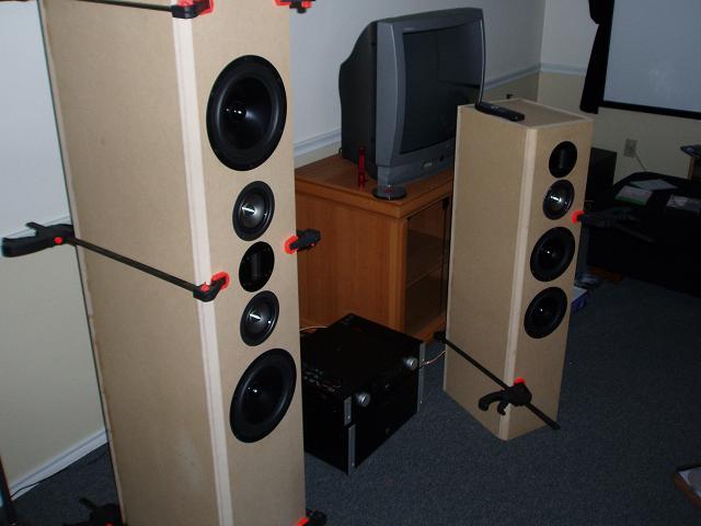

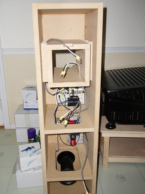

                                                                    Here are some pictures showing my current status. Hopefully tonight we can get most of the fiberglass installed and begin gluing the front baffles on. Pardon the mess as I'm moving to a new home this weekend so there is stuff everywhere. Also, does anyone put fiberglass on the back of the front baffle or just on all the other walls? I figured I would, but just hold back a couple of inches from each woofer.
                                                                    Last edited by theSven; 03 December 2023, 17:34 Sunday. Reason: Update image location
                                                                      Here are some pictures showing my current status. Hopefully tonight we can get most of the fiberglass installed and begin glueing the front baffles on. Pardon the mess as I'm moving to a new home this weekend so there is stuff everywhere. Also, does anyone put fiberglass on the back of the front baffle or just on all the other walls? I figured I would, but just hold back a couple of inches from each woofer.
                                                                      Hi Nate,
                                                                      The cabinets are coming together great!
                                                                      No insulation on the front baffle. Side walls and rear wall only. Hold back from the front baffle on the side walls a couple inches to give the woofers some breathing room. Same thing with the foam lining on the mid tunnel. Hold back from the front baffle at least an inch or so and bevel the foam at a 45 degree angle.

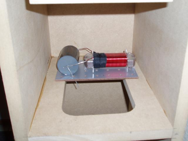

                                                                        Anyone please feel free to comment on the pics below. Thanks Jim for all your help, although I do feel bad for asking so many questions and it seems you are the one to always answer. I should bake you some cookies! BTW, the fiberglass does indeed suck, live and learn I guess. In any case if everything looks ok then I will go ahead and glue this one up for good. Other than placing the foam in the tunnel and making it look pretty, this project is almost done!! :B
                                                                        On another note, I had the speakers in the center wired backwards, once corrected the speaker sounded a lot better. The statements kick it up a notch on the sound, at least for me, and the minis sound almost just as good. Thanks for the awesome design guys.
