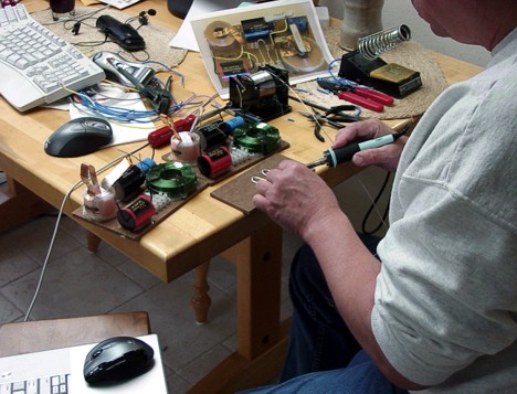

        Well, as we say around my workplace, "Slow work takes time", but the crossover elves have been busy, as this Modula NeoD Tweeter crossover illustrates....
        Working on the woofer boards now, later today will start the Isiris crossover boards.
        ~Jon
        Last edited by theSven; 27 May 2023, 10:28 Saturday. Reason: Update image location
          Nice crossover. Foil inductors, eh?
          VX is nice. I use an MX at home. Some day will have a VX for on the road I think, but the dock and built-in battery of the MX is so nice.
            • 16171
            Foil inductors were for size and DCR, not supposed HF characteristics.
            I've got a couple of VX for my laptops, the battery life is fantastic, and the integration of Mac desktop functions like Expose is very good. Plus, they read and track reliably on surfaces like light maple tables that flummox M$ mice. A highly recommended product.
            This is the second set of MkII crossovers, for the Modula NeoD build for Tom's home.
              I figured you were foiled when it came to finding the right DCR etc. and not for other reasons.
              VX is great. I love the scrollwheel on the entire line, and the sensor is shared so they all do that well on just about any surface. I like the USB dongle on the newest, but want the two thumb buttons so it'll be VX for the laptop.
              I like the thumbwheel on the MX at home, I have it set to switch desktops in Linux. (desktops finally making it to the Mac with Leopard!)

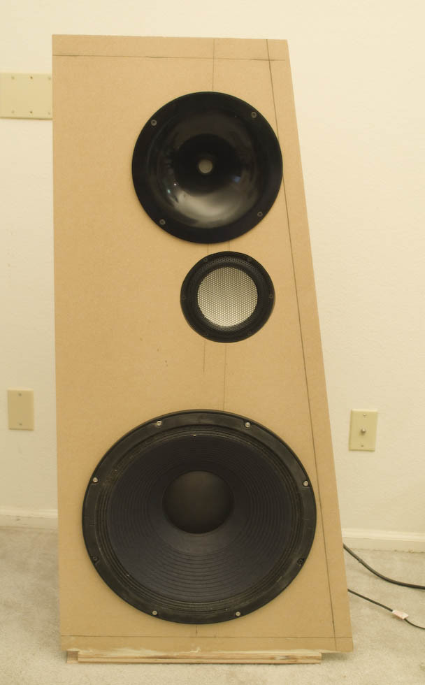

                      The Isiris Jr. Demo for Tom is another of this week's projects; I'm nearly finished with the second set of crossovers for the Modula NeoD CC's, and next I start on that- I've been laminating up front panels, bases, and braces, and he's doing the driver cut outs right now as I write, to build another set of these....
                      ...but with the Dayton RS390HF. A Biamp plus passive crossover has been designed and I'll be building those tomorrow. Gonna be a busy Friday, I think.... :B

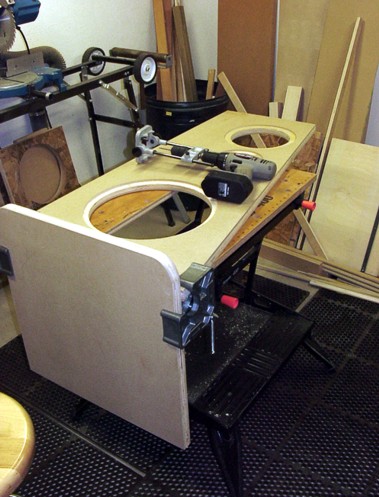

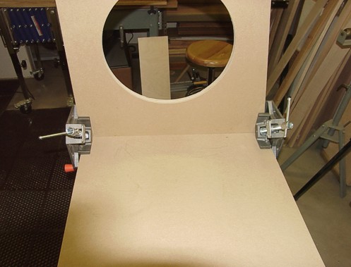

                                            Below we're laminating up the braces for the back of the Isiris
                                            Assembling one of the NeoD CC

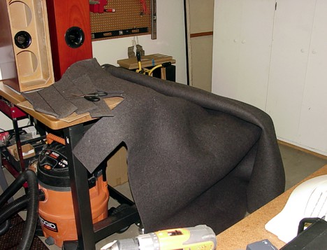

                                            We're always talking about the high wool content felt gasket material. Here's what a partial roll looks like...think $pendy... 8O

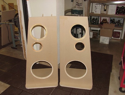

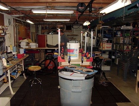

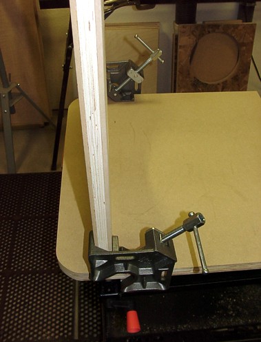

                                                  Jon's working on the NeoD, I'm slaving away on the Isiris...
                                                  Last edited by theSven; 27 May 2023, 10:21 Saturday. Reason: Update image location

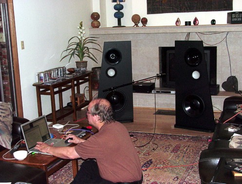

                                                    Testing, Too
                                                    Testing is as important as building, and all the Modula NeoD crossovers were connected and tested outside and compared against the reference plots.
                                                    Biggest glitch we ran into was the same issue that arose previously with Tom's Marchand passive preamp, fixed by hauling out a Sony; don't know the exact cause, it could be the RCA connectors in the preamp. All's well that ends well...
                                                    The boxes don't have the crossover in them, so with the extra volume, the port tuning drops to ~ 27 Hz. With crossovers, it's around 38 Hz.
                                                    Last edited by theSven; 27 May 2023, 10:30 Saturday. Reason: Update image location

                                                      Nice manly corner clamps!
