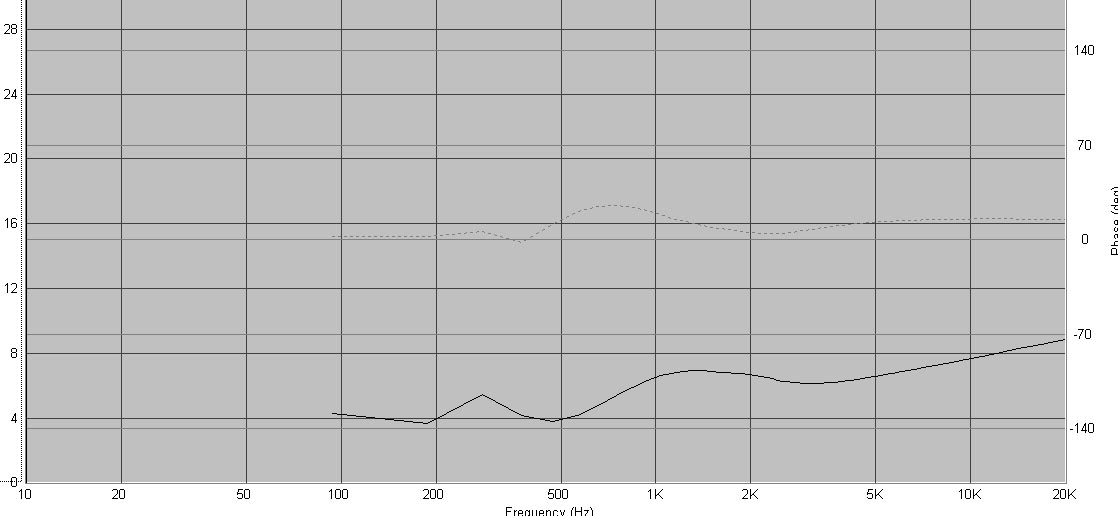

          1.) Oops may have smoothed data.. don't recall.. I'm making measures again so will not smoothe..
          2.) Woofer's level is much higher than others? Wait.. setting the impedance.. what do you mean.... ohhh DCR.. yea oops
          3.) EDIT found the post.. ok so I'm looking for a crossover point where the phase aligns..? clearly have to measure again.. first to get rid of that 10Khz peak.. and 2nd to unsmoothe my data.. Then Extract Minimum phase in the FRC.. then line up phase to see where they align.. then crossover.. then say delicious.
          4.) Will try.. EDIT put that on there.. wow.. huge jump UP.. no impedance issues there.. 3ohms or greater.. but the FR is yuck.. this goes back to phase aligning.

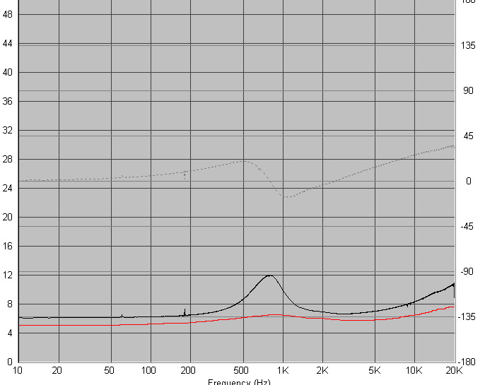

          5.) Here black is my measured.

            On measuring and phase: DON'T do the minimum phase extraction step unless you're *really* having troubles. If you do, KEEP your original data. To make sure you get the correct offset on the mids and woofer you'll need to compare response with the minimum phase model and the live data to get this right. I don't recommend that as a first pass though. But, this is not a required step. If you work with the live data straight in SW it is quite possible and valid, it's just not always as clean looking. But, you can do other things to adjust response and get there without ever looking at the phase data.
            Woofer level circuit: right now the woofer output looks low to me. Get DCR on the inductors - if you really do need less level, go with a smaller gauge inductor or something. But DO make sure you have impedance data set on the inductors set! (DCR, yeah) VERY important on any series inductors in particular.
            Impedance on the tweeter, looks fine. Just making sure. I didn't expect my random circuit suggestions to magically integrate. Will take some tweaking. Though, check it with the tweeter wired both ways.

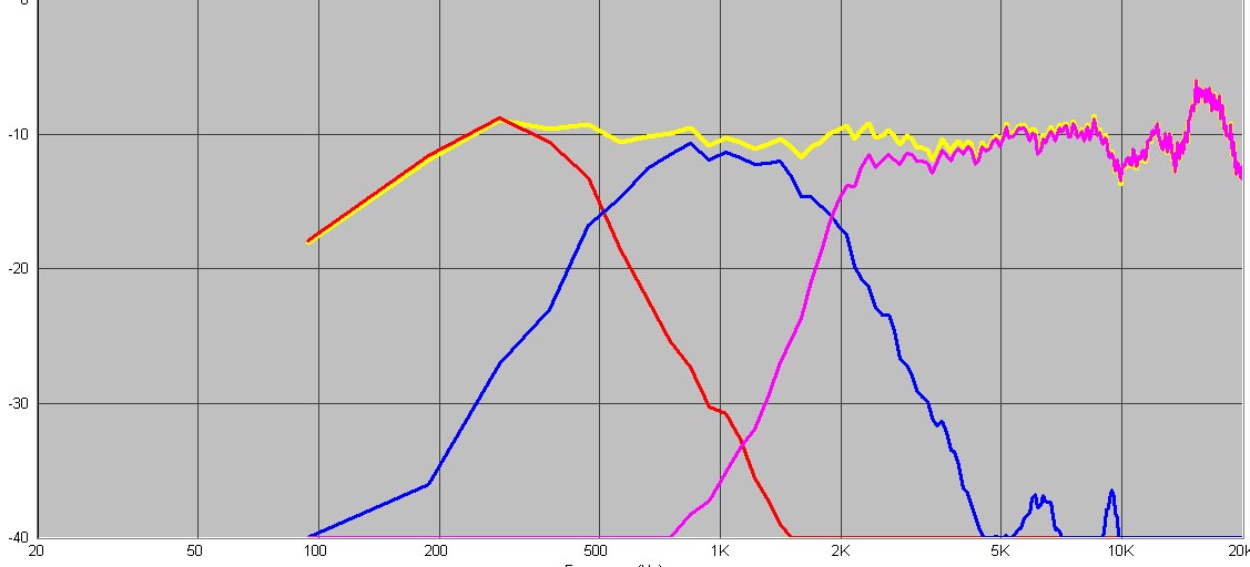

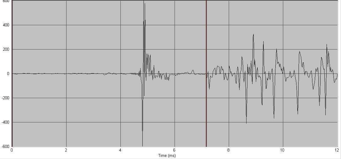

              Ok I'll post what I got so far..
              FRDs for Gate Measurements down below.. hmm peak at 2670Hz wonder what that is..
              Alright thats to about 7.15 mS @ about 2 meters.. I can increase the distance but it appears the distance increase is messing with my gated measurements.. even though it shouldnt?
              Now my phase is all yuck.. saw tooth like.. how am I supposed to line up the phase data?
              Last edited by theSven; 27 May 2023, 11:17 Saturday. Reason: Update image location

                  #98
                  Do not move the mic - keep it on-axis with the tweeter for all measurements. It simplifies things significantly. 1.5M should be OK.
                  You've got a little peak below your stop gate that might be a reflection you need to avoid.

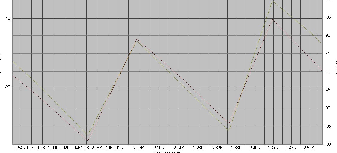

                                          #110
                                          I sent you crap CJD..
                                          I didn't have the latency set properly on my computer at home.. explains all the garbage in my measurements.. today's 1M on axis/gated produced good results.
                                          I think I found the crossover point for my Tweeter/Mid
                                          Relative phase at 2.1K = 0* this is from the Farfield Gate response of the two drivers.
                                          And if I'm reading this properly Sub/Mid at 250Hz is ~90* out of phase..

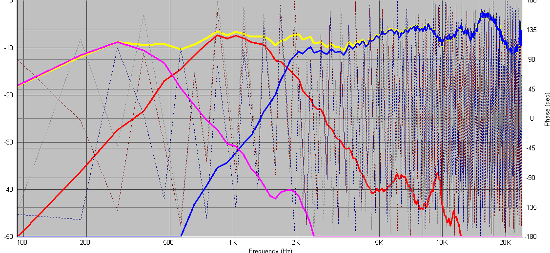

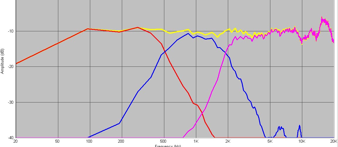

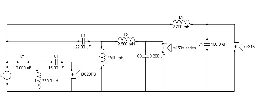

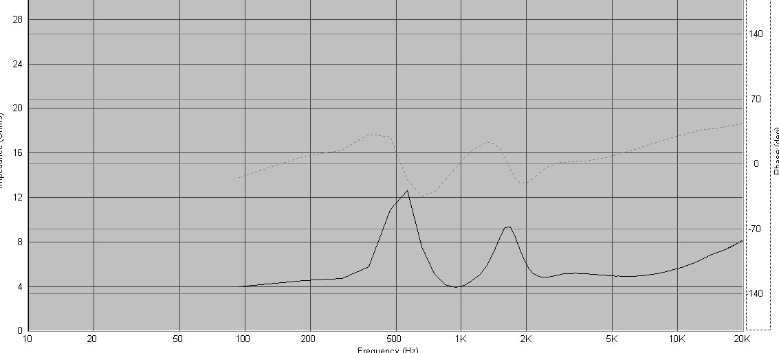

                                            I think I got it!
                                            Yea!!! I appear to be in phase at both crossover regions.. I had to pad the tweeter because it was higher than LF to start.. (was about 6dB higher.. Baffle?)
                                            Someone tell me I'm good so I can order this stuff..

                                              #112
                                              Phase tracking does seem better, but... it won't sound too good. Big hump at 500Hz to a drop trough - that's all going to be quite audible.
                                              I just want to confirm, you are including DCR on your inductors now? If so, you do have an issue with too much energy on the mid still, even in series. You'll either need to consider padding them down, or finding higher DCR inductors to use on the mid-woofers (I recommend the inductor route first). That'll force a change in slope somewhat, though.
                                              Actually, looking over the data again: Let's see if you can eliminate the second large inductor value on the woofers (I hope you're using low DCR inductors here - go cored if you don't want to spring for an expensive air-core for this project). Also, consider raising the crossover frequency slightly. The goal here is to bring that level up so you can NOT pad the tweeter down as much and bring the overall level up more.
                                              If you can, I'd also like to see the tweeter level up a little on its low end. What happens if you drop the second cap to 20uF?

                                                            #119
                                                            Alright beat me with this one.
                                                            I left the phase on there so you can see they are all pretty well matched... within crossover regions.. whaddya think?

                                                              Yeah, you're getting it.
                                                              So, I'm still a little concerned you may have too much midrange energy, and a little much on the top of the tweeter. But it's also at a point where your'e getting close - if you want to keep at this stuff as a hobby, it's time to build and keep tweaking, but to HEAR what some of the changes do. IMO.

                                                                        #125
                                                                        Originally posted by cjd
                                                                        If these are in-room gated measurements, they should automatically include baffle step.
                                                                        If you're not wanting to put out the cash, keep fiddling. Experiment with topology some. You've got data and are picking up the working knowledge to make this practical. You're already looking at something that is +/-3dB which many consider perfect. So, it depends how much of a perfectionist you are, and how much more experimentation you want to do as far as fiddling and learning from that.
                                                                        Heh I think I figured it out!
                                                                        So what do you call that.. nominal 8 ohms?
                                                                        This is with the merged nearfield spliced in..

                                                                        • augerpro
                                                                          • 1871
                                                                          #126
                                                                          Why does your impedance ahve such bad resolution and only extends to 100Hz? you should be able to use a very large gate (>200ms) and get a high res plot down to single digit frequencies. My concern here is that the XO CAD may be inaccurately modelling the response because the resolution of the impedance is too coarse. This might result in a frequency response quite different than the model predicts. Just a thought.
                                                                          ~Brandon 8O
                                                                          DriverVault
                                                                          Soma Sonus
                                                                          • Blazin
                                                                            • Jun 2007
                                                                            • 167
                                                                            #127
                                                                            It's based on the resolution of the On Axis response.. since the resolution isn't great at low frequencies it 'guesstimates' the impedance at those low frequencies.. ie it does some sort of best fit line I believe..
                                                                            I agree the chart missing that stuff is kind of an issue, so spliced far field adds in some resolution or at least bandwidth.. and goes down to 20Hz.. its not totally accurate as there should be 2 humps due to the vented enclosure.. but showing it shows ~4 ohms down to 20 Hz.. I just need it to not be below 3ohms.. as my amp can do 3 ohms
                                                                            • augerpro
                                                                              • 1871
                                                                              #128
                                                                              Hmmm...Gating for Impedance measurements has nothing to do with frequency response measurements. Impedance measurements don't care about room reflections so you can make the gate as big as you want.
                                                                                I understand this, I'm saying.. I'm not gating the impedance.. thats how SW works.. if someone knows how to change it so it had better resolution, let me know.. The resolution for the crossovers and the frequency bandwidth is deteremined by the gate of the farfield measurement.. it doesn't display impedance data with any more data points than the FResponse..
                                                                                The individual measured impedance doesn't look anything like what I've posted, it has lots of resolution and is 20-20k.. I don't know why SW re-samples the impedance from the measured impedance charts..
                                                                                            I believe when doing crossover modeling, SW will reduce the impedance resolution and range to match the farfield FR measurement of the driver.
                                                                                            One thing I'm not comfortable with is your measurement resolution below 500Hz for your woofer/mid crossover design. It looks far to coarse to me to adequately get good phase and FR data for good lower midrange phase alignment. You want at least 1 if not 2 octaves either side of "good enough" resolution. If you can't get your gate large enough, you might need to resort to nearfield measurents and hilbert transforms with relative acoustic offset entered in SW for woofer and mid. Chris knows better than I here so take his advice.
