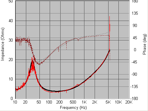

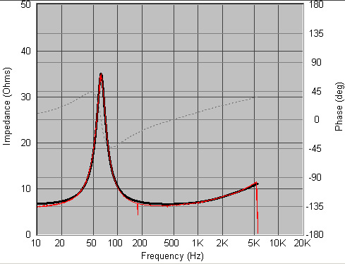

          SD315-88s:
          RS150S-8:
          Estimates of Free Air..
          I realized, it was actually quite simple to hook up the drivers to my receiver at home and use 'B Speakers' channel.. wow, I can't believe I didn't think of that sooner..
          Generally sound cards cannot read(or get fuzzy) below 20Hz, my SD315-88 has a spec Fs of 25Hz; however, in test it was approx 30.77Hz meaning an Added mass Vas calculation requires an Fs of approx 23Hz, will this be measurable?
          What do you use to add mass to the cone? I saw some people using coins, but I need about 1.5 ounces for my Subwoofer, that's approx 8 quarters, I supposed I could do that, but seems like there is a better way..

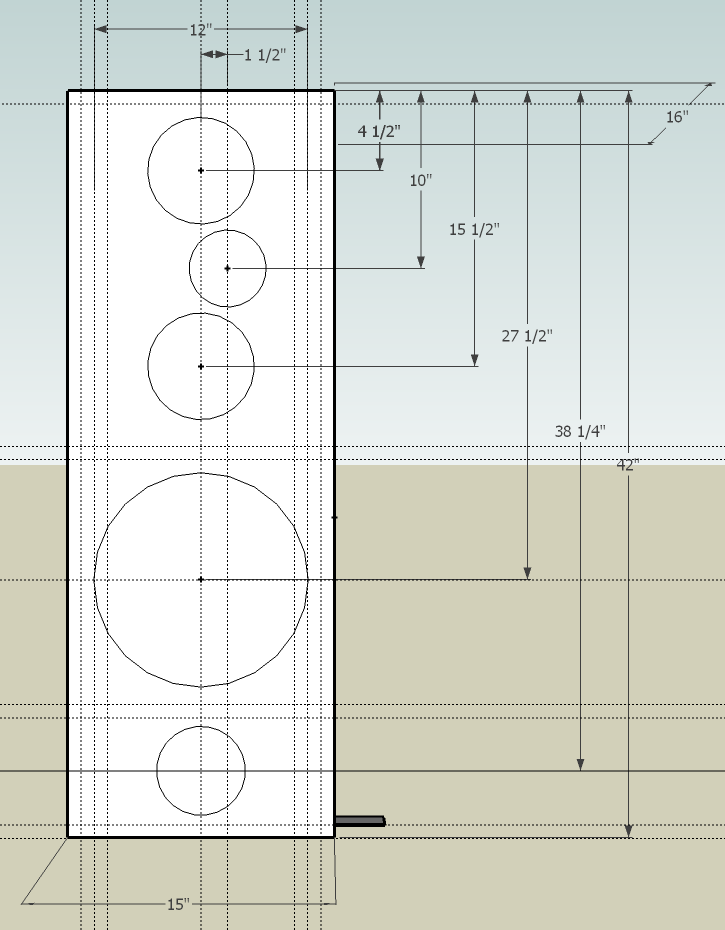

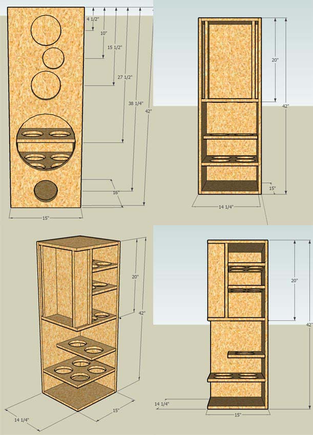

                          Finished design:
                          Last edited by theSven; 27 May 2023, 11:10 Saturday. Reason: Update image location

                            So, I've constructed my first prototype, didn't go as well as planned, over this past break I only had access to a semi decent table saw so upon picking up my prototype material I had HD do the majority of the cuts to save time and be a little bit more precise..
                            Well obviously that was dumb, they didn't do the best job, and the mixture between under and over cuts with the few cuts I made causing problems( table saw's fence was terrible )
                            I am left with a prototype box that looks a bit.. funky in some areas..
                            I am going to end up requiring to use one of the sides of the cabinet for the back as the back doesn't fit (the cabinet is not square now)
                            This all leads me to:
                            I need major help when building my finished cabinet, just making the cuts. Assembly is no big deal, I have that down, and routing my speaker holes is something I've gotten down to a science(using a fixed base router)
                            Is there anyone that would be willing to help me out..?
                            Thanks a lot

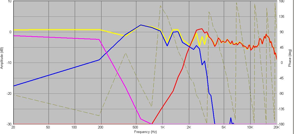

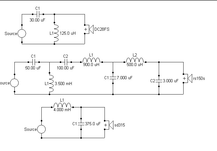

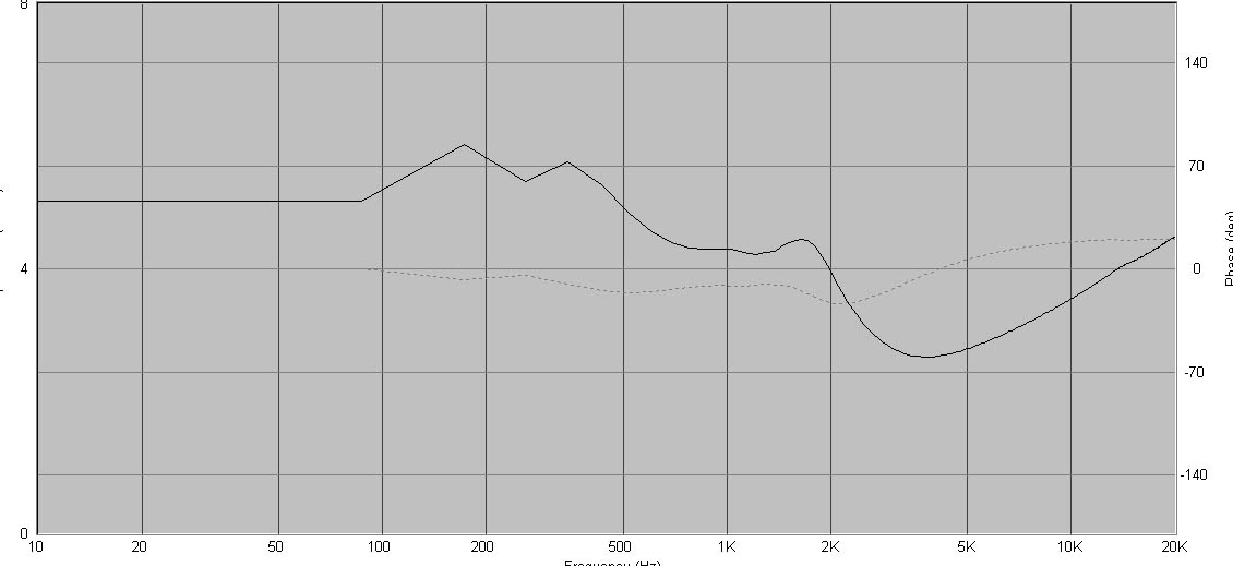

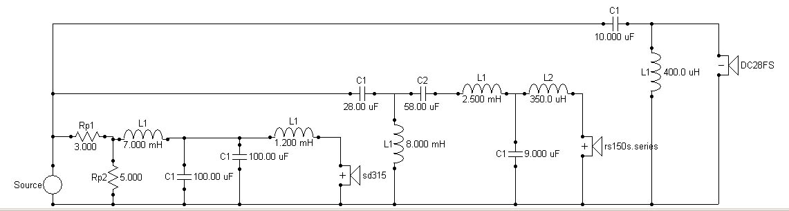

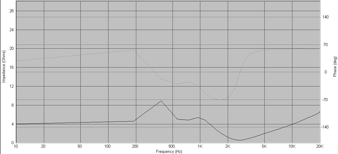

                                  UPDATE:
                                  Crossovers are getting designed.. need some help/verification if anyone would be willing..

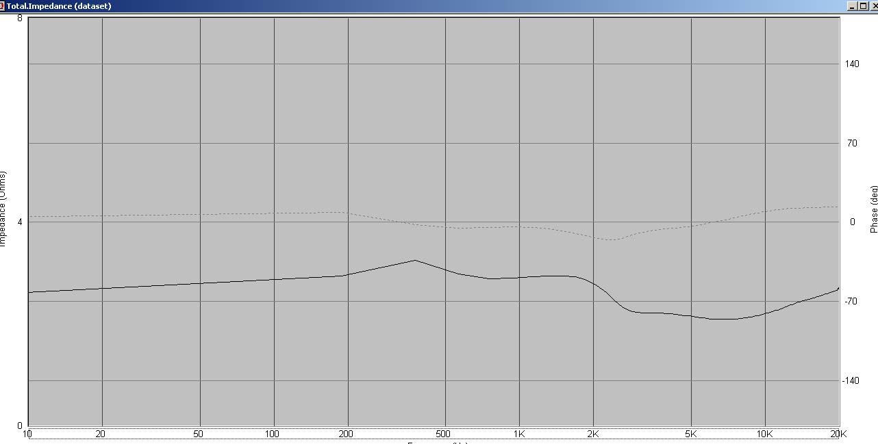

                                  Impedance
                                  Last edited by theSven; 27 May 2023, 11:11 Saturday. Reason: Update image location
                                  • TacoD
                                    • 1080
                                    30 uF for a tweeter is a bit high, I would try to use a bigger coil and a smaller cap (I think it's also your impedance problem).
                                      Woah, you've got a couple pretty big issues in the mid-tweeter end, and some general thing to work on as well.
                                      The data looks like the gating is too wide (long) - narrow it down to just before the first reflection on your impulse response measurement (Claudio explains this pretty well - I find using the tweeter to give the cleanest results for setting this).
                                      Getting this squared away will, I think, help with some other things it looks like you're trying to solve mid-tweet integration-wise.
                                      For one - watch out for nominal response ever being *below* the individual driver response. This will result in poor power response since the flat on-axis is only happening due to phase cancellation (negative summing). Your phase integration is poor - try flipping polarity on the tweeter - I'd expect a peak around 3kHz perhaps. Actually, it looks like a tiny bit of negative sum on the bass end too - perhaps keep flip polarity on the mid(s), not the tweeter.
                                      You've got excessively low impedance at 3kHz, you'll be tripping the protection circuits on your amp(s). But you already know this.
                                      Take a look at the Khanspire crossover I did for the RS150's and the RS28A - different tweeter of course, but it may help you.
                                      I think the transfer functions you're using are going to be peaky which will translate to harshness - particularly that tweet network.

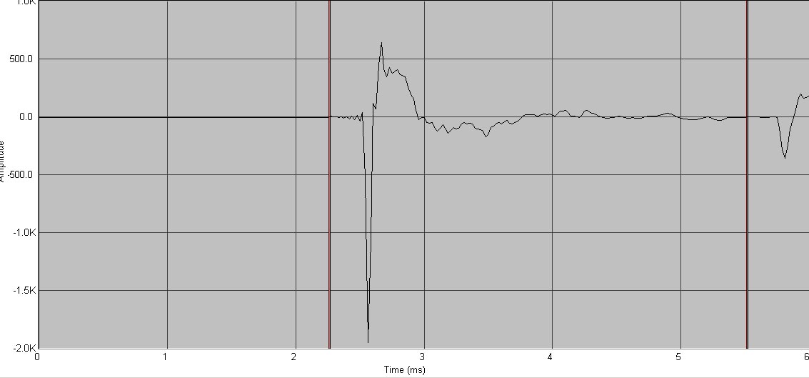

                                        Since you can't tell thats.. 2.26mS to 5.521mS I should shorten it? I'm almost positive thats the gate I used in the lab... I'm on a diff setup so I don't have the settings.. however, I can redo the measurements now that I know how to get it working I also may do these measurements again in a different location, I did this in the lab at school so I could debug.. but the HVAC system probably added in some unwanted noise and the general concrete super reflective nature of the room probably didnt help.
                                        I will try the measurements again and see what I can do..
                                        Thanks for the help, I'll take a look at the khanspire network to see if I can pick up any tips there..
                                          Set the start gate back to zero.
                                          Try setting the second to like 3.3
                                          That's insanely low gate time. You need to get the measuring environment optimized some to get longer first reflection times. I don't think it's usable for a 3-way at all unless you're crossing up around 1kHz woofers to mid (so, dome mid or something).

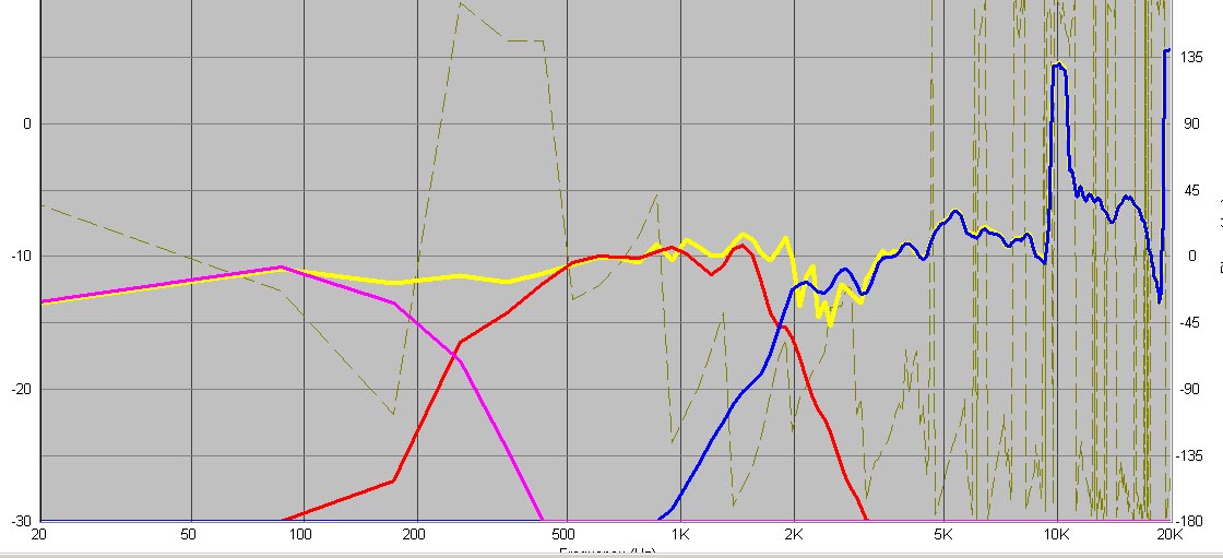

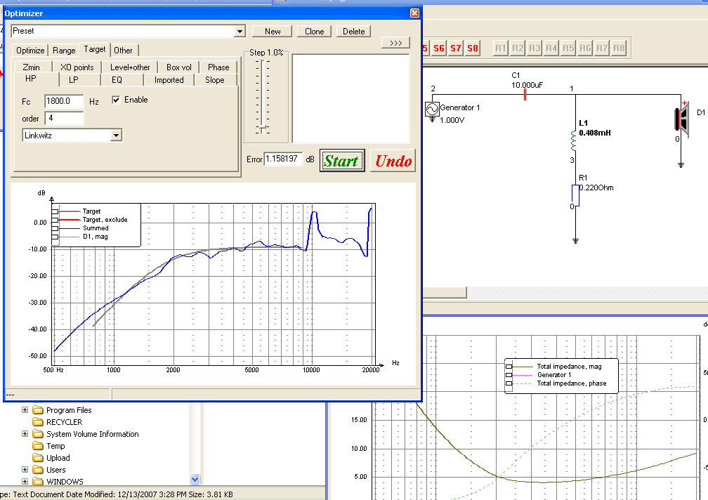

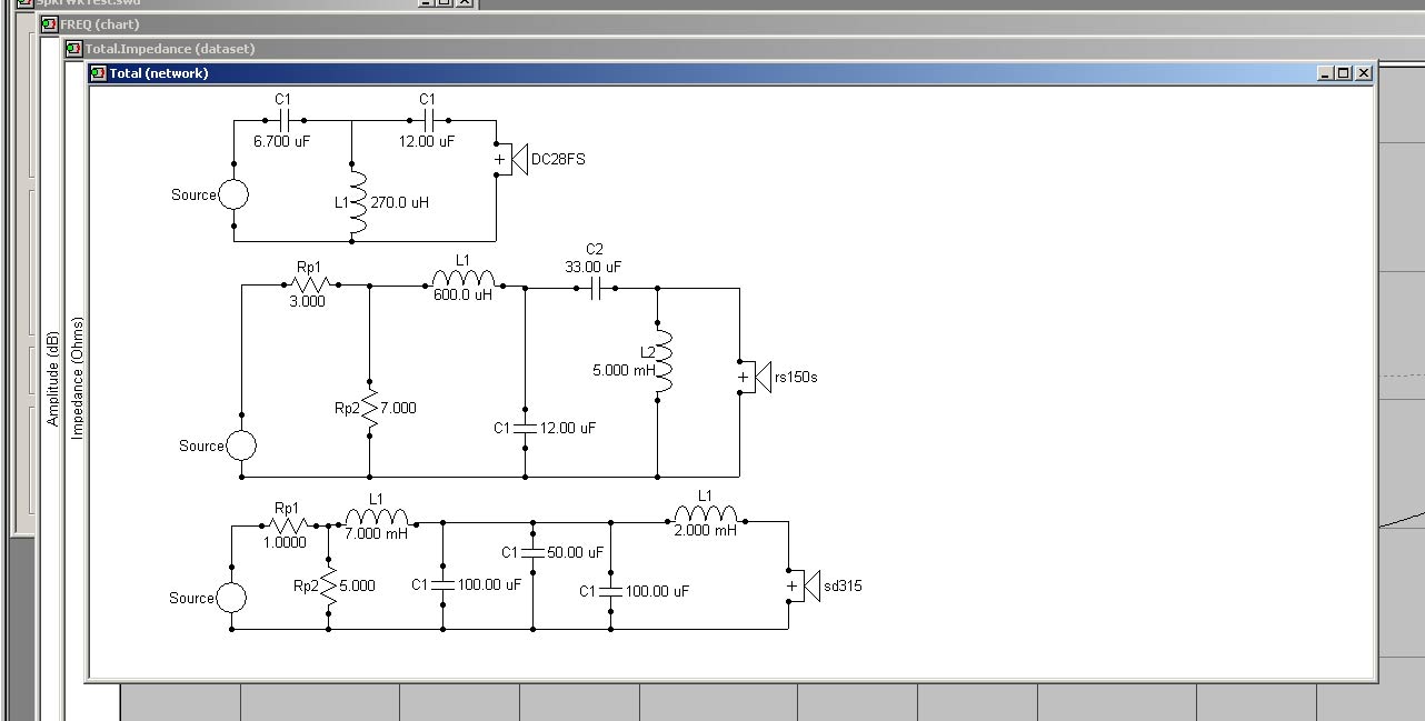

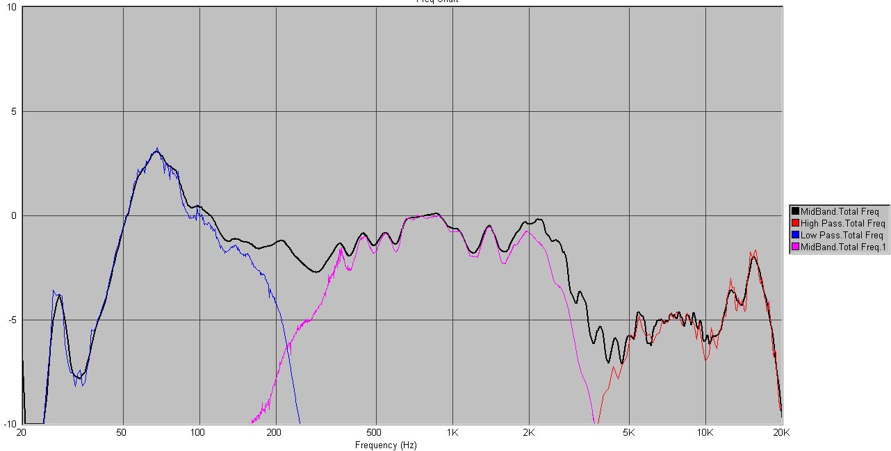

                                                So why dont I have any resolution when I combine a full system crossover?
                                                or apparently when I try to sum 3 individual crossover network responses .. this is the gating?
                                                • Blazin
                                                  • Jun 2007
                                                  • 167
                                                  Sooo
                                                  Impedance still diping down to 2 Ohms.. I need some help here..
                                                  One thing I'm confused about..
                                                  Gate + Nearfield = Gate.Splice..
                                                  Nearfield must be scaled down to match gated resposne; however, if you're scaling each response a different amount to meet their respective gates.. won't the Amplitudes be off?
                                                  Are you supposed to normalize them back to 0?
                                                  I got measurements down now, my new location is perfect! Just a bit confused about that procedure.. amplitude issues would obviously be causing issues with L-Pads, and various other crossover components.
                                                  The high is down ~ 6dB.. ideal BSC.. sure.. whatever.. I can't seem to match the levels.. this leads back to my prior question
                                                  Last edited by theSven; 27 May 2023, 11:13 Saturday. Reason: Update image location
                                                  • Dave Bullet
                                                    • 476
                                                    Hi Blazin,
                                                    First - if you are modeling the combined network - use one source not three. In my simulations - 3 different sources for a 3 way crossover gets the woofer/mid out of phase. This could lead you to think the polarity might need to be inverted (and if your target is LR4 for all Fc then drivers will have the same polarity - since 360 degrees phase wrap).
                                                    For a 3 way design, you typically need to take your gated measurements further than the standard 39" (1 metre) used for a 2 way design. This is so all drivers resemble more of a point source. You probably would benefit from a larger room. If that isn't an option - you can nearfield all drivers (maintaining the same amp output level and mic pre-amp level) then HBT transform to get phase data. Import into SW then enter acoustic offsets for each driver in the combined XO.
                                                    Maybe if you can post your raw driver FRD and ZMA files here - I can validate your use of SW (or help you troubleshoot SW problems with the measurements).
                                                    Cheers,
                                                    David.
                                                    • Blazin
                                                      • Jun 2007
                                                      • 167
                                                      Hi Blazin,
                                                      One source? all drivers wired in parallel?

                                                                    Alright, so looks like I'm getting pretty good resolution..
                                                                    0-7.5ms on my gating.. can't get anymore.. im at around 4.5-5 feet. I'm getting wall reflections.. but not exactly wall.. more like.. benches on the sides of the room..
                                                                    So I guess I understand this as.. Crossover points are all I care about.. I can't control whats going on under lets say 100Hz on my sub.. I just need to make sure it crosses over at my selected freq (I think 210 is too low.. 250 may be in order).. and on the high end.. i'll probably select 2500, well within range on both mid-tweeter
                                                                    CJD - Far field gated measurement of Mids in series.. about.. -10dB.. parallel -5dB
                                                                      it doesn't matter, the question is which works better with the woofer SPL (and tweeter, though that's usually not the bottleneck). In parallel I suspect would require padding down, which is to be avoided where possible (hence, wiring in series to knock out 5dB). The Khans run the RS150's in series and an unpadded RS28A tweet... and themids might still be 1/2 to 1dB hot.
                                                                      250 is good, I'd not recommend 2500. 2100 is listenable but my preference for the RS150 is 1800. (I don't prefer it enough to have gone and updated the crossovers in my original RS150's, which still have the 2100Hz 4th order crossovers)
                                                                      7.5ms should work.
                                                                      Getting measurements is THE pain. Once you master this, you're golden. It gets easier for me every time.

                                                                        UGH i cannot get the impedance right for the tweeter.. I can't not get 1.25 Ohms..

                                                                          FRDs attached below..
                                                                          new annoyance some 10KHz peak.. :M
                                                                          Anyone wanna try and help me out.. I don't think there is a way to cross the DC28 and RS150 well.
                                                                            You need to include impedance files for anyone to help you. Just glancing at the tweeter FRD, that's one ugly response, but I suspect that 10K peaking may be baffle effects. Are the drivers flush mounted? 10K would be about right for reflections off the edge of the tweeter or maybe the mids.
                                                                            • Blazin
                                                                              • Jun 2007
                                                                              • 167
                                                                              Originally posted by Dennis H
                                                                              You need to include impedance files for anyone to help you. Just glancing at the tweeter FRD, that's one ugly response, but I suspect that 10K peaking may be baffle effects. Is the tweeter flush mounted? 10K would be about right for reflections off the edge of the tweeter.
                                                                              Yea it is.. but look 10K is on all responses.
                                                                              I can't upload ZMAs.. too large for the forum.. 100k max and my files are like 300k
                                                                                Even zipped? Why are they so big?

                                                                                    Weird note..
                                                                                    The Nearfield response of my DC28FS looks VERY much like the RS28A response..
                                                                                    aka it starts to roll off at 1KHz..
                                                                                    Odd.. I think my farfield measurements are off.. UGH

                                                                                      Taco gave you good advice way back. Make the tweeter cap much smaller to keep the impedance up. Using your FRD and PE's ZMA, here's a quicky pass in LspCAD using 10uF and optimizing the coil for a 1.8K LR4 response. I actually got a slightly better SPL fit with 12uF but the impedance was dropping below 3 ohms. 10uF keeps it above 4 and the fit isn't much worse. That resistor is just the nominal ESR of the coil.
                                                                                      Last edited by theSven; 27 May 2023, 11:14 Saturday. Reason: Update image location
                                                                                        I had an issue at 12kHz with a faulty solder joint in my cables way back when. You can see it in some of the original MTM measurements I put out there. This stuff *really* is a headache sometimes.
                                                                                        On the other hand, if you're confident the data is good it won't prevent you from working with it, anomalies and all.

                                                                                          Hmm I was using a clip today to make it easy to reach.. that was probably it..
                                                                                          thanks for that hint..
                                                                                          and Dennis.. I see why I was failing.. I was trying to crossover too high!
                                                                                          OK!
                                                                                          Lowest Dip is 2.6 Ohms.. My Receiver does 3.. ok?
                                                                                          I see there is some of the total response falling underneath the individual response.. I recall someone saying this is bad..
                                                                                          How could I fix this.. 4th order filter on the Lowpass @ 1.8K on the Mid?
                                                                                          I reversed the polarity on the tweeter, because there was a huge dip at 1.8K
                                                                                          I think I'm good to go!
                                                                                          Am i?
                                                                                          Last edited by theSven; 27 May 2023, 11:15 Saturday. Reason: Update image location
                                                                                            You have to start looking at the phase to get a good blend. In a perfect world they would be in phase at all frequencies or at least through the crossover region. You might need to adjust the XO to compensate for acoustic center offsets -- the AC of a cone driver is behind the baffle. And that's assuming you measured phase right in the first place which is a BIG assumption. It's a delicate balancing act -- SPL, phase, impedance, how they all sum.....
