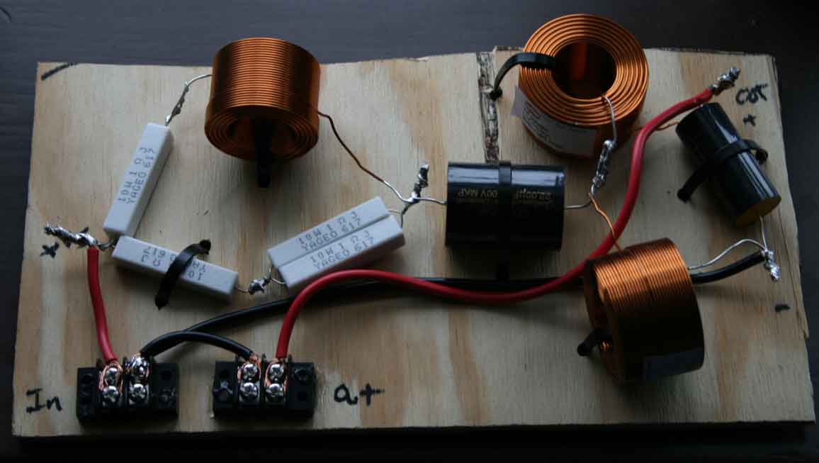

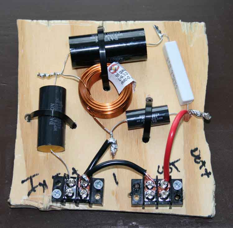

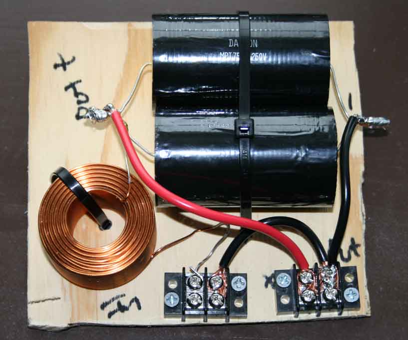

                                      Crossover Pics:
                                      Tweeter
                                      Mid
                                      Sub
                                      Last edited by theSven; 27 May 2023, 11:24 Saturday. Reason: Update image location

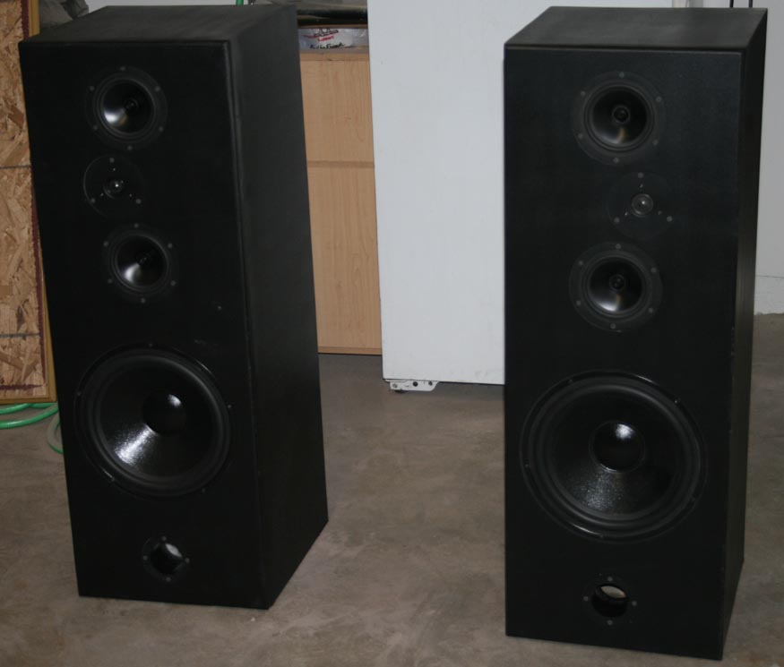

                                        Finished!
                                        Last edited by theSven; 27 May 2023, 11:25 Saturday. Reason: Update image location

                                          Update, added finished enclosure pic.. need to do final impedance/fr testing tomorrow

                                            #156
                                            Nice to see the finished product. Good work.

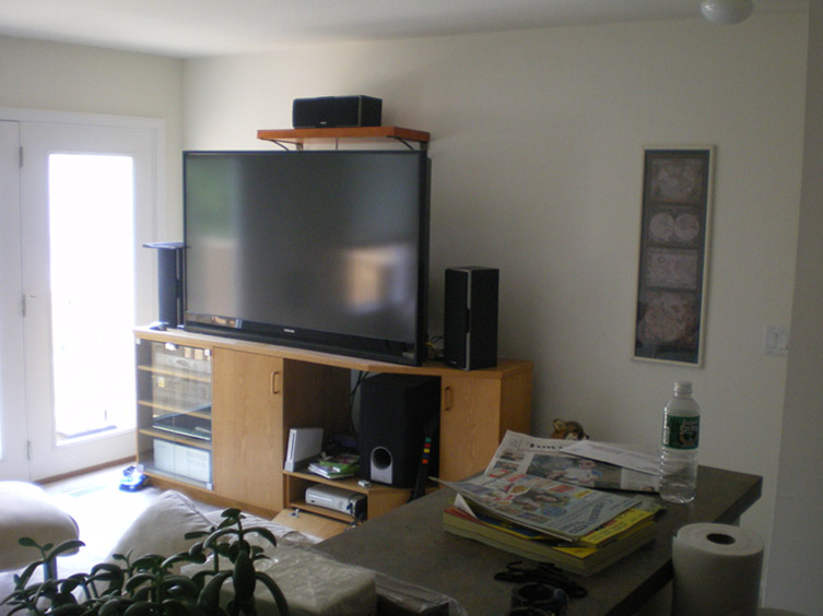

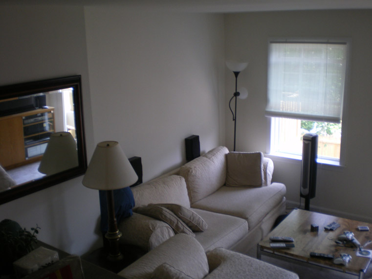

                                                  Final room placement isn't exactly determined as of yet.. I have rather small rooms for such large speakers.. ie they'd be close to back wall
                                                  I plan on doing on axis/off axis (30-60*) measurements tomorrow...
                                                  Room pictures
                                                  For reference, the farthest side of the tv cabinet has about 16-17" next to it in width.. I could fit the speaker there.. but it'd prolly create quite a bit of bass in such a tight area.. oh well hah

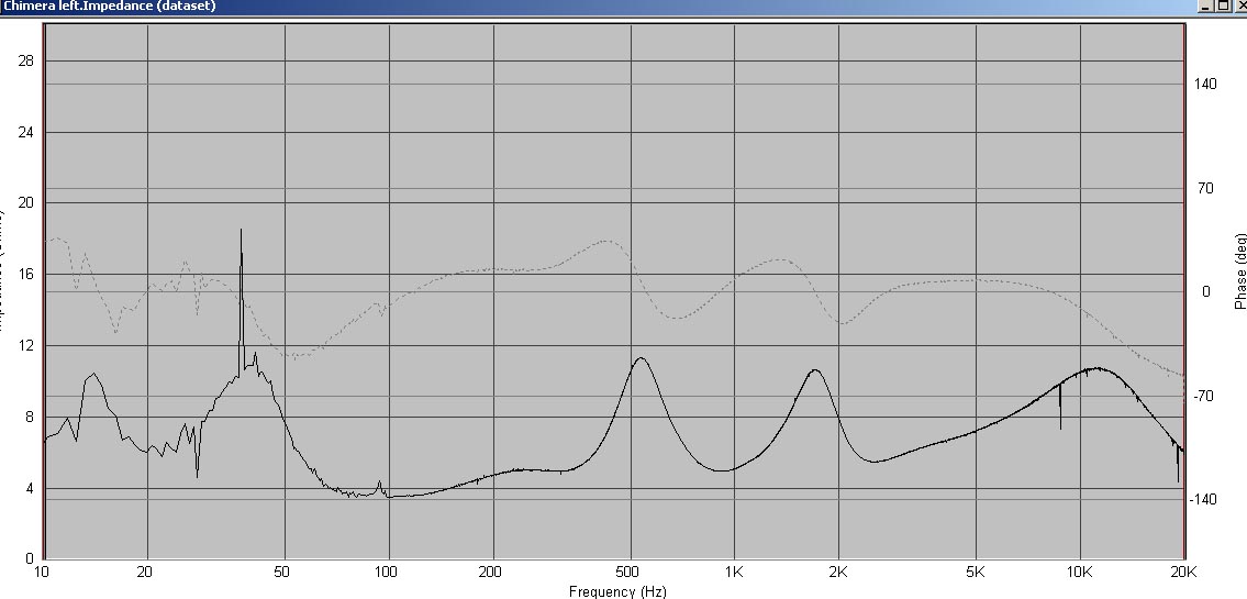

                                                    Uh so.. how am I supposed to be measuring these to provide full 20-20K FR?
                                                    Impedance measured.. looks good, will post later.

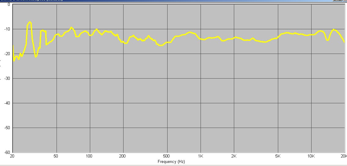

                                                          Measurements:

                                                          • Dave Bullet
                                                            • 476
                                                            #164
                                                            Dang - you've done pretty damn good. :W The FR response looks great to me (esp. 50 - 200 Hz). Your placement in room must be great.
                                                            Big pat on the back to ya!
                                                            David.
